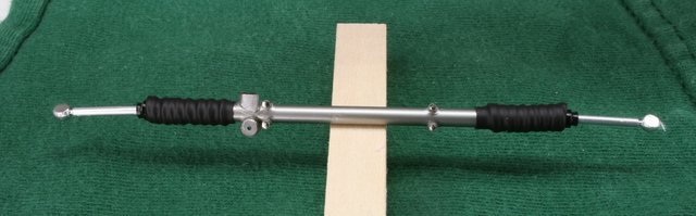

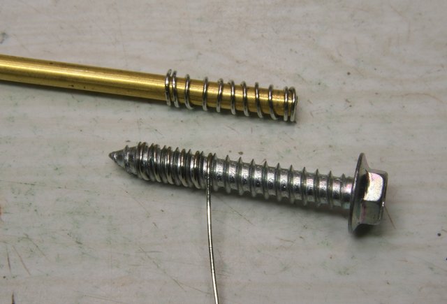

I spent most of the day scratchbuilding a new steering rack.  The kit one has huge gear teeth on it to connect the steering wheel to the front wheels, but I will be making it more scale like.
First make the rubber boots by winding some 0.022" beading wire around a screw to get a coil shape.
Then I cut some small sections of tube that fits over the 0.125" steering rack body.  This will be part of the boot.  Then made the steering column connection housing.

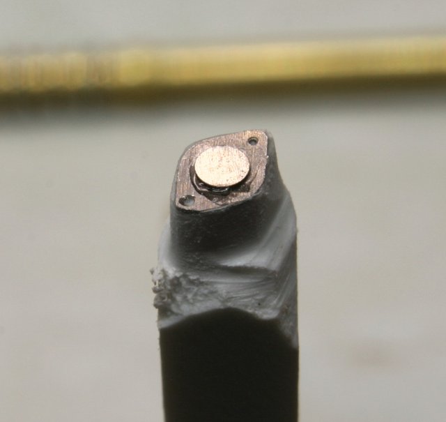

There is also a diamond shaped access port at the steering column connection.  I found a PE exhaust header that was the right size.  CA'ed it to a square piece of styrene and shaped it.
Then drilled a 1/8" hole just below the end and separated it.  This will let it sit on the steering rack body correctly.
Test fit
Next, needed the rack mounting bolts.  I will use straight pins to attach the rack to the chassis.  1mm brass tubing will come in handy.  I milled some indentations into the rack body tube and CA'ed them on.
The rack is mostly done except for painting and coating the coils with Micro Crystal Clear, or canopy glue (white glue) to form the rubber boot.   (Also made styrene pieces to form the other end of the boots). This may need to wait until I am closer to mounting the parts on the chassis to get the right length and angles of the connecting rods to the wheel hubs.

Try  some heat shrink tubing for the boots, it works well and gives you some flexibility too.  Wonderful detail on one of my favorite cars.
  • Like 1
  • Thanks 1
That's a great tip, Big John.  I did a test and it works perfectly.  Fortunately, I had the right size tubing already.

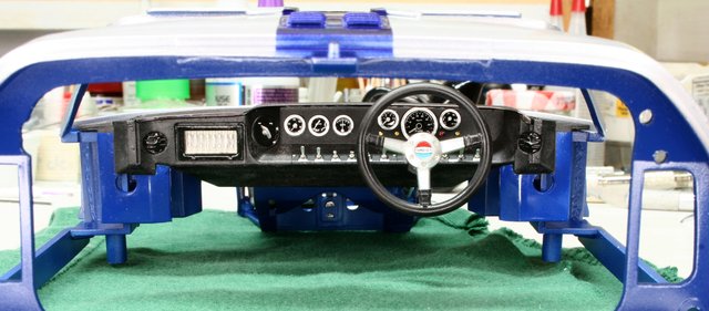

Latest progress...
Finished off the steering rack.
Test fitting the radiator and shroud.  They will be installed after this assembly is joined to the chassis.  I am working through a number of assembly sequences - deciding when they need to be done to avoid any problems.
Instrument panel and steering wheel installed.
As can be seen, the color scheme will be silver with a dark blue stripe.
I'm currently working on the body latches that will hold the front and rear clips.  This needed to be worked out before joining the two major parts.  Working latches are needed to ensure the body panels fit well.

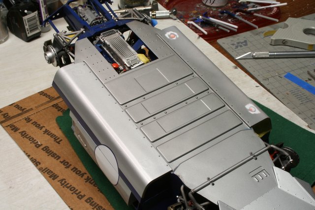

This build has reached a significant milestone today.
I got the doors painted.  I'll put number roundels on with no number.
Now I was ready to join the center section of the body with the chassis.  Everything went together without issues.
The doors don't fit perfectly with even gaps all the way around, but it's close.  I was concerned that they would fit worse when the center section was joined to the chassis, but it appears the fit of the doors didn't change after joining.
Now I need to paint the bottom side panels and deal with the open screw holes.
  • Like 3

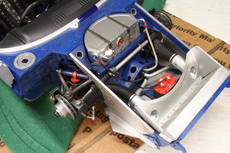

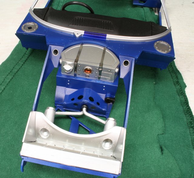

I finished painting the side pod and moved on to the front end detailing.
I fabricated the side panels out of aluminum sheet since I rebuilt the front brake cooling ductwork to delete the holes for the hoses.
Here, I tried to simulate weld lines by using an excess of styrene glue and then making weld bead impressions with the end of a rod.  This was done when assembling this piece to the mid-section some time ago.
I moved the Optima battery to this location from the passenger footwell.  I decided to use this battery as this is a 'modernized' GT40 and not an 'as-built' one.
So the front end is pretty much done, except for the wiring to the headlights.  There is an open area just in front of the doors on each side that should be covered over.  When the front clip is raised, it is visible, showing a large empty space that shouldn't be there (just below the fuel fillers as seen in the lower right in the picture above).
Thanks for looking and following along.
Edited by kensar
  • Like 4

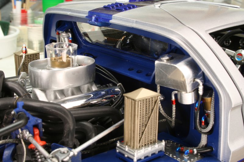

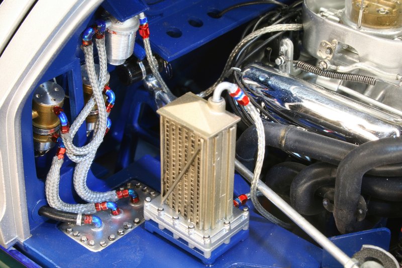

This past week I focused on the engine bay and have it mostly completed.
I re-made the reservoir for the cooling system from aluminum.
Now on to the front and rear body clips.
