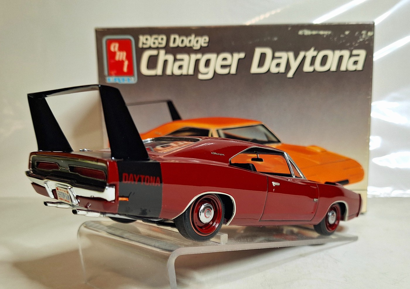

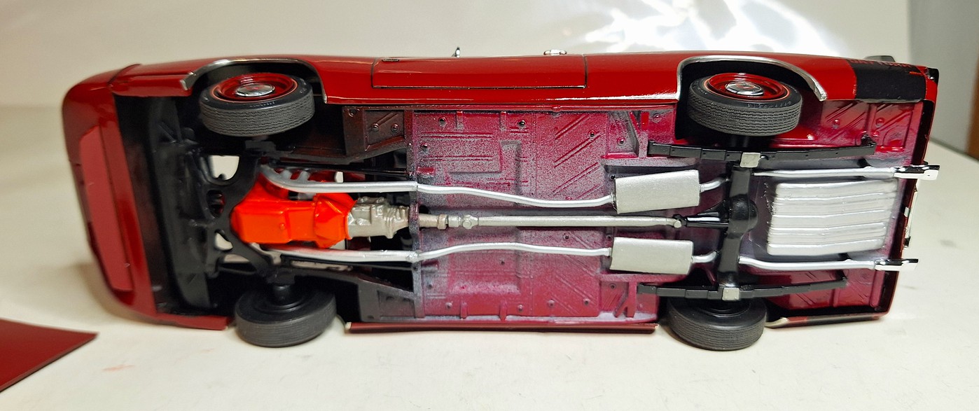

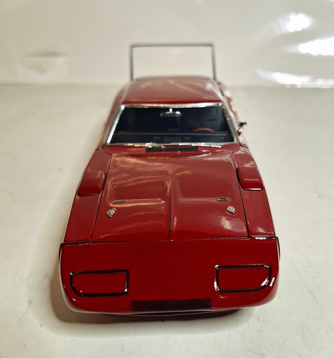

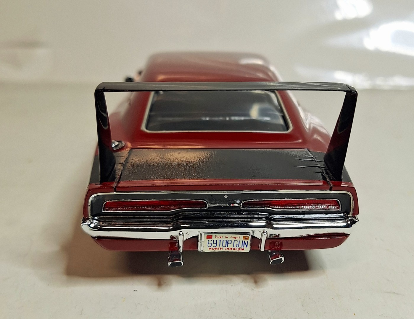

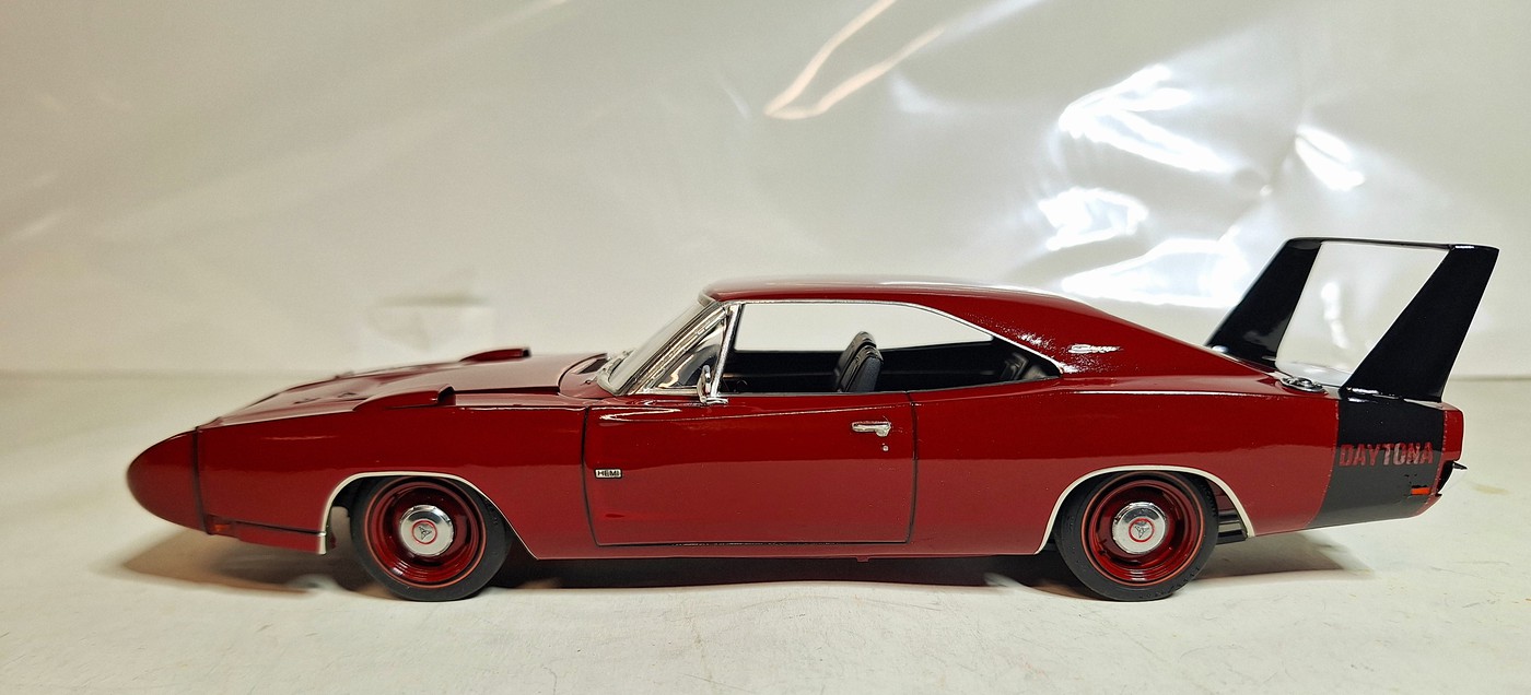

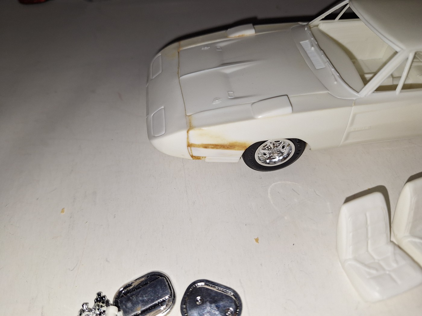

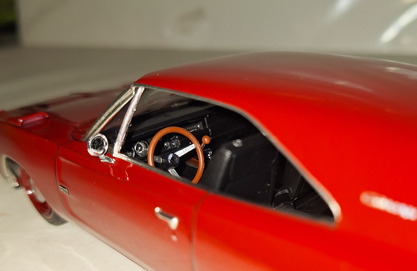

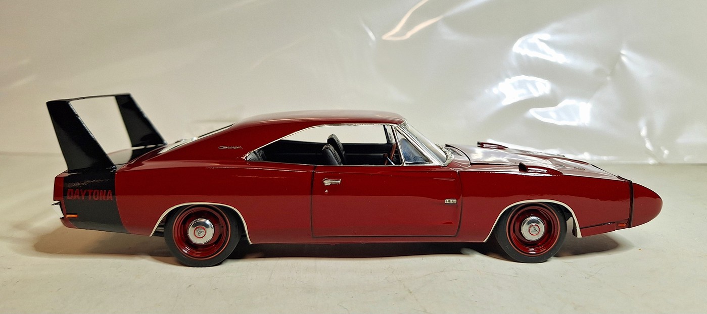

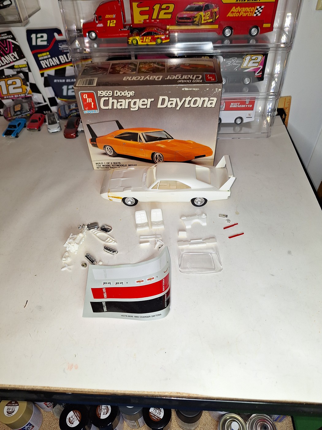

THarrison351 Posted May 19, 2024 Posted May 19, 2024 Another one started thirty some odd years ago. Next to last picture is how it was in the box save a tire inconveniently burning the windshield glass. AMT converted the Charger 500 into this car which ironically had once been a Charger Daytona before becoming the DOH kit, hence the incorrect rear window for so many early issues. This old mold has been around. I stole some parts from the Revell Daytona that weren't needed for the race version. I used this kit's decals...regretfully. I really had no options. The Revell decals were terribly brittle. The color is Testors dark red over black primer. I used Fireball resin wheels and hubcaps. I also purchased a recent issue "Country" Charger for window glass and a better bumper. The last picture was the filler I used way back when. Super glue and baking soda. A lot of my old models have had this filler fail. I scrubbed it with Wesleys and a toothbrush, then coated it in spot filler. I also created a front spoiler from sheet plastic. I copied the Revell piece. Thanks for looking! 8
