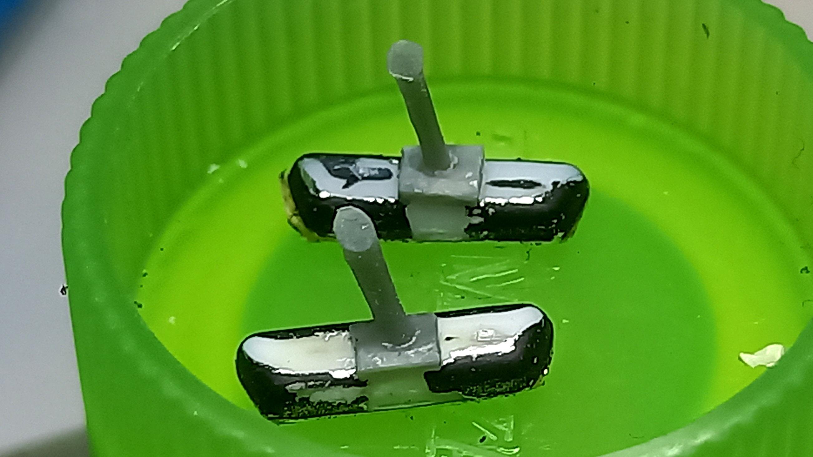

Csaba aka felhasznaaloo Posted October 27, 2024 Author Posted October 27, 2024 18 hours ago, espo said: Would a light coat of Clear Green help tone down the metallic appearance? Maybe. Painted over with the darker unstirred paint, the metallic flakes still show through when you look at it in direct sunlight.

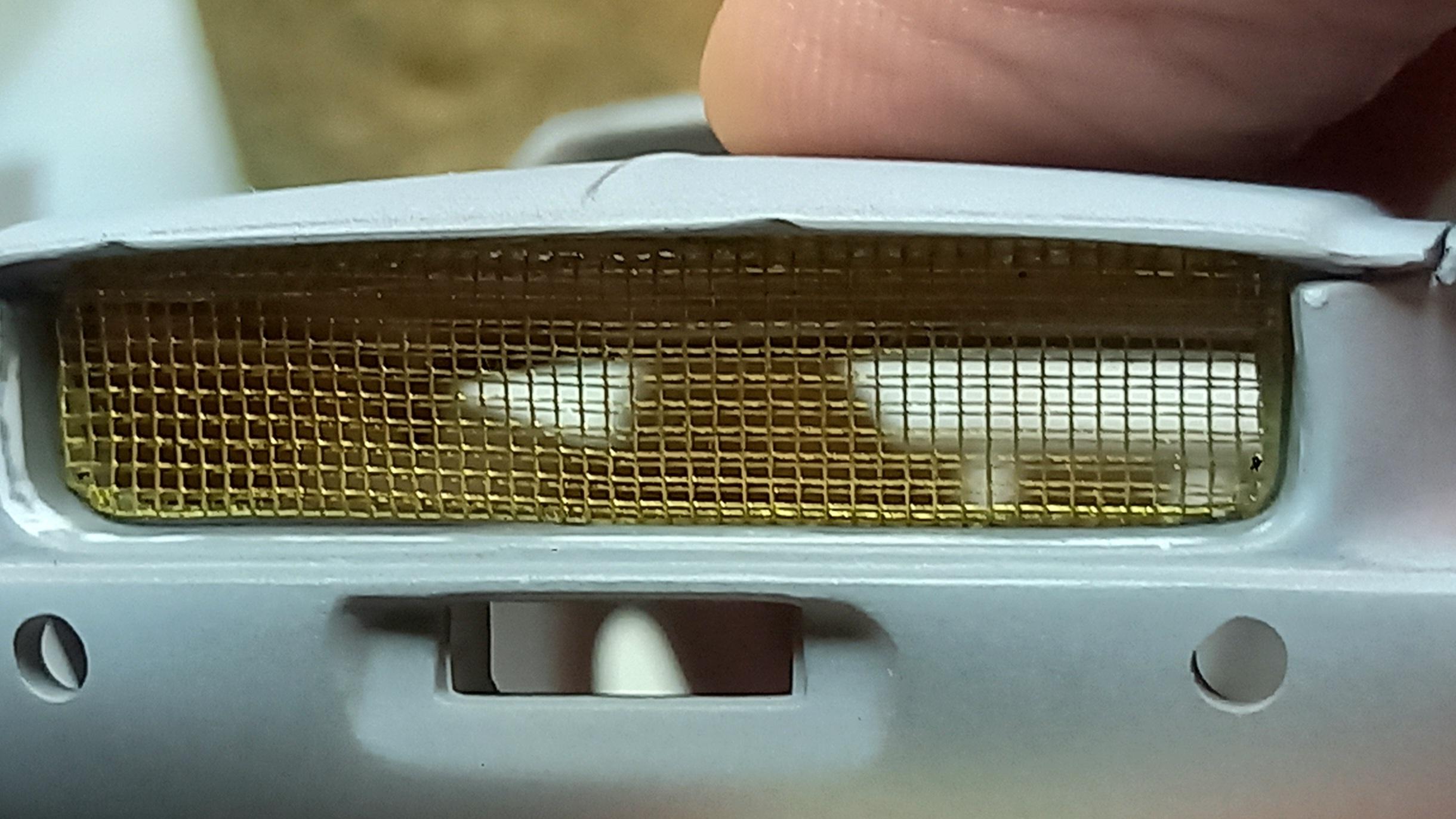

Csaba aka felhasznaaloo Posted October 29, 2024 Author Posted October 29, 2024 Update: grills are in. Cca 1/32" square mesh in double layer, overlapped with half a square. Built crude overhead consoles with map lights. 2

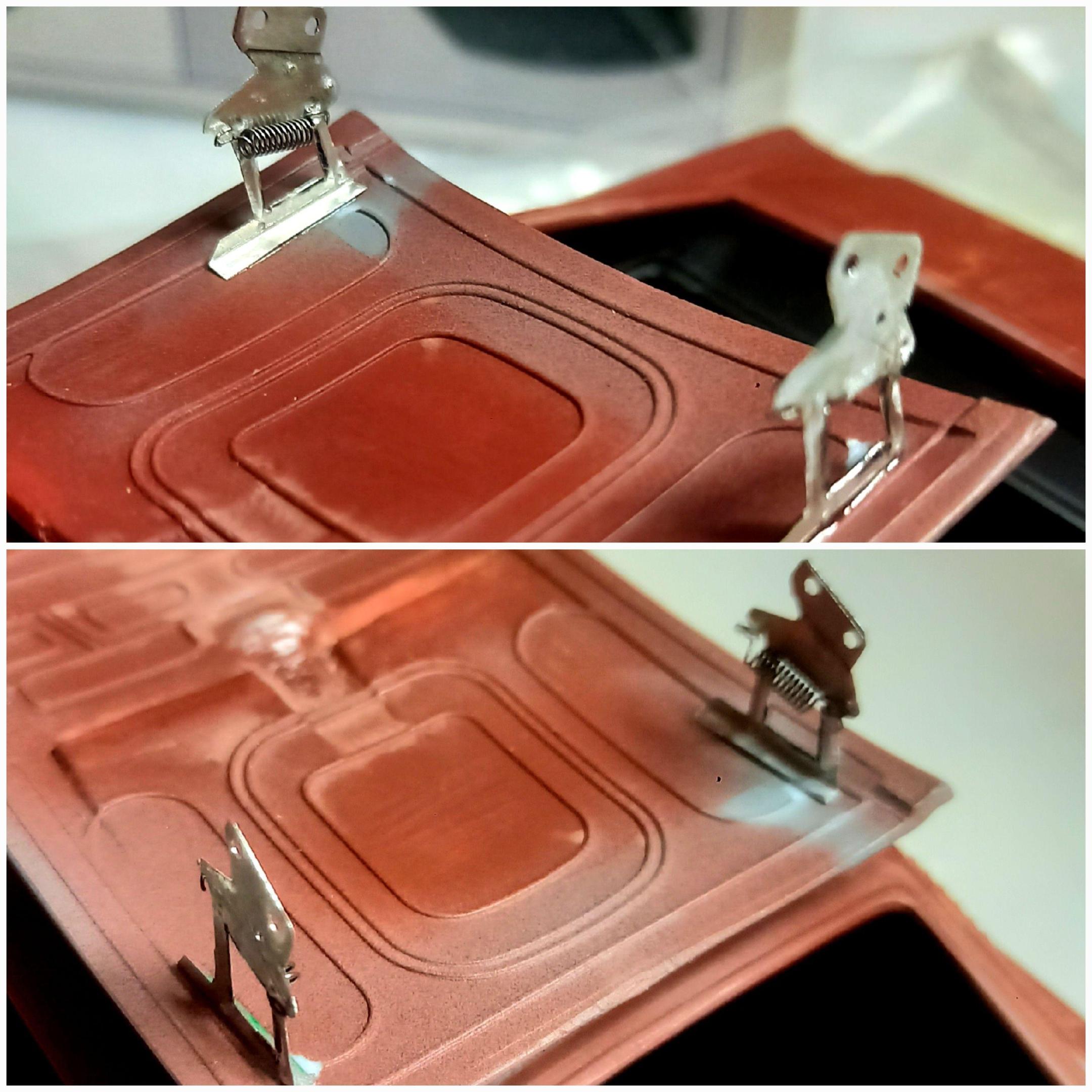

Csaba aka felhasznaaloo Posted November 17, 2024 Author Posted November 17, 2024 A little update: almost forgot to replicate the front side of the radiator, which was necessary since I did not cut an opening in the radiator support. I used a piece of tulle(?) ribbon and heat shrink tube slices on both sides. I also made "cheating hood hinges" out of beercan material ? and some coil spring from a 4-color pen. These hinges will not operate properly - did that on my '70 Dodge Challenger build, not this time. So the hinges will just sink into the engine bay when the hood is closed, and will rest on a pair of flanged studs at each side when the hood is up. Managed to blue tack the hinges in the lowered position, then glue the hood onto them on one model so far. Also had highland green paint custom mixed without the metallic flake, and semi gloss 2-part clear to go with it, though haven't tested them yet. 6

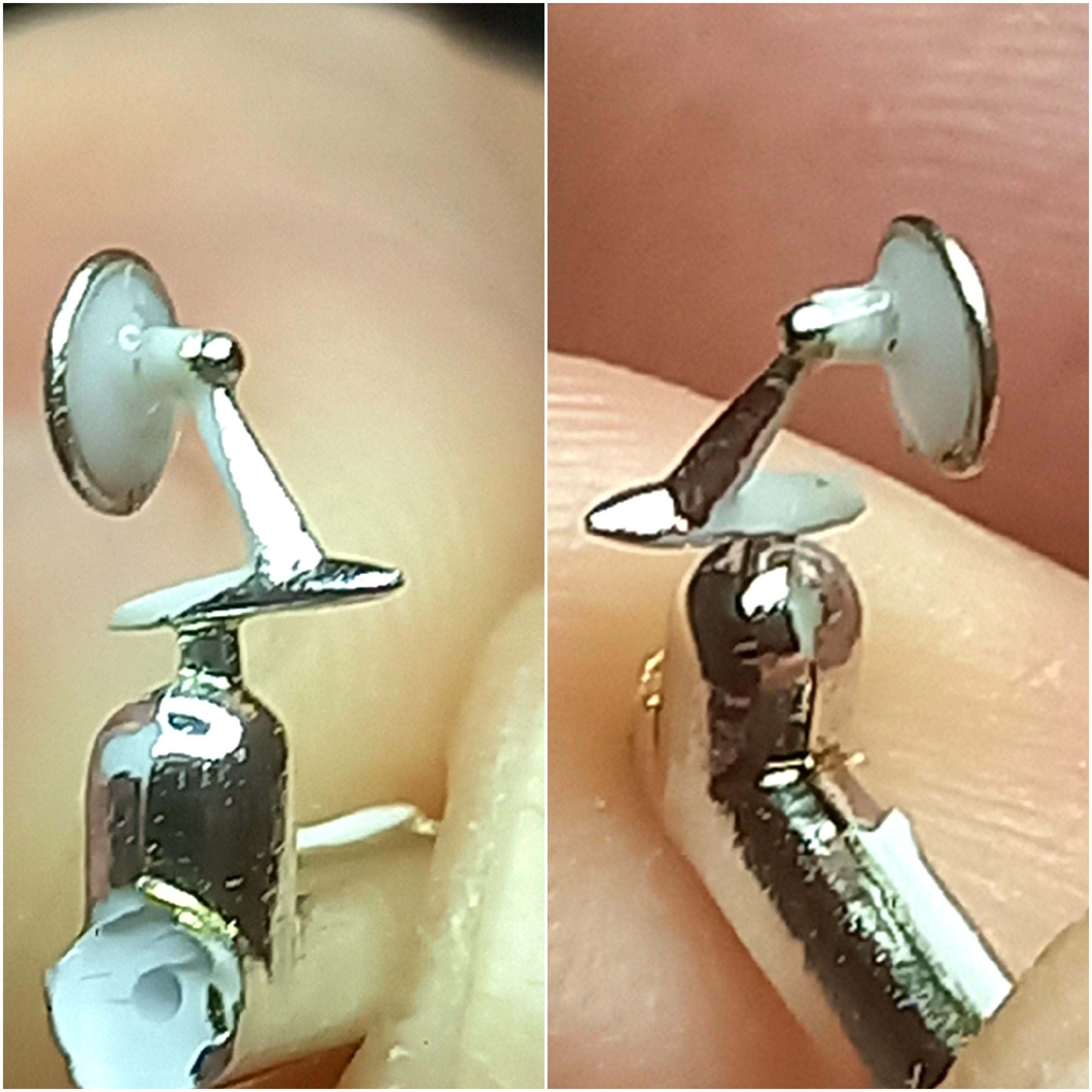

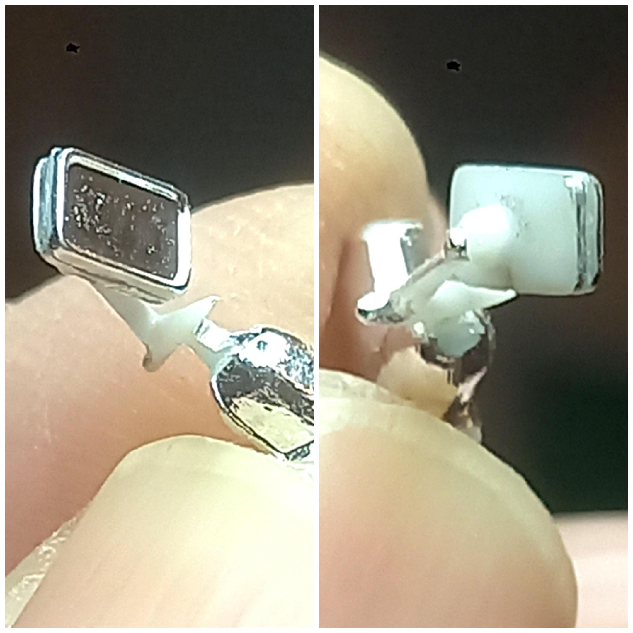

Csaba aka felhasznaaloo Posted December 11, 2024 Author Posted December 11, 2024 Hello all. When I started out model building, in 2012, I asked my first questions, shared my build progress, and made a few modeling friends on the Scale Auto forum. I was surprised back then how many people generally contributed to that forum. Now/here I get the feeling this is a nice little club with just a few faithful patrons. Much less scary 😉 Teeny tiny update here. Both bodies are now prepped for painting the color, apart from some masking/salt application on the survivor car. Made / modified mirrors and sun visors while gathering courage for the painting 😁 (little scared I'll screw it up). 2
