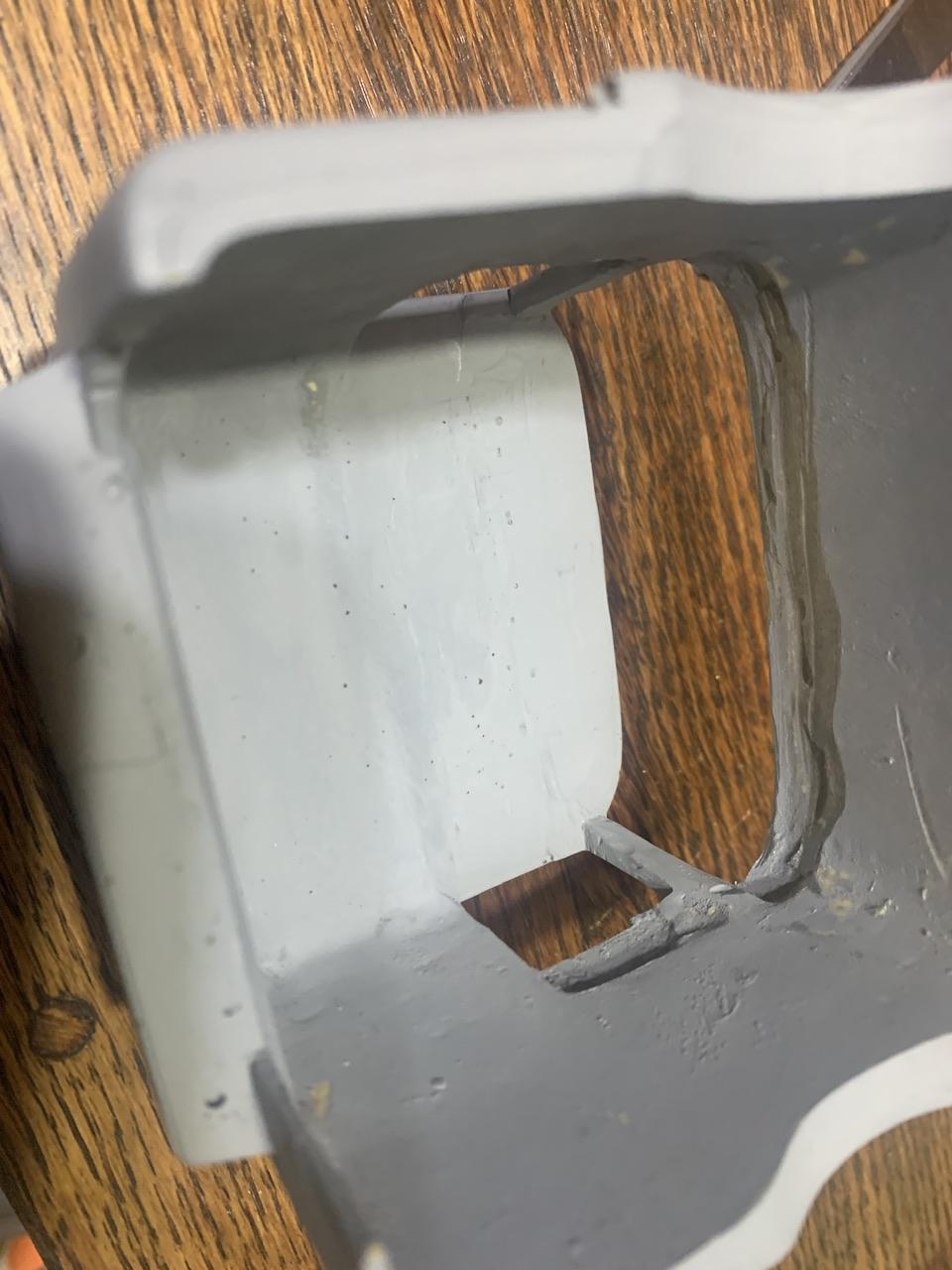

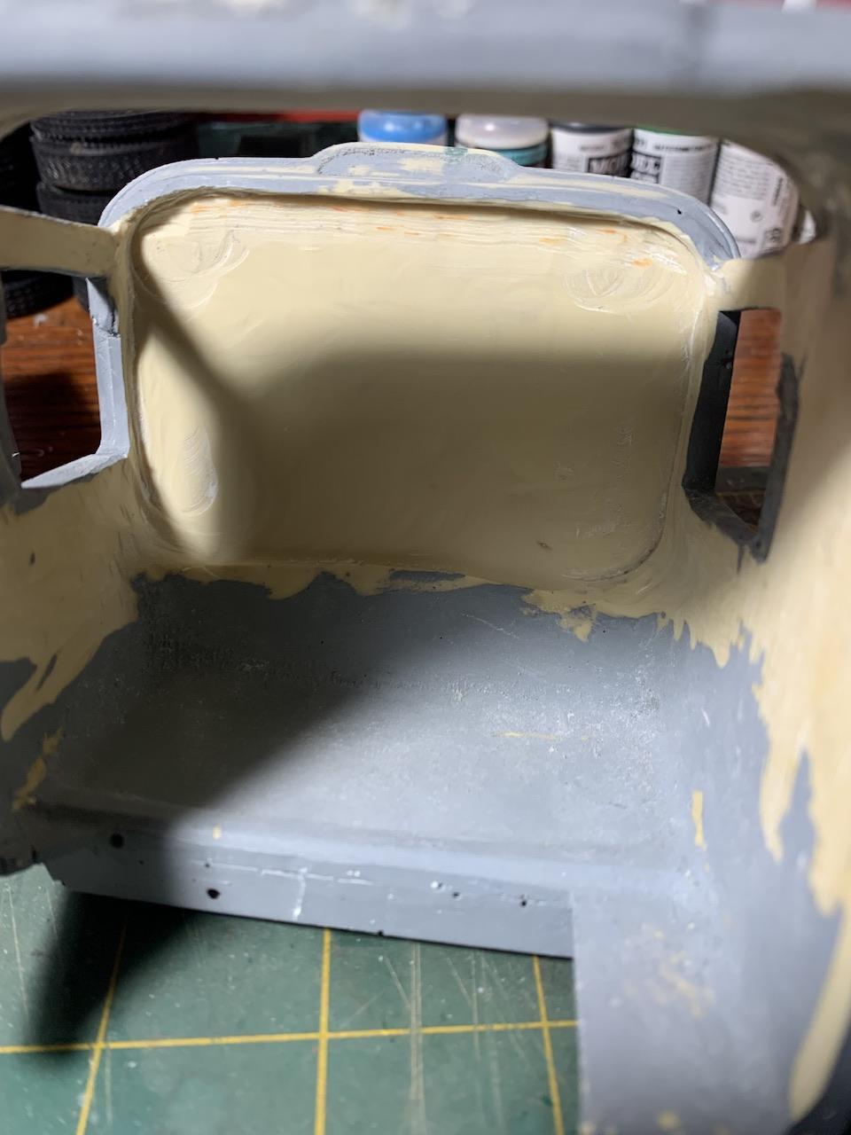

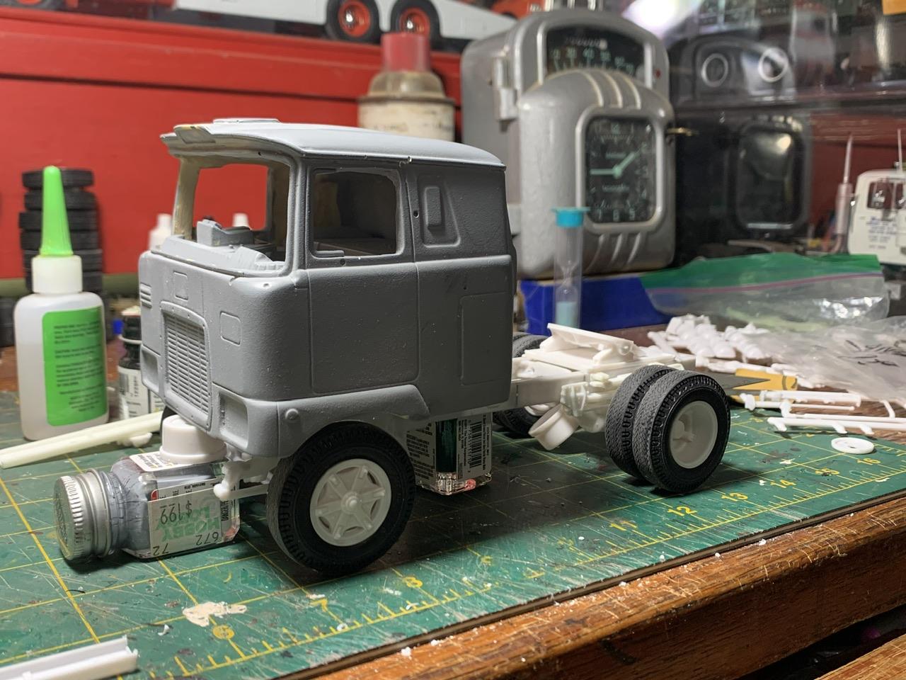

DRIPTROIT 71 Posted May 25, 2024 Posted May 25, 2024 Next project started. It is an old M.T.F.A. Cab. For those of you who have never used one of those, they are very thick and require a lot of grinding. 2
Jim B Posted May 25, 2024 Posted May 25, 2024 (edited) Nice start. Aren't the M.T.F.A. cabs fiberglass, or are those the AIM cabs? Edited May 25, 2024 by Jim B
DRIPTROIT 71 Posted May 26, 2024 Author Posted May 26, 2024 On 5/25/2024 at 10:17 PM, Jim B said: Nice start. Aren't the M.T.F.A. cabs fiberglass, or are those the AIM cabs? Expand Thanks Jim. No this is resin. I’ve had several M.T.F.A. Cabs over the years and they have all been resin. Dave really did a good job of cleaning these cabs up when he sold these. I have built a couple fiberglass cabs and the ones that I have had were very thin and very light. Jamar was one of the old fiberglass casters if I am not mistaken. The Road Commander that I added the aerodyne roof to is fiberglass and the R-190 International that I built was fiberglass. I don’t think that I have ever seen an old AIM cab in person.

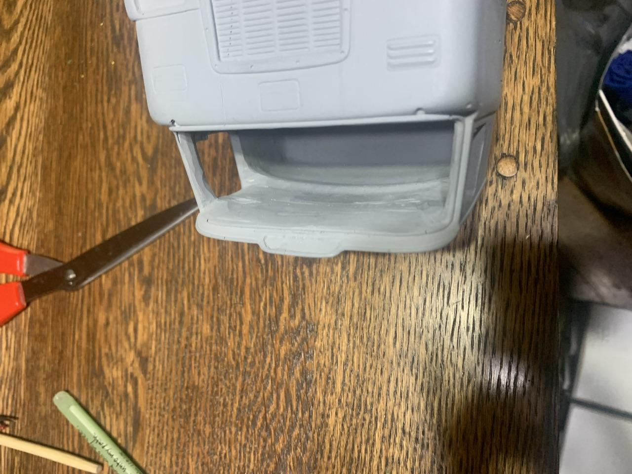

Chariots of Fire Posted May 26, 2024 Posted May 26, 2024 Hey, Brian. The rear of the top looks like it needs to be raised up some. Does it in fact slope backward a bit? I have one of those CF Mack cabs that is very thick as well and would really need some TLC to get it to look right.
DRIPTROIT 71 Posted May 26, 2024 Author Posted May 26, 2024 On 5/26/2024 at 3:32 PM, Chariots of Fire said: Hey, Brian. The rear of the top looks like it needs to be raised up some. Does it in fact slope backward a bit? I have one of those CF Mack cabs that is very thick as well and would really need some TLC to get it to look right. Expand The cab wasn’t mounted when that picture was taken. The entire cab is leaning backwards. I think that this might have caused it to look worse than it actually is. I’m working on the front hinge now.
Chariots of Fire Posted May 27, 2024 Posted May 27, 2024 On 5/26/2024 at 6:48 PM, DRIPTROIT 71 said: The cab wasn’t mounted when that picture was taken. The entire cab is leaning backwards. I think that this might have caused it to look worse than it actually is. I’m working on the front hinge now. Expand Ah, bad camera angle. Got it!?

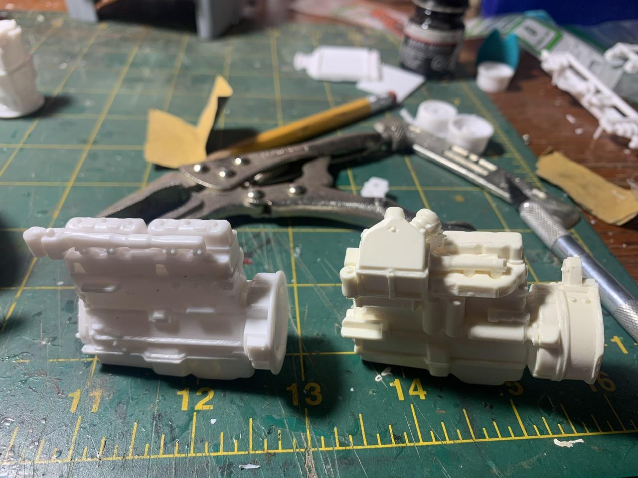

DRIPTROIT 71 Posted May 28, 2024 Author Posted May 28, 2024 Alright guys I need some expert information on this one. On the left is the kit engine from the Cruiseliner. On the right is a resin one that I picked up somewhere, I think off of Ebay probably. Notice the extension on the bell housing. At first I thought that it was just extra resin from casting, but it appears to be there on purpose. Did Mack run some kind of brake saver like Cat did? If not, what is this supposed to represent? Does anyone have any pictures of the real thing?
leafsprings Posted May 28, 2024 Posted May 28, 2024 (edited) Mystery why AMT never covered the F cab, IMO, they were a popular cabover. Oh well, we have to do them the hard way, glad to see you tackle this one Brian, the more Mack donor pieces, the better. It appears to be a flywheel PTO. Edited May 29, 2024 by leafsprings 1
Scott Eriksen Posted May 29, 2024 Posted May 29, 2024 That thick resin cab makes me want to start my Fleetstar build....... maybe ,,,lol
DRIPTROIT 71 Posted May 29, 2024 Author Posted May 29, 2024 On 5/28/2024 at 9:52 PM, leafsprings said: Mystery why AMT never covered the F cab, IMO, they were are popular cabover in the era. Oh well, we have to do them the hard way, glad to see you tackle this one Brian, the more Mack donor pieces, the better. It appears to be a flywheel PTO. Expand I knew that you would have the answer. I guess this will go back to the parts drawer for a later project. No need for live pto on a furniture hauler.?

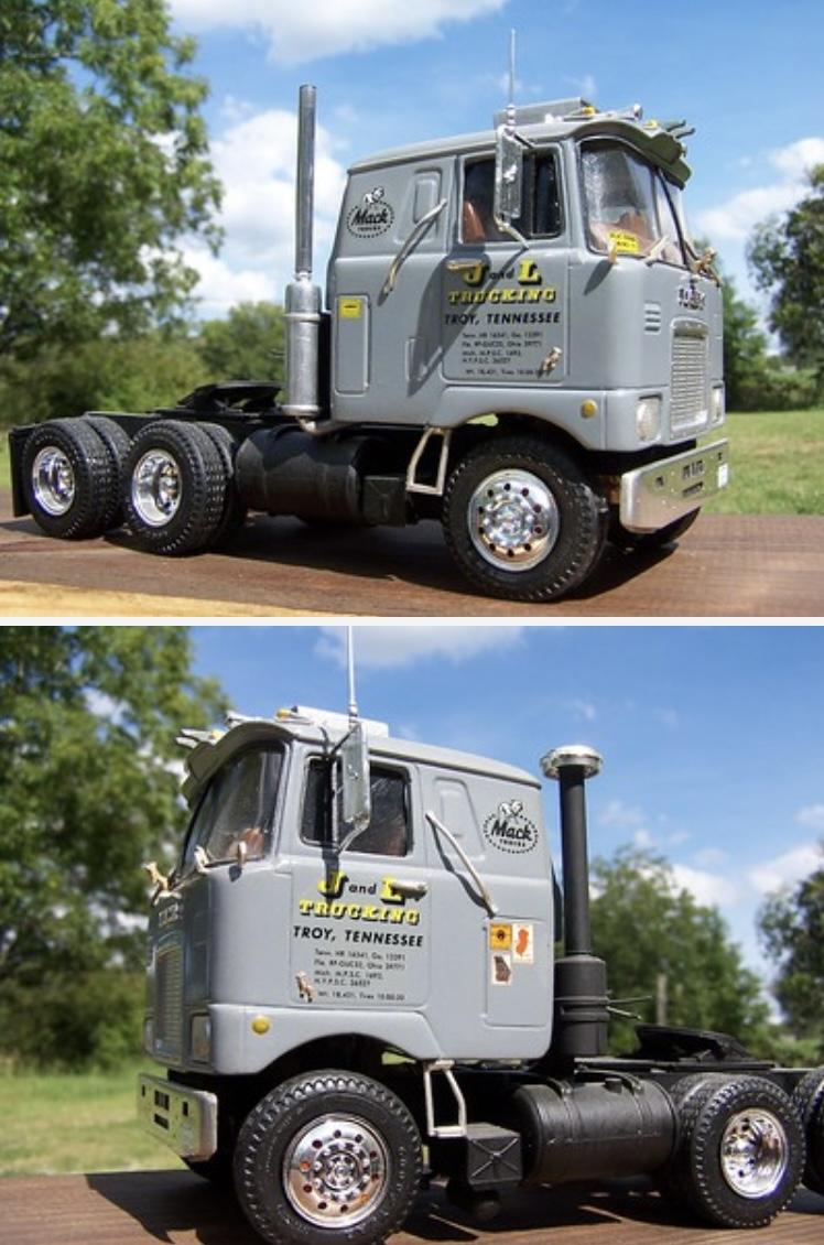

DRIPTROIT 71 Posted May 29, 2024 Author Posted May 29, 2024 This was my previous attempt at a MTFA cab. I built this one a little over 25 years ago. 3
Scott Eriksen Posted May 31, 2024 Posted May 31, 2024 On 5/29/2024 at 1:06 AM, DRIPTROIT 71 said: This was my previous attempt at a MTFA cab. I built this one a little over 25 years ago. Expand That's a good lookin' Mack bro!

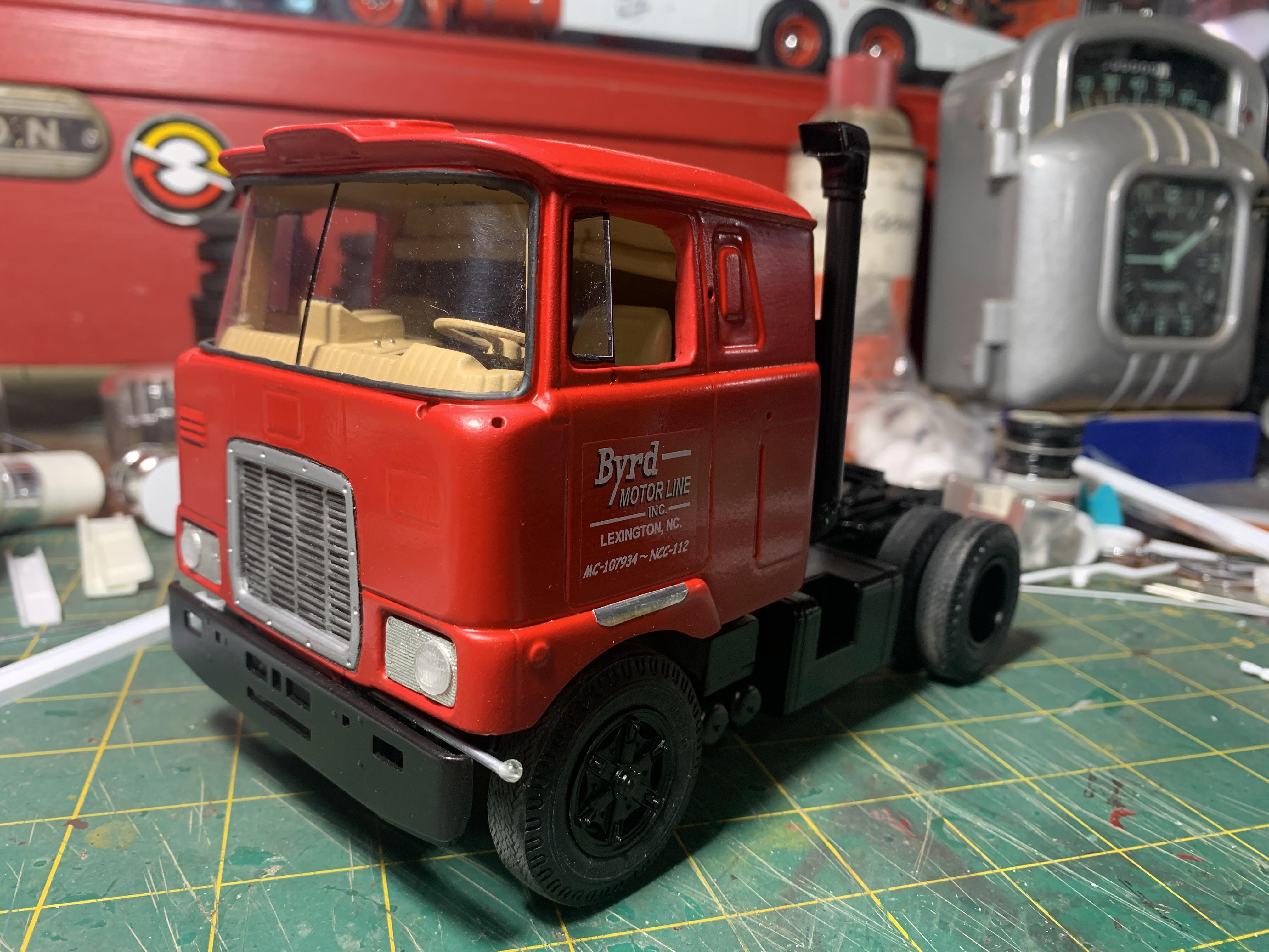

DRIPTROIT 71 Posted June 9, 2024 Author Posted June 9, 2024 Thanks for the comments! Getting closer to the finish line.
DRIPTROIT 71 Posted June 12, 2024 Author Posted June 12, 2024 Thanks for all of the comments guys! This one is done and Under Glass.
Repstock Posted June 13, 2024 Posted June 13, 2024 Looks great! I just started one, myself. From what I can see, I prefer the interior in yours! Well, on to Under Glass!
DRIPTROIT 71 Posted June 13, 2024 Author Posted June 13, 2024 On 6/13/2024 at 2:18 AM, Randy D said: That is a great result Brian!! Randy Expand Thanks Randy
