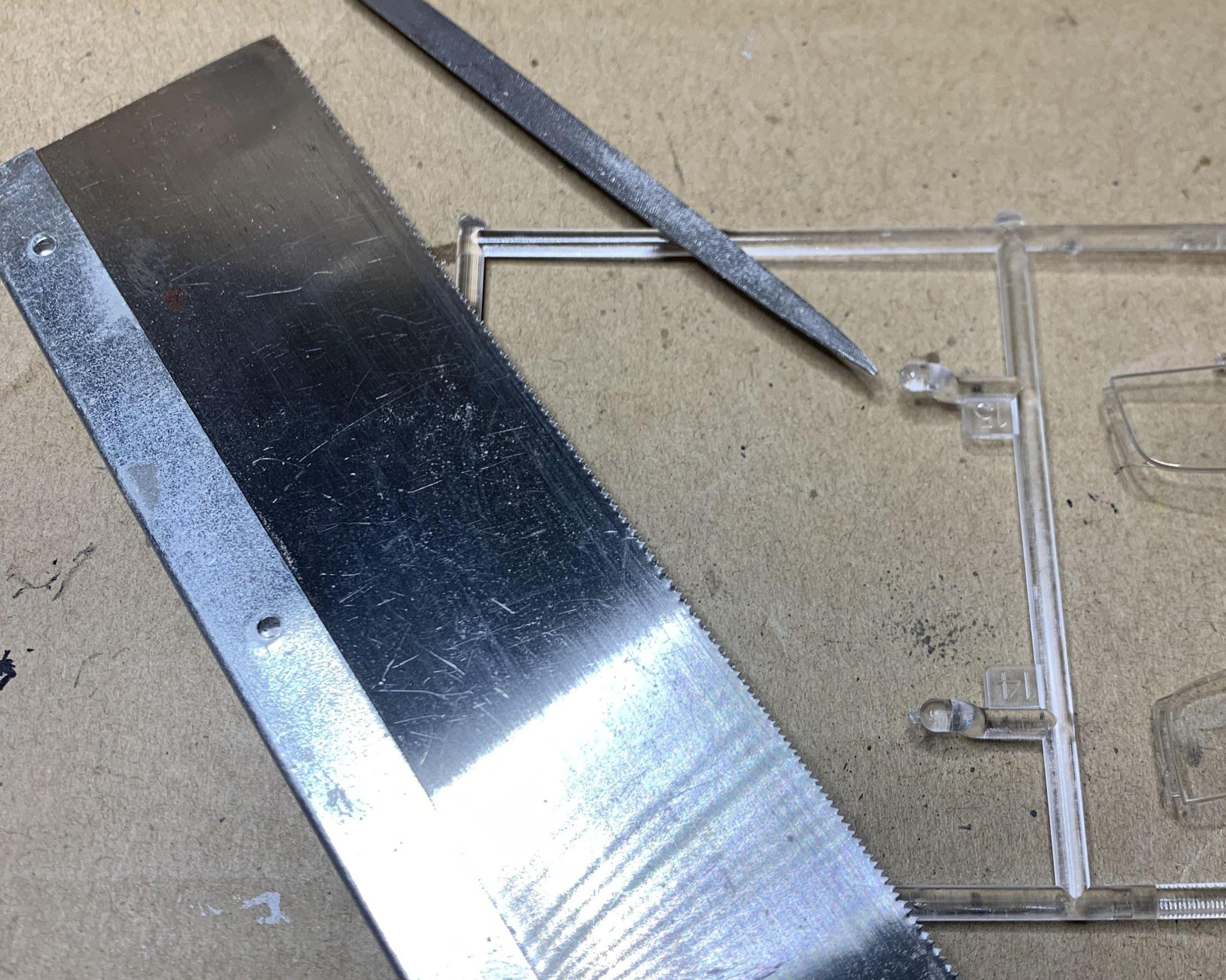

I used a file to round the bottom of clear sprue, then cut it off, glued it to the fuel pump and painted it clear orange.
Usually these are mostly hidden but on this one it's right out in the open, so I thought it could use a bit more detail.
Simple but fun!

Well that’s a heck of a detail!

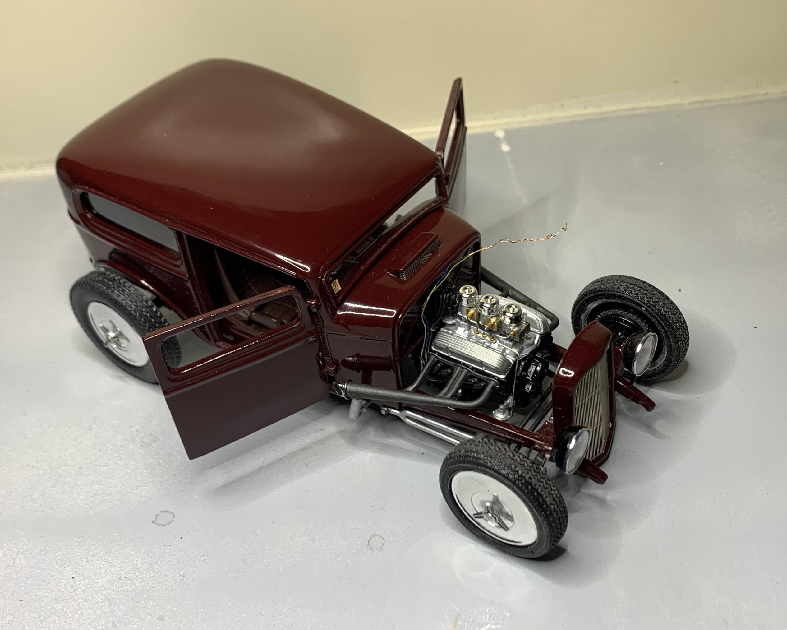

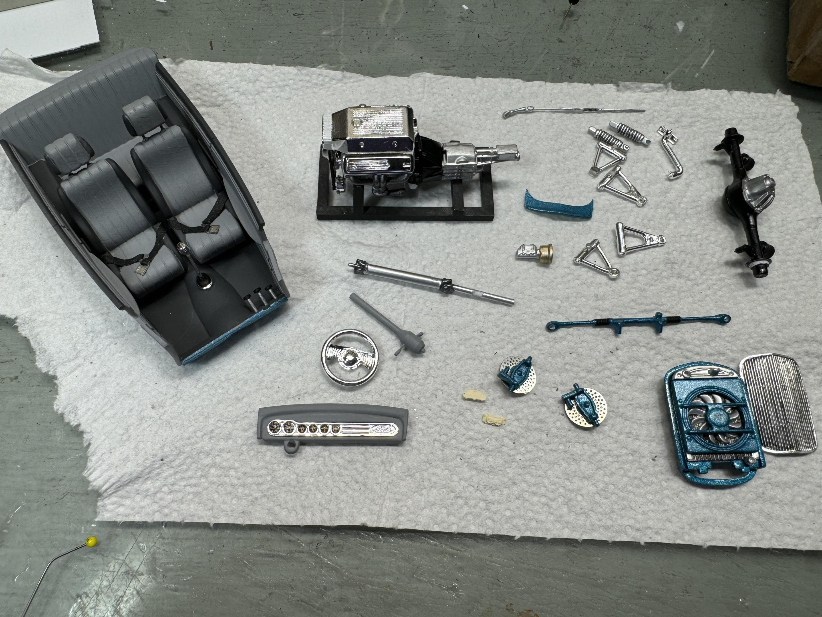

I'm making (slow) progress on the final assembly of my sedan. The engine is completed. The SBC block and accessories are from the Testors Boydster. I had components aftermarket chromed many years ago. This seemed to be a perfect opportunity to use it. The T-5 trans is from a Mustang kit. Block hugger headers are from the Revell '37 Ford. The interior is dialed in. Front seats and door panels are from the Speedwagon. I used a second set of seats to make the headrests. Dash center section and gauge panel is from the Revell '37 Ford convertible (blue kit). Billet style steering wheel is from the Monogram 55 Ford pickup (red kit). I'm using the IFS from the AMT Phantom Vickie [sic] and photoetched disc brakes. I have so little space between the discs and the wheel, I'm having a hard time fitting in brake calipers (track width is a concern). I'm using some resin calipers from Reps and Mins of MD. Hopefully I can get this done over the upcoming long weekend.
Thanks for looking.... -RRR

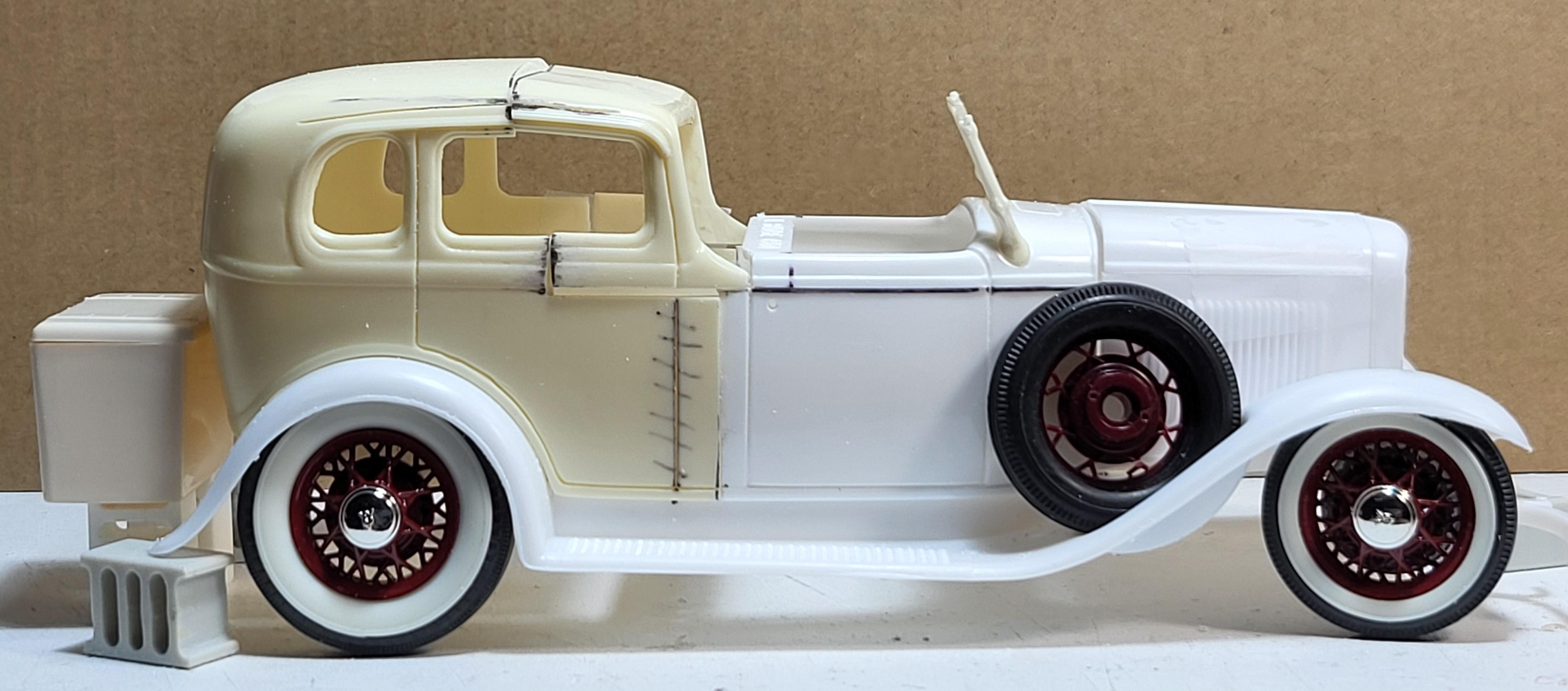

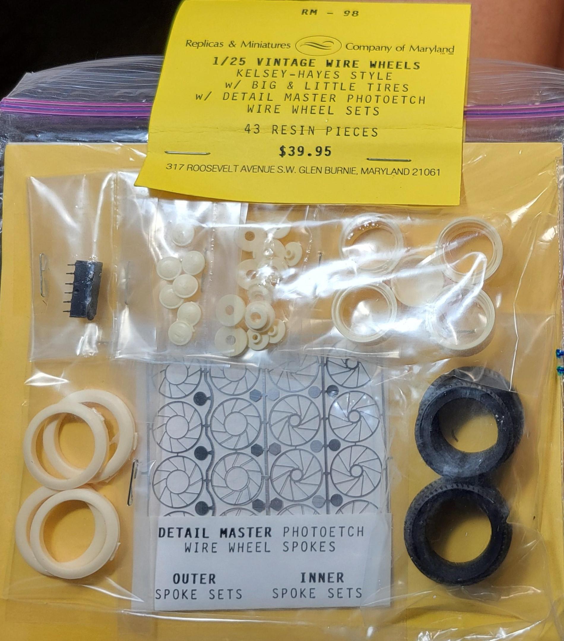

@Rocking Rodney Rat sent me a set of Replicas and Miniature of Maryland Vintage Wire Wheels w/BIG&LITTLE Tires for the '32 Ford Chauffeured Driven Town Sedan:
After careful consideration, the decision had to be made in favor of the Replicas and Miniature of Maryland Rat Rod Tires & Wire Wheels:
The early mockup of the '32 Ford Chauffeured Driven Town Sedan showed that the size of the BIG&LITTLE Tires really made the difference... -KK

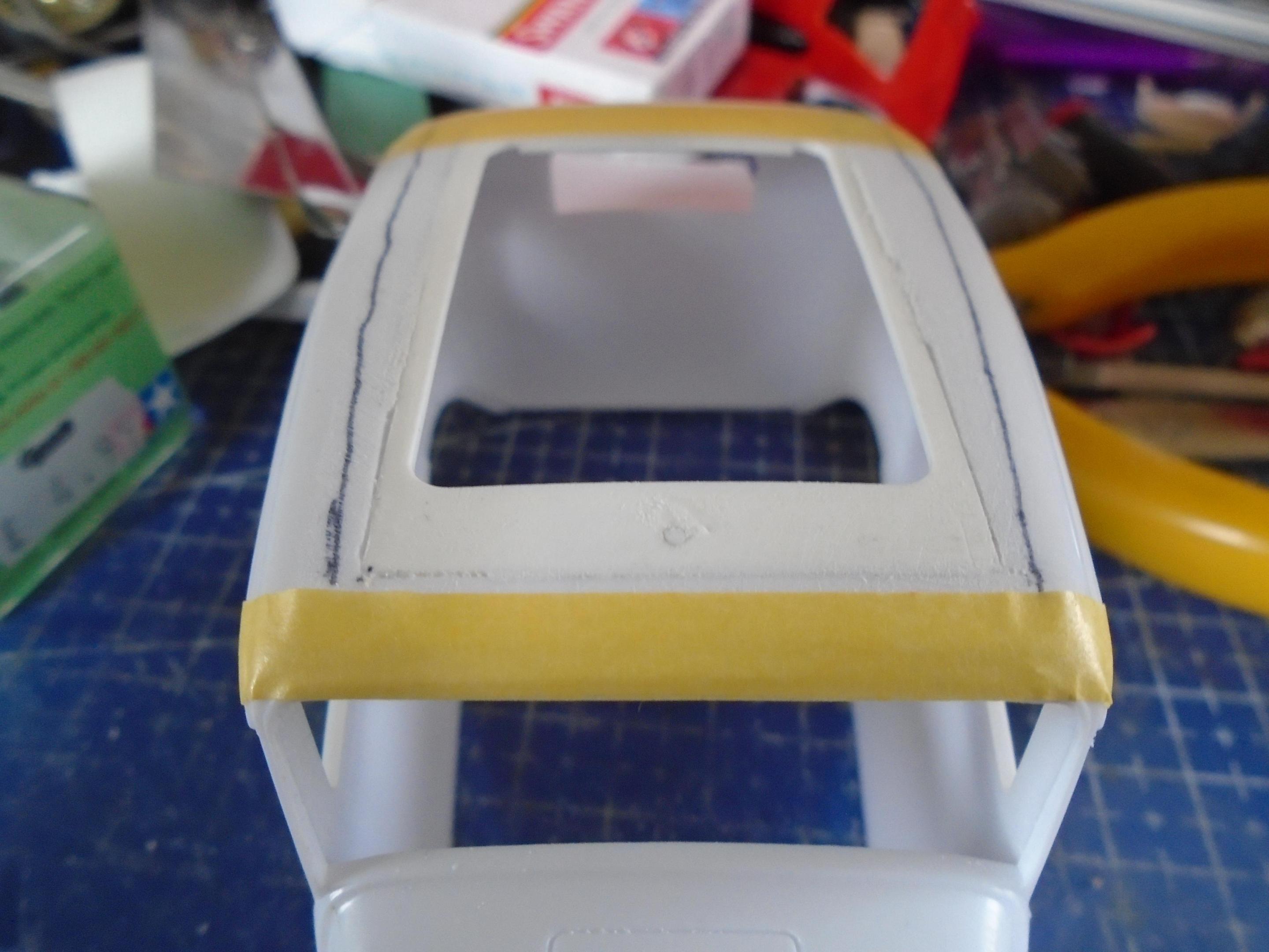

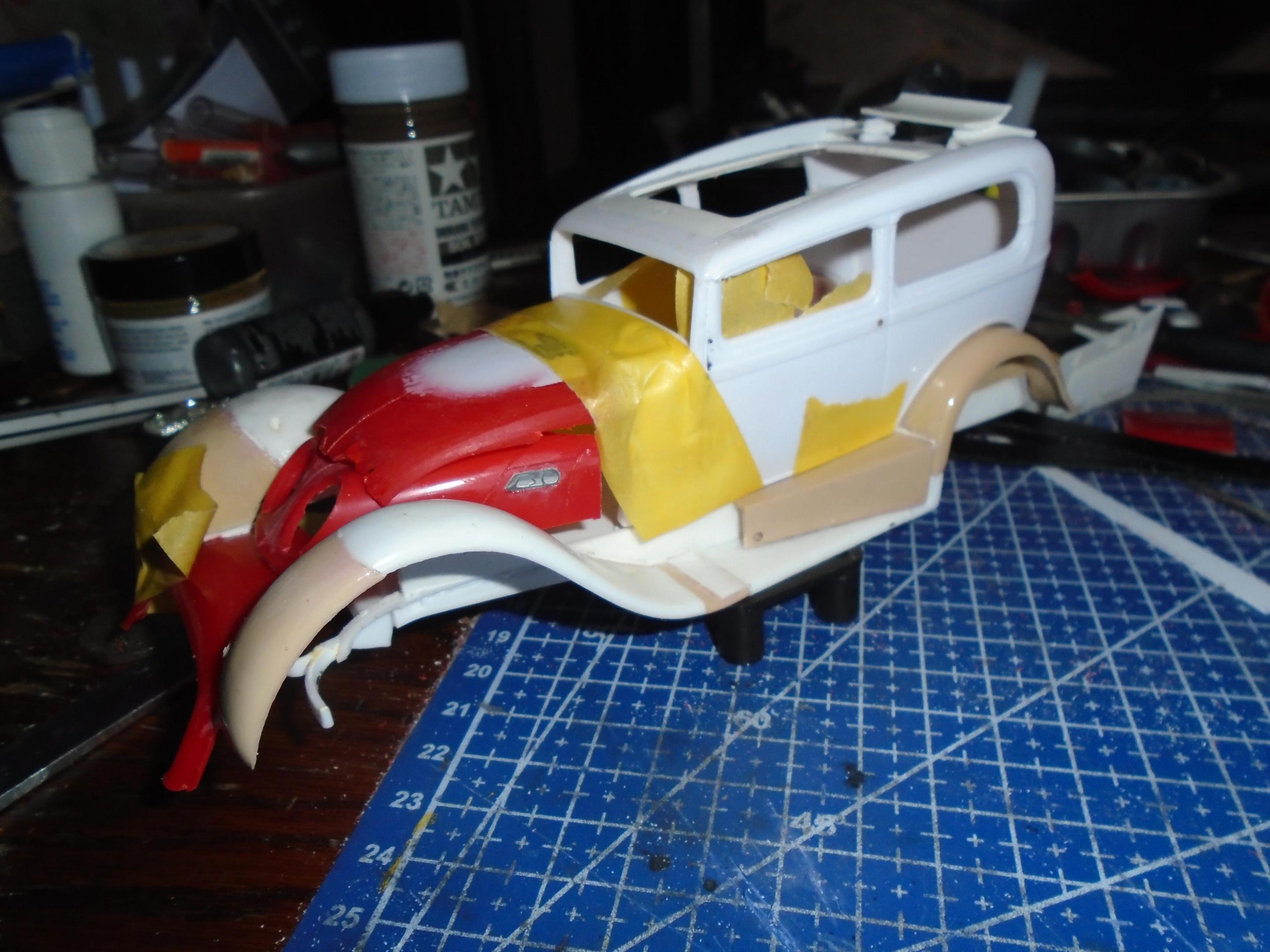

After a short pause while my nieces were home I've got back to this. My last post i talked about curving a spare grille but after doing it,  well it looked naff and only suceeded in wrecking 2 grilles, so i needed another plan. the result of which involved a new mini front end and a bug hood for an approximation of a indy car if it didn't need a grille and had lights instead. i think i can hide their mini origins with some detail painting. its only in the early stages but the shape is starting to come together. the outside of the body has a 2mm wedge chop using the bottom edge of the rear glass for the rear corner and the front top corner for the front. this saved cutting the roof (for now) and brought the pillars close enough to be fixed with a file later. then i chopped only the centre of the roof another 4mm. i added a split spoiler to the roof but think i might have another idea forming for it, so we'll see if it lasts. next up is finishing up the front end, suspension and chassis/aero....stay tuned, its about to get wilder....lol

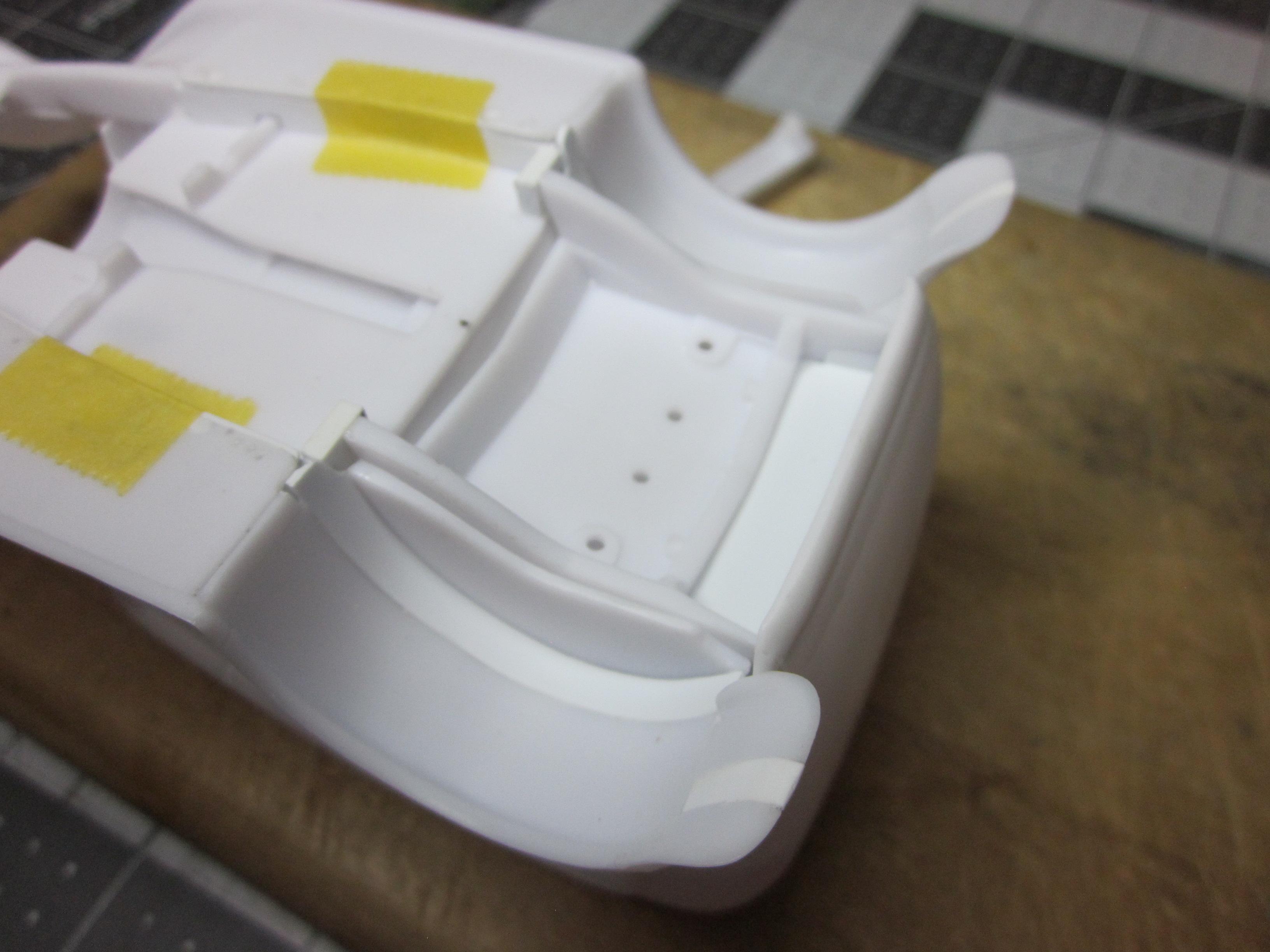

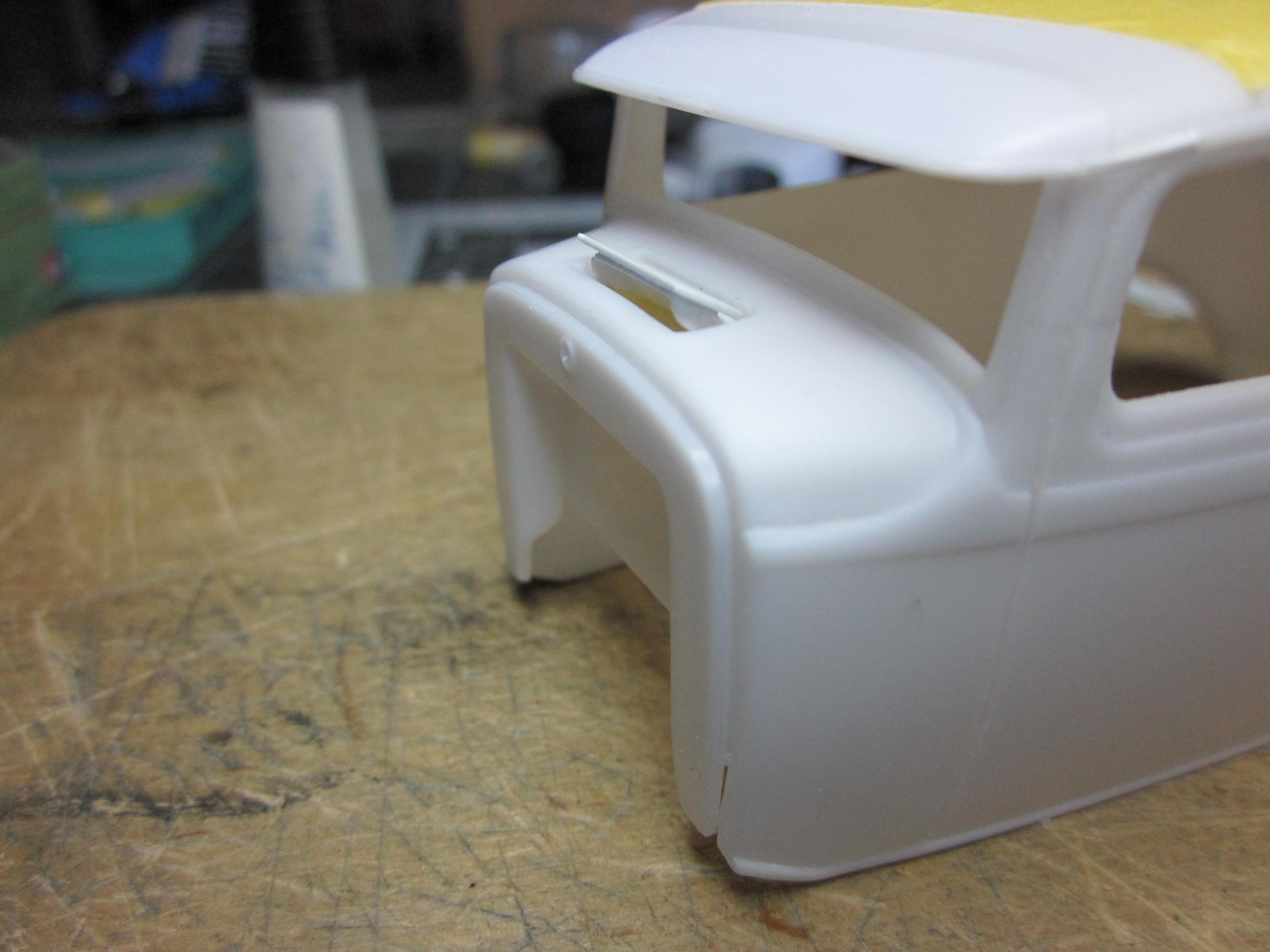

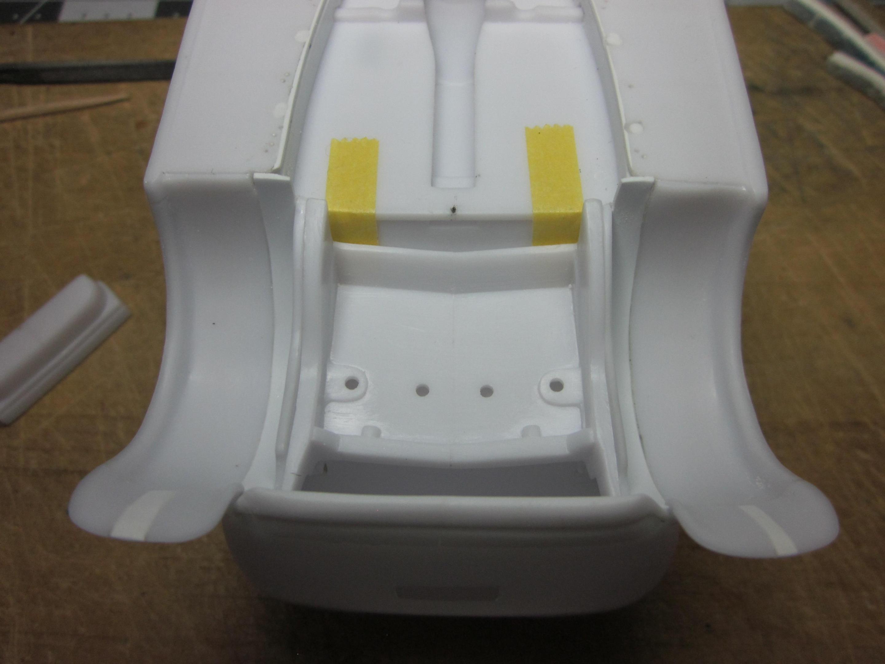

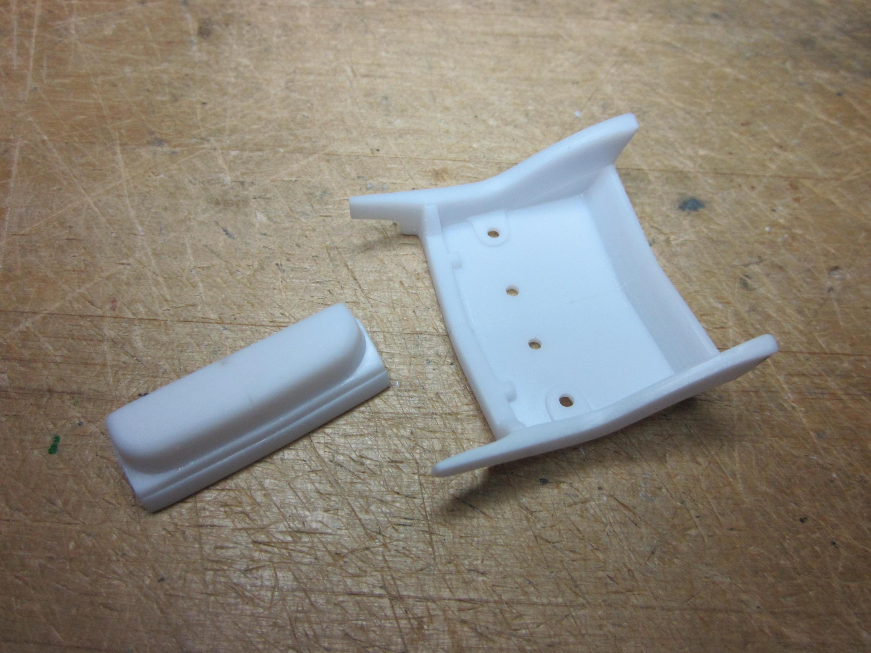

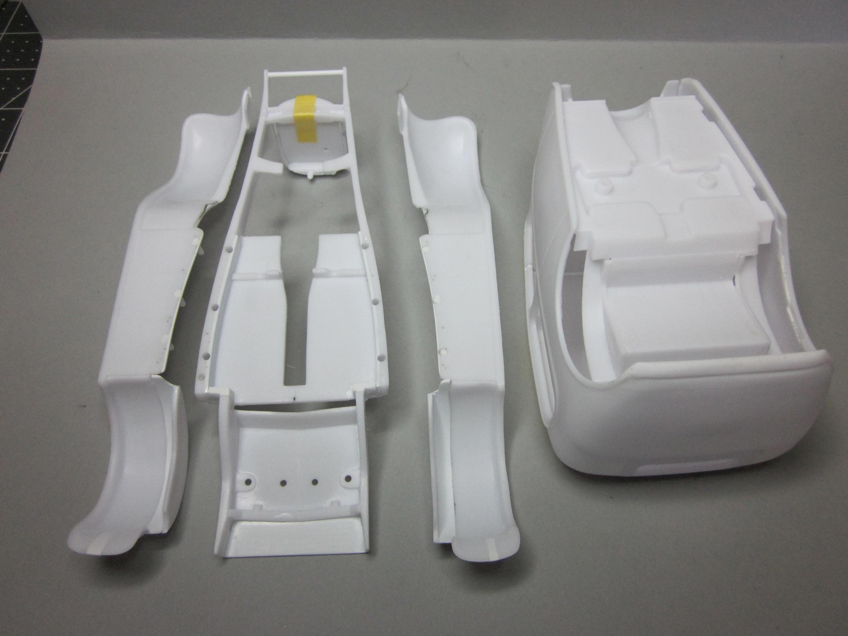

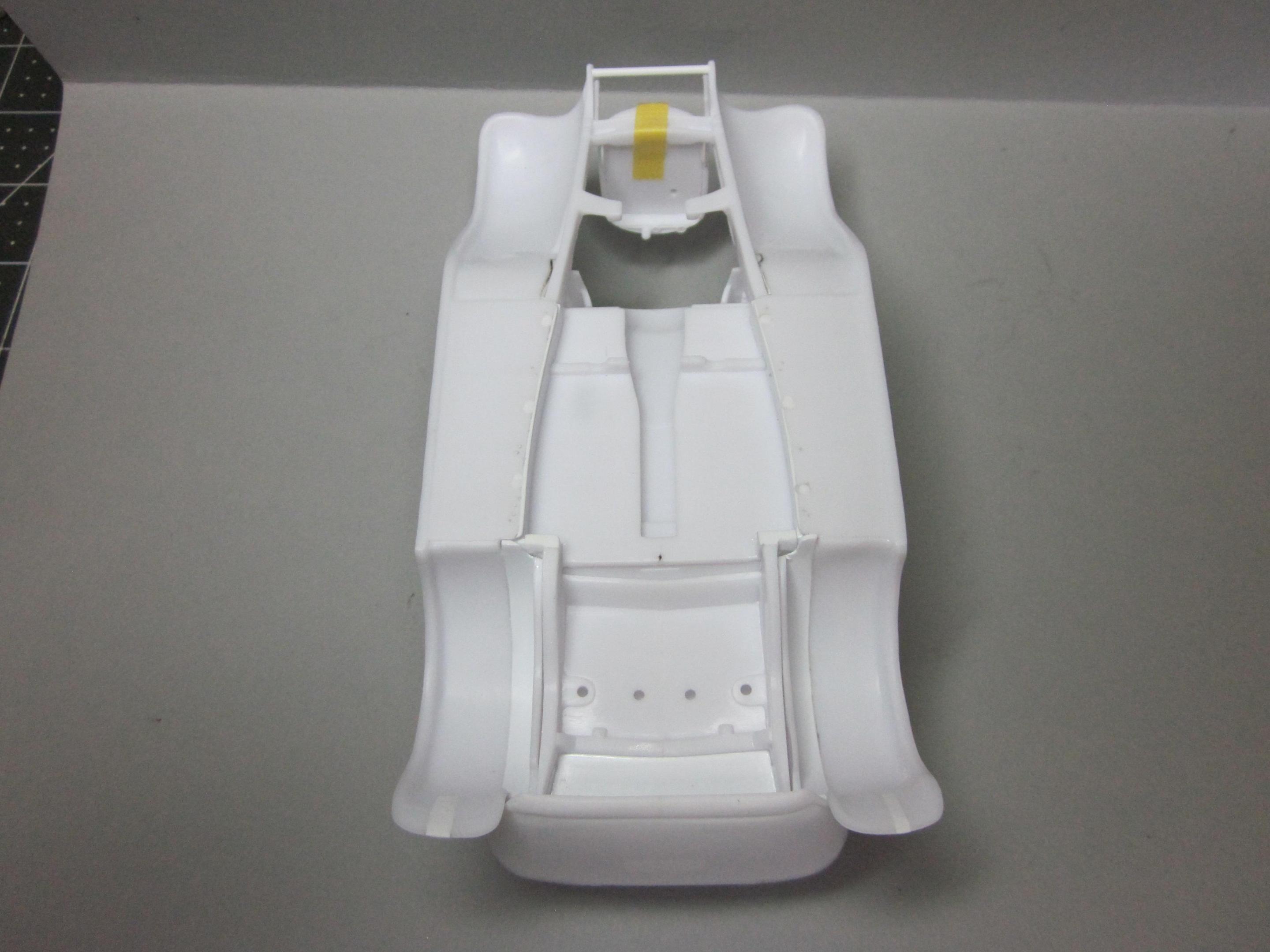

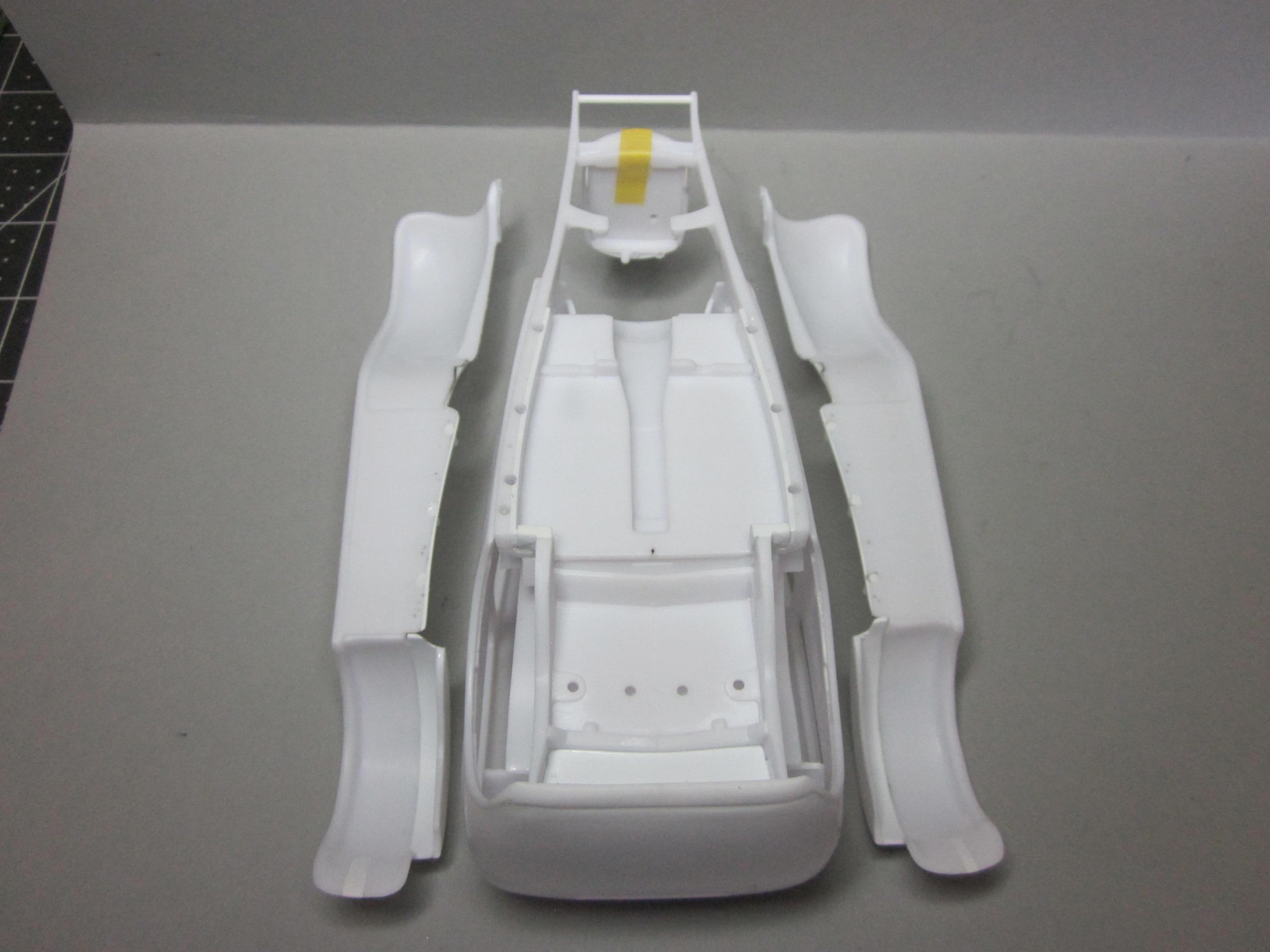

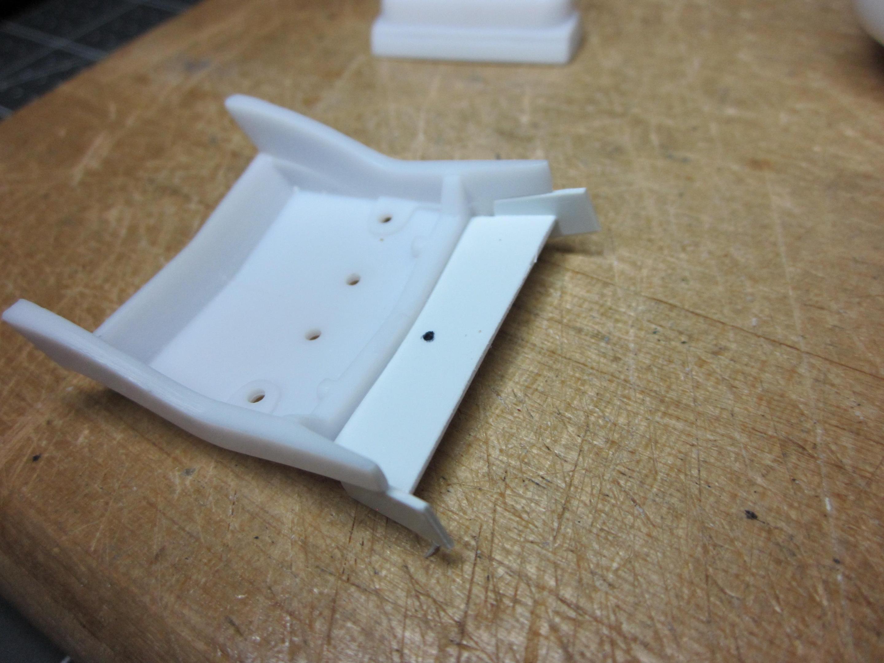

The last update of my '32, left off getting the wheel tubs finished up. At this point it is ready for the rear frame to be modified to fit between the new wheel tubs. First thing to be done is to cut the frame apart to remove a sizable chunk out of the middle. I chose to save the gas tank, and it will be reinstalled in its original location This got things close, but the rails did not run true to the tubs as the front part of the frame section is wider than the rear. To fix this, a small amount of material was removed get things straightened out.

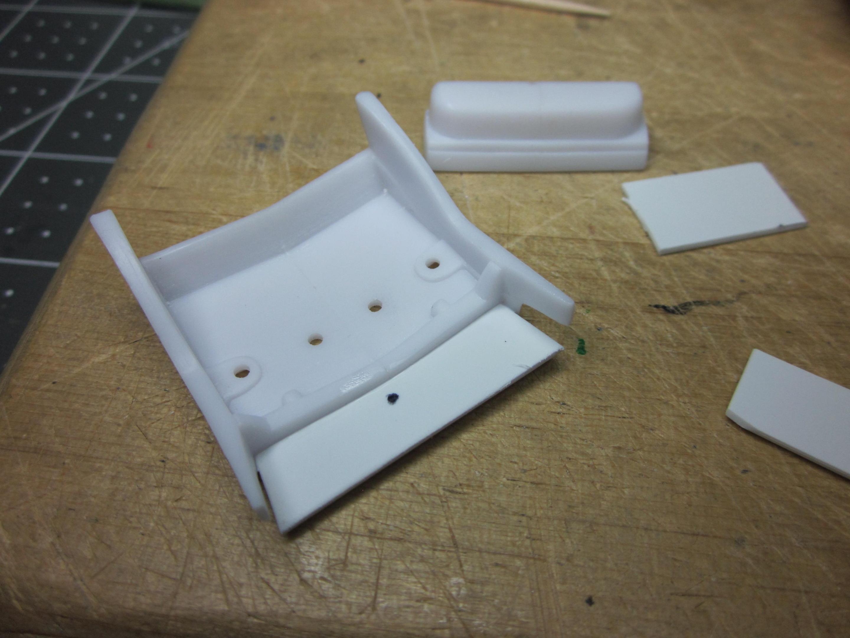

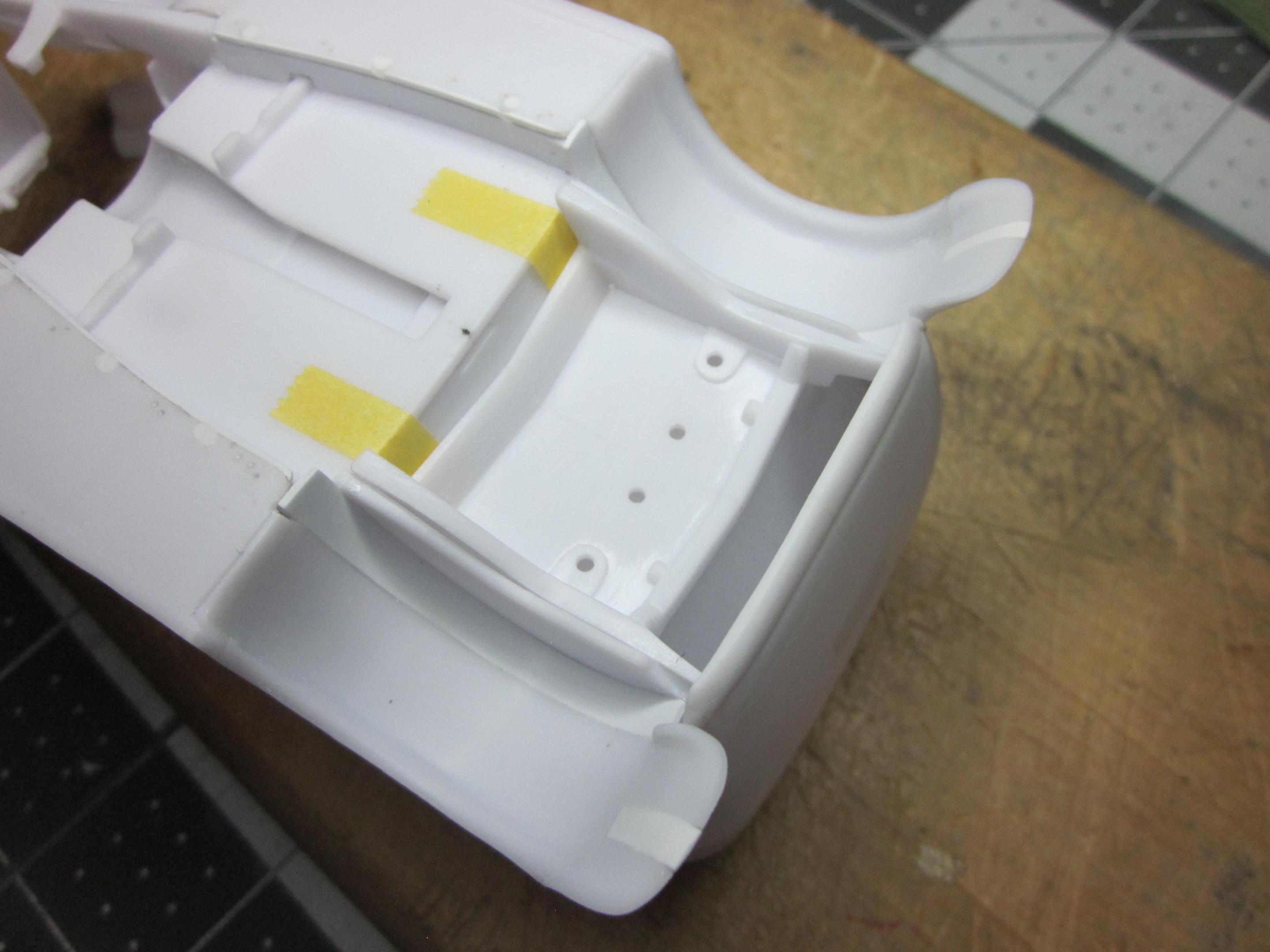

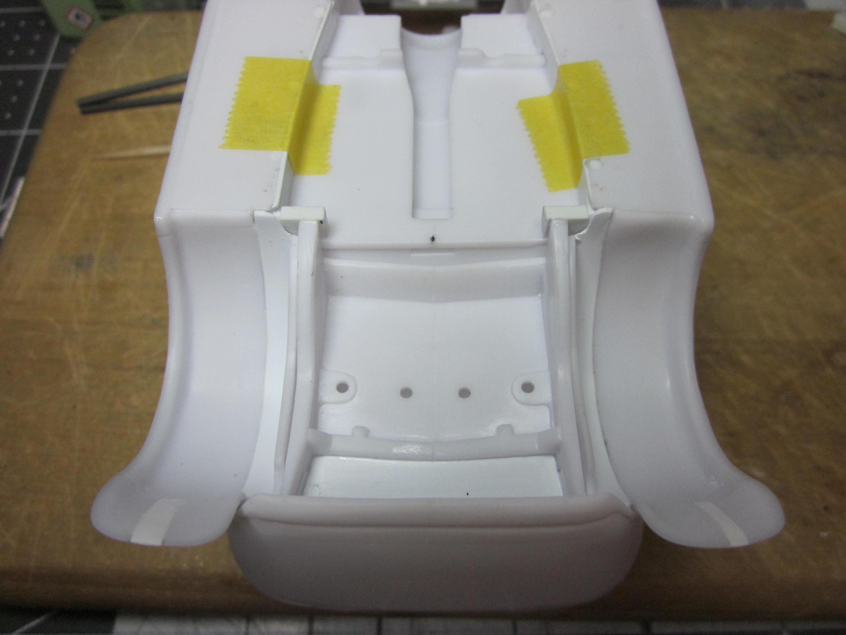

The rear frame section now fits. And fits nice and snug. So next is the gas tank. It needs a place to mount. Some pieces of 0.60 sheet were used to build a new floor at the very back.
After the new rear floor was cleaned up and finished, it was time to rejoin the rear frame section too the main frame. A couple small pieces of .080x.156 evergreen is used to create the area to glue too. Once glued in place, it was left to dry overnight

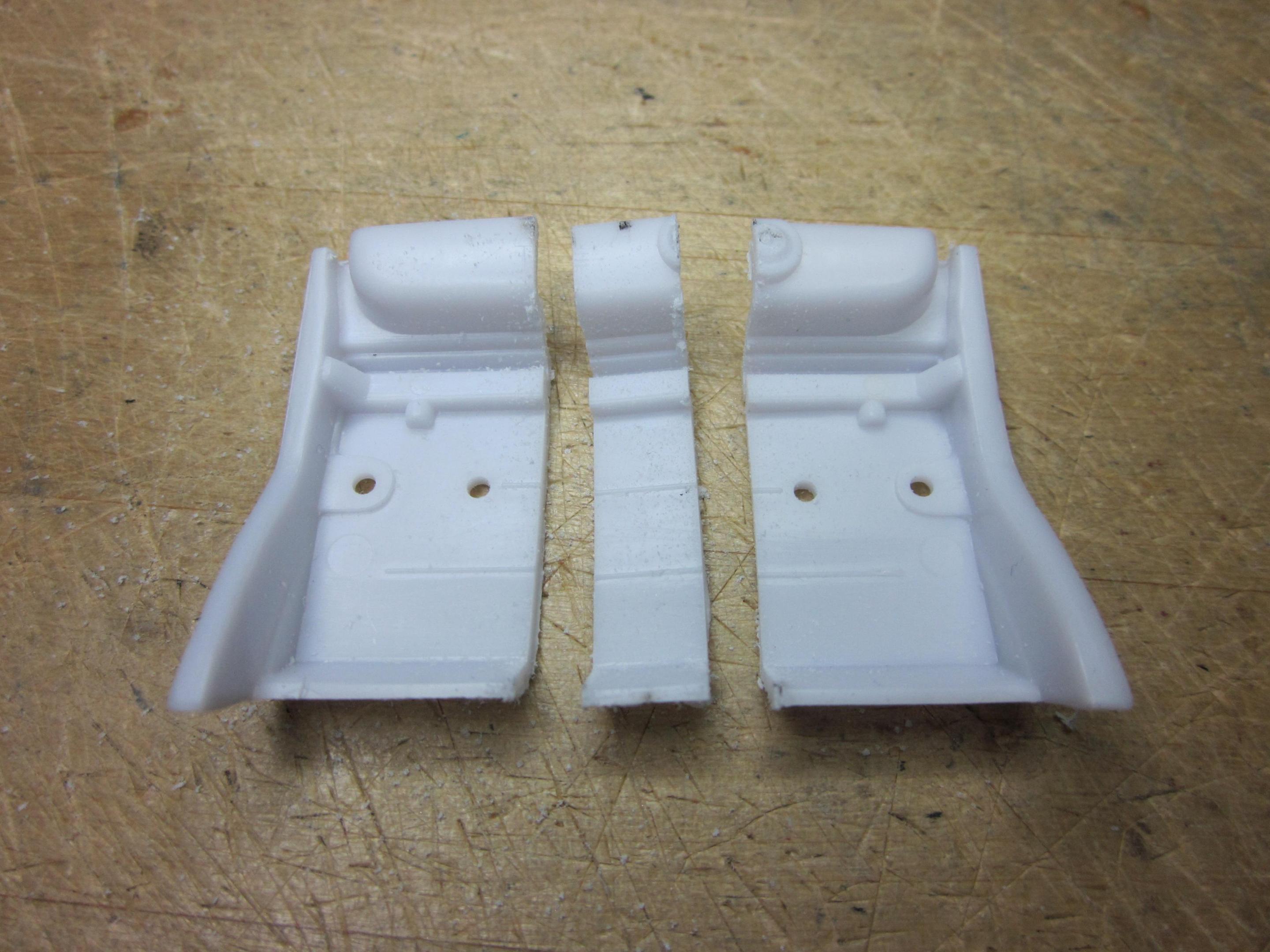

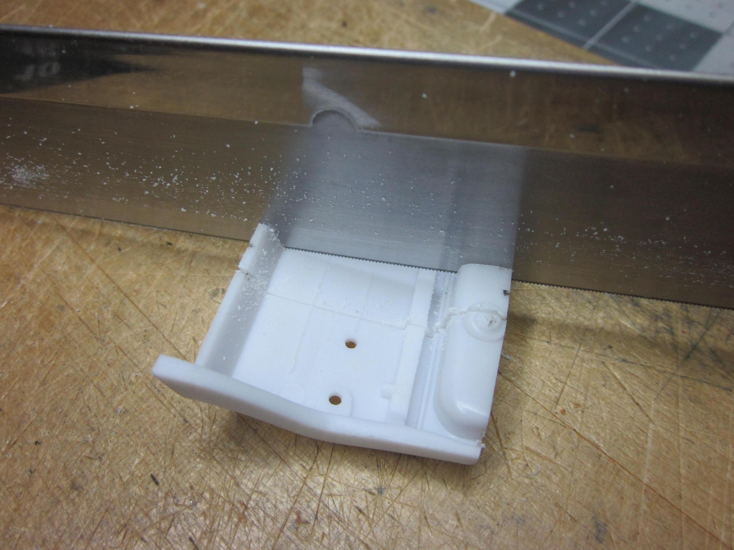

Still more to do now that the frame is rejoined. I did get the rear seat narrowing started. Will show that next time.

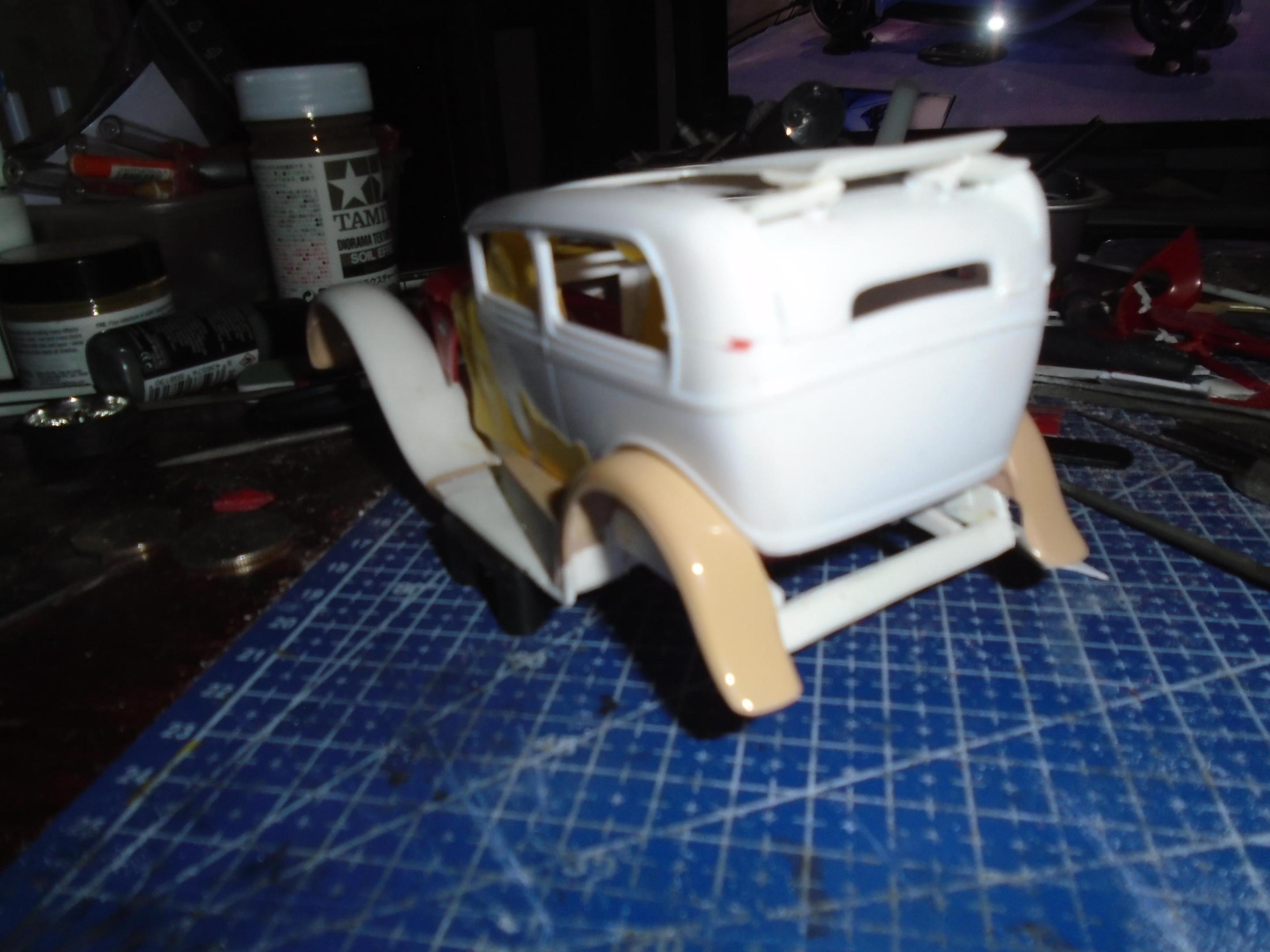

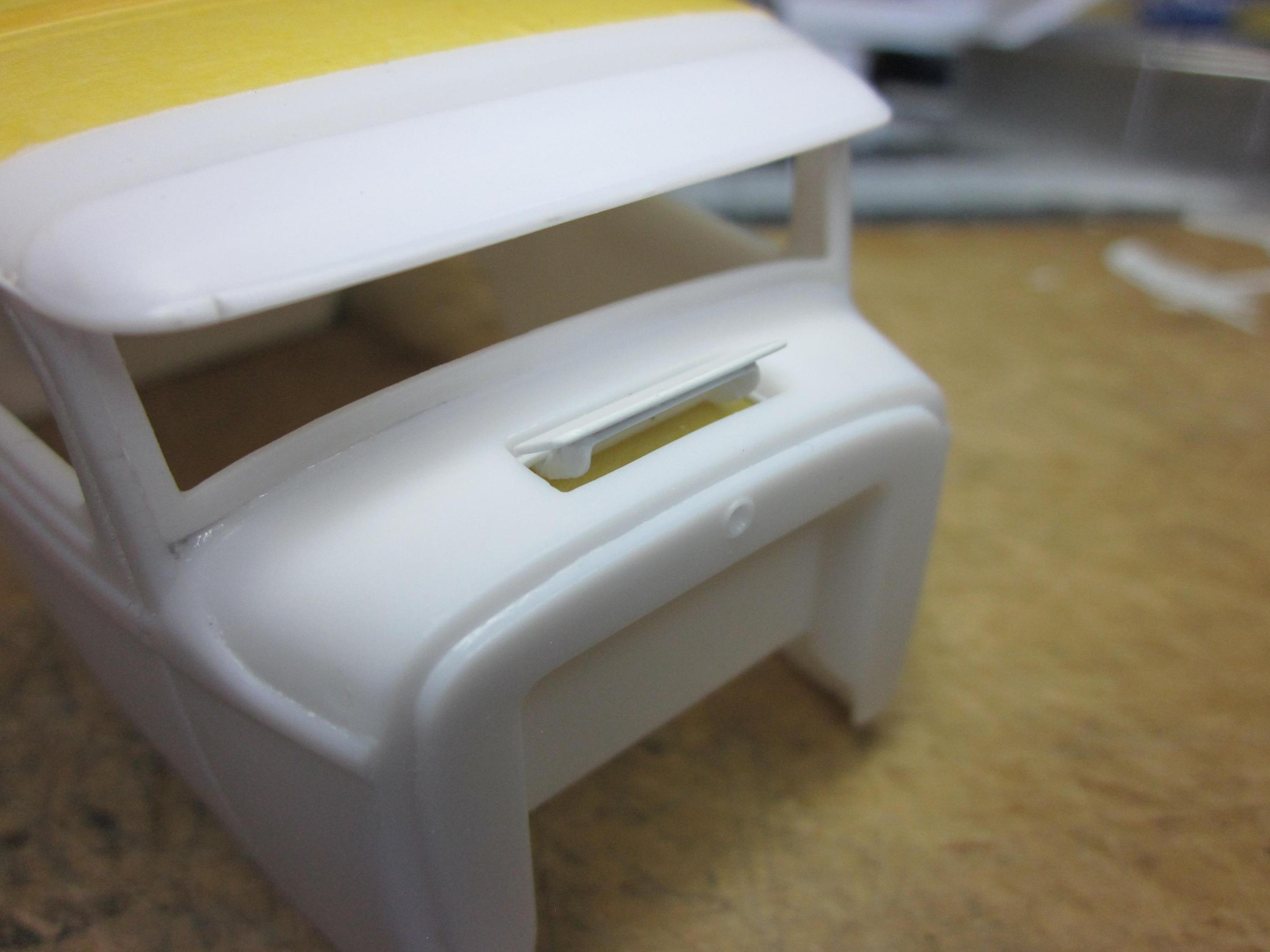

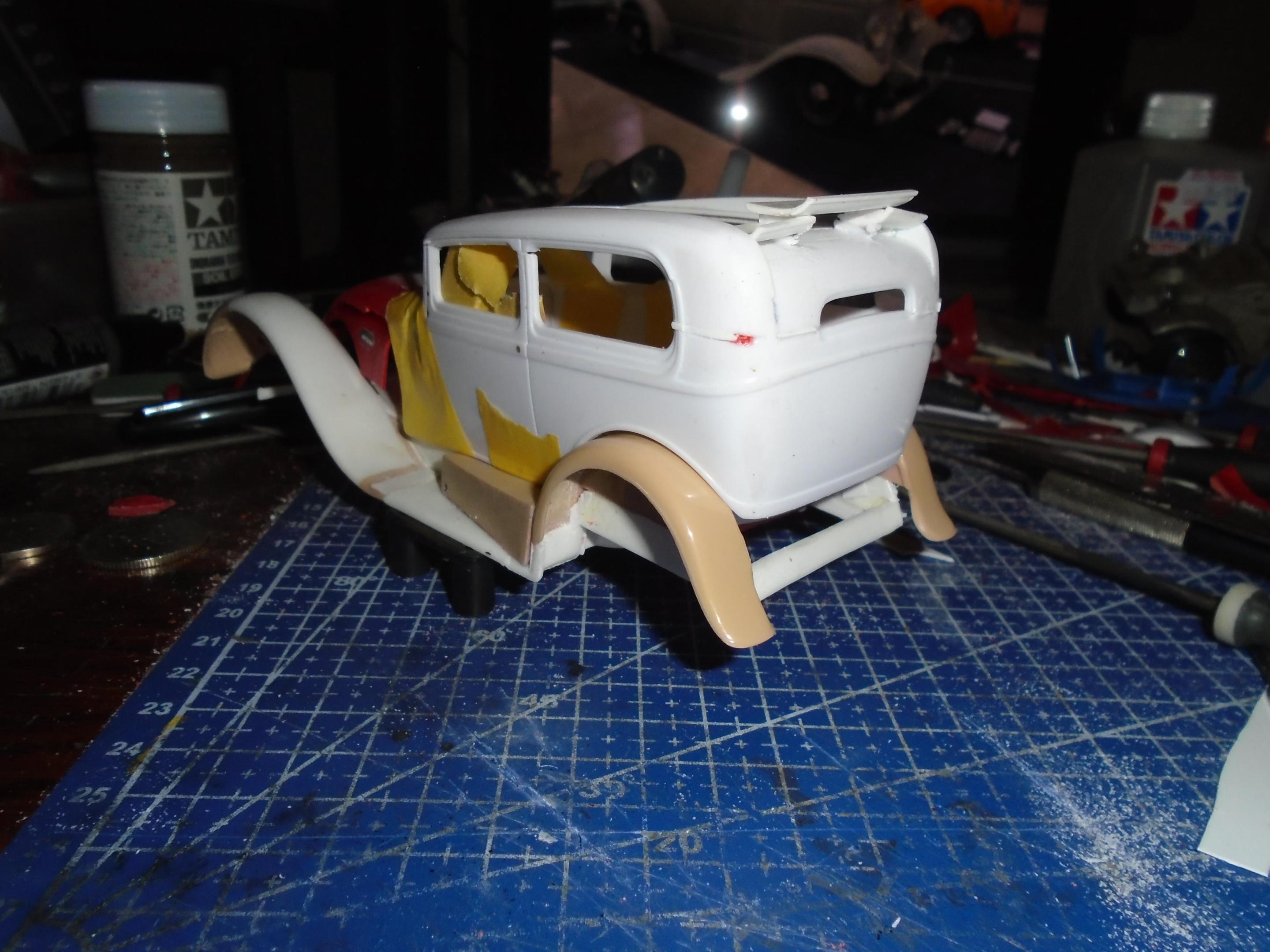

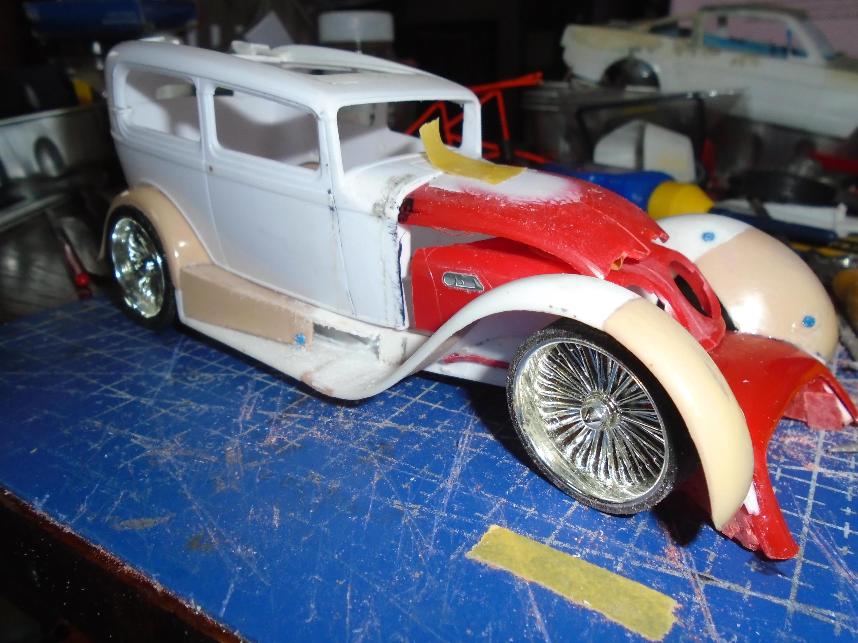

Here's a couple pics of the car fitting together. Also added the vent door.
That's it for now. More to come..........

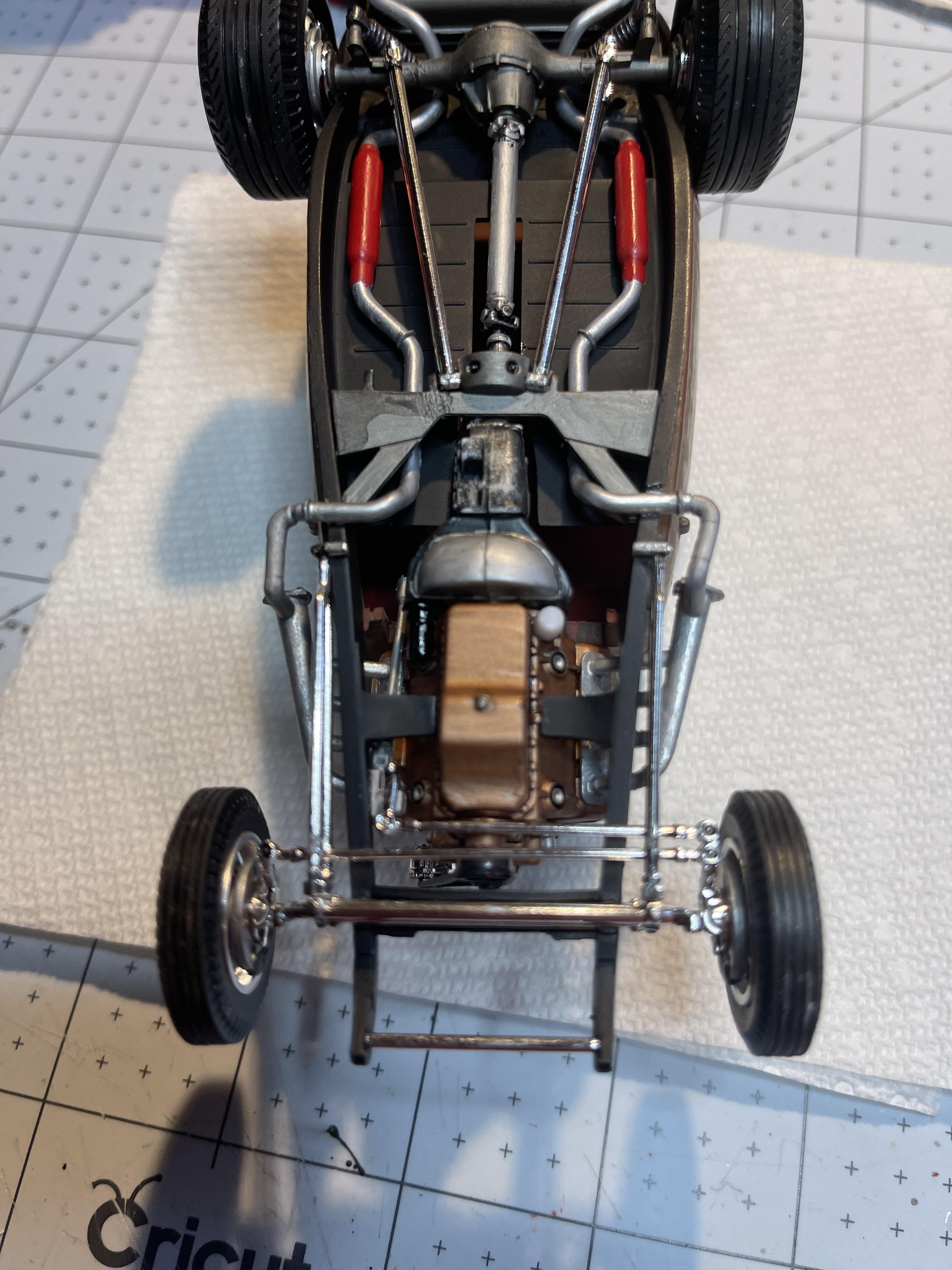

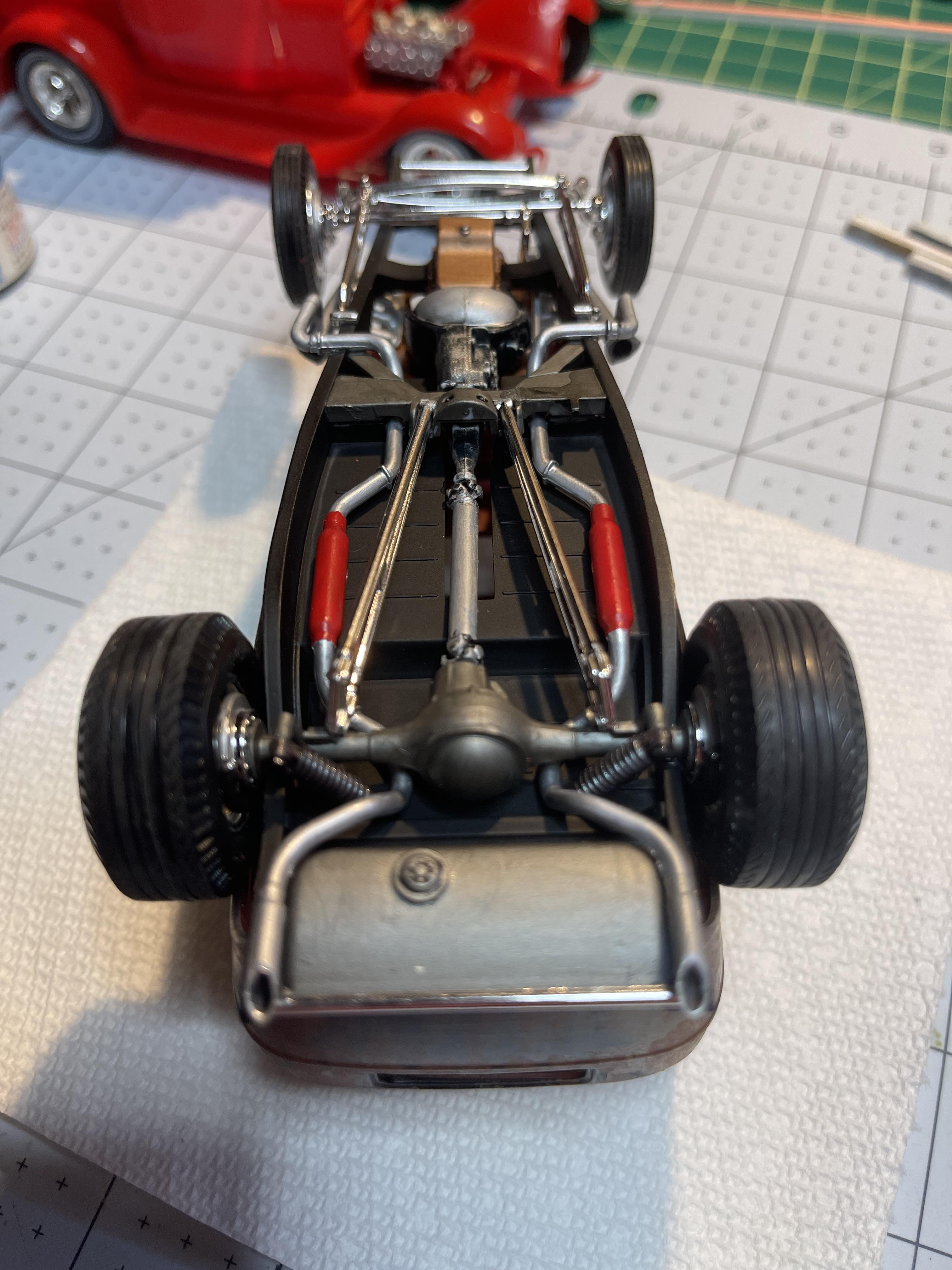

Update!
Chassis is ? % done! Spent a little time doing some extra touchups and maybe a little  drop of Tamiya panel line black fell in there a couple of times. Yes I know the brake master and booster are not in there, hadn’t decided if I was going to mount to the firewall or not.
I usually don’t stress too much about the detail of the chassis as they rarely if ever get seen by anyone again. Now to flip it over and see where I can continue,

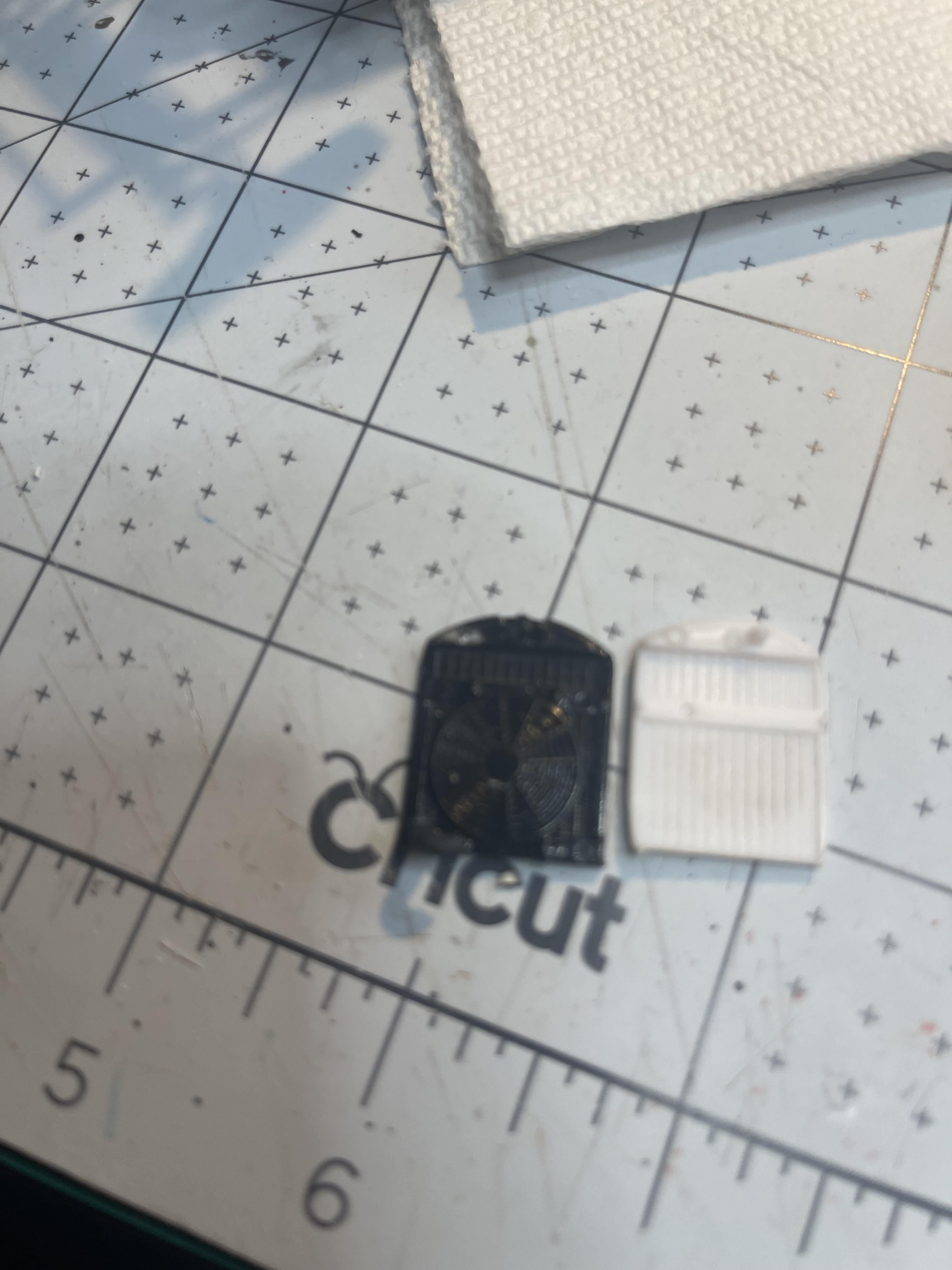

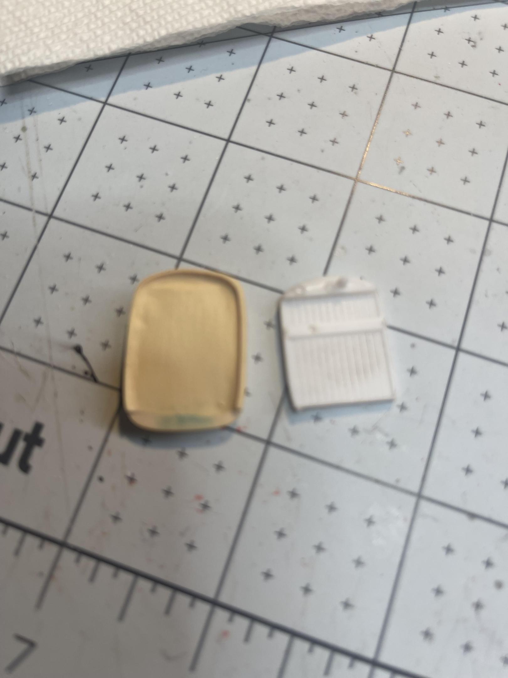

Radiator revision, I wasn’t feeling that the amt rad was fitting correct so I binned it in favour of a revell piece, just have to allow for the shorter height and adjust the rad hoses.

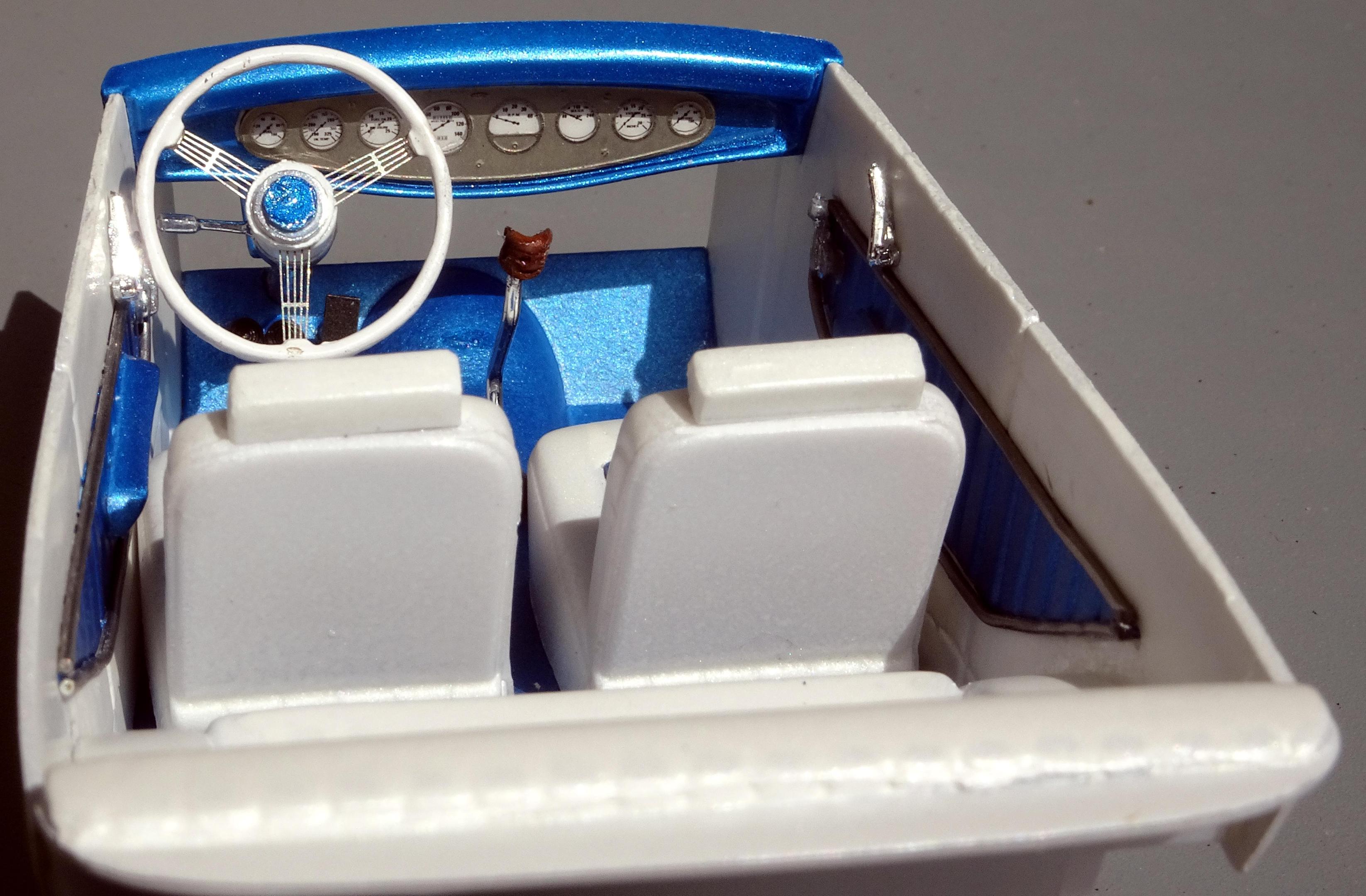

I have completed the interior of my Tudor. The banjo steering wheel and dash are from Model Car Garage and I fashioned a bit of a Tiki shift knob. The upholstery pattern was altered and thin solder was used for the trim on the door panels. The blue is Tamiya Light Metallic Blue which will be the exterior colour. Both the blue and the Tamiya Pearl White were matt coated.

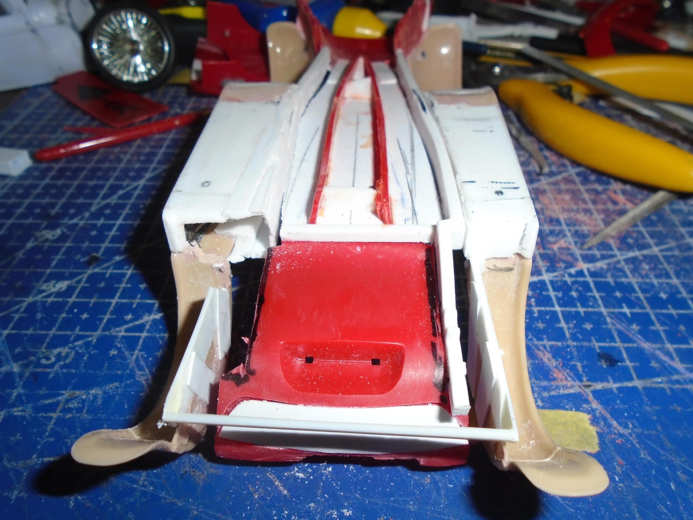

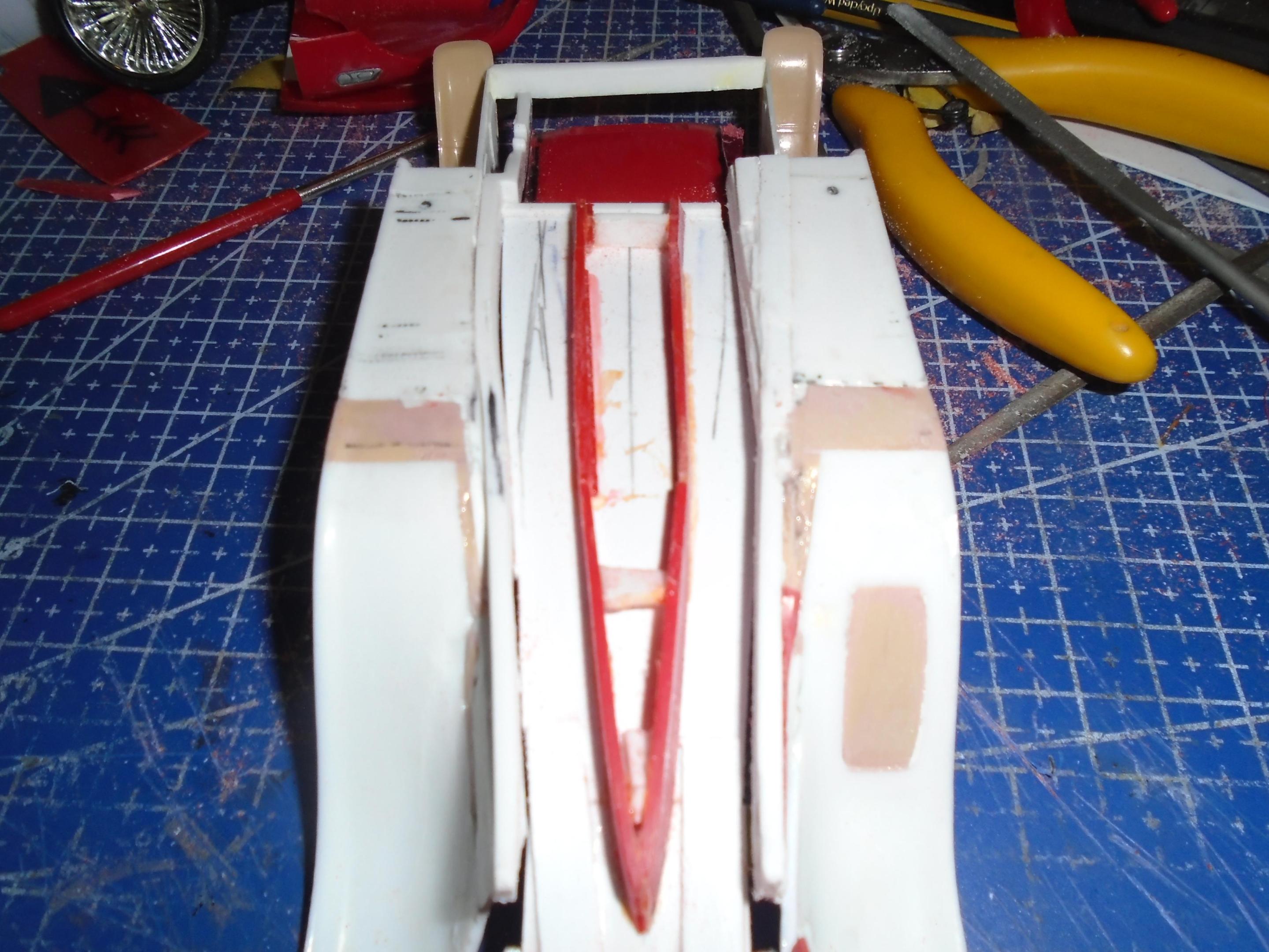

I've made a start on the aero. I opened up the vents on the running boards and they now exit at the rear. i'll be tieing this into the diffuser and fenders but i need to do the other side before then. now your probably wondering where the motors will go as there aint much provision for them but they will be mounted to each wheel with a lexus type semi independant trailing arm suspension mounted to the red centre diffuser in a f1 style. so this doesn't have a chassis as such. i've got a lot more to do on the aero bits. i also cut dwn the firstr motor i made and made up 2 more so this has 4 motors now. i also found a set of bigger tyres for the rear.
