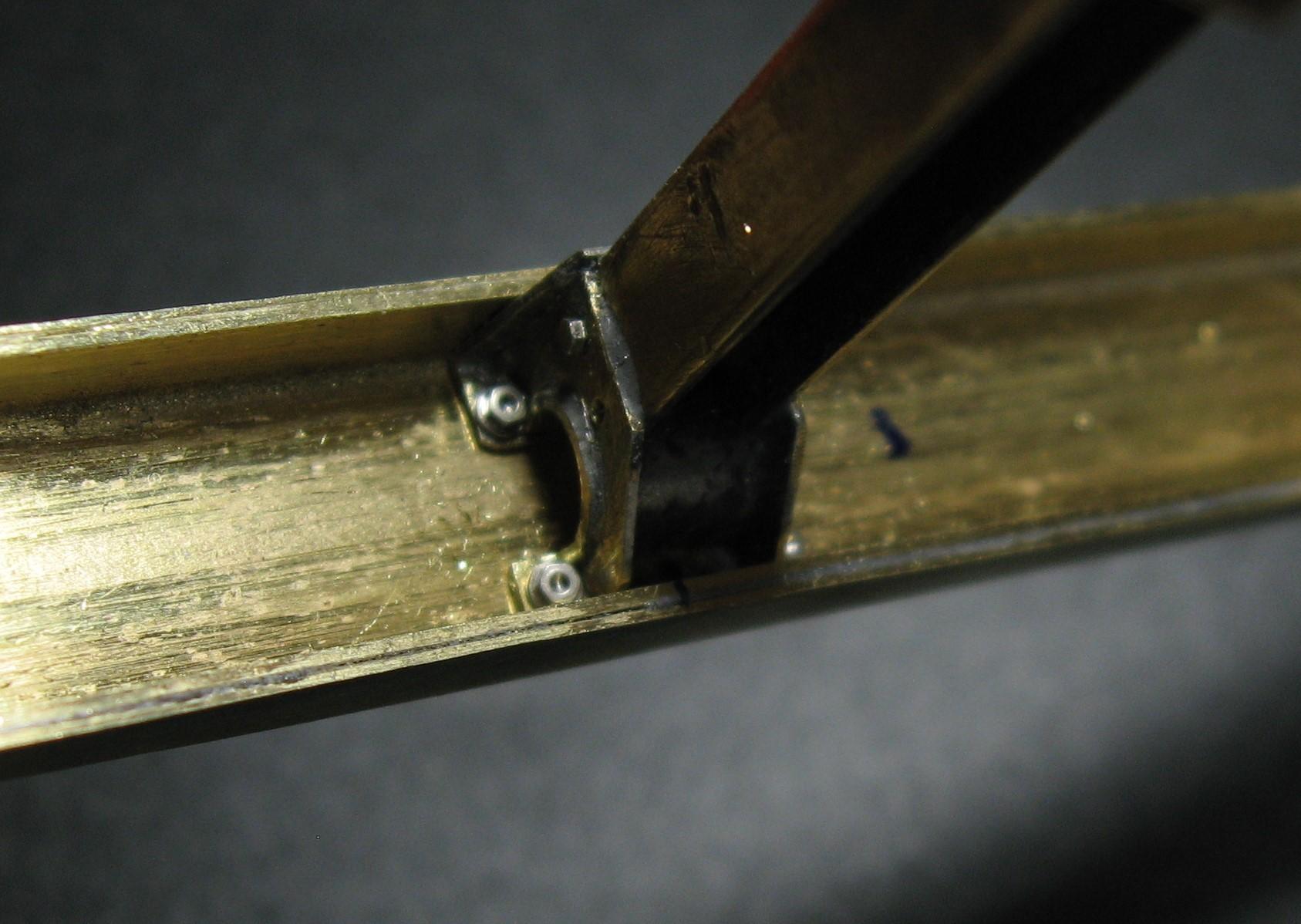

The frame is K & S rectangle tubing with a side cut out forming a c channel. Still was not quite big enough so I wrapped it with sheet stock creating a double frame.
IMG_7038.JPG.902e71431c58461aafd8aacb98cb76d4.JPG IMG_7133.JPG.1b57695a9e7052a15859856e6a6e896a.JPG

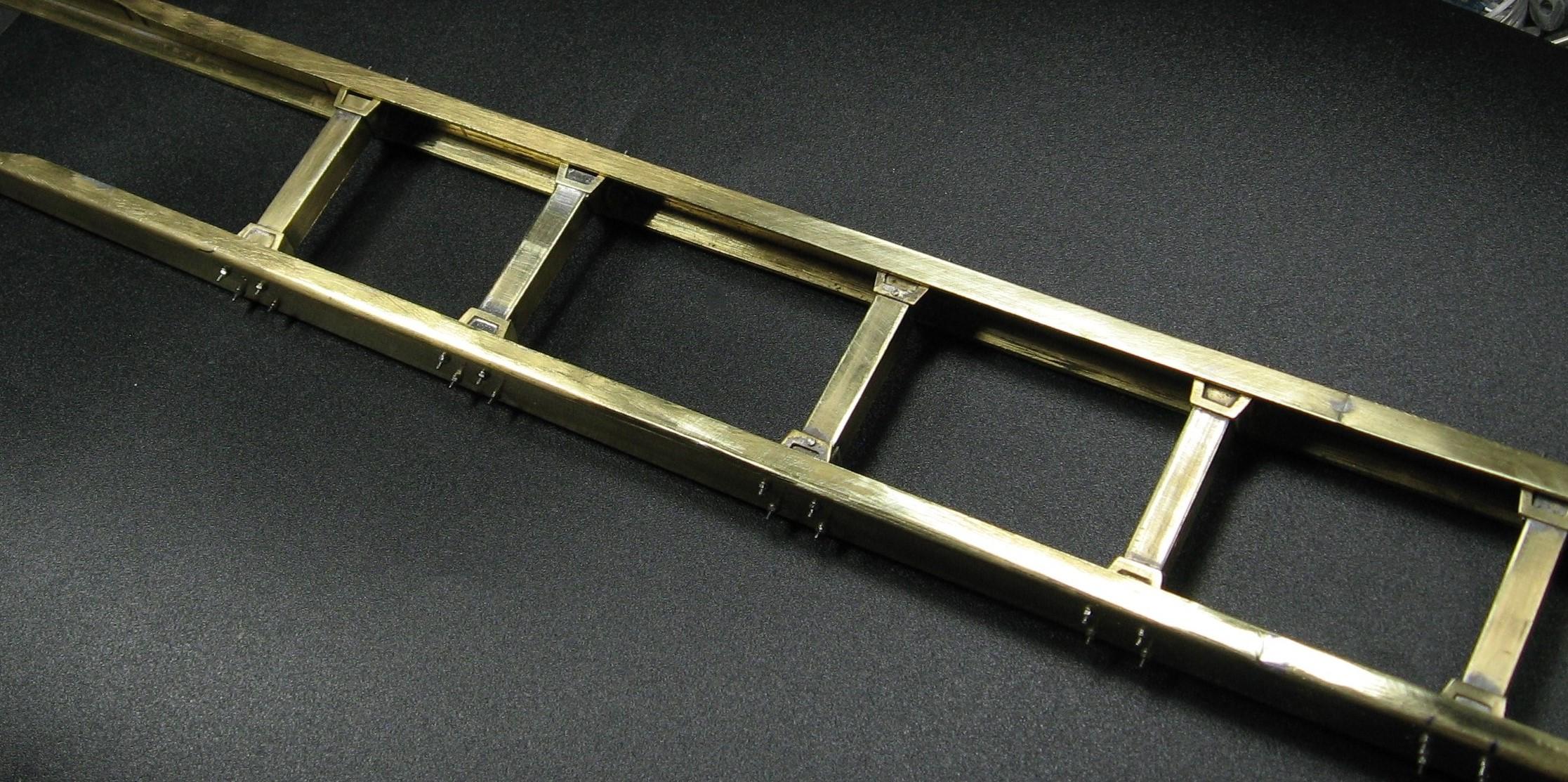

A few pics showing a simple jig to produce same size cross members
I am building them upside down in the jigIMG_7044.JPG.c41ad567b9c8f8a310a2c03357b0fea7.JPG
more ....

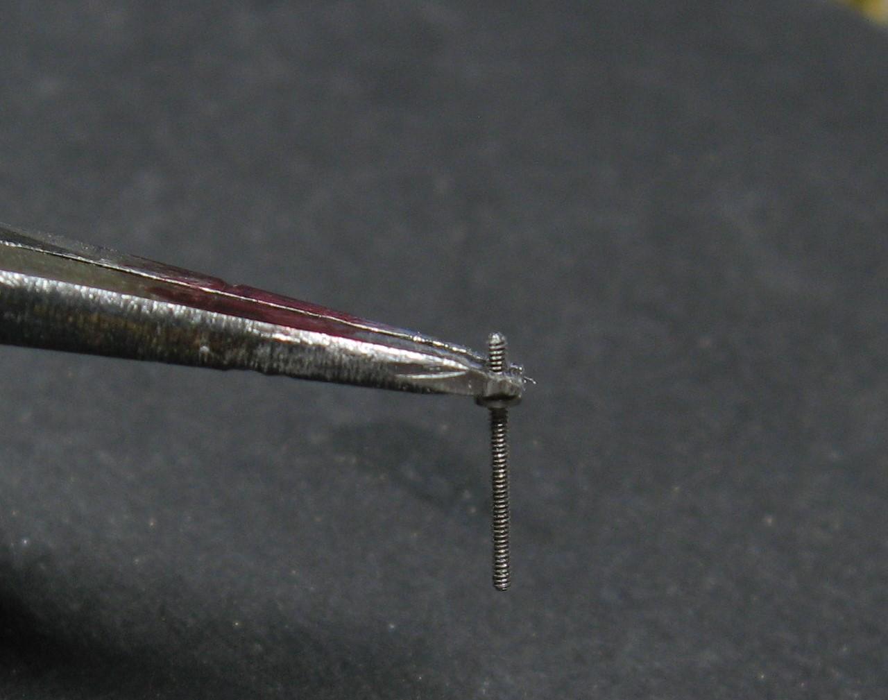

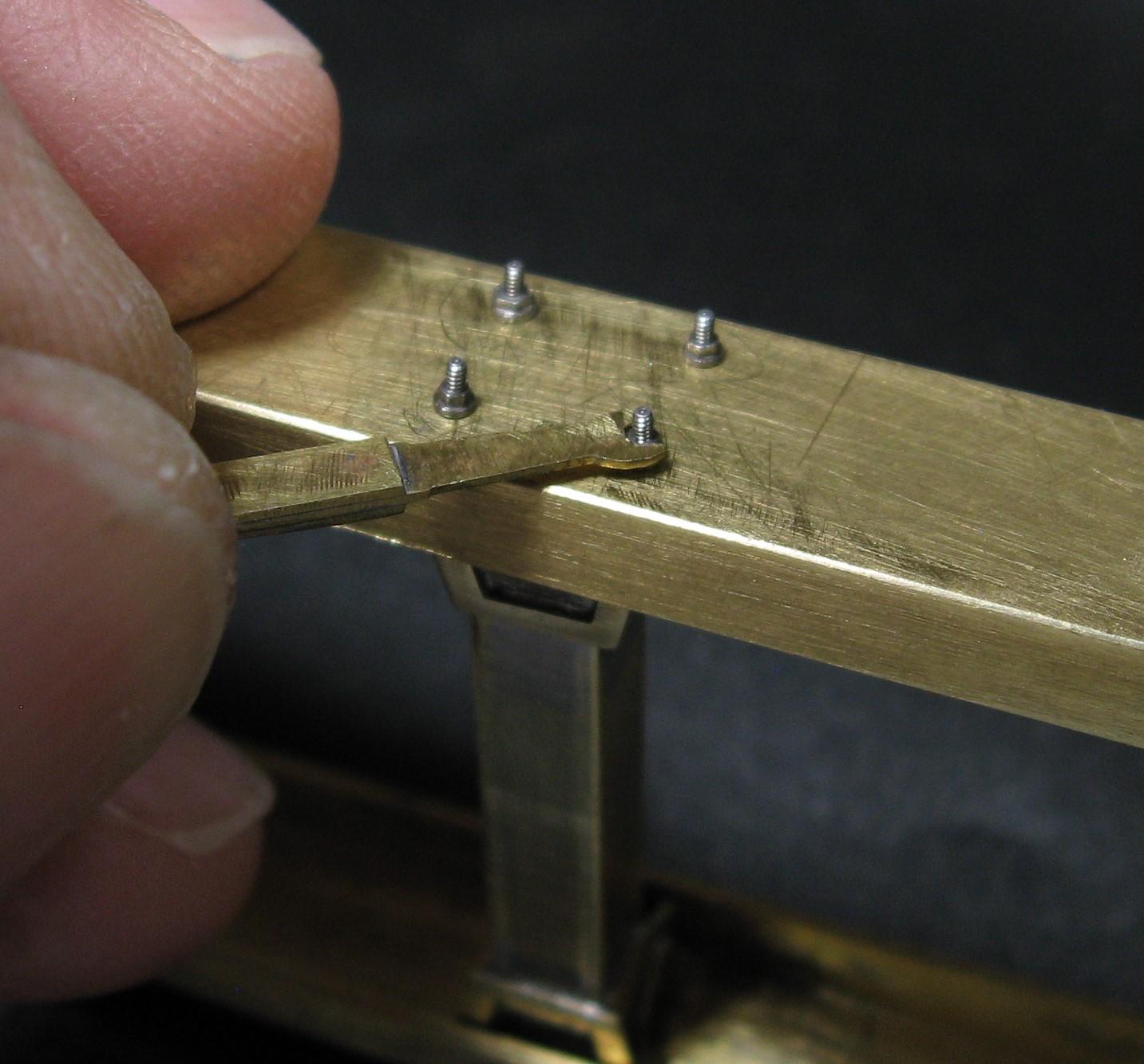

The middle upper bolt for the cross members proved to impossible(for me ) to get to so I will do a short piece of threaded rod and a nut, a fake that will match up to the others.  The pic below shows the rod that I will be able to cut into four pieces...
