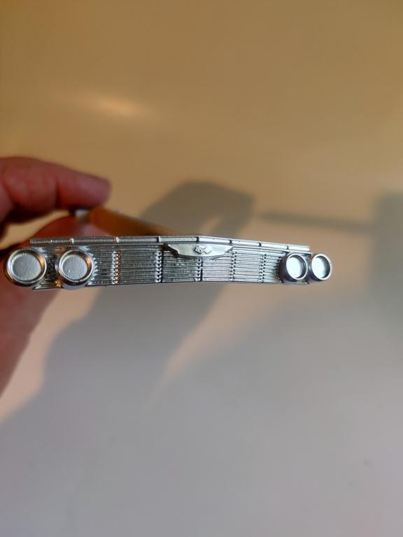

bluestringer Posted June 14 Share Posted June 14 AMT 61 Chevy SS. The kit has been in my stash for a couple years. Decided to build it and noticed all the chrome is spotted. It's worse and most notable on the bumpers and grille. What's the best way to deal with it. I tried cleaning with alcohol but it did nothing. Quote Link to comment Share on other sites More sharing options...

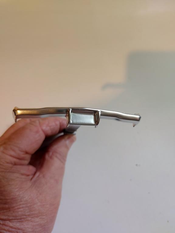

bluestringer Posted June 15 Author Share Posted June 15 After checking on molotow refill and Revell Chrome, the prices are out of my budget. I was going to email Round2 but then remembered I had bought a can of Krylon Original Chrome spray at Micheals about a year ago. I decided to try it. It's not as bright as the kit chrome, but I think it looks ok. 1 Quote Link to comment Share on other sites More sharing options...

bluestringer Posted June 17 Author Share Posted June 17 I've been handling the bumpers and grille I did with the Krylon and it's holding up well. And from some of the photos I've seen my 6 dollar can of Krylon Chrome looks just as good as the Revell and Molotow stuff. Quote Link to comment Share on other sites More sharing options...
