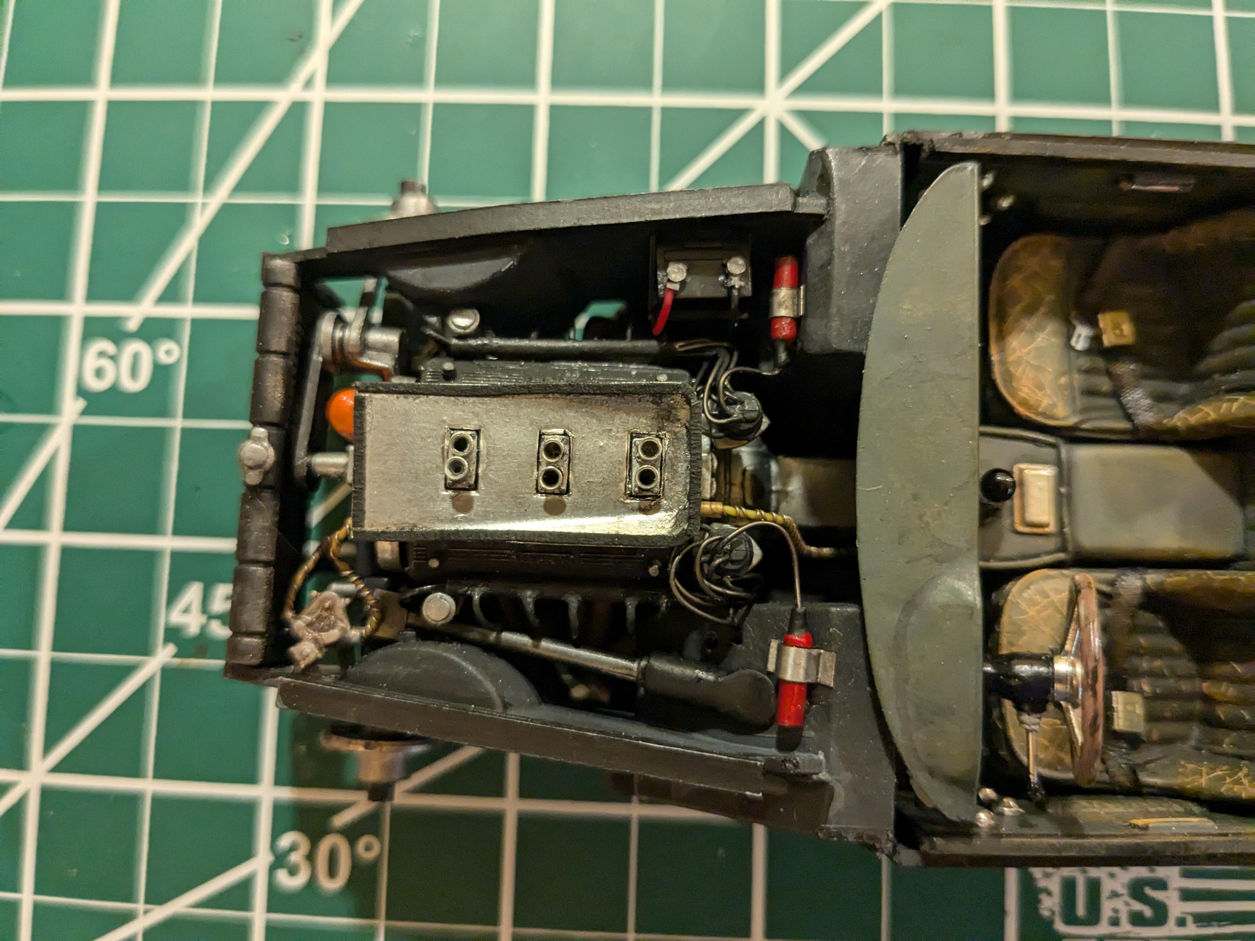

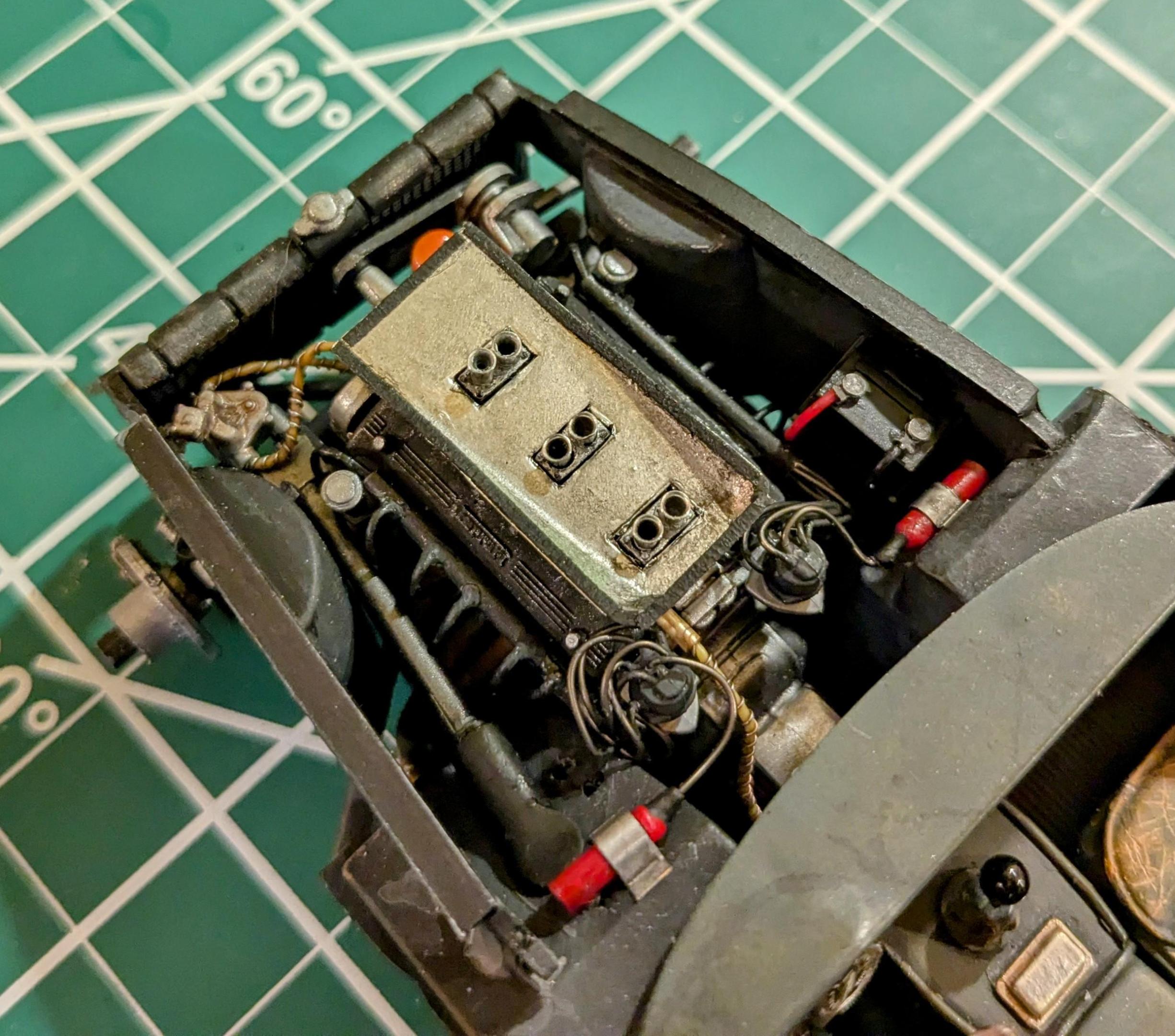

jaymcminn Posted September 18, 2024 Author Posted September 18, 2024 Thanks all! The interior is something I'm especially happy about and the techniques I came up with here will definitely be used for future projects (looking at you, Revell 427 Cobra!). The engine bay is as done as it's going to get. I took a swing at Ferrari's trademark yellow fuel lines by wrapping thin wire around 30awg yellow wire. The kit coils were enormous and crude so I scratched new ones. The battery was a parts box addition. I cut down the kit's air box tray a bit and foiled it. The black "foam" around the edges is 1/32 Chartpak tape. The bad news is the lack of radiator hoses... Italeri doesn't provide them and I was going to swipe the part from the Fujimi 250GTO kit but I discovered in the innumerable test fittings that the radiator needed to be moved back by about 3/16 of an inch to avoid fouling the hood hinges. Ferrari 250 radiator hoses are actually an extremely complicated assembly and if I tried to adapt the Fujimi part it wouldn't have looked right. At this point I decided you have to draw the line somewhere. On to pics! You can see the shims I added to the engine compartment sides to raise the body a bit and provide a better gluing surface during final assembly. Next the body and chassis go together and final details will be added, including the lovely 3d printed Borrani wheels. More to come soon! 1
