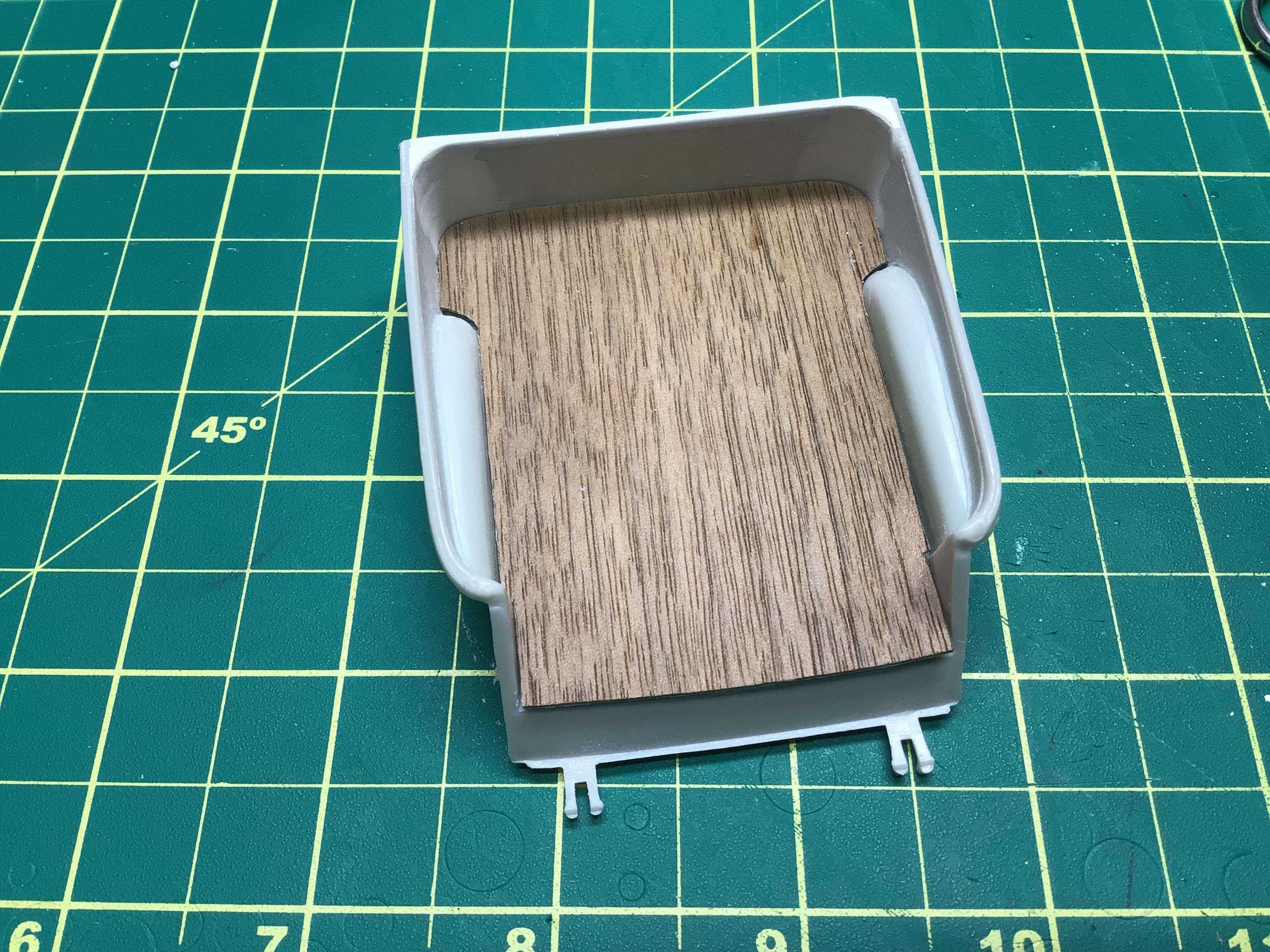

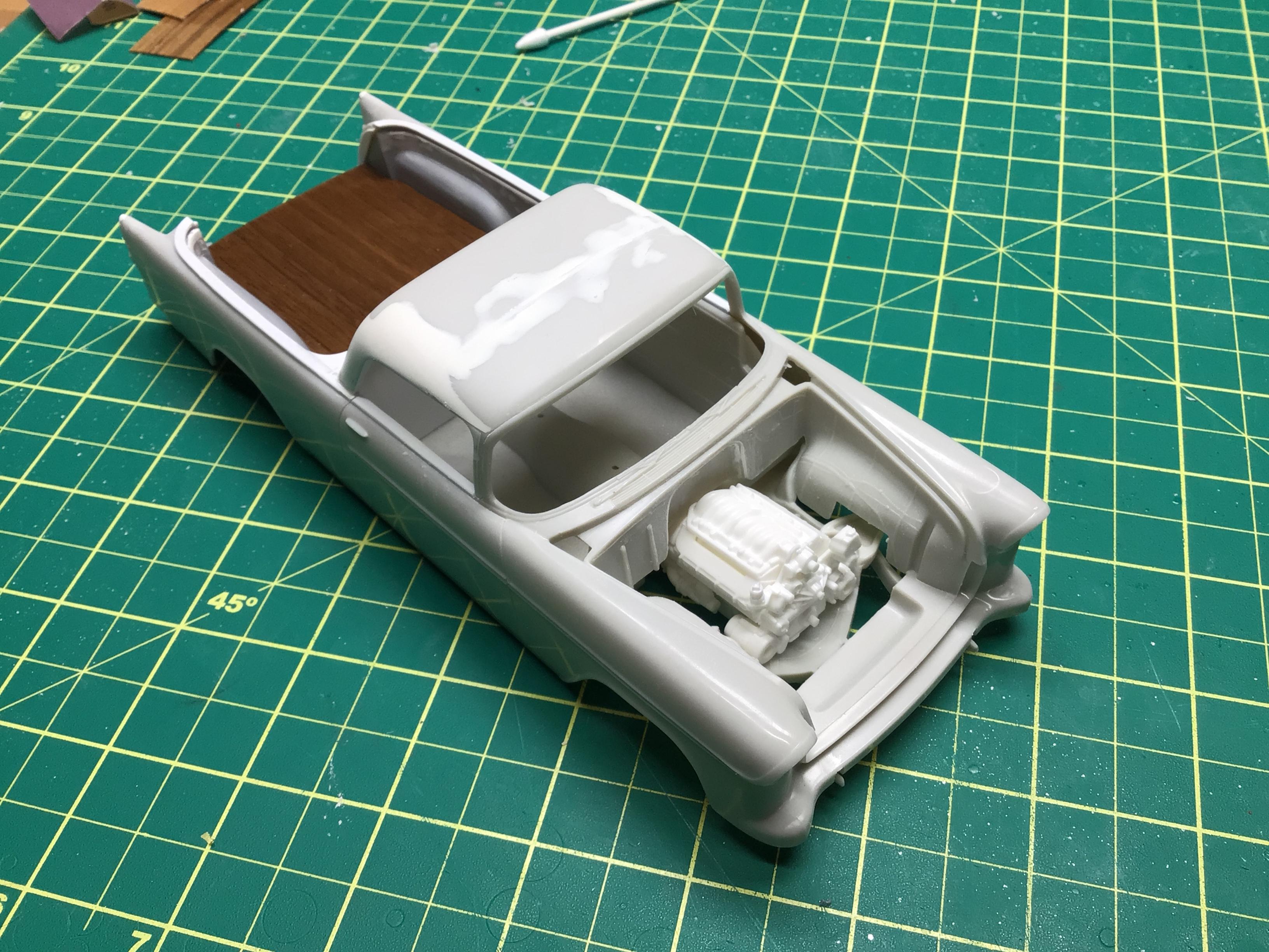

NOBLNG Posted August 1, 2024 Posted August 1, 2024 (edited) What can I say…I have to build it.? I got this kit for $3 due to an estate sale. I am separating the box from the interior so that the box can be attached and painted with the body. All comments welcome as always.? Edited August 1, 2024 by NOBLNG 8

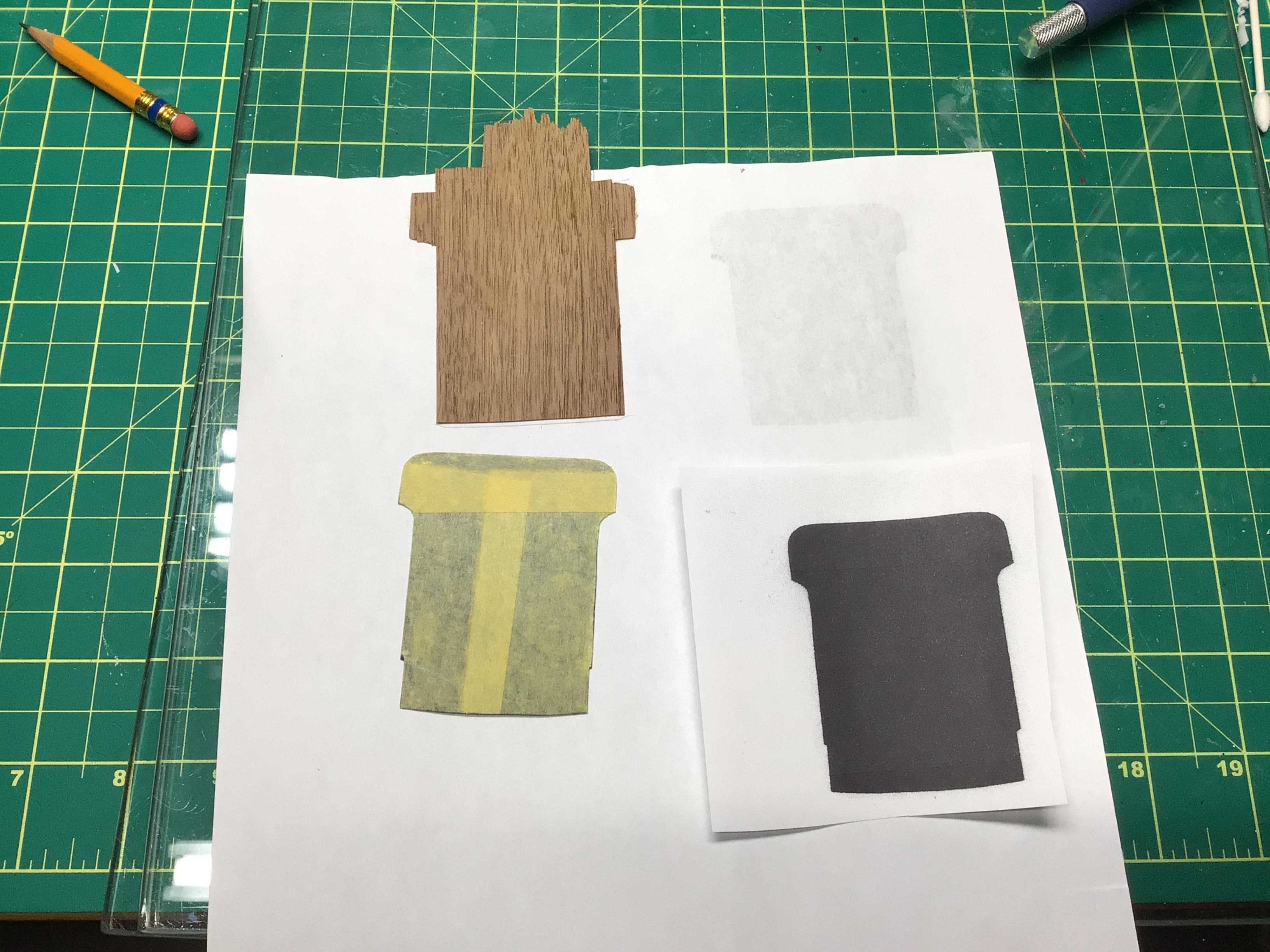

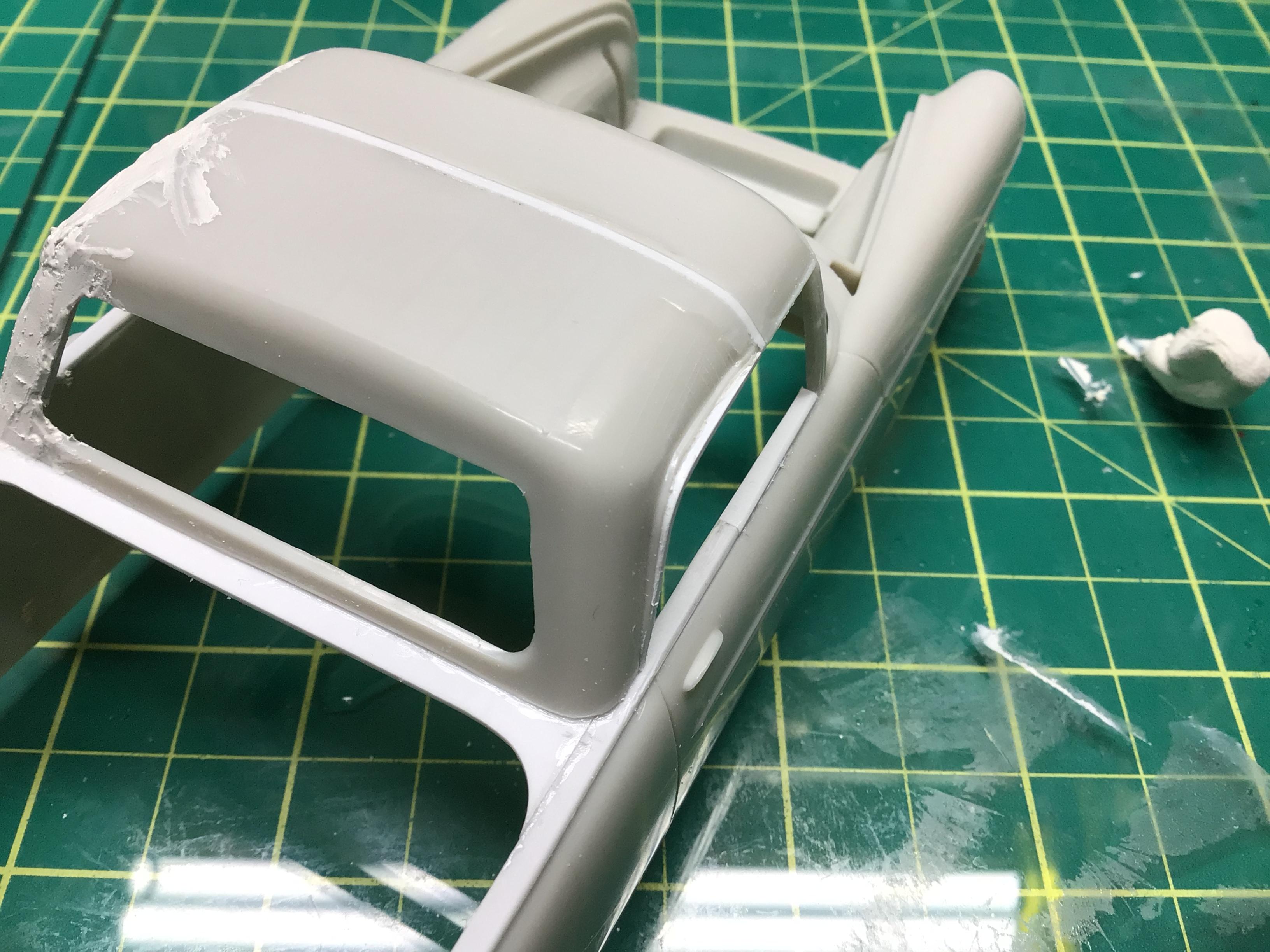

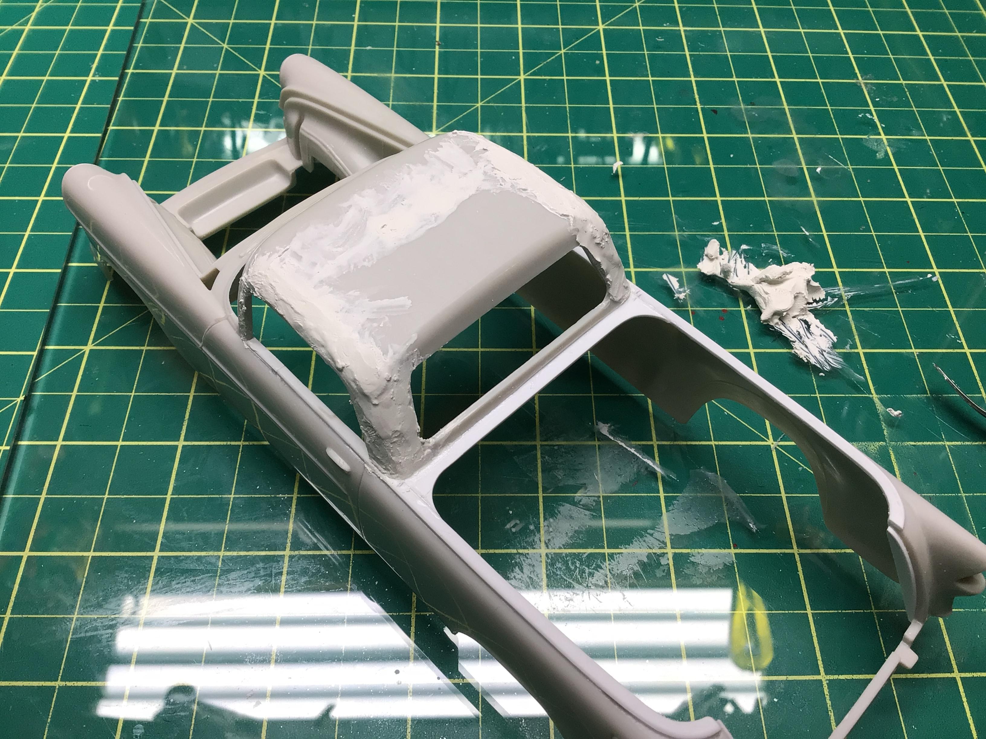

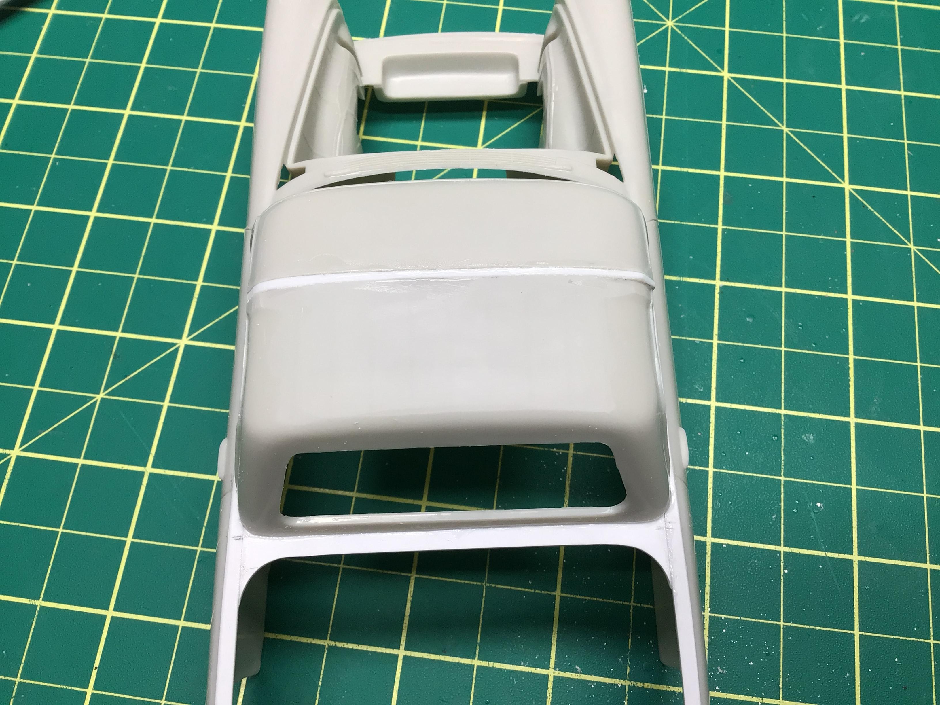

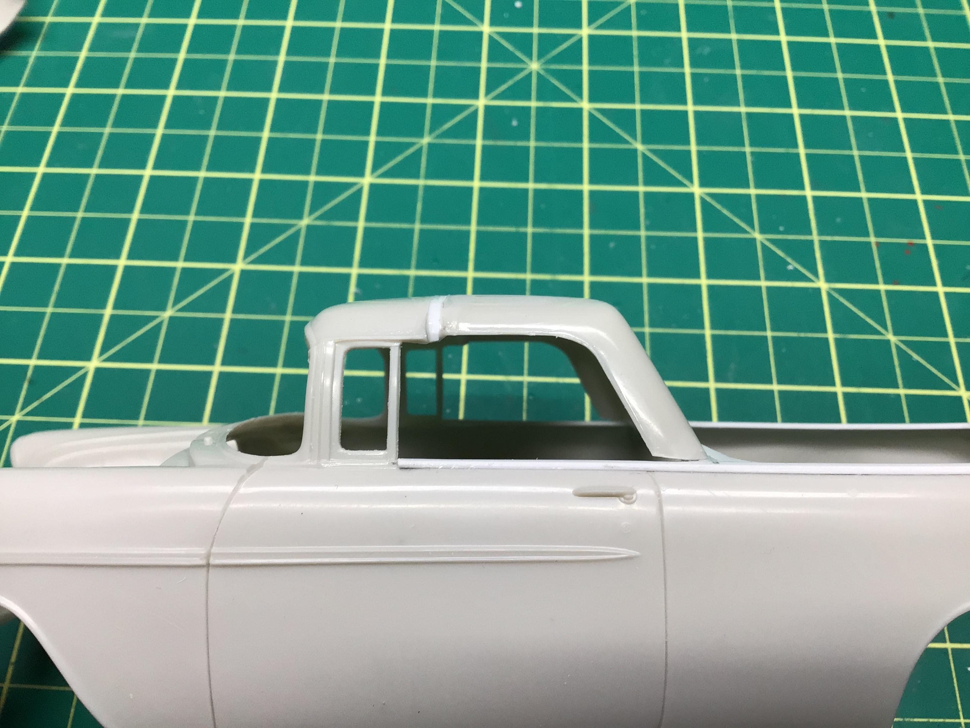

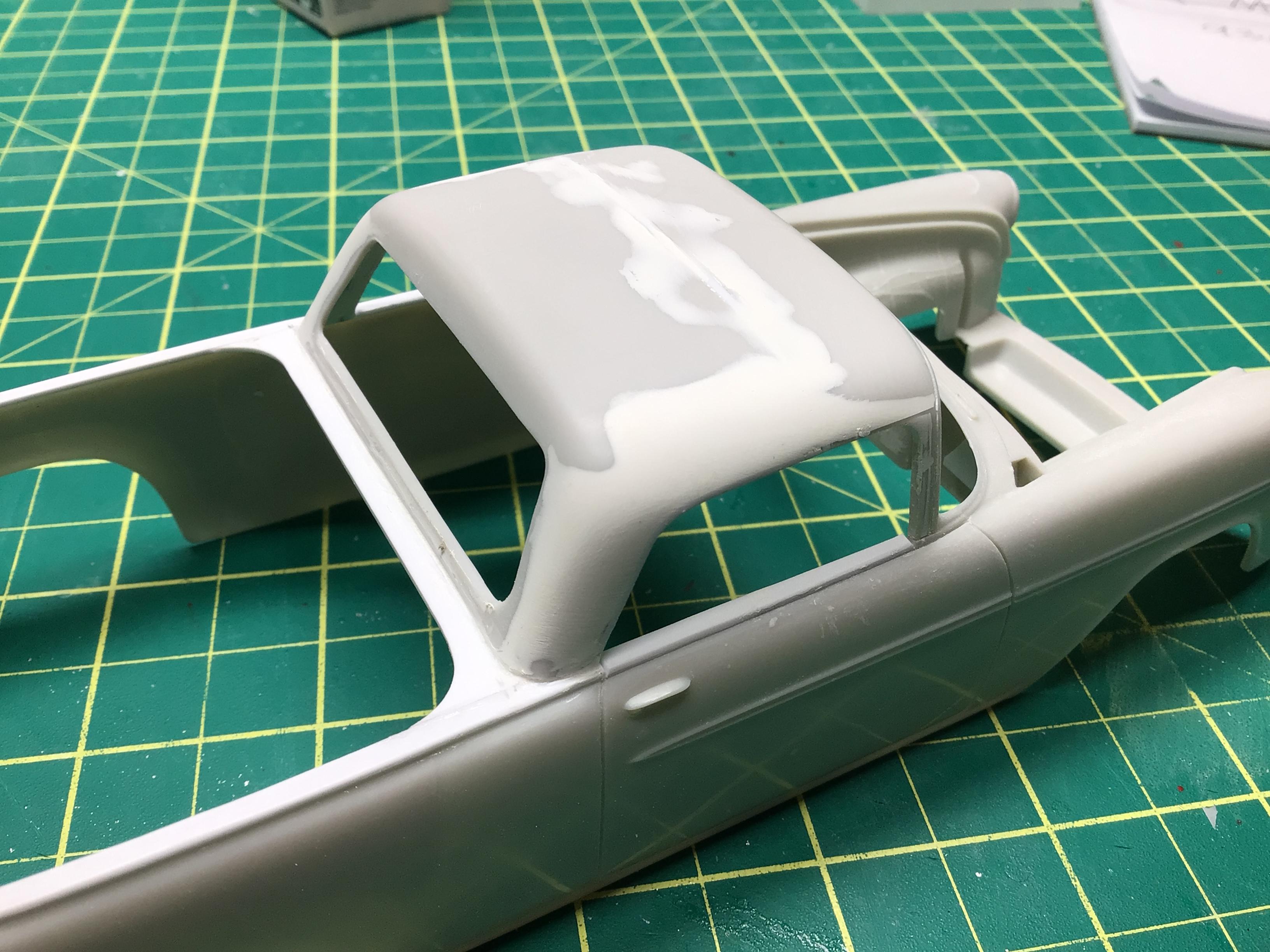

NOBLNG Posted August 1, 2024 Author Posted August 1, 2024 (edited) The half cab roof section supplied with the kit is narrower than the original roof and needs a fair bit of work and putty to look like it belongs there.? And I’ve removed the vent windows while I’m at it. I am going to install a real walnut bed made from 2” wide edge banding. Once I get enough clear lacquer on it, I will add styrene strips and foil them.? Edited August 1, 2024 by NOBLNG 7

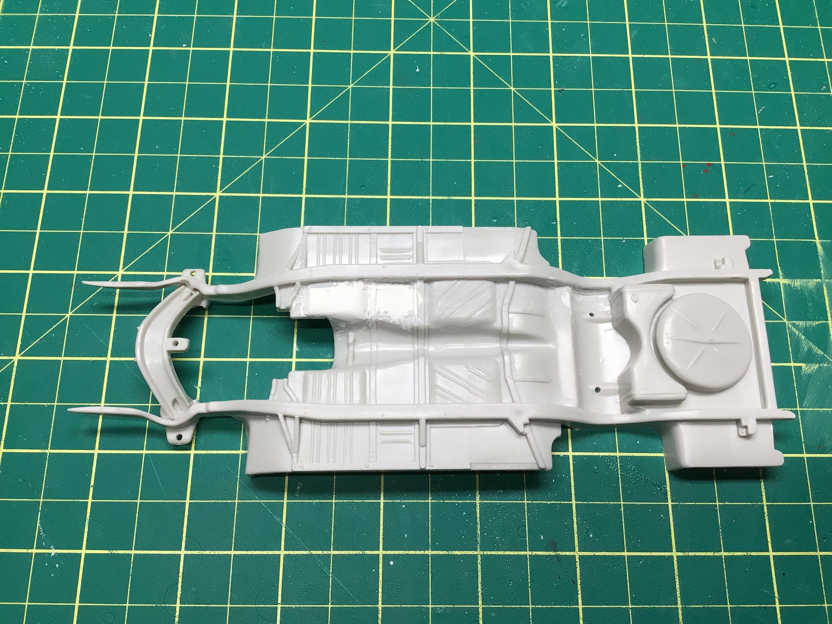

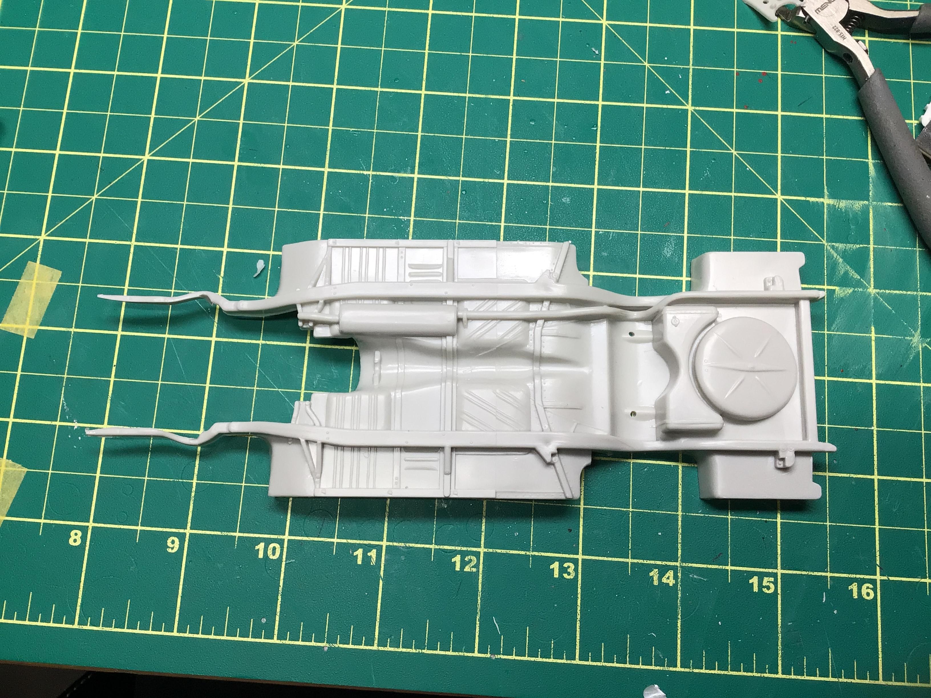

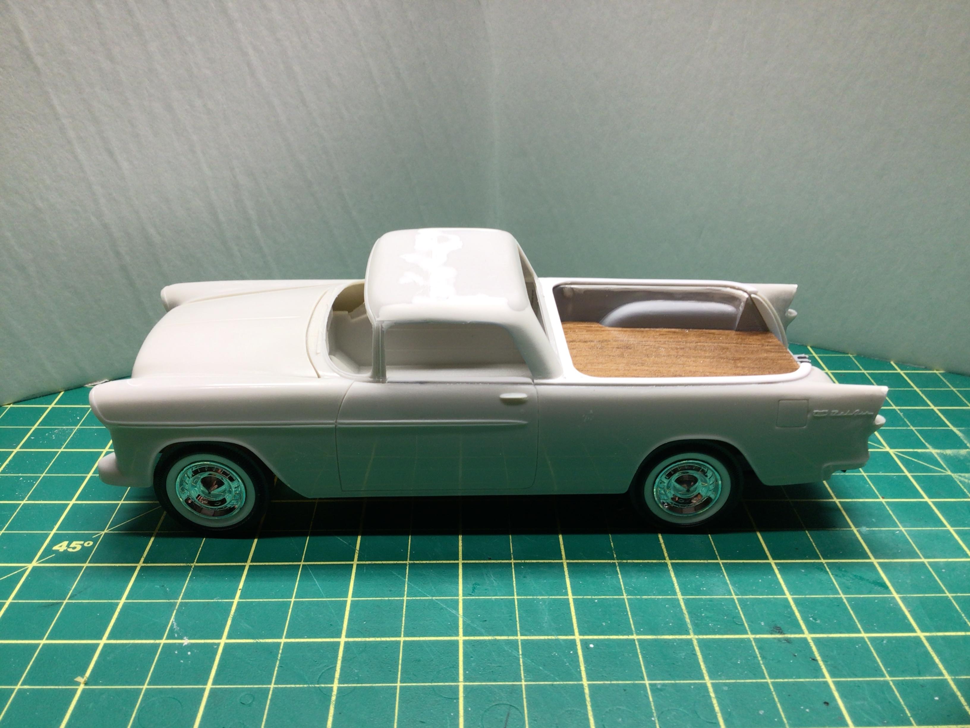

NOBLNG Posted August 1, 2024 Author Posted August 1, 2024 The engine will be an LS from a Revell Camaro. I plan to use the dual exhaust from a Revell ‘55 chevy…or scratch build something? So I removed the molded in exhaust and patched up the chassis. I have not yet decided on wheels/tires and stance. That’s all for now.? 10

Speedpro Posted August 1, 2024 Posted August 1, 2024 Nice work so far! Look's good with the white walls and stock caps in the mockup.
NOBLNG Posted August 1, 2024 Author Posted August 1, 2024 7 minutes ago, Speedpro said: Nice work so far! Look's good with the white walls and stock caps in the mockup. Thanks Paul.?

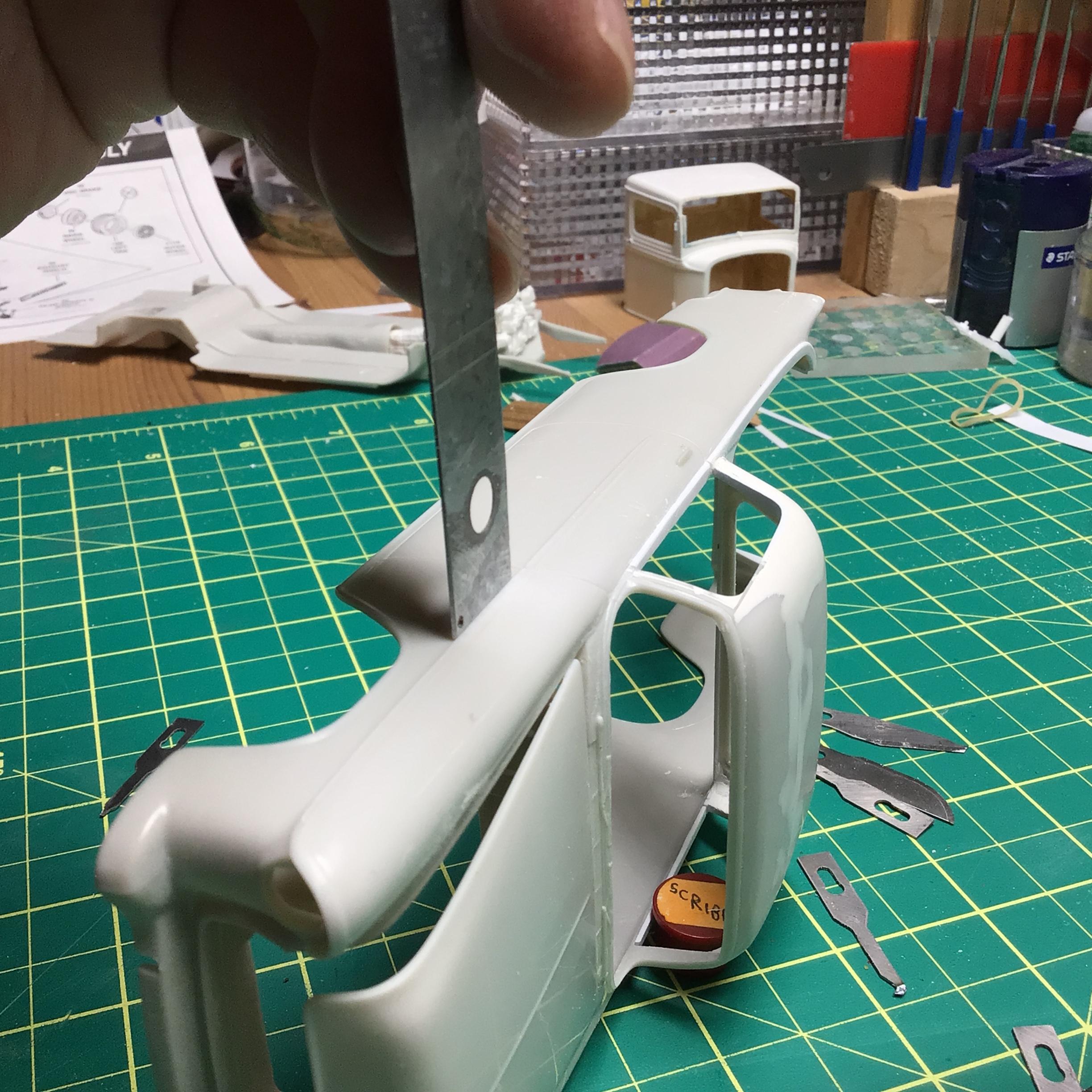

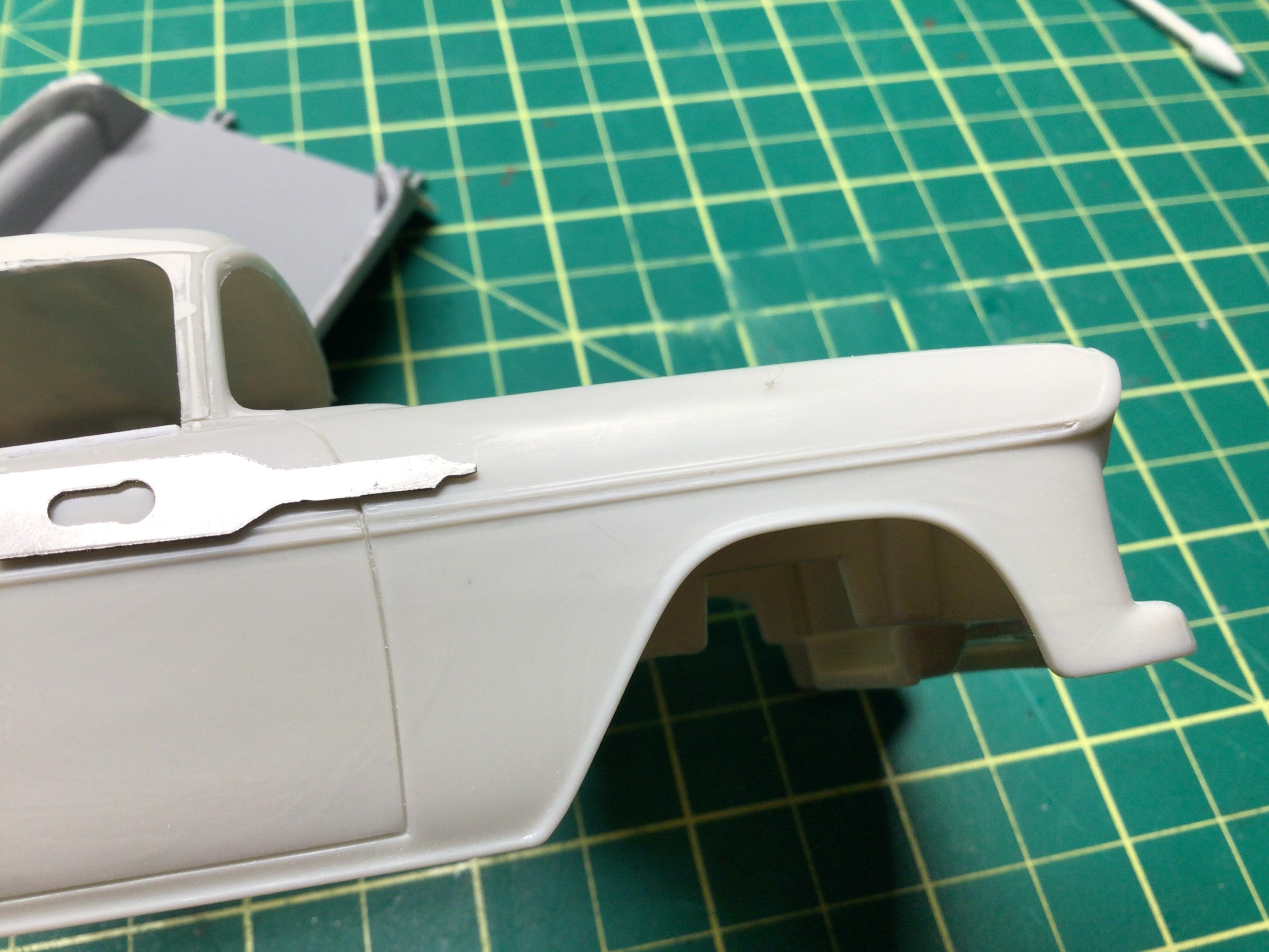

NOBLNG Posted August 1, 2024 Author Posted August 1, 2024 There is a mold seam running right down the center of the front fender chrome trim that needs to be removed. I used a modified hobby blade and a piece of 26ga. metal to carefully scrape it out.? 5

dino246gt Posted August 2, 2024 Posted August 2, 2024 It's looking great already, that roof is way better integrated after you worked on it! Love the attention to detail on the side chrome spear, these little things really pay off on the finished model. If your spare parts boxes are a little short, I have a ton of stuff, just ask, I'm only a cappuccino away from you!
NOBLNG Posted August 2, 2024 Author Posted August 2, 2024 4 hours ago, DJMar said: Awesome idea, and it's not just because I was just looking through this and thinking, "Wouldn't a '55 Nomad pickup be sweet? I think I have that kit in my stash somewhere..." Great minds think alike. ? But seriously, you've got this one off to a great start. Thanks DJ. Dig it out and get started on it.? 1 hour ago, dino246gt said: It's looking great already, that roof is way better integrated after you worked on it! Love the attention to detail on the side chrome spear, these little things really pay off on the finished model. If your spare parts boxes are a little short, I have a ton of stuff, just ask, I'm only a cappuccino away from you! Thanks Dennis! Yeah, the fit of that roof was BAD.? Thanks for the offer…I think I have all I need. But the cappuccino sounds good.?

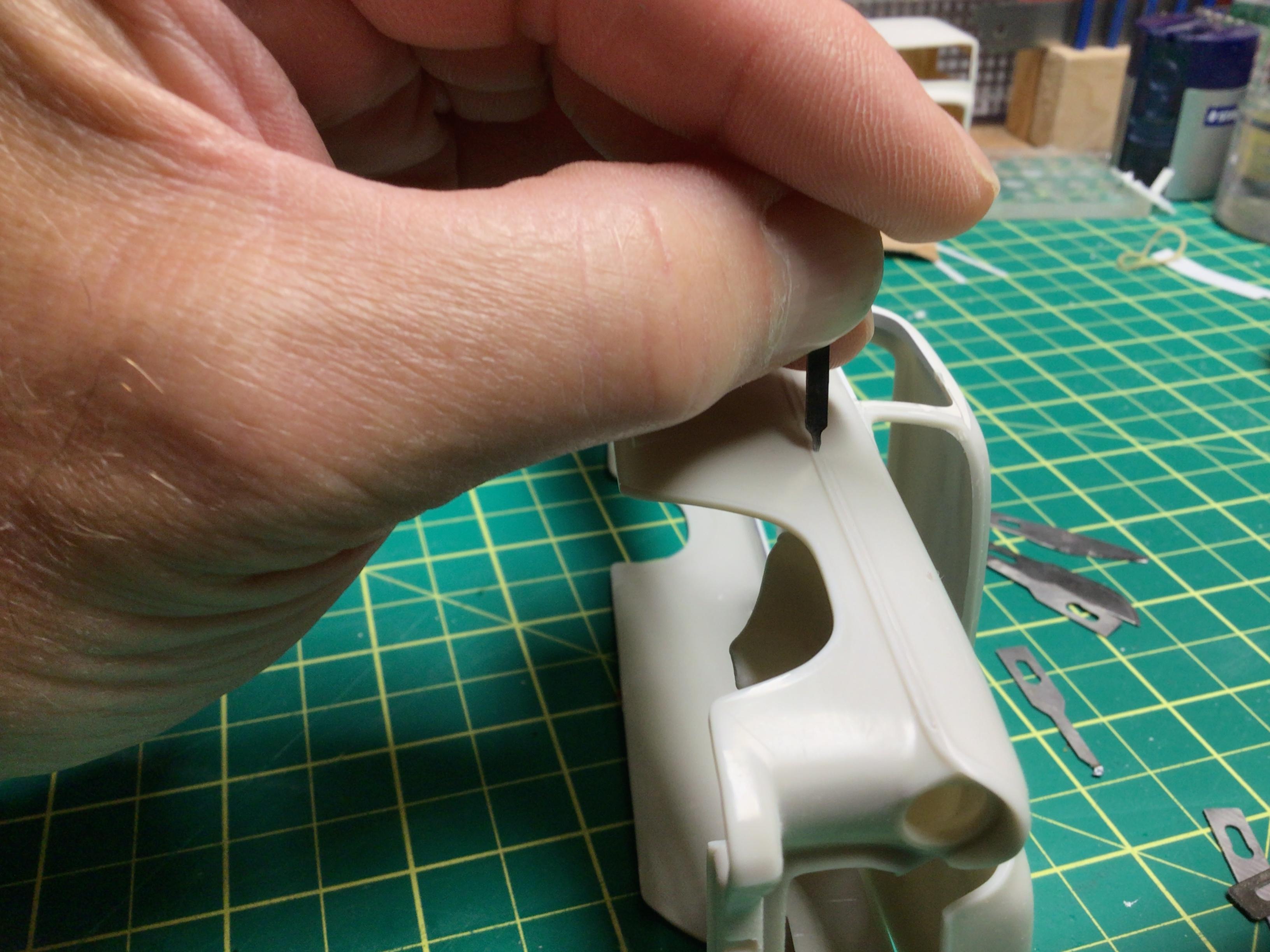

slusher Posted August 2, 2024 Posted August 2, 2024 Another one of your sharp builds. You have been building som fabulous builds. This one is looking great! May I ask what you used to remove the molded in exhaust?

NOBLNG Posted August 3, 2024 Author Posted August 3, 2024 8 hours ago, slusher said: Another one of your sharp builds. You have been building som fabulous builds. This one is looking great! May I ask what you used to remove the molded in exhaust? I hogged out most of the exhaust with a 1/8” end mill in my drill press. Then some careful whittling with a #18? Exacto Chisel blade, then some curved needle files and some scraping with the same modified hobby blade that I used on the side molding. Thanks for the compliments Carl.? 5 hours ago, customline said: Oh boy.....glad I caught up with this one, Greg. I've got a Mono '57 that has been begging for this treatment. It looks like you had this one well planned. I'm on board. I have lots of questions. ? Thanks Jim. Does the ‘57 come with a half roof? If not, I’m sure you could use the back 1/4 of the Nomad roof. Just cut a chunk out and move it forward. I’ll do my best to answer any questions you may have.?

TheBEAUMONTGURU Posted August 5, 2024 Posted August 5, 2024 Nice scratchbuilding work there Greg! whats that putty you are using on the roof? looks like good stuff.
NOBLNG Posted August 5, 2024 Author Posted August 5, 2024 (edited) 35 minutes ago, TheBEAUMONTGURU said: Nice scratchbuilding work there Greg! whats that putty you are using on the roof? looks like good stuff. Thanks Dave. That is the fine white Milliput. If you’re not familiar, it is a two part epoxy putty. A very tiny amount of water added will soften it greatly so it can be sculpted to an almost finished shape, and it sands like drywall mud.? I like it WAY better than the Tamiys brand. Edited August 5, 2024 by NOBLNG
