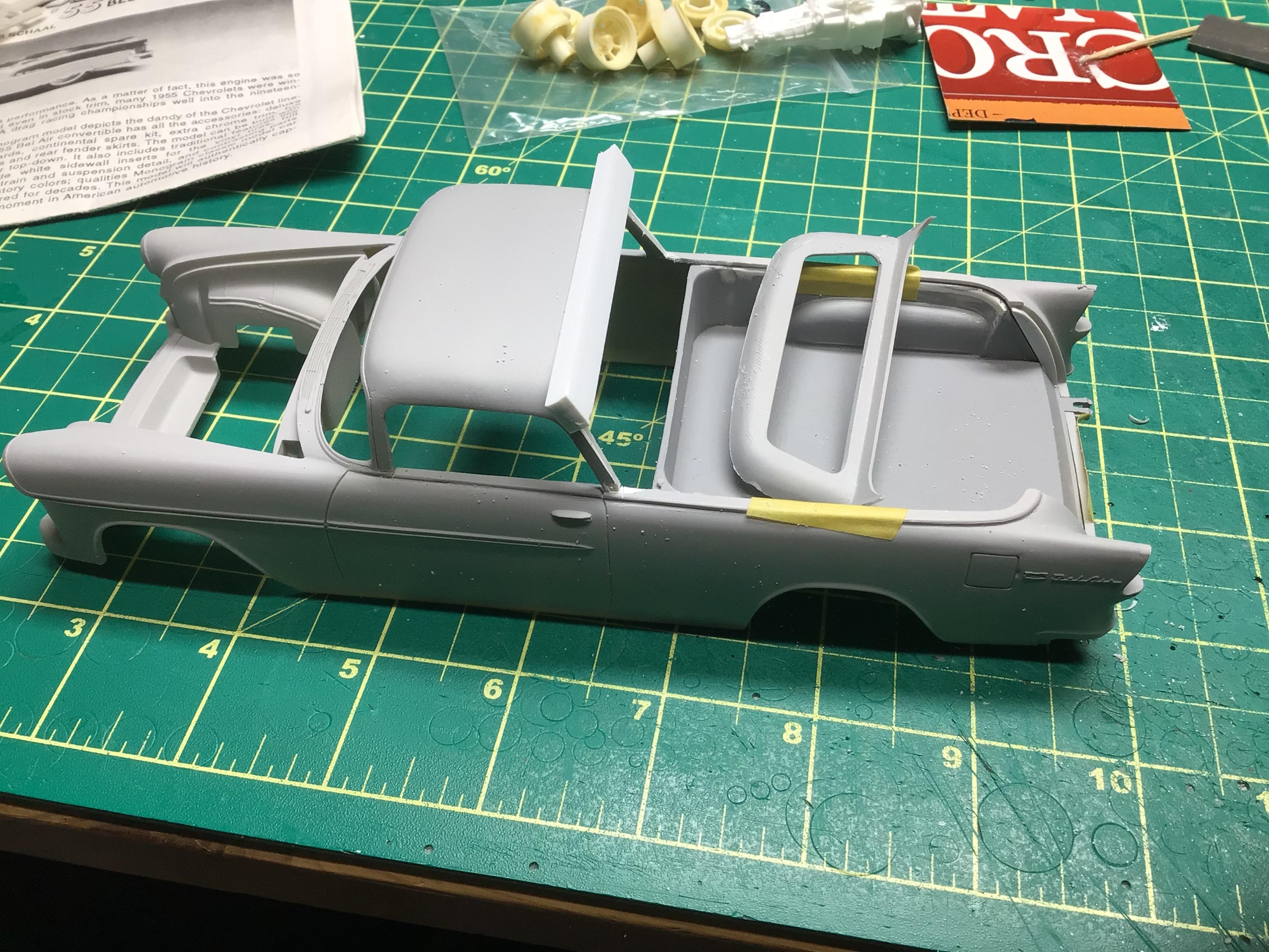

The proportions are better on the kit roof. I like the omission of the vent window. Brings this build in to the present century. Body work on both is amazingly smooth. Well done.

Yeah, the more I look at the two of them…the more I like the kit piece.

I think the design in the AMT roof is really good and does not need anything to look like it was designed by GM. I decided to leave vent windows but removing works also well and makes the roof look a bit lower. I think the front window in the kit is a bit too low compared to original Nomad but looks nice in the pick up conversion. Then again in Monogram 57 the whole roof it is way too high and I think it is difficult to build a nice model out of that.
Tbird roof makes me wonder would it work as a shortened two seater roadster?

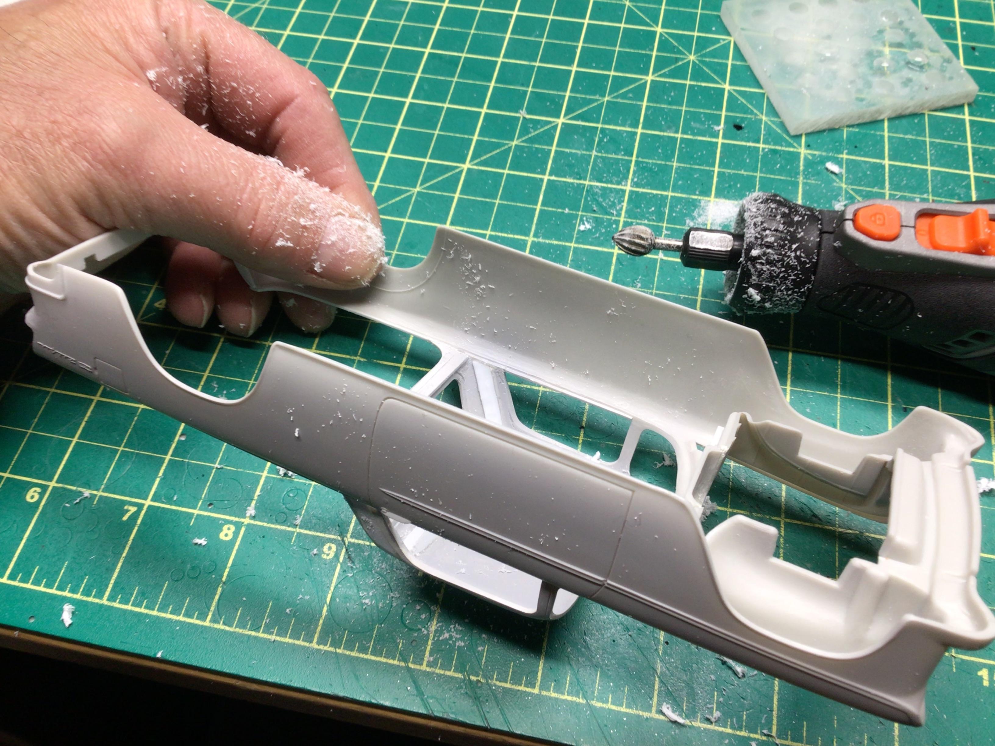

Well I WAS working on something else, then a couple of Nomadic Squirrels ran across my bench and here I am now….So I decided that I might like to mount a slightly wider set of tires on this, and the moulded in fender wells on the bed are the limiting factor.  I briefly thought about tubbing it using some hacked off wheel wells from the parts box. But I could only move them in  about 1/8” before I matched the frame width. So I decided to just move the existing stuff inboard a bit.

I had the box mounted to the frame and then realized that the interior tub was the depth guage for mounting everything else. So I wound up re-fitting the interior tub and then the box mounts. I am attaching the box to the chassis/floorpan as I think it will work better for painting and assembly.
I’Ve put so much work into these wheel wells that I think I should leave the wheels off and just display it on Jack Stands.🥵

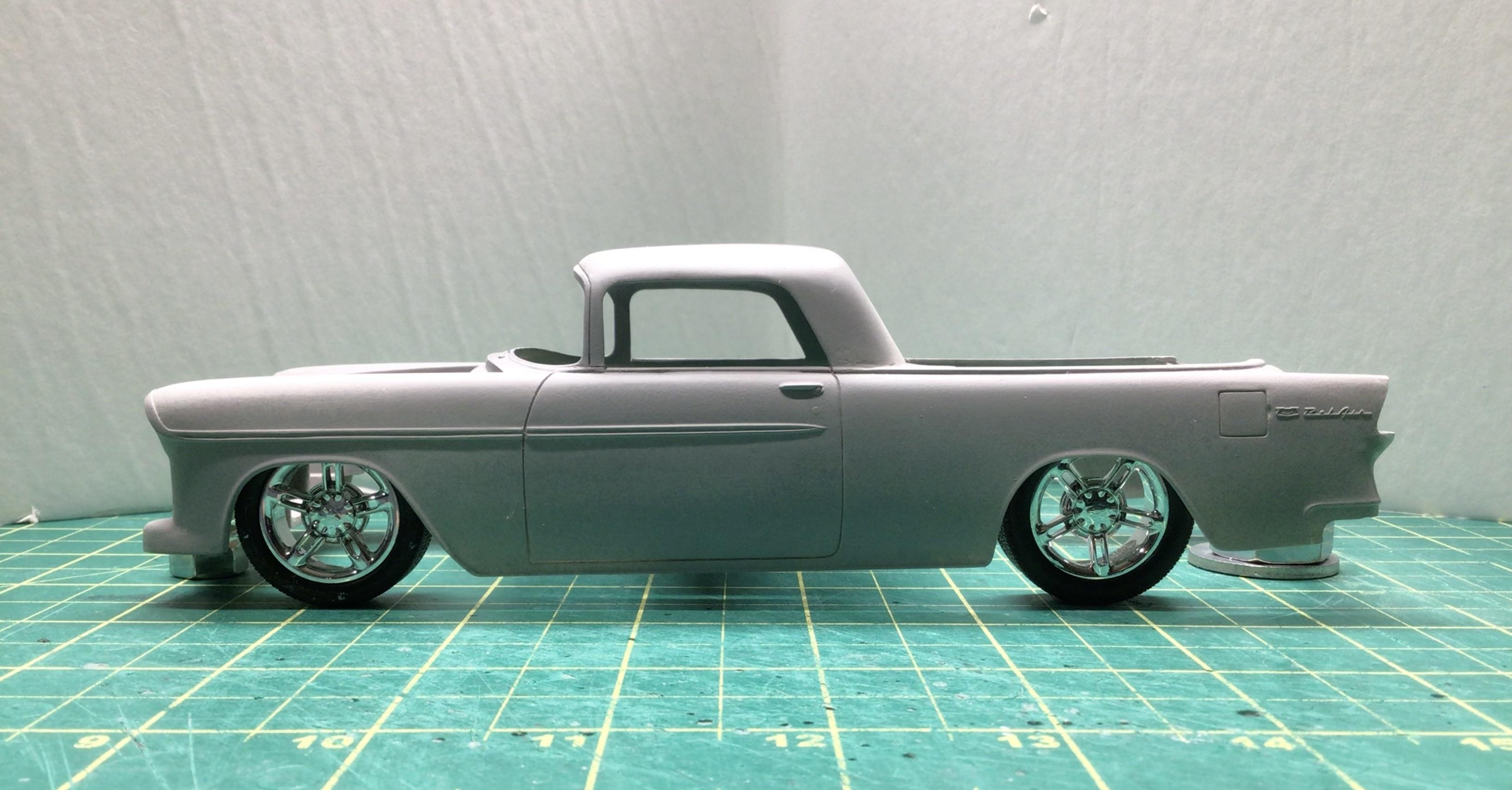

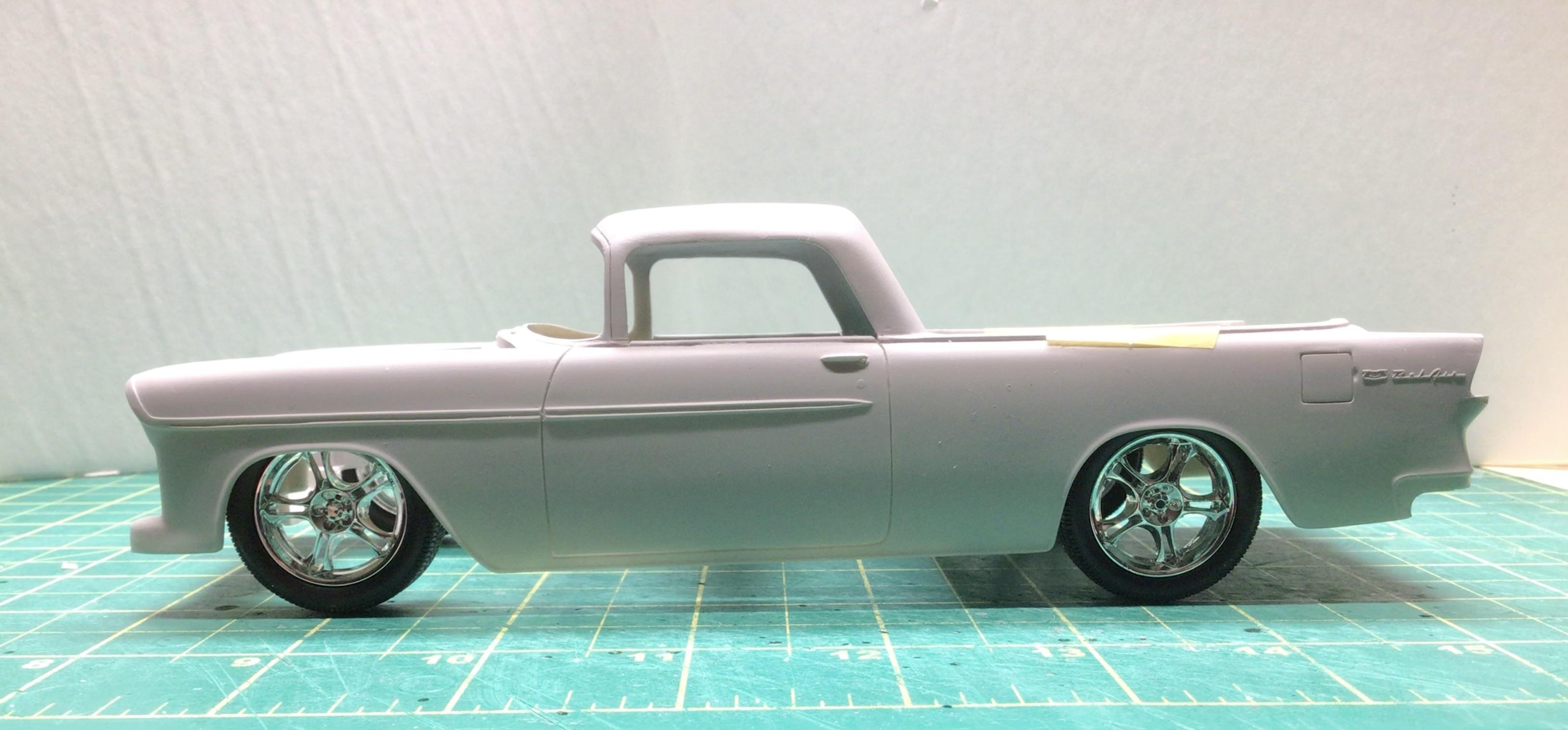

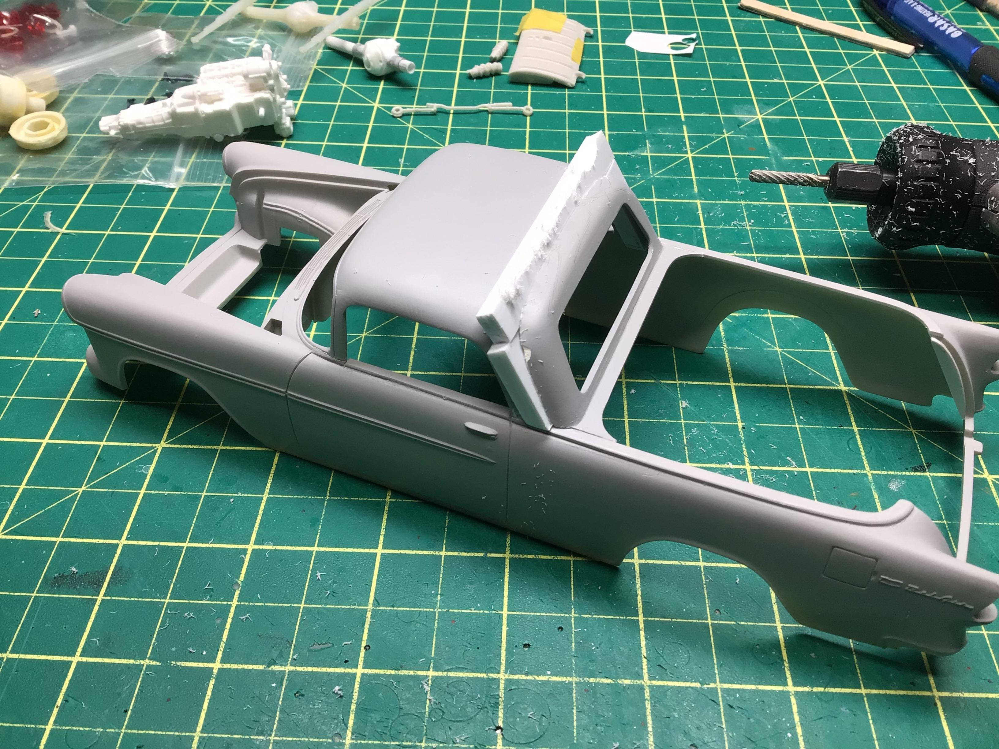

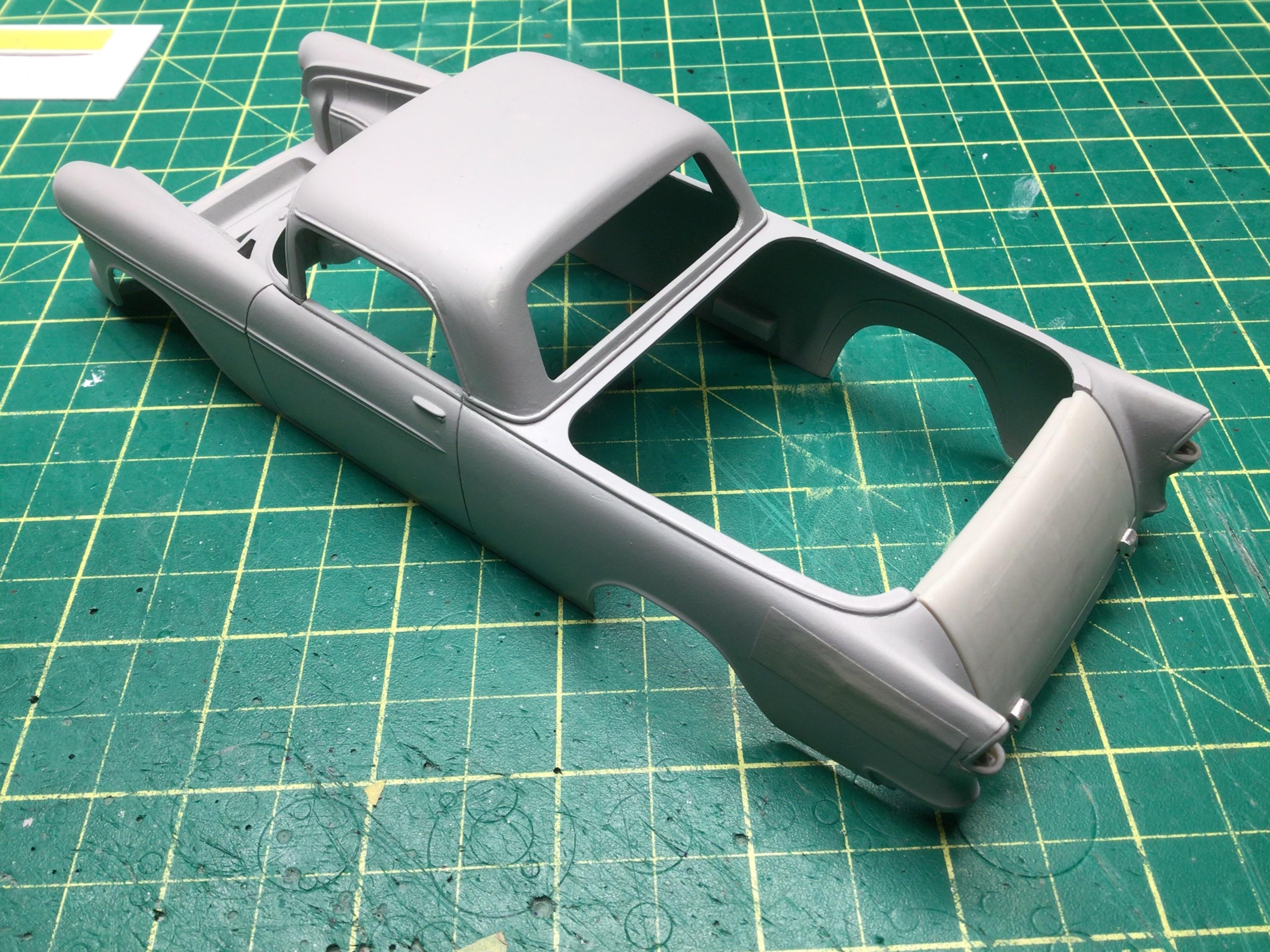

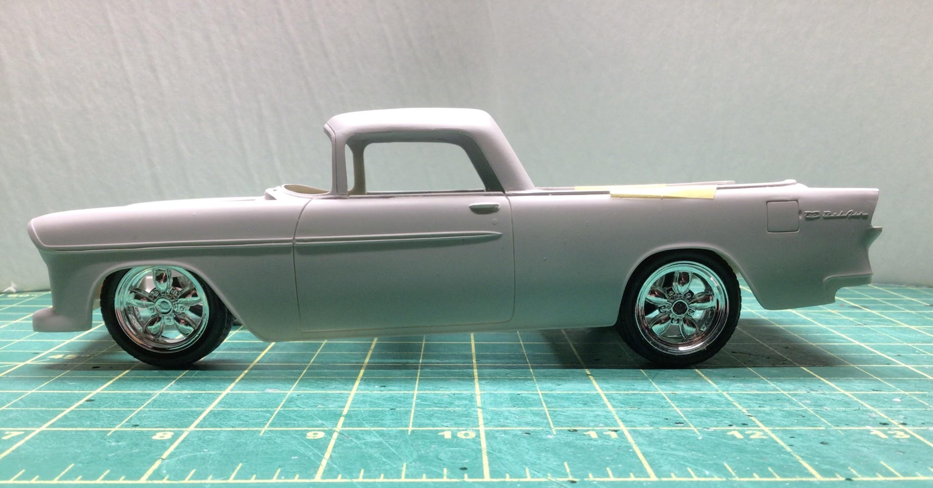

I just wasn’t pleased with the roof which led to the whole silly T-Bird graft attempt. What this one needs in my mind is a slightly beefier B pillar. So…out came the razor saw.
Glued in some 0.156”x0.250” Evergreen. Just enough to stretch the B pillar but not shorten the box noticeably.🧐
A bit of grinding to be done.🥵 This is where the rotary tool comes in handy.😎
Trying to decide on some rims and tires too. These are my four favourites so far. I kinda like the stock white walls and hub caps.

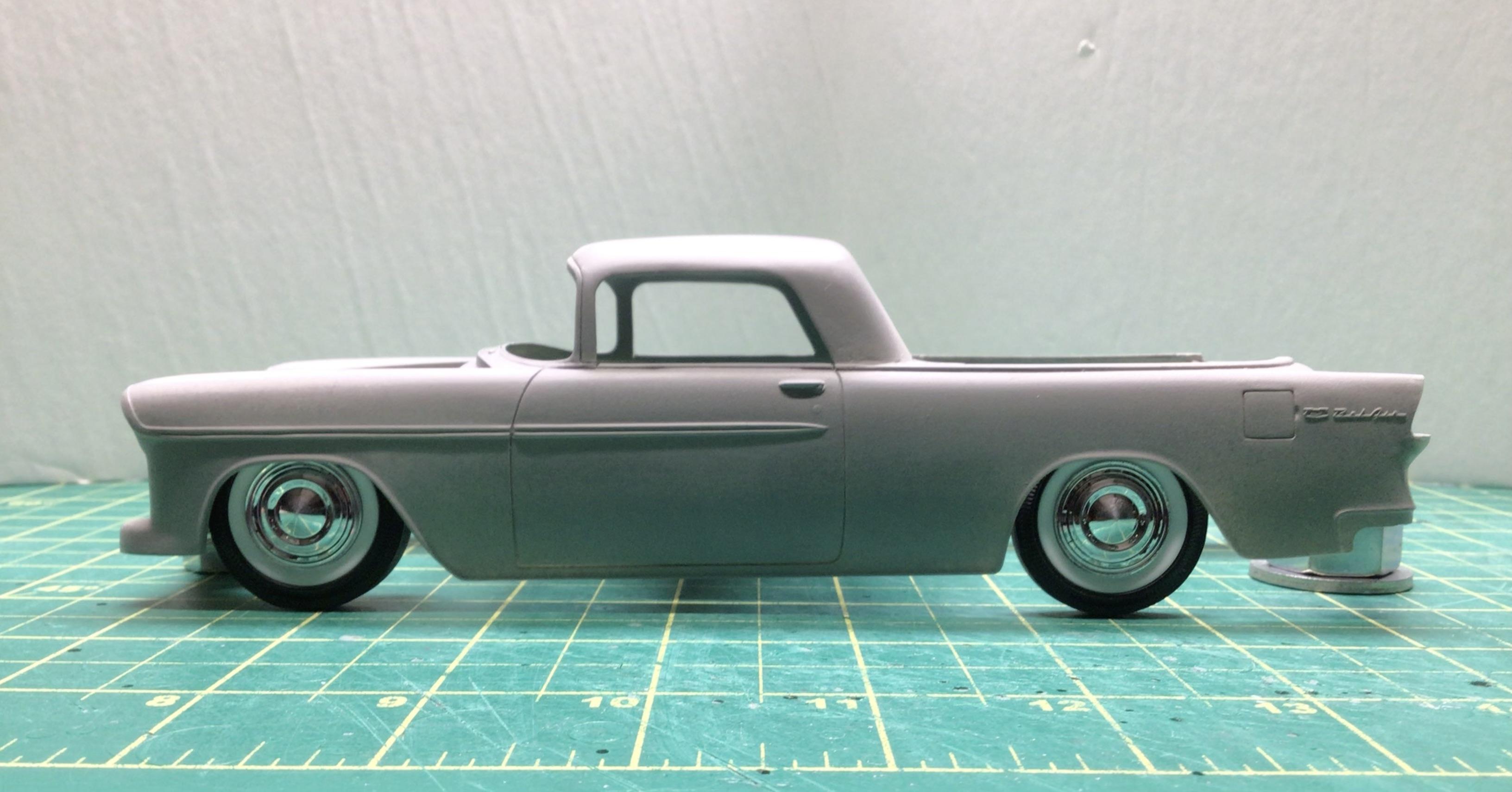

Now that’s more like it!🙂 It almost looks like it’s been slightly chopped?
Edited by NOBLNG
  • Like 6
That looks really good. Small change to that b pillar made a huge difference,  great eye. Both sets of wheels "work", the 'caps and white walls have my vote.
  • Like 3

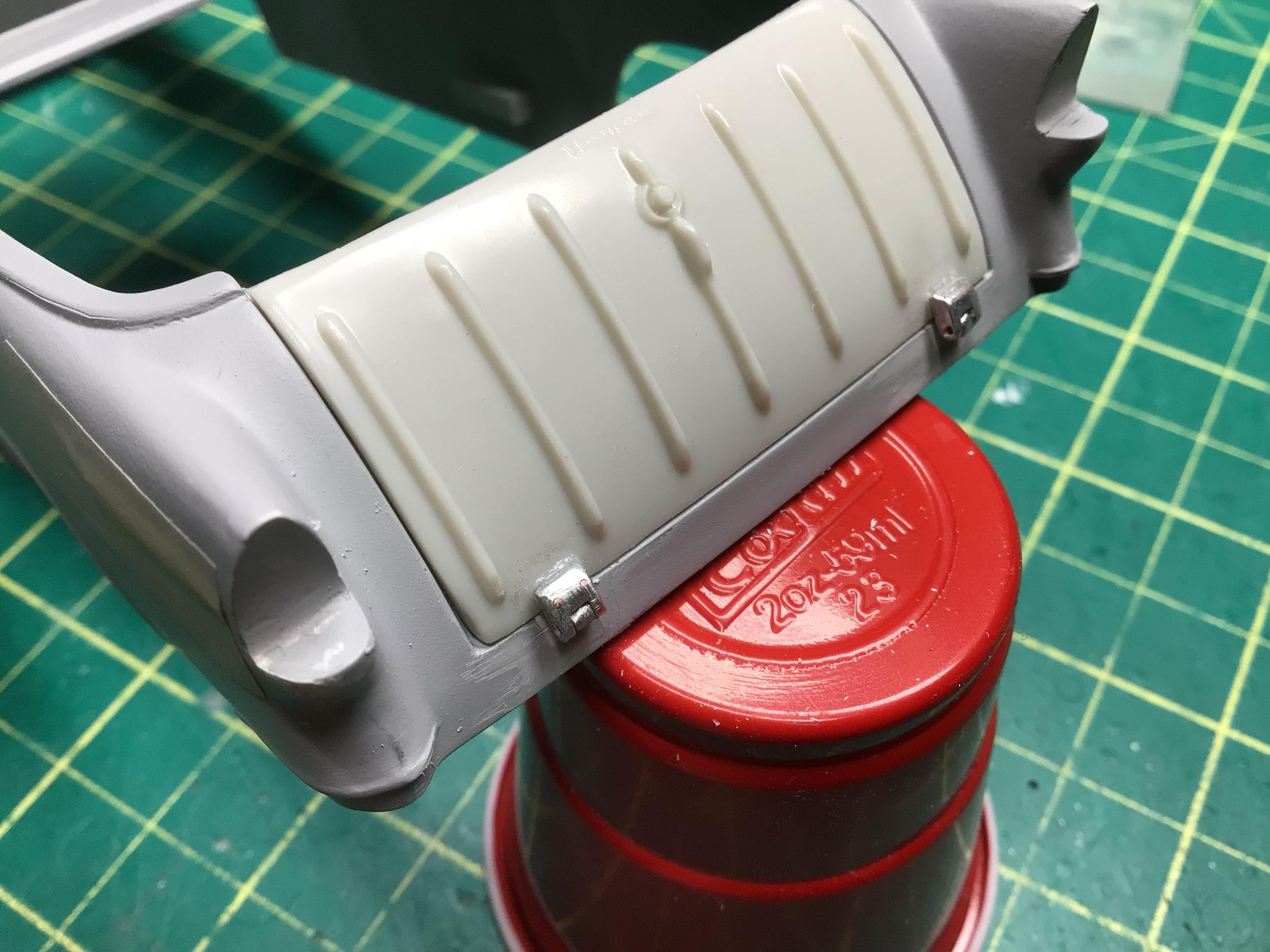

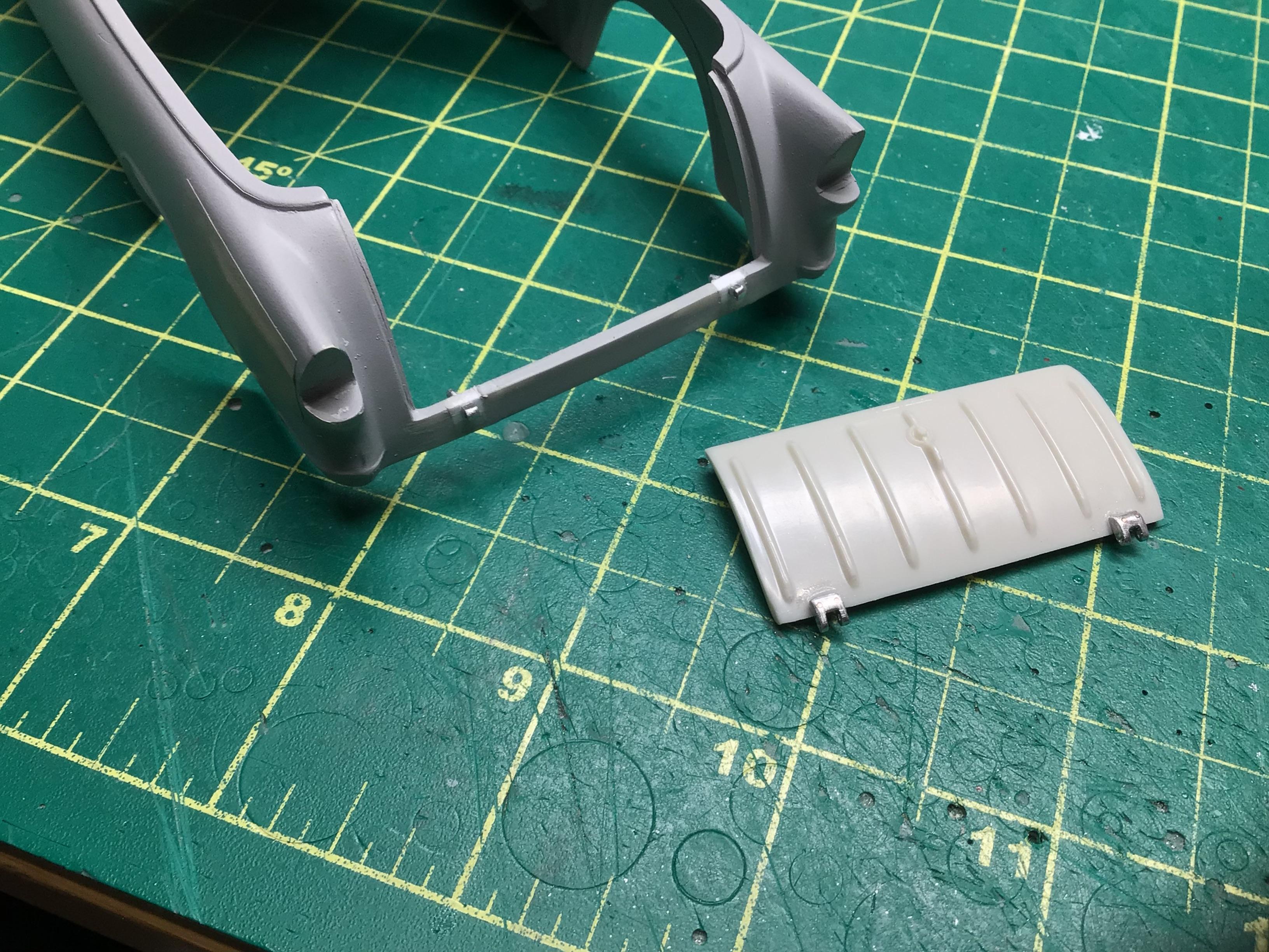

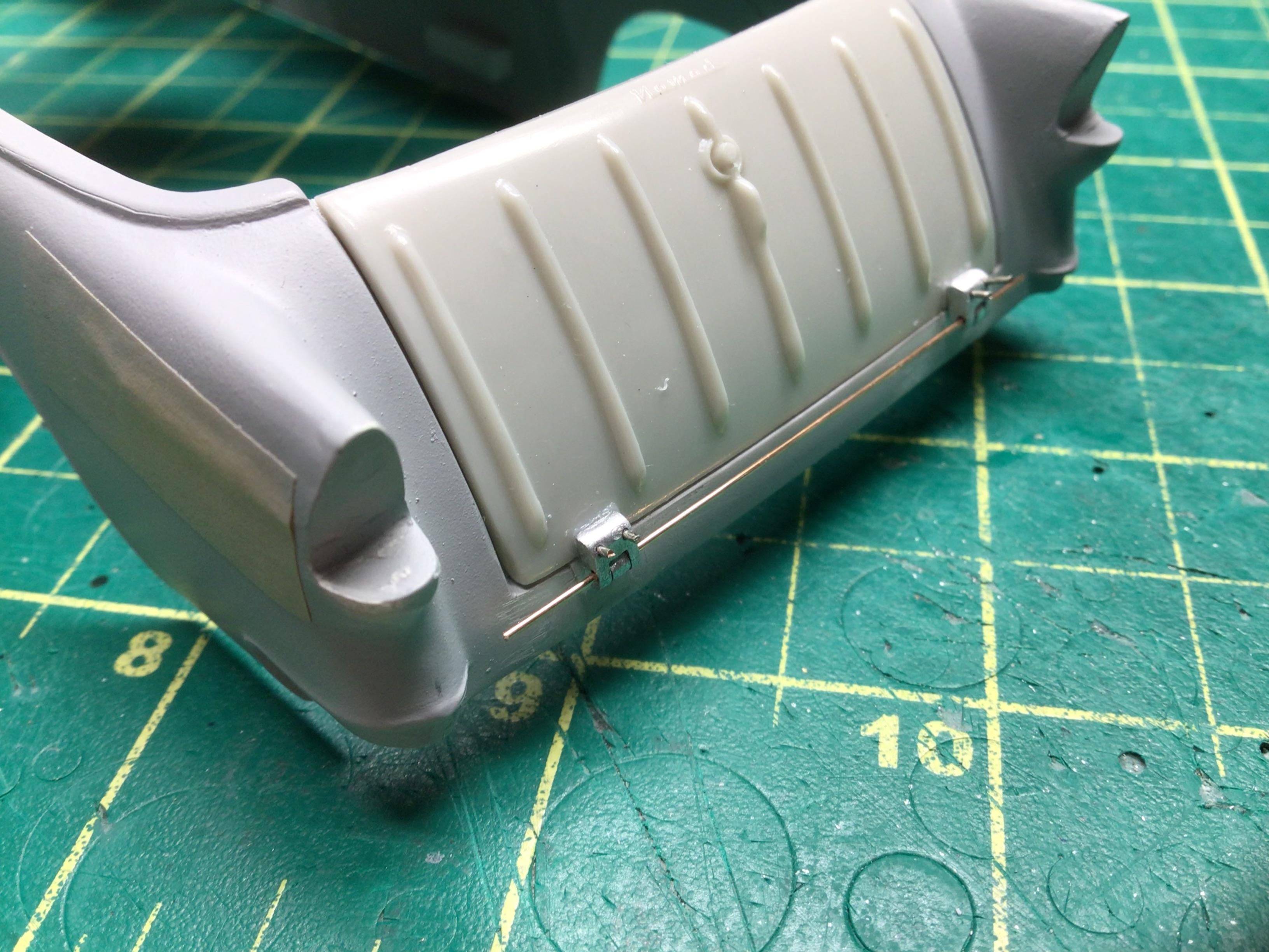

The tailgate on this kit is captured between tabs on the floor pan and the body. So the tailgate is designed to be installed at the same time as the floorpan.😕 That doesn’t work for me…so I made some new hinges from aluminum. Now the tailgate can be installed as a last step pretty much. Now to tackle some hood hinges.🙂

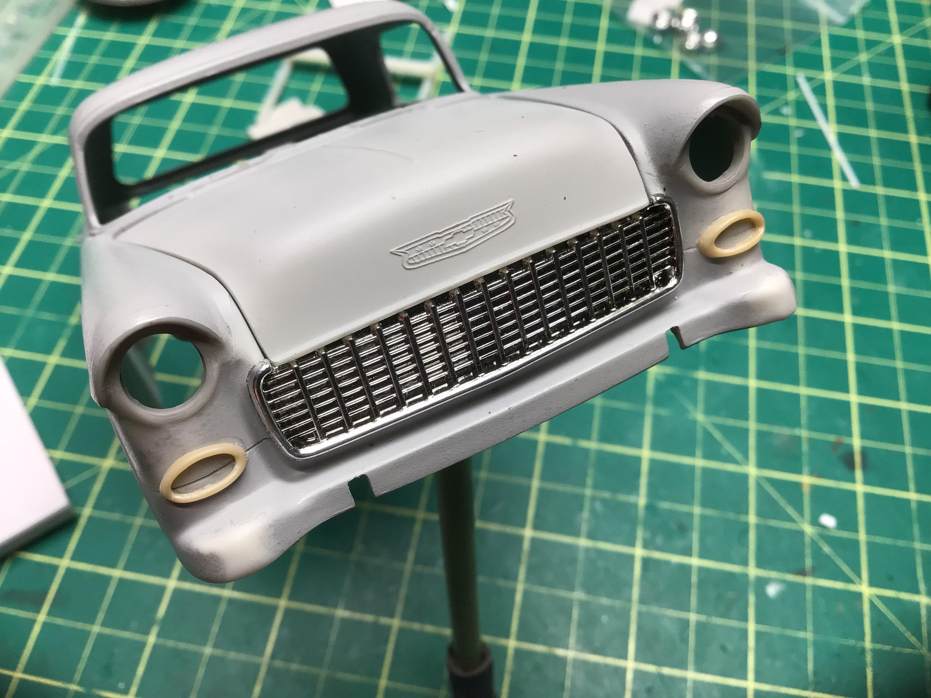

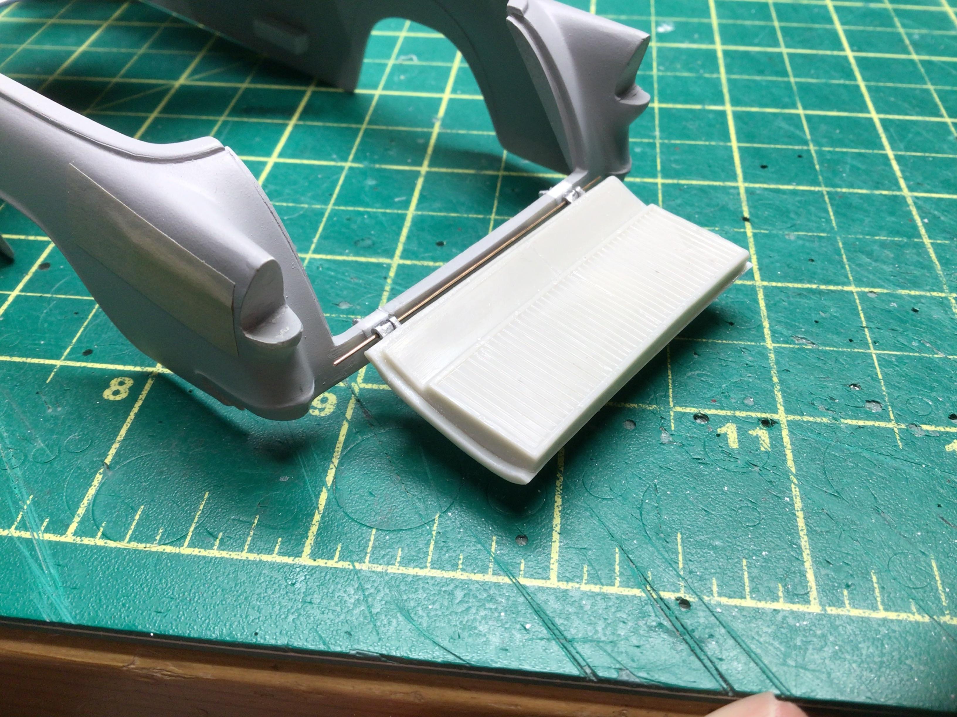

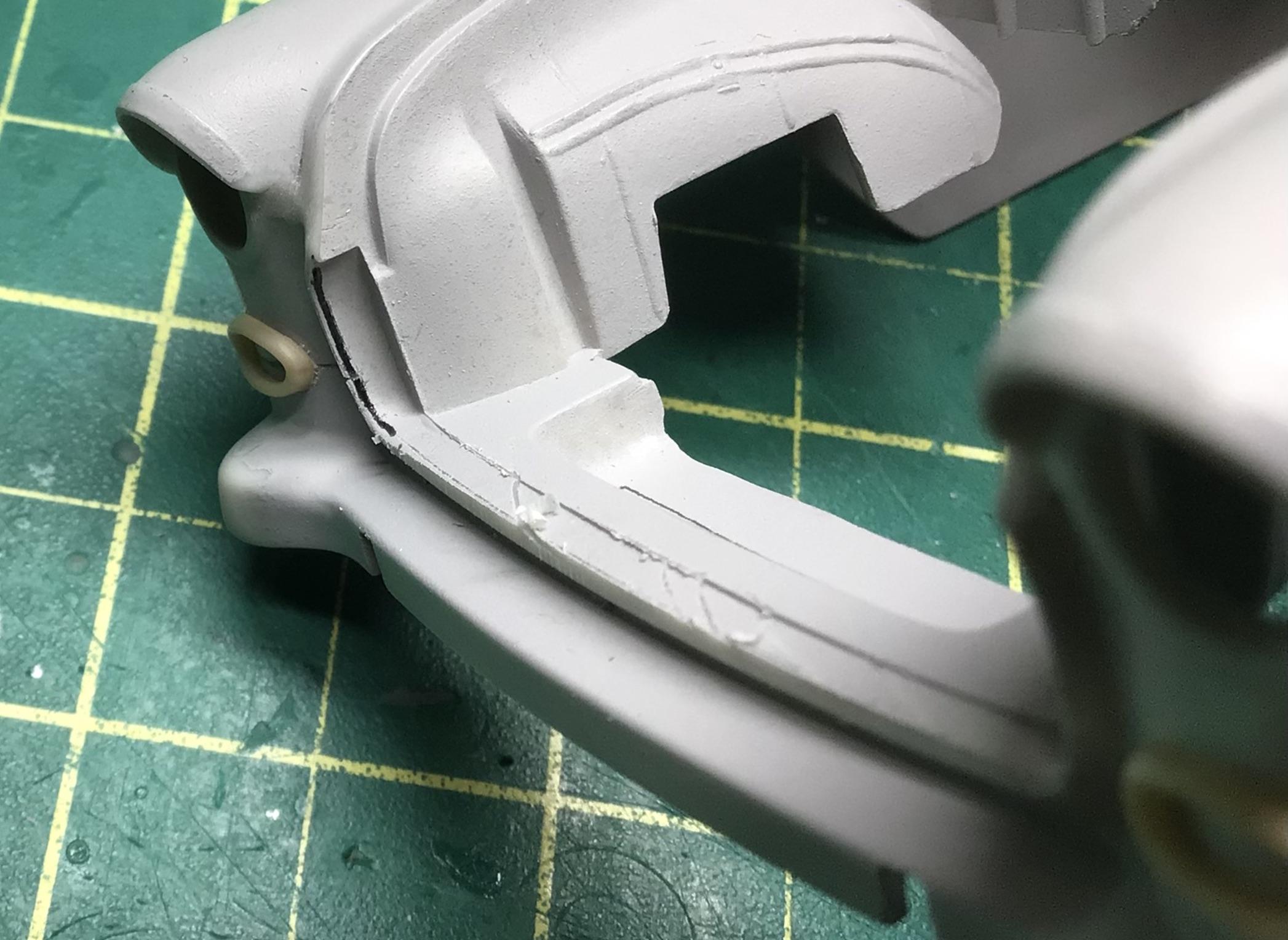

Thanks Guys!🙂 I did a little contour correction around the headlight bezels, scribed in the missing body seam and added the turn signal bezels that I will foil later.
The front bumper needs a bit of tweaking to fit nicely and I’d like to pin it somehow for a more positive mount.

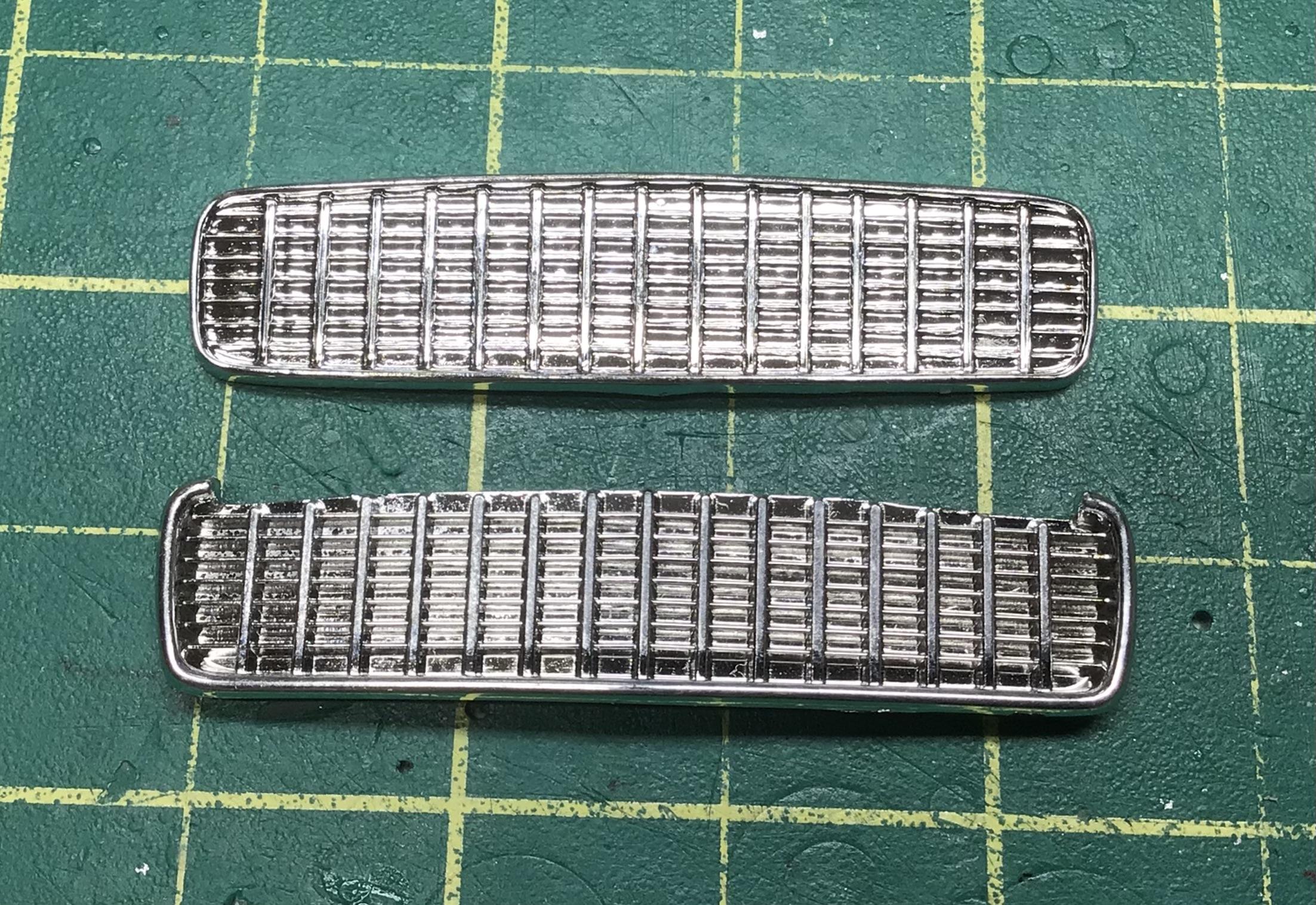

The grill really doesn’t have any nice mounting points.😕 I do happen to have a nicer Monogram grill that almost fits so I think I will use it instead. That’s all for tonight.🙂

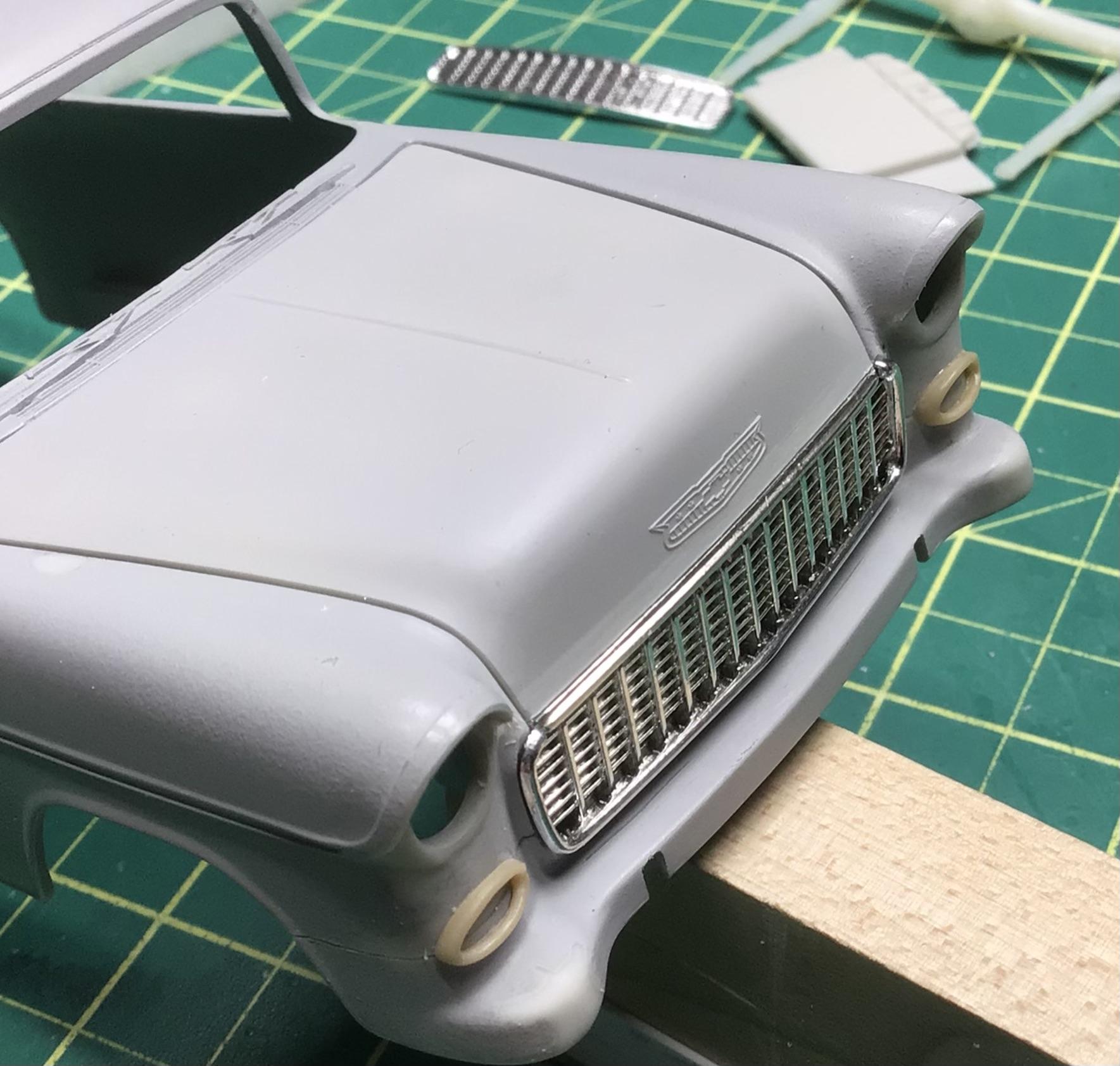

The Monogram grill actually fits with only a bit of filing on each end.IMG_8510.jpeg.891fe4ab2e957f86c6389df5e06ad3b8.jpeg

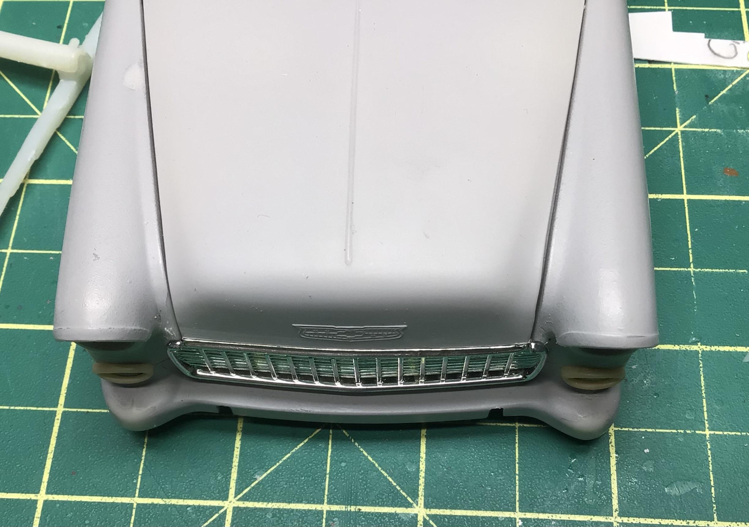

it sits a little too far forward though, so I removed about 0.020” from the nose of the body and also scraped a bit away to lower the grill slightly.IMG_8512.jpeg.7208b605486a91d54c05195c4ef27e43.jpeg

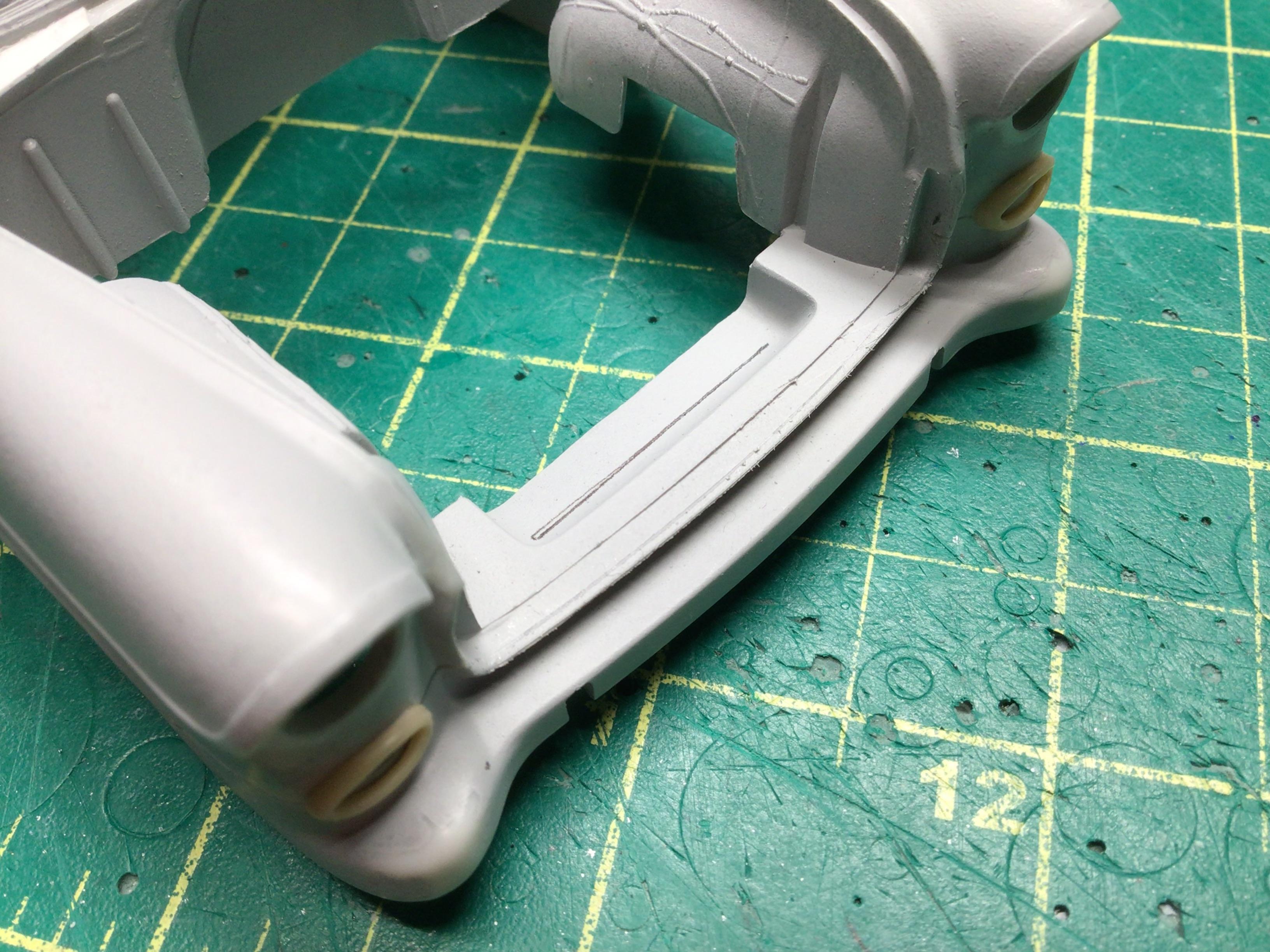

The AMT hood has no separate chrome trim so I decided to trim 0.040” off the leading edge and make one from styrene sheet. I scribed a cut line and after making a couple of passes it dawned on me that it looked pretty good just like that. So I foiled it to get a better perspective and am quite satisfied with it as is.🙂
Edited by NOBLNG
  • Like 2
The scribe line is perfect!  Nice.

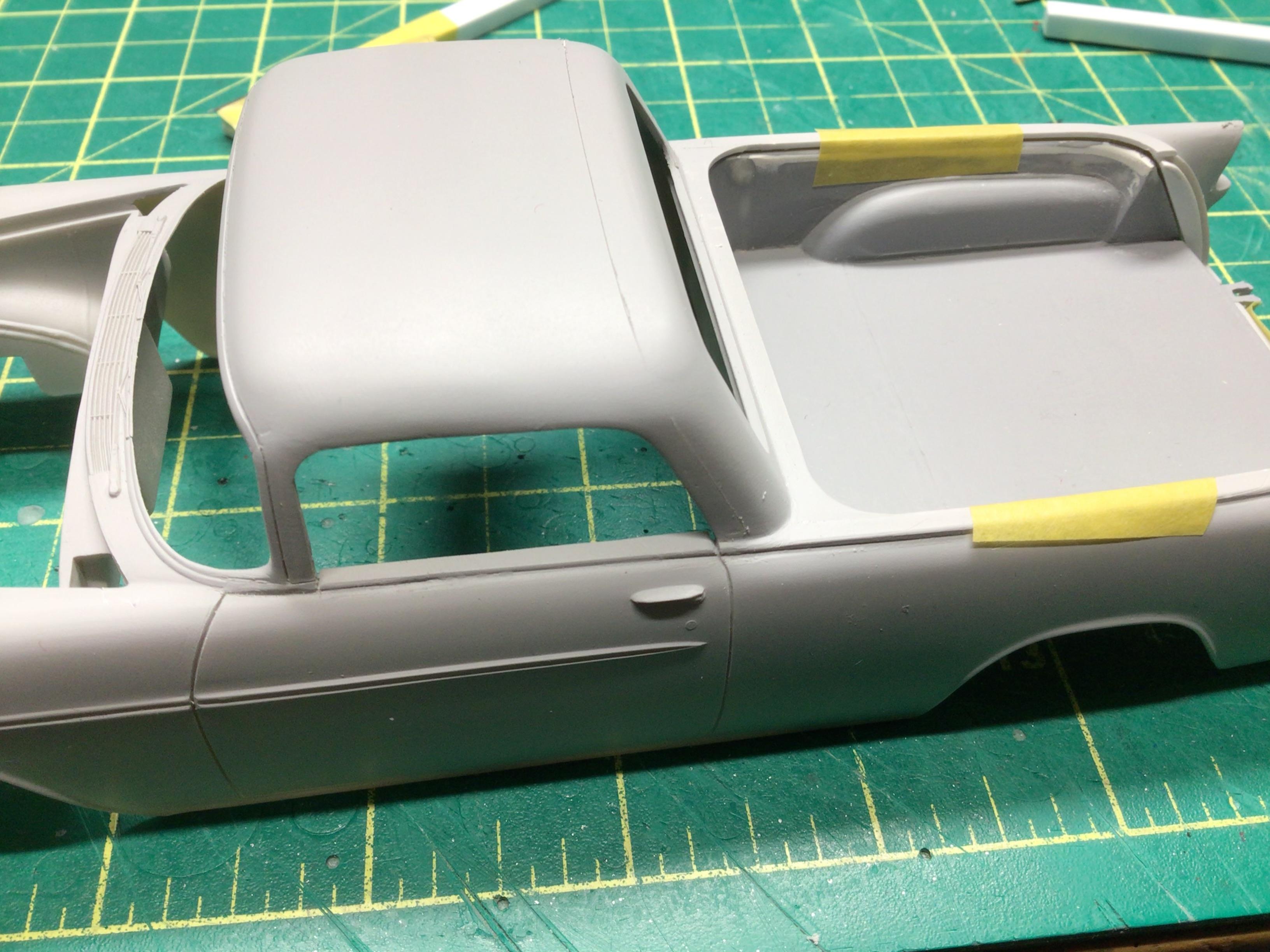

I’ve added some drip rails to the roof and a piece of molding around the base of the cab. Also smoothed the tailgate.
  • Like 1

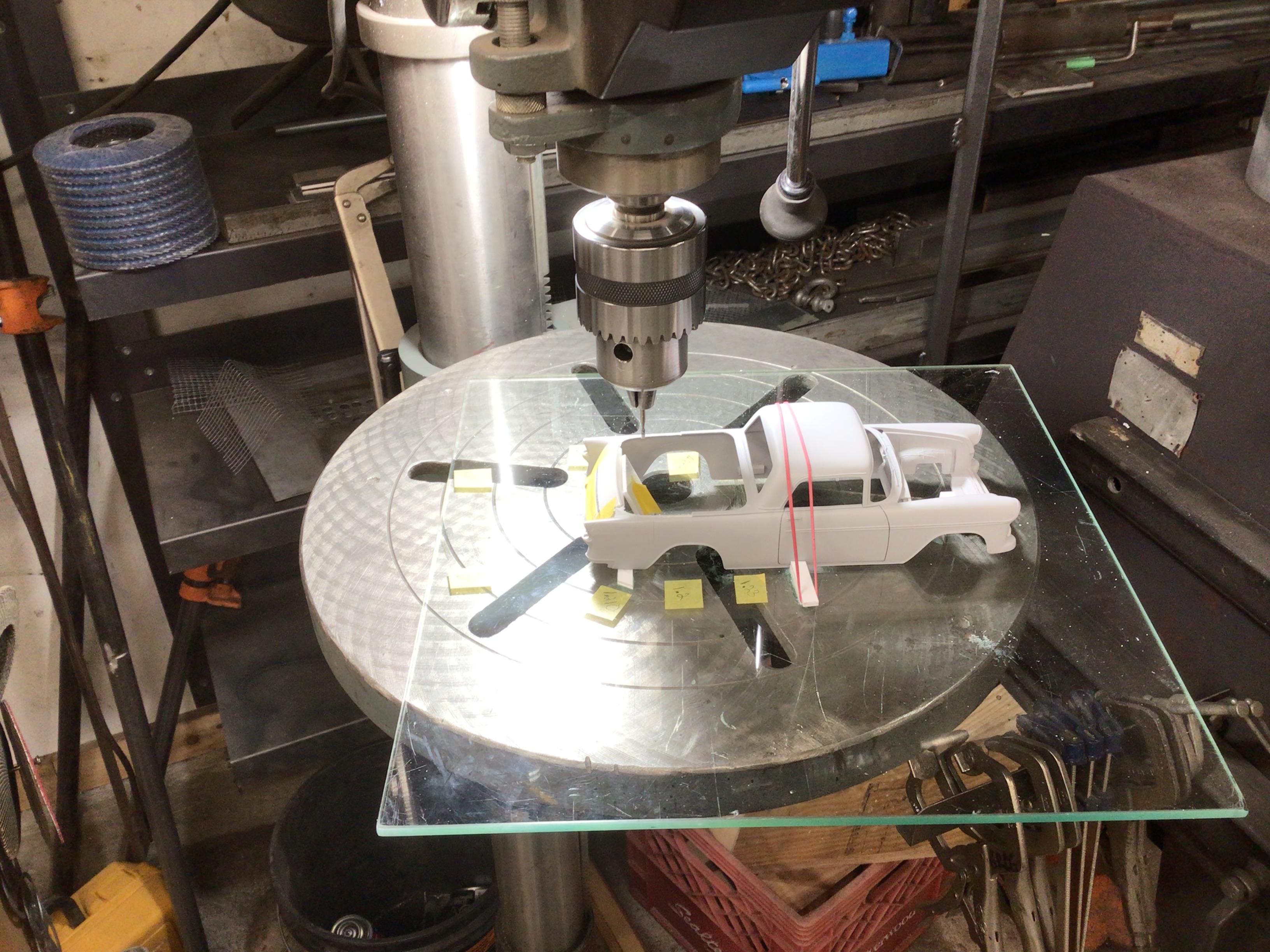

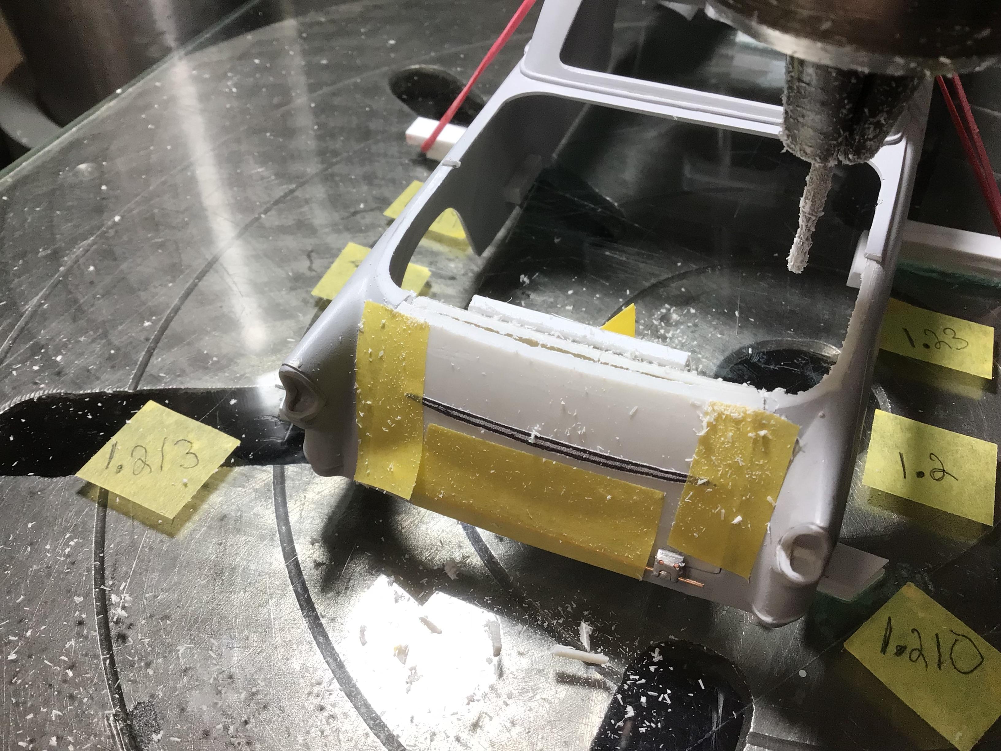

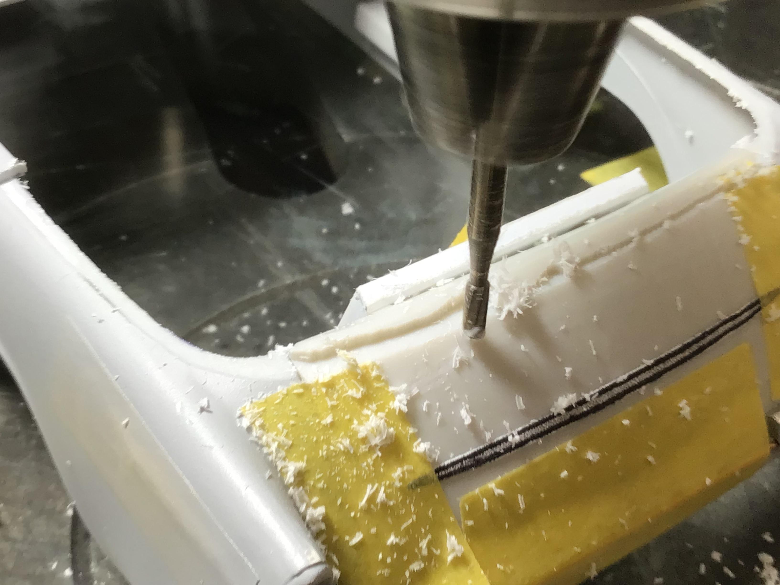

Like my tag line? says…I haven’t finished creating problems yet.😳 I noticed that the bed rails curved upwards at the rear. I set it on a piece of plate glass and took some measurements. They aren’t off by much side to side but front to back was noticeable. So I fastened it down to the glass and took it out to my drill press and milled the bed rails and tailgate level. Now I have to remake the rails from 0.040” sheet along with a tailgate cap.
Edited by NOBLNG
  • Like 3
