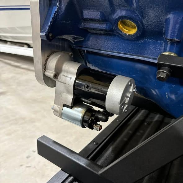

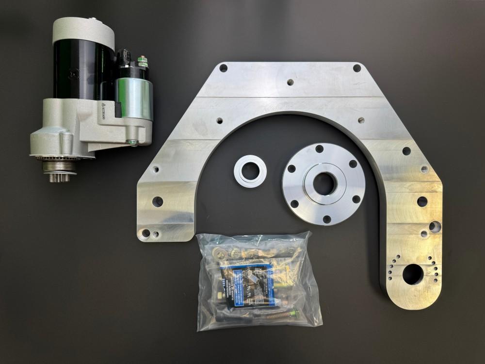

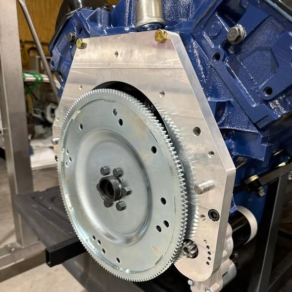

arpbob Posted yesterday at 01:26 AM Posted yesterday at 01:26 AM Lenny, A few photos that may help you out. Let me know if I can be of any help. Bob Florine ARP Inc.
LennyB Posted 11 hours ago Author Posted 11 hours ago 22 hours ago, arpbob said: Lenny, A few photos that may help you out. Let me know if I can be of any help. Bob Florine ARP Inc. Thanks Bob, lots of good shots there. That will be a big help. I could use some chassis shots if you have some.
