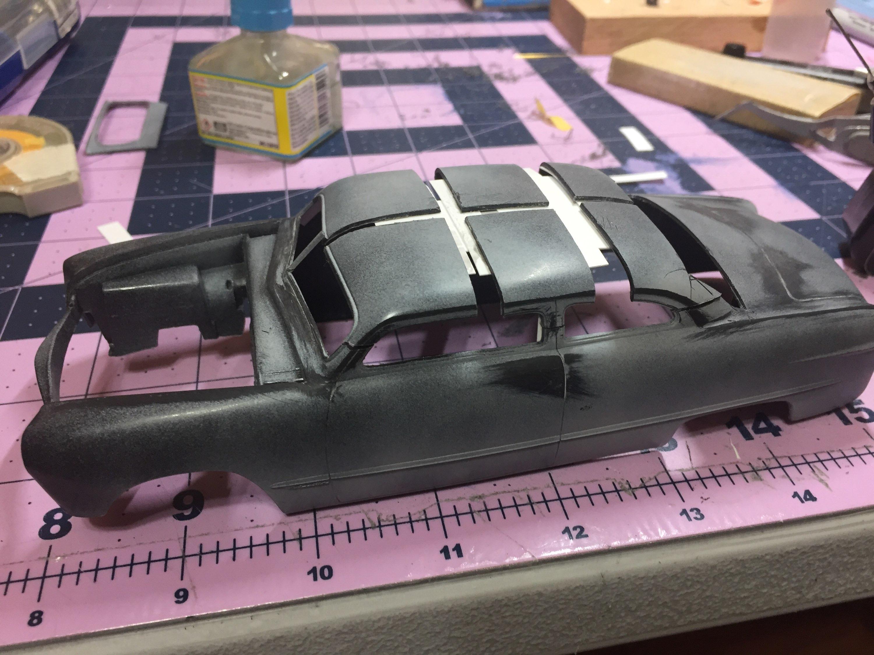

The early plan was both section and chop but after a week of mental activity the conservative won out.  Here's the victim, an eBay find ?

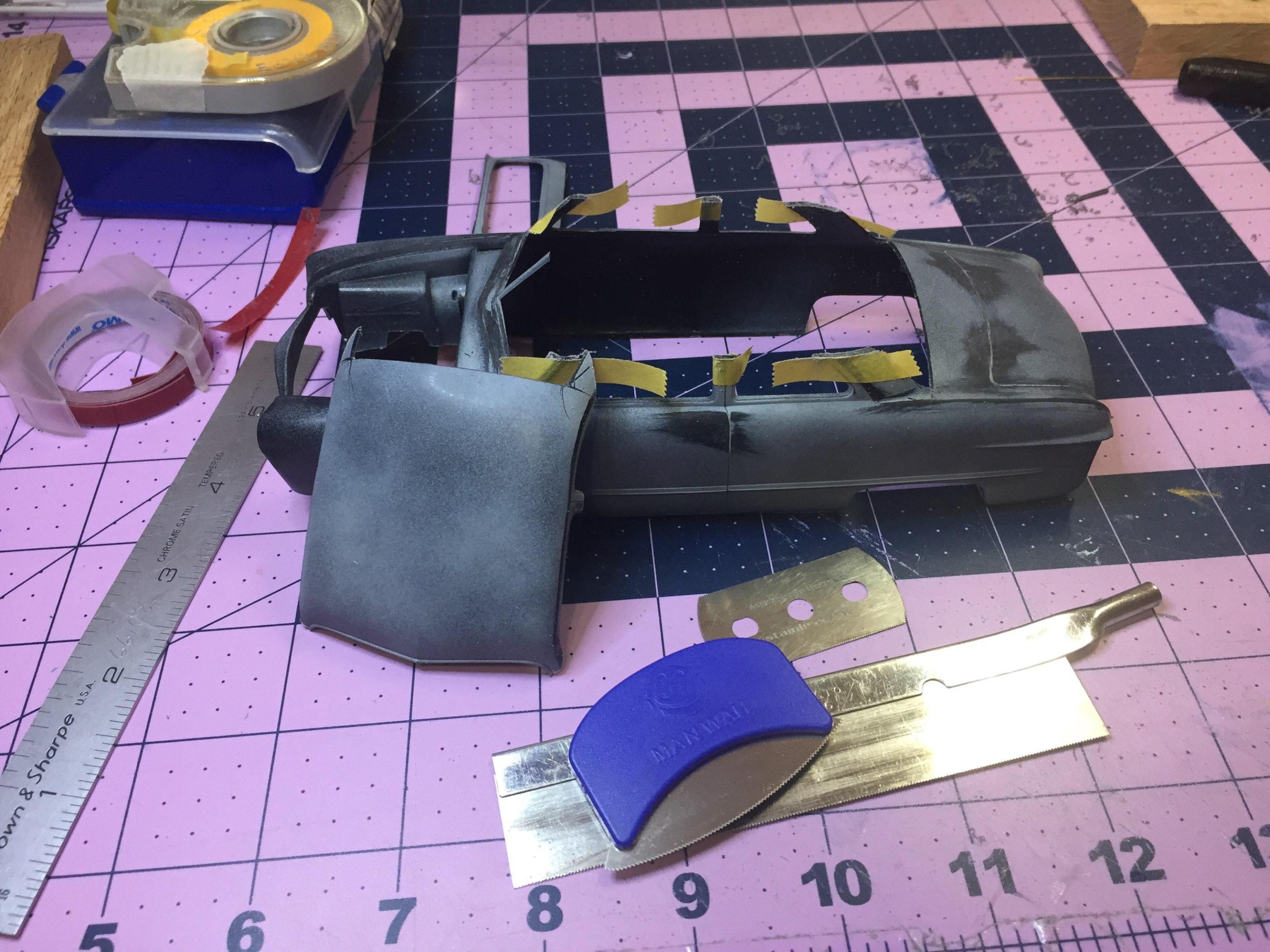

I want it understood that this is not a "how-to" because  I'm learning as I go (and this ain't like whacking a Model A.)

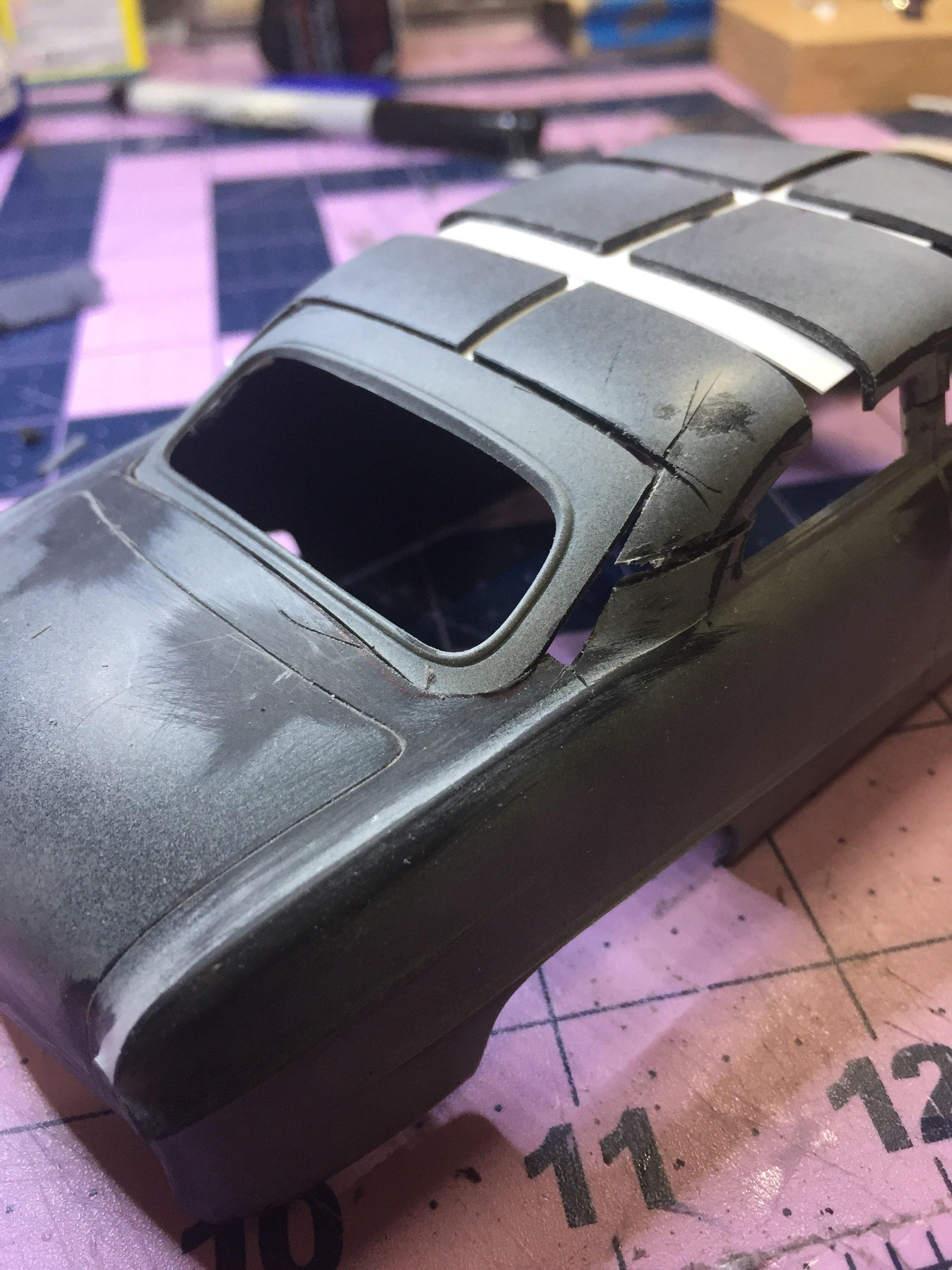

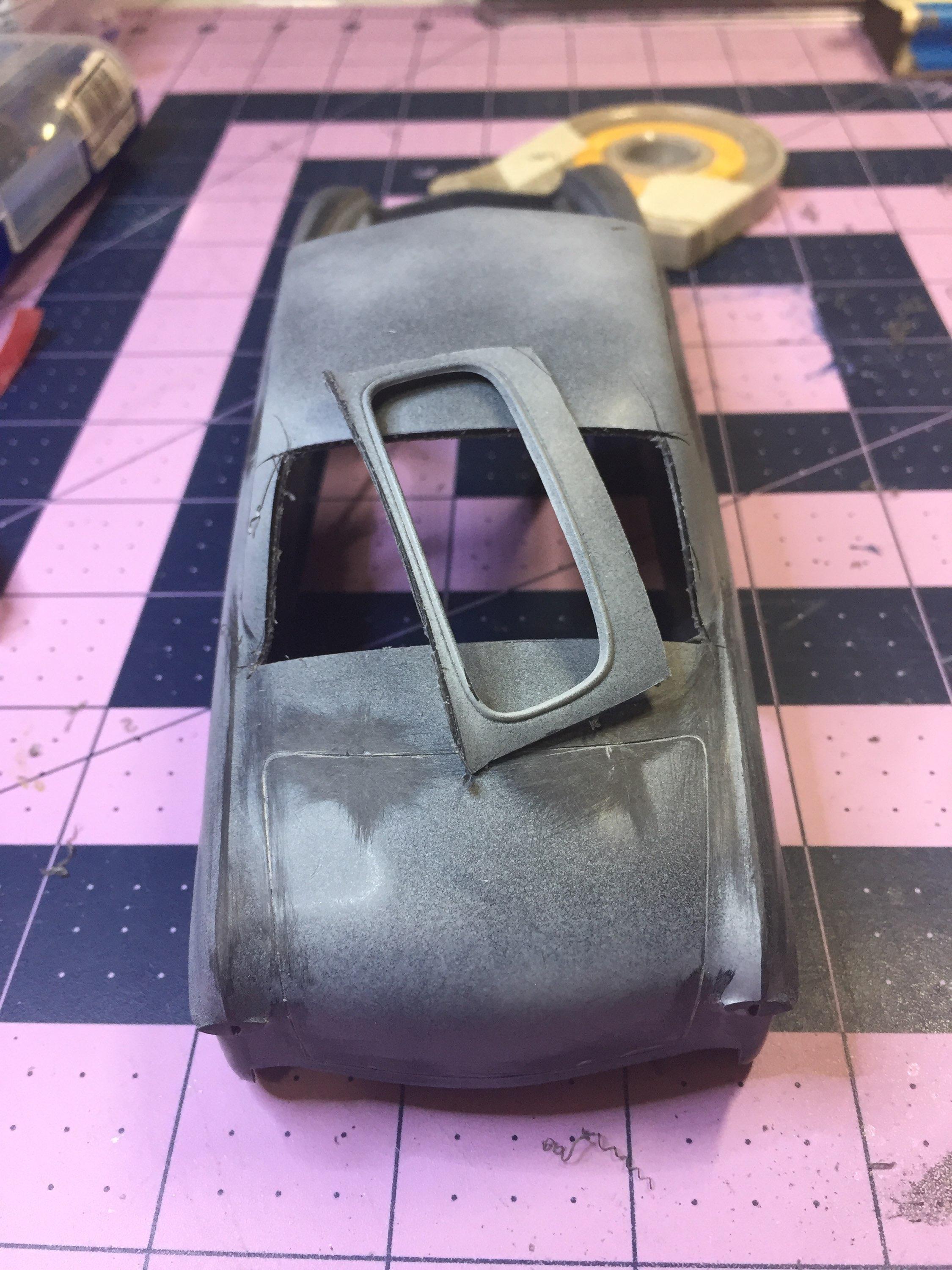

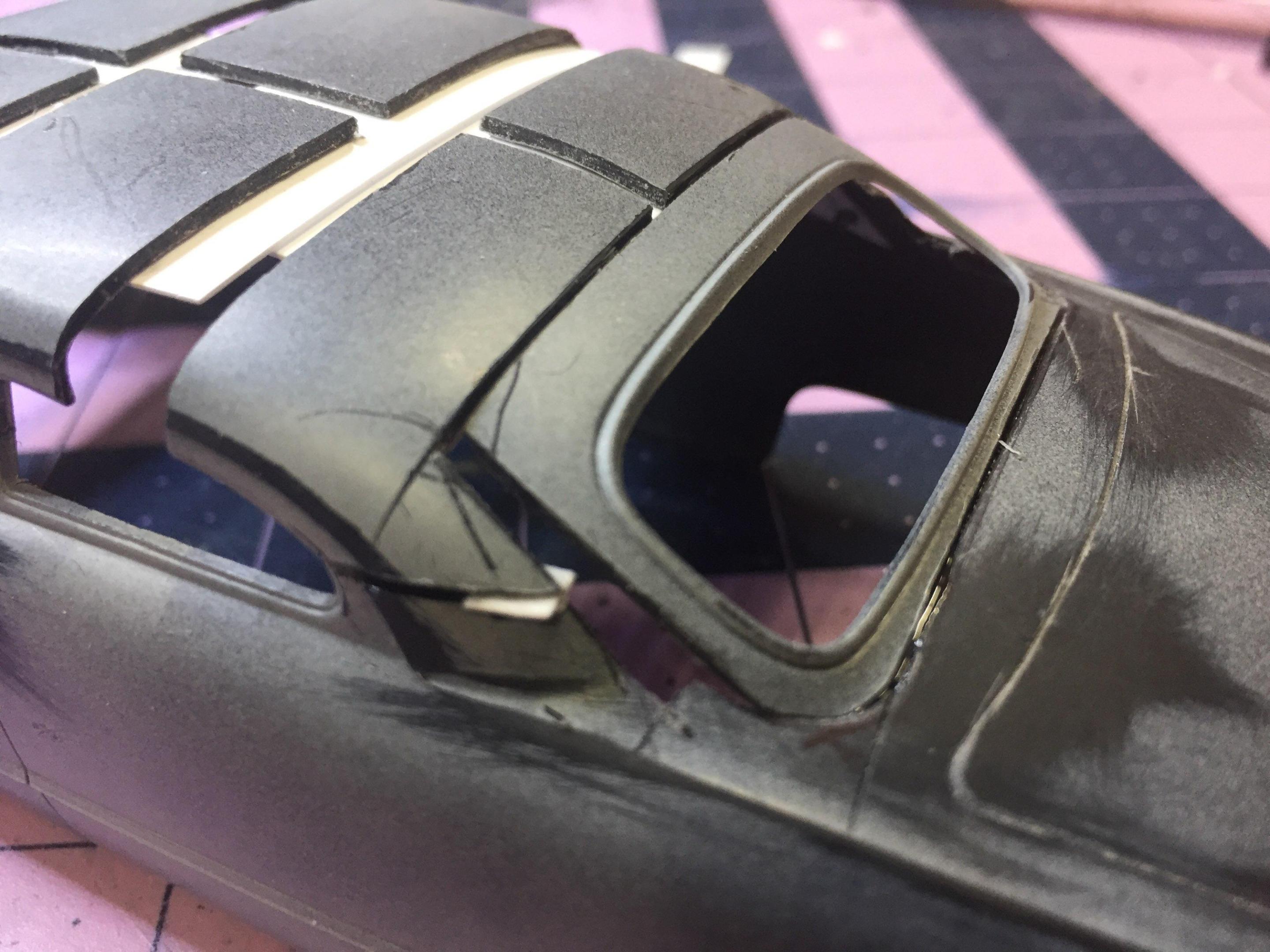

I started to put the pieces back together in their new locations. It's no surprise my cuts were not terribly accurate. I added small pieces of sheet to the inside of the pillars to make it easy to get the top pieces in place.  During this process I used the Testors liquid in the black dispenser because it allows a little "adjustment" time (but not much).  I glue a piece of .015 sheet to the inside of a roof pieces and manipulate them into place.  You can imagine how that goes but the pictures may help you decide if you want to try this.
IMG_6944(1).jpg.e6658caa22cec7199aa5a8991c136725.jpgIMG_6945(1).thumb.jpg.9e80879a4bbd748f194e3452357fc23e.jpgIMG_6946(1).thumb.jpg.3cbcd93507534f9c690c086c683fca21.jpgIMG_6949(1).thumb.jpg.be6aed2576c8534d5d5535f5ece6b892.jpgIMG_6948(1).jpg.60cf824db5f4dfa938006581d8b3ddd7.jpg
the .015 evergreen is pliable enough for bending during "adjustments" and it holds it all together. The next step is to fill in the top.  I am using the top from the '53 Ford for those filler pieces.  The package shelf will need to be extended and the the glass will need to be created and mountings put in place. All of that later.  Thanks for looking in and feel free to say I'm nuts. ☺️
