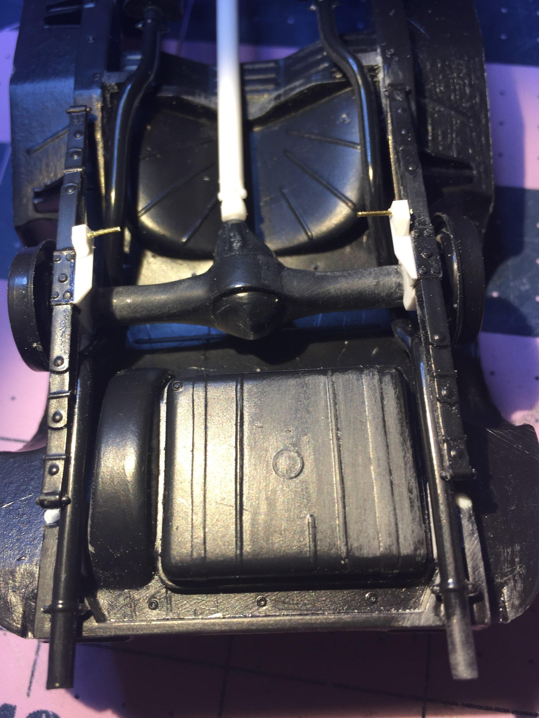

customline Posted November 24, 2024 Author Posted November 24, 2024 (edited) 1 hour ago, espo said: On the drive shaft tunnel. Just cut along the length of the tunnel on the floor side and add a strip of styrene maybe. I have seen others here cut the body of a ball point pen in half and use that. I know you'll figure it out.Ā Ā Turns out I didn't need to. I shaved off the "mount" from the tyranny tail shaft and reduced the thickness of the cross member. That gave me a proper angle on the shaft. Problem is solved.Ā Ā Edited November 24, 2024 by customline 1

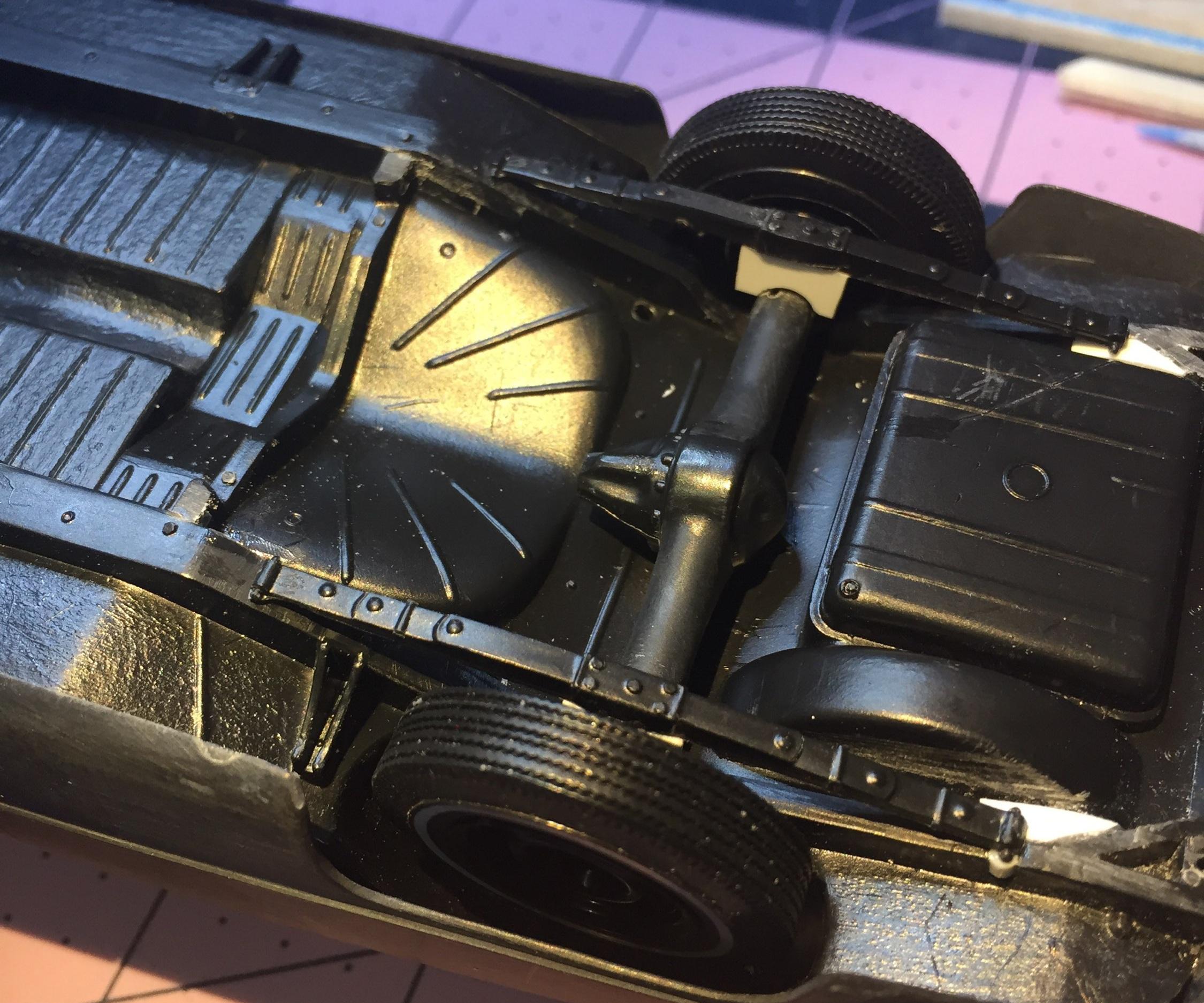

customline Posted November 24, 2024 Author Posted November 24, 2024 Today I was searching for I can't recall what when I ran across this set of porta-walls. Just what I needed.Ā Spent the rest of the afternoon scraping plating. No need to paint the rims since the kit was molded in color š. I added shock mounts to the narrowed rear axle.Ā I would have done this even if I had not lowered it, due to way the kit was designed. It's as low as I can get it without going hydraulic. I may need a shim or two in the rear to level it. Skirts are on the table but flush ones, not the crappy kit skirts. And the kit engine will be used with a liberal application of Marine-Tex to seal up the leaky block ( ever have to do that? š„“) I just love this kit. 3

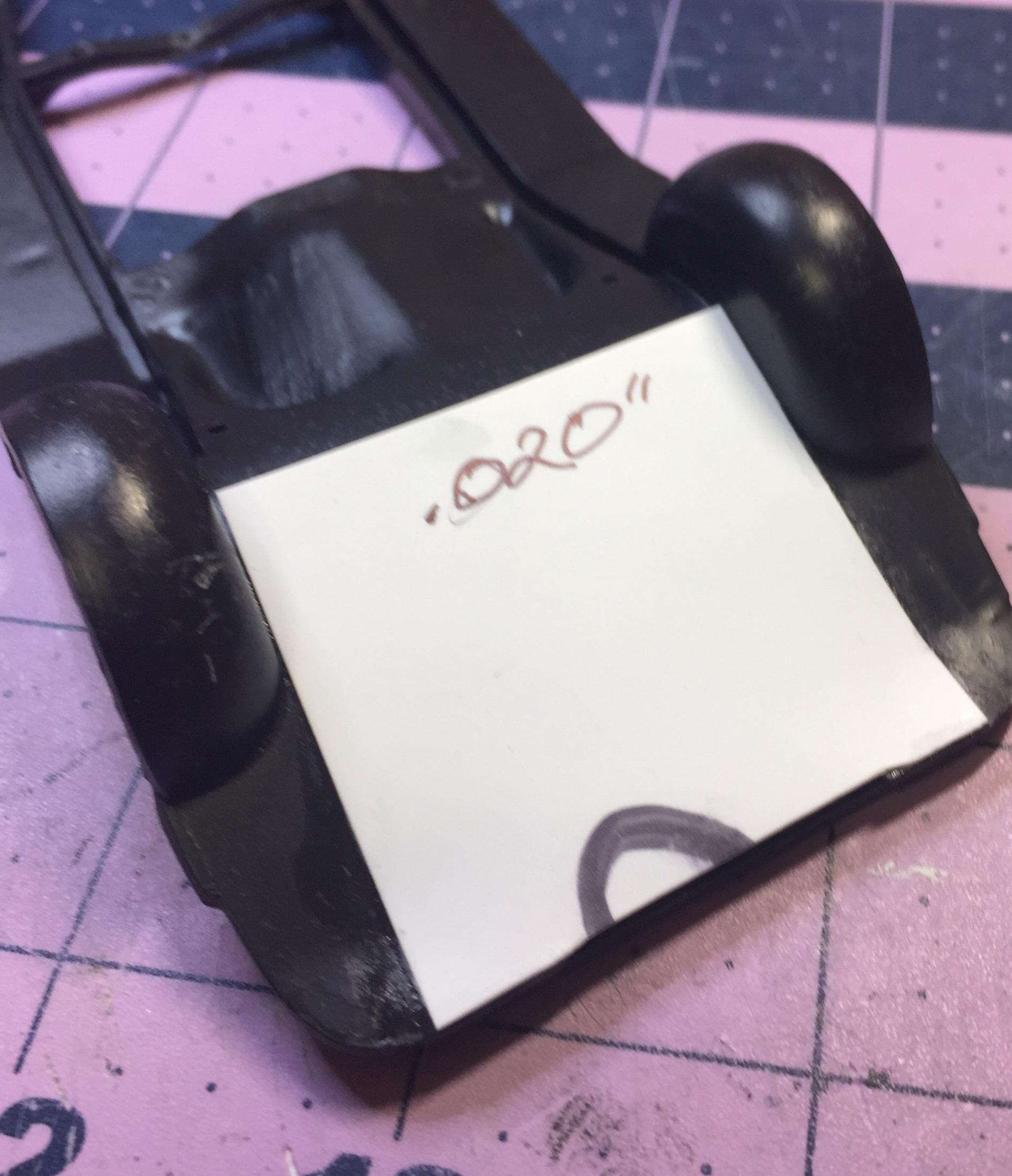

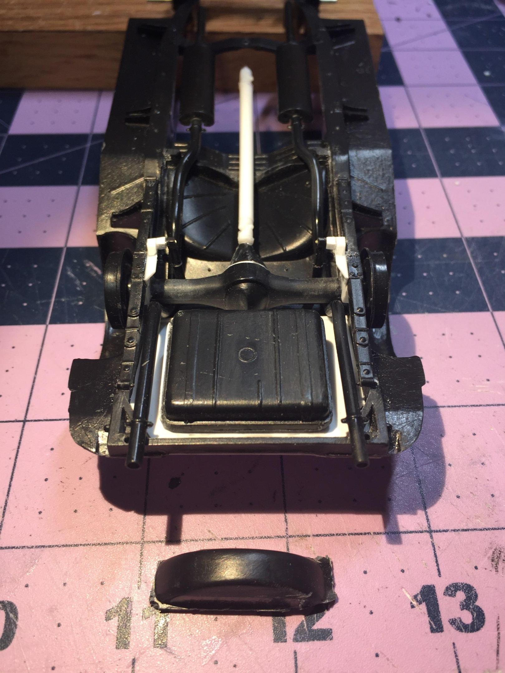

customline Posted November 30, 2024 Author Posted November 30, 2024 (edited) You may recall that I narrowed the rear axle housing in order to get the car lower. No?...well I did, and it caused some problems. This kit came with a non-ford engine that is set up with dual exhaust and tri-power. Not great but cool enough for my taste. I decided to run with it.Ā Although most of the kit is marginal, I wanted to use as much of it as possible, and that includes the exhaust system. I discovered the tail pipes and the re-positioned springs and all that stuff wouldn't play well together. I let that little issue take root in my fertile(š©) gray matter and after a week it finally bloomed. This was the problem š lp Too crowded. Nothing lining up right. š¤ .....and then....one week later...š an easy solution! Who needs a spare tire? I have AAA!Ā Oh...I guess I still need a spare tire...but not the well. After removing the gas tank, spare well, and trunk floor, I glued a piece of .020 sheet to the top-side to catch the actual floor and fashioned a floor with .030 to mate with the existing floor and hid the seam with some half-round. I patched the tank where the well was sawed off of it and glued it to the new floor. Yay! š¤.Ā I still had an alignment issue with the drive shaft so I modified the housing at the "pumpkin" to get the shaft centered. I added spacers to my shock mounts, too. The shocks will be re-located inboard of the tail pipes rather than the original mounting holes adjacent to the frame rails. That's it, thanks for sticking around! I still need to detail the spring mountings but it will just be totally uninteresting. Ā Edited December 1, 2024 by customline 3
