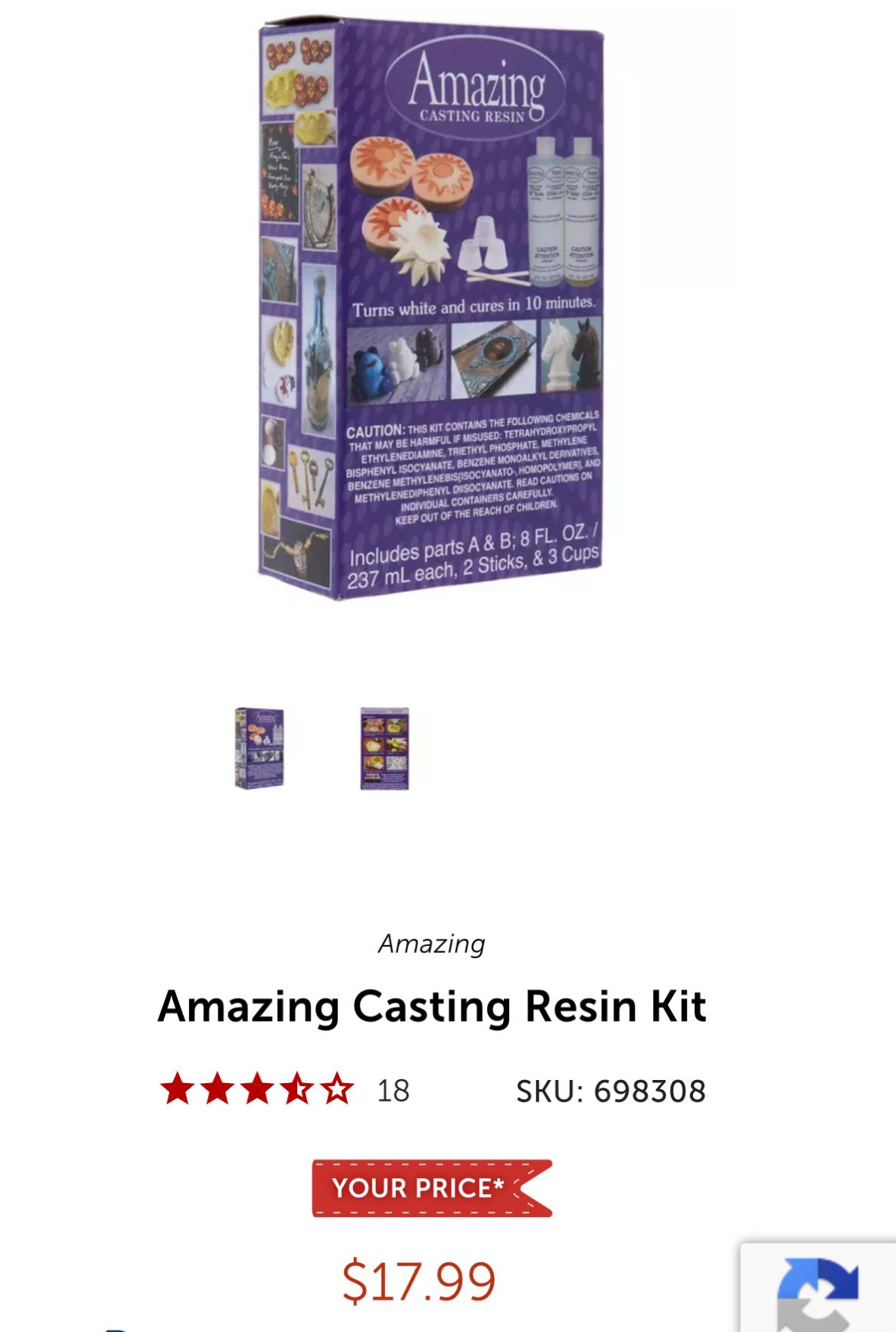

OldNYJim Posted January 29 Posted January 29 @oldcarfan, which product were you using - was it this one? Not at ALL helpful for your question, but I was curious how well you liked it…I was planning on doing some more casting here soon and didn’t really Hobby Lobby actually carried this…
oldcarfan Posted January 30 Author Posted January 30 19 hours ago, CabDriver said: @oldcarfan, which product were you using - was it this one? Not at ALL helpful for your question, but I was curious how well you liked it…I was planning on doing some more casting here soon and didn’t really Hobby Lobby actually carried this… That's the one!
OldNYJim Posted January 30 Posted January 30 4 hours ago, oldcarfan said: That's the one! Thank you!  Picked some up this evening…didn’t realize they sold this

Casey Posted January 30 Posted January 30 Just FYI, the Alumilite Casting Resin is a very poor choice for beginners. It leaves you very little time for proper mixing and sets very quickly-- both not ideal when you are still trying to get the hang of it. Get something with a longer pot life and slower cure time. Buy yourself an accurate scale which reads in grams, a good plastic measuring cup or two with a pour spout, and toss out anything porous you might use to mix the two parts together-- the less air you introduce the better. If you are meticulous and have great close-up vision, you should be able to make small parts without deep undercuts in one-part molds without a vacuum de-gassing your mold rubber first. It works, but you will likely quickly see the benefits or properly de-gassed mold rubber, as well as the benefits of using a pressure chamber when casting the parts. 1
oldcarfan Posted January 30 Author Posted January 30 On 1/28/2025 at 10:47 PM, CabDriver said: @oldcarfan, which product were you using - was it this one? Not at ALL helpful for your question, but I was curious how well you liked it…I was planning on doing some more casting here soon and didn’t really Hobby Lobby actually carried this… I like it, it comes in just the right amounts for the castings I do and the price seems decent. I've used it before and never had an problems.
OldNYJim Posted January 31 Posted January 31 11 hours ago, Casey said: Just FYI, the Alumilite Casting Resin is a very poor choice for beginners. It leaves you very little time for proper mixing and sets very quickly-- both not ideal when you are still trying to get the hang of it. Get something with a longer pot life and slower cure time. Buy yourself an accurate scale which reads in grams, a good plastic measuring cup or two with a pour spout, and toss out anything porous you might use to mix the two parts together-- the less air you introduce the better. If you are meticulous and have great close-up vision, you should be able to make small parts without deep undercuts in one-part molds without a vacuum de-gassing your mold rubber first. It works, but you will likely quickly see the benefits or properly de-gassed mold rubber, as well as the benefits of using a pressure chamber when casting the parts. Good tips, thank you!  I’ve done a decent amount of casting, but I’ve never got as far as investing in a pressure pot…
