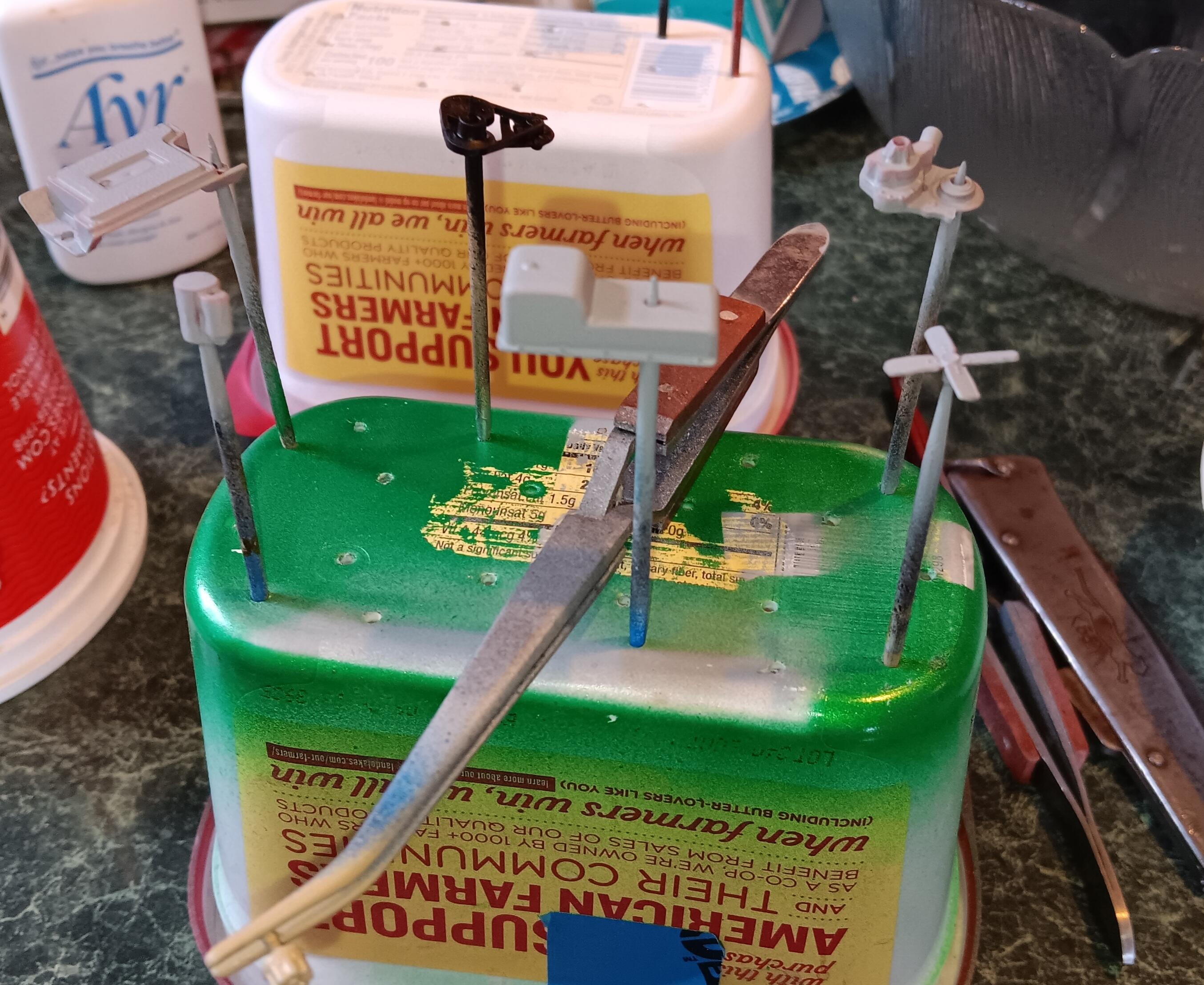

bobss396 Posted February 8 Posted February 8 I like using old butter tubs and similar plastic containers. Usually I impale a part on a toothpick. Sometimes I add small holes where they will not be seen later. I also glue short pieces of tubing to the inside of parts and break it off later. On the tubs, save the lids. I tape something heavy, like small stones, to the inside of the lid so the wind doesn't blow it over outside. 1
