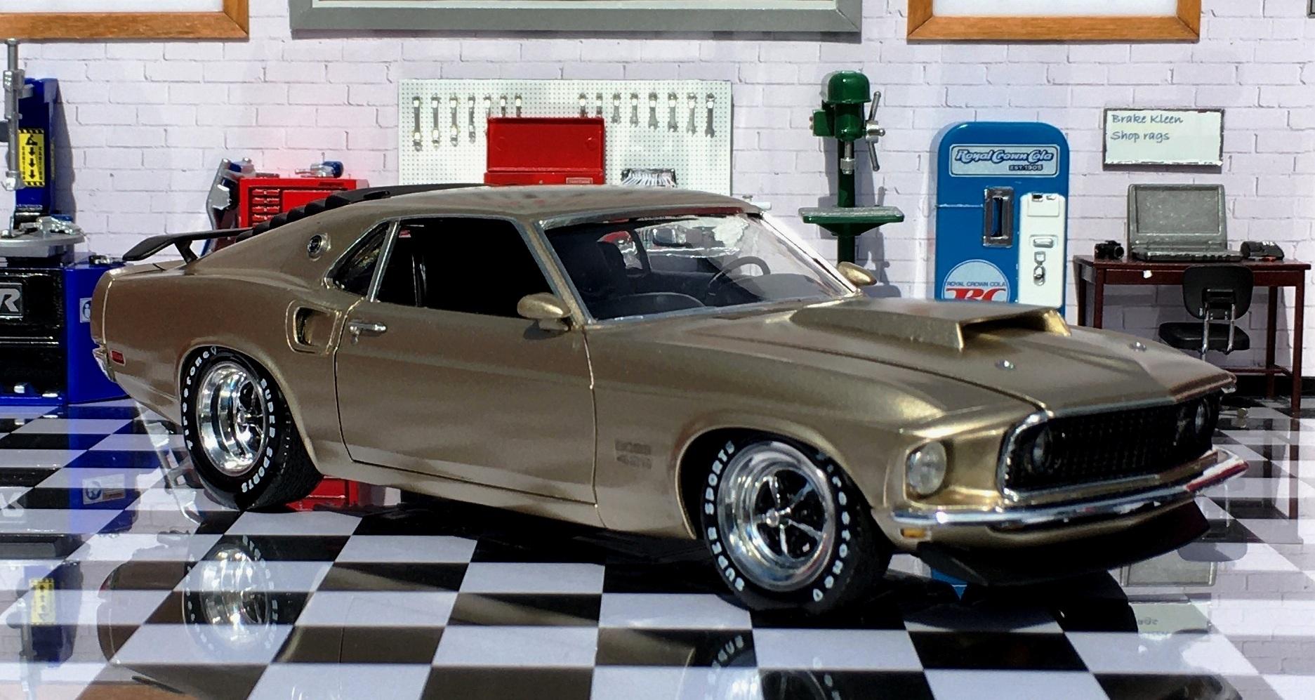

Bills72sj Posted March 21 Posted March 21 Other than the "Sad eyes" of the outer headlights. That Amigo kit can turn out pretty nice. I converted mine to a 69 Boss 429. 3
SpeedAndViolence Posted March 21 Author Posted March 21 @Bills72sj You absolutely did a gorgeous job on that. Very nice!! 😎 Did you alter the ride height at all? I really like the stance...

Bills72sj Posted March 22 Posted March 22 23 hours ago, SpeedAndViolence said: @Bills72sj You absolutely did a gorgeous job on that. Very nice!! 😎 Did you alter the ride height at all? I really like the stance... Thanks. I long ago I determined that stance is WAY more important than wheels that actually ROLL. So I tend to build suspensions stock in relation to the chassis. I then painstakingly glue the tires to whatever is available. I do so in exactly the position I want them to be located in the wheelwells. Do I get misalignment from the ends of the suspension? Sure, but I do not have anyone in my life flipping my models upside-down to give me any grief over it. 2
