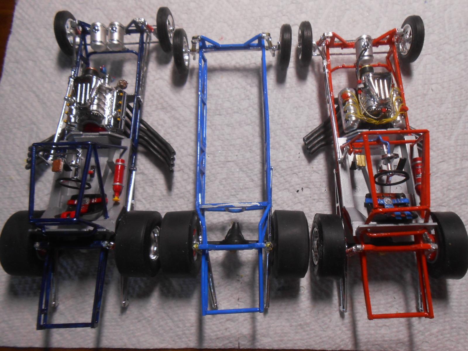

Thanks again guys.  These are among my favorite.  I am currently working on the Jess Tyree '69.  This is a hard one as the paint scheme is extremely difficult to do without an airbrush.
This pic is the Tyree frame (center) after modifications.  Left one is standard Polar Lights chassis from a Cuda (slightly longer).  Right one is from the Brutus Firebird, which I used the Cougar kit tires to fit the smaller Bird body.  I modified the rear frame, wheelie bars and rearend to take the larger slicks for the Tyree car.
As you build, you learn.
