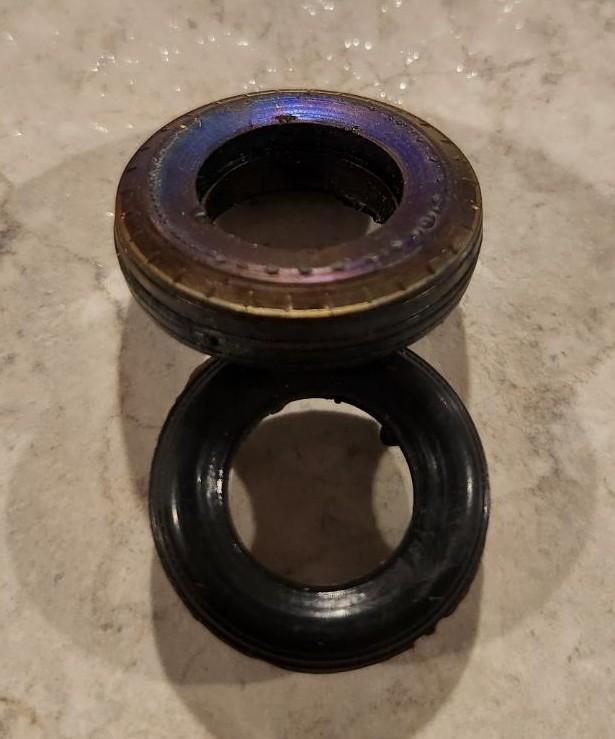

Carmak Posted Monday at 08:09 PM Posted Monday at 08:09 PM This is a 60's vintage tire (the top one) that has leached plasticizer to the surface. It kinda looks like oil on water (the purple shimmer).
