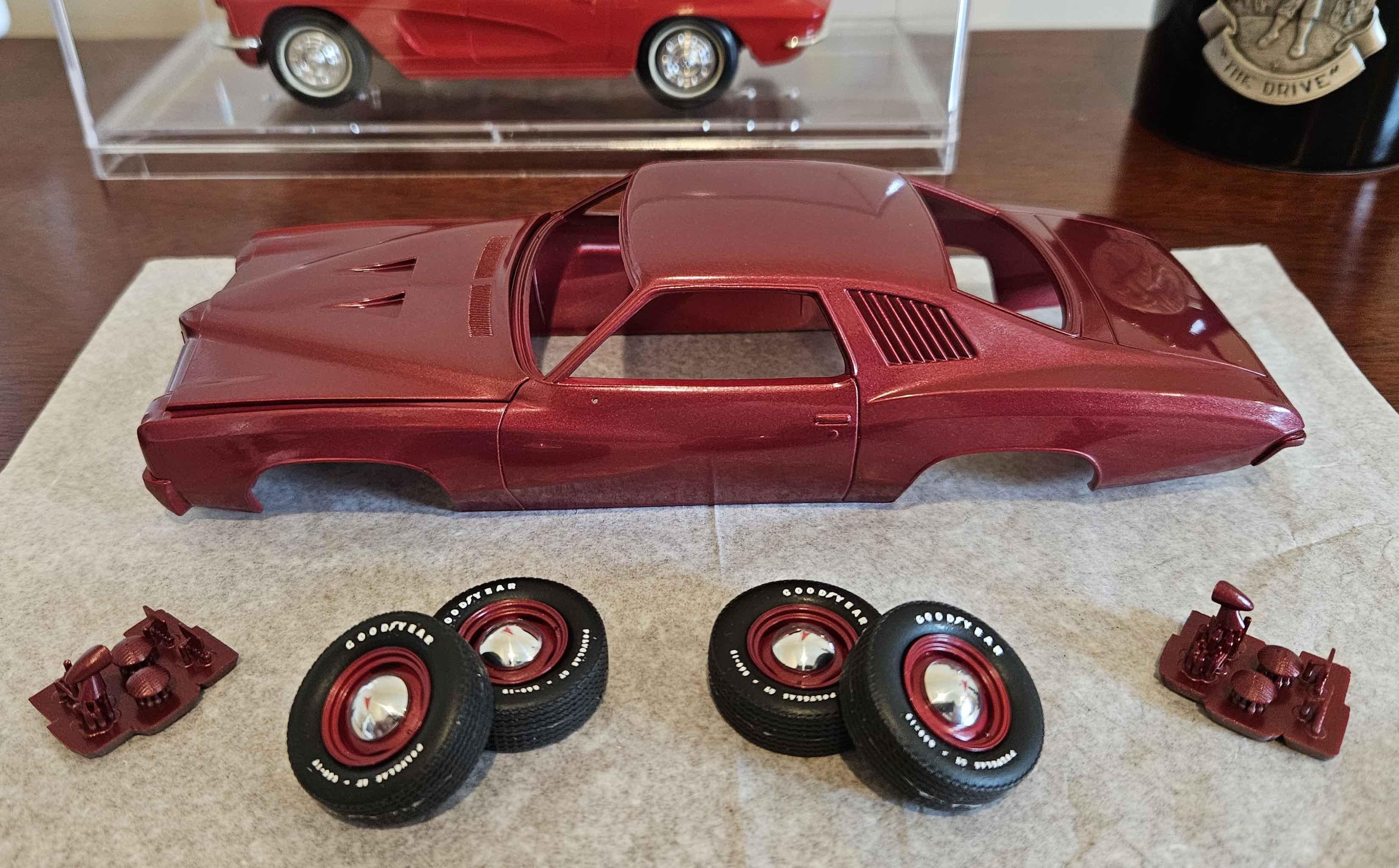

johnwitzke Posted July 6 Author Posted July 6 So here is an update. Final color coat on the car. I will let this set for a couple of weeks to allow it to gas out. Then it will be hand polished to replicate a factory finish. I used Scale Finishes 1973 Pontiac Florentine Red. 9

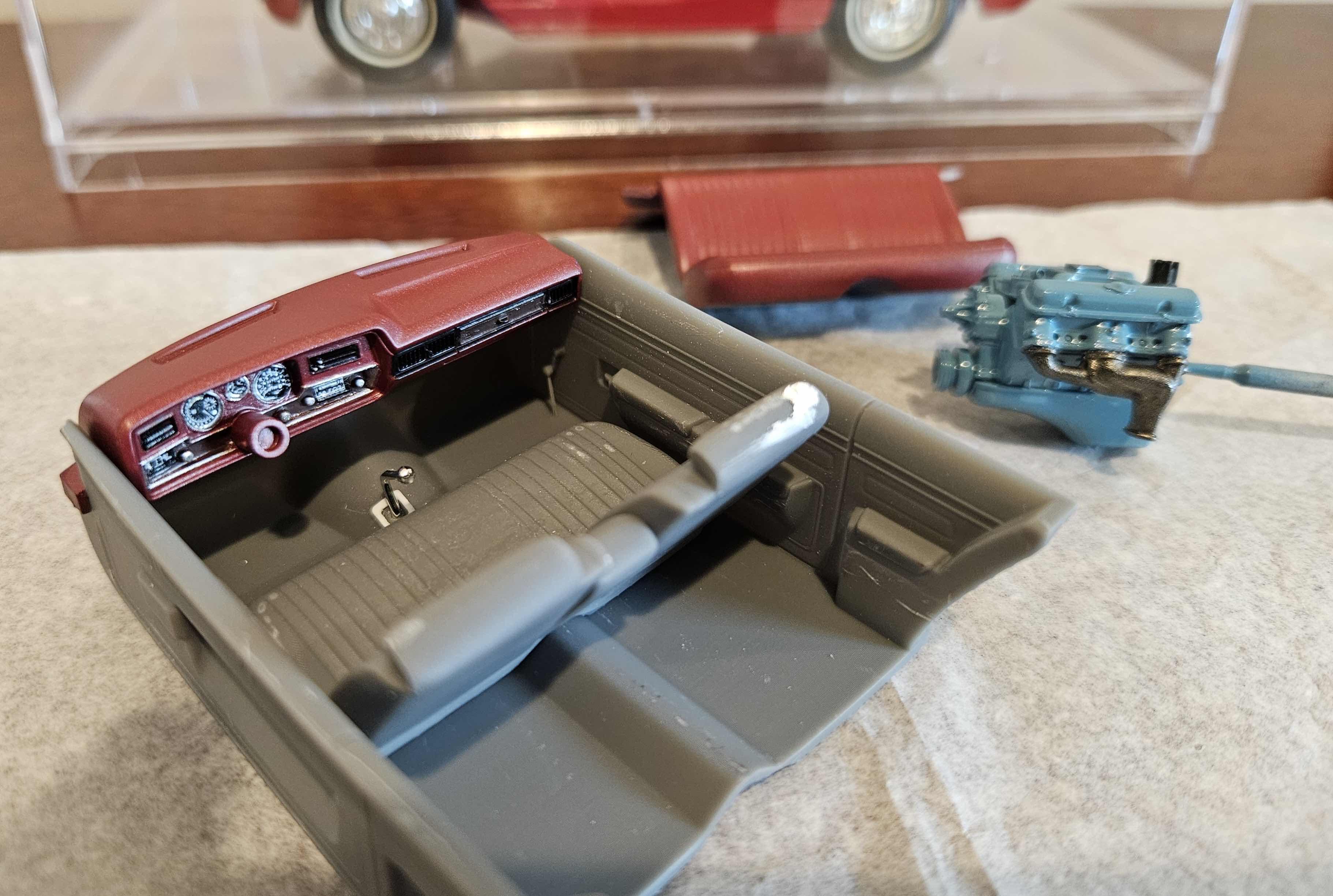

johnwitzke Posted July 6 Author Posted July 6 Interior color was changed to Black with red accent carpeting. This was a factory option. Paint used was MCW semi gloss black lacquer. 7
rickcaps55 Posted July 7 Posted July 7 WOW that color came out beautiful. The interior has a great finish with the black you used this is going to look great i just got a mail notice mine should be here by Friday. I am still not sure of what color to use yet.
DoctorLarry Posted July 7 Posted July 7 Mine is going to be Golden Olive with a Dark Saddle interior. I have a 73 Grand Am 4 door that is Florentine Red. Great color choice! 1

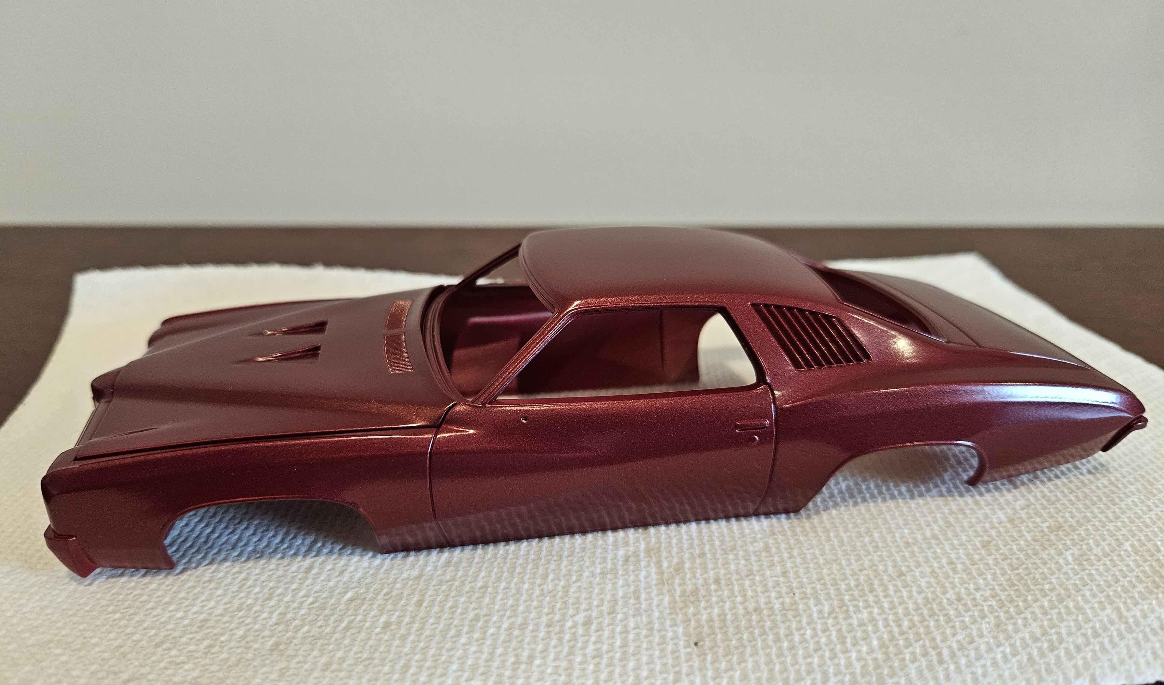

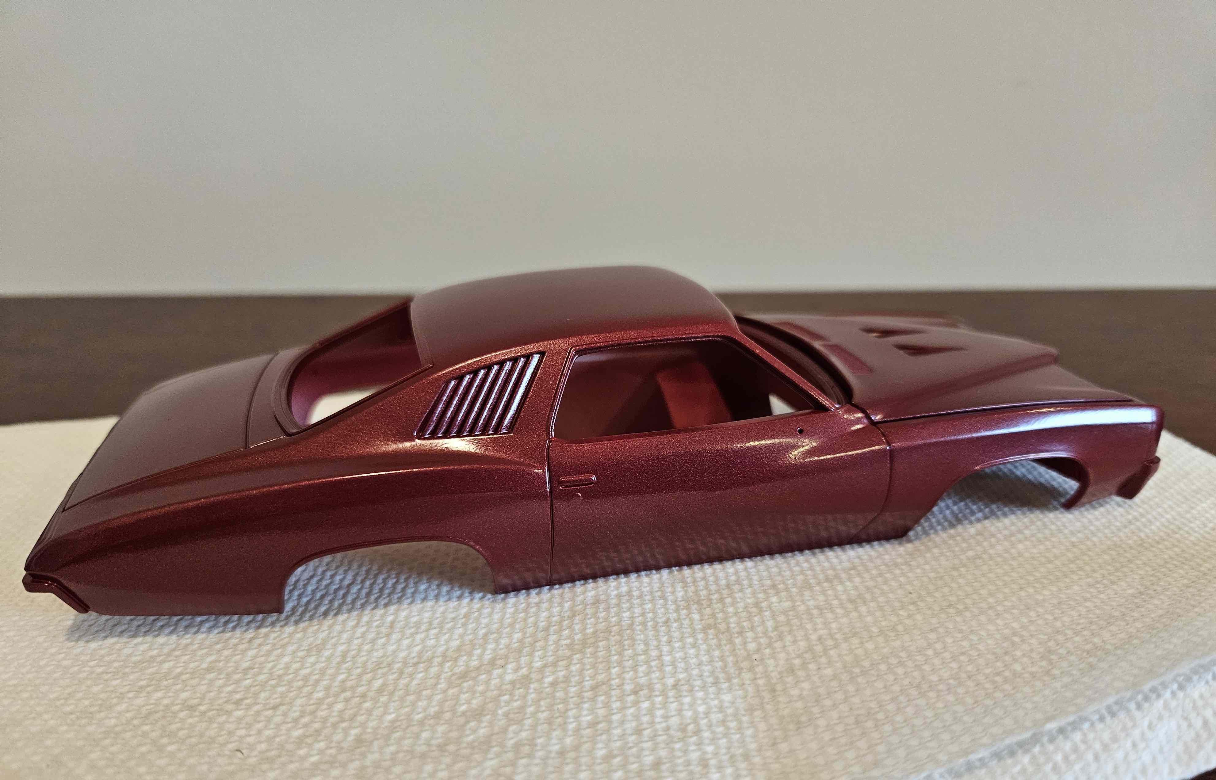

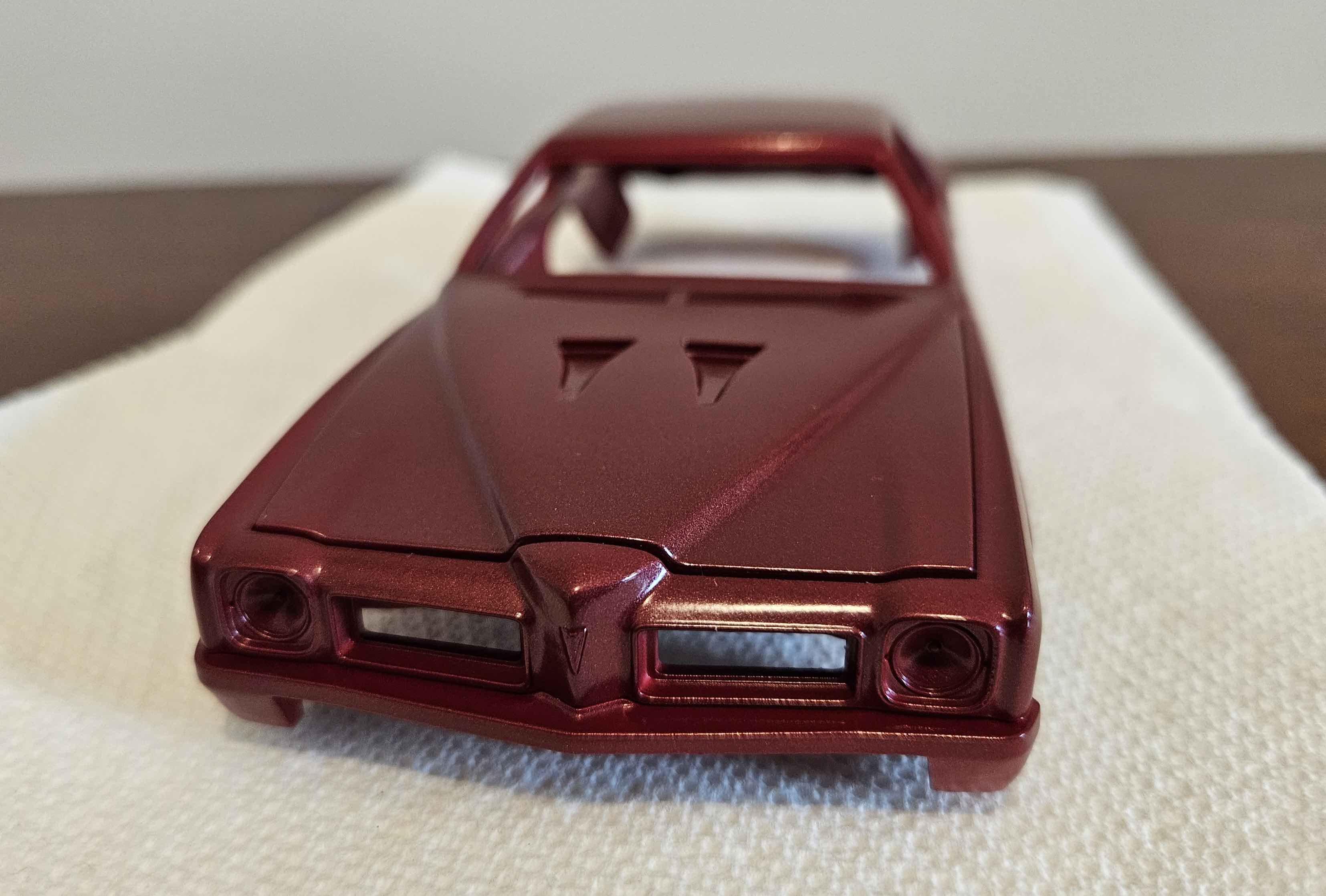

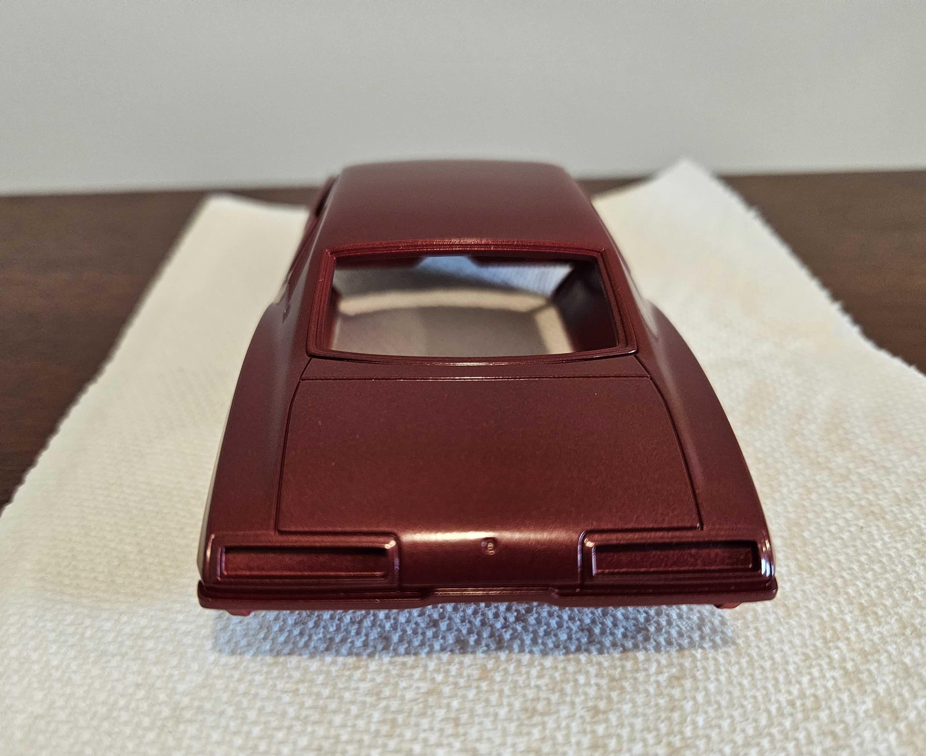

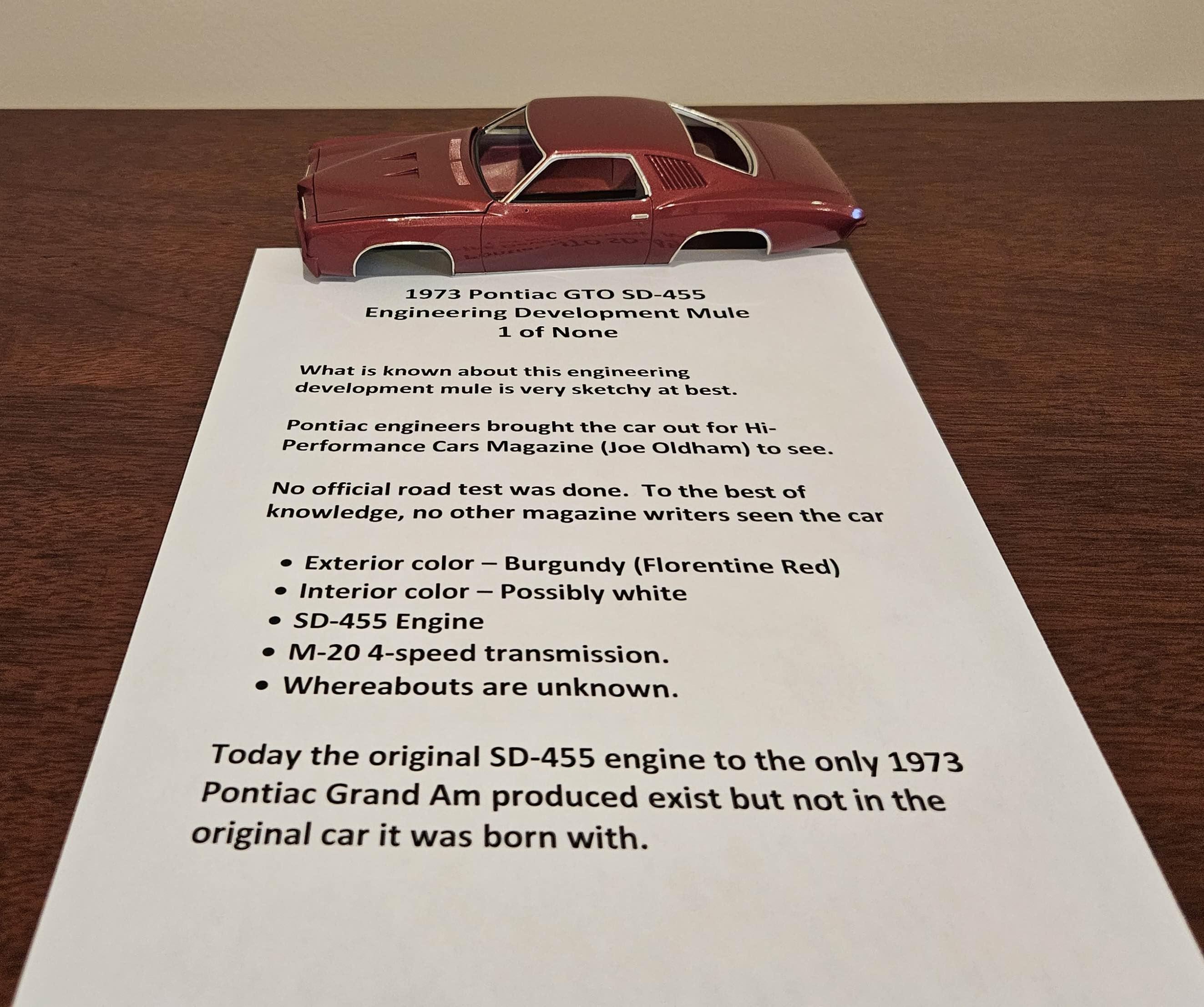

johnwitzke Posted July 12 Author Posted July 12 Polished Florentine Red. No clear coat. Trying to replicate a factor finish. Next will be the masking off the engine compartment, front wheel wells and interior roof and side panels for semi gloss black paint. Work continues on the interior detailing, it will be time for the cardinal red carpet. I will post a photo of the completed interior later. 11

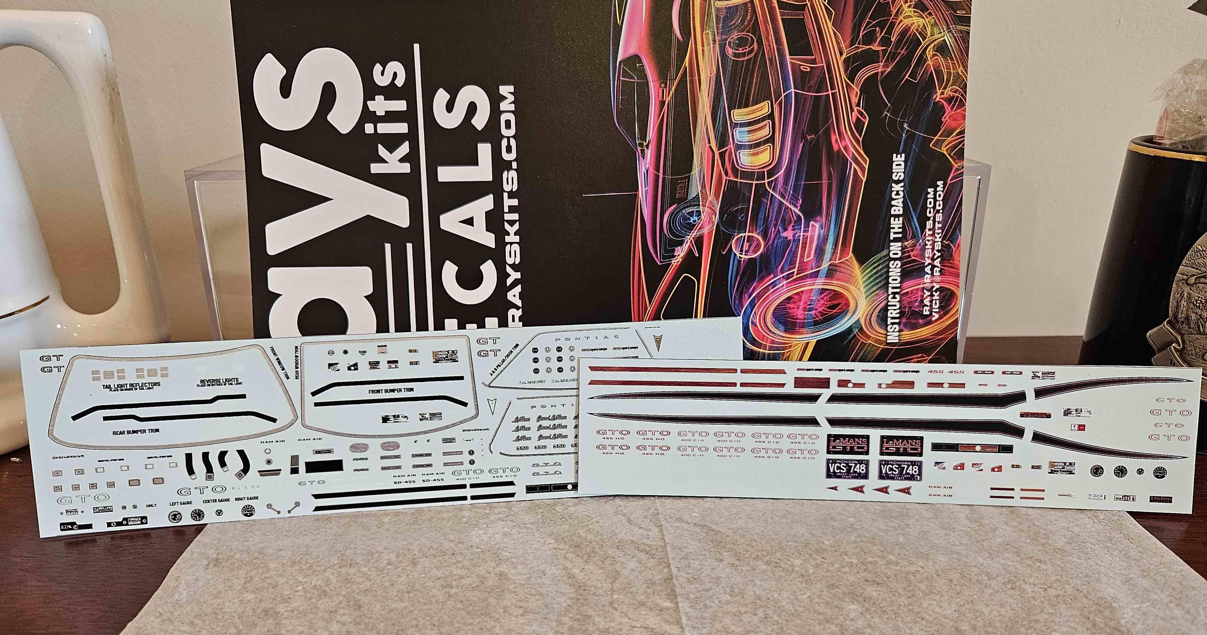

johnwitzke Posted July 12 Author Posted July 12 Decals have arrived. GTO on the fenders and trunk lid will be white. the body stripe will be applied. There are various interior and under hood decals that I will use. 8

johnwitzke Posted July 22 Author Posted July 22 So I have been doing some additional research and have found out some interesting facts about the Hi-Performance Cars Magazine 1973 Car of the Year GTO. A good friend of mine that knew Joe Oldham confirmed that the 1973 Pontiac GTO with a SD-455 motor was in fact Florentine Red. It was also thought to have been a 4-speed car. The GTO was an engineering development test mule. This was a 1 of none car as the SD-455 motor was only available in the 1973-74 Firebird Trans Am and Formulas. Like the SD GTO, Pontiac also built one 1973 Grand Am with the SD-455 engine and was also an engineering development test mule. It was a white car with burgundy interior with an automatic transmission. Unfortunately the car doesn't exist anymore but the engine does. After the press review was completed and the journalist left, Joe was asked to stick around while Pontiac brought out the SD-455 GTO for him to view. Other than Joe Oldham, no other car journalist seen it, nor do any photos exist. While not 100% sure of the interior color, we do know it exterior was Florentine Red. So with that said, I have decided to make the 1 of none 1973 SD-455 GTO. I had another interior tub made along with a bench front seat. it will have a burgundy interior. I will put a correct style 4-speed shifter add the proper number of pedals and transmission. 7

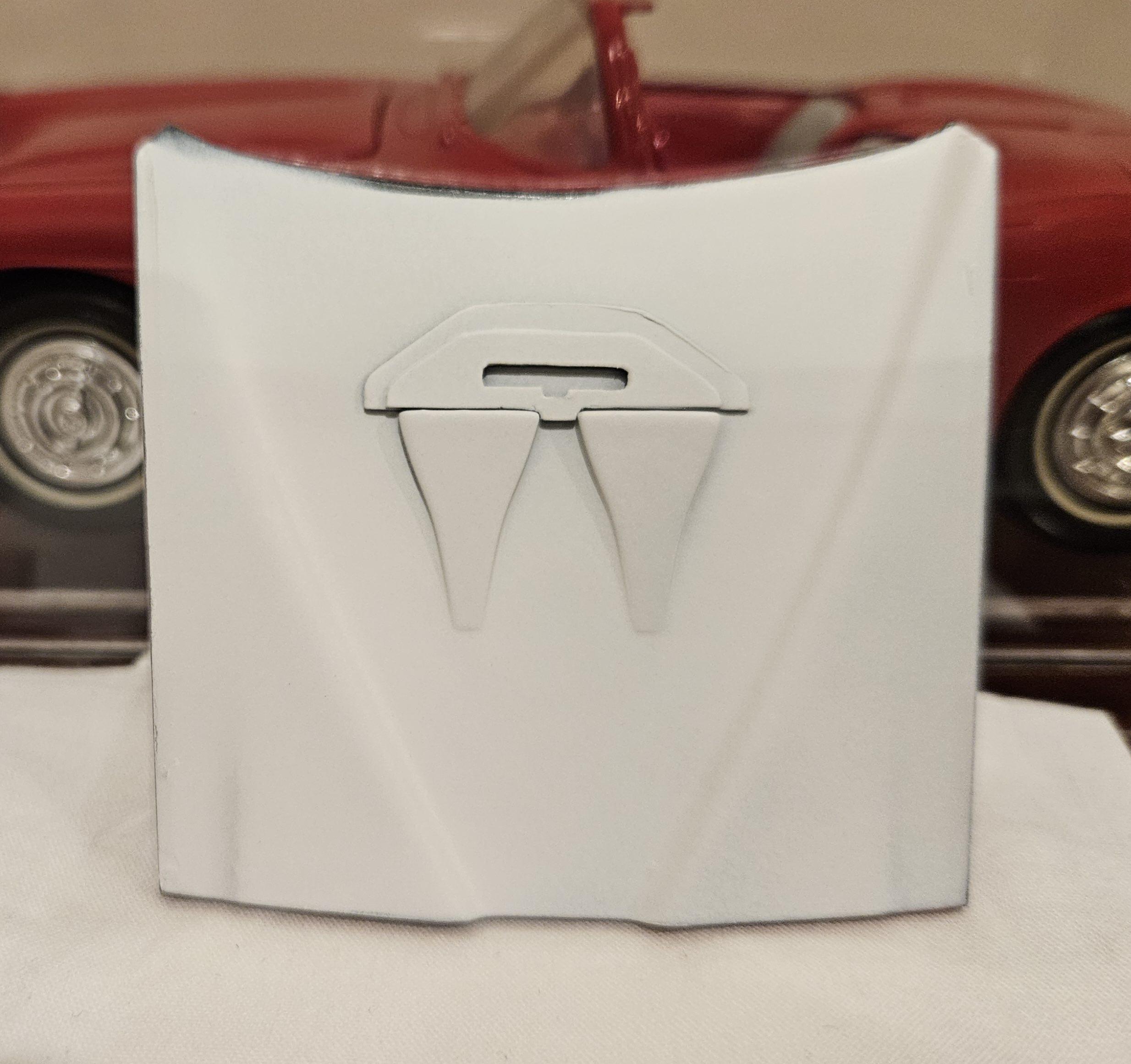

johnwitzke Posted July 27 Author Posted July 27 Added the unique 1973 Ram Air under-hood ram air pan. I am in the process of fabricating the air cleaner lid as well 5

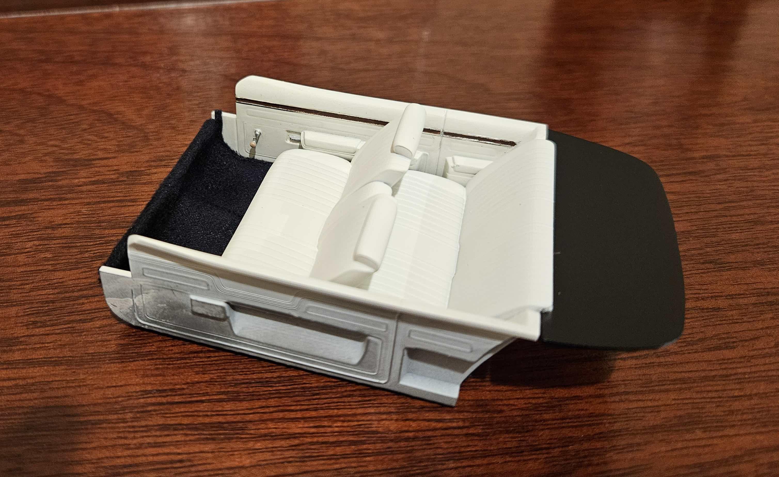

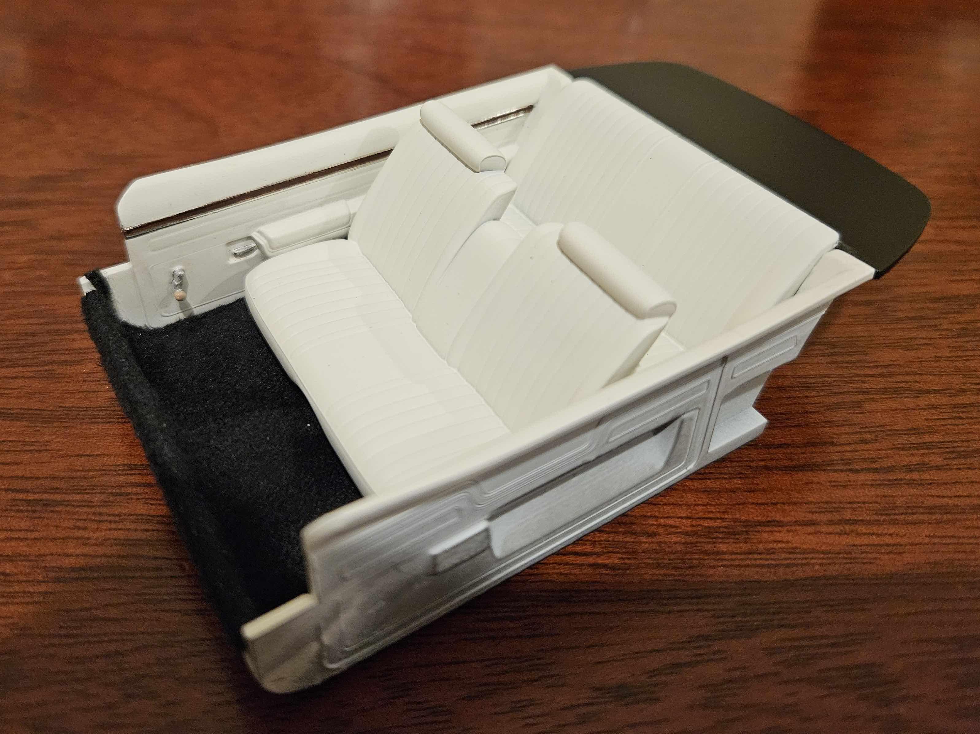

johnwitzke Posted August 10 Author Posted August 10 (edited) Beginning work on the interior. This will be a 4-speed car with the shifter in front of the bench seat. I found an adhesive back suede material from Scale Motorsports that I used for the carpeting rather than embossing powder Edited August 10 by johnwitzke 3
