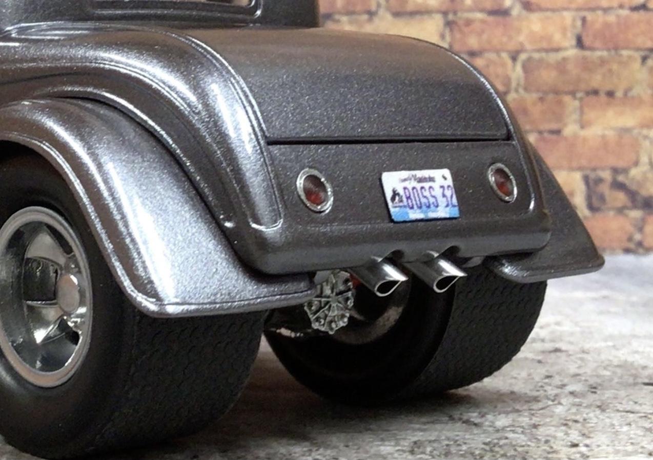

Nice work so far Jim!👍 I made some exhaust tips out of aluminum tube using a round chainsaw file. Is this kinda what you’re looking for?
Those look great!  Nice work!  Yeah, that kind of look!  Thanks for sharing!
