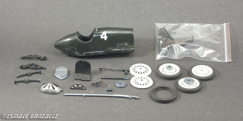

Hello,
Using the freezer trick I was able to disassemble most of it.  The bag on the right contains the broken parts from the rough mail ride.  It will be a challenge to fix but I will take a crack at it because the other alternatives are triple digit money.
I'm cheap 🙂
The kit's wheels would require a lot of work to get to barely adequate but still oversized.
Any suggestions for a good 3D print period wire wheel/tire file?  I have plans for several vintage racers and I will need a few period wire wheel sets.

The freezer trick is a simple yet effective process to disassemble gluebombs.
1. You dunk the model in water. I personally use a large ziplock bag just in case some small part falls off.
2. After a few minutes, you drain as most water as possible. In my case I close the zip lock almost complete but allow water to drain from a small opening.
3. Immediately close the bag and put the model in the freezer.
The idea is that water has seeped inside every little gap, nook and cranny.  As water freezes, it expands, usually breaking the glue joints.  As simple as it sounds, it has worked wonderfully for me in the past.
Thanks,
Ismael
