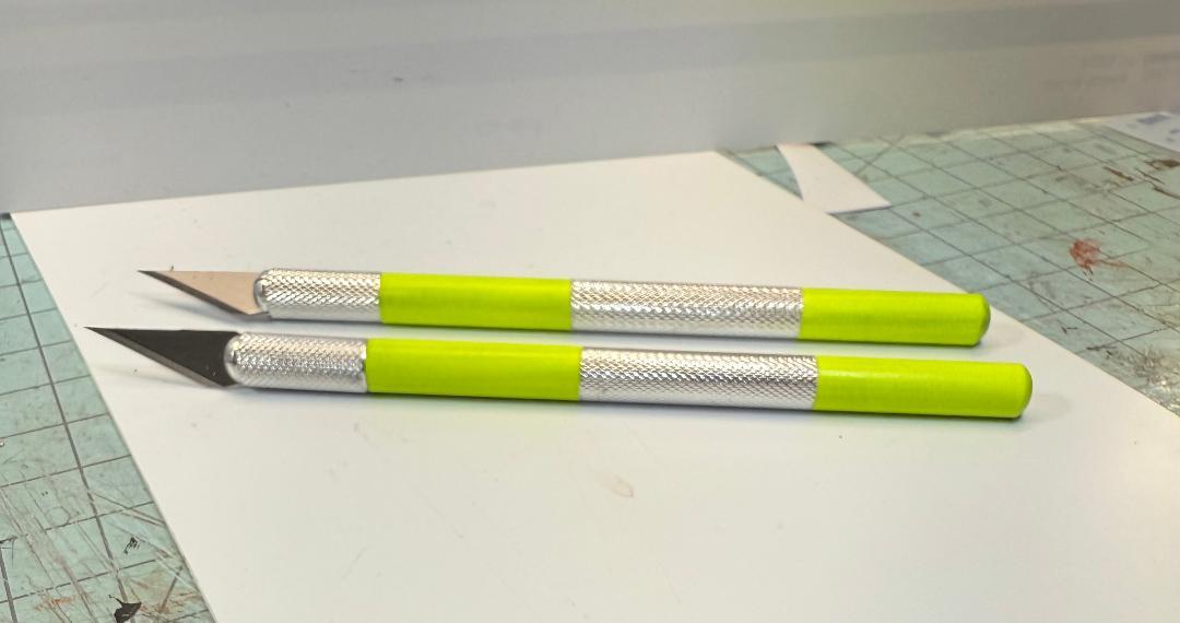

oldcarfan Posted July 31 Posted July 31 (edited) This is a simple tip, but some might find it helpful. Recently I lost all three of my good X-Acto knives. Knowing they would show up eventually I grabbed a couple of cheap Hobby Lobby knives. Sure enough the good knives showed up within a week. That was long enough to realize I don't like these cheap knives. Every time I went to use one the blade fell out. The collet backs off and let the blade slip out no matter how much I tightened it. In a moment of clarity I decided to try some plumber's Teflon tape. A couple twists around the threads and it seems to hold. While I had them apart, I decided to make them easier to see on the work bench. Some white primer and some left over Tamiya fluorescent yellow and they're done. Edited July 31 by oldcarfan 4 2
Swamp Dog Posted July 31 Posted July 31 i buy the cheap ones in different colors, but i dont have that problem of having to tighten them ever time i use them. could be the brand i buy. good tip. 2
NOBLNG Posted July 31 Posted July 31 I put some large shrink tube in different colors on a couple of mine so I can tell at a glance which blade is in them. 2 1

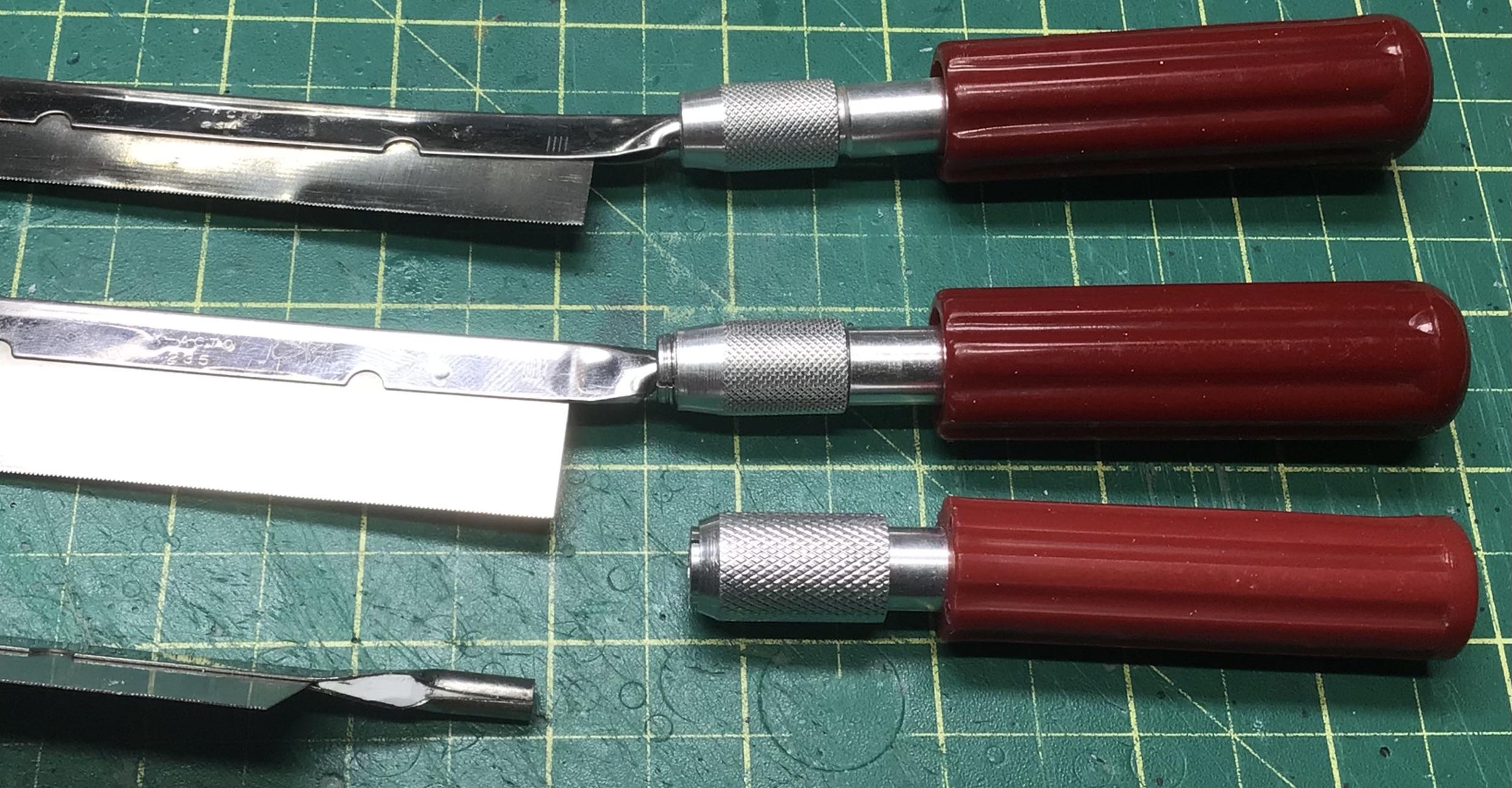

NOBLNG Posted August 19 Posted August 19 (edited) On 8/18/2025 at 2:09 AM, Bugatti Fan said: Exacto razor saws. Again not that expensive in the grand scheme of things and a good quality tool that will last for ages. Sort of related to the fixes idea… I filled the hollow tang that fits into the handle with some evergreen rod so that it tightens up better. If I recall, I heated the blade slightly with a butane torch as I pushed the rod in and it conformed nicely with the cavity. the top two handles are Exacto. The middle one has been overtightened ( probably due to the hollow tangs) and the collar is stretched over the chuck.😕 The bottom one is a cheapo and will not tighten up at all. Edit: I have dulled the bottom blade substantially by cutting brass and aluminum, so I only cut styrene with the others. Edited August 19 by NOBLNG Crop pic 2

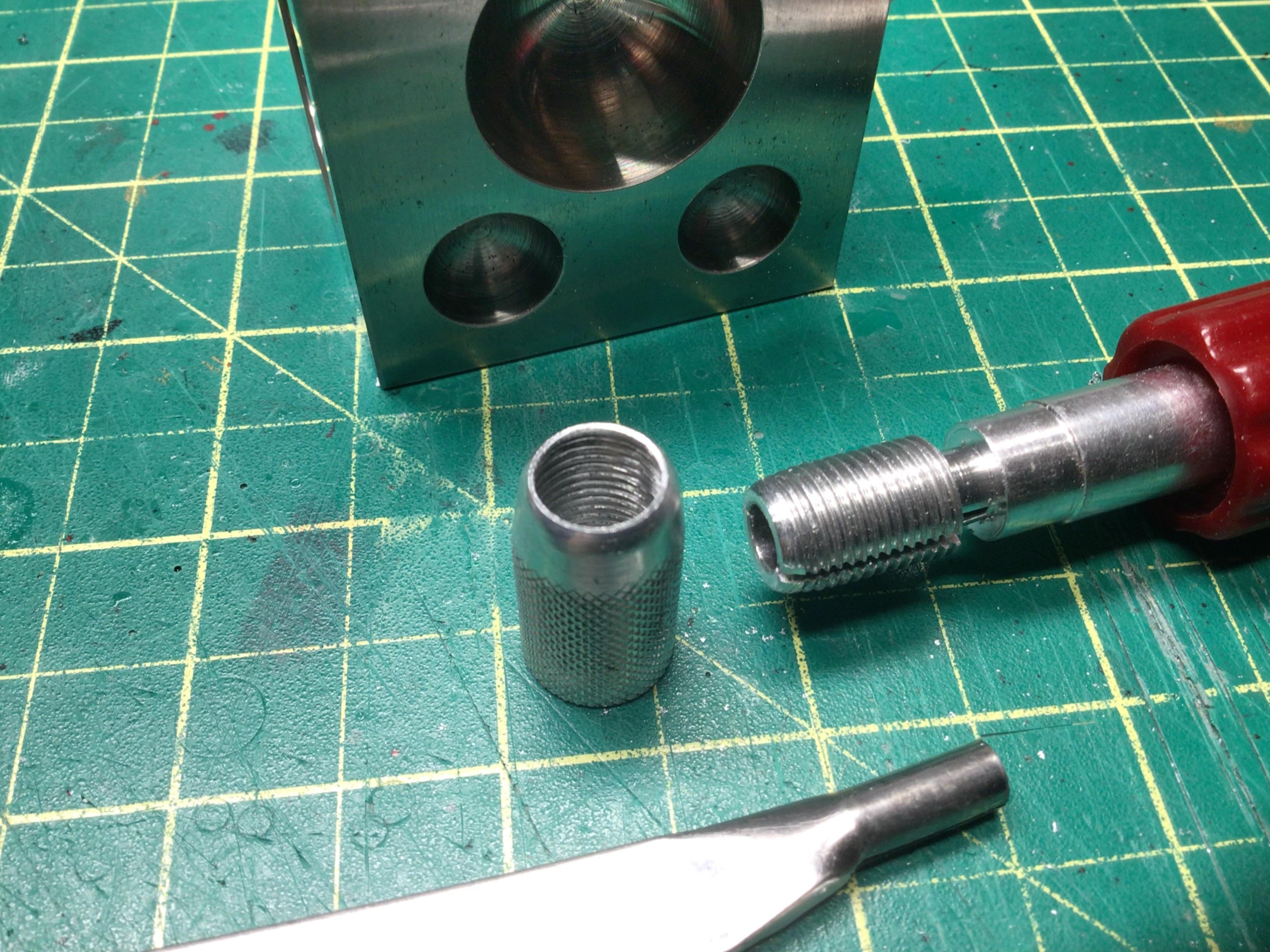

NOBLNG Posted August 19 Posted August 19 (edited) I just now fixed the handle by carefully tapping the stretched collar into a doming block and filing a slight chamfer at the end of the threads.🙂 Edited August 19 by NOBLNG 2 1
