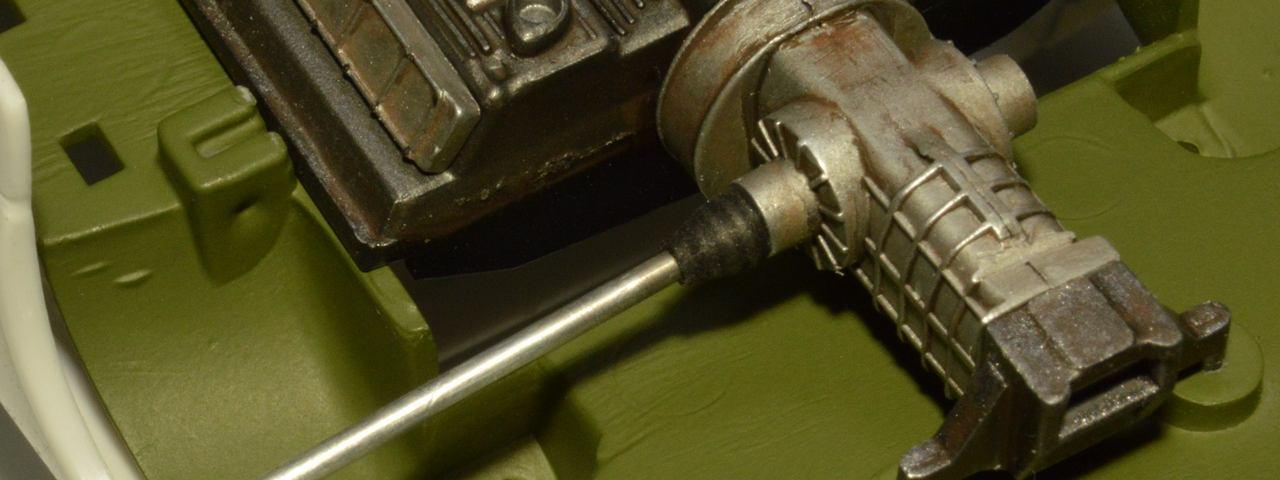

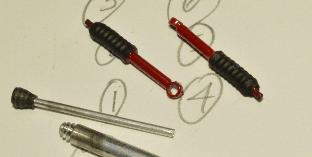

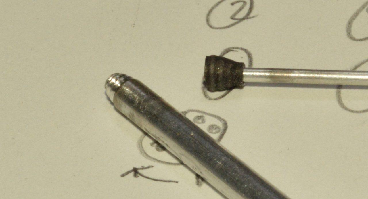

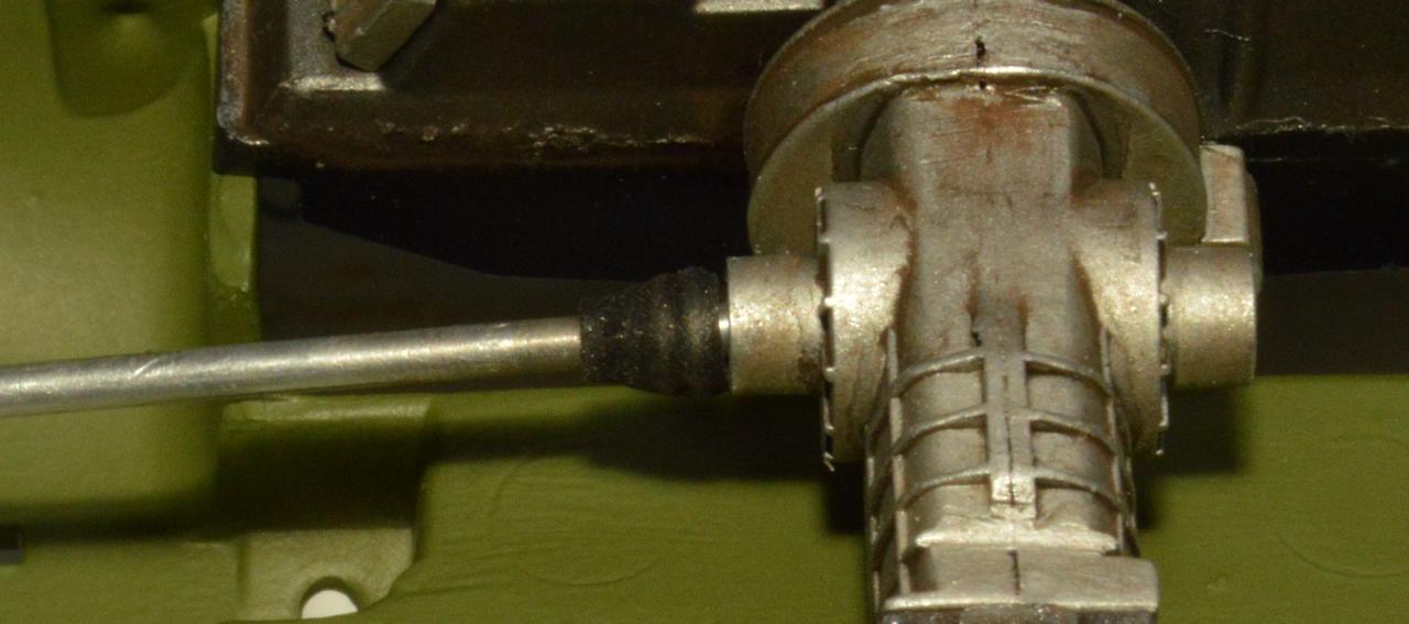

Straightliner59 Posted Thursday at 11:41 AM Posted Thursday at 11:41 AM (edited) I needed some CV joint dust boots for the 914 I'm building. I used a 1/8" shank 'v' cutting bit in my lathe to make this little forming tool from aluminum. I bored it to accept the .052" aluminum wire I'm using for the half-shafts. Then, all that was necessary to do, was to slip a length of heat shrink over the half shaft, and the form, and heat it with a lighter. I think they're pretty convincing! Edited Thursday at 11:42 AM by Straightliner59 6 2

Straightliner59 Posted Thursday at 12:18 PM Author Posted Thursday at 12:18 PM 2 minutes ago, Beans said: Looks great! I don't have a lathe but I'm sure I can come up with some way to make a form. Great idea. Time to experiment. If you can hold your drill in place, somehow, maybe sharpen a dowel with a pencil sharpener, then chuck it in the drill, and use a triangular file, to cut the grooves? I was thinking about that, because, not everyone does have a lathe.🙂 1

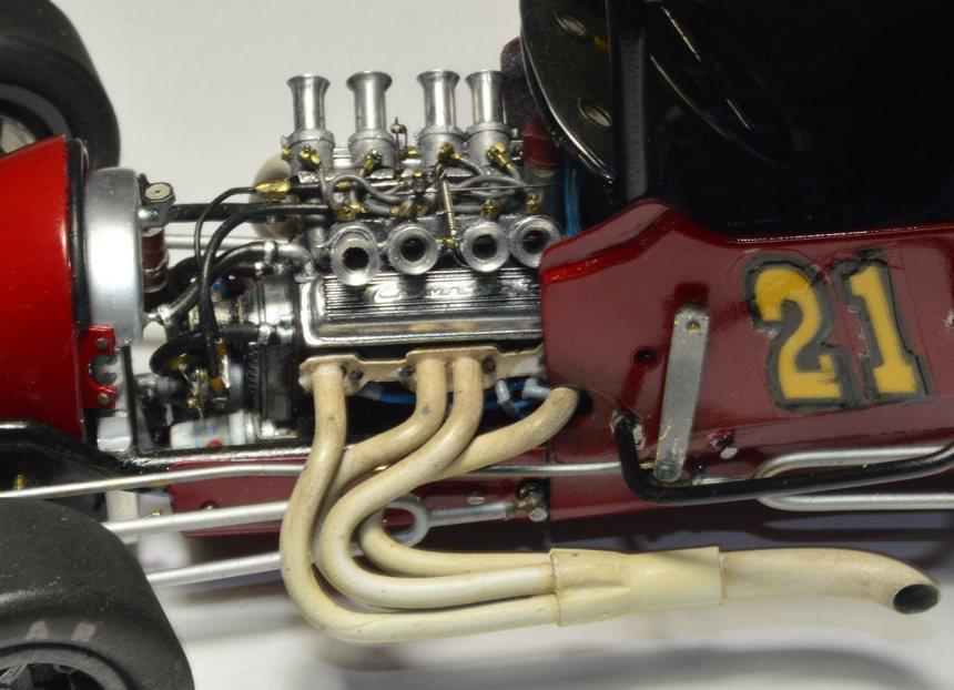

bill-e-boy Posted yesterday at 06:35 PM Posted yesterday at 06:35 PM Heat shrink idea is cool I have used it to make 4n1 header collectors in the past 1
Straightliner59 Posted yesterday at 07:26 PM Author Posted yesterday at 07:26 PM 51 minutes ago, bill-e-boy said: Heat shrink idea is cool I have used it to make 4n1 header collectors in the past Same, here! Versatile stuff!
peteski Posted yesterday at 08:06 PM Posted yesterday at 08:06 PM Good idea, but to me the bellows shape is a bit softly defined. There are many different types of heat shrink tubing available. I suspect that using a thin-wall tubing would give even better results.
Straightliner59 Posted 23 hours ago Author Posted 23 hours ago 1 hour ago, peteski said: Good idea, but to me the bellows shape is a bit softly defined. There are many different types of heat shrink tubing available. I suspect that using a thin-wall tubing would give even better results. I was thinking the same. I just used what I had on hand. I still think they look better than molded plastic.

Straightliner59 Posted 14 hours ago Author Posted 14 hours ago 11 hours ago, Straightliner59 said: I have used it to make 4n1 header collectors in the past I did these, with it. I just pushed my thumbnail into the heat shrink, while it was still warm. 1
