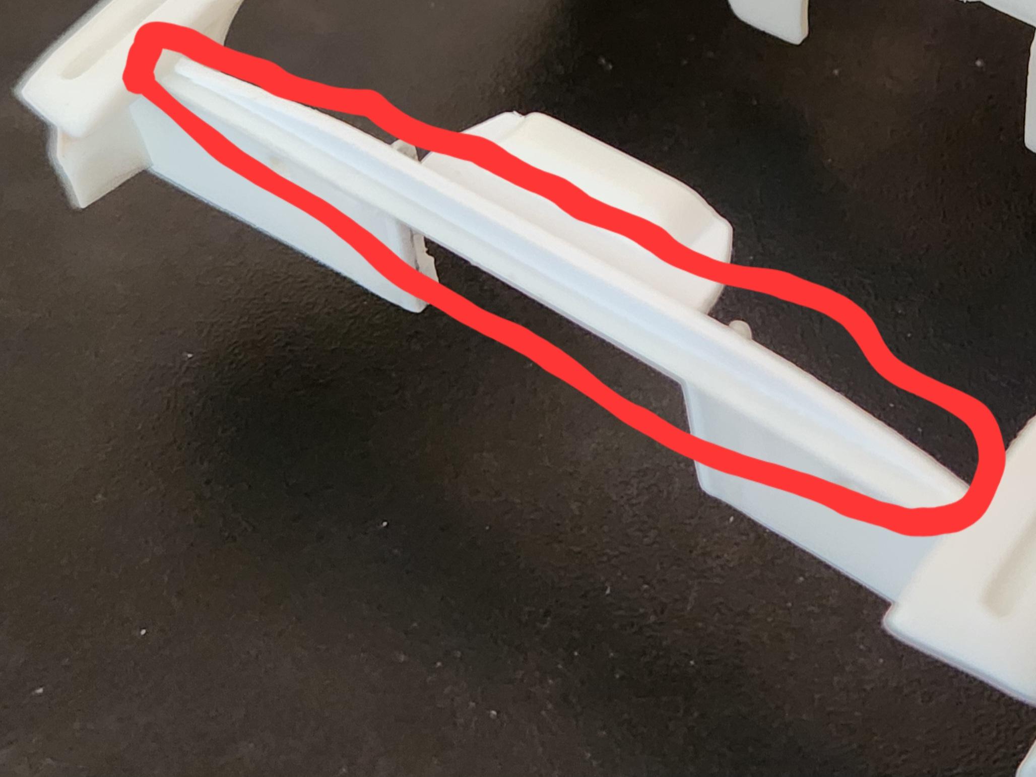

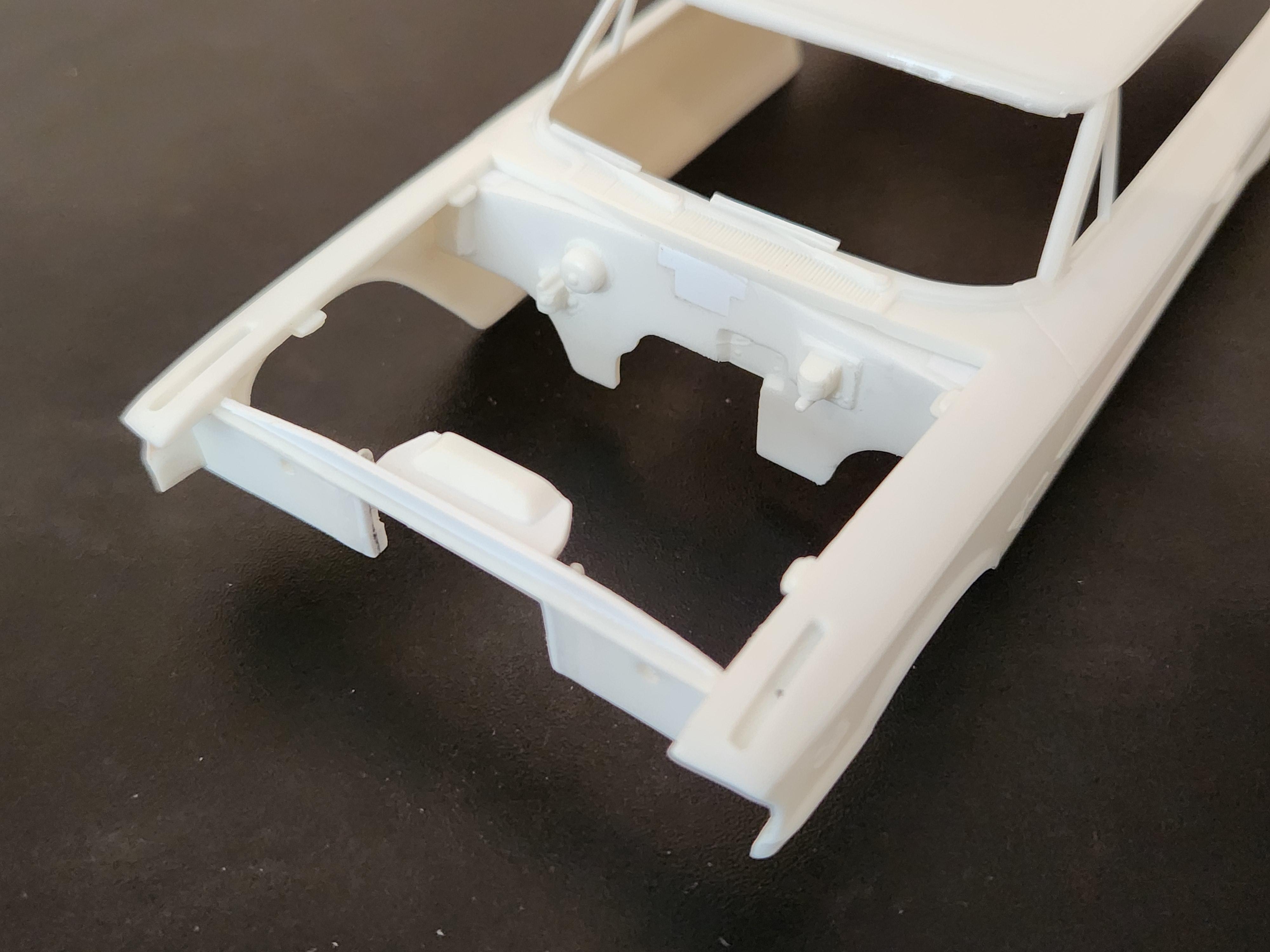

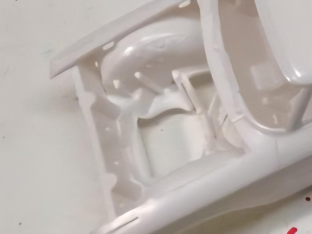

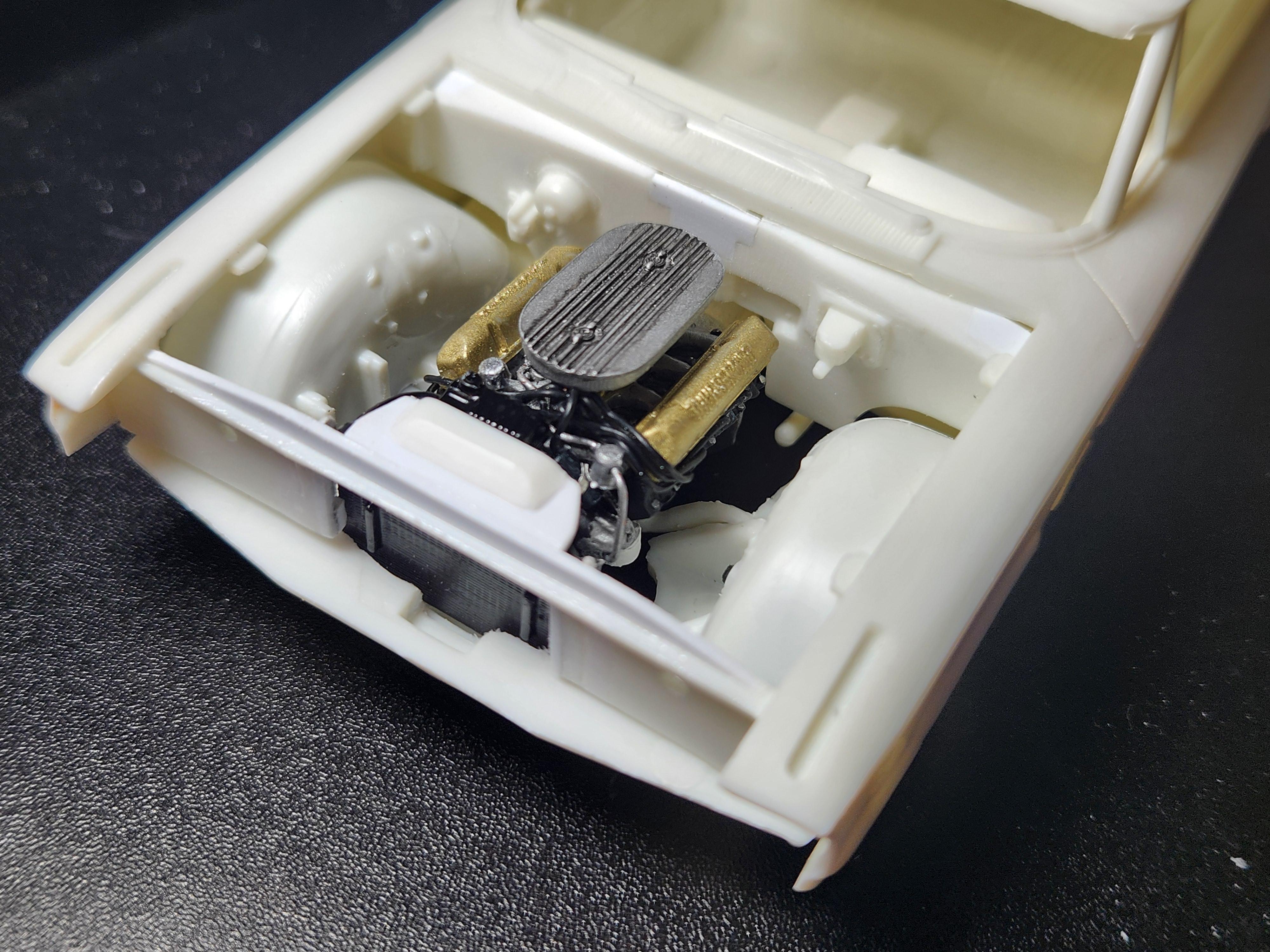

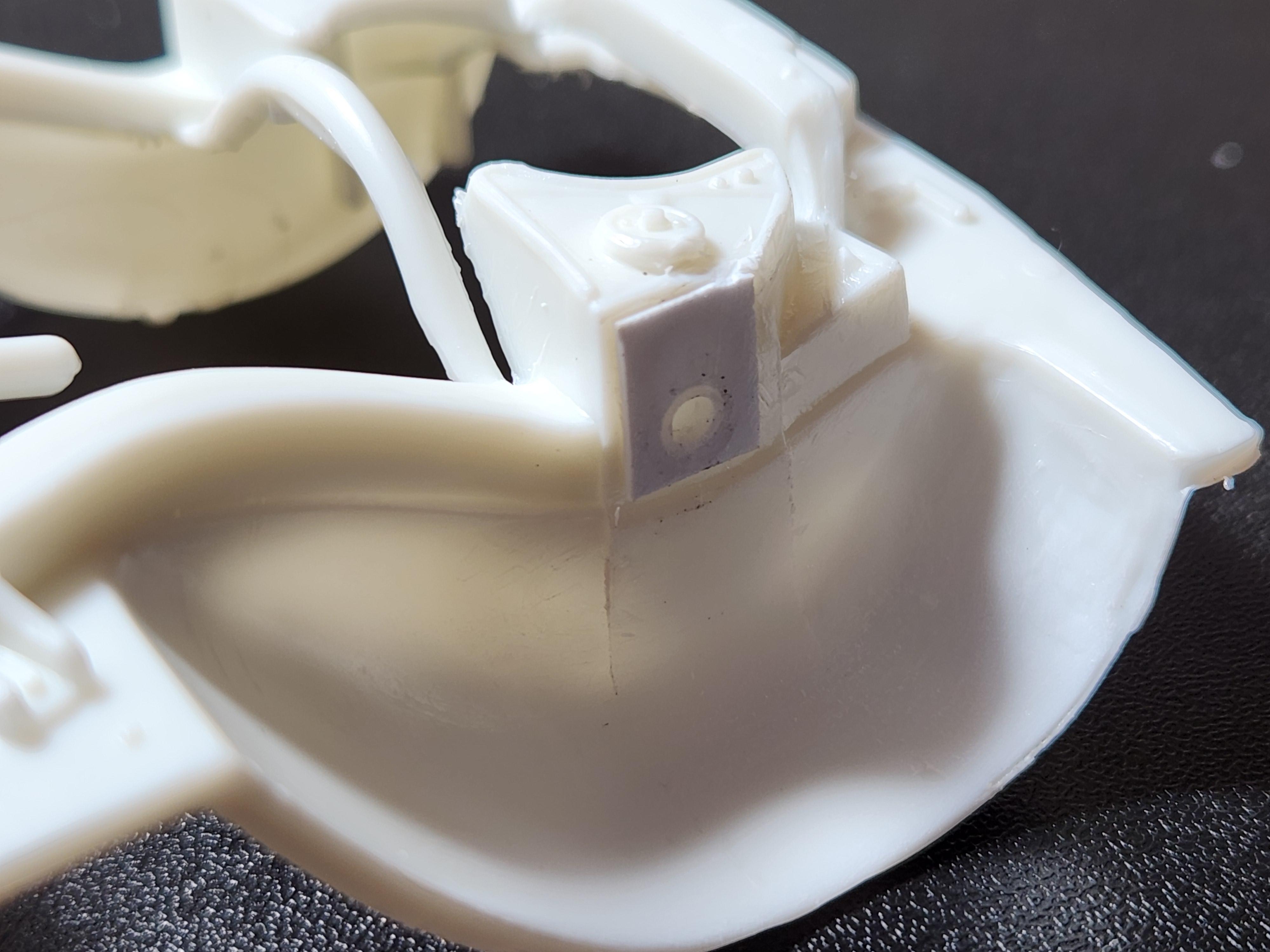

My least favorite part about these early annual kits is the screw post on the radiator support. I have filled these on my 65 falcon awb, time to do it again. Drilled them out with a 1/8" bit and filled with 1/8" piece of styrene. Shaved them down with a dremmel tool. I then added the top raised piece with some plastic stock.20250807_161025(1).jpg.f3a08c4c3dc6cae965de54e341098f0c.jpg
The fan shield was made from evergreen and the raised piece was stolen from the kit radiator.20250807_161025(2).jpg.295efcf76ee4005360bfc9f7b1af272e.jpg

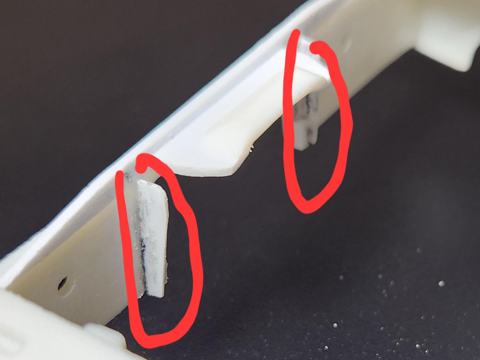

There is also some little ears on the back side to hold and locate the radiator so of course I made some.20250807_161004(1).jpg.5eabfd456be9970ce57e8bacfb7d8a08.jpg
The last thing I have done so far to clean up the engine bay was shave all the wires off of the fire wall and patch some of the holes.20250807_161025.jpg.6f9ff9c3c6c411d7b6243e49cd449ee5.jpg

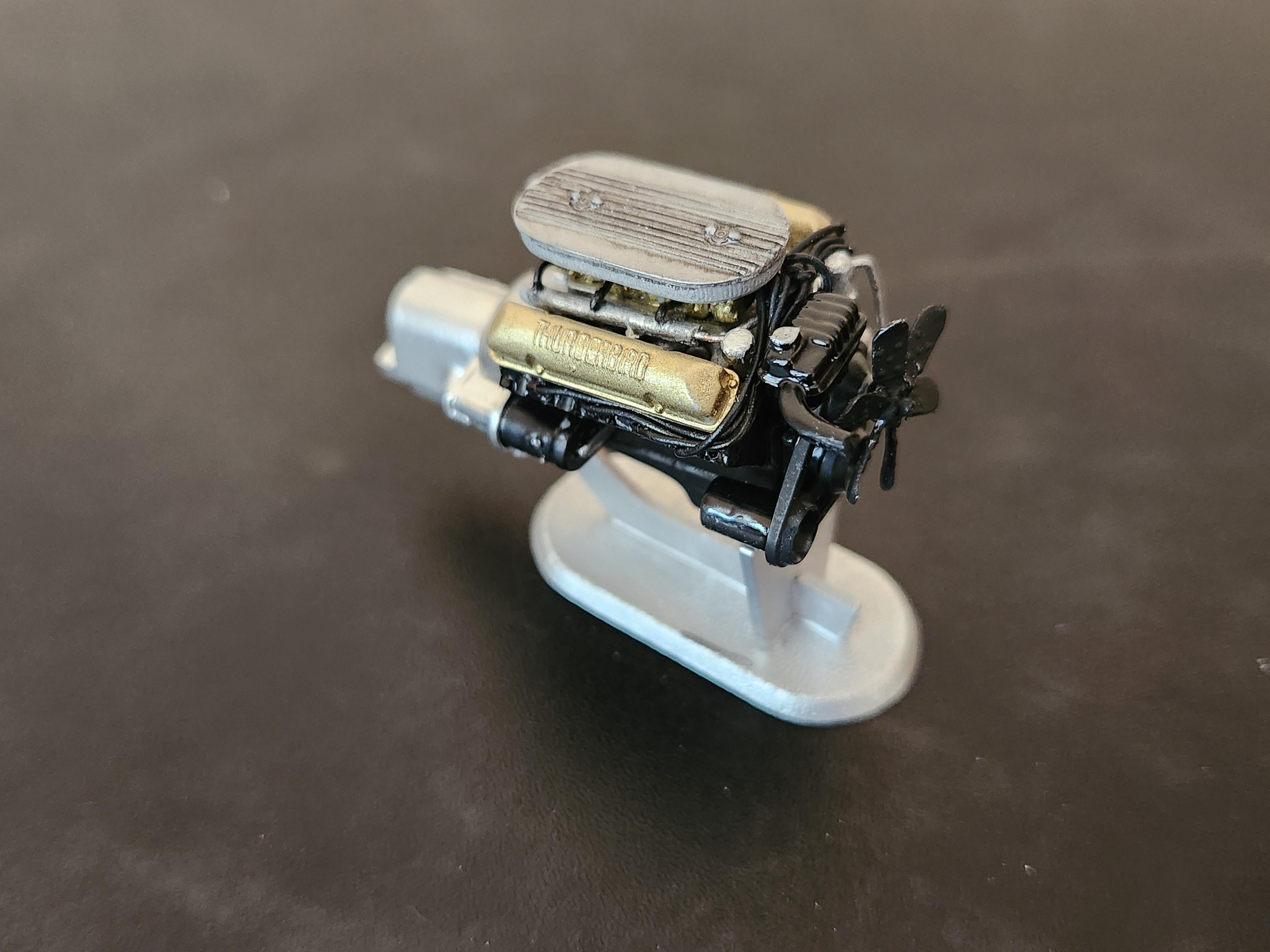

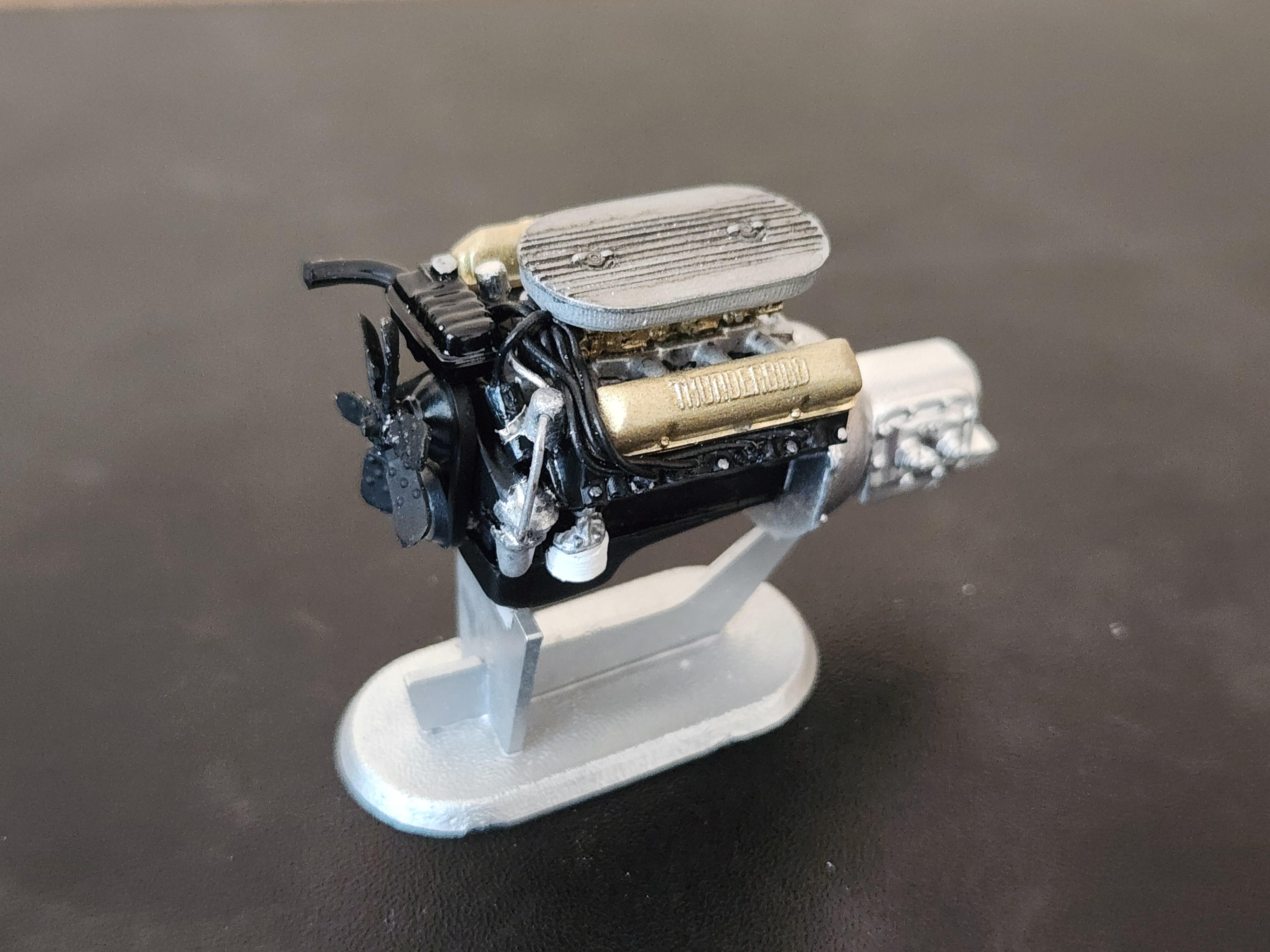

The next thing I did was build and detail the engine. The kit engine is not horrible, the one glaringly obvious thing is the big hole in the block for the metal axle. That had to go. Now this won't happen when you fill it with oil.
After that it got detailed, fuel lines run and plumbed to the filter and pump. The ignition was also wired in the correct firing order, I try to do this on all of my builds but sometimes it just depends on my mood that day.20250807_160937.jpg.8ec1595847935cc9a2d1af5deb1e600f.jpg20250807_160904.jpg.1ba219f46d439b57f7fab56f9123ea53.jpg

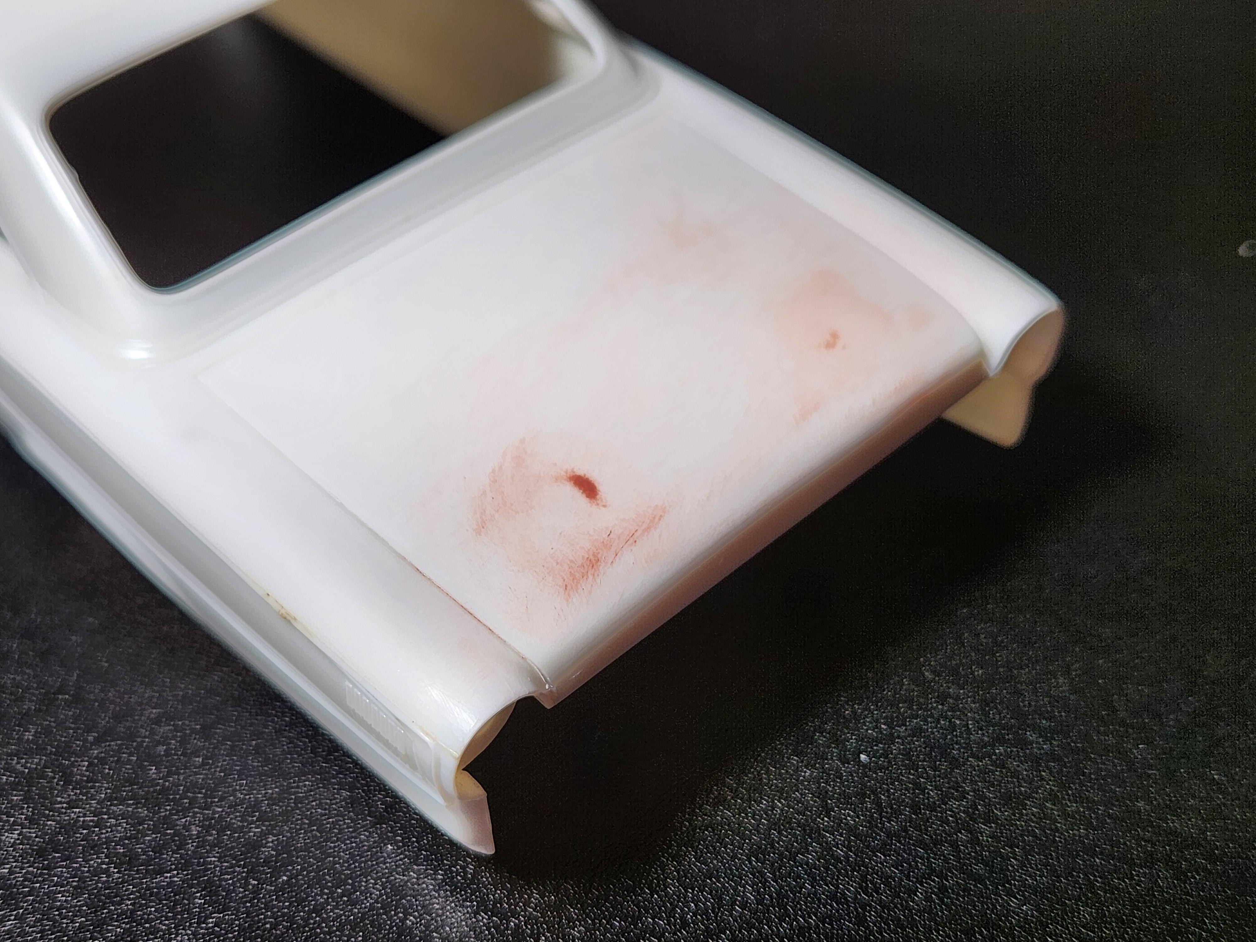

The overall body on this, well, not the worst thing I have ever seen, worst part were the sink marks in the trunk. No problem that a little spot putty can't fix.20250807_161104.jpg.9ff226130696803f10d88ed50fb4effb.jpg

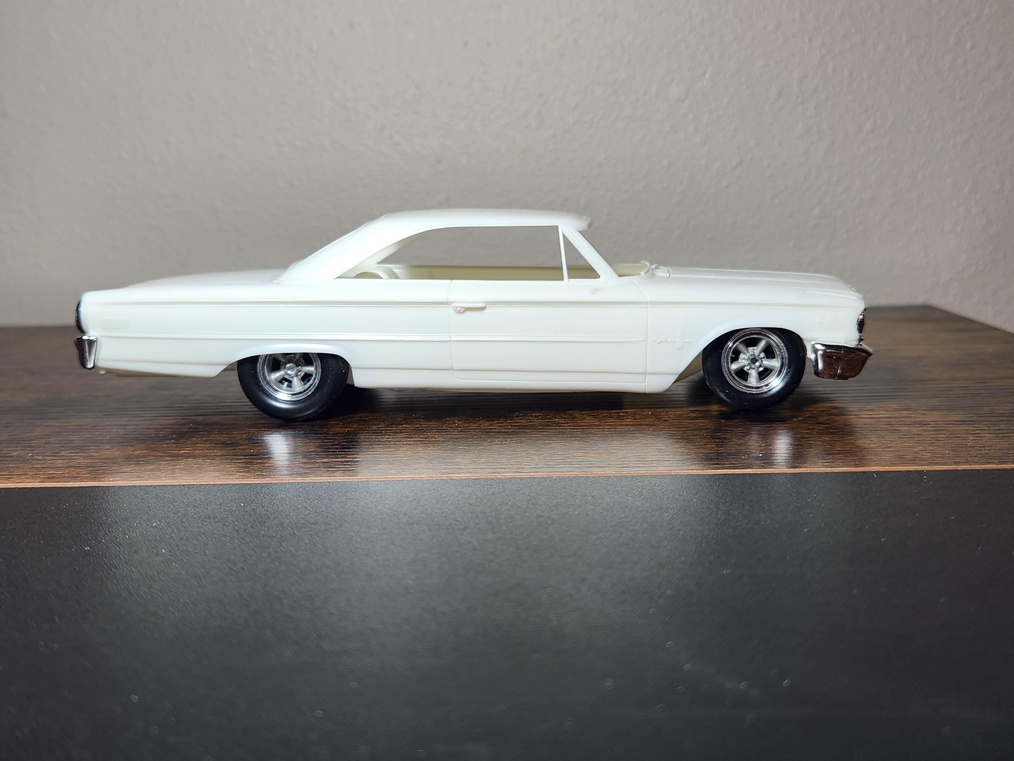

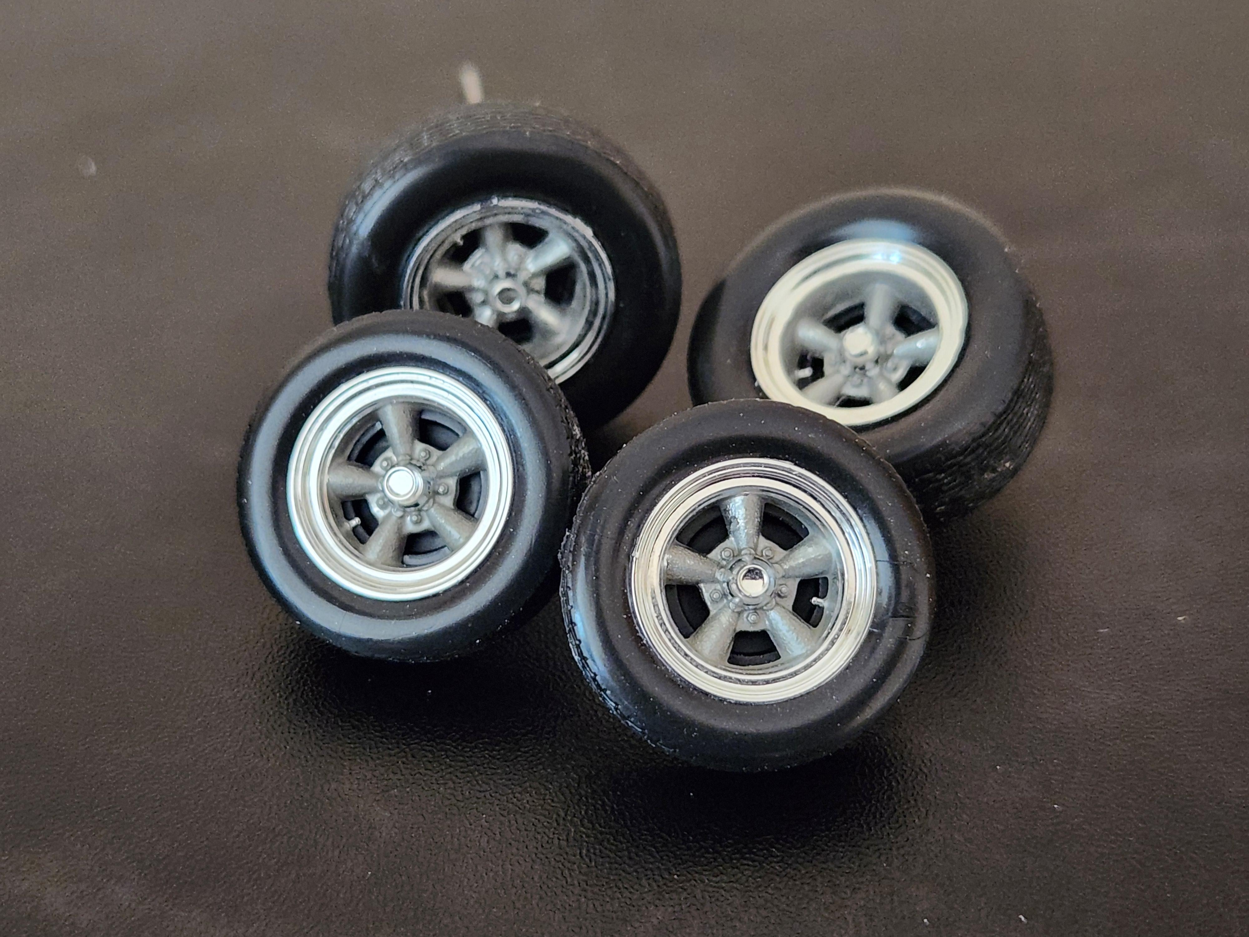

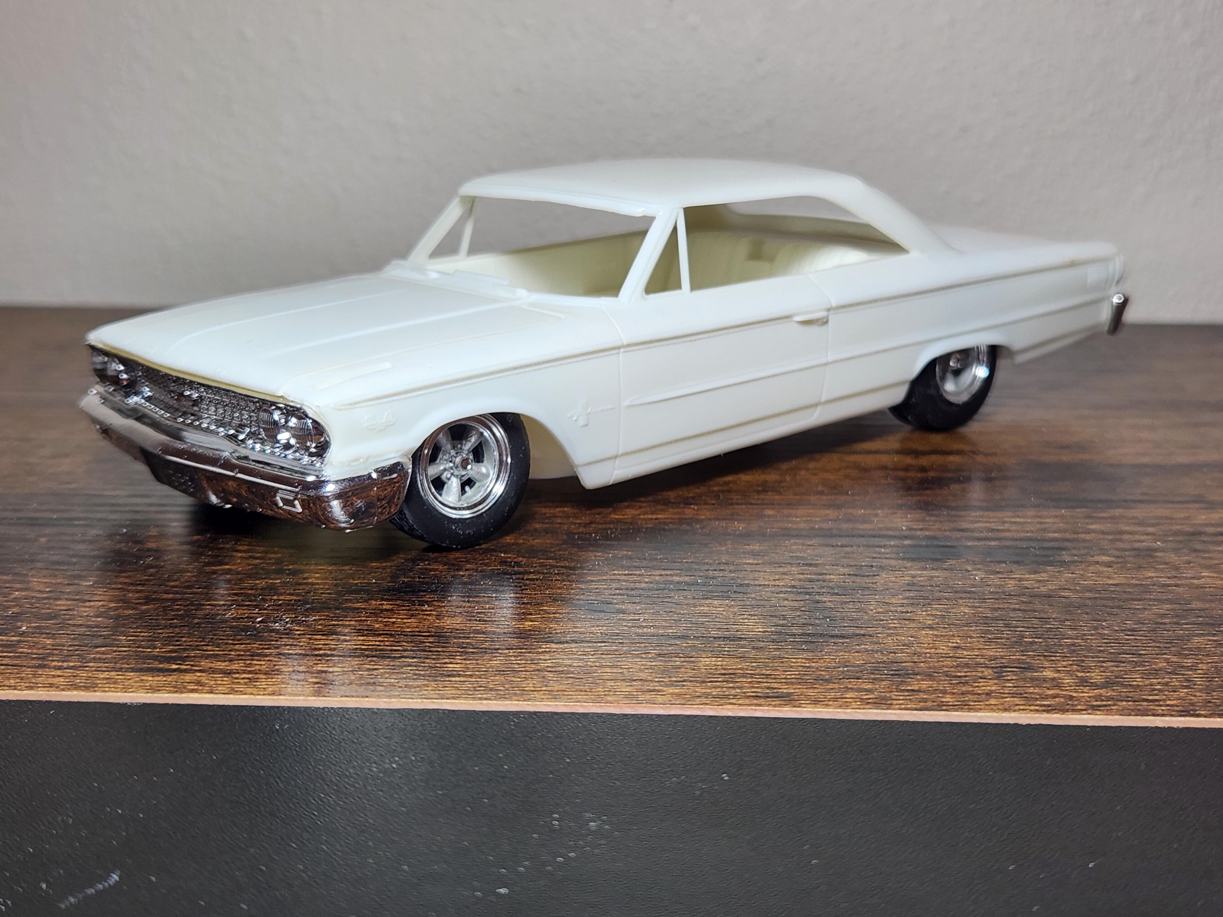

My favorite part about this is the stance and wheels. The wheels and tires are the ones from the revell 32 ford.20250807_160838.jpg.d5fb50482d3008fd5144b68e555c3fce.jpg

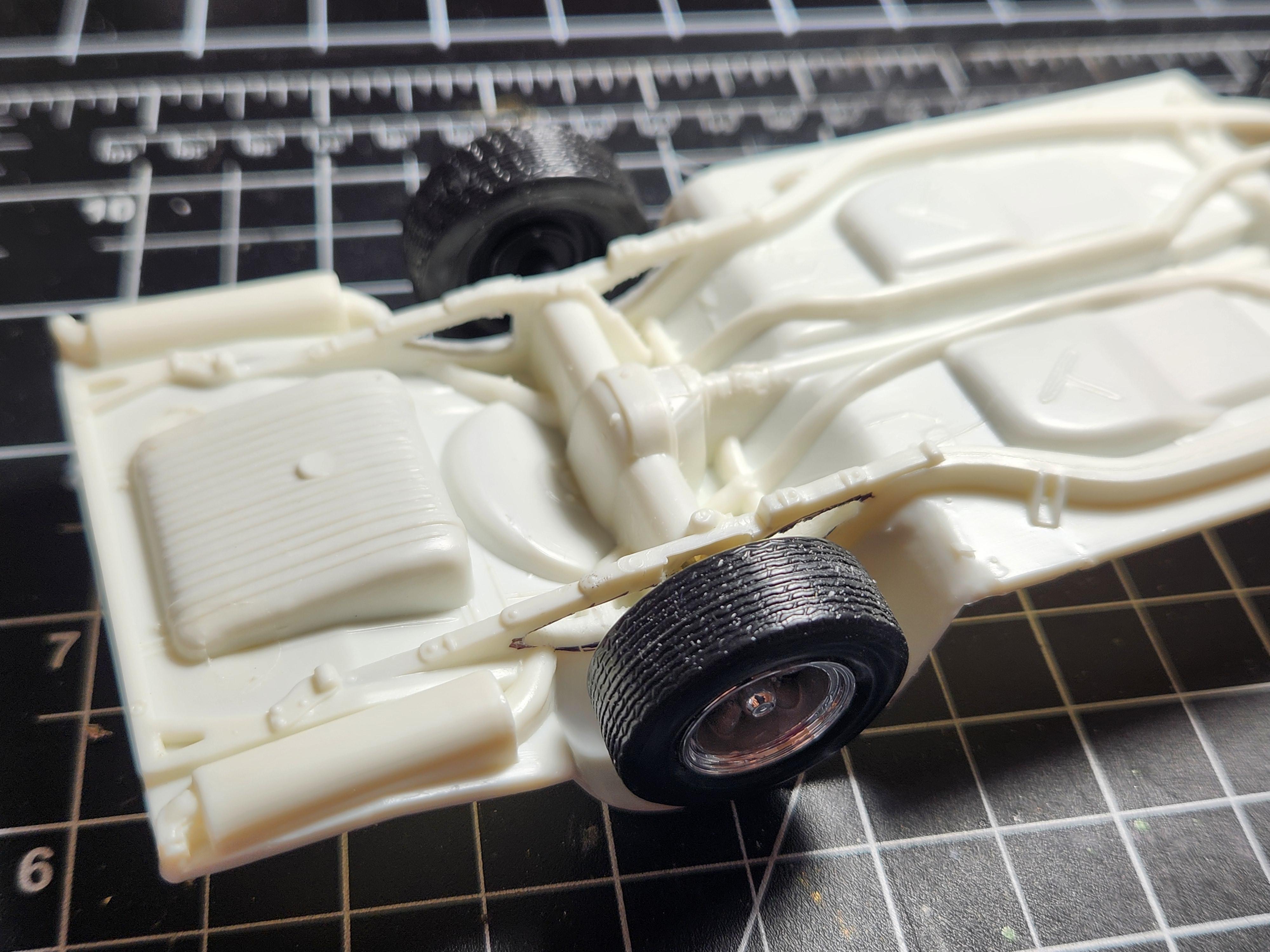

The stance was achived by drilling another hole above the original then putting some evergreen 1/8" tube into it, I then covered that with some flat stock to add some support and hide the original hole.20250807_161119.jpg.16f67e50eb9579c505eef5dd48dffdcd.jpg

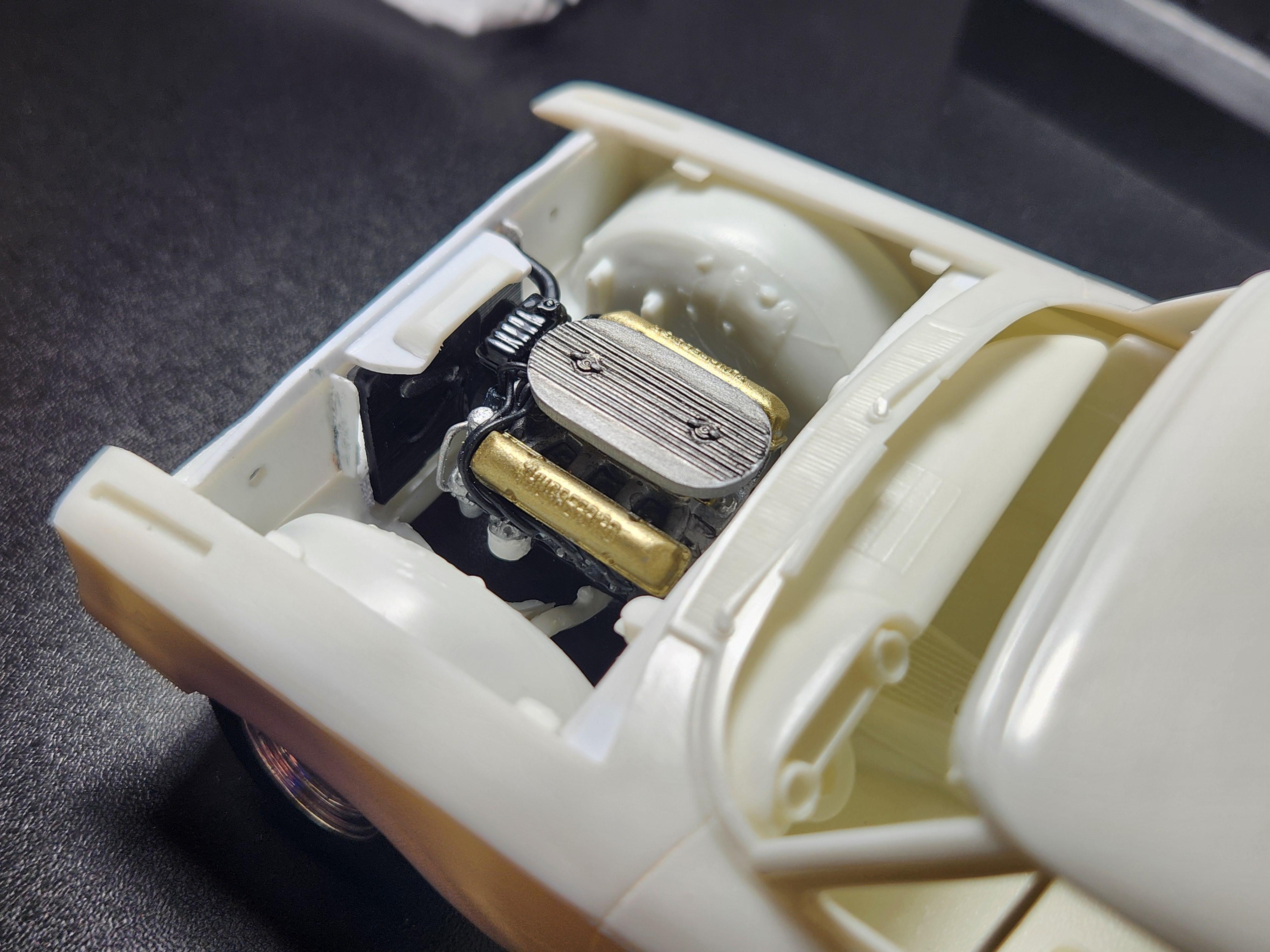

Here's a moch up of the engine bay and over all car.20250807_160309.jpg.bbc936548dbb661e7c71e59959e3593e.jpg20250807_160301.jpg.4cb7a4c7c81d814dd5c79beca8732137.jpg20250806_210118.jpg.1d87573e28b871f92bb8a8aa8a9db3cc.jpg20250806_210232.jpg.d8fc26f027f6862b677d12e549d21d73.jpg

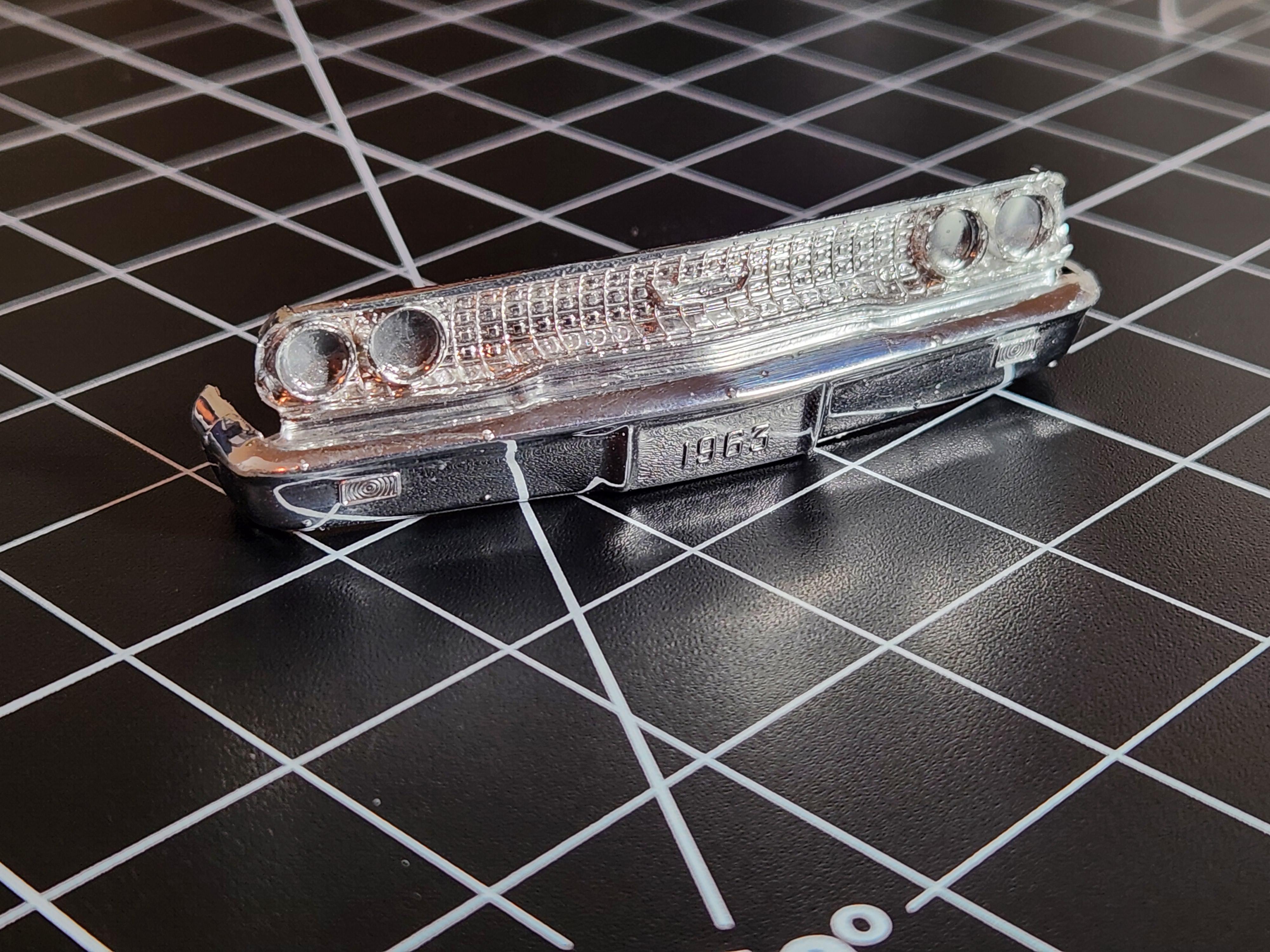

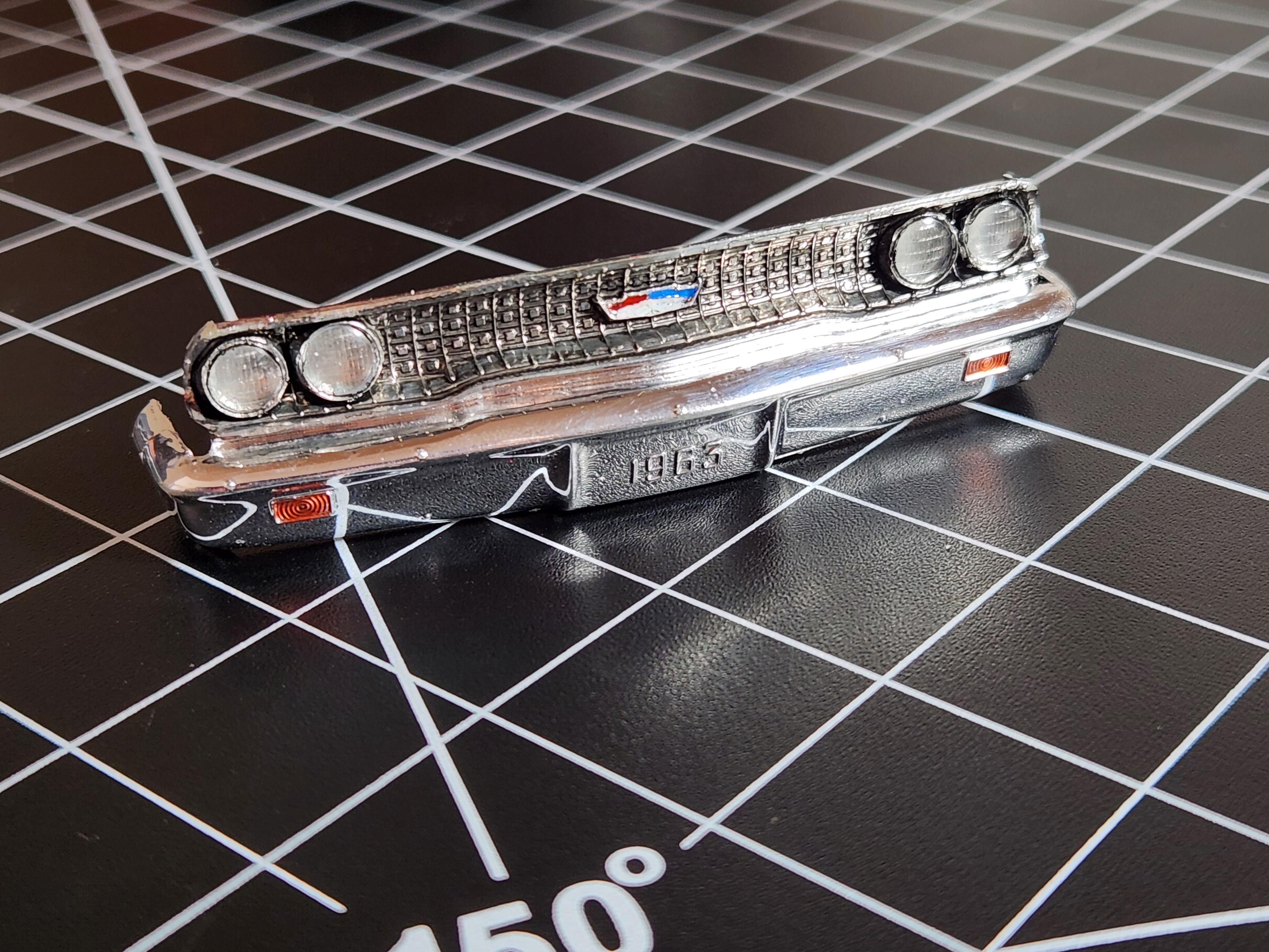

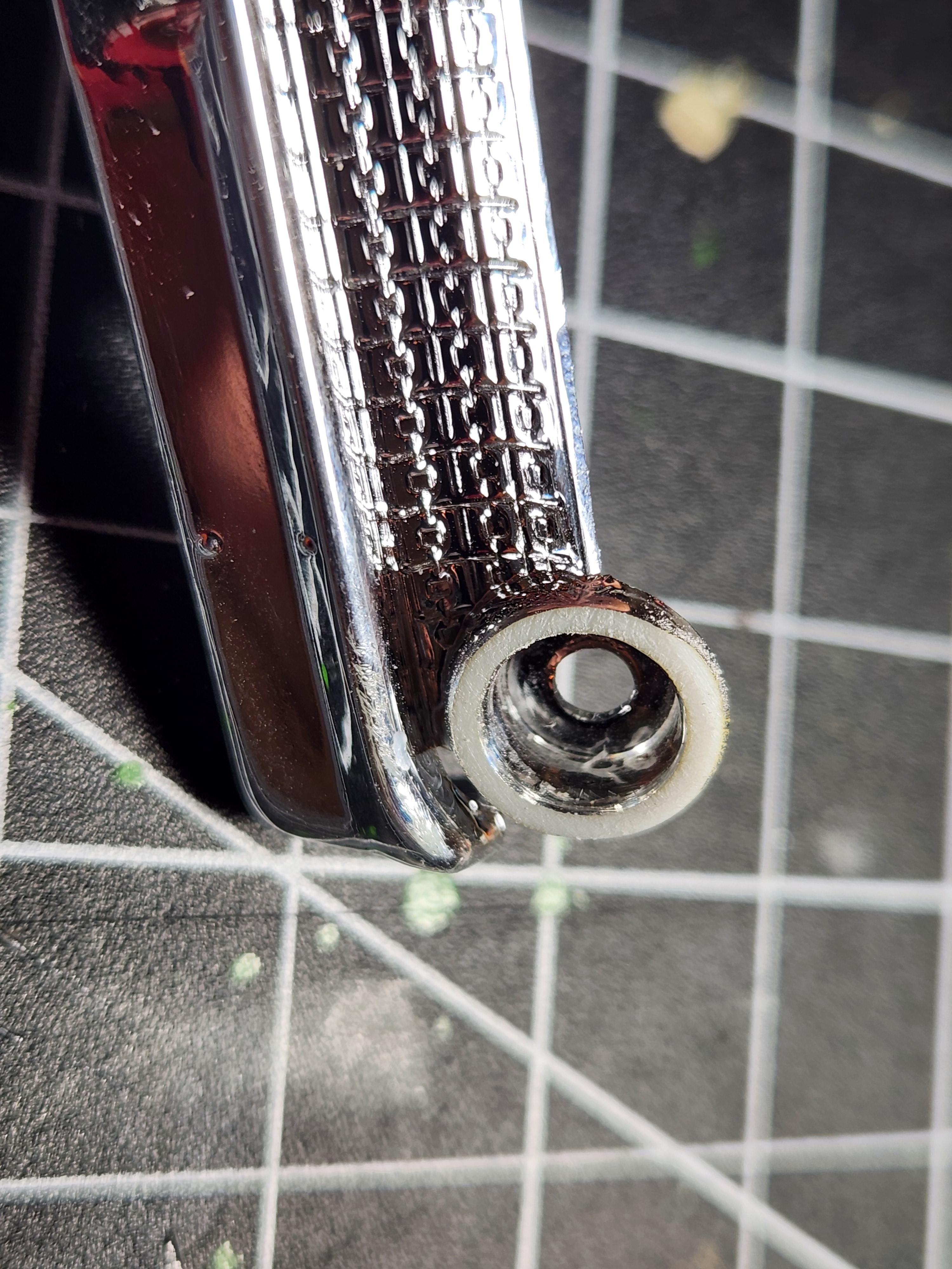

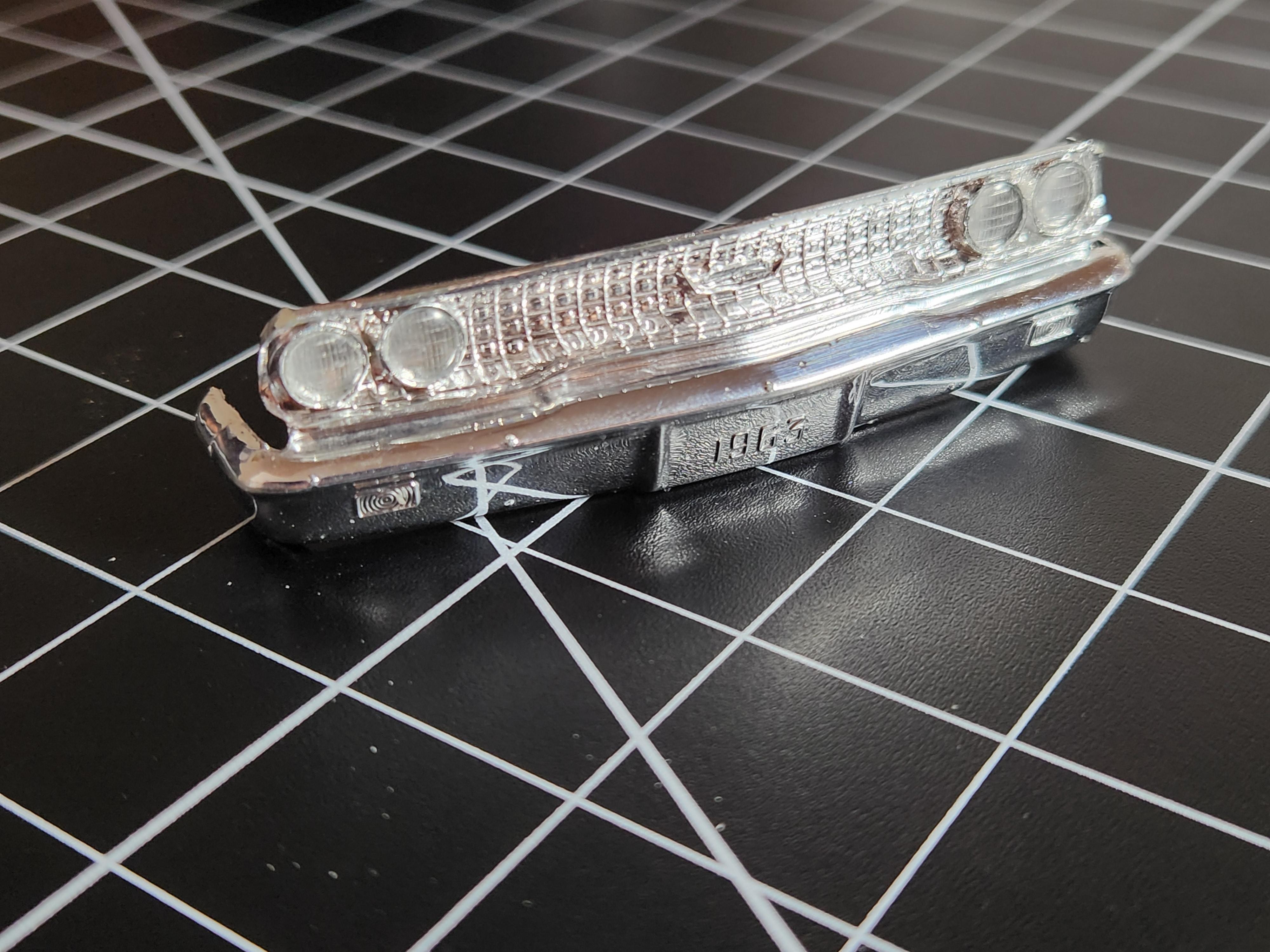

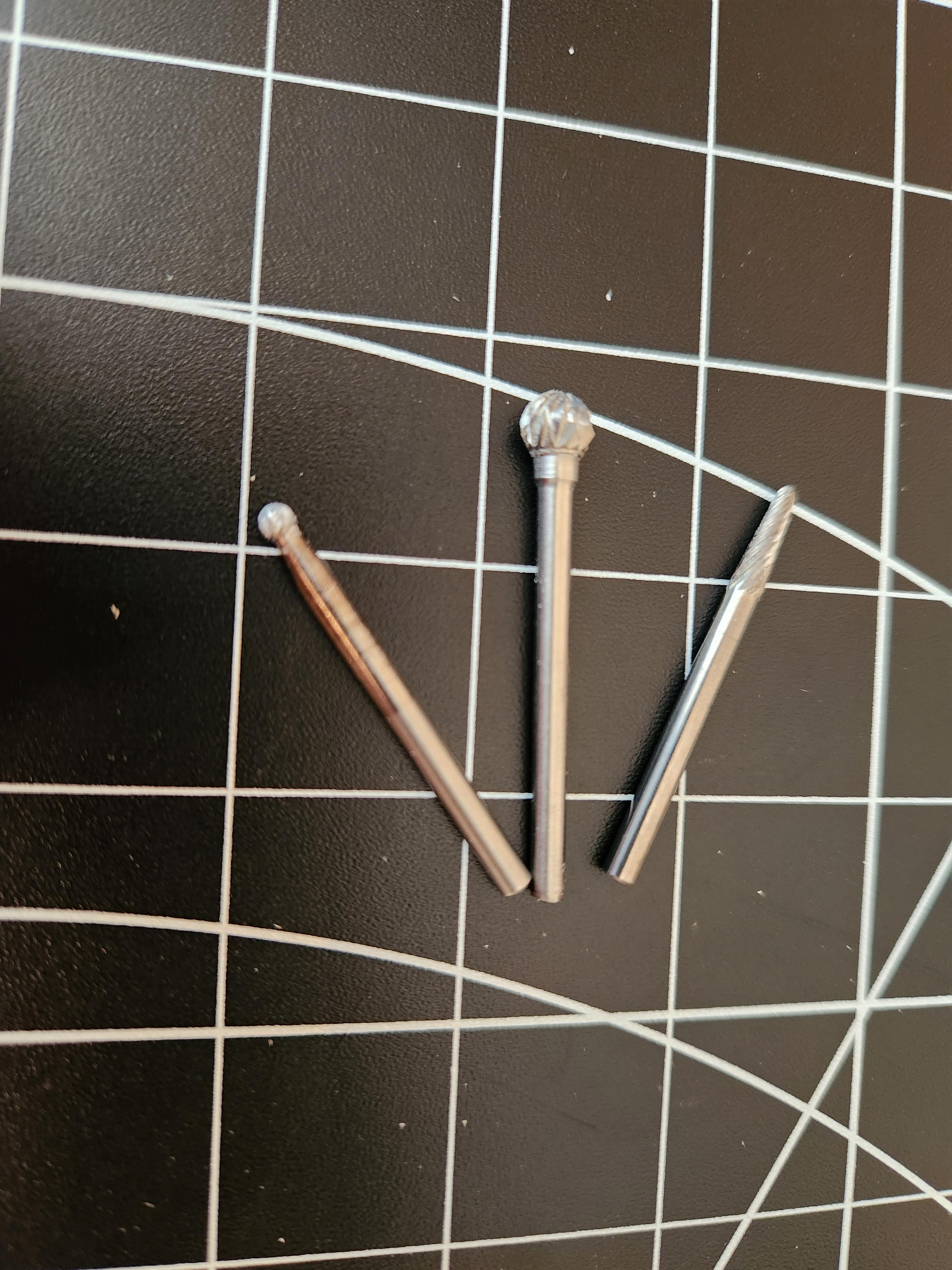

Thanks for all the comments guys, I really appreciate them! Today I got some much needed chrome work done. Those chrome headlights had to go, took the dremmel with these 3 bits and grinded them out.20250808_161944.jpg.fd354997bf33057194aa38b2dec16c46.jpg

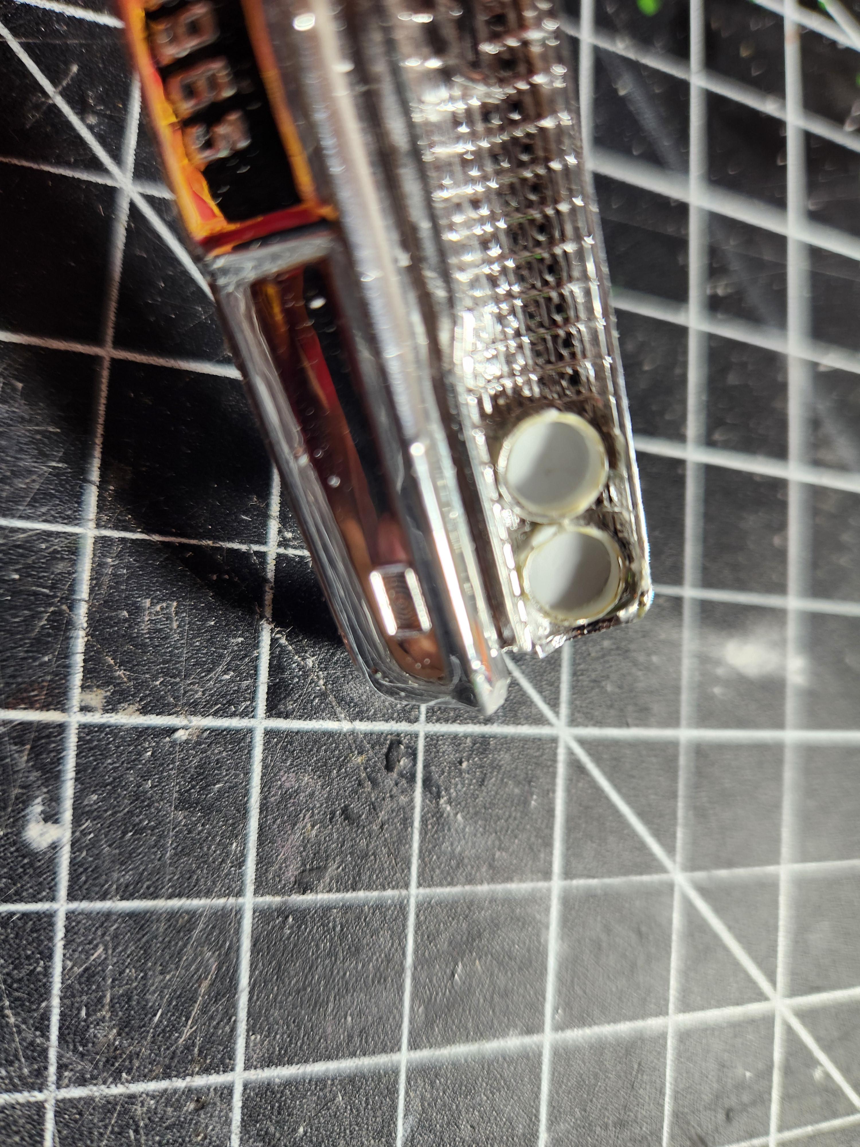

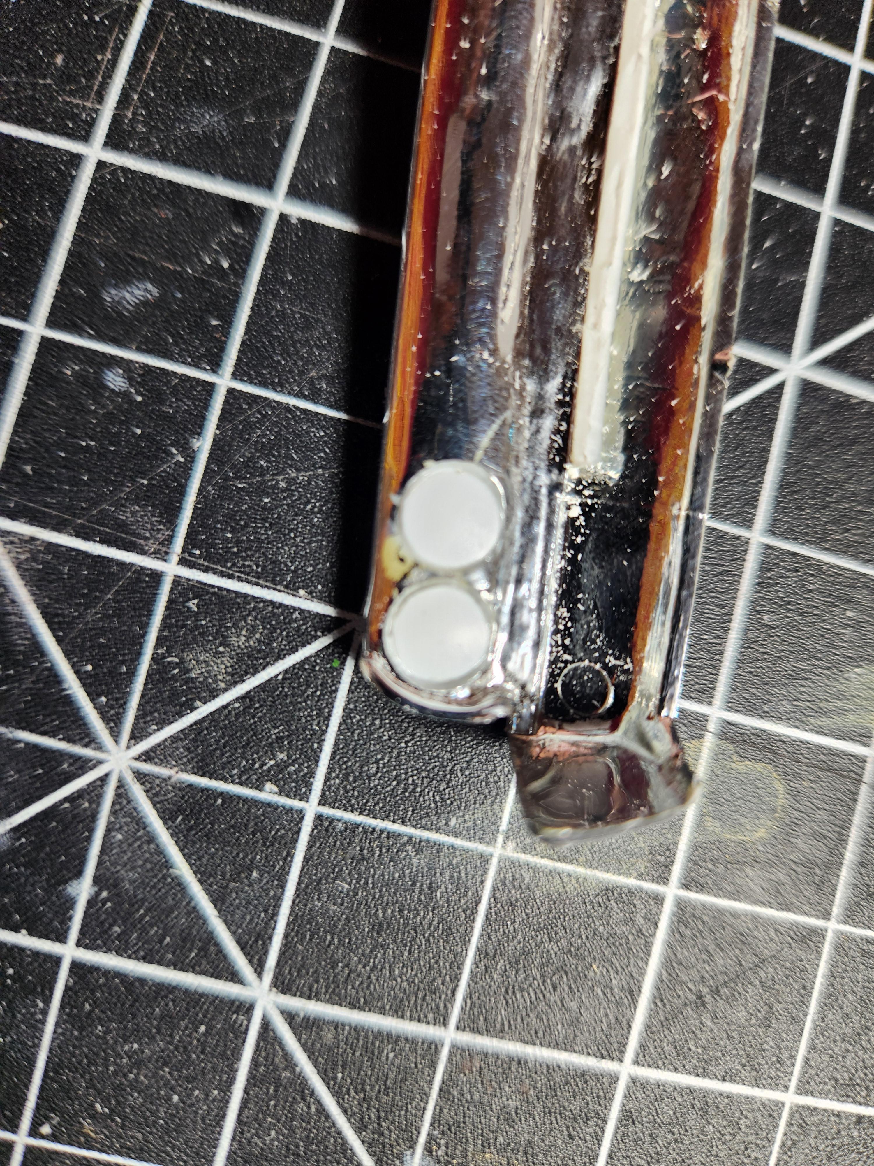

Heres where I started grinding, the plastic behind it was pretty thin so I had to go all the way through.20250808_134318.jpg.fe4ba1ed38699f6d6d0f16e5db005685.jpg

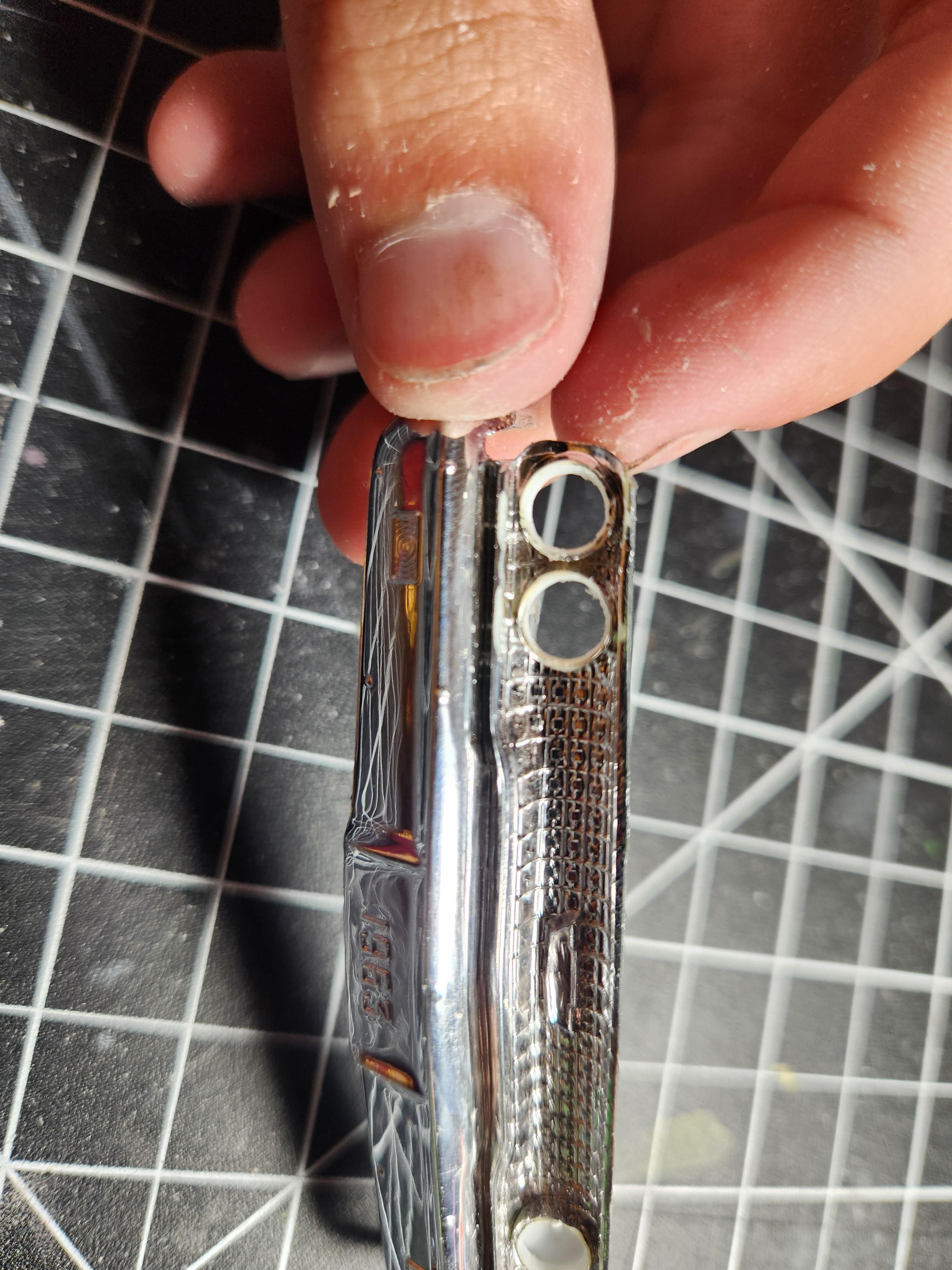

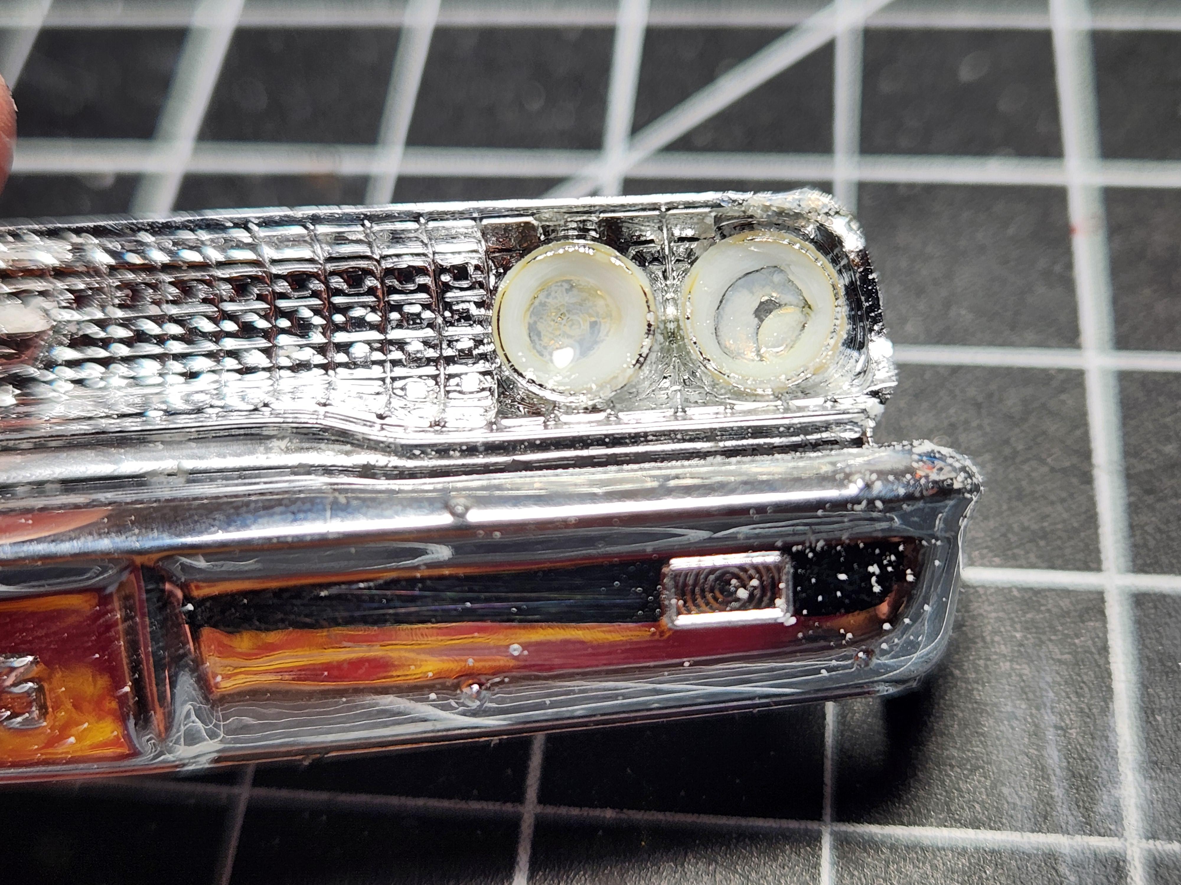

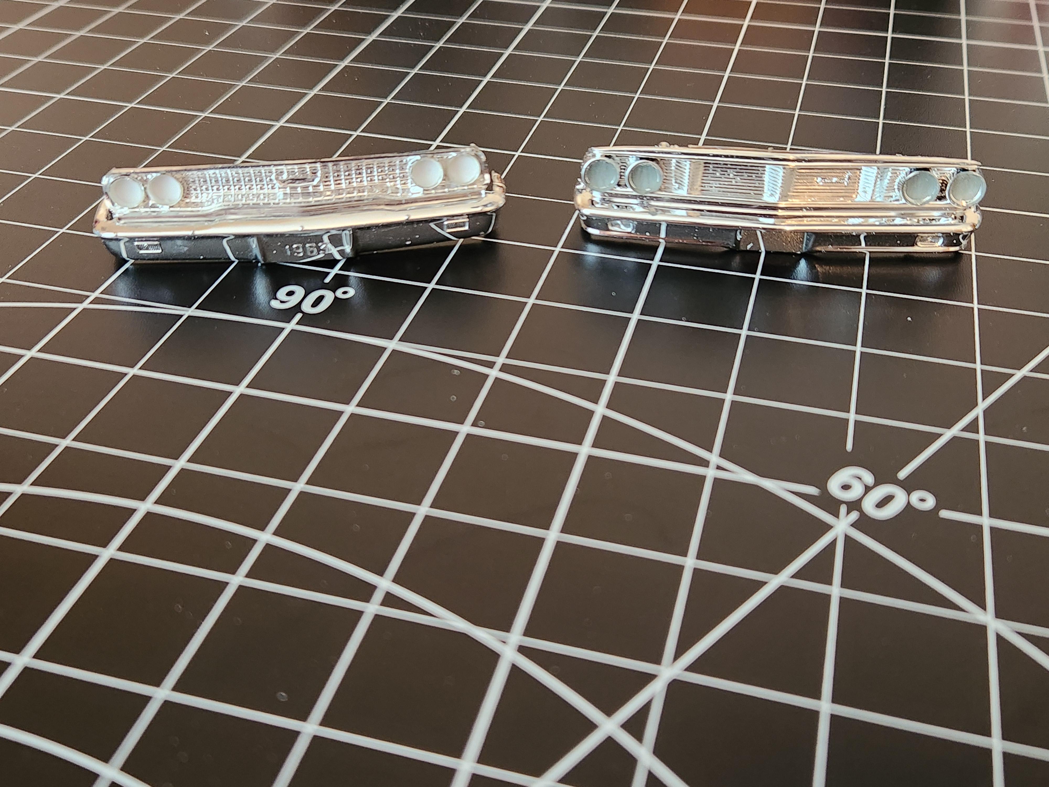

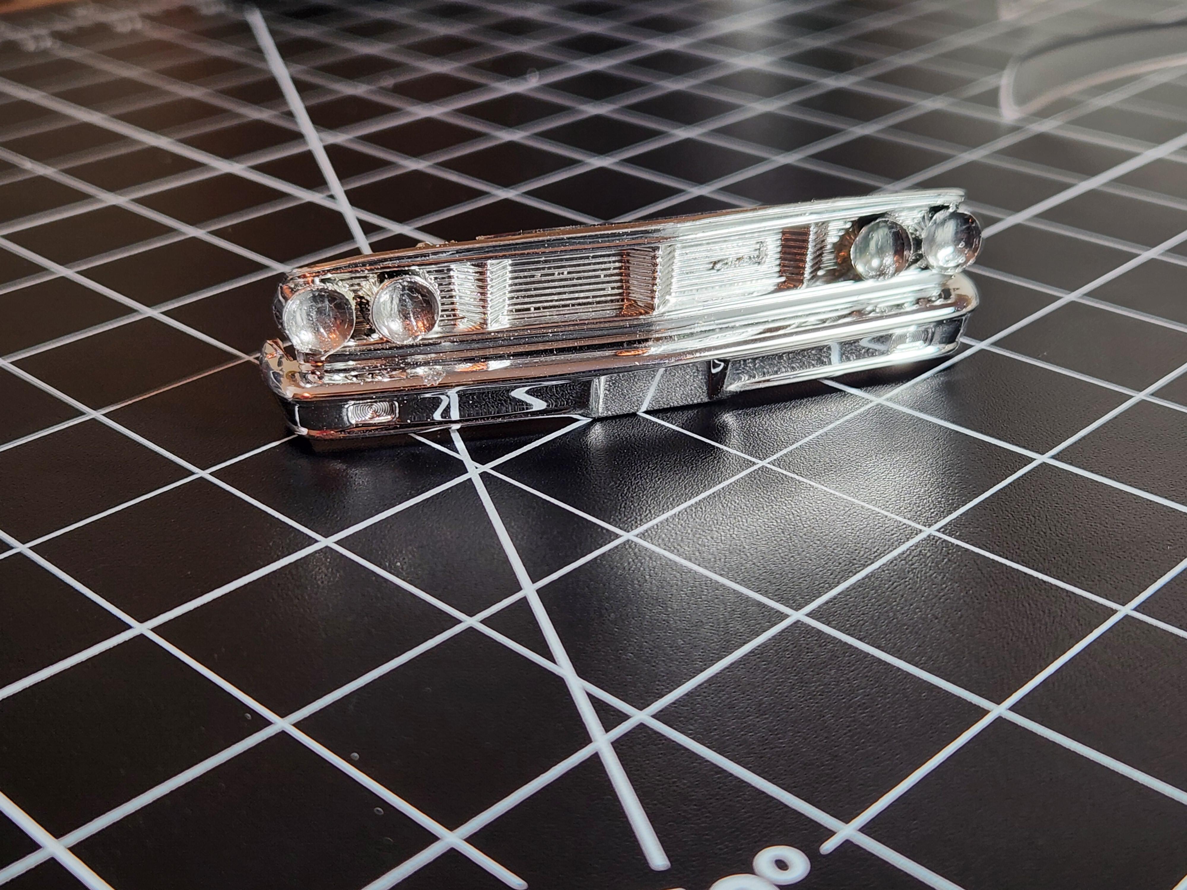

I then used a hole punch to cut out some evergreen styrene. I then rounded them out with the butt of a paint brush and glued them to the back. Also ginded a 64 grille because i had the dremmel out, didnt need to use the backing technique with it sence it had more material.20250808_141035.jpg.4dabd8f518ee914105c45e128c81bfe9.jpg20250808_141052.jpg.361f9e8f41dd45dfe37c94820d9ca1ca.jpg20250808_142444.jpg.6a199efff9563fcb23cef50de66afbcf.jpg
I then painted some chrome in them with a molotow marker and set them in the dehydrator.20250808_152422.jpg.d95730e2b3bdf78483d70d06f268740d.jpg20250808_152437.jpg.974fd9a95ca9af8cffab2f069e0701ca.jpg
Last thing was to throw some parts box lenses on, blackwash the grille, and paint the emblem.20250808_153423.jpg.93cdde607f749b706f69cc6fc5ba6a31.jpg20250808_155903.jpg.d149a769bfbcfcdf28a99fd13f343972.jpg

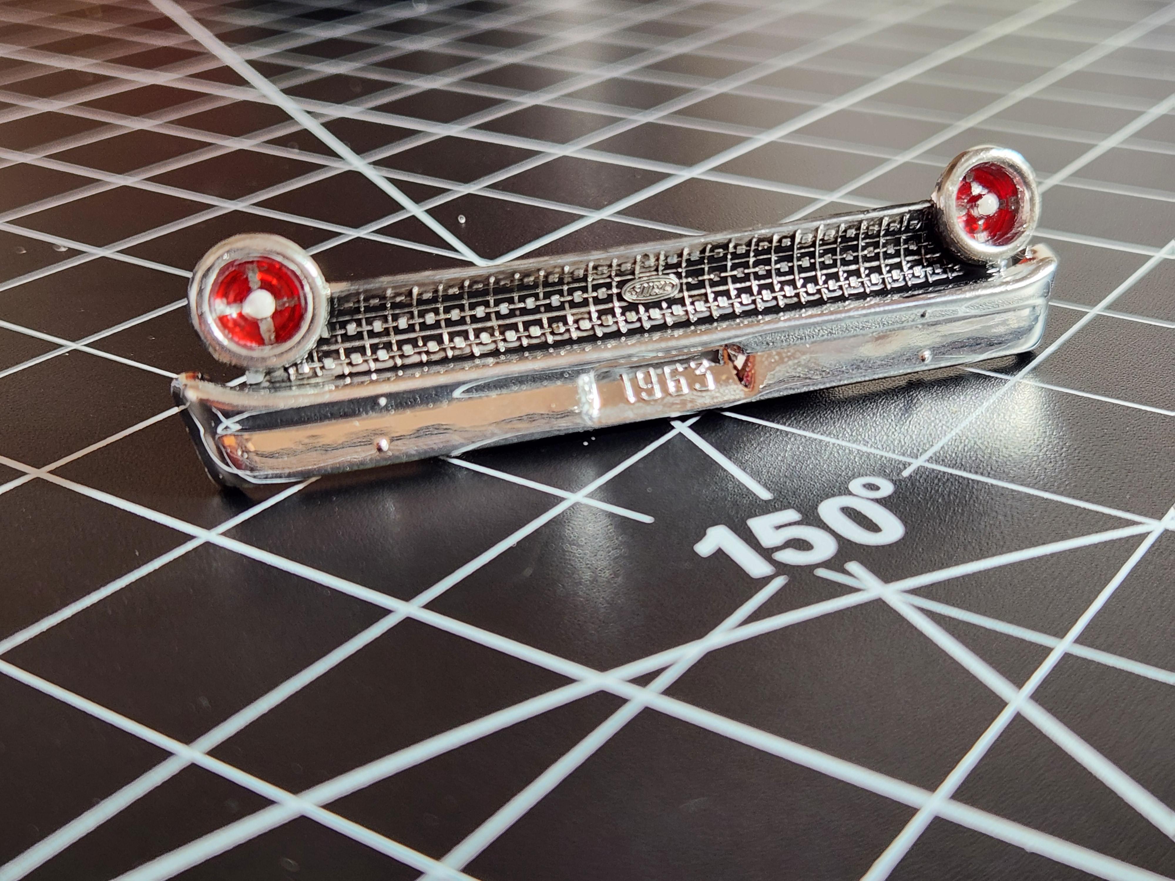

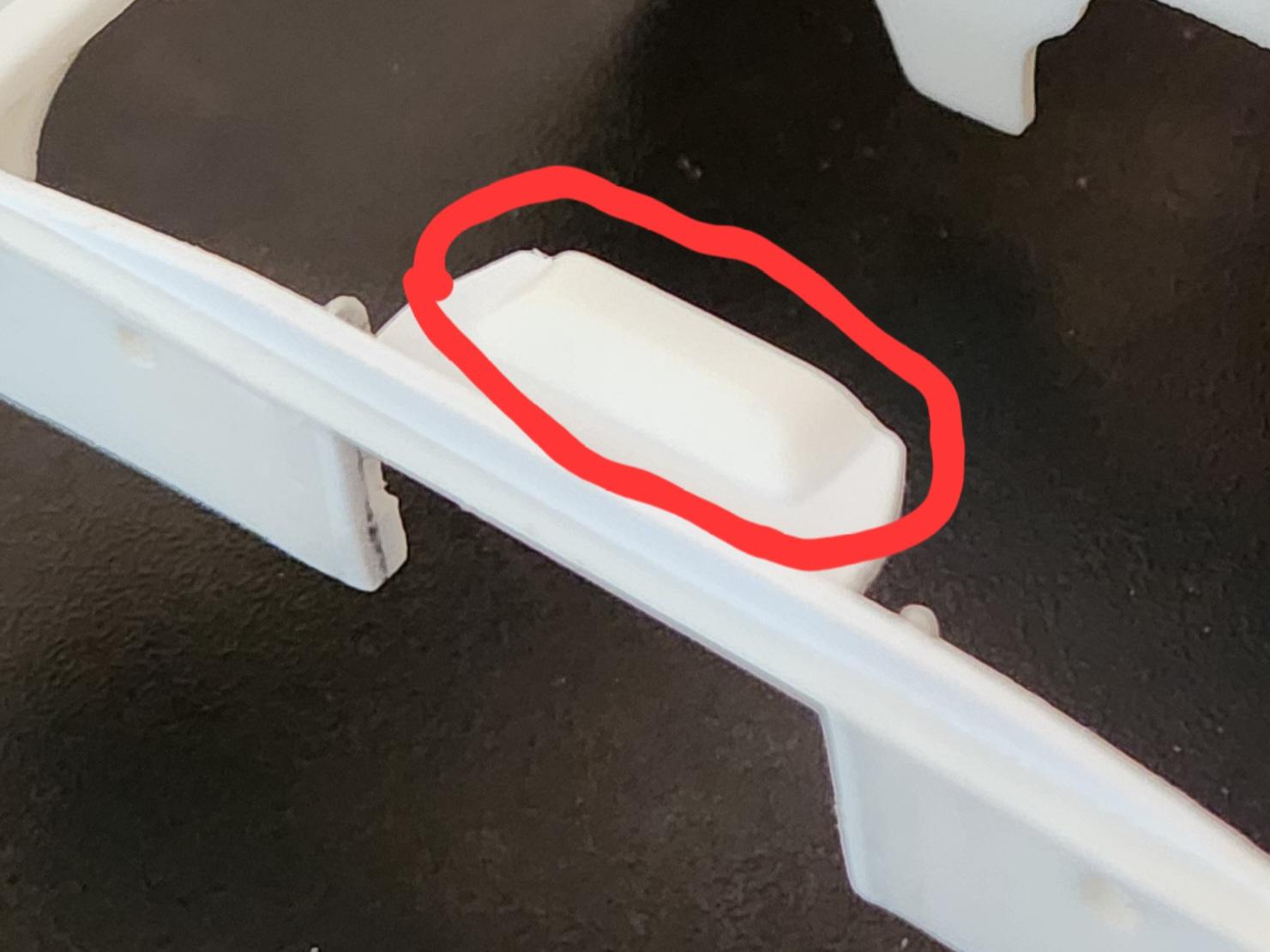

I also took Dennis's (dino246gt) advice and thinned down the tail light bezels. Then I detailed the lenses with the little crosses and the reverse light.20250808_144528.jpg.3a6d7adc73040153264478ac722650d5.jpg20250808_161531.jpg.e82701da4e5891ea8699775cd8447021.jpg
Now to the chassis and engine. On the chassis I carved out the space inbetween the frame rails and leaf springs to give the ilusion that they are Seperately applied springs.20250808_161552.jpg.7e5770120a29109a0ffefea75ba79147.jpg20250808_161608.jpg.36ee7e83d8d31230fce182985642947d.jpg

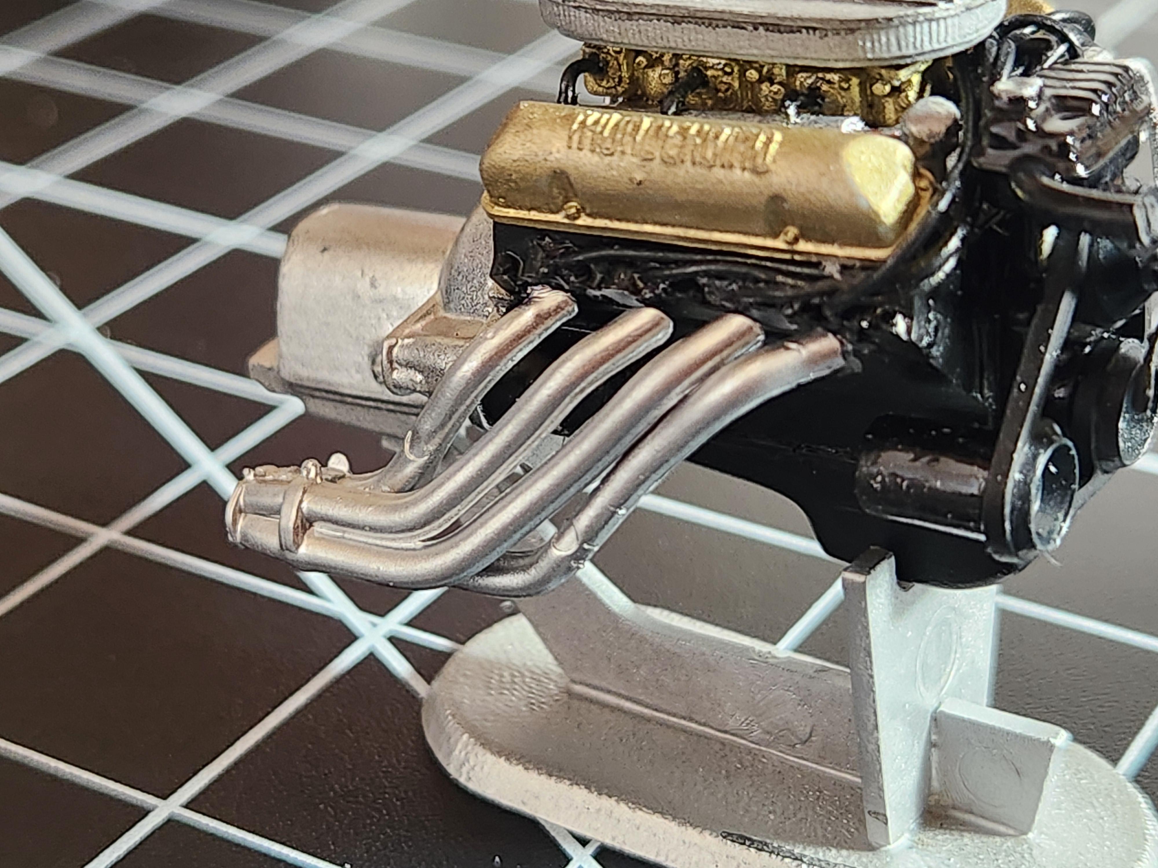

I wanted some long tube headers to make it a little bit more of a hot rod. They are modified ones from the amt 69 gtx.20250808_160013.jpg.d36ac997366125fe80772ec770407d6f.jpg

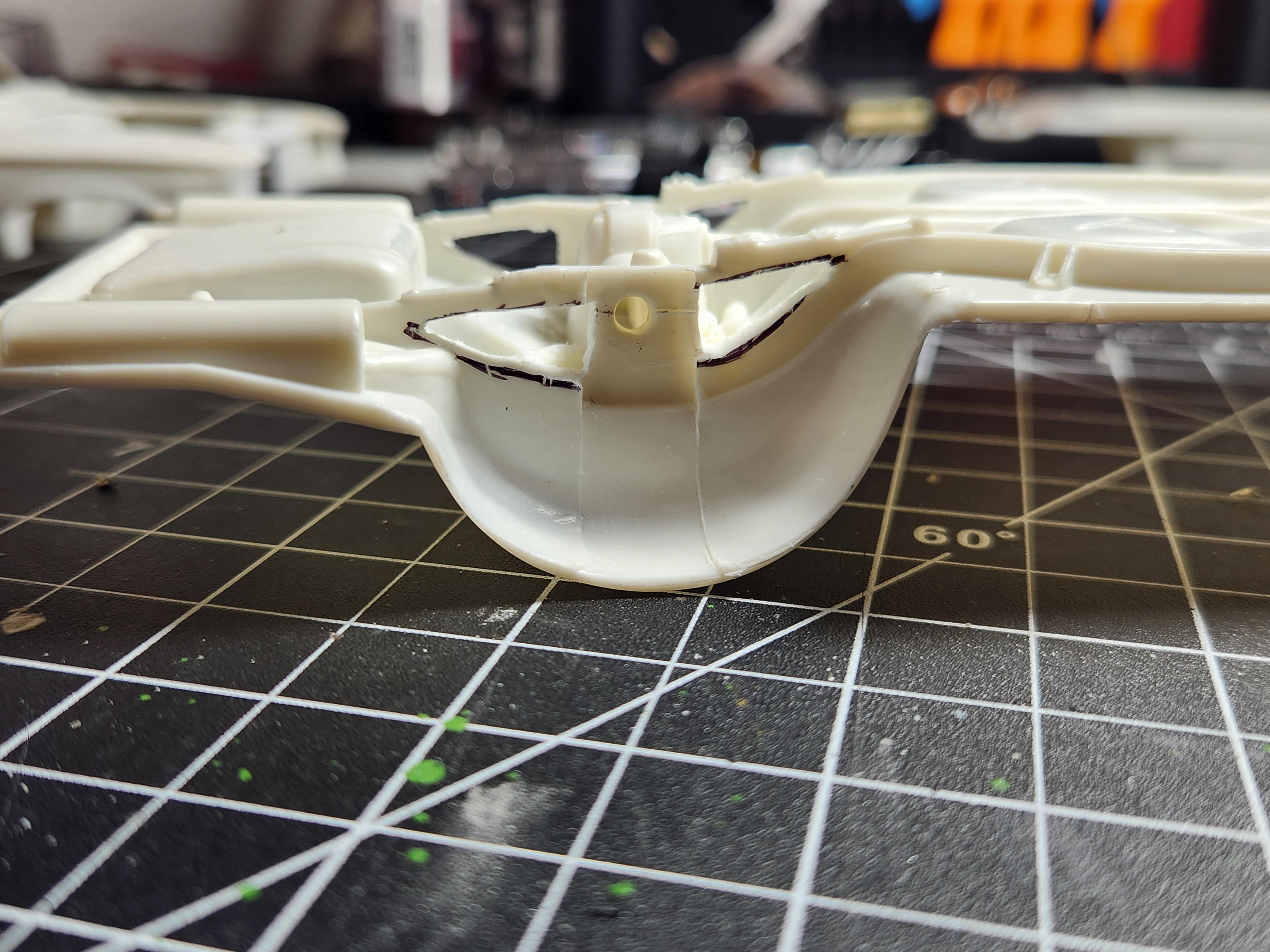

I got a junk 64 Thunderbolt hood from a parts lot. Ive always loved the way teardrop hoods look on fords. So I carved the scoop out of the Tbolt hood and traced it onto the 63s hood.20250818_151220.jpg.fb51254cd14f36f1c7d53865aca5edb1.jpg20250818_151240.jpg.c5dfb62b74d3412c16867c251cc8cd5b.jpg
Next thing to do was to mark out the area that will be opened up. Then drill it out and check.20250818_151947.jpg.ae0c41596433f39b637455785ee8ead8.jpg20250818_153134.jpg.e7a9daaf7bae75786dd476f38692af72.jpg
Then I glued the scoop to the hood and carved out the mesh area. I also had to carve the opening to make sure it was flush with the scoop.20250818_165117.jpg.c4a6e394ad5fa98247e89cd14cfac34b.jpg20250818_165146.jpg.ff6bc22a83fa2c3746edd64ad80dc904.jpg
After some filling, sanding, filling, and some more sanding it was ready for a test shot of primer.20250818_174456.jpg.a90526b9d9cae7197084f45397a91cf7.jpg
After the imperfections were showed with the test shot I had to do yet again more sanding and filling. One last shot of primer and I am happy with how it looks.20250819_084455.jpg.da95aee87253ab6f4f93a6be7ed7b188.jpg20250819_084503.jpg.6491185b2c14faa2c9a35a48f3e8621c.jpg20250819_084437.jpg.58f31eb85f30f919ba04e57bc40efe31.jpg

Great job on the rear tail lights. Looks way better. Those mopar headers are pretty universal. I’ve used them on many builds. They fit easily in many engine bays.
  • Like 1
Thanks! I knew there was something wrong with the kit ones so looked up a photo and sure enough, there are chrome cross bars.
