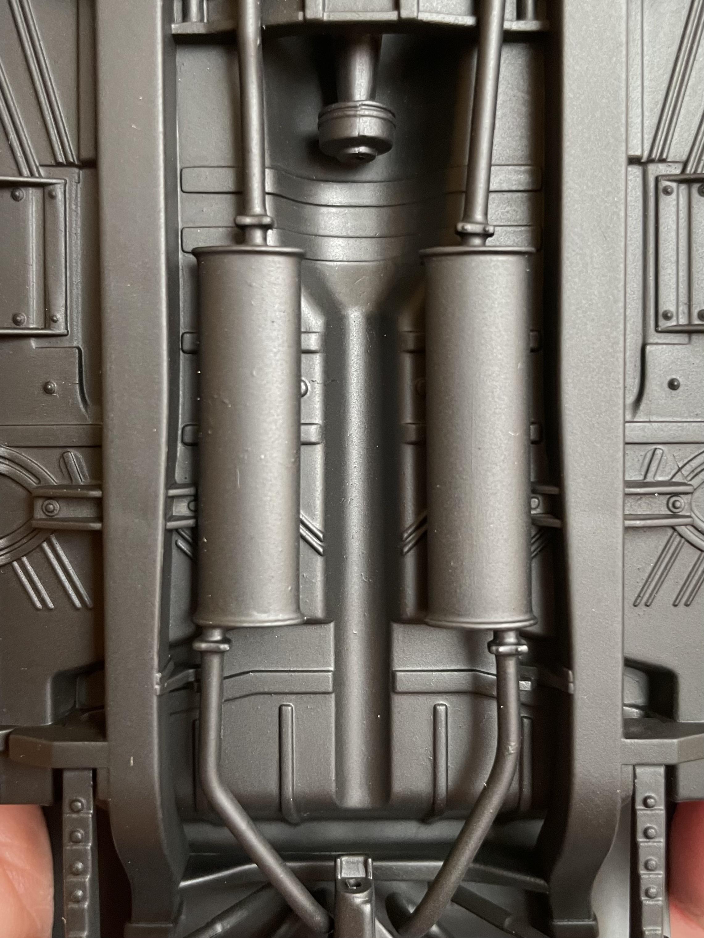

I opted for the "old" headers that were left over from the Rat Roaster version. They were attached to the engine as an assembly because I didn't follow the instructions. I pinned them to the block and the tie-ins for the muffler system would not line up. I made bosses from aluminum tube to mate the headers to the pipes. I fish-mouthed the tubing with a round riffler file and they are just glued  to the pipes. I can leave them that way or I may try to put a CA "weld bead" at the headers and then Molotow the joints and bosses

I thought about adding levers and cables to the bosses to emulate cut-outs but....nah.
