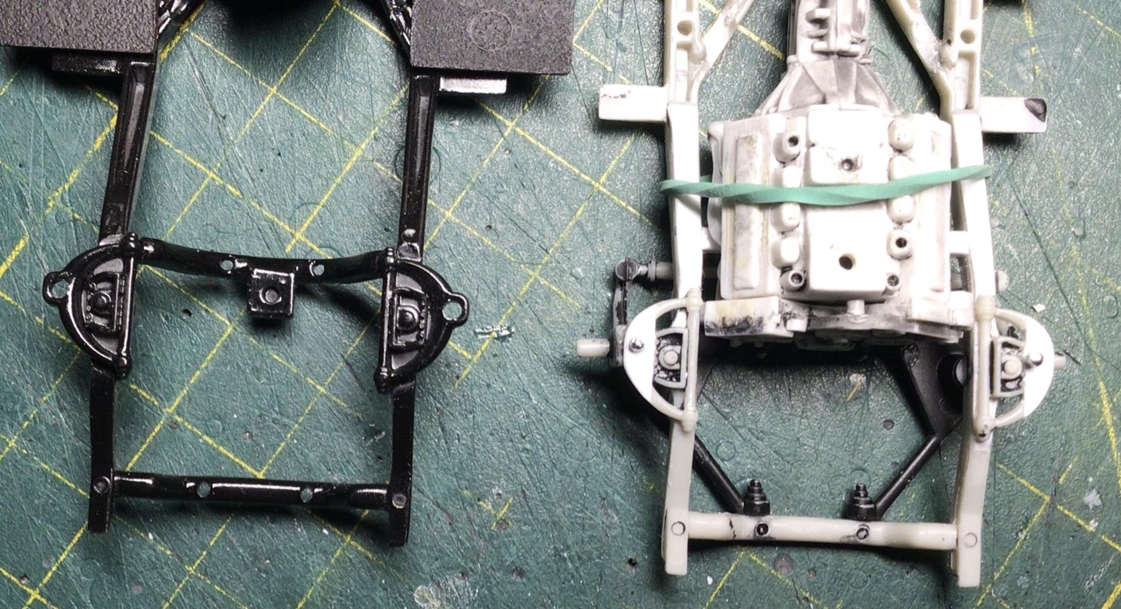

I am currently working on the Revell-Mono 69 Dodge Coronet Super Bee.
One of my goals for this build was to give it some nice rake, and wider tires all around.
The width of the kits front K-member to the spindle locations, would not allow me to use another tire choice without modification. The outside of the tires were all the way up against the inside fenderwell, and would not allow for any steering movement at all.
I have since narrowed the front tire track, and I'm attempting to rebuild the front suspension, but I have ran into the issue of not having adequate A-arms.
For a size reference, the A-arms in the photo belong to a 58 Edsel Pacer kit. The straight pins in the photos are located in what will be the lower spindle pivot point.
My issue is having decent looking A-arms with such a narrow wheel track.
Is there a source for tubular 'performance' style upper and lower A-arms out there that does not require raiding another perfectly good kit?  With prices these days, I can't afford to render another kit useless for 4 parts. I don't mind attempting to scratchbuild, but I would def need a good tutorial.

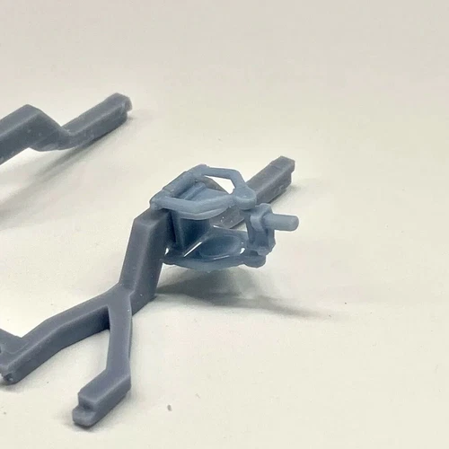

46 minutes ago, Ace-Garageguy said:
eBay is a good source for what you need, both 3D-printed and kit-sourced.
Just enter "1/25 scale front suspension" in the search area.
One printed example right now:
https://www.ebay.com/itm/363702408956?

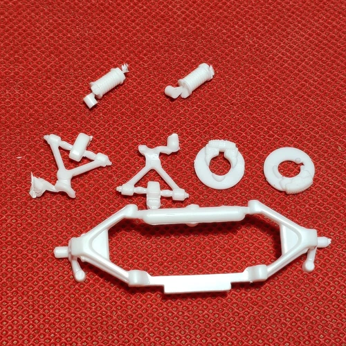

One current kit-sourced example:
https://www.ebay.com/itm/156830350950?
Independent Front End Hot Rod 1937 Ford 1:24 scale model car part Lindberg - Picture 1 of 6
I actually purchased the items in the top photo, and they were much too wide. They were actually wider than the kit parts.  I need something with a much narrower wheel track.
If it means anything, even the steering arm from the Revell 68/69 Charger, will have to be modified, due too excessive toe-in.
19 minutes ago, SpeedAndViolence said:
Thank you.
Useless info: I actually purchased the A-arms in the top photo, but they are much to wide.
I searched on feeEbay using every combination of terminology, but was not getting anything like the bottom photo. So thank you.

How odd. Here's another one.
https://www.ebay.com/itm/286518404371?      Picture 1 of 9
Anyway, you don't narrow the track on an IFS vehicle by getting tiny little short control arms that can't possibly provide proper suspension geometry. It is often necessary to narrow the distance between control arm pickup points so as to work with aftermarket control arms that are based on something like the popular Mustang II geometry, and that sometimes requires the frame rails themselves to be narrowed. Aftermarket real-car frames or subframes often incorporate this requirement from the get-go. Aftermarket crossmembers that are set-up for tubular control arms (again, very often based on Mustang II geometry) will include a nominal track-width measurement with a particular wheel offset (if they're from any kind of competently-engineered source, anyway) so the car builder can determine in advance how much frame surgery, if any, might be required to allow full steering lock, etc.
