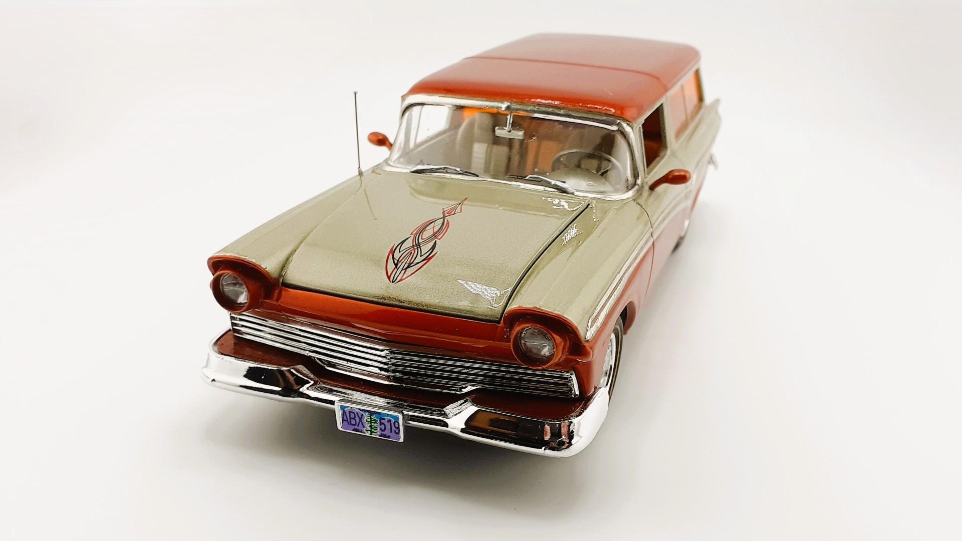

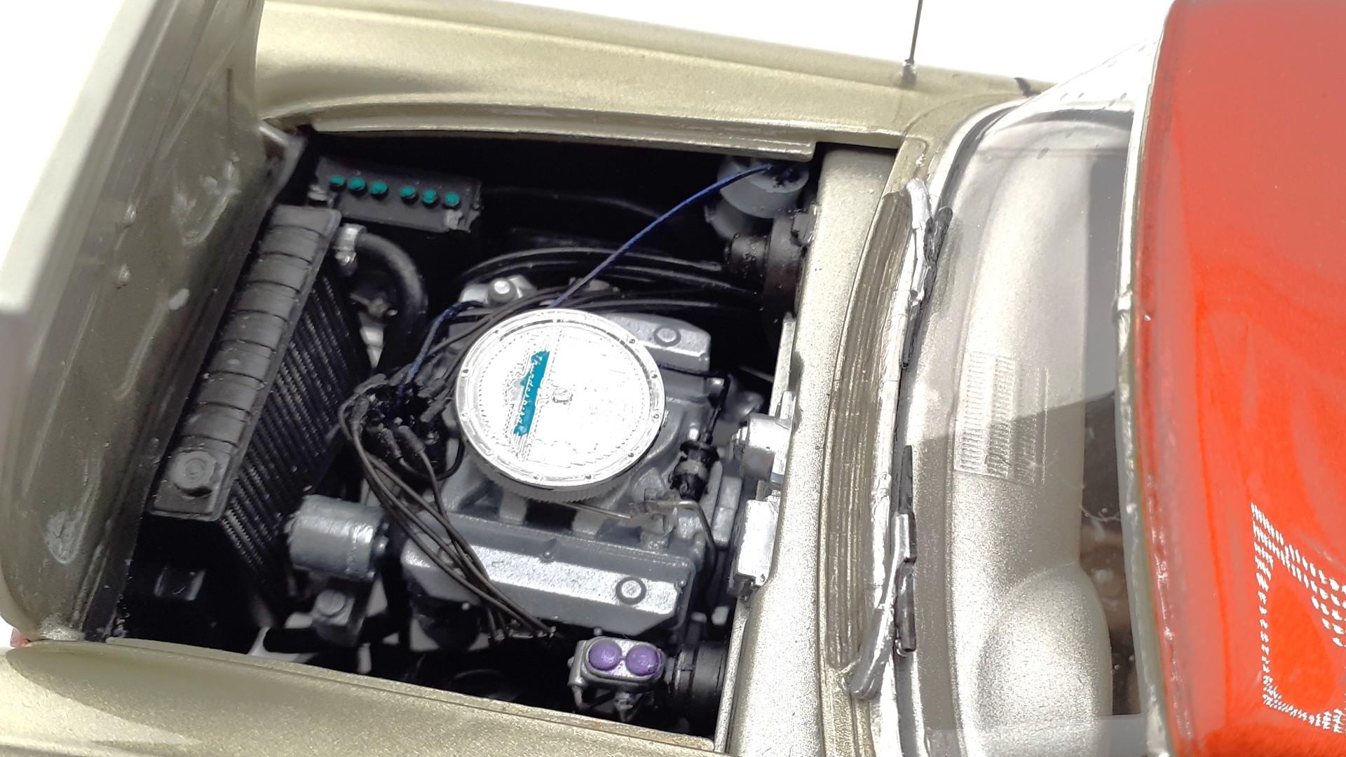

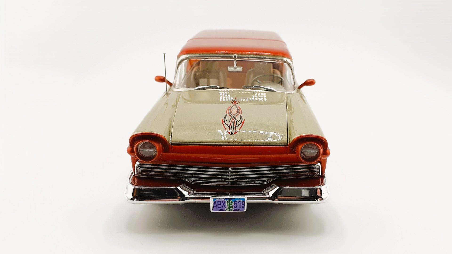

Finally finished this up.  I just need to work a little more on the closure of the hood.  It closes and slightly pops open.  May need to add a magnet.  We’ll see.

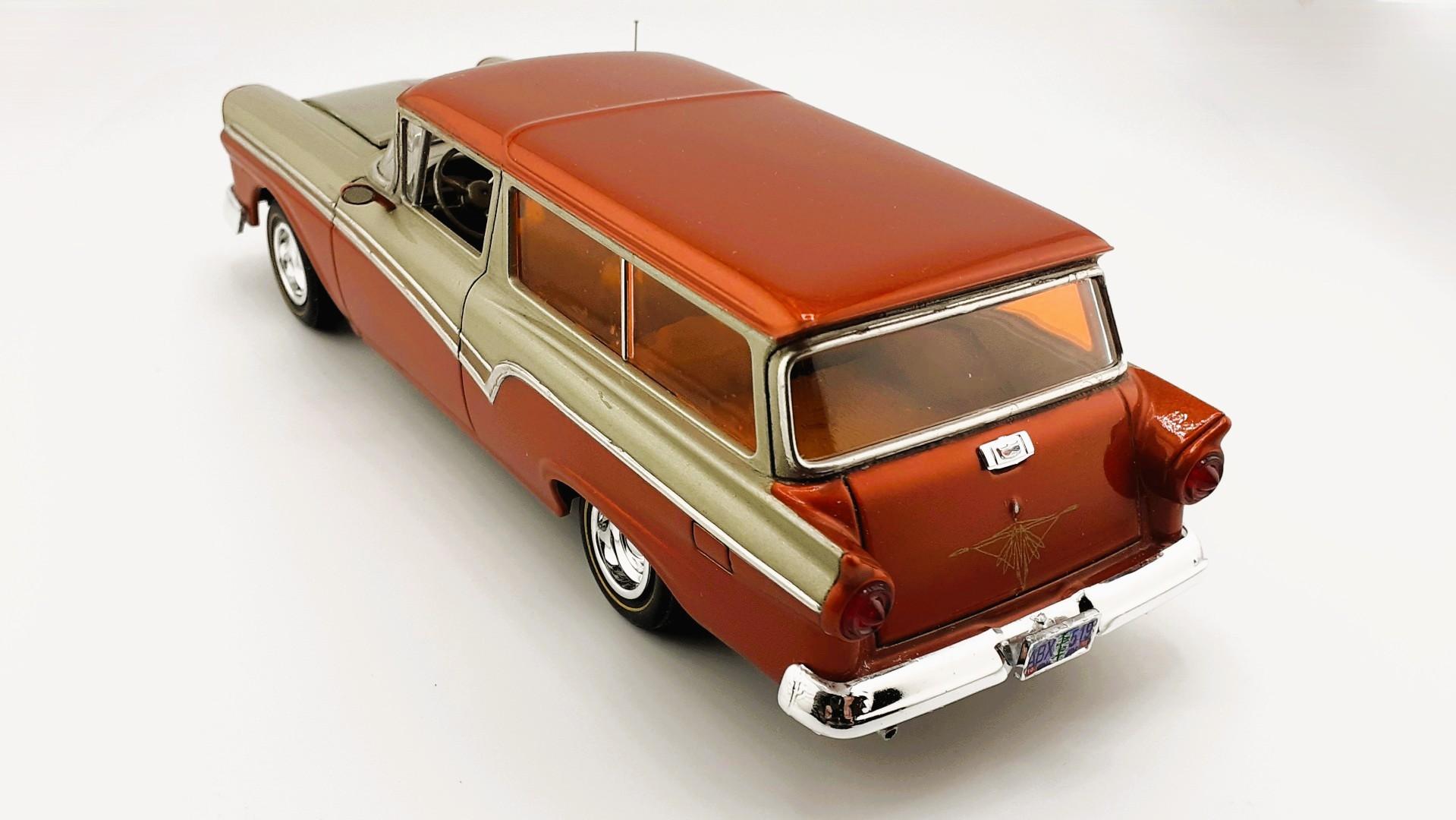

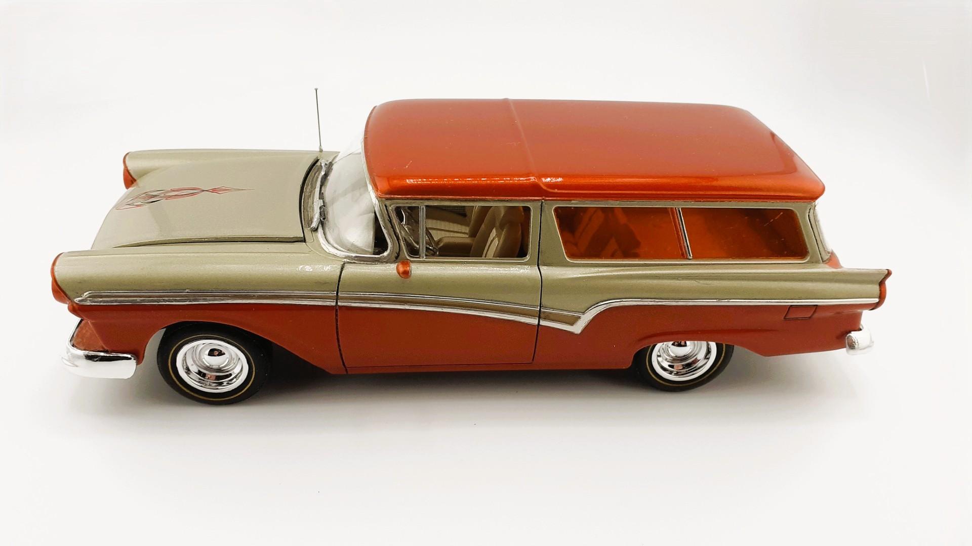

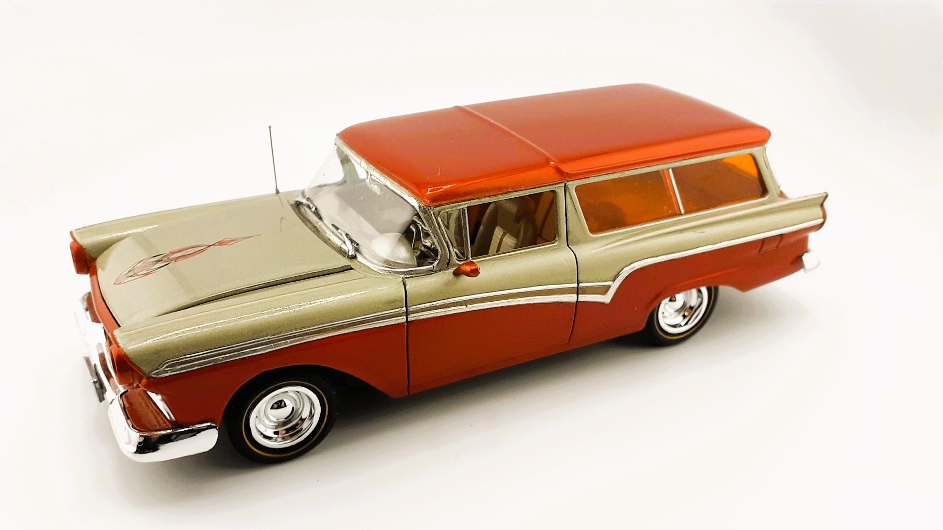

Anyway, this is sort of a customized street machine.  Some body mods done like shaved door handles and kit custom bumpers and grill.  Here is what else I did:

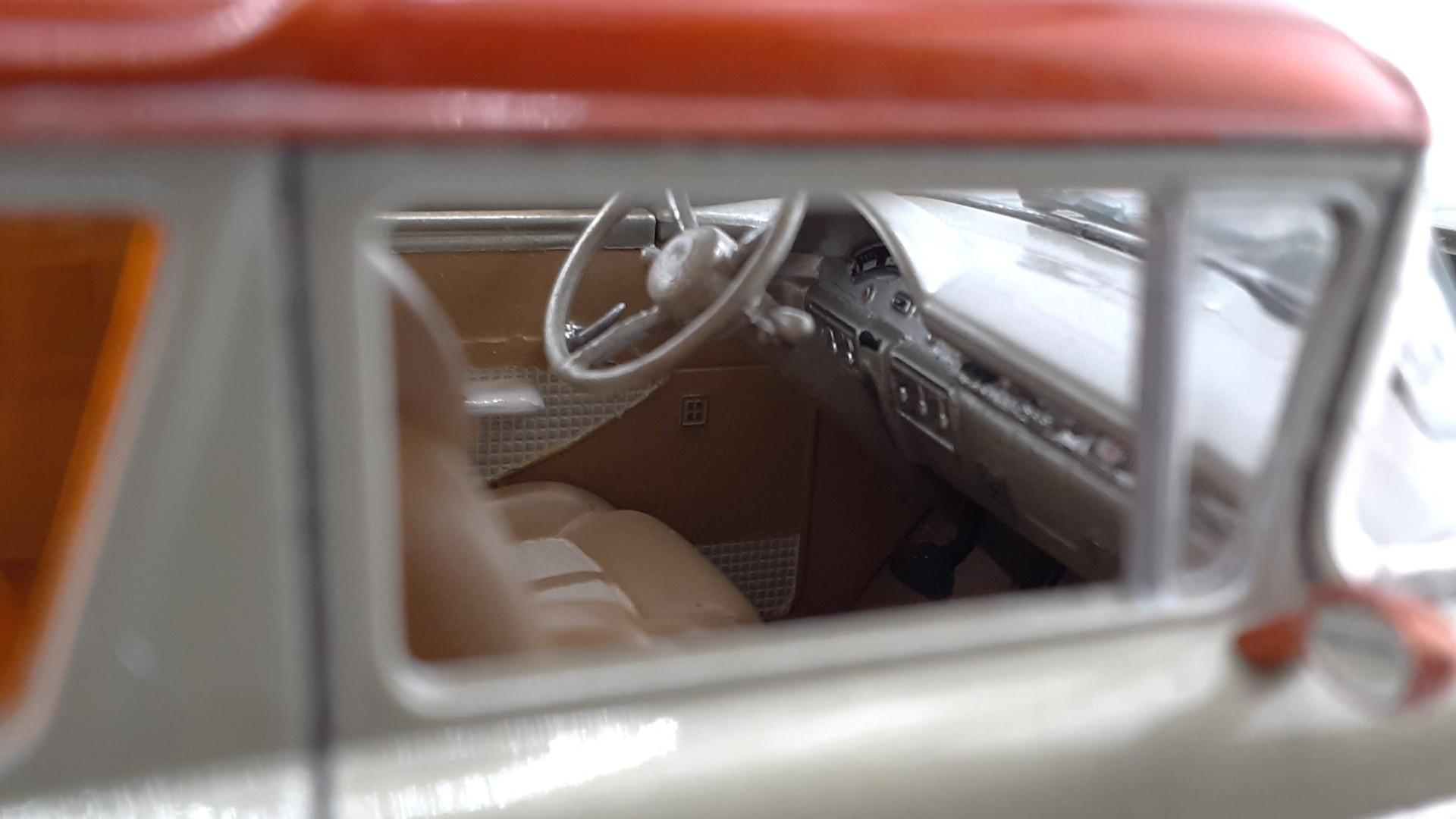

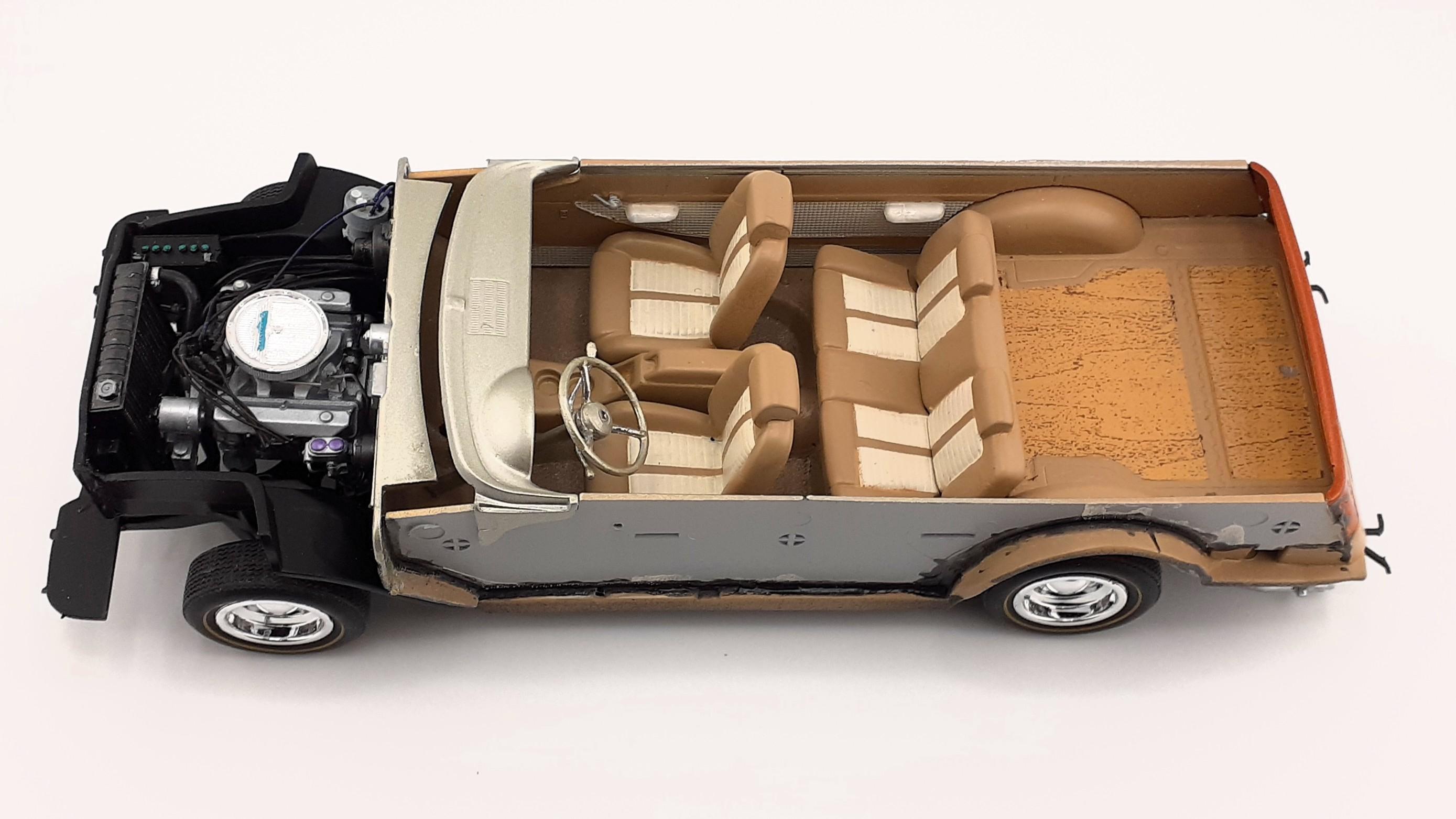

  • Customized the interior with Grommet Ring Front and Rear Set from Texas 3D customs.

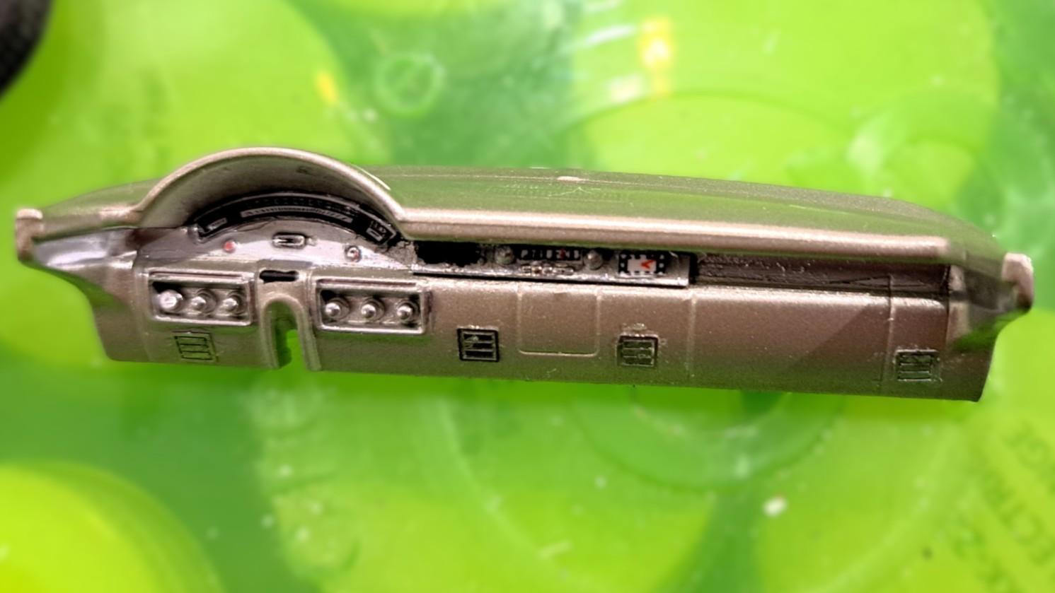

  • Cannibalized a spare AMT 57 Ford Fairlane dash with the Revell to get more detail and added air conditioning vents.
  • Added a steering column with turn signal and gear selection.
  • Added wood graining to the cargo area using Microscale decals.
  • Added aftermarket inside door hardware.

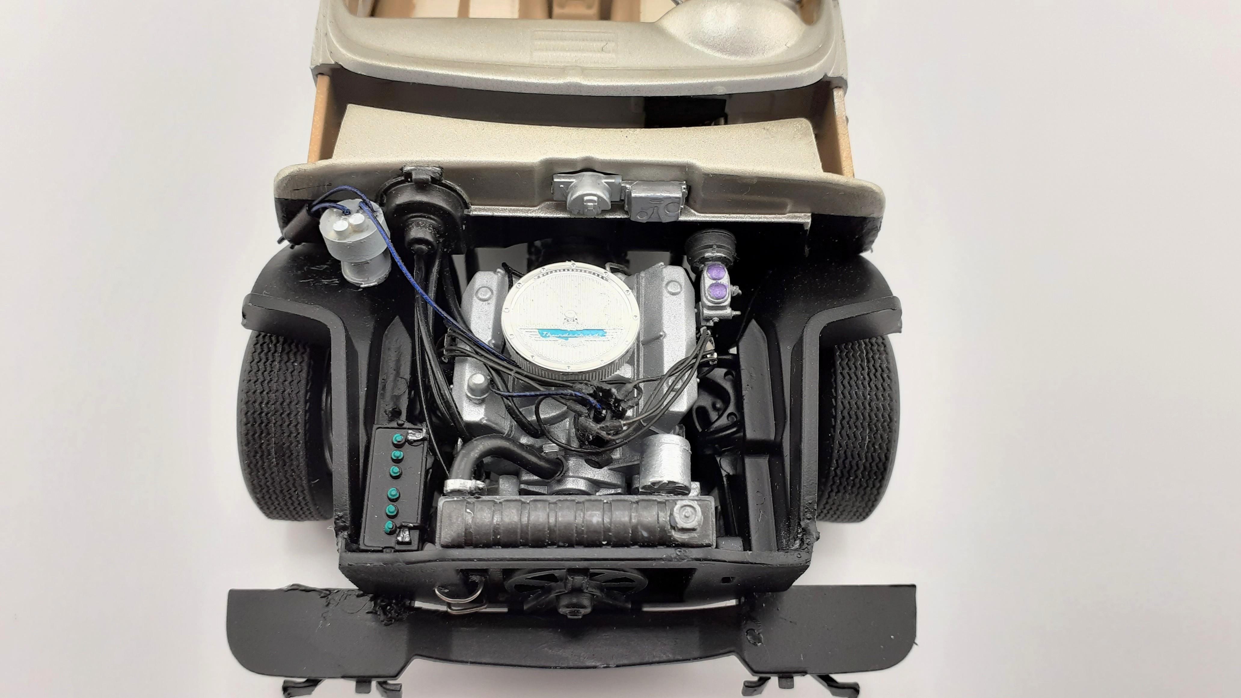

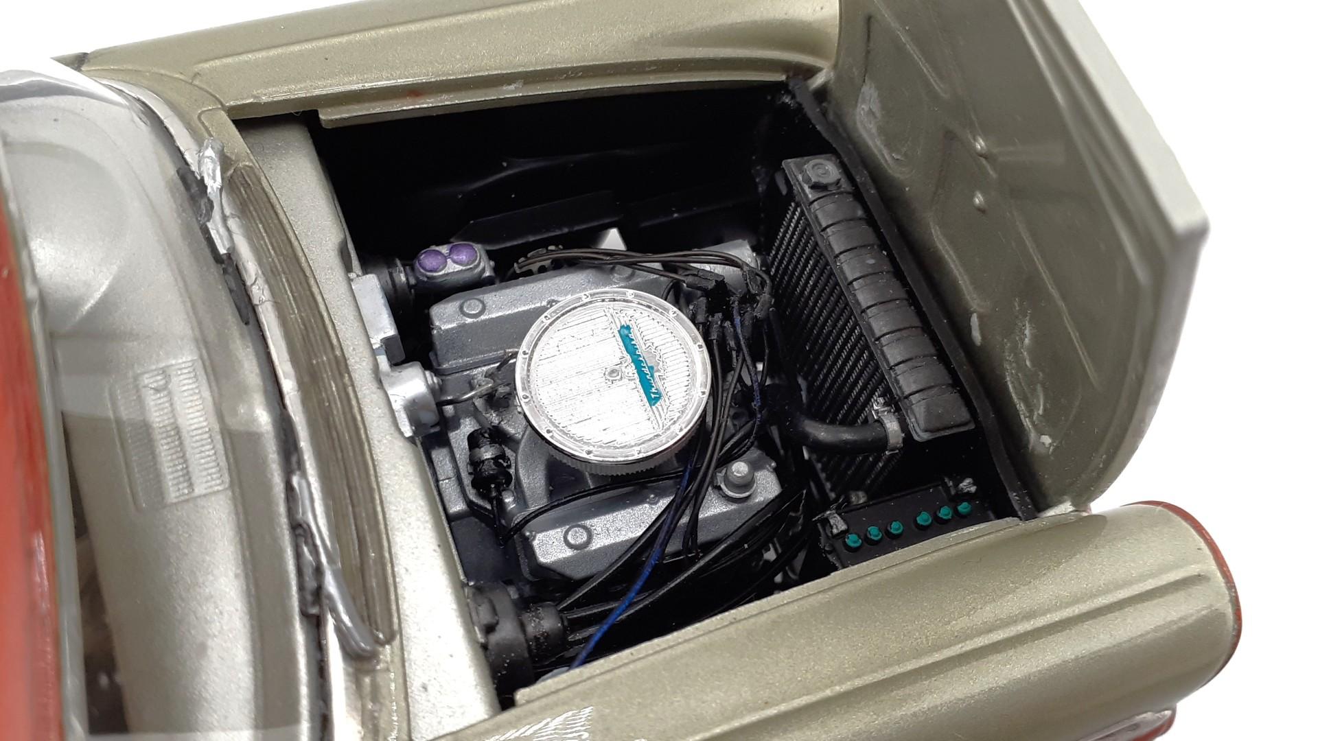

  • Wired and plumbed the engine and engine bay.  Added a Fireball Modelworks FITech FI system to an AMT 427 engine replacing the Y block Ford with the kit.  Had to modify the radiator hoses for the new engine and added a modern power brake unit.

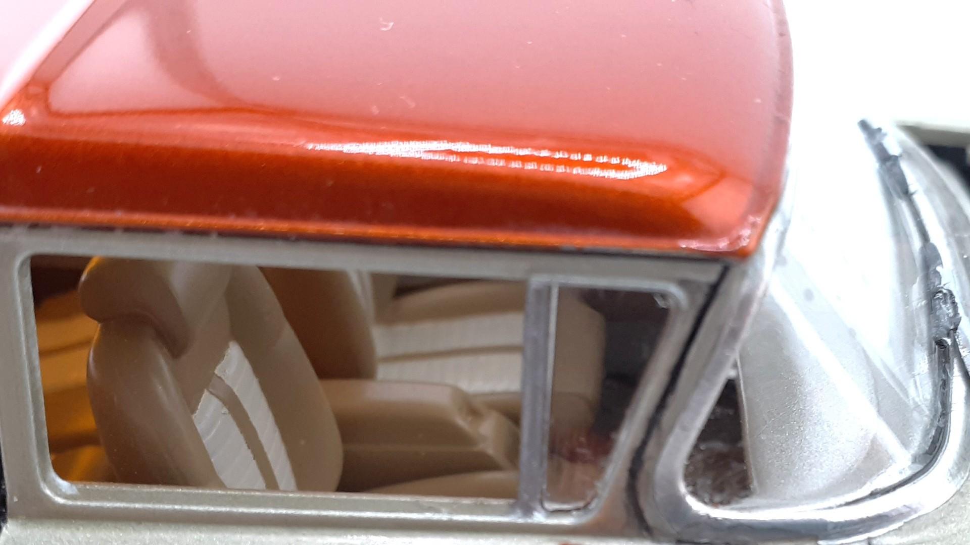

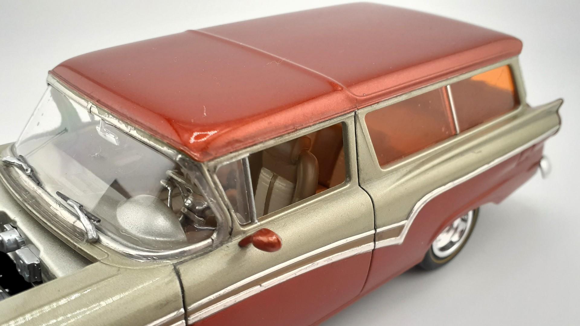

  • Added Hasegawa Clear Orange Finish to the rear side windows for tinting.
  • Used AMT Parts Pack Gold Stripe tires with parts box Chrome Reverse wheels.  Added valve stems to wheels.
  • Did a two-tone paint with Tamiya Metallic Orange and Platinum Gold.  Cleared with Tamiya TS-13 Clear.  During the clearing process, I added some pin stripe decals.

This thing needs way more dents and dings, its an Oregon driver. Haha! Nice work bud, love the color choice.
