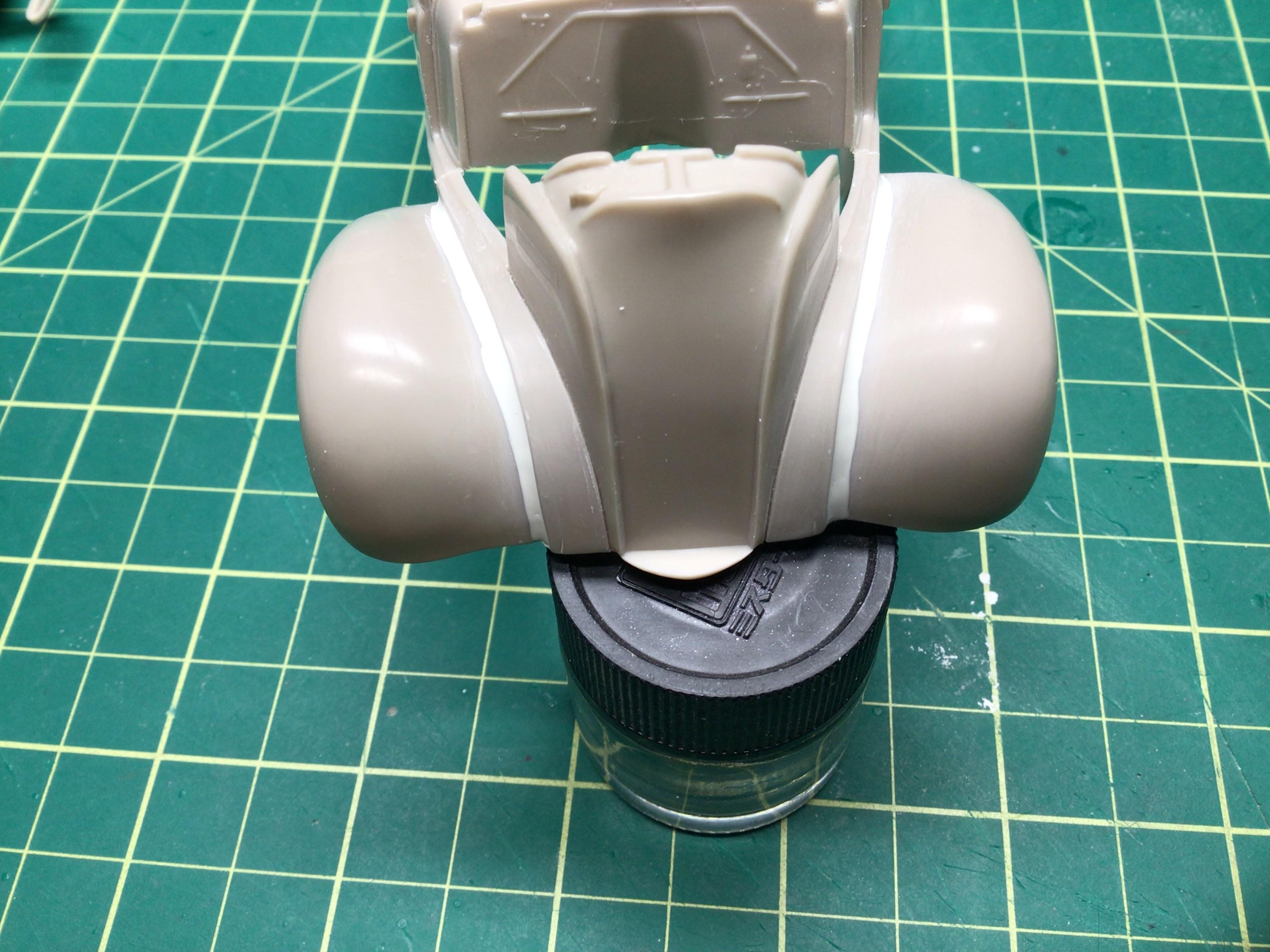

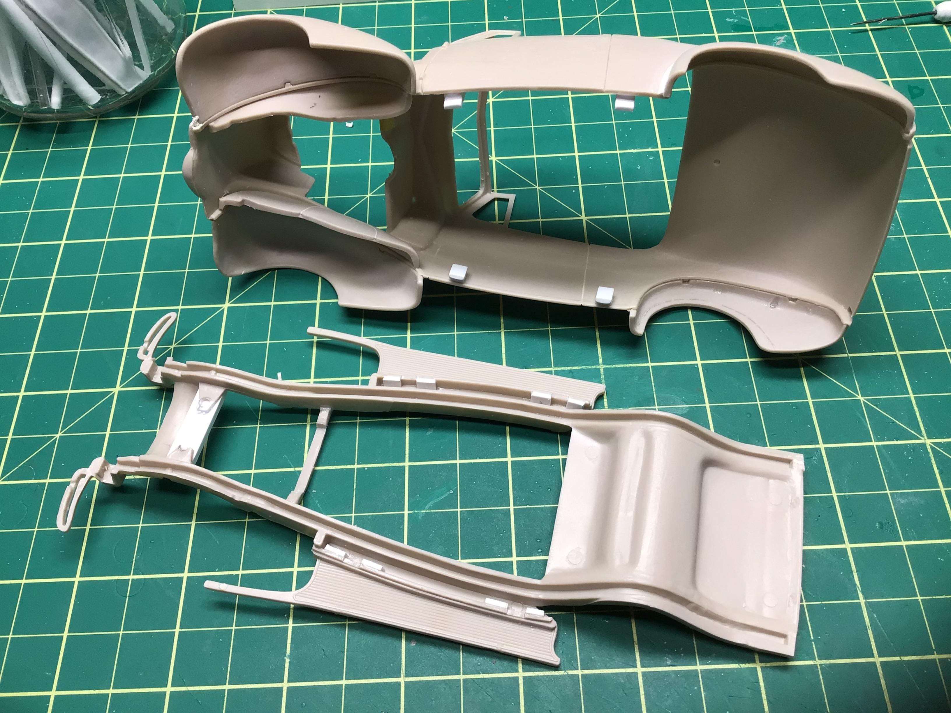

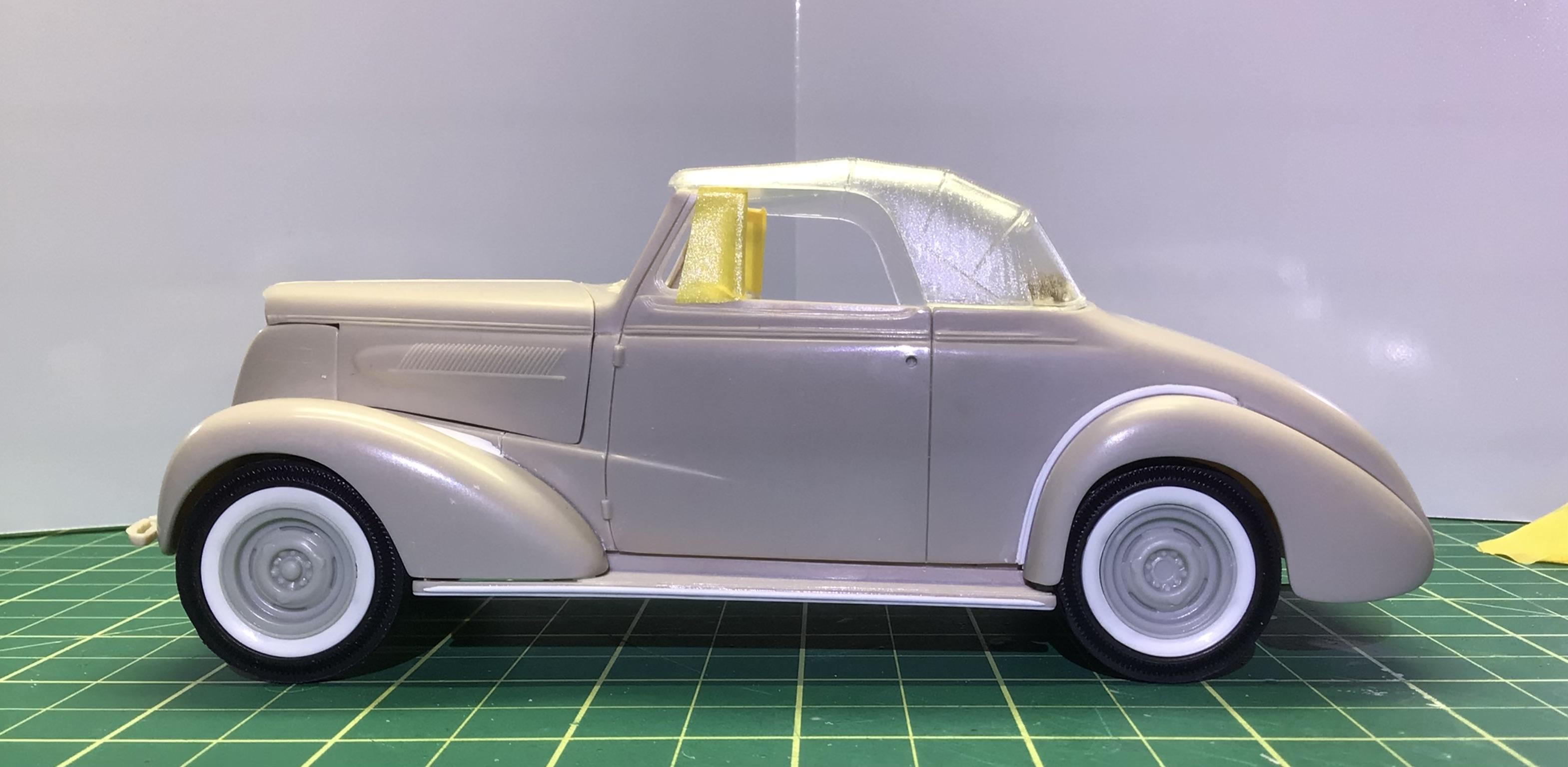

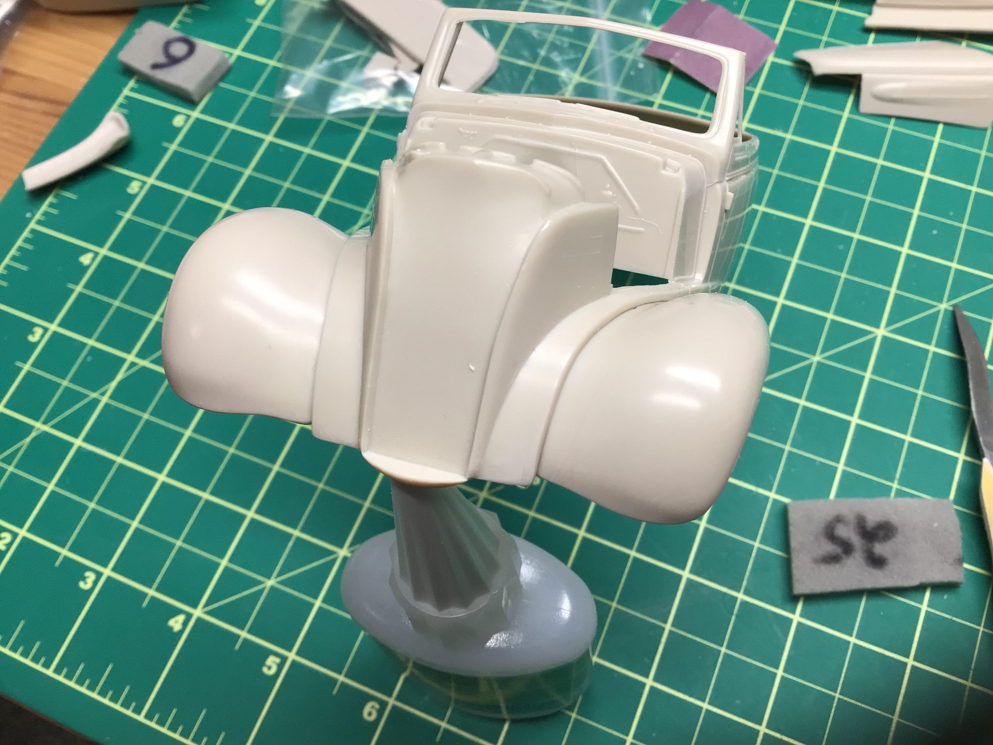

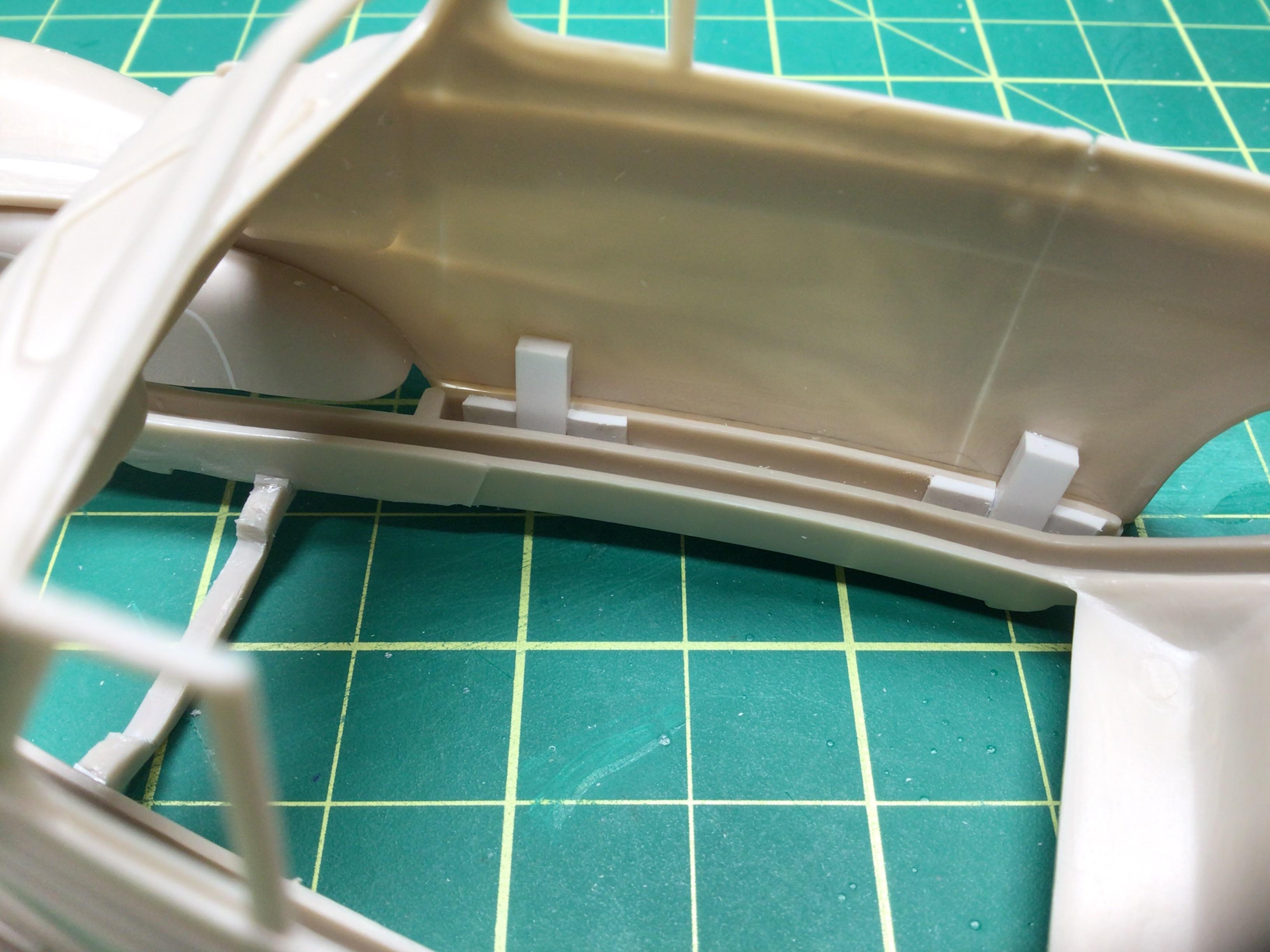

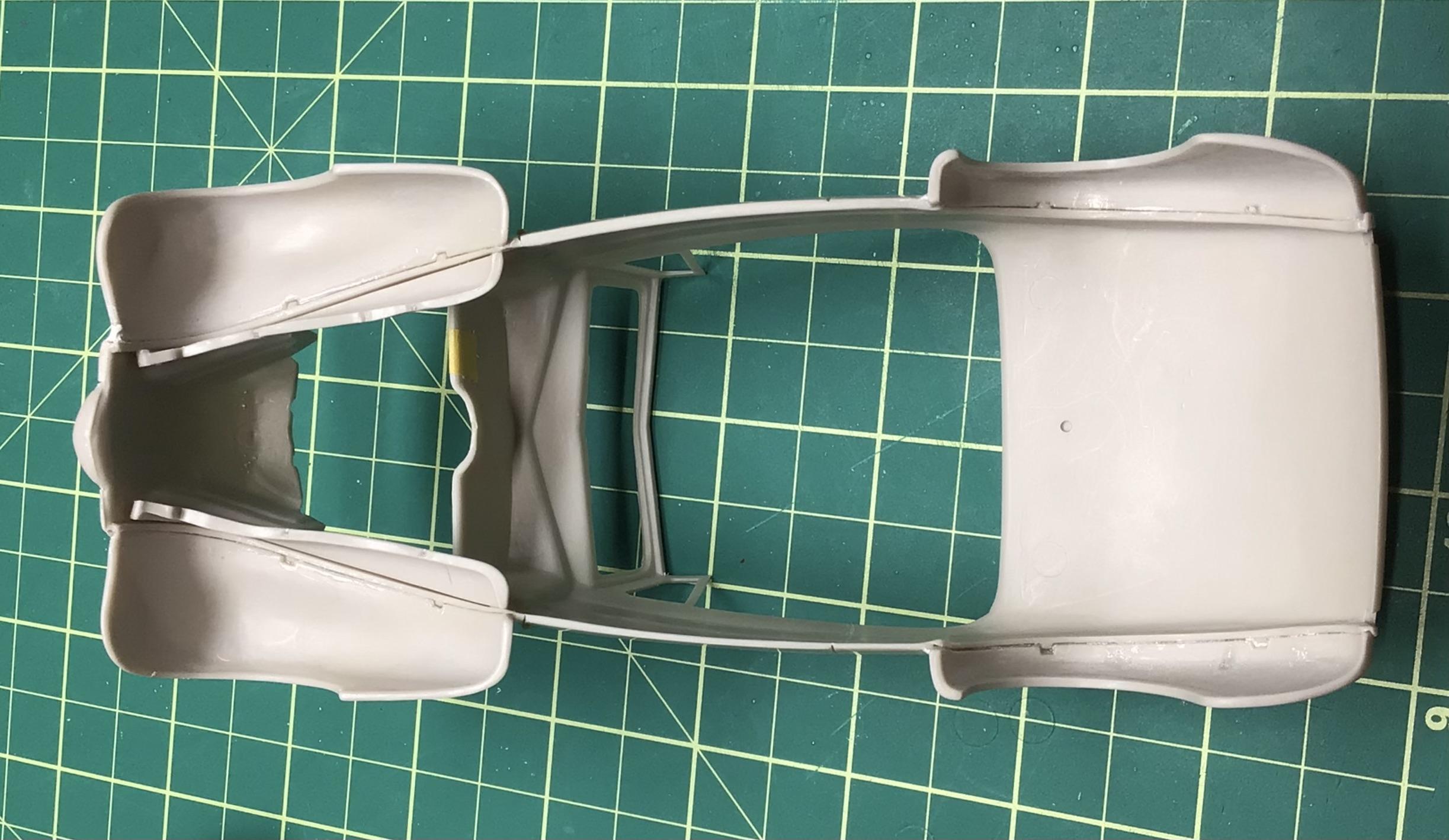

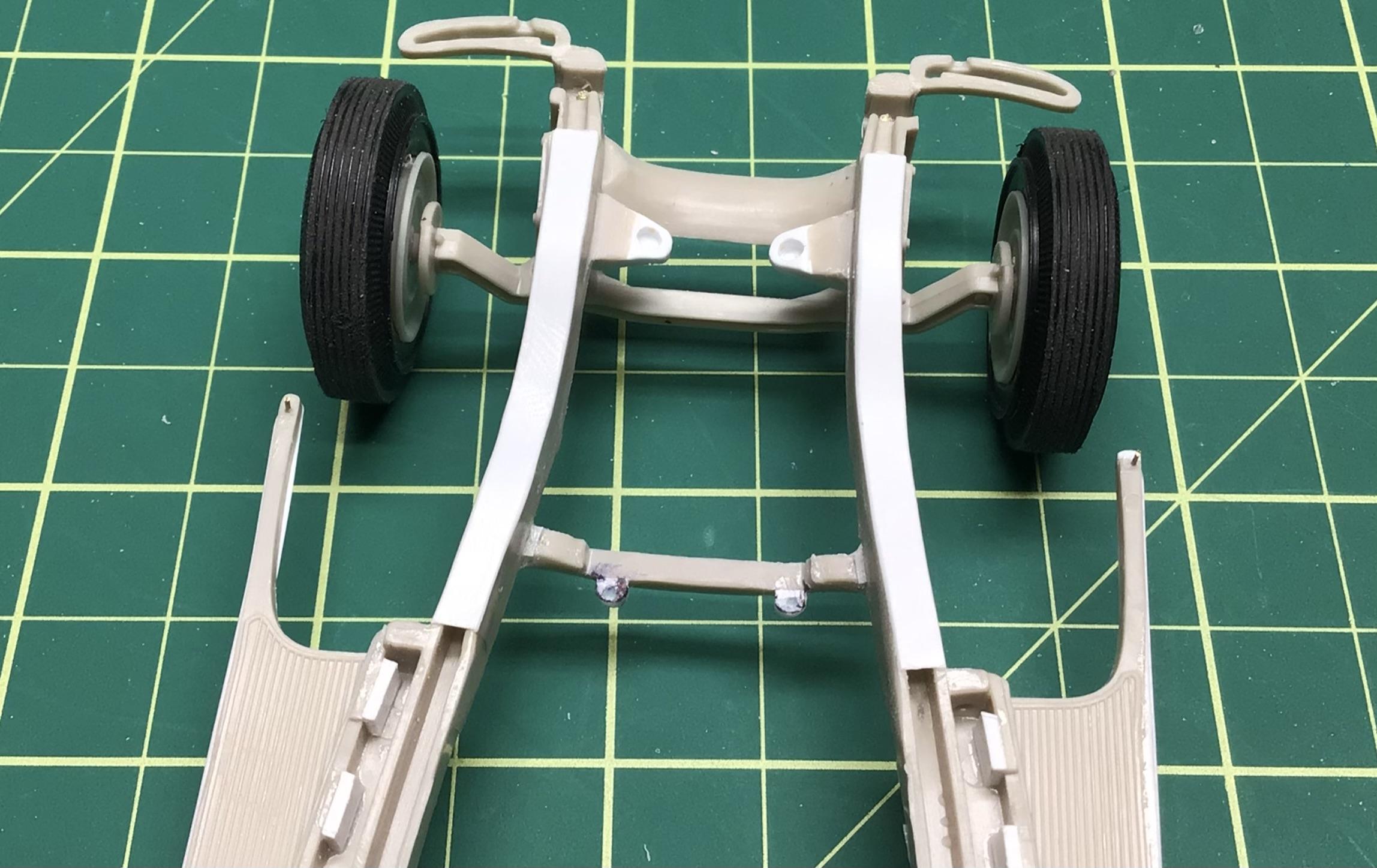

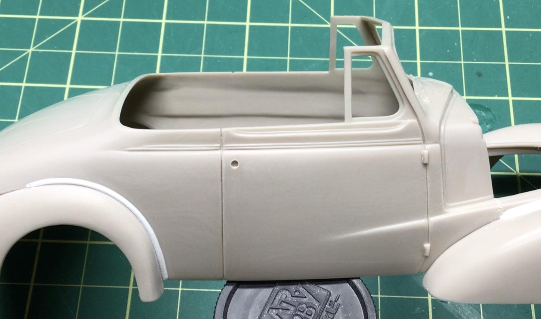

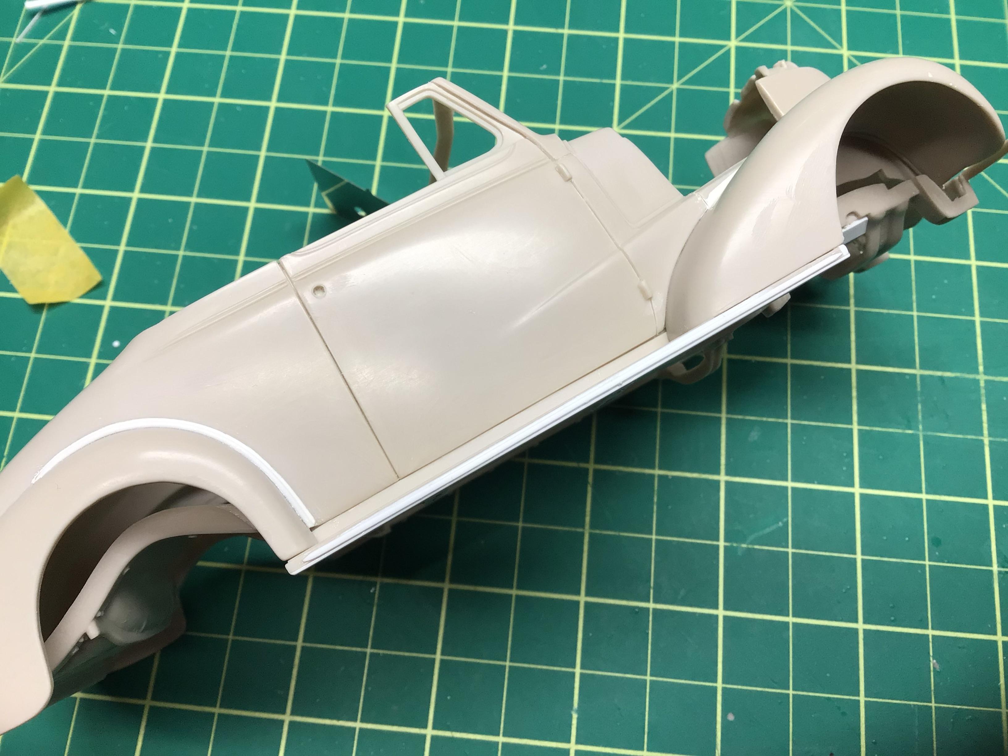

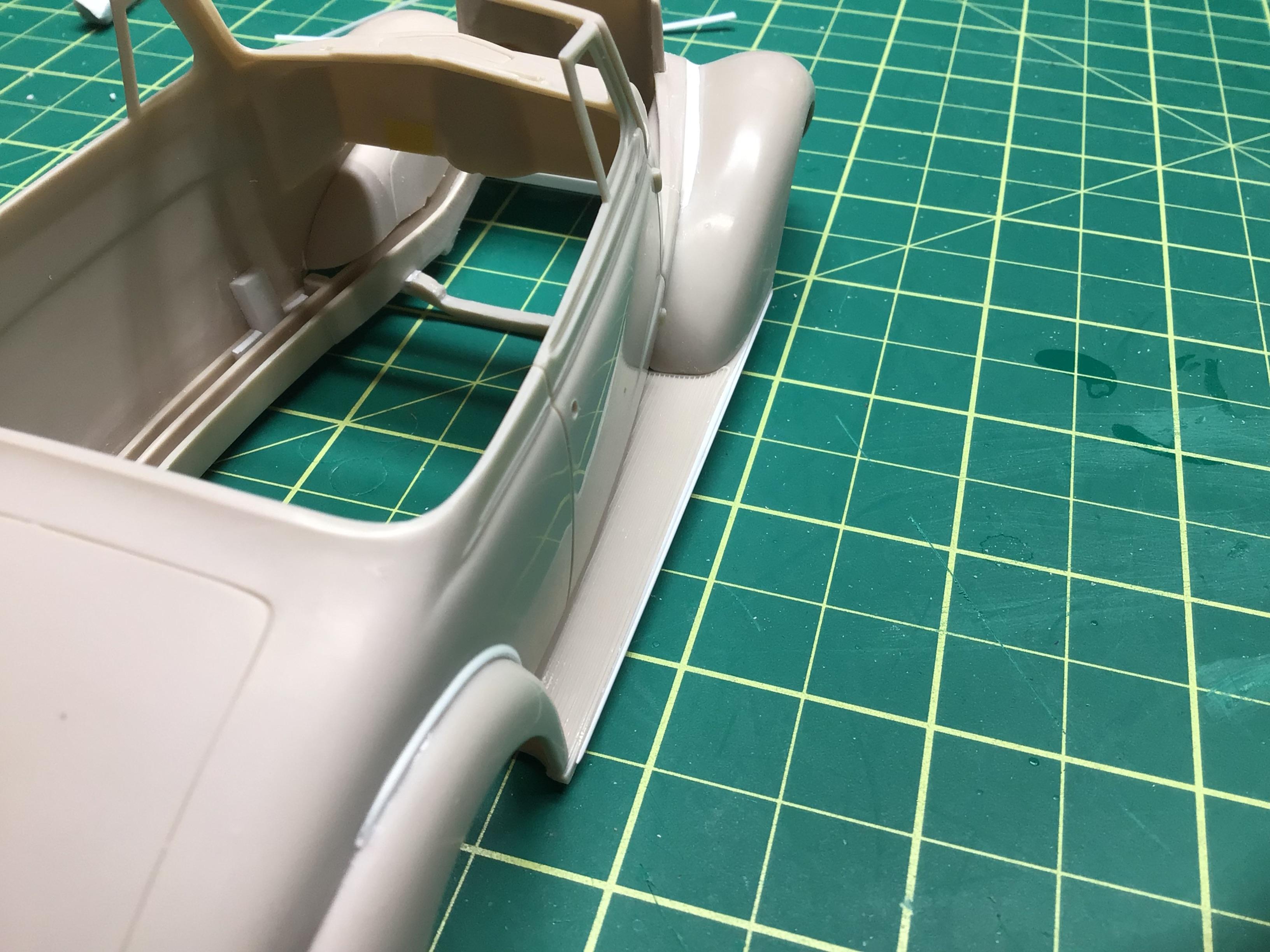

NOBLNG Posted Sunday at 06:42 PM Posted Sunday at 06:42 PM (edited) There are precious few early Chevys portrayed here, so when a club member offered this up for $5 I jumped on it.😬 It’s obviously not a great kit…but it does have potential I think with a bit of detailing. Edit: Little interest is no wonder…that is pretty pathetic box art!😳 I glued the fenders and inner fenders onto the body. And typical of older AMT kits, one side is waaaay thicker than the other.🥴 A first thing I need to address is the poor mounting of the body to frame/running boards….no more iffy location going forward.😜 Another thing I want to address is the running boards. The outer edges should be dead straight and not have a bulge approaching the front fender. So I filed them straight. I had to add some material to the passenger side to get there.🥵 And I added the chrome trim along the edge from .030” half round, as well as the missing bead that should go halfway around the rear fender. Edited Sunday at 08:59 PM by NOBLNG 6

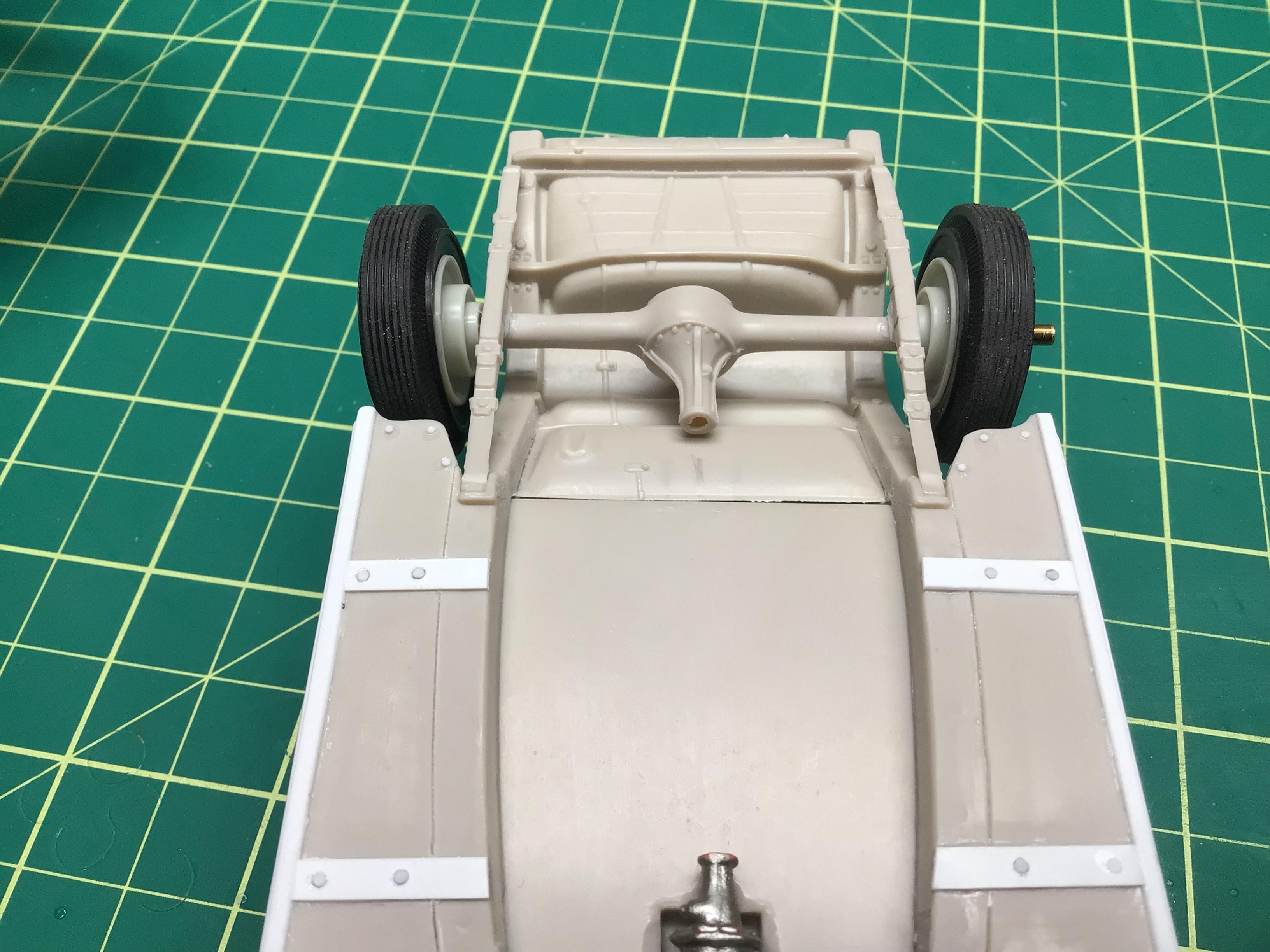

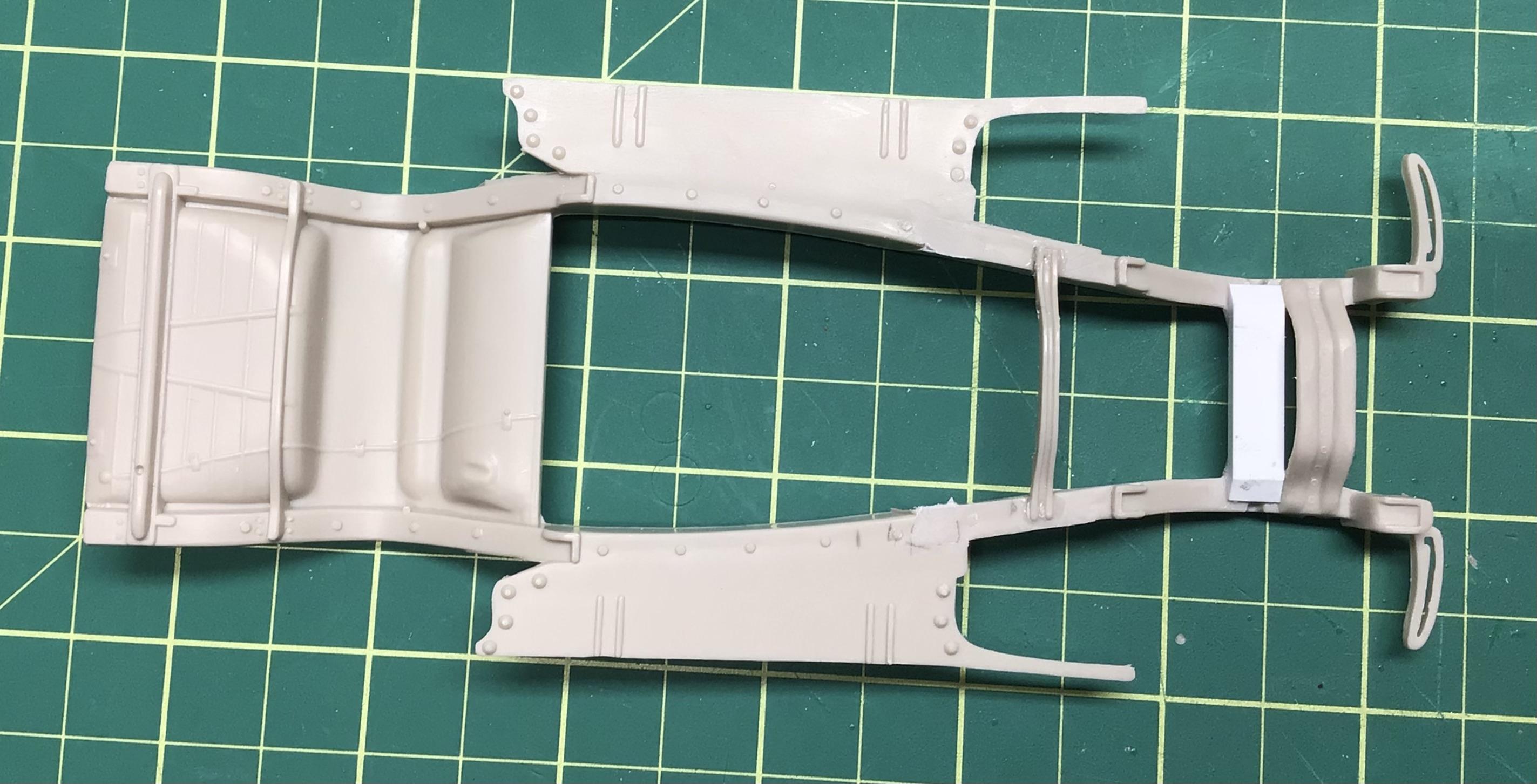

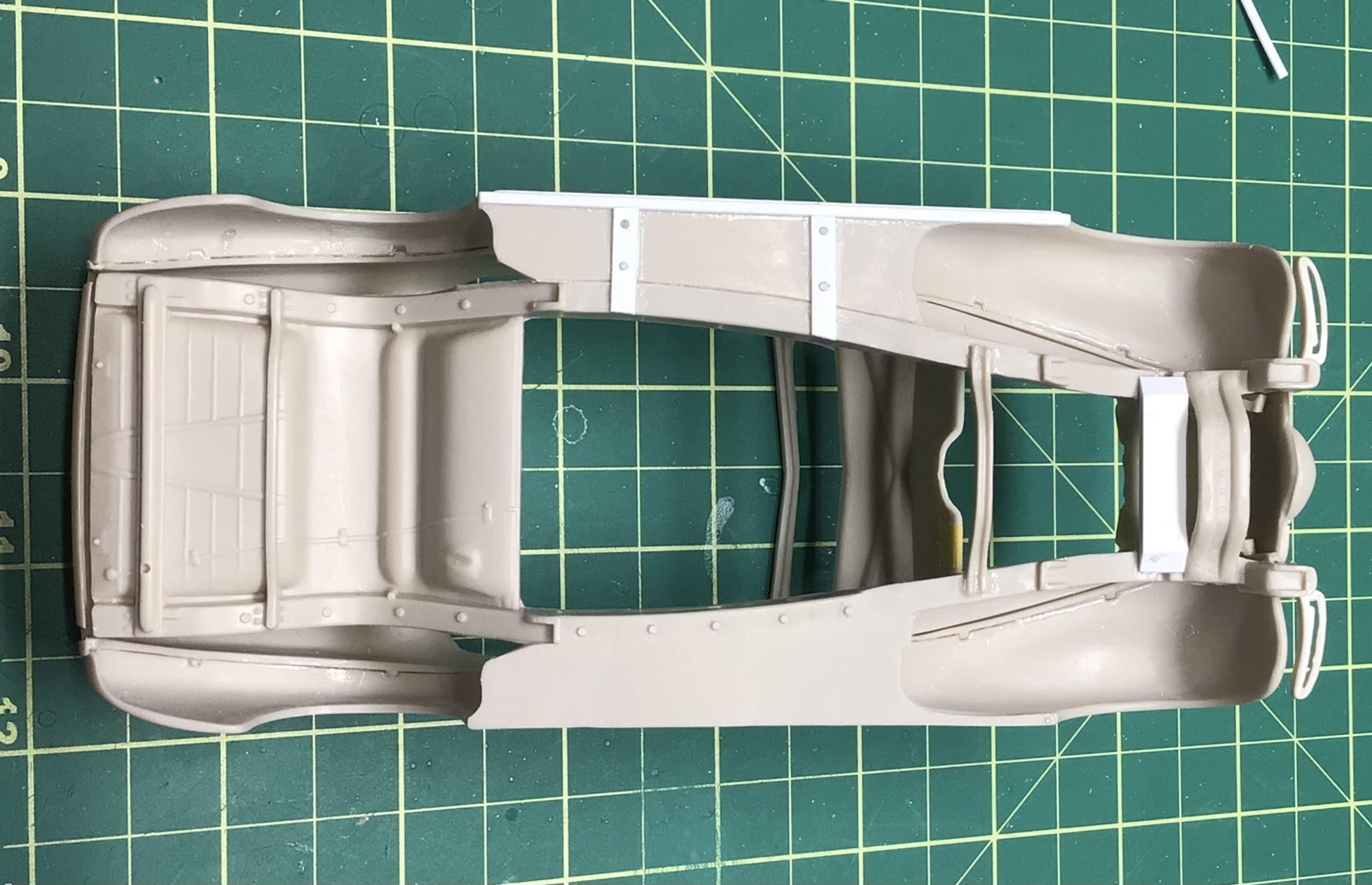

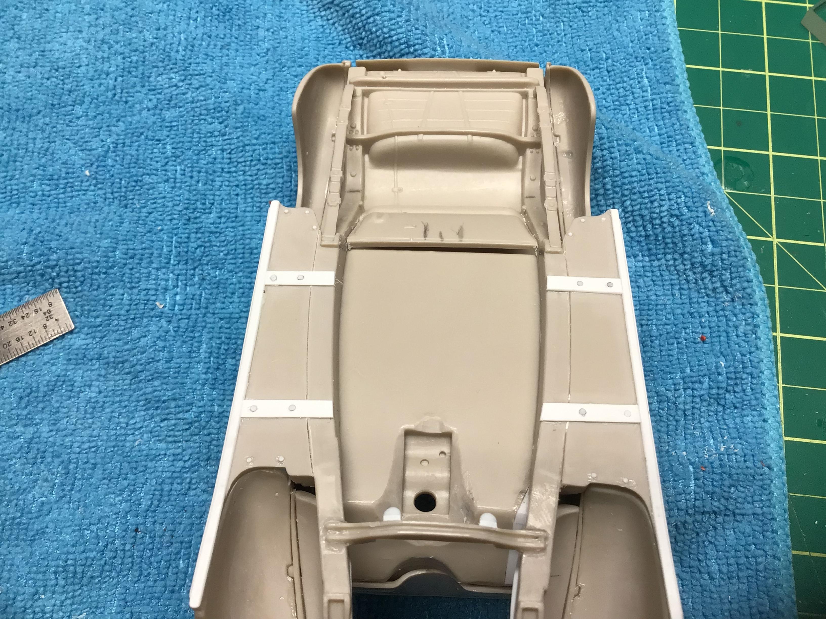

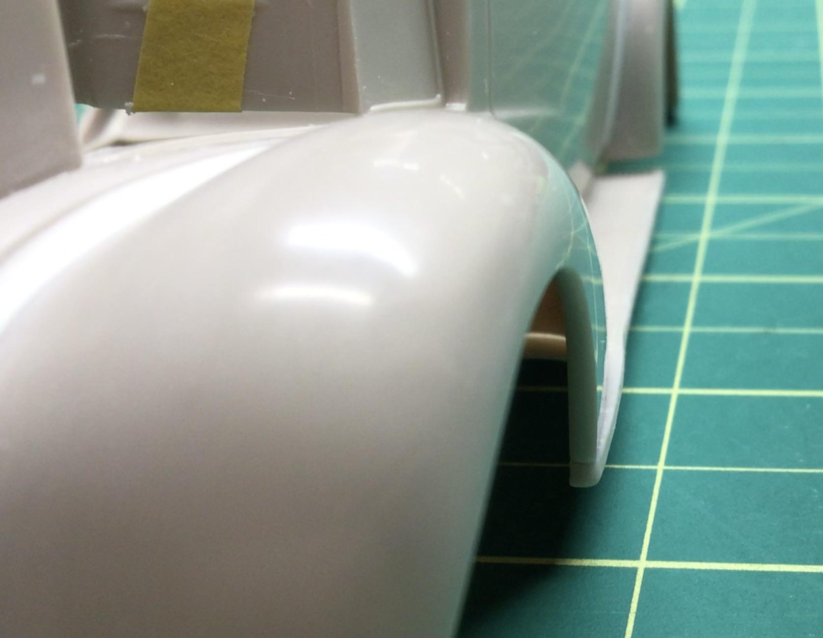

NOBLNG Posted Sunday at 06:56 PM Author Posted Sunday at 06:56 PM (edited) The raised sections on either side of the grill should actually be part of the fenders, so I scribed some new panel lines and used some Milliput to blend the transition. These were very handsome looking cars…more elegant than the Fords in my opinion.😎 While I was working on the running boards, I filed off the 3/4” bolts that AMT used to attach them and am kinda winging it with some new mounts. Undercarriage photos of original equipment are pretty scarce, and I don’t really care if I’m completely accurate.🤯 Edit: I think someone at AMT left the bolt head making machine on overnight.😬 Edited Sunday at 07:30 PM by NOBLNG 5

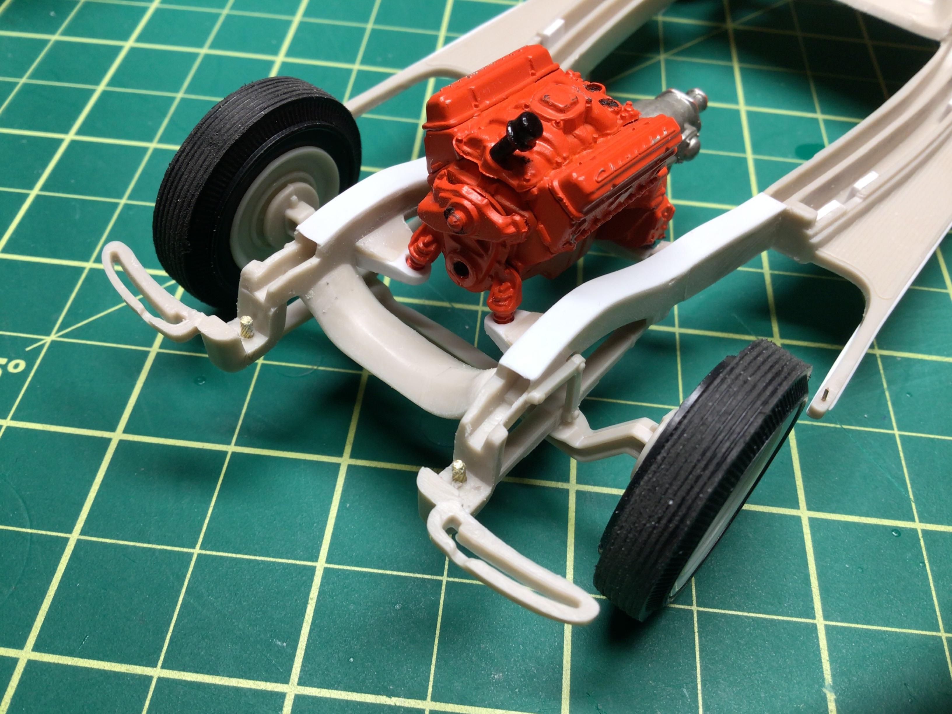

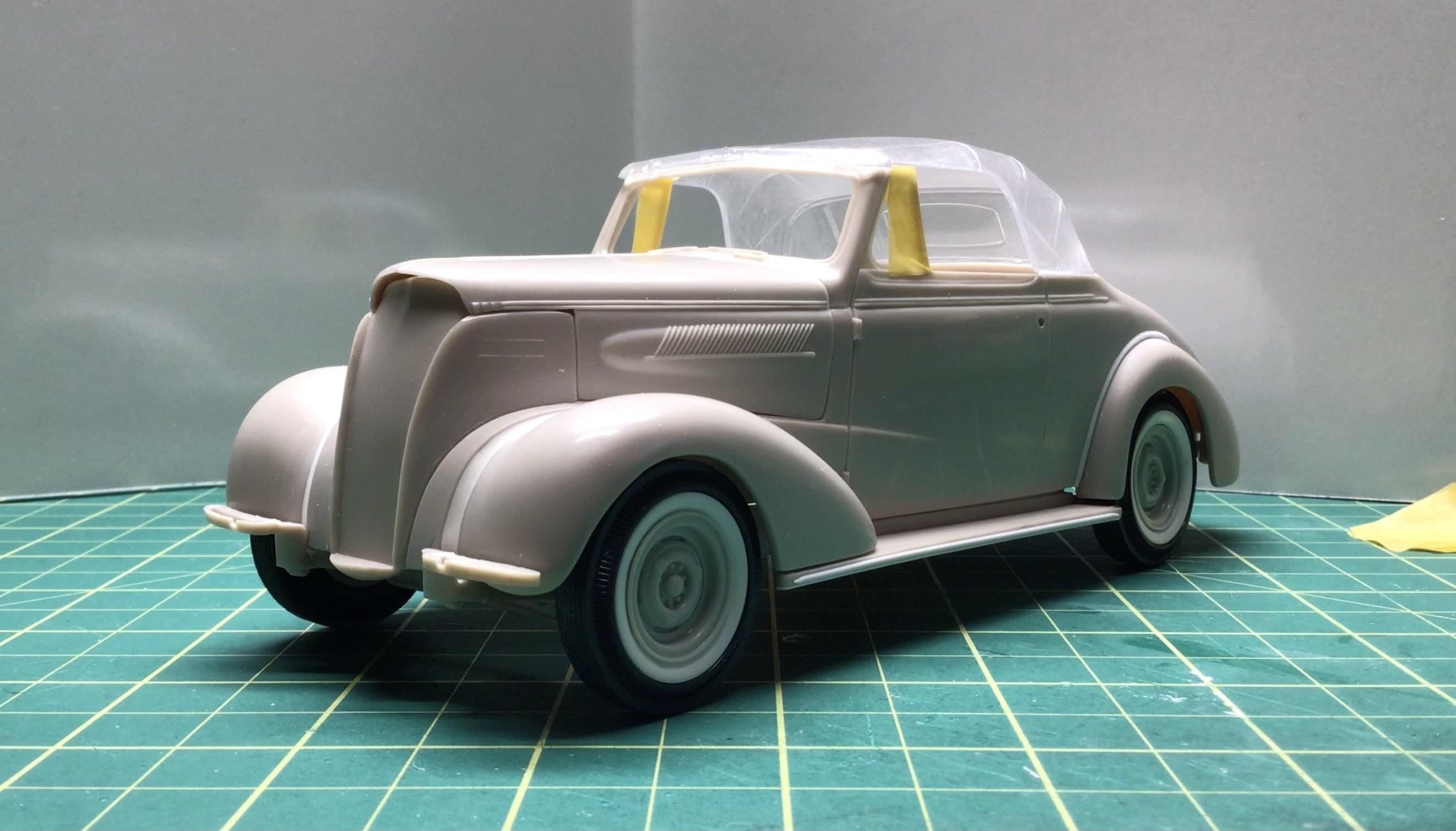

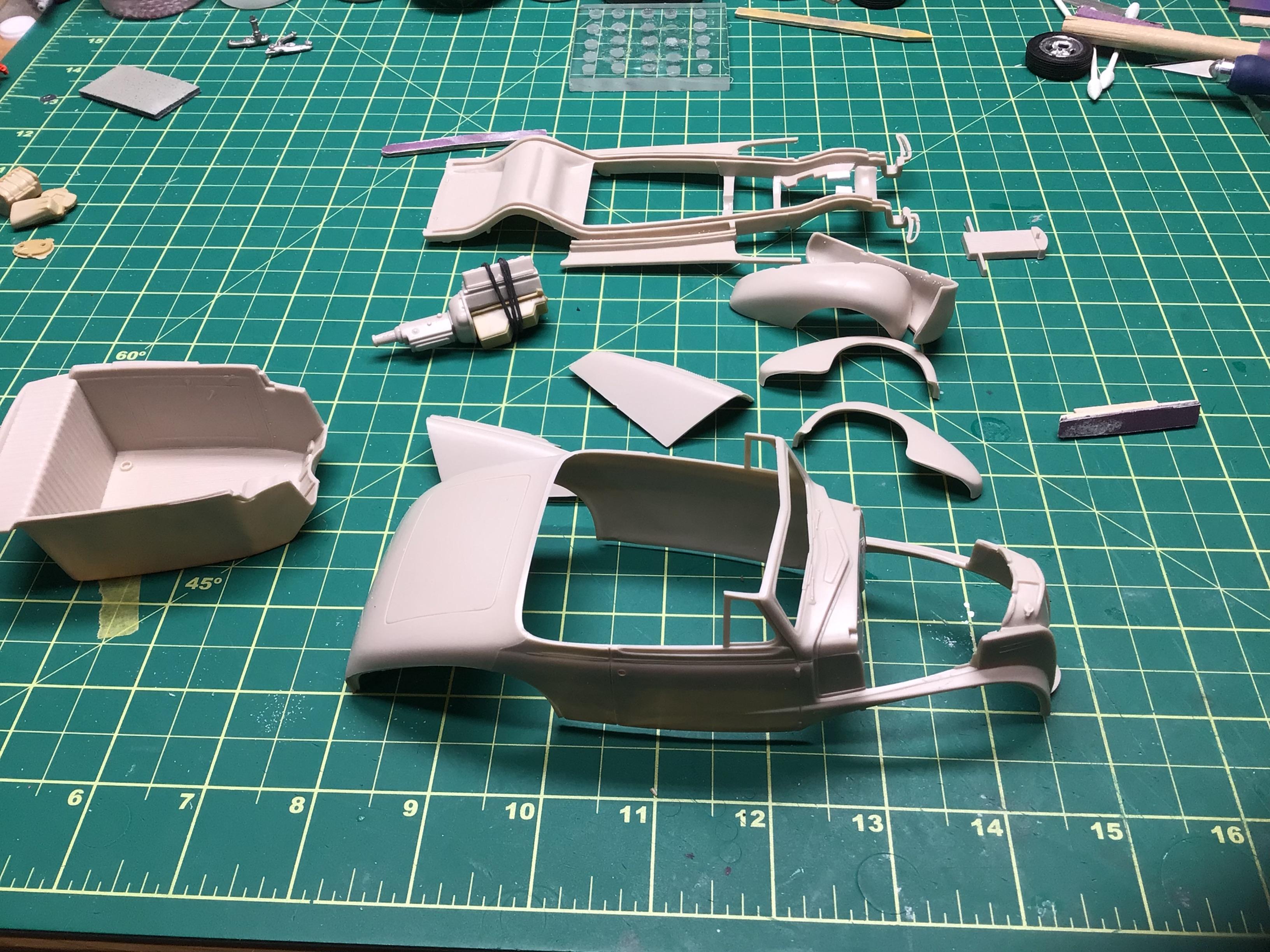

NOBLNG Posted Sunday at 07:14 PM Author Posted Sunday at 07:14 PM (edited) 6 hours ago, meechum68 said: Following this! 6 hours ago, Big Messer said: Following. I have one... somewhere. Thank you for your interest Gents! I hope to fix a few of the fitment issues and upgrade it slightly. The wheels and tires were missing, and there was no stock engine, but for $5….I’m happy.🙂 The supercharged 454 supplied in the kit is a bit ridiculous without a complete ground up rebuild, so I am just going to swap in a 283 and cast iron powerglide from the Revell ‘56 DelRay, like someone may have done back in the 50’s or early 60’s. Some nice mags or maybe steelies and baby moons and good enough….maybe something along these lines.😎 Edited yesterday at 01:38 AM by NOBLNG 3
DJMar Posted Sunday at 07:22 PM Posted Sunday at 07:22 PM Cool beans. The '37 is one of my favorite early Chevs, but the AMT kit is kind of a disaster. Nice work on all of it so far. The front fenders/grille interface and those curvy running boards have always been a pet peeve of mine - good job with getting that all sorted. It makes a big difference in the look of the finished kit. 1

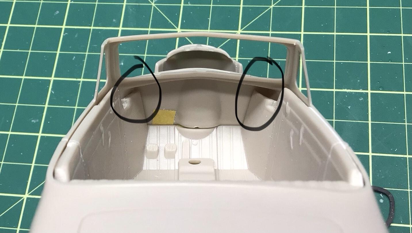

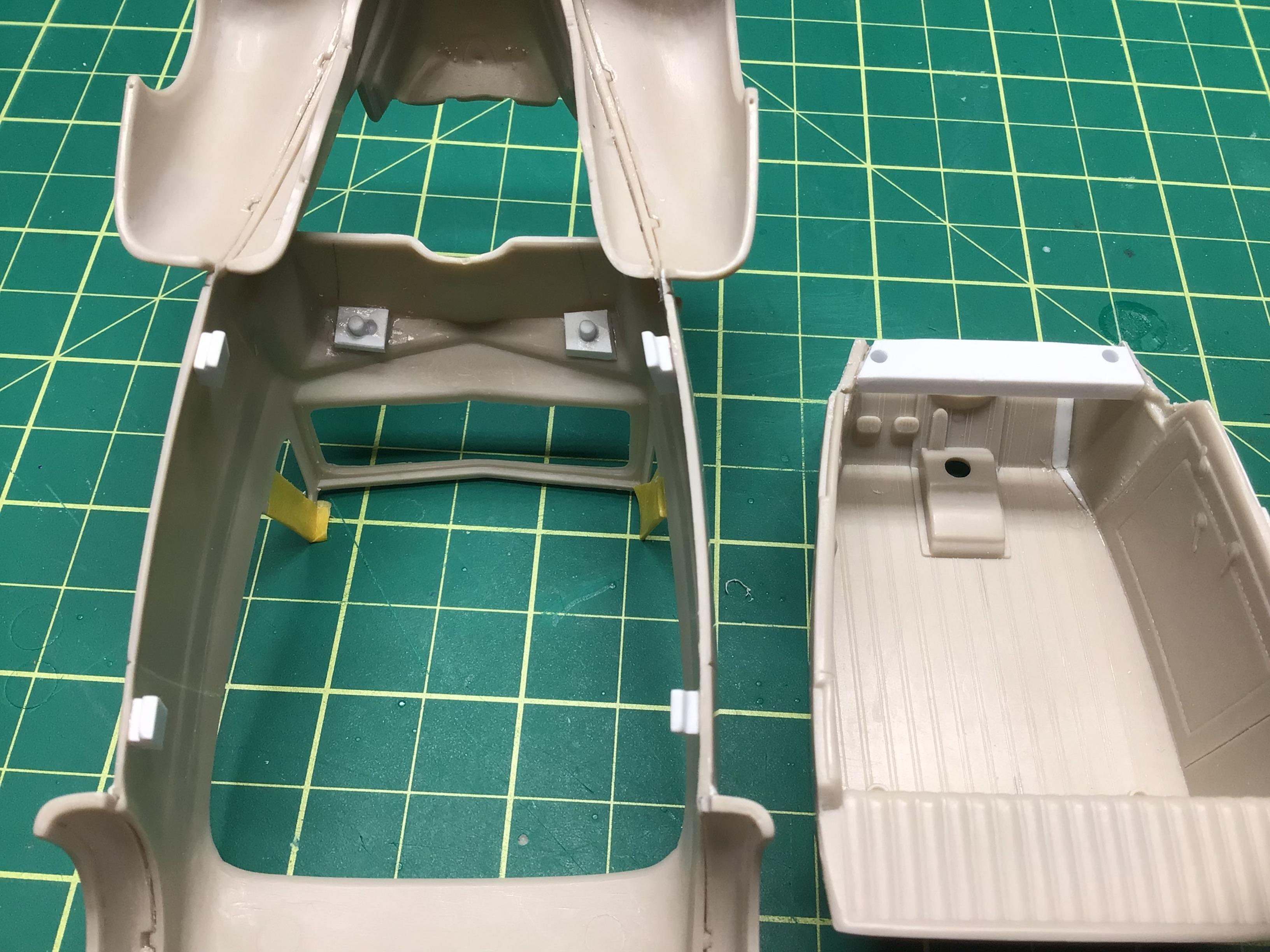

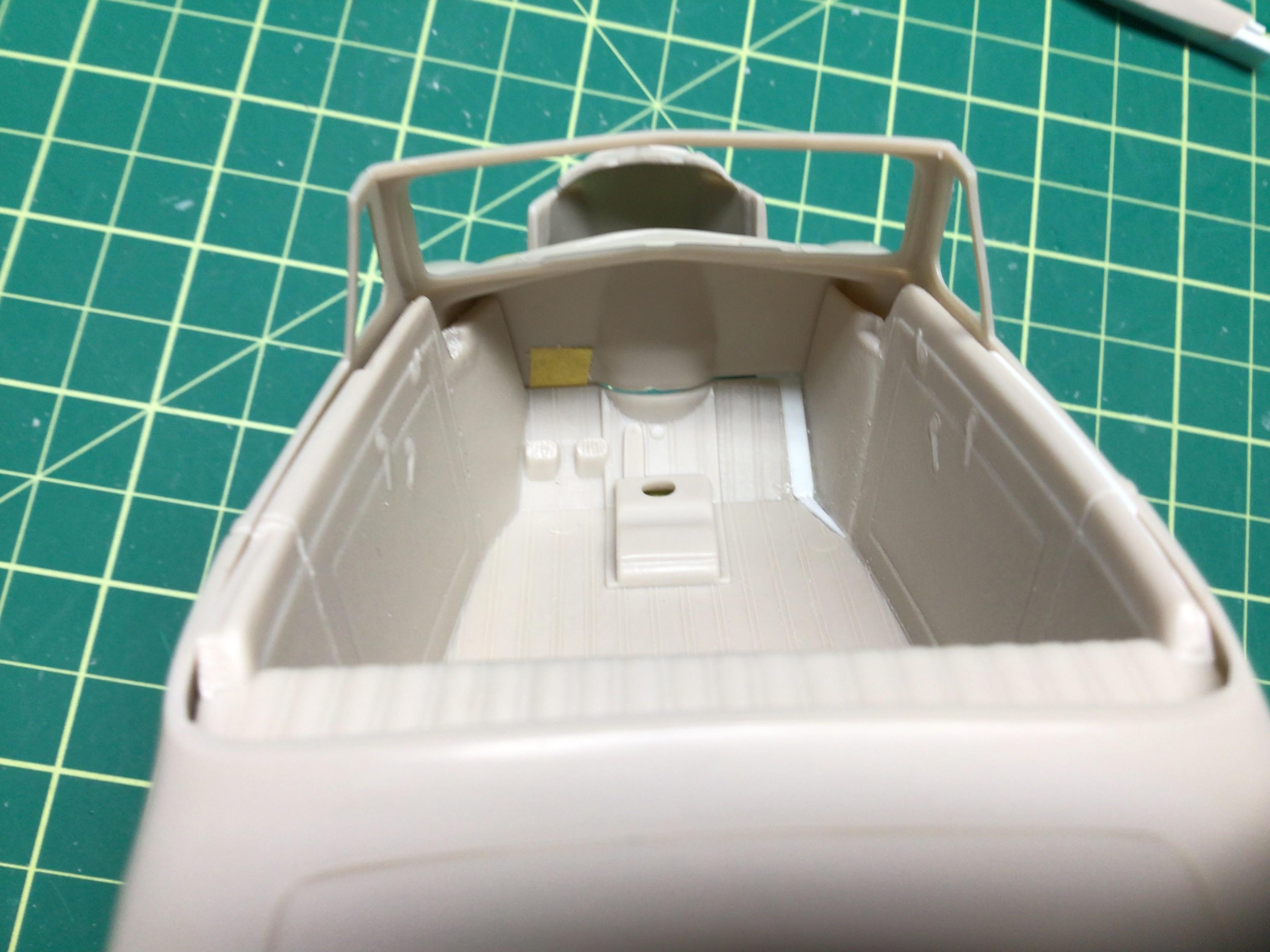

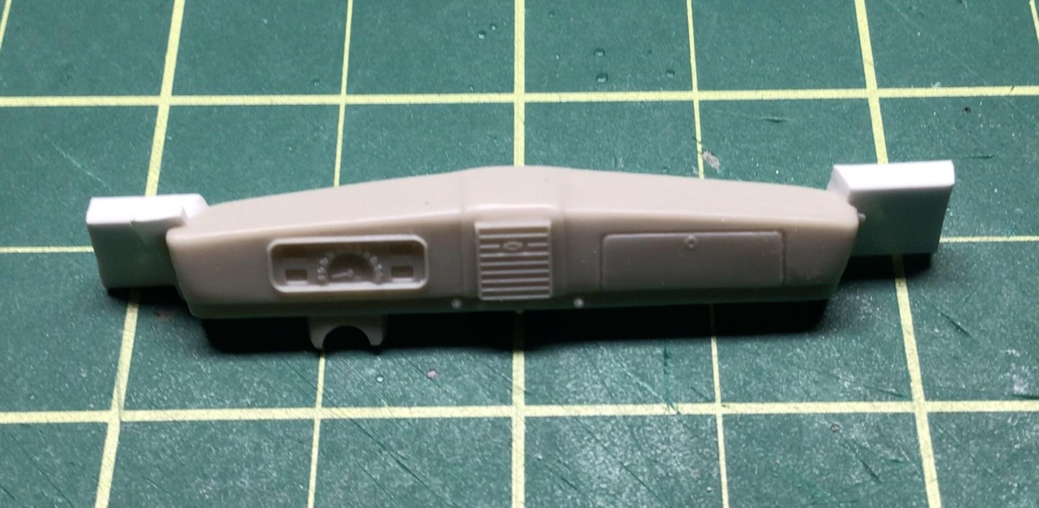

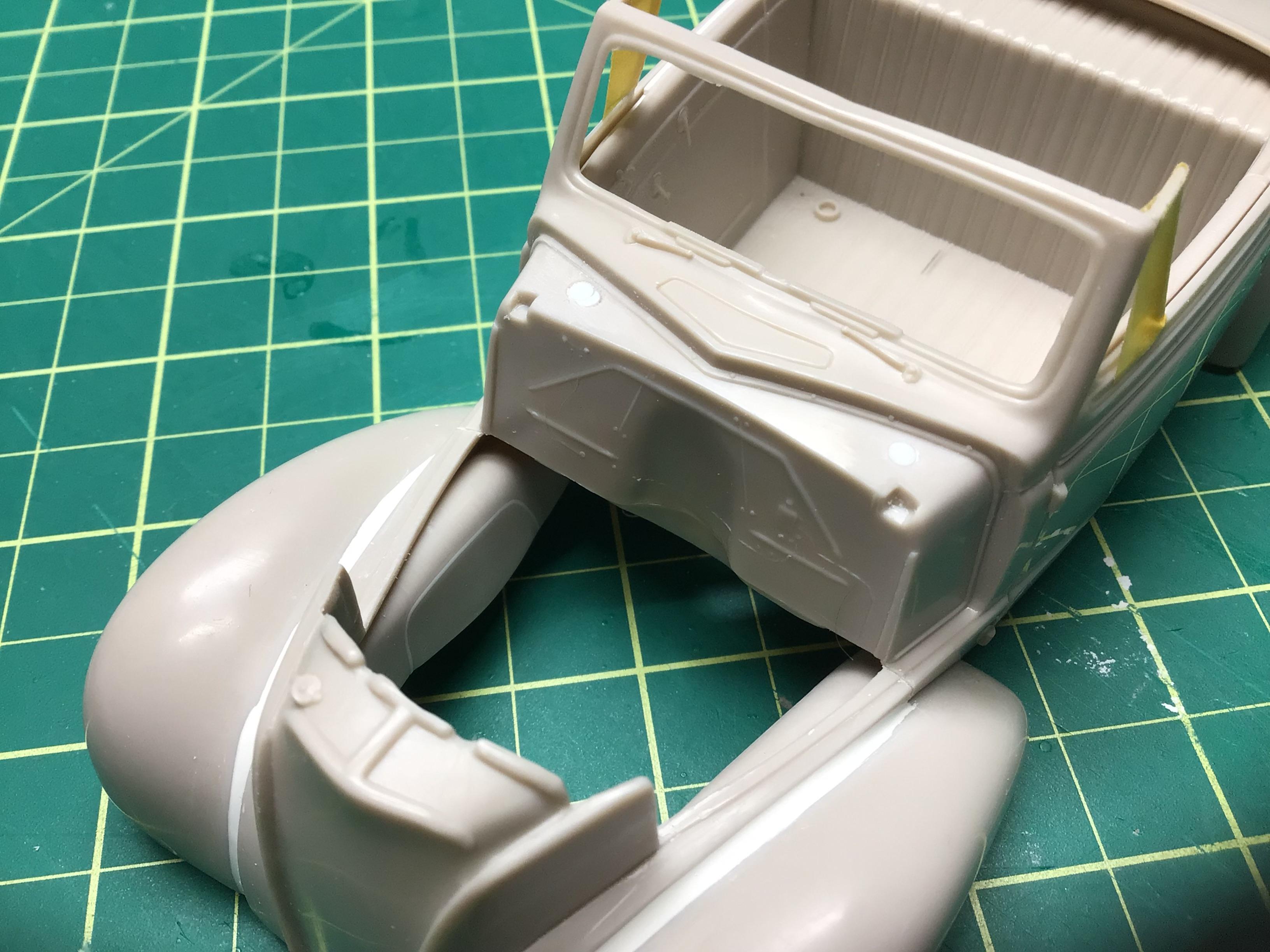

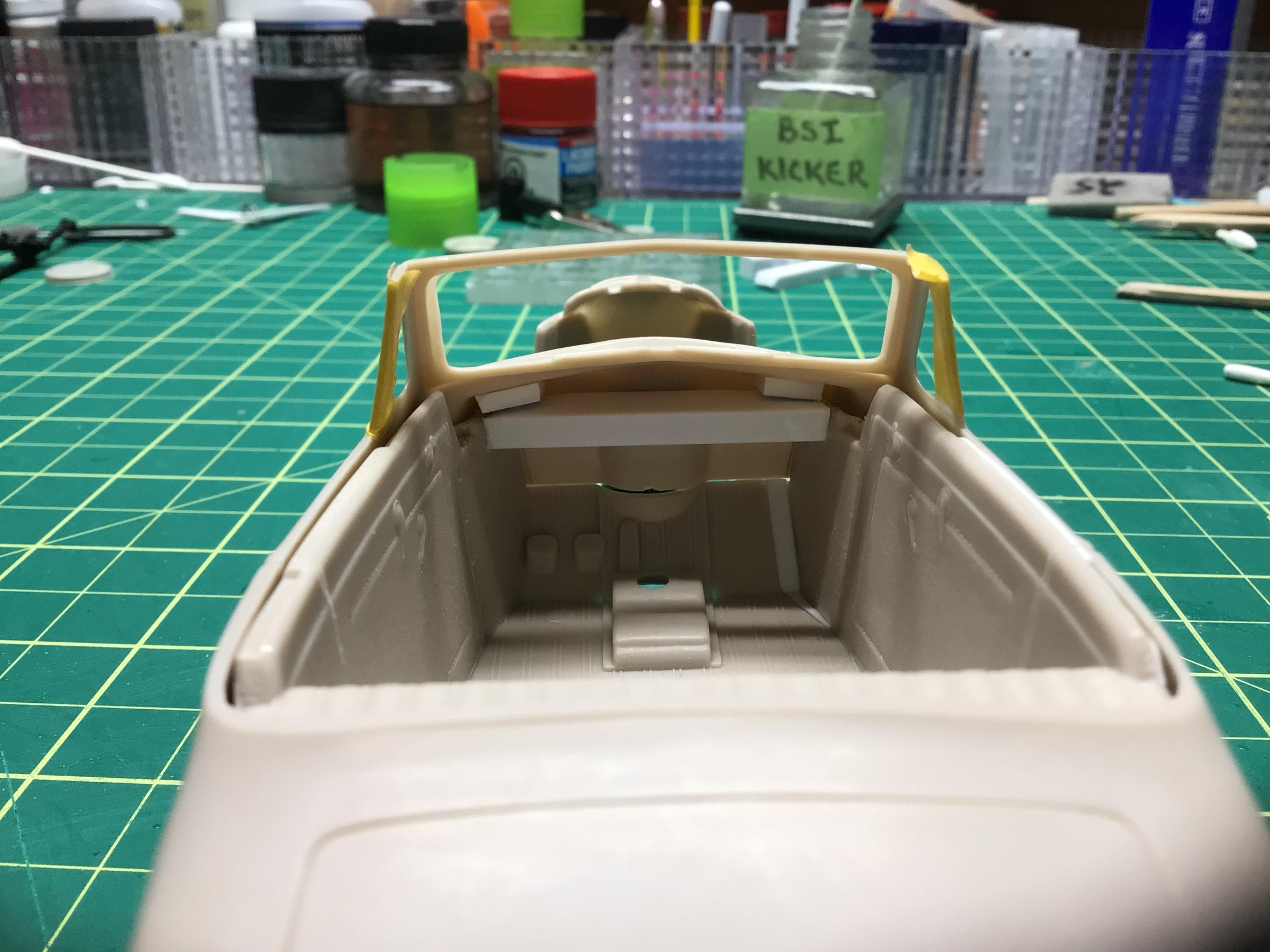

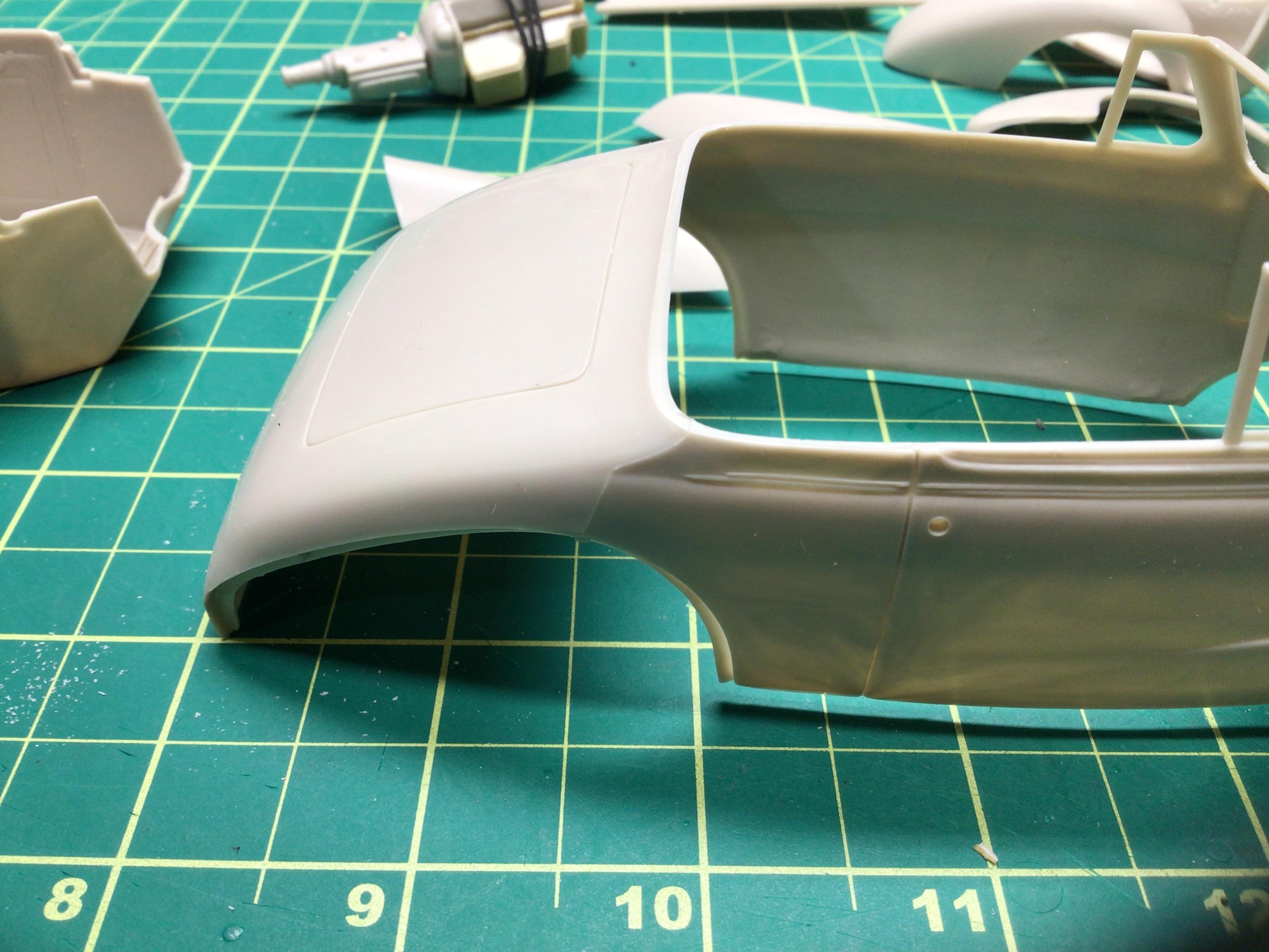

NOBLNG Posted Sunday at 07:49 PM Author Posted Sunday at 07:49 PM (edited) I am tempted to replace the dual beads on the side of the body, as they should extend back to about where this mold line is. And they are missing on the cowl between the door and hood, so it may be best to replace them with half round. .030” would work for the lower one, but there is no smaller half round for the upper bead so I may have to make some if I decide to go that route. The interior tub is pretty crappy and neither of the dashboards locate nicely.😕 So I am in the process of fixing stuff.🤯 The gaps from side to side are nowhere close to symmetrical. Still re-engineering stuff.🥵 I may have to get rid of that box on the floor and put in a proper trans tunnel…but that’s yet to be determined. Edited 14 hours ago by NOBLNG 5
Big Messer Posted Sunday at 08:16 PM Posted Sunday at 08:16 PM (edited) It MAY be possible to replace the ugly/inaccurate body beads with stretched styrene rod. But I will deny all the way to the guillotine being the instigator. And those stumps that pass as pedals... Edited Sunday at 08:18 PM by Big Messer 1
Big Messer Posted Sunday at 08:27 PM Posted Sunday at 08:27 PM FWIW I found this coupe. It is hot rodded but there are interesting detail pics: https://classiccars.com/listings/view/1791683/1937-chevrolet-coupe-for-sale-in-clarksville-georgia-30523
NOBLNG Posted Sunday at 08:34 PM Author Posted Sunday at 08:34 PM (edited) 25 minutes ago, Big Messer said: It MAY be possible to replace the ugly/inaccurate body beads with stretched styrene rod. But I will deny all the way to the guillotine being the instigator. And those stumps that pass as pedals... I have .015” and .020” round evergreen which may work. I could carve a trench for it to sit in but getting it to NOT look “wavy” might be a challenge which is why I’d prefer to make some half round if if possible. The pedals are definitely being deleted.😬 Edited Sunday at 08:42 PM by NOBLNG

Can-Con Posted Sunday at 11:01 PM Posted Sunday at 11:01 PM 2 hours ago, NOBLNG said: I have .015” and .020” round evergreen which may work. I could carve a trench for it to sit in but getting it to NOT look “wavy” might be a challenge which is why I’d prefer to make some half round if if possible. The pedals are definitely being deleted.😬 I was going to suggest stretched sprue too, Greg. Easiest way to keep it strait when putting it on is to glue one end first, just tacking the tip down so it doesn't move then pull it tight against the body and tack the other end down. I'll use super glue for tacking the ends and just a little liquid cement to glue down the rest after the super glue has set. I'll also cut the strip longer then needed and trim it off to length after it's attached. 1

NOBLNG Posted Sunday at 11:41 PM Author Posted Sunday at 11:41 PM 32 minutes ago, Can-Con said: I was going to suggest stretched sprue too, Greg. Easiest way to keep it strait when putting it on is to glue one end first, just tacking the tip down so it doesn't move then pull it tight against the body and tack the other end down. I'll use super glue for tacking the ends and just a little liquid cement to glue down the rest after the super glue has set. I'll also cut the strip longer then needed and trim it off to length after it's attached. Thanks Steve. I myself have had very little luck stretching sprue.🥴 Stretched sprue is still round and I have round Evergreen that is OK size wise. 1
