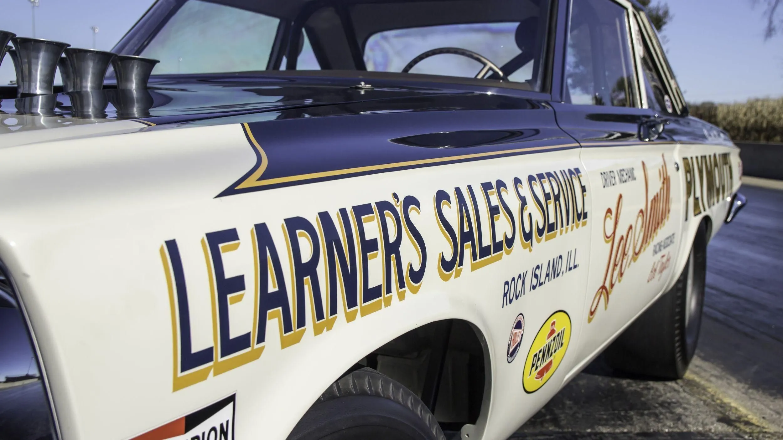

gtx6970 Posted Monday at 05:48 PM Posted Monday at 05:48 PM (edited) Wonding if anyone has ideas on how , if even possible to replicate this gold pinstripe in between the 2 blue stripes Im thinking a .5mm wide tape if that is a size even avail take two Exacto blades mounted side by side and make my own from a gold foil type tape maybe? will even that be narrow enough? Edited Monday at 05:48 PM by gtx6970

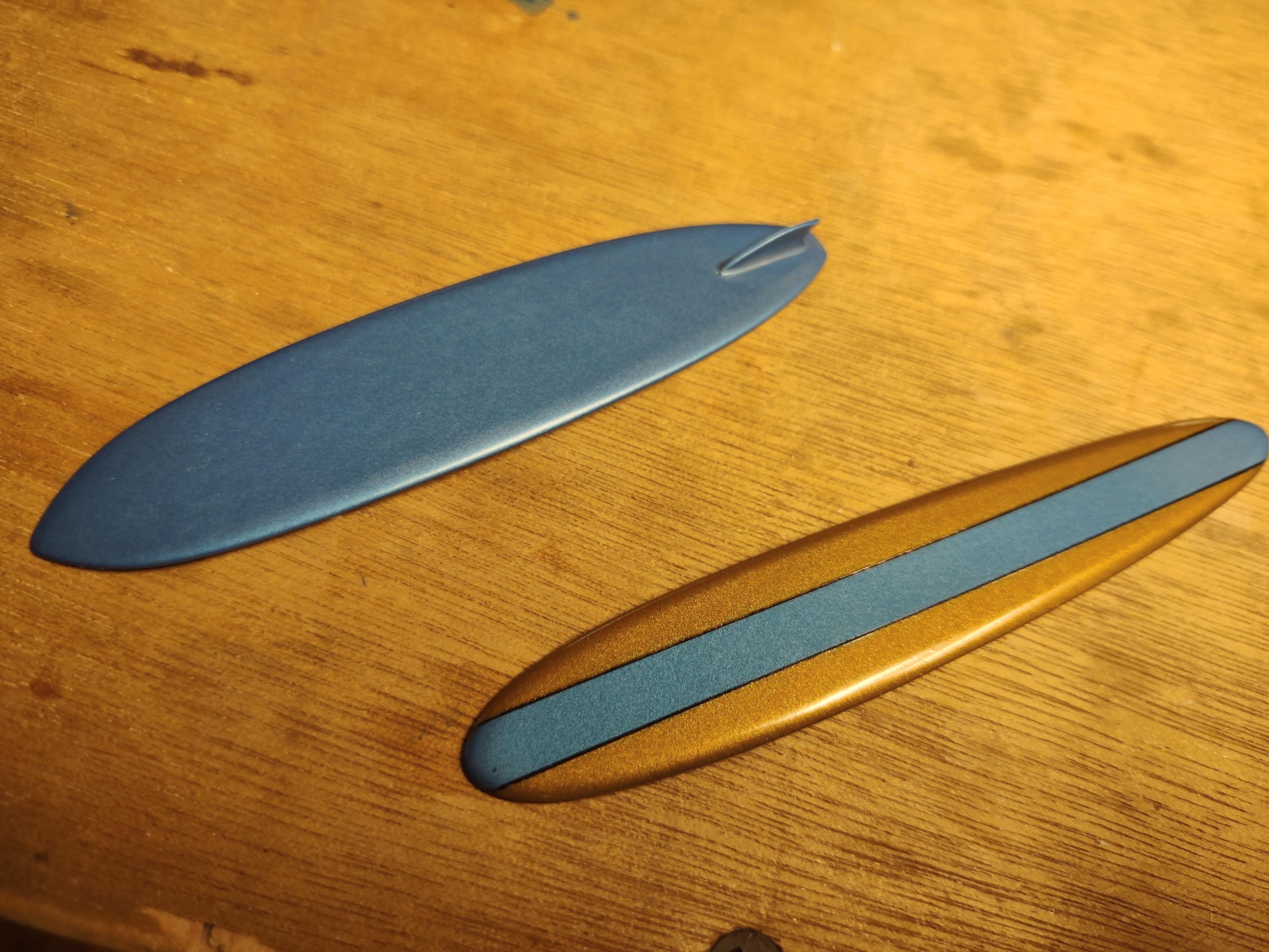

64SS350 Posted Monday at 06:16 PM Posted Monday at 06:16 PM I did do these with some painstaking masking...
peteski Posted Monday at 06:28 PM Posted Monday at 06:28 PM To me it looks like the blue areas are painted and the gold stripe is the applied over the gold. Is the stripe (and lettering shadows) actually metallic gold, or imitation gold or just a non metallic dark yellow/orange paint?

gtx6970 Posted Monday at 06:43 PM Author Posted Monday at 06:43 PM On the 1/1 I think the gold is painted pinstripe on top of the blue Appears to be about a 1/2inch maybe wide I;ll be cking out Microscale later today . I did see they had this one / but need to see what scale they say it is I did lay out some 1mm wide Tamiya tape and it MIGHT work , but deep down would prefer something just a touch narrower I have a pinstripe decal sheet from The Last Detail . but there's not enough stripes to do the entire car all the way around on the sheet . IF its even still any good I will try to take 2 exacto blades in one tool in an attempt to make my own and see what it comes out to as well
