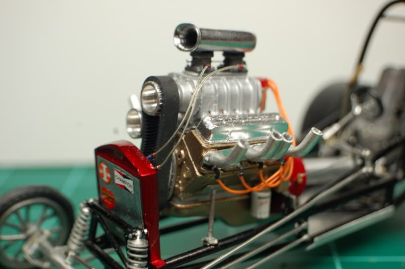

MikeMc Posted September 8, 2009 Posted September 8, 2009 (edited) Gotta agree with Izz Solder or plastic rod...no kink bending. Use rosin core or solid solder..no acid core CA will fog!! use elmers or epoxy I use solder with a few tricks.... 1) roll it flat on a piece of glass 2) polish it when flat...get some gloves to work in 3) drill out the head then put the tube thru a flange (if wanted ) and mount to block(I work fire wall to front) 4) bend slowly for shape...rebending looks awfull I also admit quickly it took 5 or 6 tries for my first set!! Both of these are SBC motors w\o flanges Edited September 8, 2009 by MikeMc

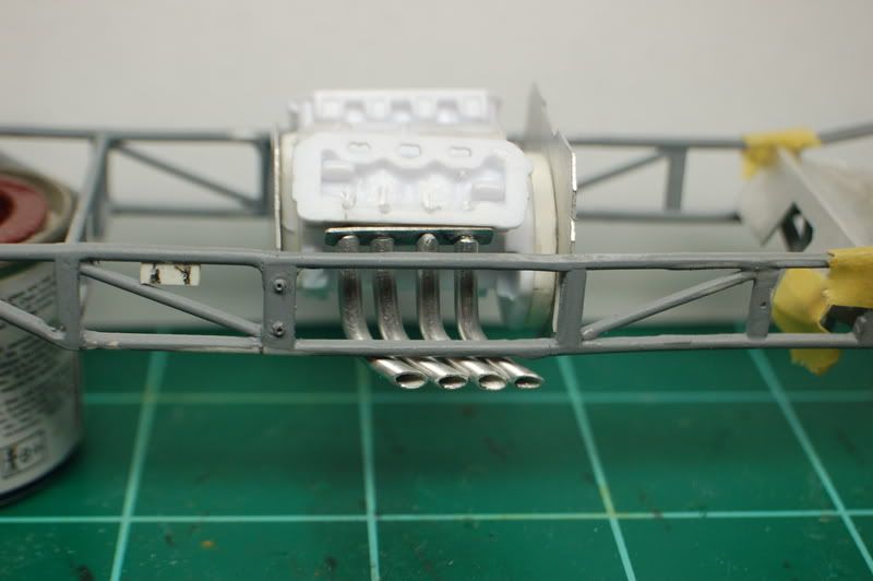

curt raitz Posted September 12, 2009 Posted September 12, 2009 Your timing on this is perfect... I'm building the Little Red Wagon for the Loins Drag Strip build off and came to the same conclusion as you...dem pipes ain't long enough thought about bending aluminum tubing and or using solder, but decided to retain the upper part of the kits exhaust (lot of cleaning up to do on it) and add aluminum tubing past the cross braces on both headers. if didn't work, i would go with the tubing and/or solder. here is how i did it step by step: used 5 minute epoxy to hold brass pins attached aluminum tubing with 5 minute epoxy (stronger joint than super glue) painted with Spaz chrome... but still need a little cleanup on the seams between the kit parts and tubing presto - bingo all cleaned up and ready to do some wheel standin' just another option...

charlzrocks Posted September 14, 2009 Author Posted September 14, 2009 I went with Curt's idea on this one, just epoxied the tubes to existing headers, they came out identical to his. I am gonna paint the plastic parts silver and use a jewelers cloth to polish the chrome portion. The plastic portion is mostly hidden anyway and I can get a real good polish on the tubing. I would love to know where TxRat is getting that 2nd tube bender from....looks like it does wonders for bending, let me know! Thanks all!
