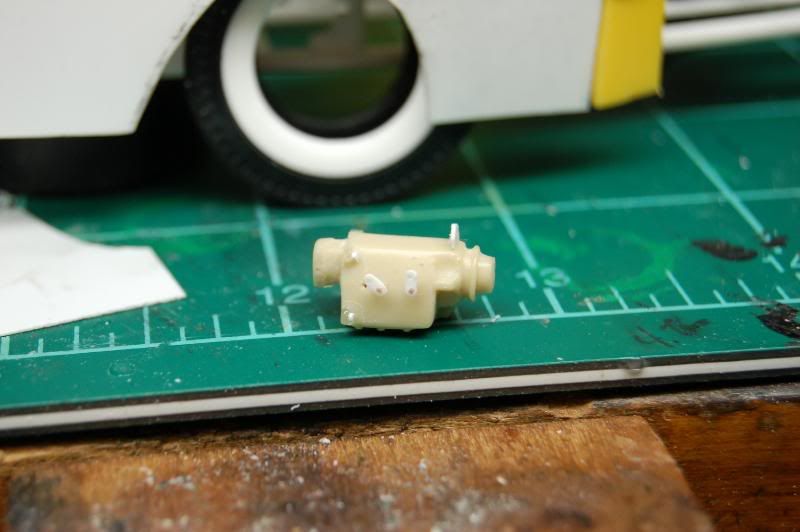

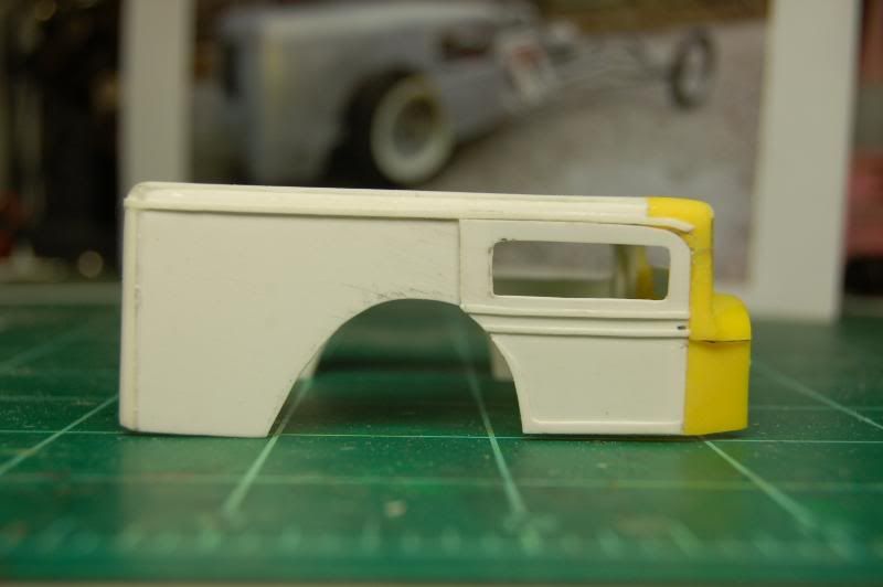

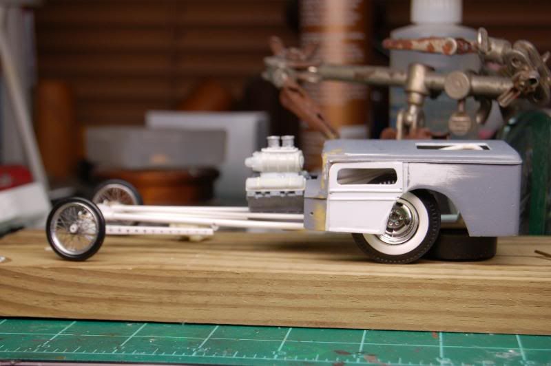

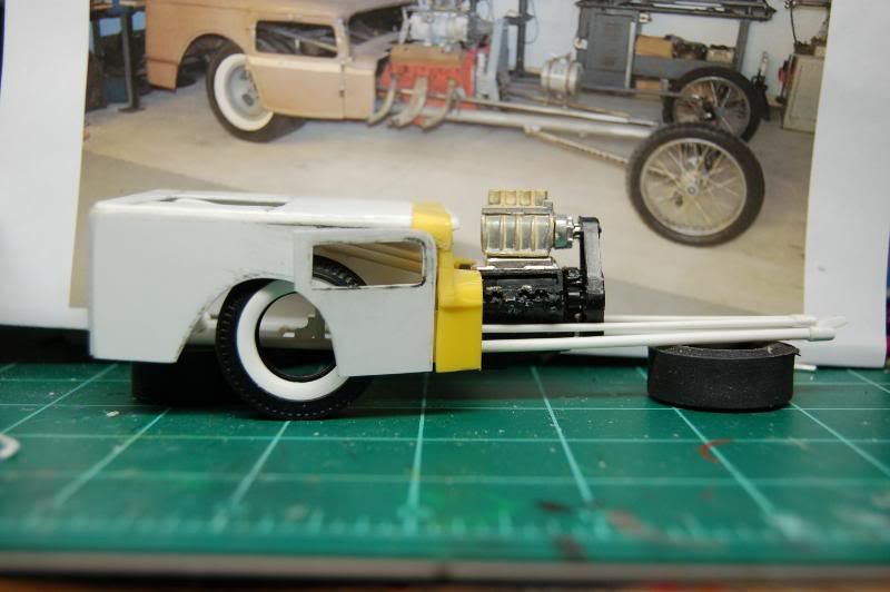

Fuel Coupe Posted November 19, 2009 Author Posted November 19, 2009 (edited) Here's a small update. Been working ALOT so I haven't had much time at the bench but I did get these done First, I was on a search for a Lasalle transmission and was told that there was one in the miss deal stud kit. Got it out and broke out the resin casting goodies and whipped one up I added some nut and bolt detail (which isn't showing up to well in the pics). then I started on the body first scratch built body ever. Not too bad but I can see I need to trim the bottom of the body some as the doors appear too tall.... as always comments are welcome.. Edited November 19, 2009 by TxRat

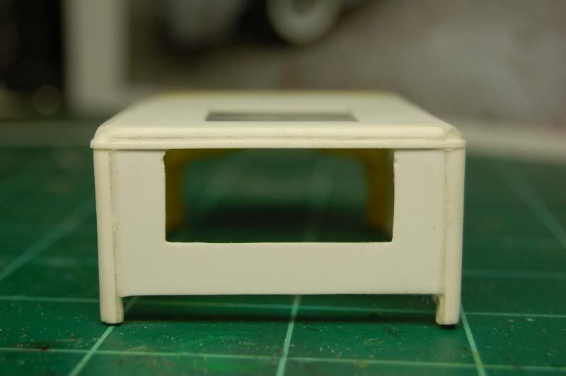

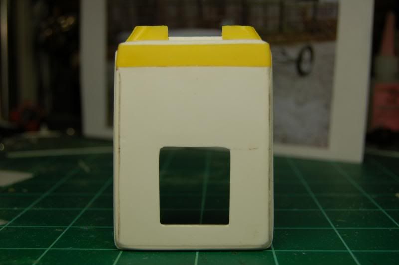

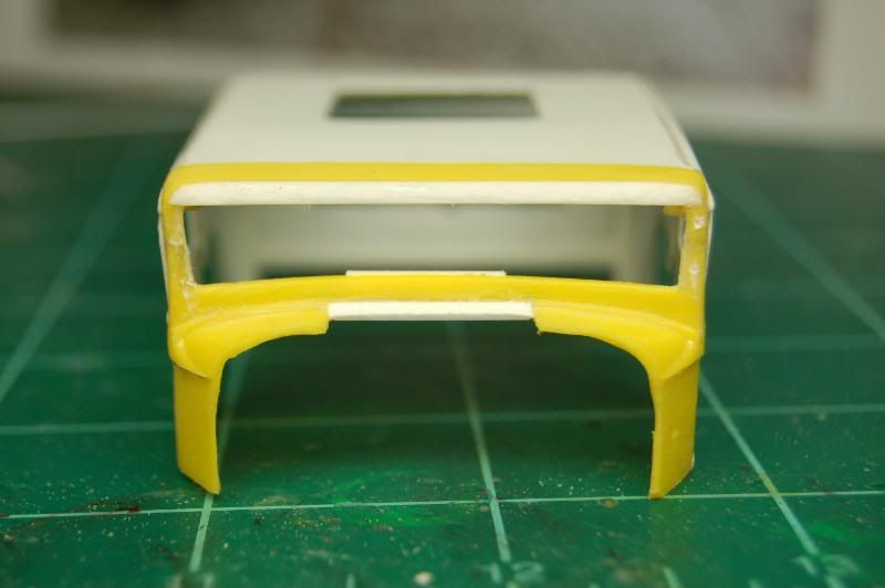

Fuel Coupe Posted November 23, 2009 Author Posted November 23, 2009 OK, the body is about ready for primer. I have added the drip rail around the roof and some side molding. on to the suspension next go around. let me know what you think good bad or just plain junk....
Bernard Kron Posted November 23, 2009 Posted November 23, 2009 At first glance (and if one hadn't seen your work before) you could be accused of crude and haphazard fabrication of the body. But in fact examination of the 1:1 pics will reveal that this is in fact a carefully considered, skilled and meticulously faithful rendition of the original!
Fuel Coupe Posted November 23, 2009 Author Posted November 23, 2009 (edited) At first glance (and if one hadn't seen your work before) you could be accused of crude and haphazard fabrication of the body. But in fact examination of the 1:1 pics will reveal that this is in fact a carefully considered, skilled and meticulously faithful rendition of the original! Thanks, I think There's still some work to do around the window openings to make them more 3 dimensional. The roof opening definitely needs some tuning as well...I'm sure more will be revealed once the first coat of primer goes on as well... Edited November 23, 2009 by TxRat
Bernard Kron Posted November 23, 2009 Posted November 23, 2009 (edited) Thanks, I think There's still some work to do around the window openings to make them more 3 dimensional. The roof opening definitely needs some tuning as well...I'm sure more will be revealed once the first coat of primer goes on as well... Because I have seen your work before it was definitely meant as a complement! But the original is very funky - which is part of its charm. So using your skills to capture that funk will also capture the charm. I'm really enjoying this build and will keep watching for more. Edited November 23, 2009 by gbk1

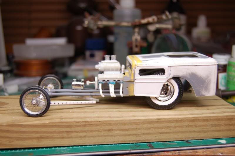

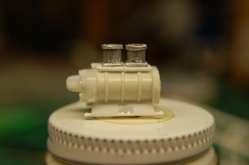

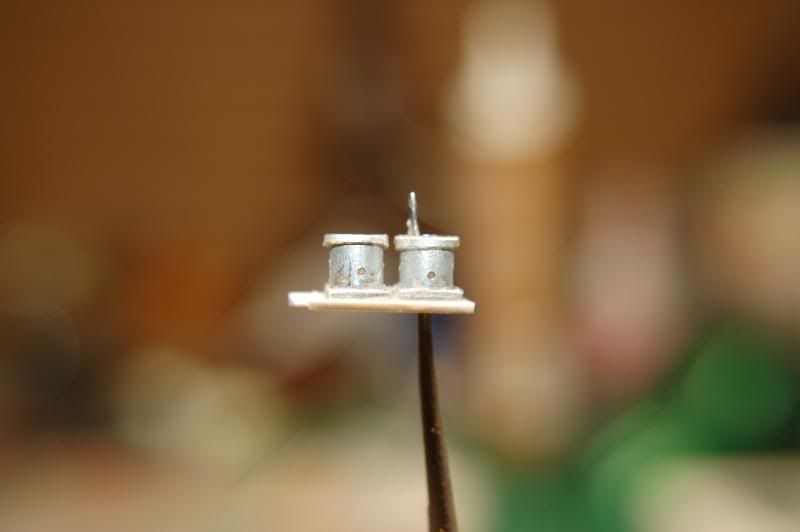

Fuel Coupe Posted December 1, 2009 Author Posted December 1, 2009 Started on the motor and blower set up. The original car had a handmade blower manifold welded up from 12 pieces. mines a modified one from a Stone Woods and Cook kit The two hole injector is made from aluminum and plastic and will have alum bolts around the edge.. Here's the induction unit mocked up Pretty boring stuff really. I still need to figure out the chain drive Thanks for looking...
noname Posted December 1, 2009 Posted December 1, 2009 Looks great so far. I really like the rear wheels.

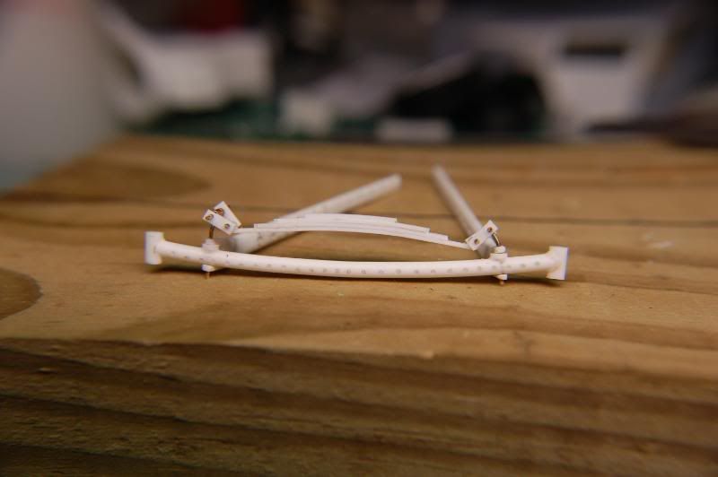

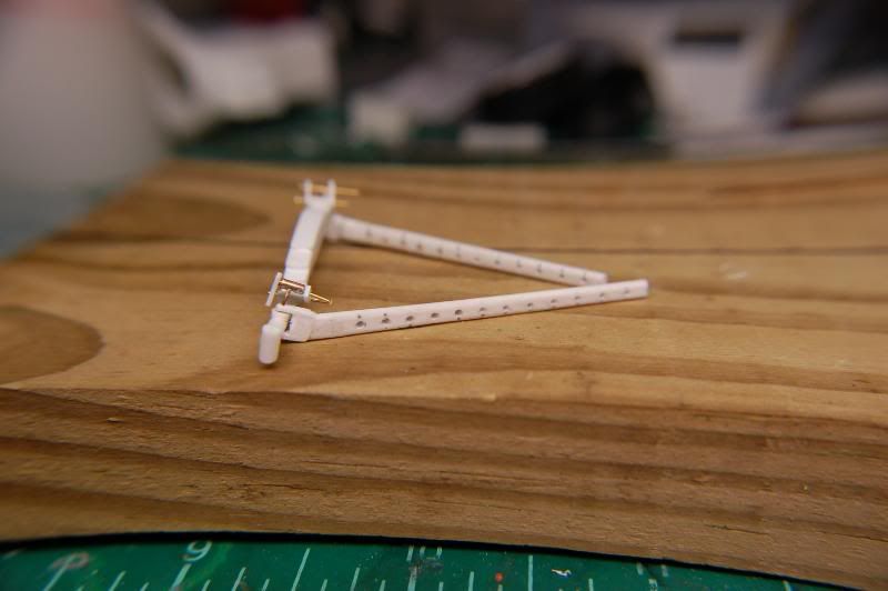

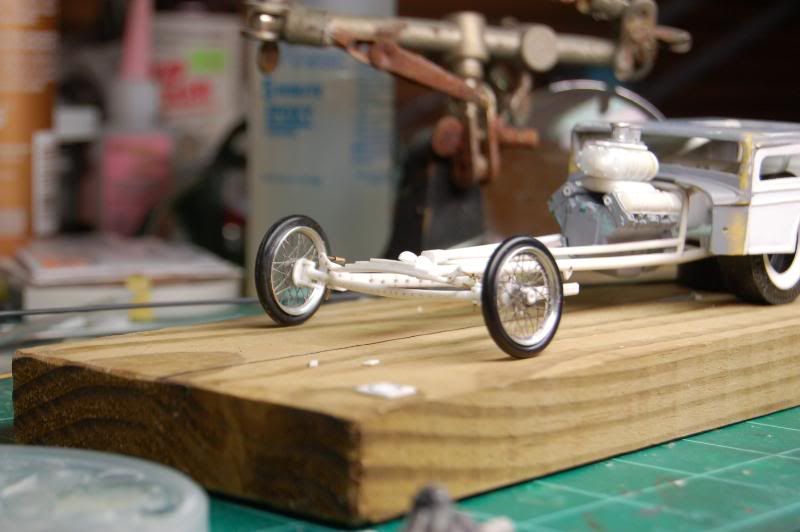

Fuel Coupe Posted December 7, 2009 Author Posted December 7, 2009 small update on the frontend. It is entirely scratch built. the shackles are brass and soldiered... Thanks for looking...
Bernard Kron Posted December 7, 2009 Posted December 7, 2009 I have to admit to being a real junky when it comes to fabrication, I guess that's why I like drag cars so much. They lend themselves to scratch building especially well. That front suspension is great. (I also like the support on the back of the roll cage - nice touch.) Like Dave, can't wait to see the spindles...
Foxer Posted December 8, 2009 Posted December 8, 2009 looking great on that front axle ... those holes are hurting MY eyes!!

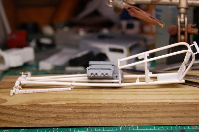

horsepower Posted December 8, 2009 Posted December 8, 2009 Wow Thanks guys for all the interest. Here's what I got done today. In a previous life My father and I used to build race car chassis so I was able to put some of those skills to work today.. All Scratch built Chassis Research TE 440 Chassis. I know it's a bit off the subject, but I know where one of these chassis is, hanging in a garage, has never been used, it was purchased as a high school project, & never got any further.
horsepower Posted December 8, 2009 Posted December 8, 2009 OK, the body is about ready for primer. I have added the drip rail around the roof and some side molding. on to the suspension next go around. let me know what you think good bad or just plain junk.... I think a piece of 1/2 round strip between the two pieces of strip on the doors would help.
Fuel Coupe Posted December 8, 2009 Author Posted December 8, 2009 I think a piece of 1/2 round strip between the two pieces of strip on the doors would help. Already been addressed thanks. Thanks everyone for the comments. This has been a really fun build so far... Ive been in touch with the owner of the car and he has been a great help....

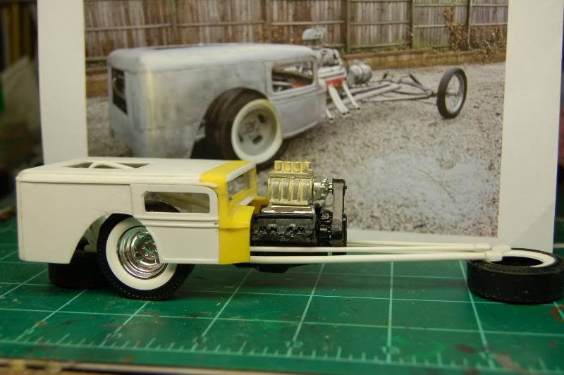

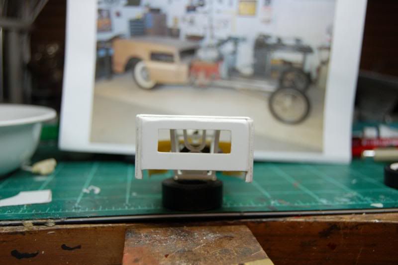

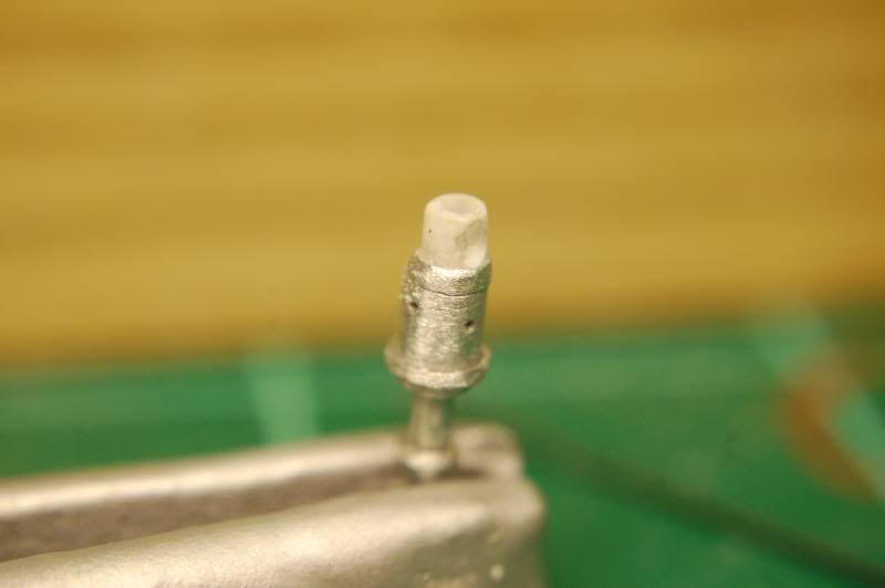

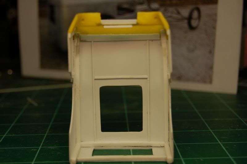

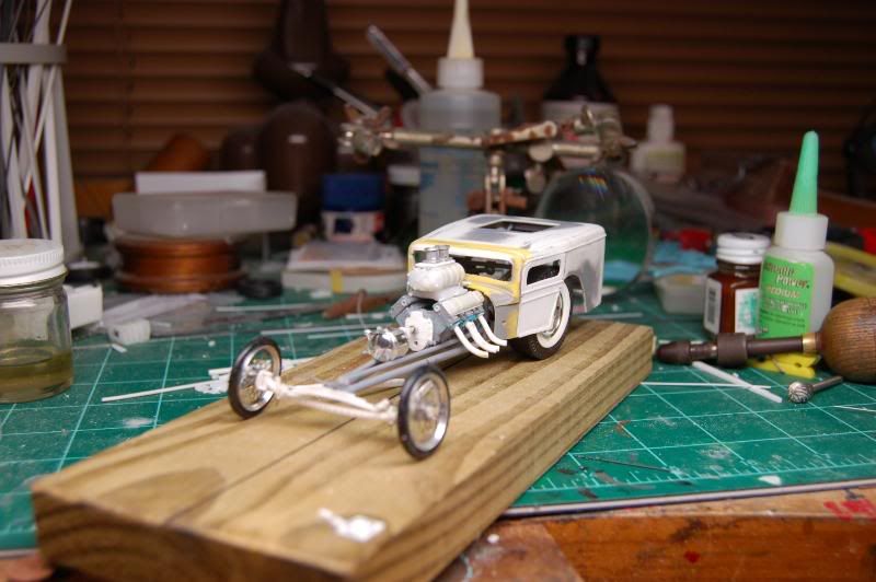

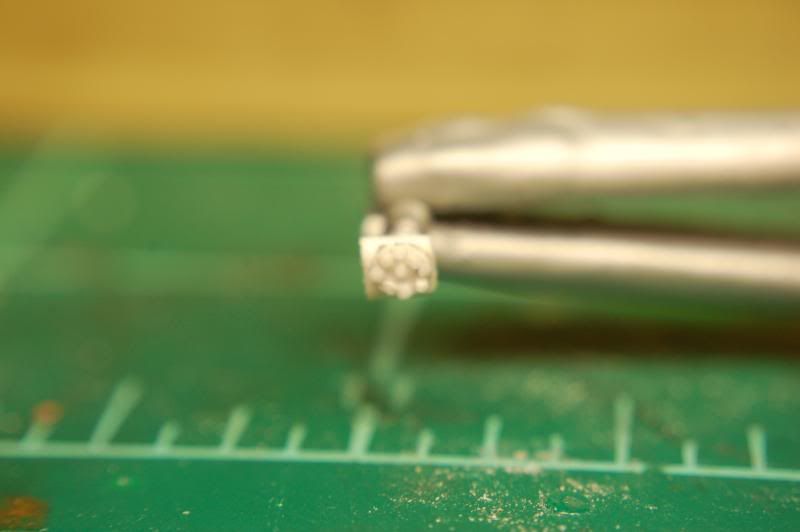

Fuel Coupe Posted December 17, 2009 Author Posted December 17, 2009 (edited) OK , well after discussing the progress with the owner of the Hollish car it was determined that the chassis was a bit too long. So I cut about 1/2" out of the chassis forward of the cockpit. I've also scratchbuilt a fuel pump and a mag. Ive also added some height to the roof as More I looked at it I figured it was too "flat and wide" I hope this modification make this car more accurate to the original. Thanks for looking... I have been emailing a talking on the phone with the guy who is doing my decals. We agreed on the artwork and they being printed shortly. He wishes to stay anonymous and I don't blame him as he truly is doing this for the love of the hobby and does not wish for it to become a business. With out him this project would not have been able to be done. Edited December 17, 2009 by TxRat
Chuck Most Posted December 17, 2009 Posted December 17, 2009 I saw Miscalculation in Hot Rod, and I thought it would make a killer model. Looks like I'm right so far... even if I'm not the one building it! (Of course, that can be a blessing... )!
noname Posted December 18, 2009 Posted December 18, 2009 TxRat, that is looking awesome right now. Isn't that a pain putting those tiny nut heads on the fuel pump?!!!
