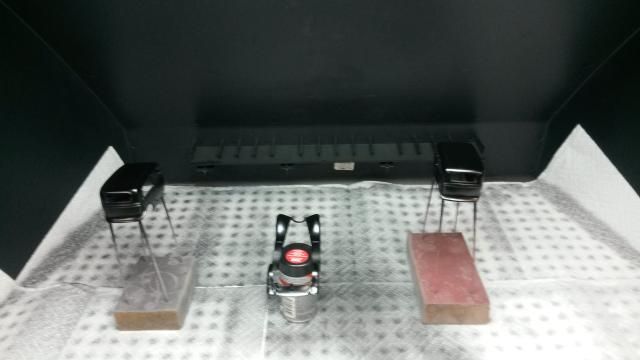

oldnslow Posted February 16, 2015 Posted February 16, 2015 First run in the new booth, covered the pegboard with cheap paper towels to make it easier to clean. a couple of 34 sedans, one for a client, the other for me. You can see the paint is drawn down all over the paper towels and you just pull them and toss for a clean booth.
