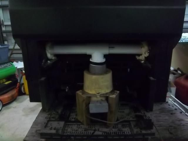

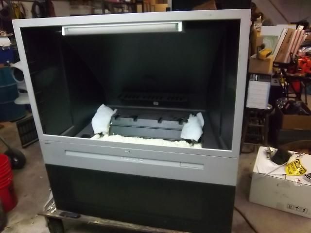

Decided I needed a spray booth to replace the cardboard box I was using to spray in.
A neighbor was tossing a large projector screen TV and I thought the shape was right for what I wanted.

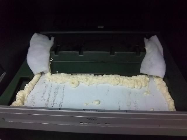

So I gutted it, put in a floor of coroplast (plastic cardboard) and sealed it with expandable foam.
I had some vacuum motors from a bank tear down to move the air, they were used to move the cylinders from the drive thru to the bank and have brushless motors, the main filters are behind the white fluff in the corners.
The motor is supported on 2 pieces of 2x4 and a metal flange that is part of the motor assembly. The rest is a 3" to 2" reducer, a 2" T and 2" tubing cut to length. The valve in the motor assembly is 2" so reducing it won't affect the performance.

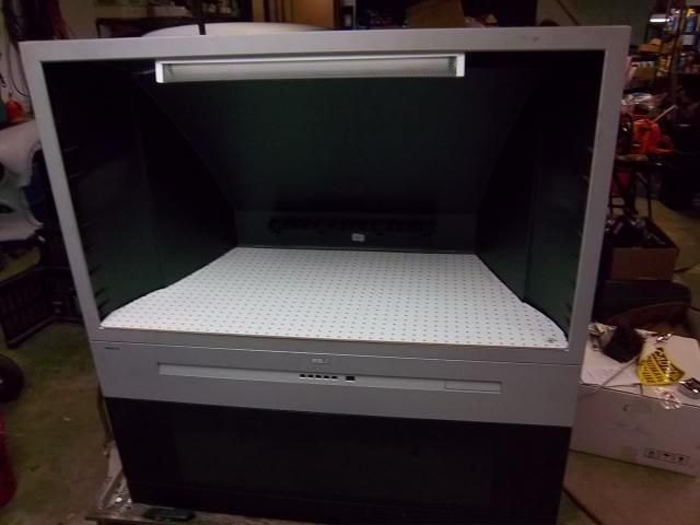

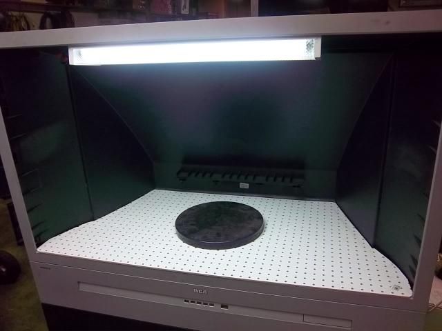

I put a floor of pegboard in and a 24" light fixture.
And a turntable.

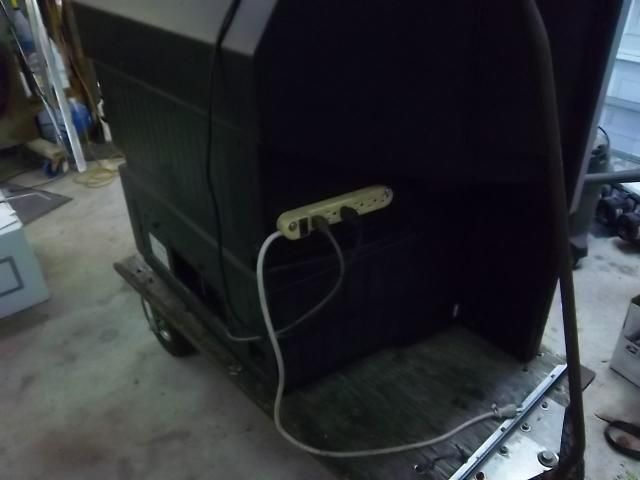

An old power strip screwed to the side provides a place to pug in everything and it's ready to go.

Looks great! Just a thought to watch for during testing, Being as the cabinet is plastic, it may tend to have static issues. I used MDF board for mine and the vac system created a fair amount of static during painting. Make sure the motor is grounded also.
Awesome idea, keep us updated!

Great idea! I painted the inside of mine white to help with the light. I used the cheap Walmart paint and go over it whenever I doing housekeeping in the booth. My 70 year old eyes need a lot of light. I've just modified my booth for about the 4th or 5th time. I'll post some pics when I get to it.
