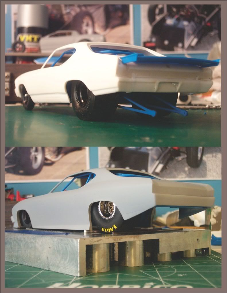

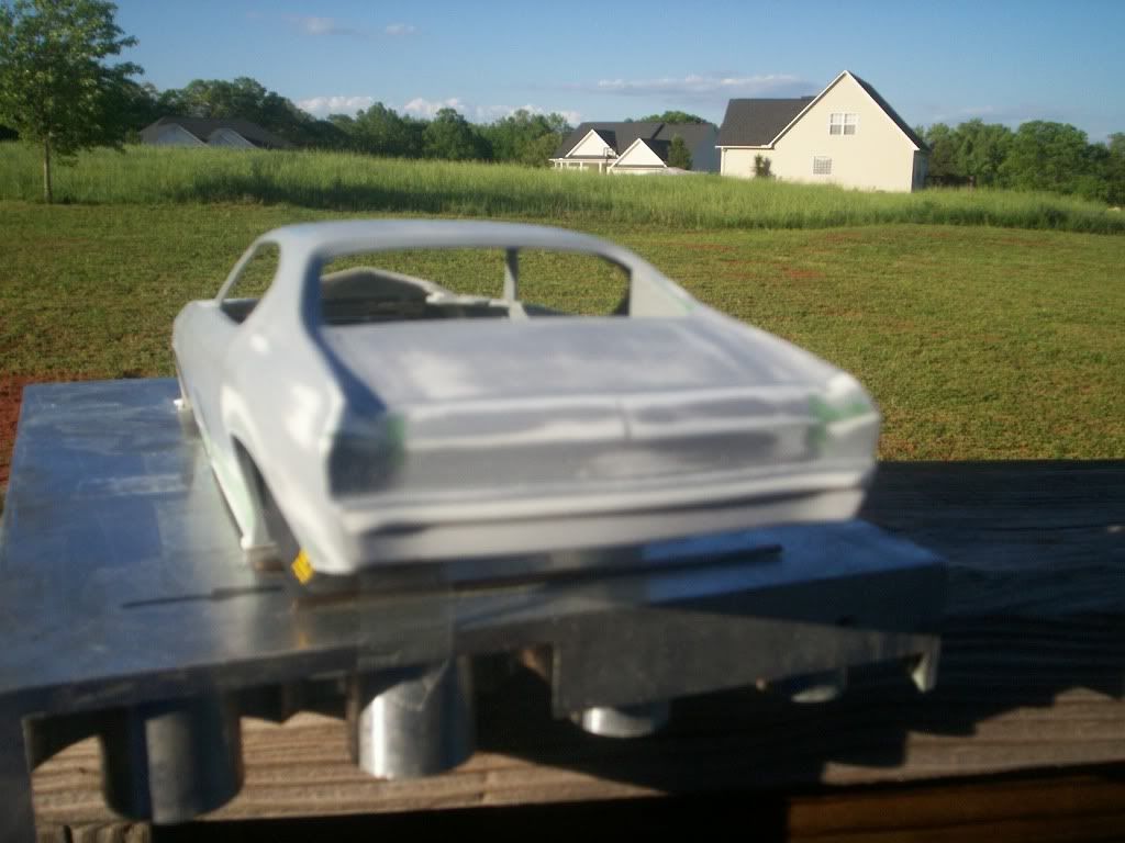

Alright guys, this Chevelle body seems to be inching closer and closer to being finished, this process of the build is close to seeing the light. I've now got the scratched rear bumper roughed in.

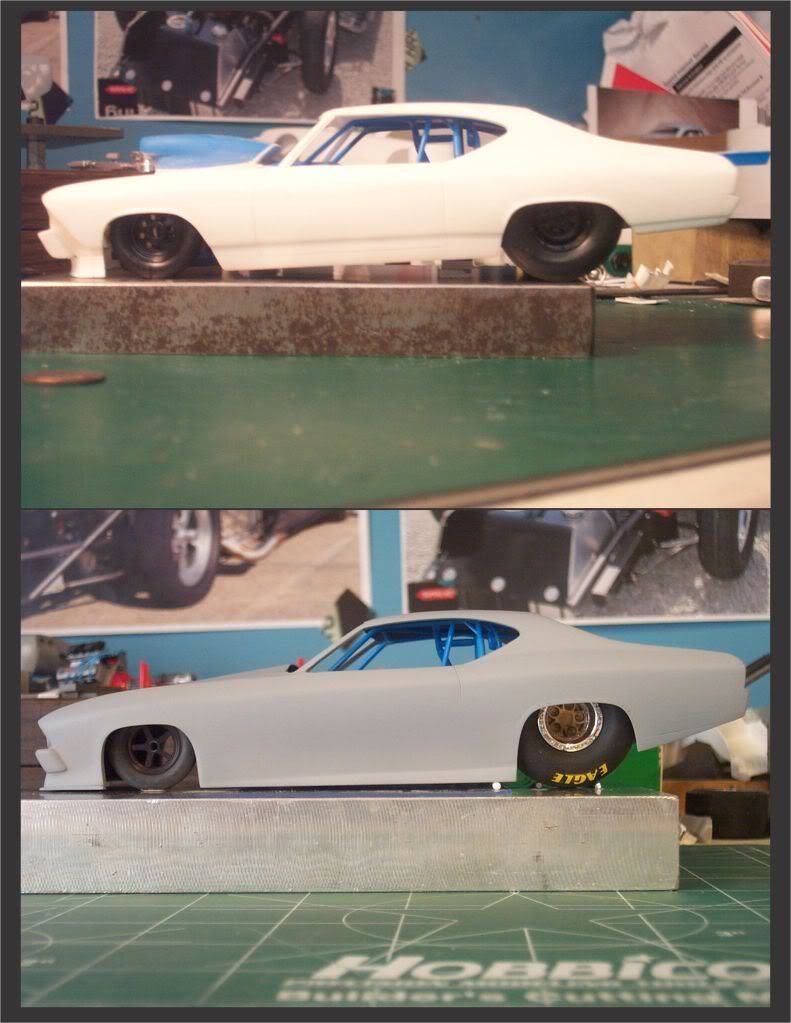

I think I've somewhat achieved my 4 main goals for this experiment. I've achieved an aggressive wedge shape, brought the roof line into the aero world and close to having the narrowed, lowered and bullitt shaped nose complete. Number one goal was to keep the '69 identity, what an outstanding car and certain to always remain a standout. I can honestly say I now look at this body style different than b4 I started, with a sincere appreciation for the people who made this car happen.
I have some more processes to do, though most of the shapes will not change much more...1)Finish the front air-dam lip 2)Massage the headlights and hood 3)Finish the rear bumper/trunk lid, including wheelie-bar clearance 4)May open rear fender well a bit, looks a little bit tight 5)Scratch the rear wing and 6)Minor frt and rear bumper detail. Once I have all that, it will be time for double-checking/adjusting heights, window treatments and smoothing it all up. I'm probably a long way from paint, if this one sees paint at all...lol.

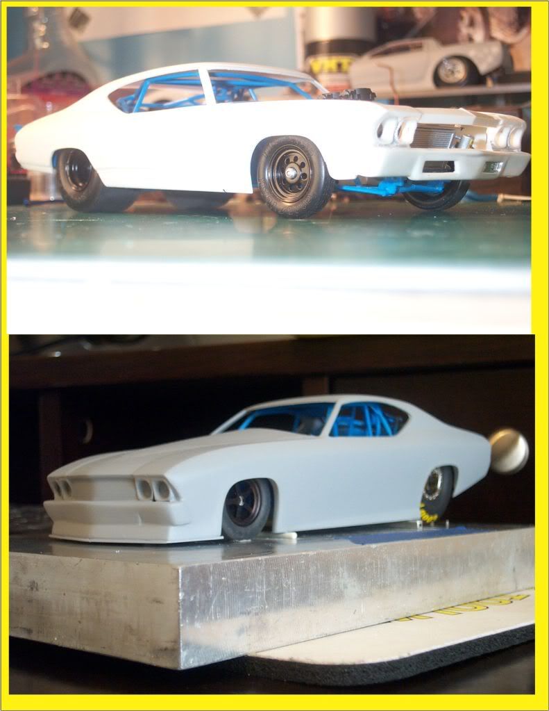

A big thanks to all who have followed and commented, I've enjoyed this one extremely....maybe chassis work is right around the corner? It would be great to have the wheels back on this one. Included some before/after pix.

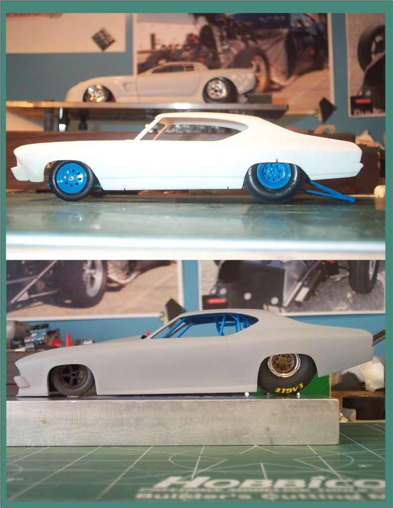

Hi guys, been at it with couple more mods....u know, chop, cut, rebuild. Posting some pix, sorry but they r a bit blurry. Trying a new camera dial-in. One day I'll finish this SS!!!
I've changed the front air dam, added more angle (front and sides) so that now I'm only five scale inches from the 45" max from centerline of frt wheels. I went ahead with adding to the sides to help match the side skirts a little bit.
I've replaced the hood bulge yet again and I think I'm almost satisflied with this one. I made this from two cut wedge sections from an old hood in the parts box, not sure what the hood went with...kinda thinking is was the WJ Olds?
Been doing some finishing/blending on both sides, those are close. Also, added some detail to the rear bumper. I used some 3/32 rod and sanded a flat on one side to .035/.040 thk for a half-moon shape, then placed. Still needs finishing. Was flexible enough to follow the bumper curves.

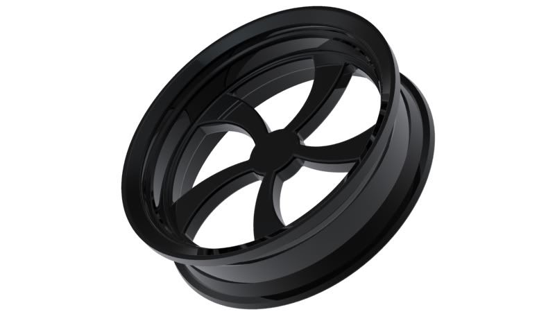

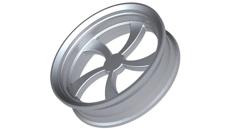

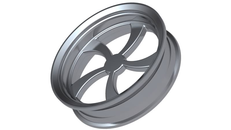

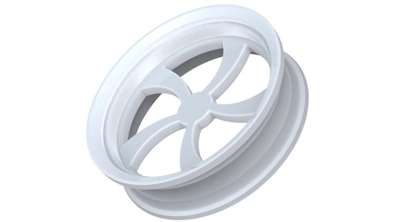

Here's one of my front wheel designs in the early stages of 3D modeling. I have more, this is the only design I've photo rendered so far. I may machine them, though I'm looking into several processes to make these. Thanks for looking.
Jeff this thing is looking great. I am loving all of the body mods and you sure have a lot of time and hard work that is going to pay off. Those Rims are sick and love the design. I vote for the Black ones. I can't wait to see what you have instore next.

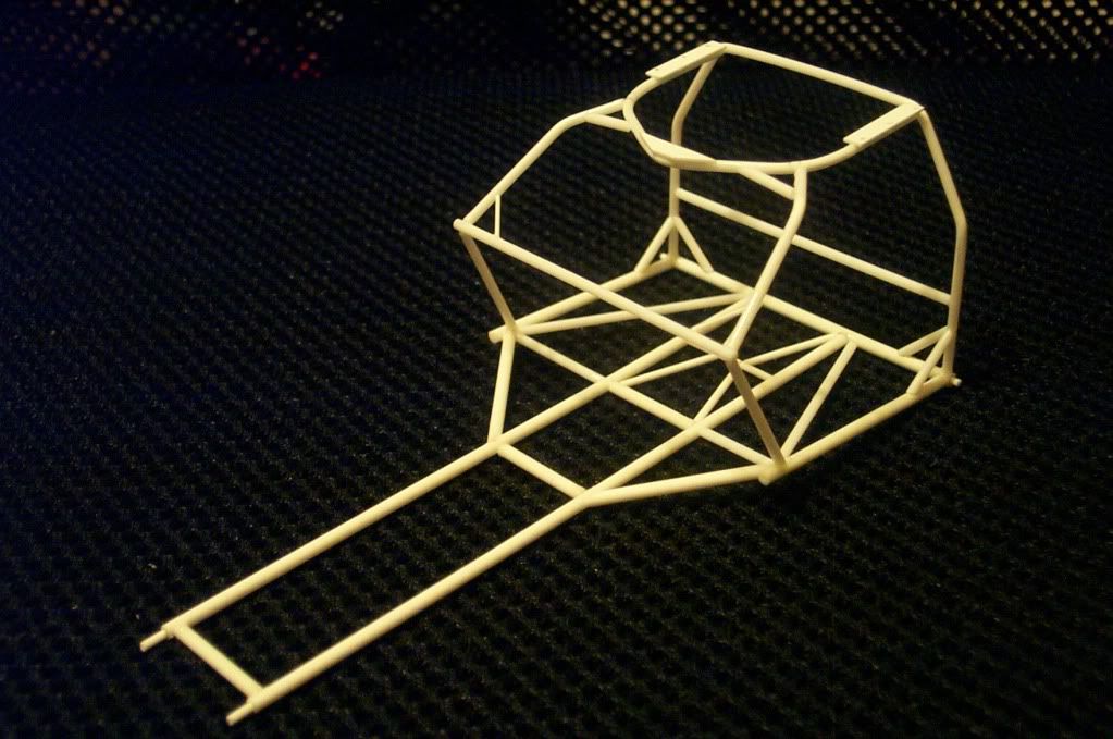

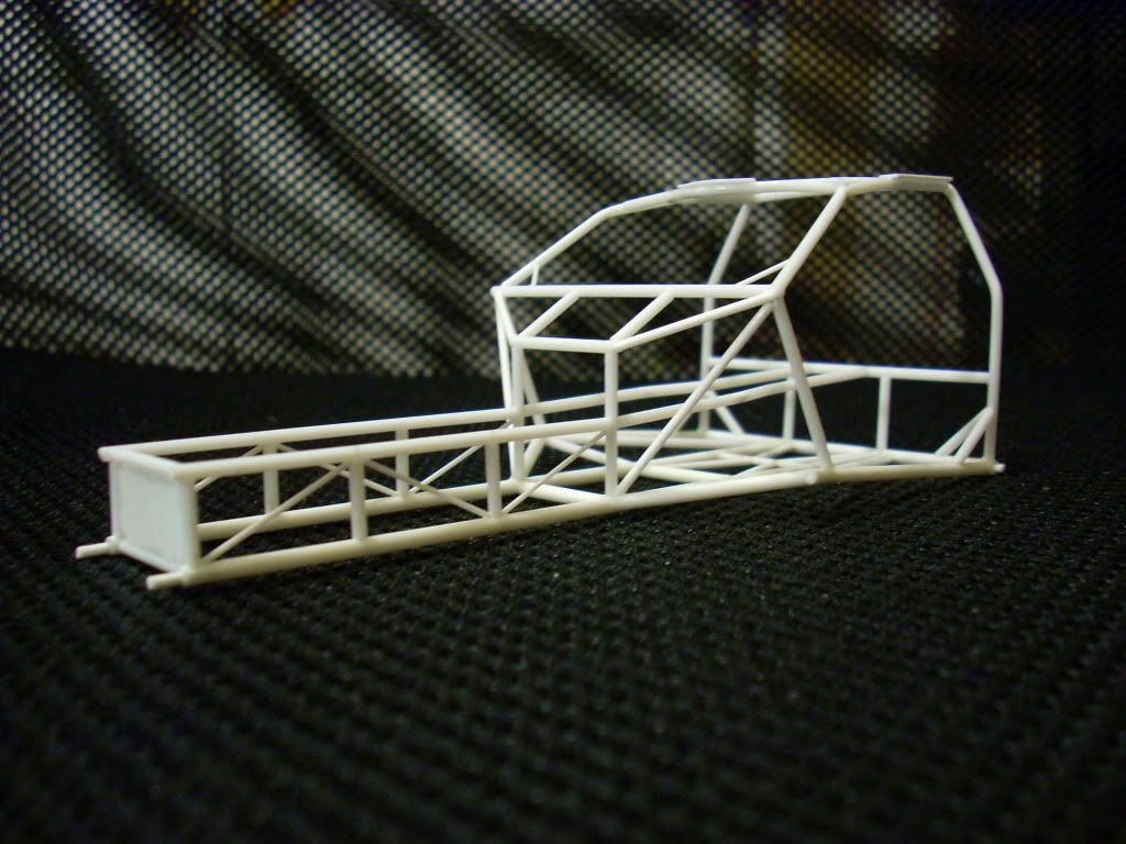

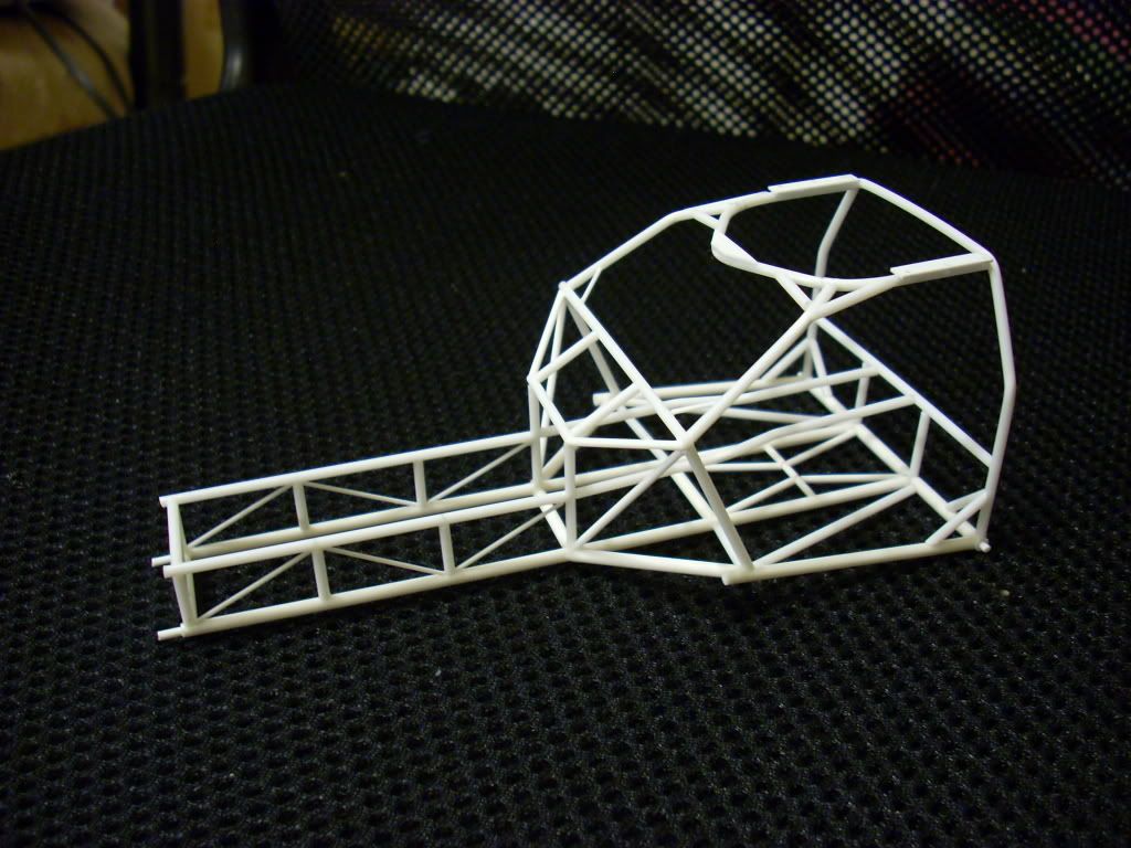

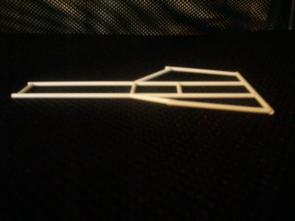

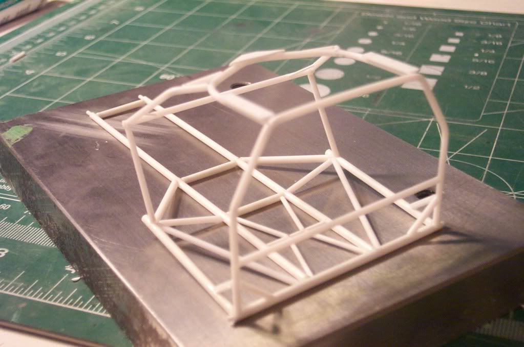

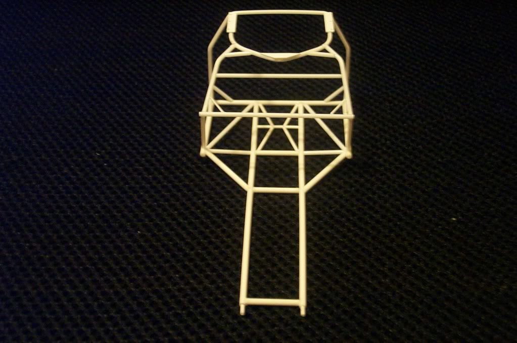

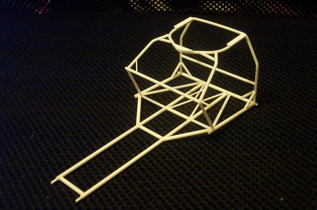

I started some chassis work last night, I have the main platform rails laid out and hope to do some more this evening. Included couple pix of the start, using styrene tubing. This is my first attempt at a chassis in plastic, hope it goes well. I usually go with soldered brass, we'll see what happens. Thanks for looking!

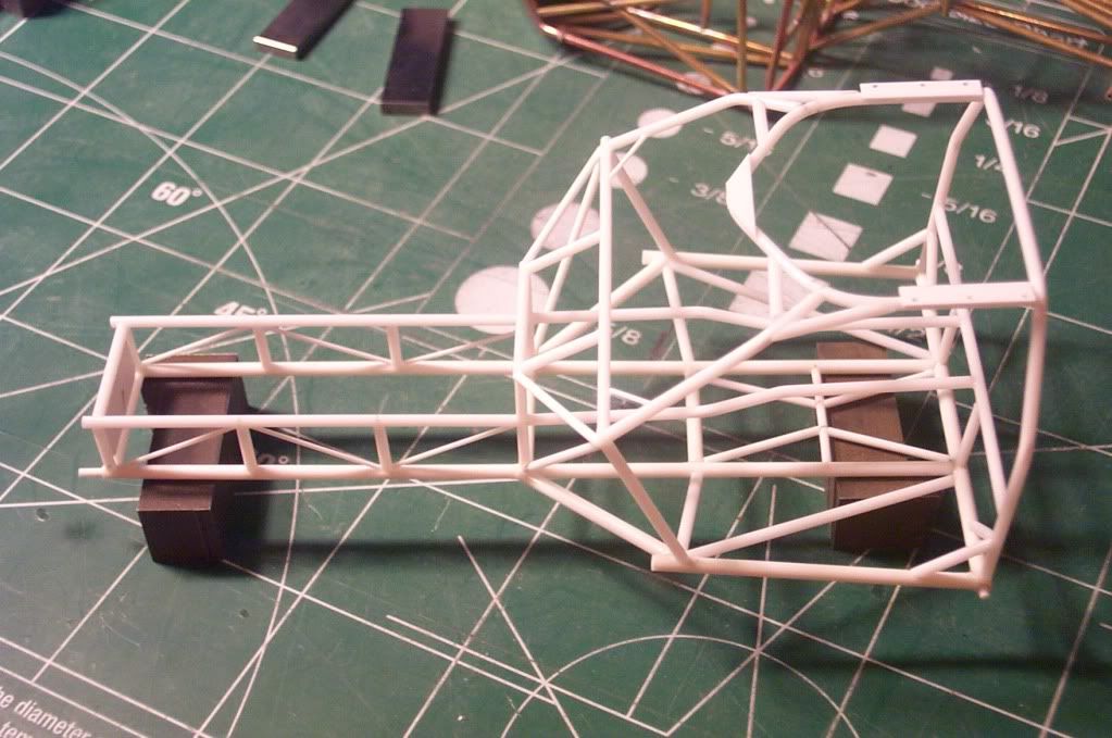

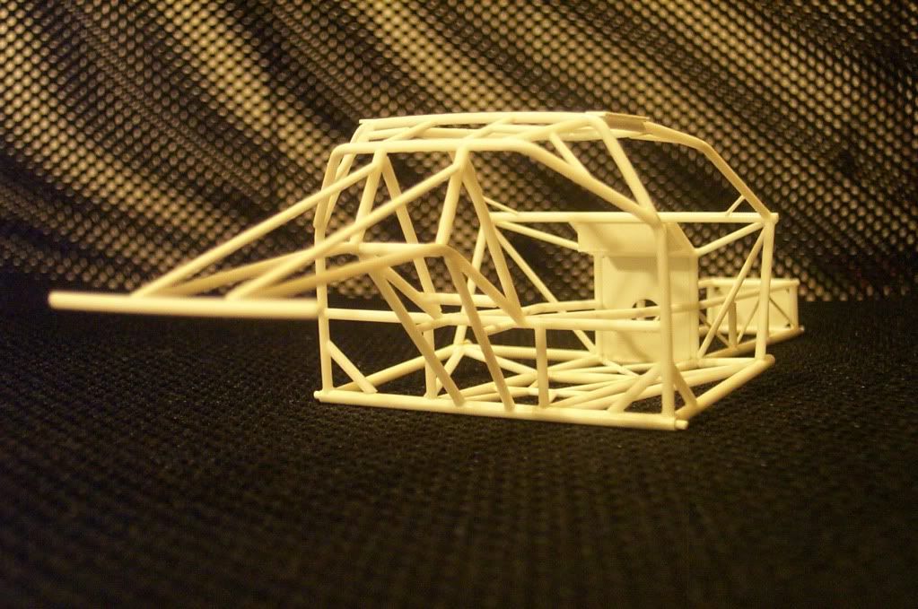

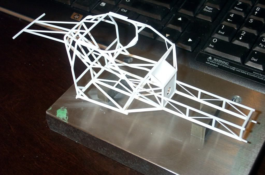

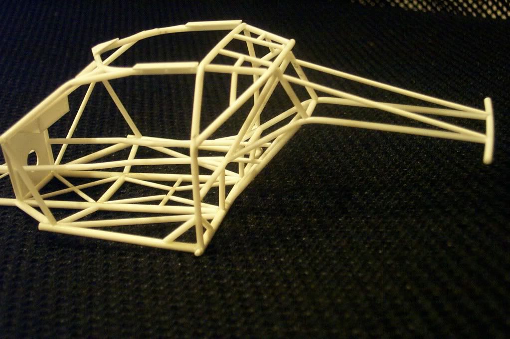

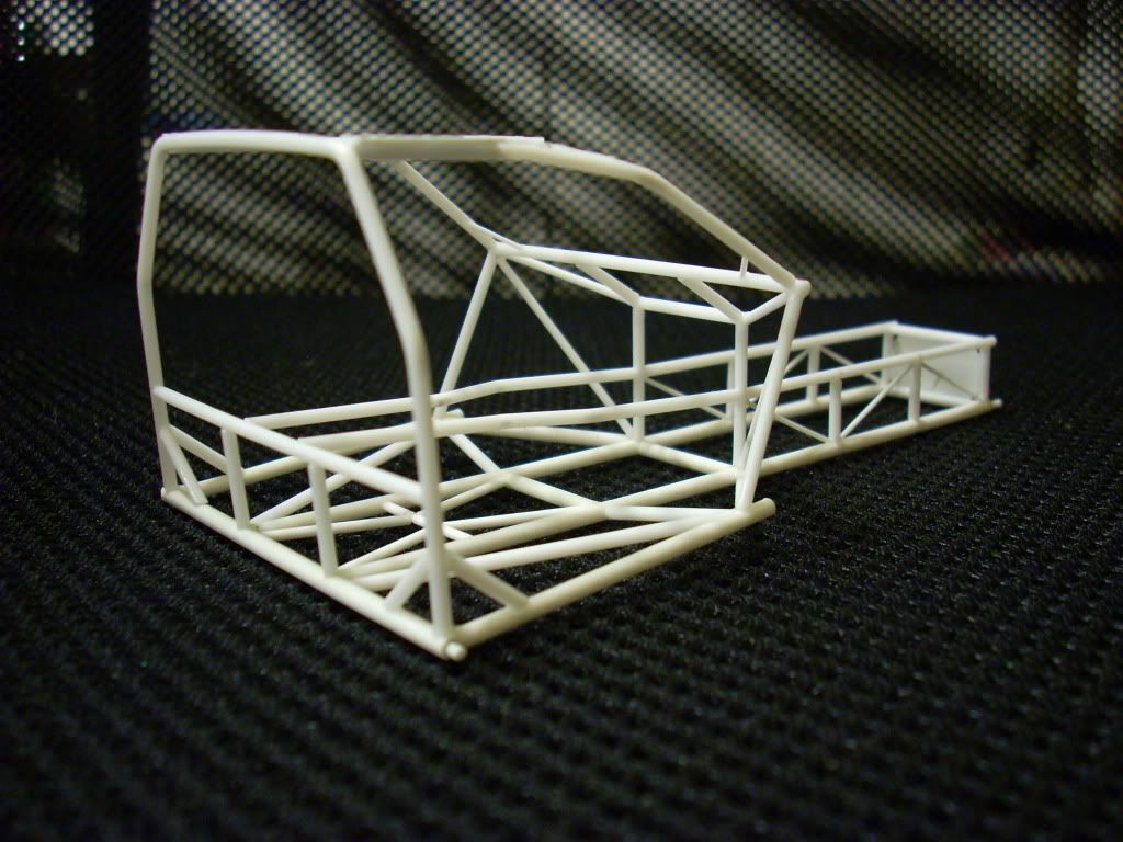

Hello all. I was able to make some chassis progress today for the drivers compartment, also able to establish mounting points to body....fits pretty well. I hope to make it to having front suspension this week while finishing the body. I'm using .093 on the main rails, .062 on the other main tubes and .045/.025 for support tubes. I'm using varied sheet thk's for body mtg brkt's. Thanks for looking!

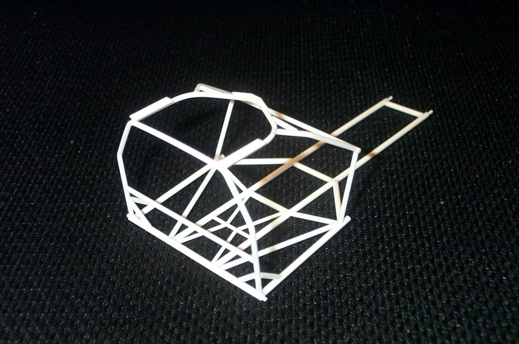

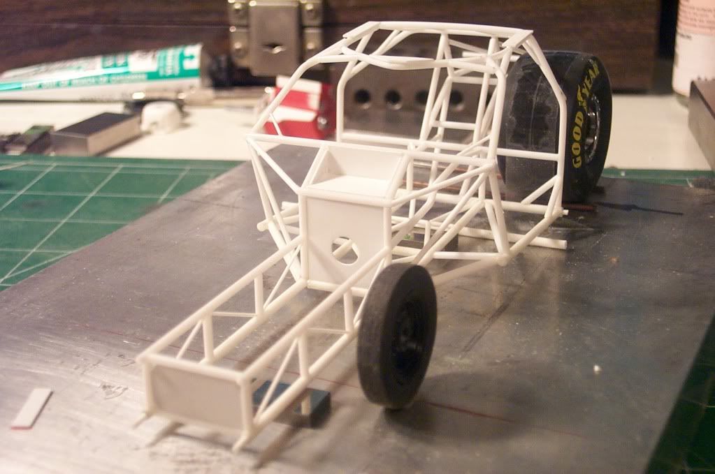

Hello all. I've been able to make a bit more progress on the chassis...added the firewall and a good portion of the front clip.

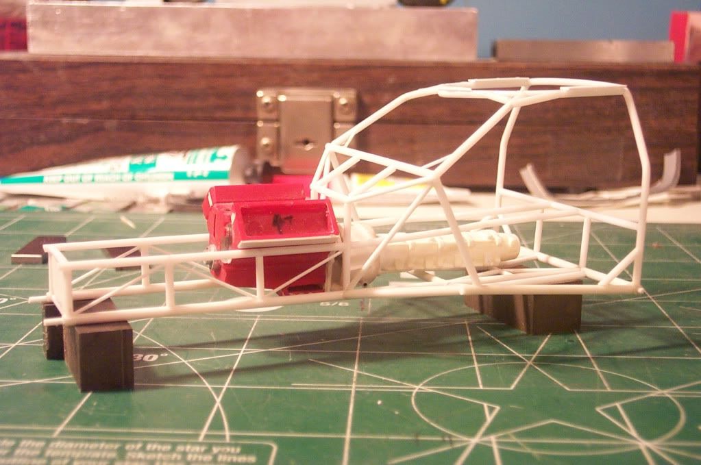

Also, I have the powerplant (will be fully blown) and some running gear started. The block is from one of the old T-bird pro-stockers and will be modifying that to....well, not sure yet, but will be current. The bell housing will resemble a Trick Titanium unit and the Lenco is a five-speed that I may cut a case out of to be a 4-speed.

The chassis looks great. Somehow I missed the bodywork to raise one side of the roof and tail light section. It sucks that you had to make the corrections, but I'm glad that you did it and shared the work with us. Your hard work is really paying off. This is a truly exceptional build. I think you exceeded your goal of retaining the character of the '69 Chevelle in an aggressive and modern promod. :P

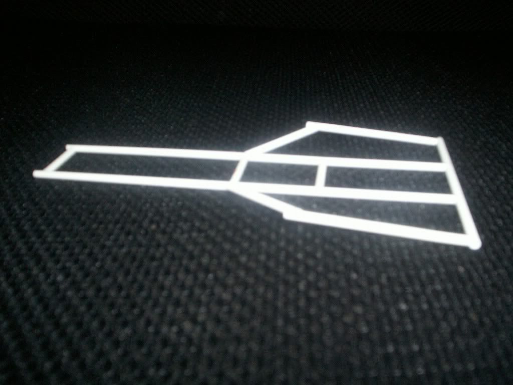

Hi guys, thanks for the comments. Been able to make some progress on the rear of the chassis and some sheet work on the firewall. Hope to make some good progress over the next week.

Jeff, you have been making great progress and that Chassis looks great. Love the look of the firewall and can't wait to see the mods on the Rims that you have done. Also the rear of the chassis is awesome!
Awesome work man !! that chassis is very cool. Quick question, did you find the styrene chassis easier to do than the brass ? or was there another reason you used styrene? sorry that was 2 :)
