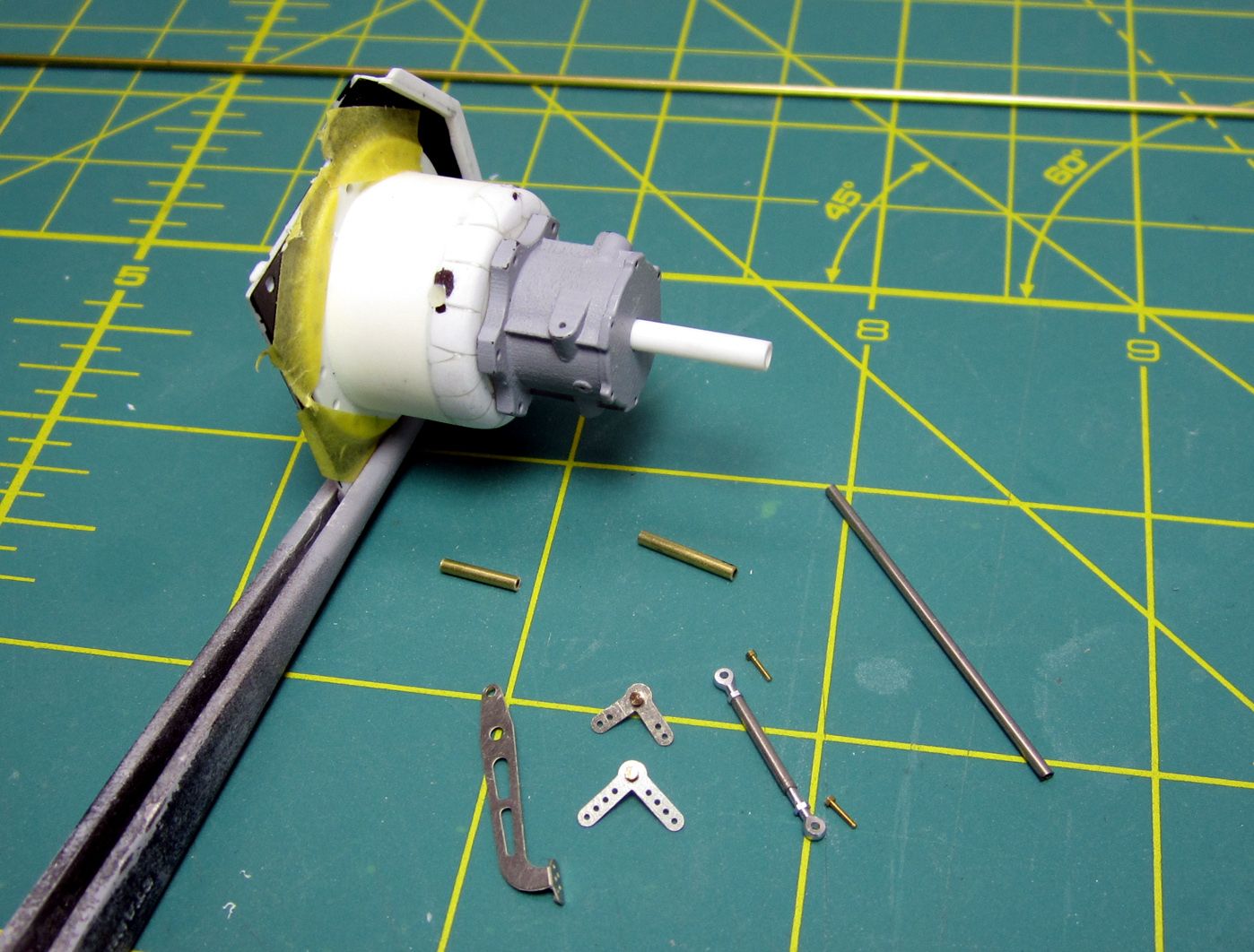

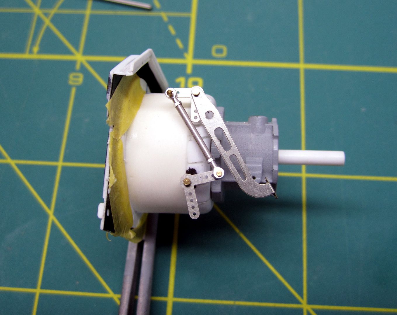

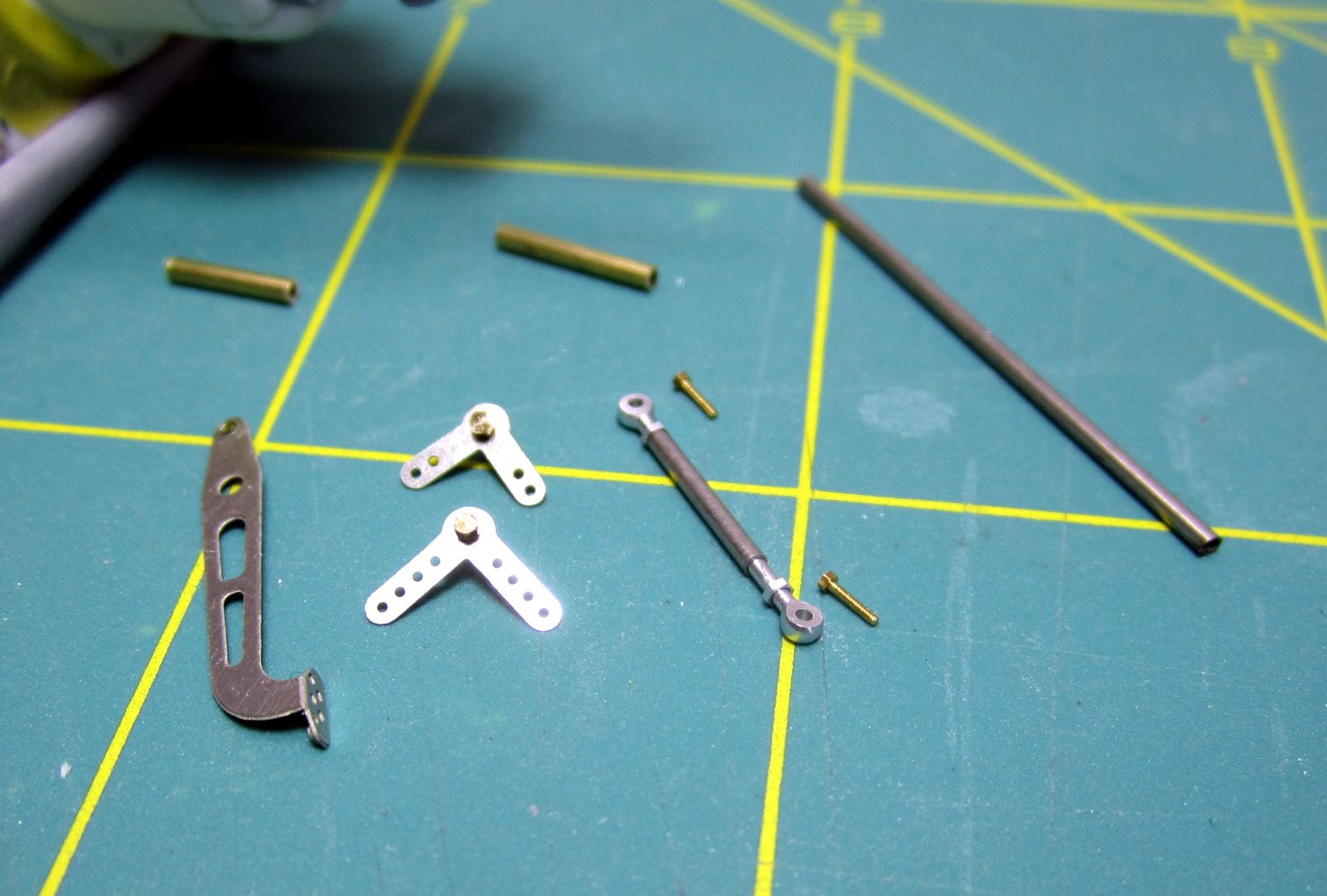

Mooneyzs Posted January 25, 2015 Author Posted January 25, 2015 Ok Fellas... I have an early afternoon sneak peak I wanted to share what I was working on for the last hour and half. Got a little bit of a late start at the bench today. I was hoping to be at it much earlier. Anway here is more progress with the transmission. remember it is in the early stages..... So here is a sneak peak at all of the parts.... I have here parts from Pro-Tech, Future Attraction and RB-Motion..... Up-close shots of the parts: Here is what I am working on... The clutch pedal and the linkage. Keep in mind that I have to trim the two Pro-Tech linkages and then I will be soldering the clutch pedal lever and one of the Pro-Tech Brackets to each other. When this is done I think it should look somewhat ok:

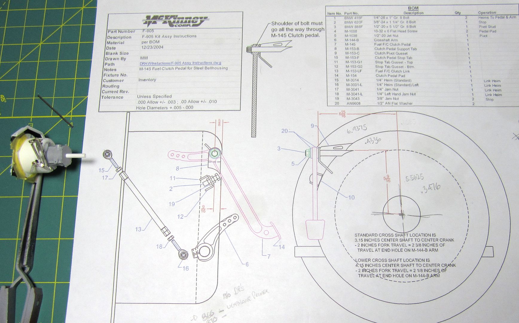

Mooneyzs Posted January 26, 2015 Author Posted January 26, 2015 (edited) Bob... Thank you. Danno... Thank you buddy. You know I need to bust my tail off to get this one done. I keep telling you, I hope to have done by next years Desert Scale. I would love to have it done for this years if possible...lol It will be close for sure I bet... haha Martin... Thanks man. Part of what I came up with was from a drawing that Dave (Comp1839) sent me. I have seen different funny cars from searching pics but I never had a pic of the army vega funny car that show this so I made the decision to make something look like the drawing Dave gave because I know it would be correct. Here is a shot of it Cheers: Edited January 26, 2015 by Mooneyzs

Nitrozilla Posted January 26, 2015 Posted January 26, 2015 You need to start providing an "Awesomeness Warning" on updates like that Chris. I'm old and I was fine looking at the first couple of pics. Then came the pic of the assembled linkage. I think I strained something. Gonna' have the doc take a look. Might be a hernia.

Mooneyzs Posted January 26, 2015 Author Posted January 26, 2015 Mike... Thanks. you and me both on seeing this done. I did get more done last night but wasnt able to upload the pics. i got the linkage cut and shapped as well as getting ine of the Pro Tech brackets soldered to the clutch pedal. hopefully I will get a chance tonight to get a little more work Done. Gluing the mounts on the clutch can and addind some bondo so I can get thoa bad boy in primer.

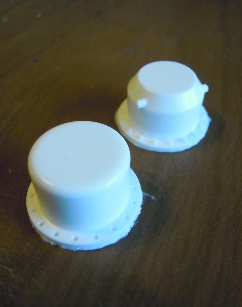

edboys Posted January 26, 2015 Posted January 26, 2015 (edited) Chris, you should have given me a shout cause I would have sent you another clutch can that is shaped like that. You did a wonderful job transforming the chamfered type anyway. Photobucket is down at the moment so I can't forward a pic, maybe later. Edited January 26, 2015 by edboys

edboys Posted January 27, 2015 Posted January 27, 2015 Here's the pic I wanted to share earlier. These are right out of the molds. The can in front is the one that would have saved you some time, it is basic like the one you already had and the other behind it is one that I do with all the details in place. With your building skills you got the basic one so you could add those details yourself.

Mooneyzs Posted January 28, 2015 Author Posted January 28, 2015 Mark... those are some awesome parts and would of made my job easier if I would of asked you if you had a Clutch can like that...lol Love your work man. Dave... Thank you. It has been fun working on the tranny.

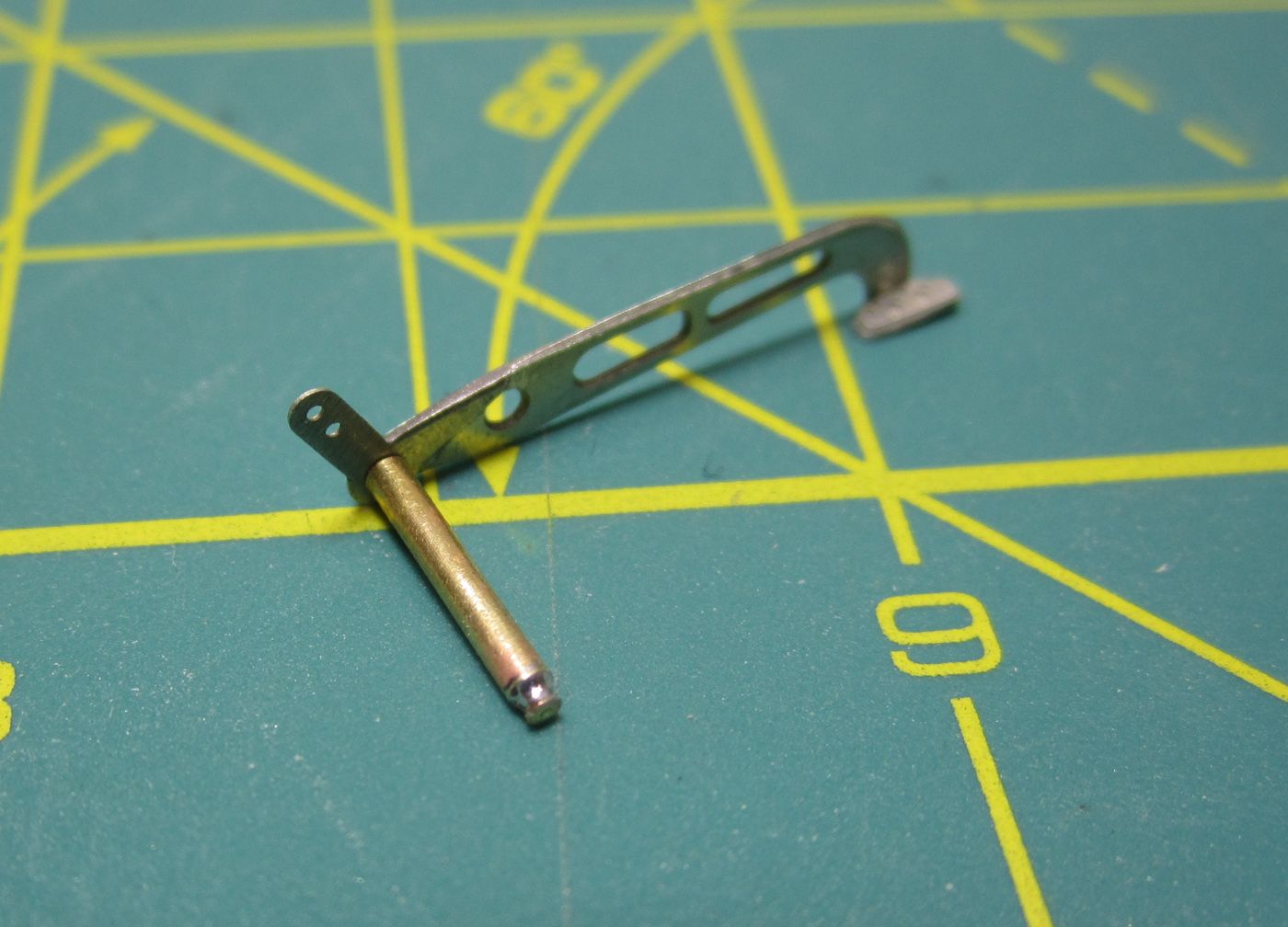

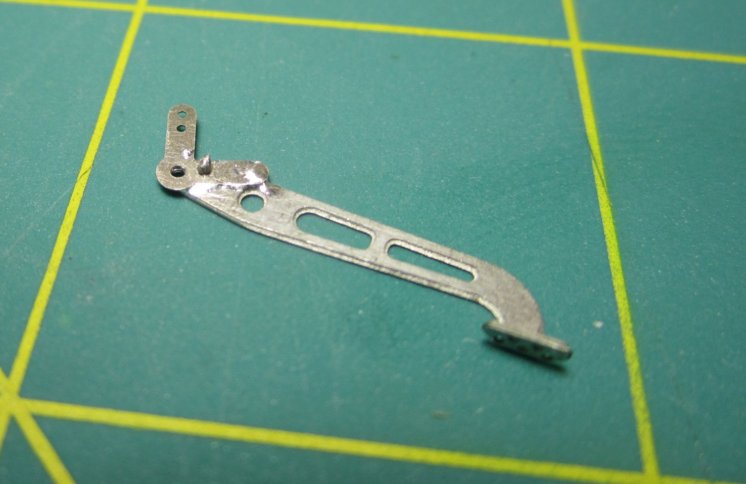

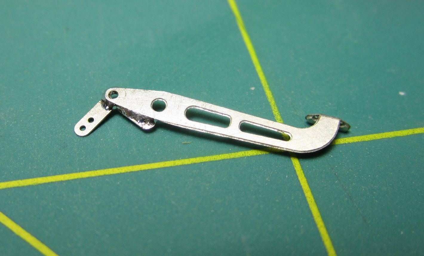

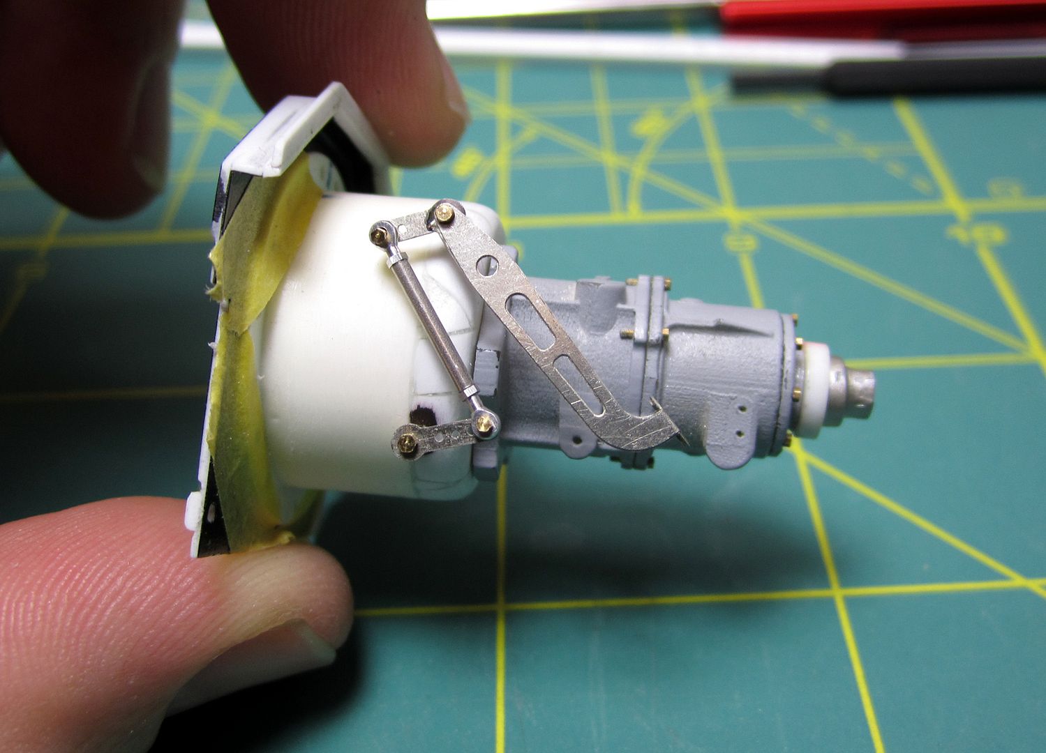

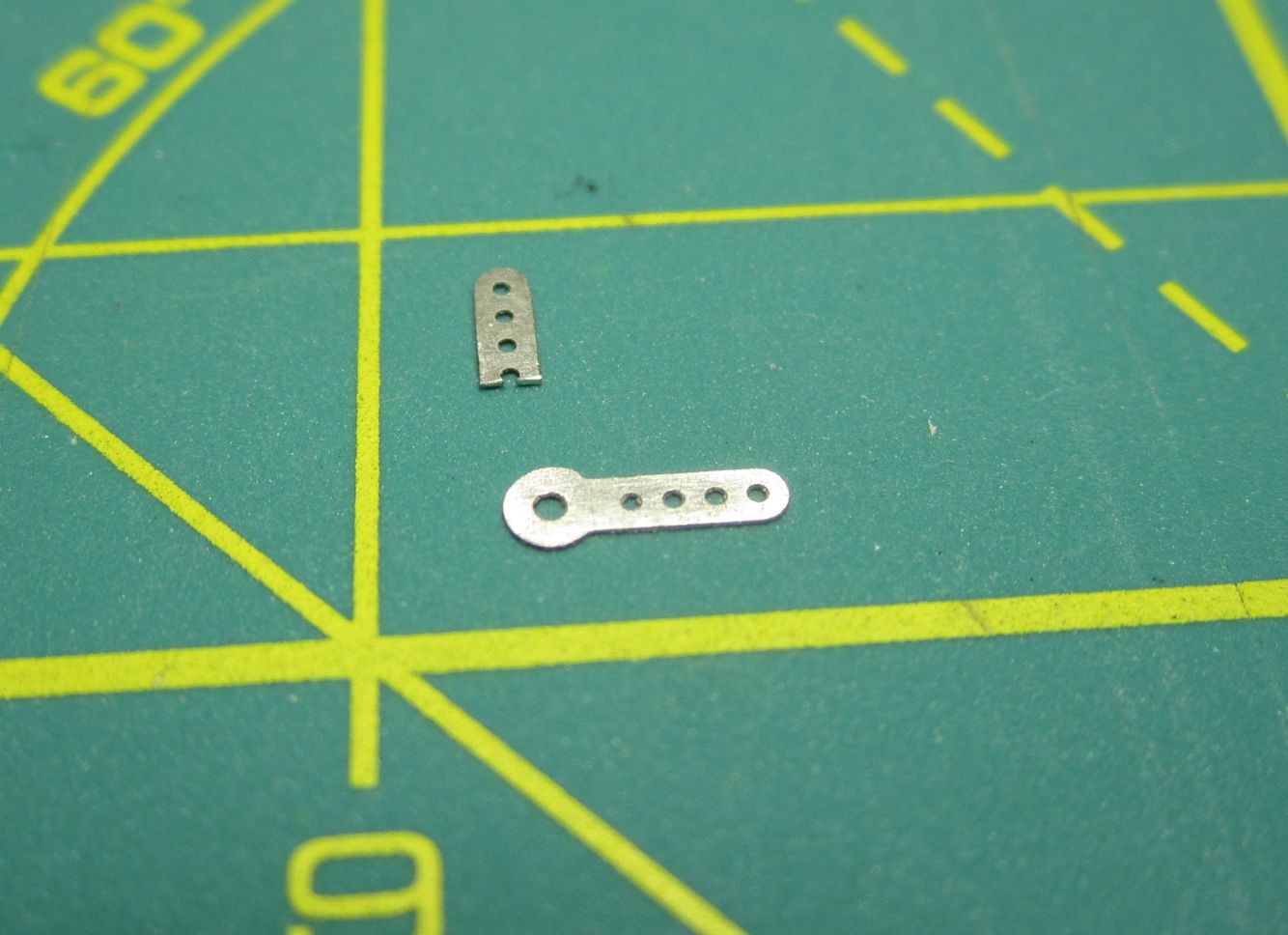

Mooneyzs Posted January 28, 2015 Author Posted January 28, 2015 Well its time for another update for all of you. I continued working on the transmission clutch pedal and linkages..... Here is the start of modifying the Pro Tech 1/16th scale Throttle Linkage brackets: Here is the other Pro Tech 1/16th scale throttle linkage bracket and Future Attractions clutch pedal that I soldered together using Tix Flux and 60/40 solder: Here is the back side to show the solder joint: Here is the Clutch mount that will be glued into the bell housing. I made it too short and a soldered and extension in to push it out a little farther: Here is a mock up of the updated Pieces:
