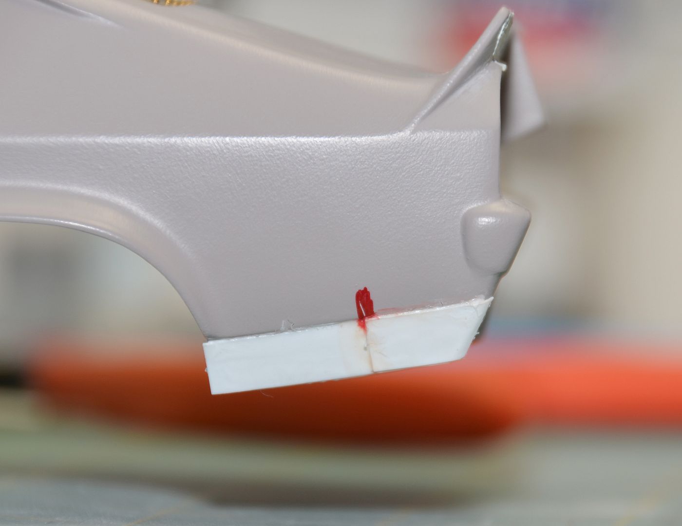

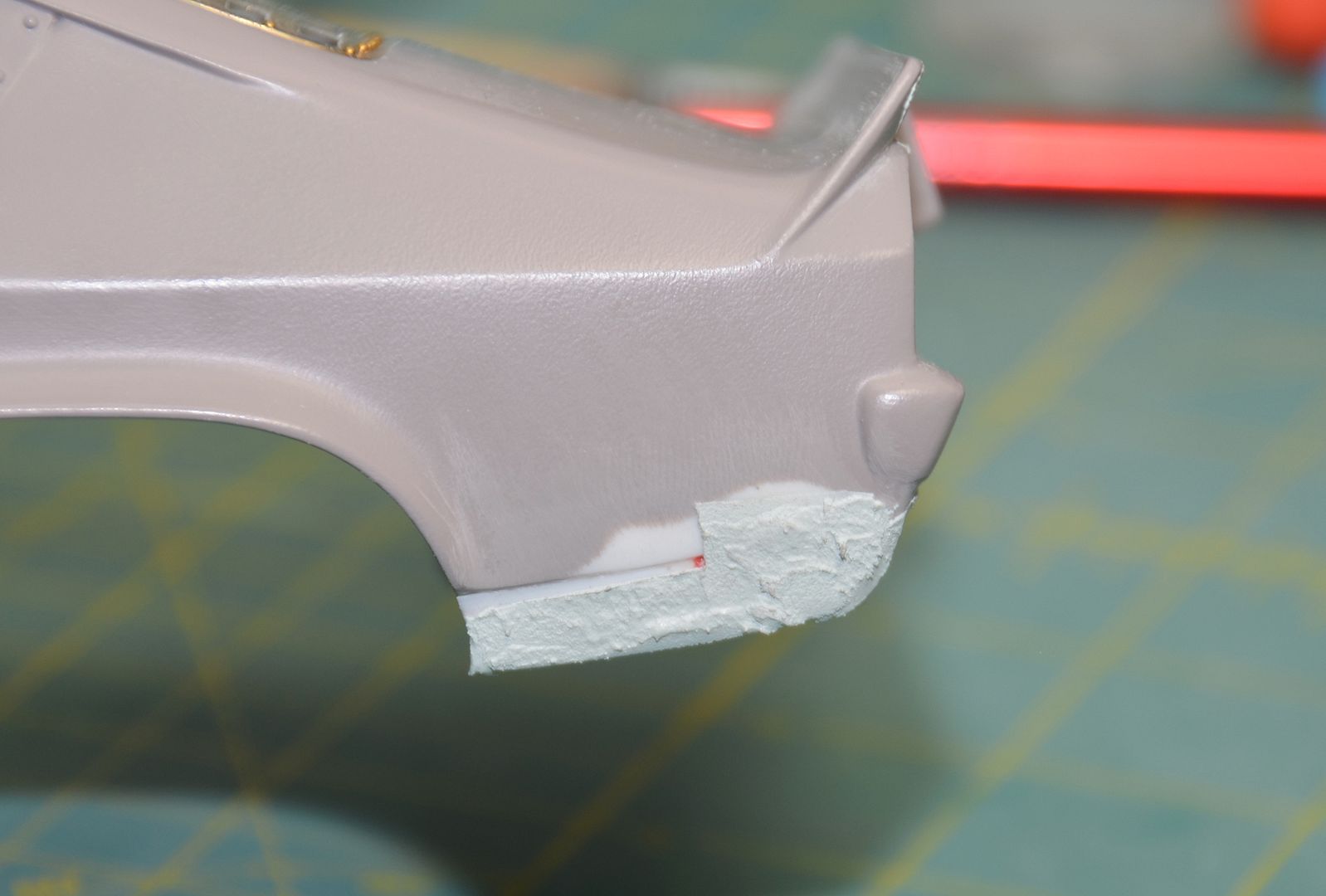

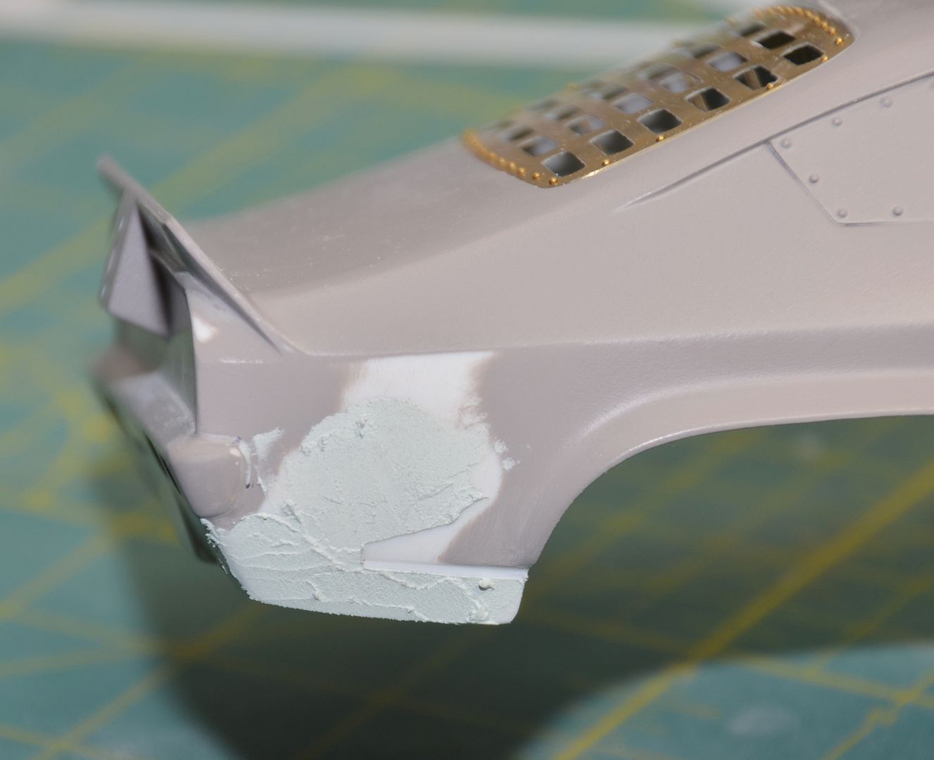

Mooneyzs Posted January 23, 2016 Author Posted January 23, 2016 Well Fellas...As Promissed... Its time for another update. I have been getting some bench time in lately. I did some additional body work to the quarter panel rear rockers to try to make it look a little more like the real car last week and then this past week I decided to tackle making the Grips for the Butterfly steering wheel out of wood and what a pain in the Butt it ended up being. What I thought wouldn't take me much time at all ended up taking me way way longer than I expected. I will show a few pics and hoping to get in some good bench time this weekend on this. So Here the addition to the rear Quater panel rockers I added. I started by laying some .010" thick styrene out on the rocker panel and glueing it to the body. Then you will notice my red mark on the quarter panel and I added another layer from that mark to the rear of the car so that it blends into the rear: I did the same thing to the other side of the car and well you see that I glued a piece of plastic to the quarter panel and it was because some how I had cracked the body from holding it and sanding it from all of the work I was doing to it. So had to fix it...lol: Then it was time to mix up some Evercoat Part #400 and lay some Body Filler down to both sides:

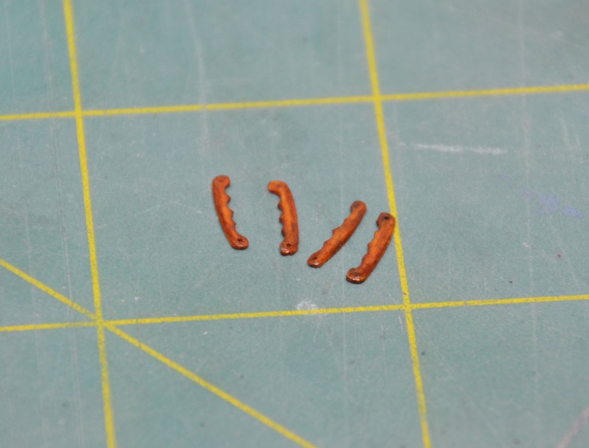

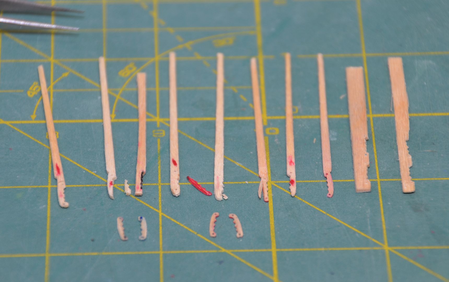

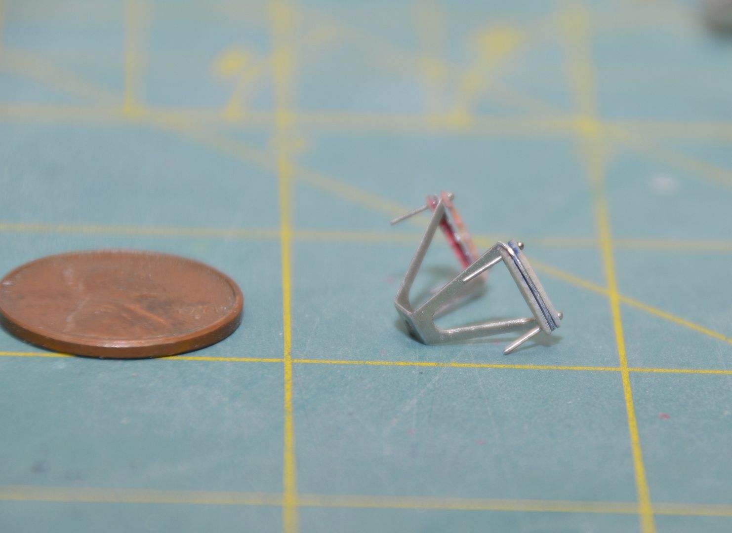

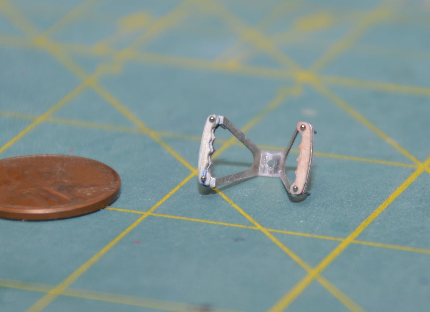

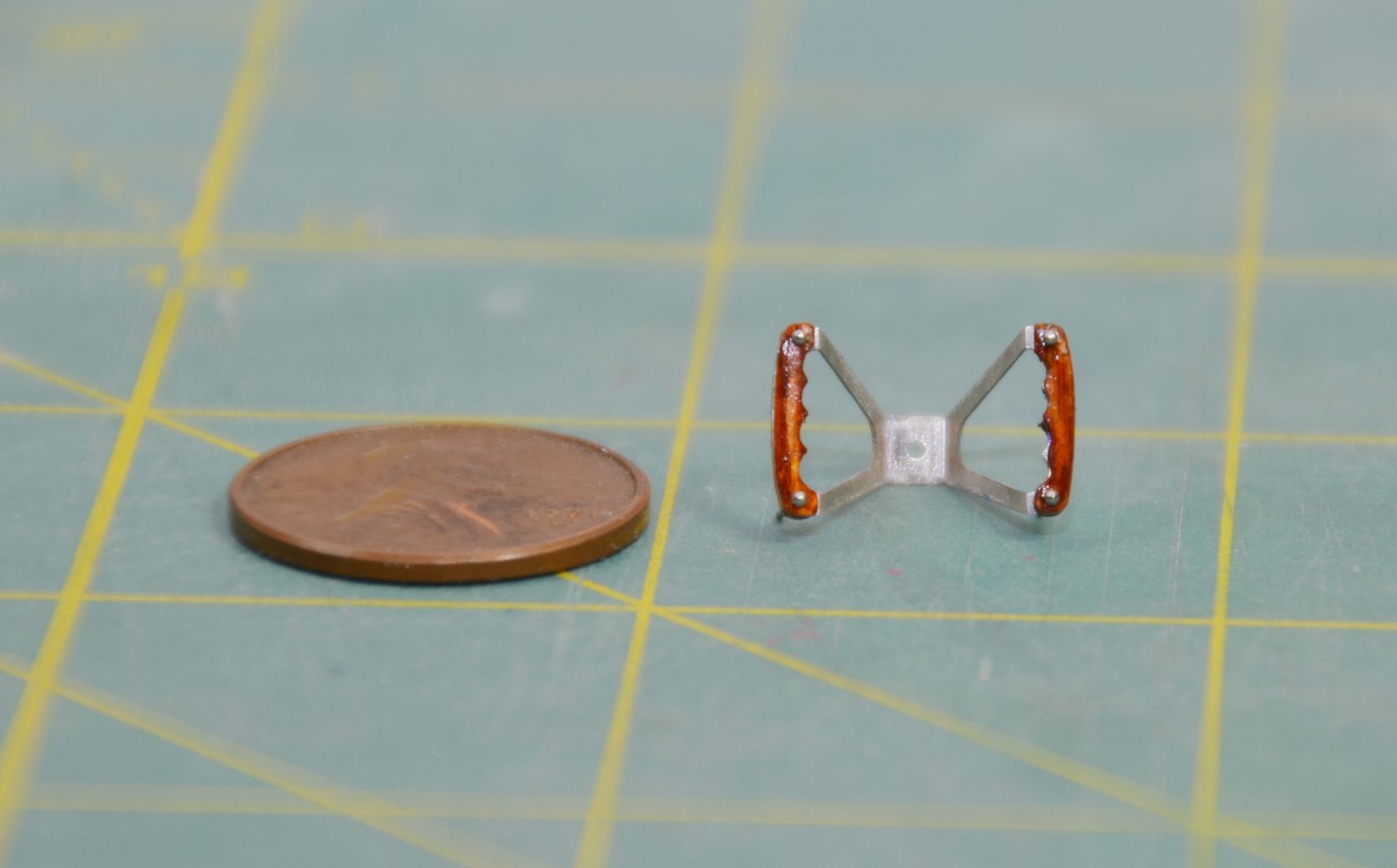

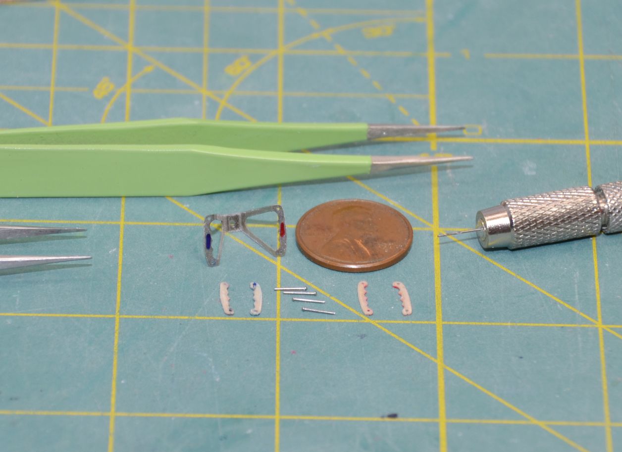

Mooneyzs Posted January 23, 2016 Author Posted January 23, 2016 Now comes my last week of work that I thought I would never get it done... LOL So here is the start of making the Butterfly Steering Wheel Grips out of wood. I started with Flat toothpicks, and well after multiple failed attempts of making these grips I had decided to try some craft stick or Popsicle sticks and was finally able to make successful pieces. Although I did have to make a few of them as well.. lol:. Here are the pieces once I was successful and happy with the grips. Sorry for the crappy pic but was having trouble getting the camera to focus on the right spot: Here I was test fitting the Grips onto Future Attractions Photo-Etch Butterfly Steering Wheel: Side View: Up next was to paint and stain the wood to try and make it look like steering wheel on the real Army Vega Funny Car. I used some Mig and Vallejo acrylic paints as well as a couple Tamiya paints. This is another pic that turned out horrible cause I couldn't get it to focus. I think I need a Tripod...haha:
Mooneyzs Posted January 23, 2016 Author Posted January 23, 2016 Here is a mock up to see how it looks on the steering wheel: And another view of it to compare with the one from the real car:

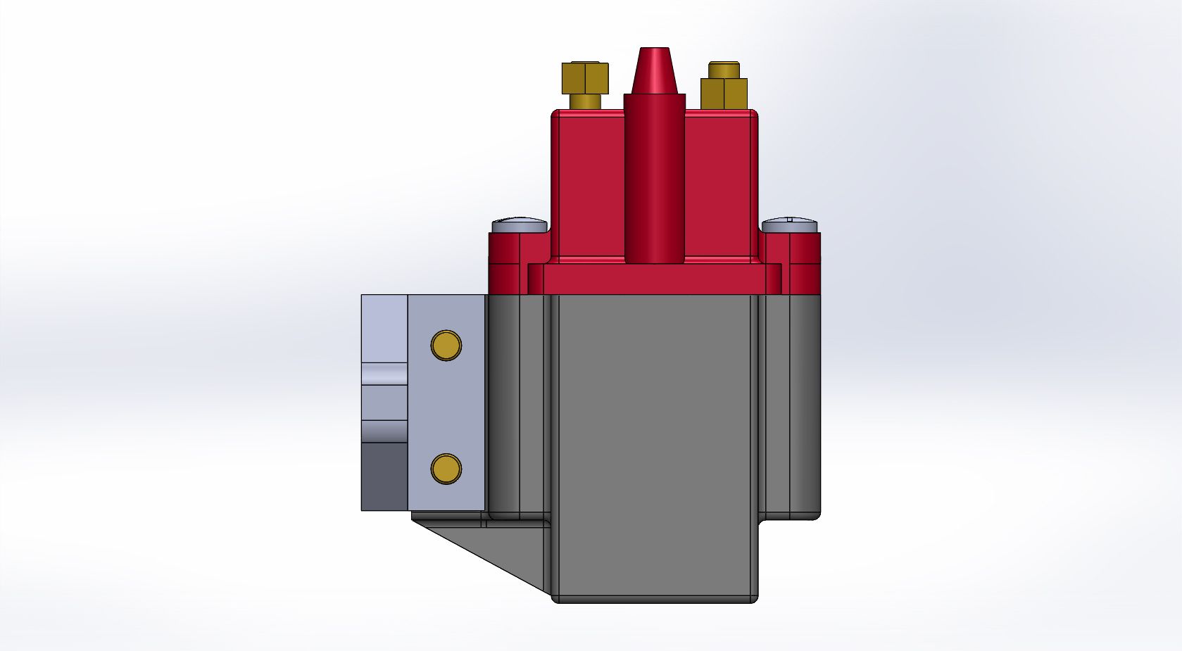

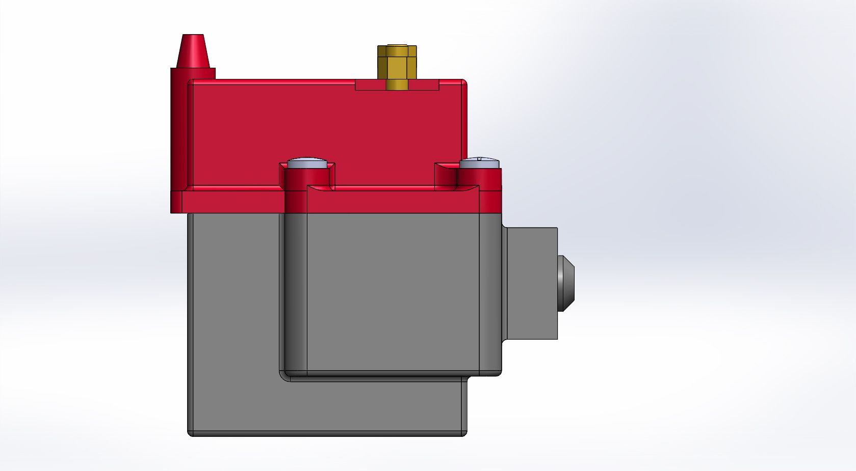

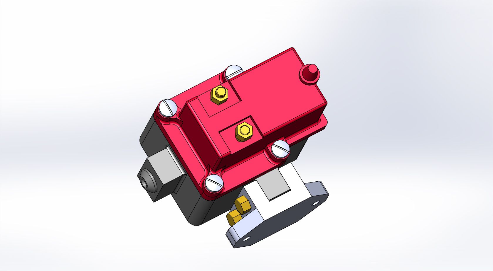

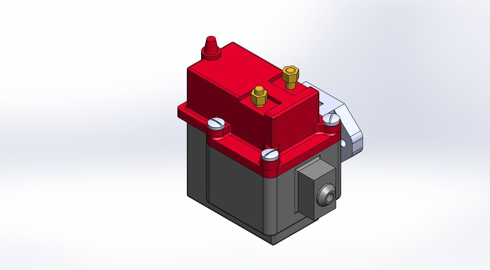

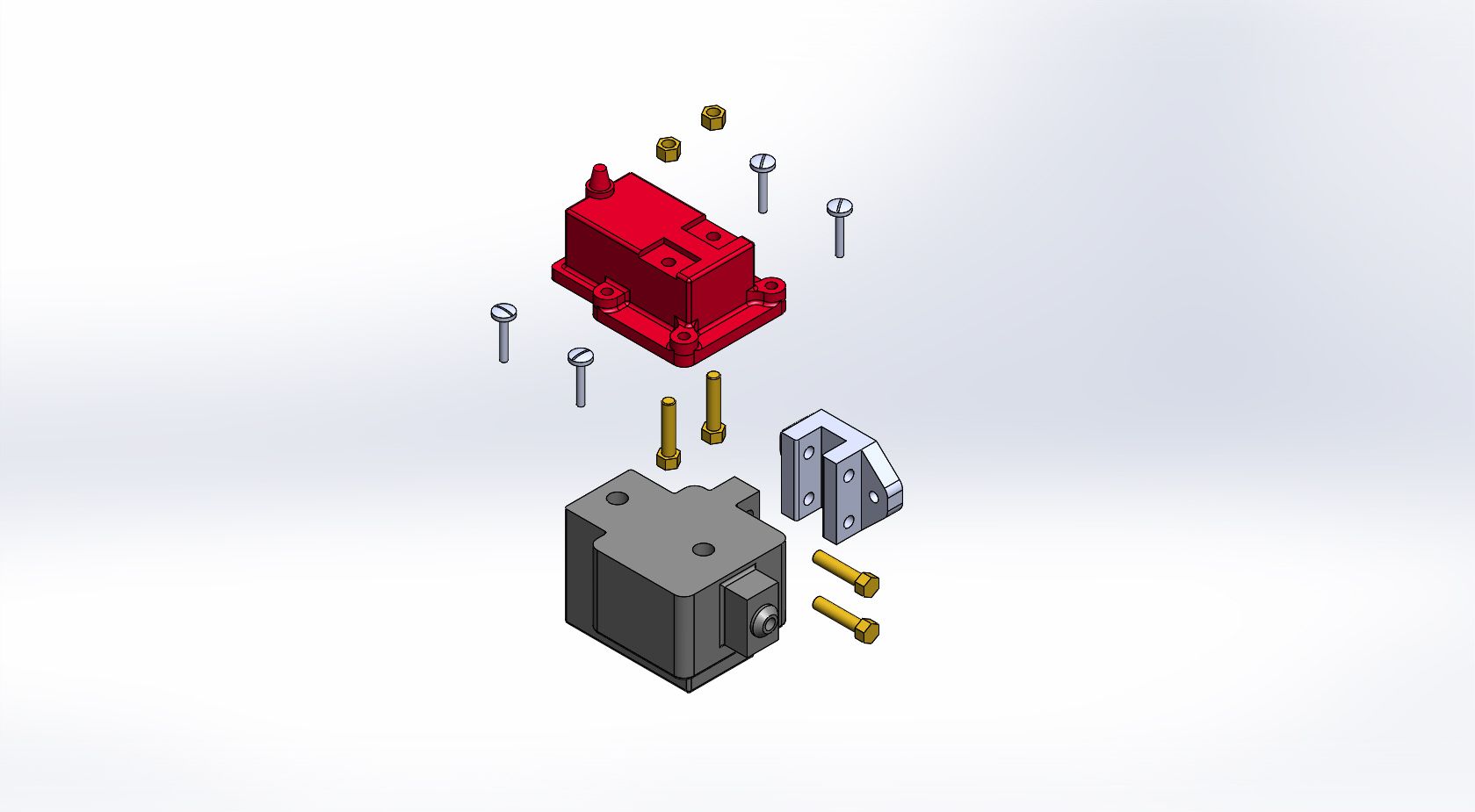

Mooneyzs Posted January 23, 2016 Author Posted January 23, 2016 Early afternoon update for you guys.... I sat at the Computer this morning designing up the Mallory Ignition Box which I will have 3D printed. Hopefully it will print ok but here are some shots of what it looks like.... Exploded View: Isometric View Back Side view of the mounting bracket Side View: Another view:
