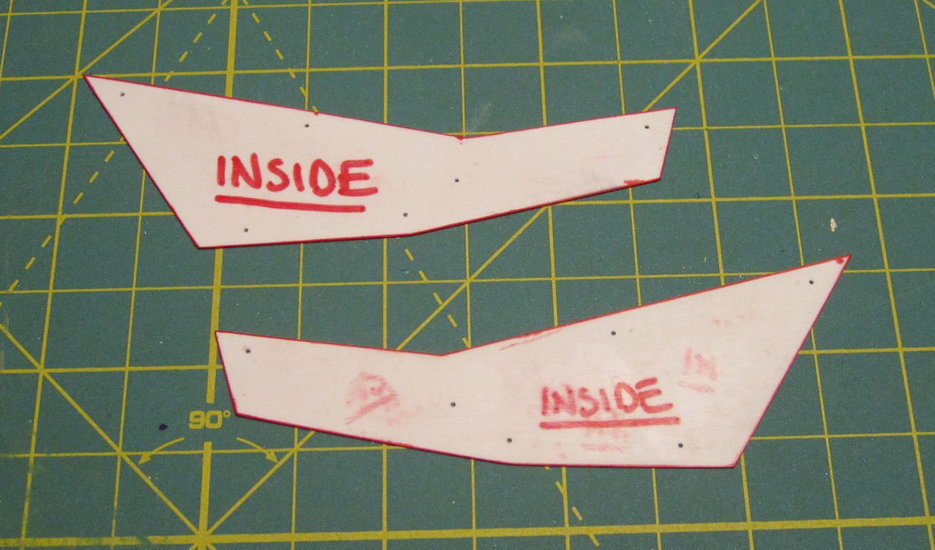

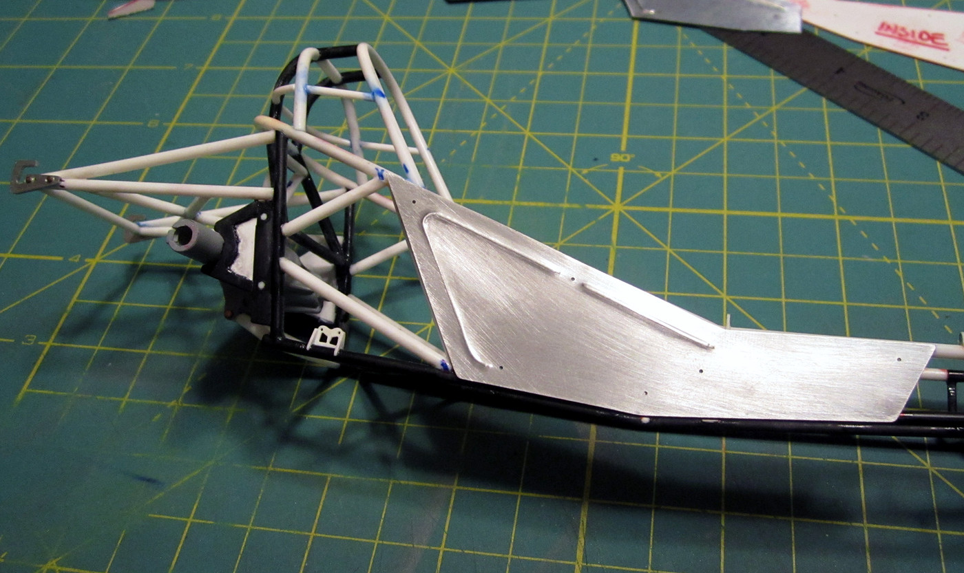

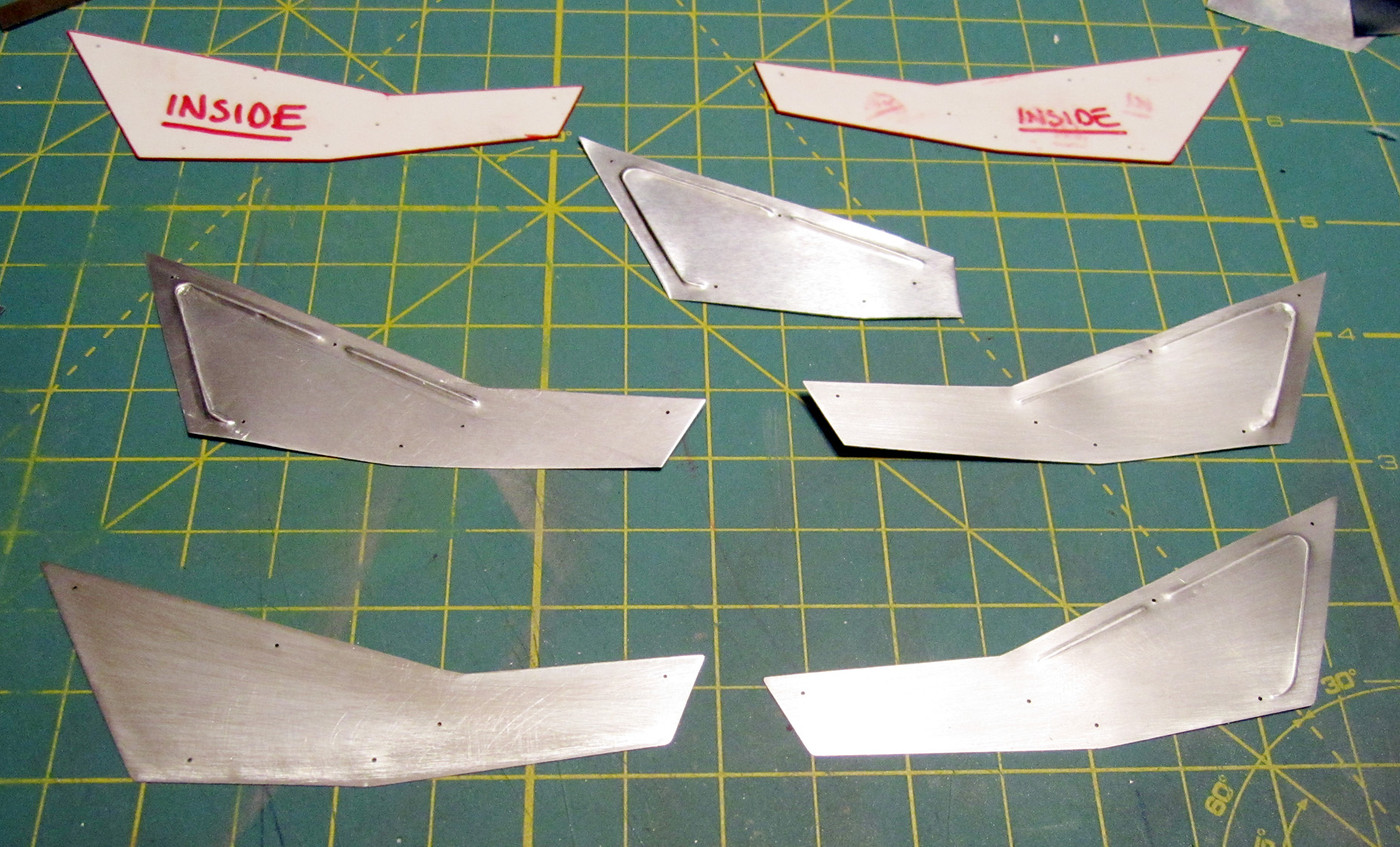

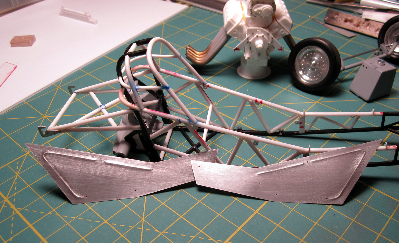

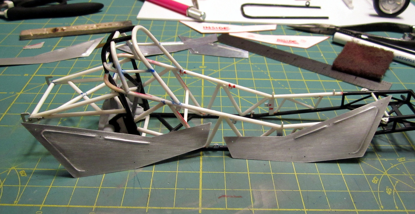

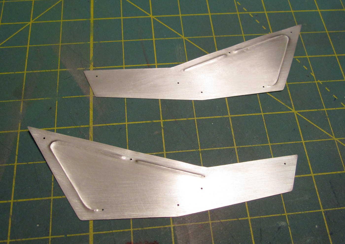

Mooneyzs Posted January 22, 2012 Author Posted January 22, 2012 (edited) Hey Edgar... thank you man for the nice words and for following along. Well as promised a little later than expected but I did sit at the bench for a few hours and worked on the Chassis Tin work and made a good accomplishment and that much closer to having the refab done. I started out by getting the templates made out of plastic, one for each side: I then started making pieces out of aluminum printing plate and as you can see I made a bunch since I wasn't totally happy with some of them and kept starting back over : After making a few of them here are the two that I was happy with although, I am considering redoing the top one yet again because I have a couple of dimples that I am not happy with. i was considering seeing if I took a little bondo to them and sanded down that you may not see them. but its easy enough to make another. but was tired for the night and decided to wait til tomorrow: I had to then hold it up against the chassis making sure it all looked good and lined up.... it passed the test : Here I just stuck both pieces next to the chassis: Edited June 10, 2020 by Mooneyzs
AZ Boy Posted January 22, 2012 Posted January 22, 2012 How did you make the rolls in the printing plate Chris? I have a few sheets of that stuff, and always wondered how to do it without creasing or marring the surrounding area.

Mooneyzs Posted January 23, 2012 Author Posted January 23, 2012 (edited) Hey Aaron.... I took the material and layed to down on a somewhat hard rubber peice and I used a ball point pen to make the bead rolls using the rubber piece as a backing. I did practice on some prior to doing it but I did a little at a time. applying pressure then applying a little more. When it was done then I had to go back and work the front of it a little more with some pieces of balsa wood pushing some of the part down because of how the piece bends a little when you put the bead in it. Brad.... Thank you bud.... I am much happier with these new tins I made. I think they came out better as well. Dave... Thank you buddy. I appreciate. Thank you for all of the inspiration with all of your builds. I am a big fan of your killer work. Joe... Thank you. I feel that I can get some primer on these tins now, I just need to clean the back side up a little and remove the ink from the ball point pen. lol Darryl... Thanks man... I sure hope it all is going to pay off. I can already see some of the reward from the rework and detail I redid. it makes me glad I did so and feel it will make it look better. Scott... Thank you as well. these past two days really tested my patience with redoing these tins. I can't tell you how many of them I made. today alone I must of redid the one side like 4 or 5 times Bob... Thank you, I really appreciate your kind words. I have been making myself take it to the next level and can say its paying off with the results so far. Well Guys I sat down for a few good hours today and tonight reworking the tins again... actually redoing one of them that I wasn't happy with. I am pleased to say that after making about 5 of them because i wasn't happy or I slipped with the ball point pen while doing the bead. I finally got it to where I was happy with it. thats all I was able to get done today but now I can move forward and add a couple more components to the frame and start diving into more of this build...... Here is a pic of the Tin pieces completed and which ones I ended up going with, so glad to have them done and I don't think I want to see another tin piece with bead rolling for a while : Edited June 10, 2020 by Mooneyzs
