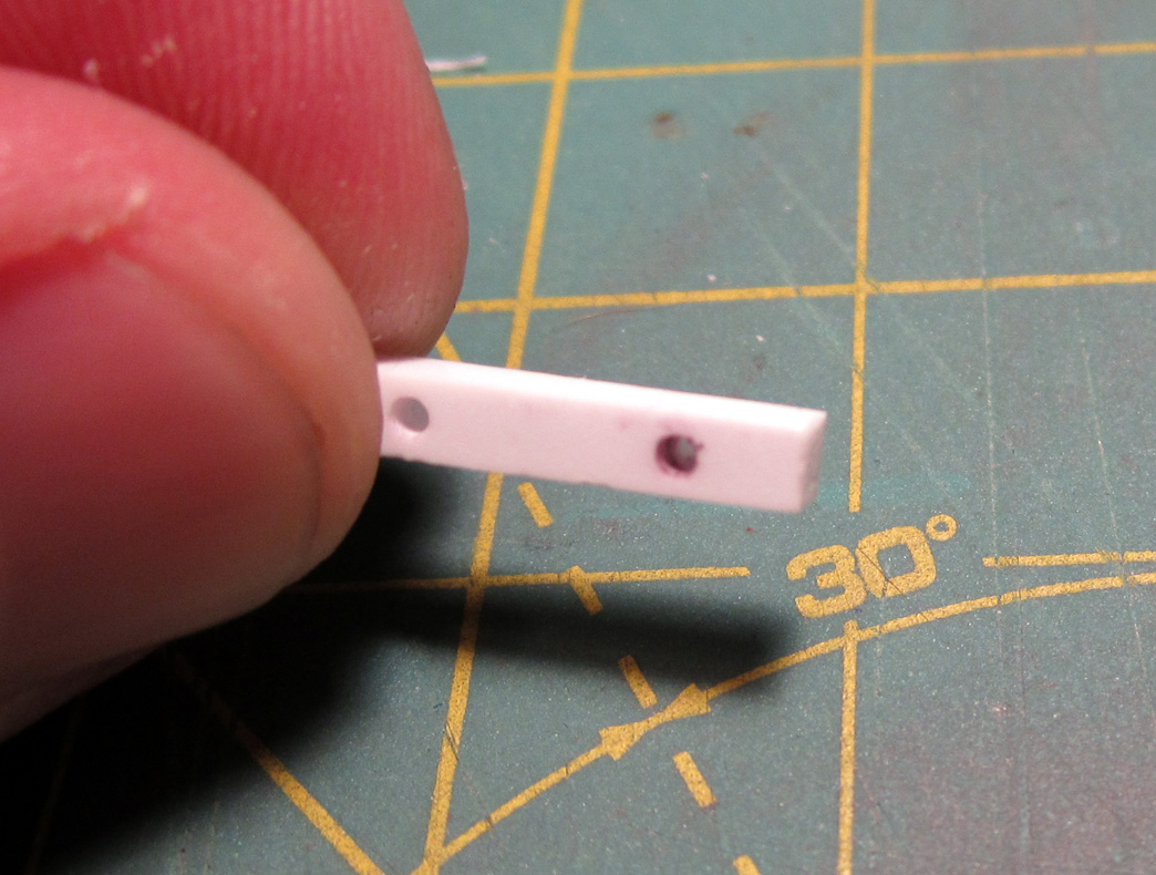

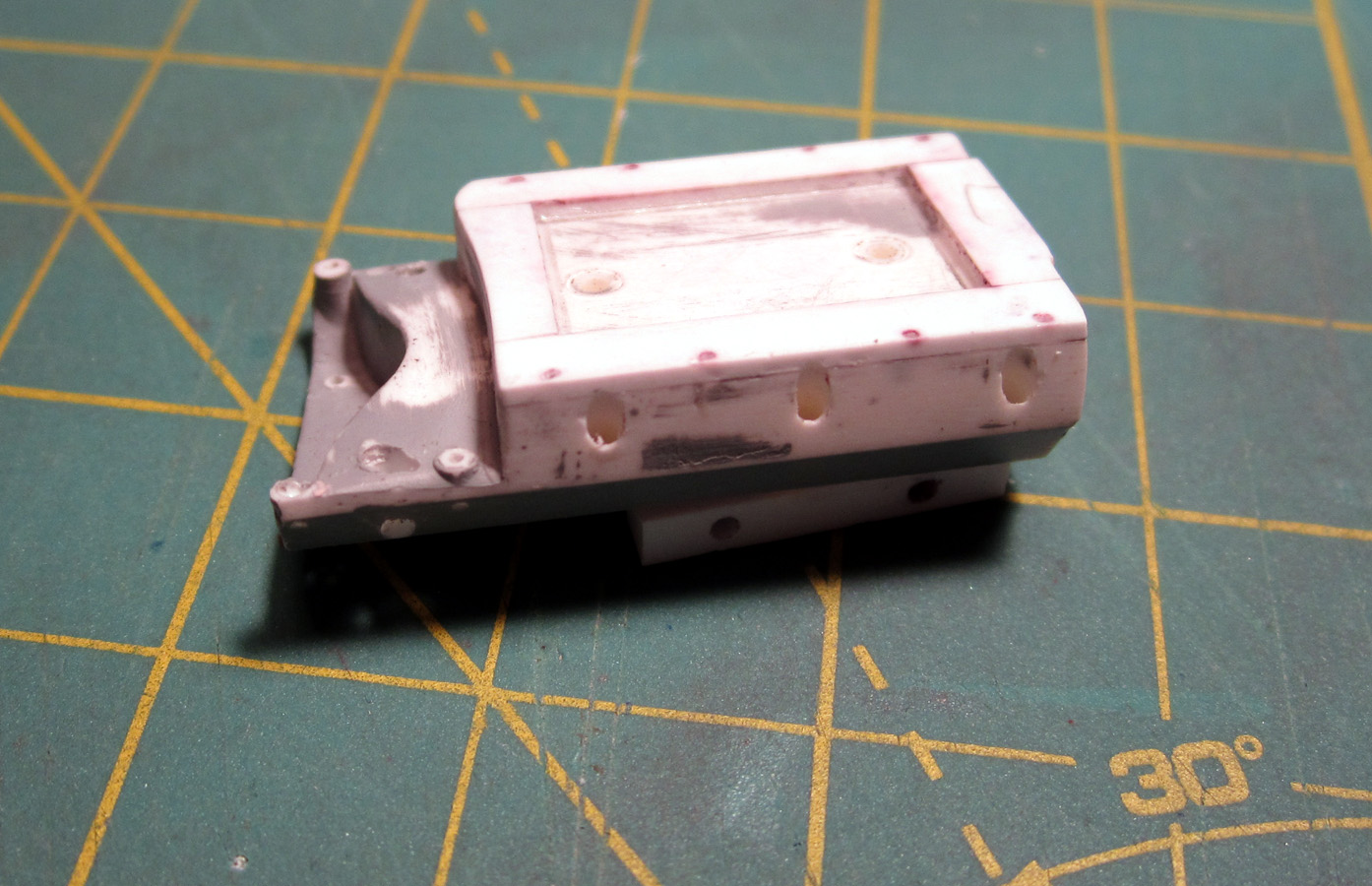

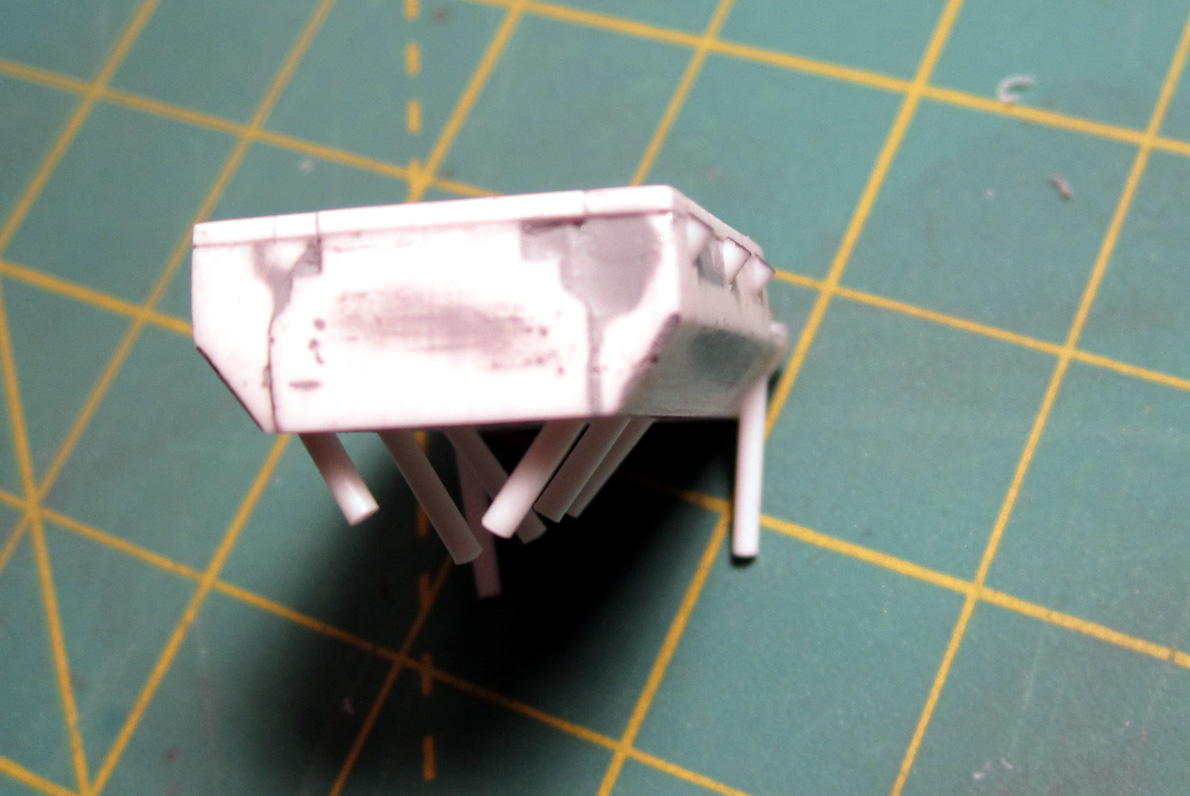

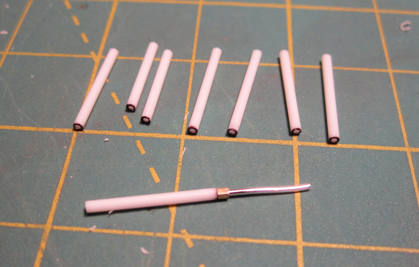

Mooneyzs Posted May 16, 2012 Author Posted May 16, 2012 (edited) Good Morning Gents..... I was able to do a little more work on this last night. I pretty much just focused on the Blower Manifold. As you know I had started on the injector lines and was happy with were I started but after asking all of you about how I should do the line below the flare nut. I took what you guys had said and came up with an idea. I couldn't be happier, it sorta just came to me when I was sitting at the bench last night. I started out by deciding that I was going to use Evergreen 3/64" (.047") O.D. rod to make the base for the flare nut to sit on. With that being my starting point, I started out by drilling out my original holes in the manifold to be able to slip the 3/64" rod in to: After I had gotten the manifold drilled out, I started taking the rod and trying to drill the end of it. well the first couple attempts I wasn't drilling dead in the center. So I thought to myself, I am going to make a tool to help me get the center drilled perfect. After thinking for a few I came up with an idea which was I would use some plastic square rod and have it as a guide. So the line I am using for these injector line is .025" dia wire. and I started out by drilling with an .025" dia drill all the way thru a square stock of plastic. Then after that I took a .047" drill and drilled one side of the plastic so that you could stick the rod in on one side and then you could take your pin vise and drill from the other and start drilling the center of the rod. Here is what it looked like: Here is the rod sitting in one end of the tool and the pin vise in the guide hole: Here are the 8 rods that I made. If you notice I started out by cutting the rods and sanding the end flat. I then took a black sharpie and colored the end that way when i started drilling I could see if it was in the center easy. When they were done you can see the little black ring on the ends of the rod showing that I drill holes in them. Then I had to test fit my line with a fitting on it to see how it looked: Once I had the rods done I took them and test fitted them by sliding them into the manifold to see how they will look. They will get glued in when I have them exactly where I want them, I also left them long on purpose: Edited June 16, 2020 by Mooneyzs

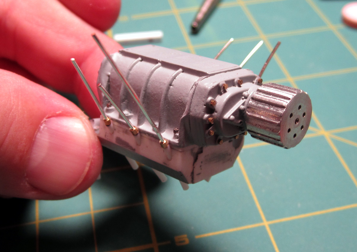

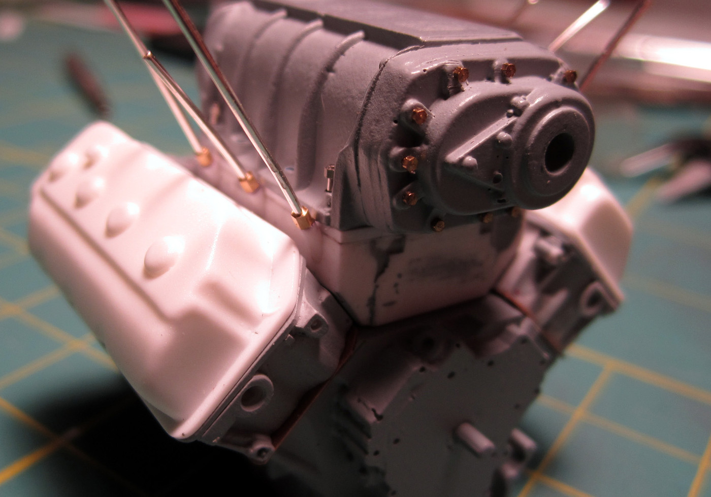

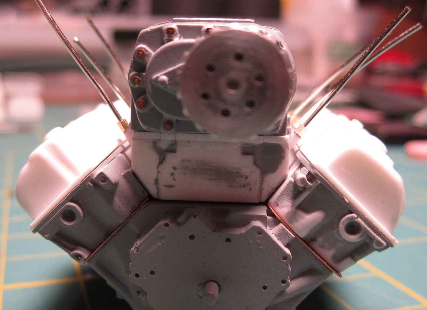

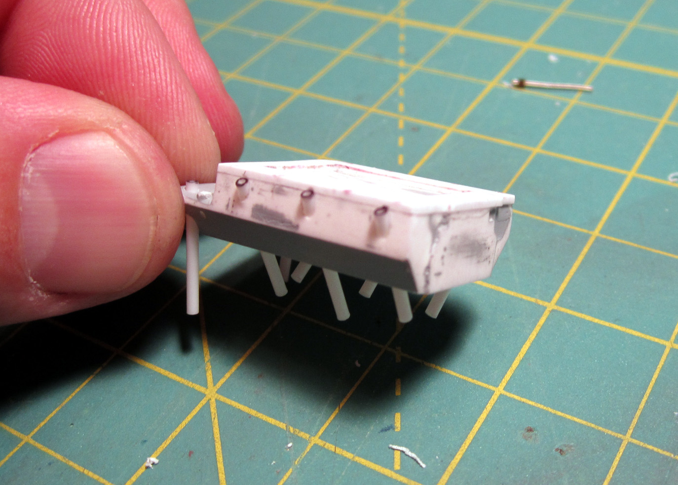

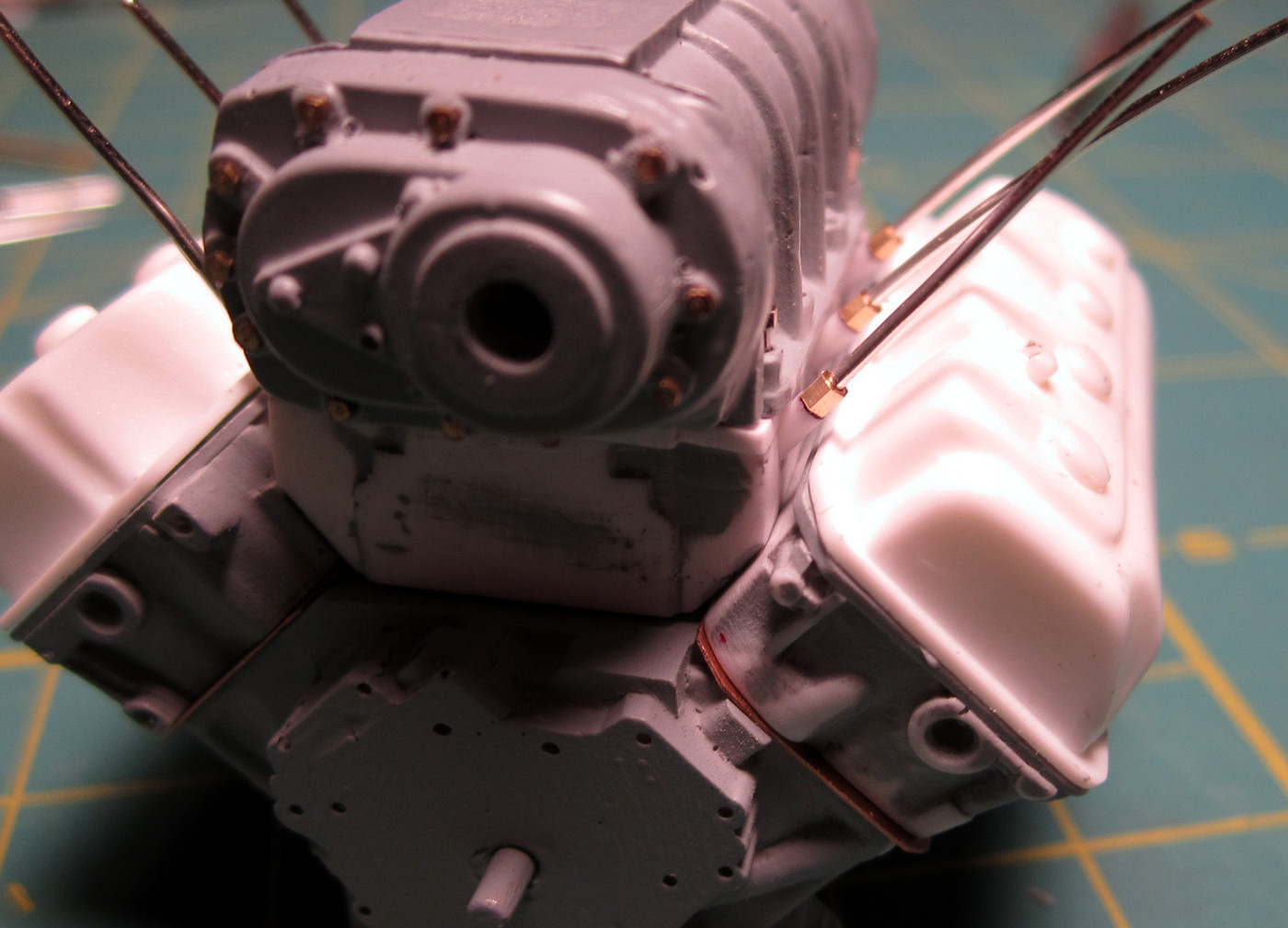

Mooneyzs Posted May 16, 2012 Author Posted May 16, 2012 (edited) Here it is a kind of side view look to see how much will stick out from the side: Here I sat the blower on top to get a quick peek at how it would look: I had cut the rods down so I could set the manifold on the block and get an idea how it all looked together, here is the left side: Now the Right Side: And a view from the front. The one thing I want to do is go back and take a look at a few pics because I am trying to determine if I should lower the height where the fittings are just by a tad. Let me know what you guys think. don't think I would need to lower it very much. My original placement was lower than you see here so I raised it up a smidge and now I tihnk I need to lower like .015" lol: Edited June 16, 2020 by Mooneyzs

Prostreet Posted May 16, 2012 Posted May 16, 2012 Awesome work Chris, Great tool idea. Definitely going to make a couple of those, I used to use something like that on my RC cars to drill the links. Never dawned on me to use it in modeling.
comp1839 Posted May 16, 2012 Posted May 16, 2012 chris, something to think about. the hard injector lines are 3/16" diameter tubing in 1:1. that would be about .012" in 1:16 scale. here are some shots i took, of some injectors for you. perhaps they will help. i realize this particular motor has 2 injectors per cyl.. it is just to help visualize the size of the injector also, the last injector on each bank you have at a different (steeper ) angle. that would be something new to me. i'm not saying it's wrong. i'm saying that's something i don't think i've ever seen. hope this is helpful.
Magic Photos Posted May 16, 2012 Posted May 16, 2012 Nice work Chris thanks for sharing that jig is a great idea. I will start using one. Mike
eviltwincustoms Posted May 17, 2012 Posted May 17, 2012 Nice work Chris thanks for sharing that jig is a great idea. I will start using one. Mike You know it is funny that Chris showed us how to make that Jig, because in SAE this months issue has a Jig in how to center holes in rod as well! How they show it is using two different size tubes. One just a size larger to fit over the rod you are going to drill and one sized down to go inside the larger tube to use as your guide. This way you know it is not only centered but also the exact same angle. This is usually where I screw up and drill down at the wrong angle and come out the side even if I am centered. LOL
Mooneyzs Posted May 17, 2012 Author Posted May 17, 2012 Phantom... Thanks man. Richard... Thank you! Joe... Thanks, it came in handy that is for sure. Dave... Thank you for the info and for the pics as well. I wasn't exactly sure what size the injector lines typically were. Pictures really help alot because i wasn't able to find angles to show exactly how they were and had to make some assumptions. As far as those last injectors not being as steep when I was doing them I was thinking that I should probably make them the same angle but didn't because I couldn't tell very well. That means I will go back and redo those to be at the same angle as the rest. Thank you for clearing that up for me. Now with your up close shot of the fittings. Its making me wonder if I should approach these different now. I could get some hex rod and rig them up to be turned down on my dremel since I don't have my mini lathe yet which I really want one of these days. Again thank you for the info you have provided, it has been very helpful. Much appreciated bud. Mike... Thank you, it does come in handy and I think maybe using a bigger stock for it would have been better. Bart.... Thanks man, I totally forgot about that article using different size tubes as guides. I don't think these would of been standard size tubes. I think my little drill guide would of been a little better if it was a little bigger rod, but it did work and that is all I had on hand when i was doing them. I am totally with you as far as drilling down at the wrong angle and coming out of the sides. Can't tell you how many times I have done that before....
