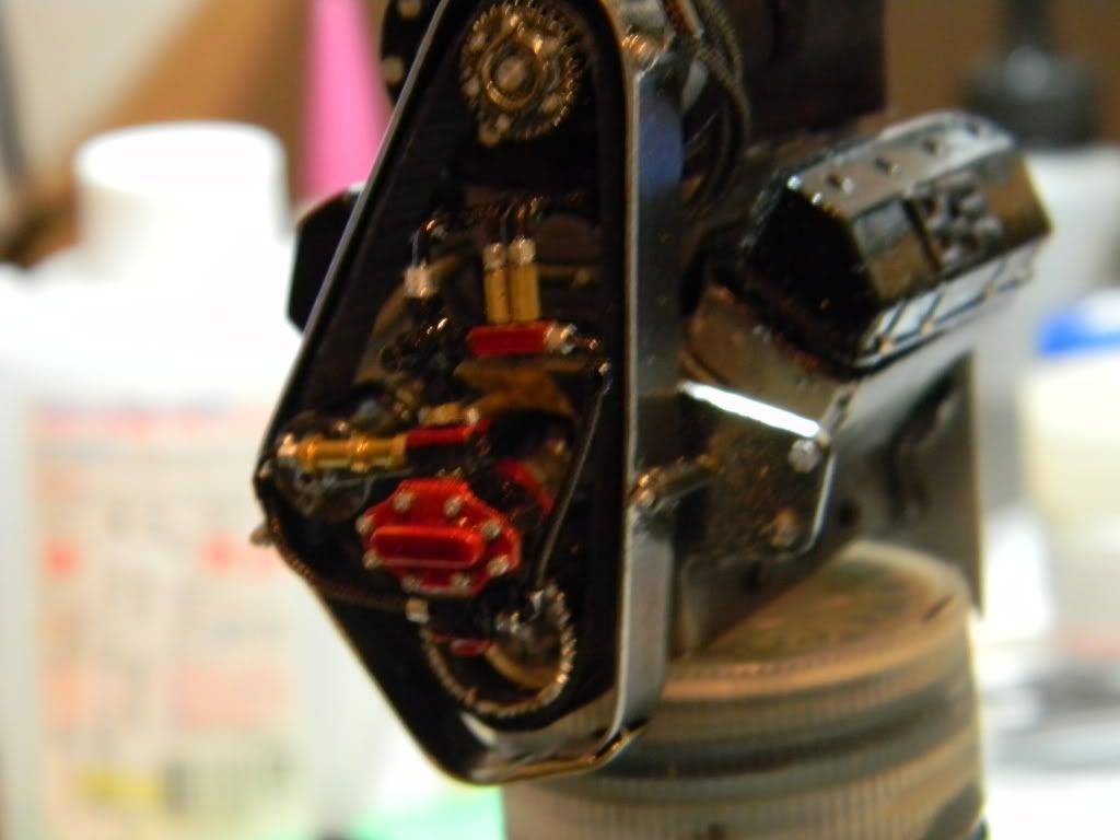

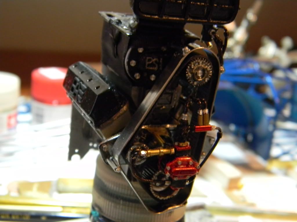

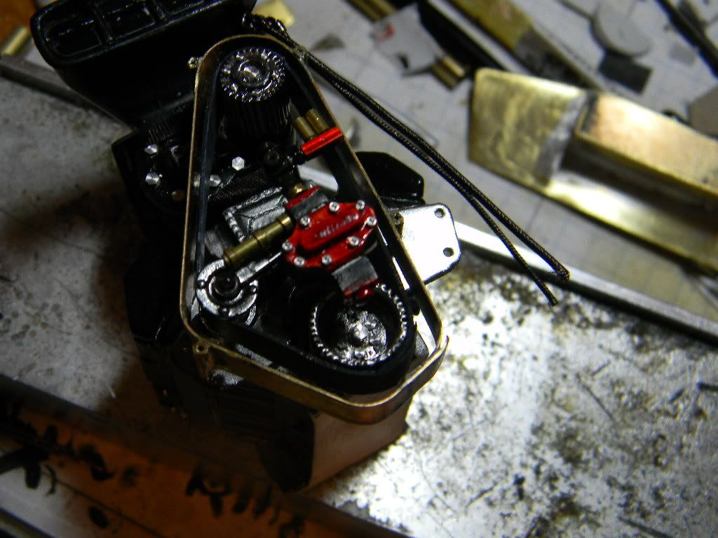

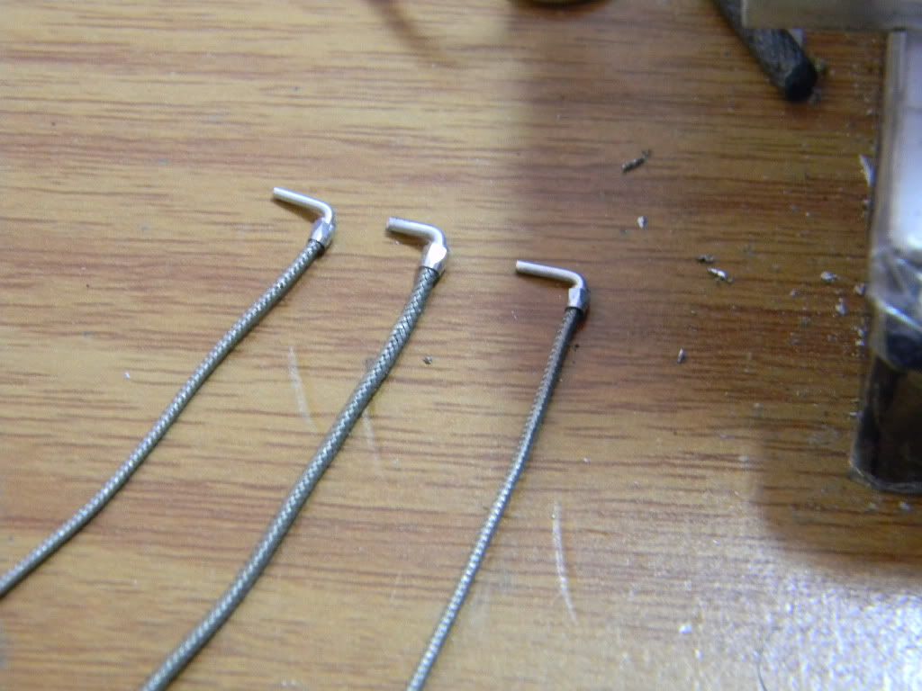

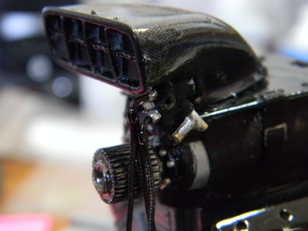

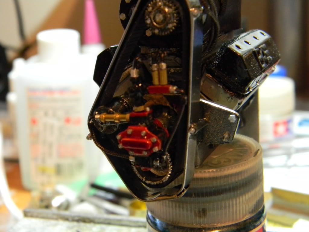

Romell R Posted August 2, 2011 Author Posted August 2, 2011 Hello again my friends and thx again for the great compliments. I got some work done on the motor not quite finished but its started. Hope you enjoy the pics needed to fab a throttle body so i pulled out the trusty soldering gun and got busy again these are the fuel lines that will run from the fuel pump the one in the center is slightly bigger this will be the main line fuel pump installed decided to do the fuel lines in black , used a black sharpie for the job here you can see the line attached with belt on also come back later today for more up dates

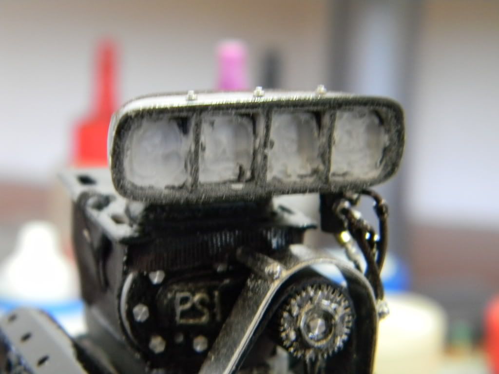

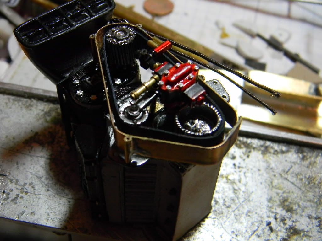

Romell R Posted August 2, 2011 Author Posted August 2, 2011 Here's the Blower belt guard i made from brass I'll paint it tomorrow Come back later for another update

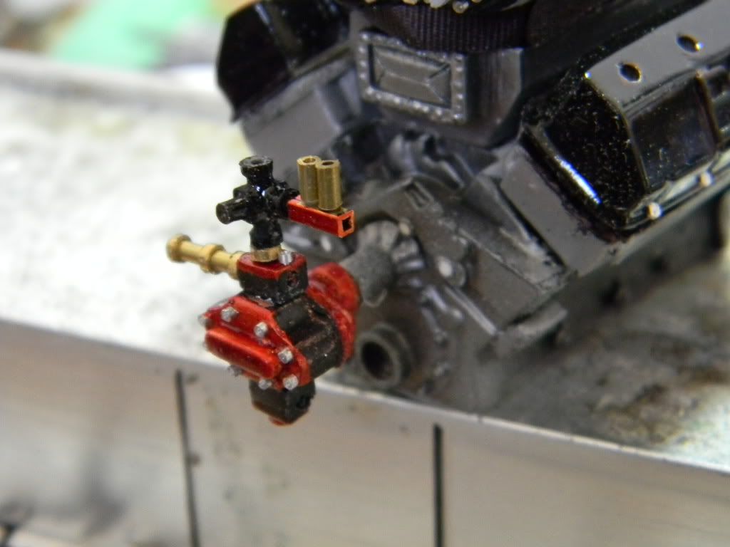

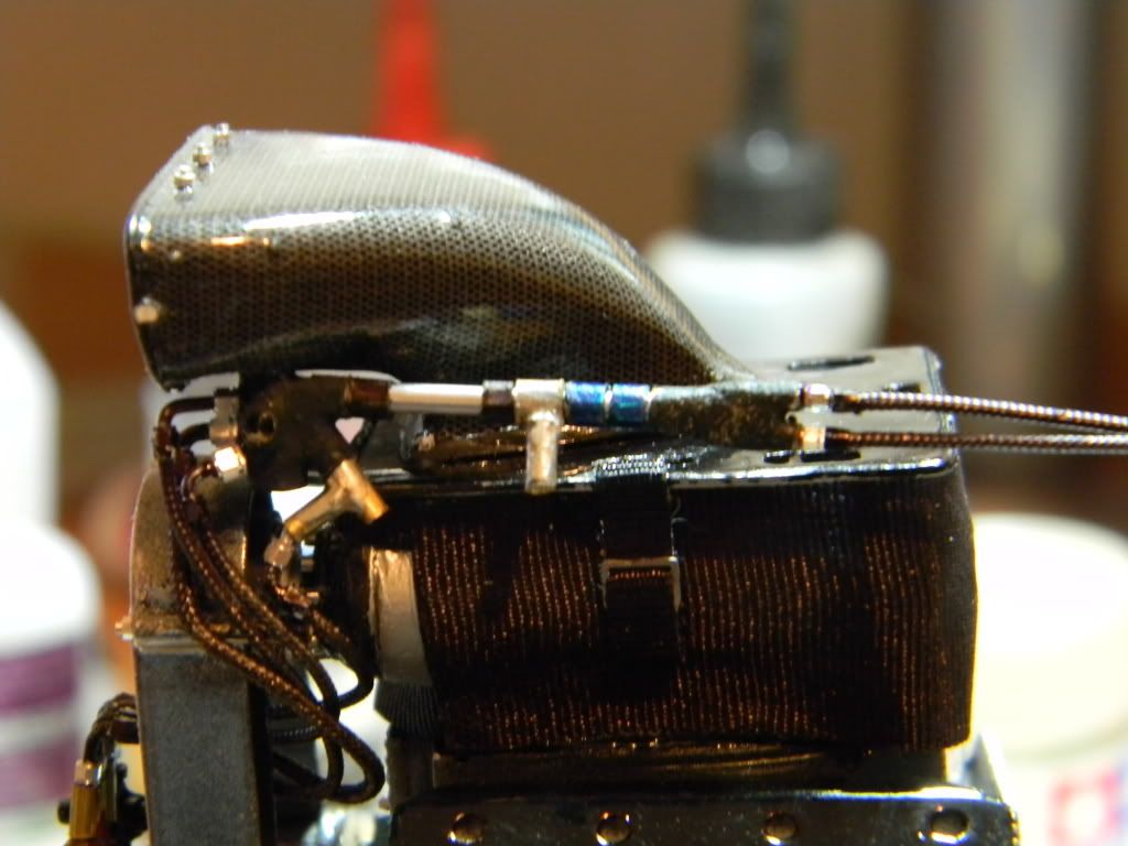

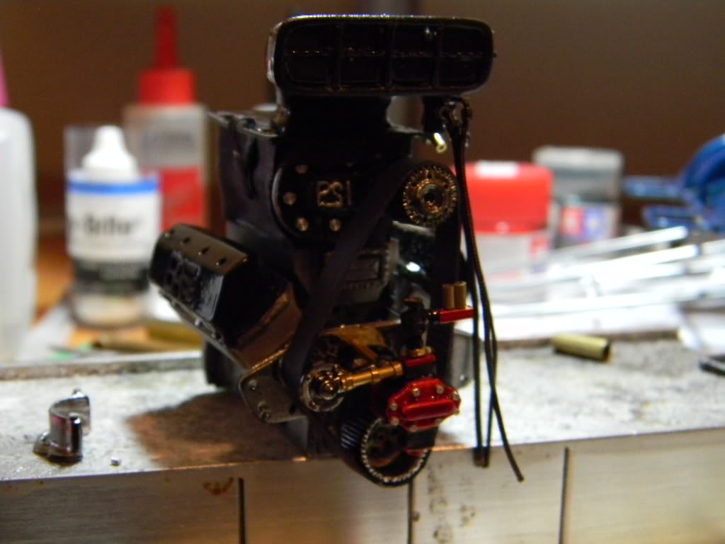

Romell R Posted August 3, 2011 Author Posted August 3, 2011 Here's a couple with the pump plumbed. Hope you enjoy come back later for more.

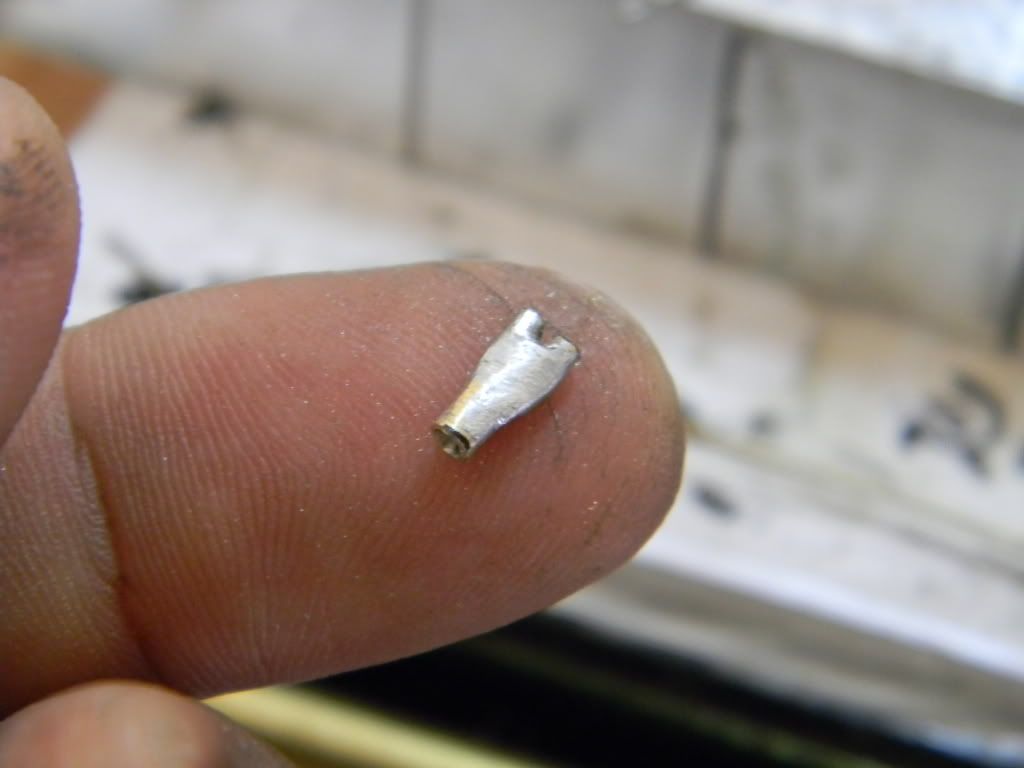

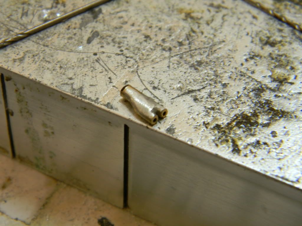

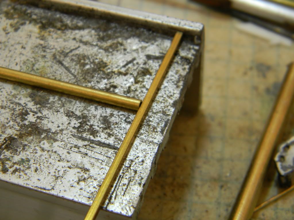

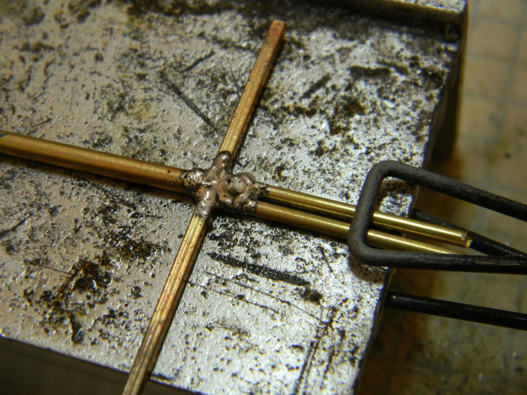

Romell R Posted August 4, 2011 Author Posted August 4, 2011 Hey fellas I have a few pics for ya , I got a lil more of the plumbing done I had to make a "Y" splitter to lead fuel lines to the top and port fuel blocks here's how I accomplished that. I started off by soldering a piece of tube to a square piece of tube then two smaller pieces of round tube after cutting off the excess this is what I ended up with Well almost at my picture limit so i'll save the rest for the next post.

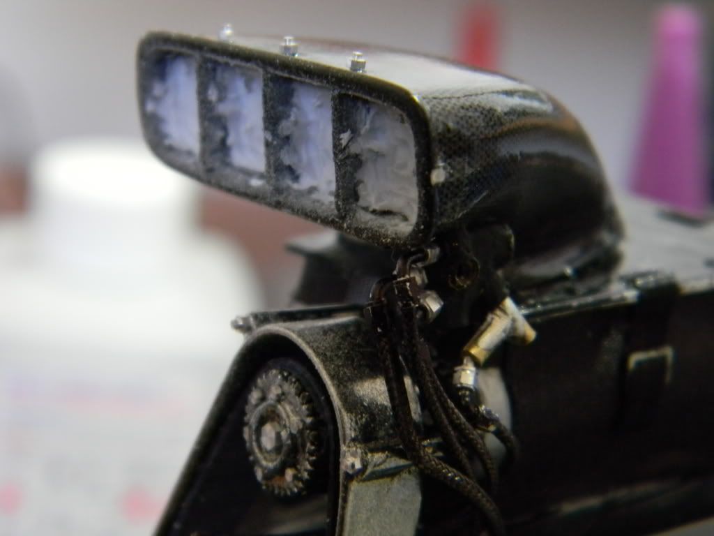

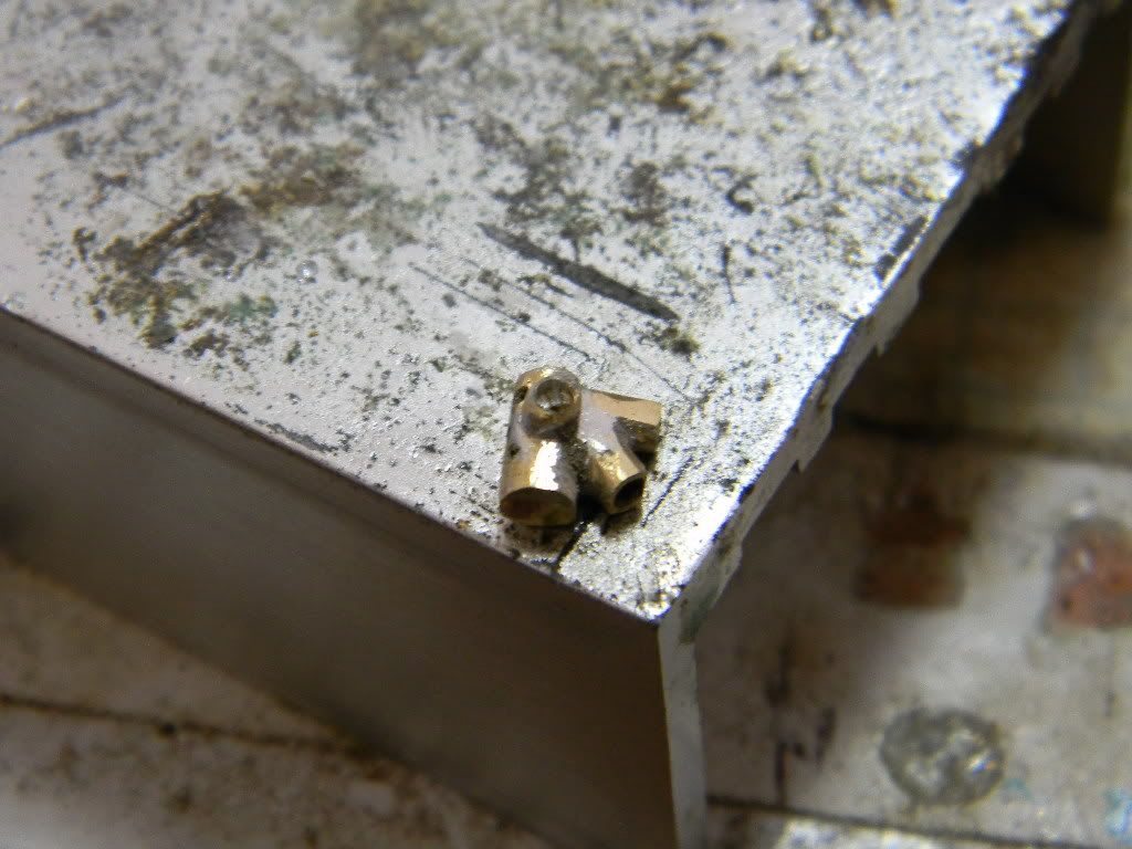

Romell R Posted August 4, 2011 Author Posted August 4, 2011 Ok so here's what the splitter looks like all done and connected And I figured while I was at it i'd drill out the scoop so I can start on the working butterfly doors Hope you'll return soon....

pharr7226 Posted August 4, 2011 Posted August 4, 2011 Great idea and execution on the splitter. I'll file that one away for use later.
