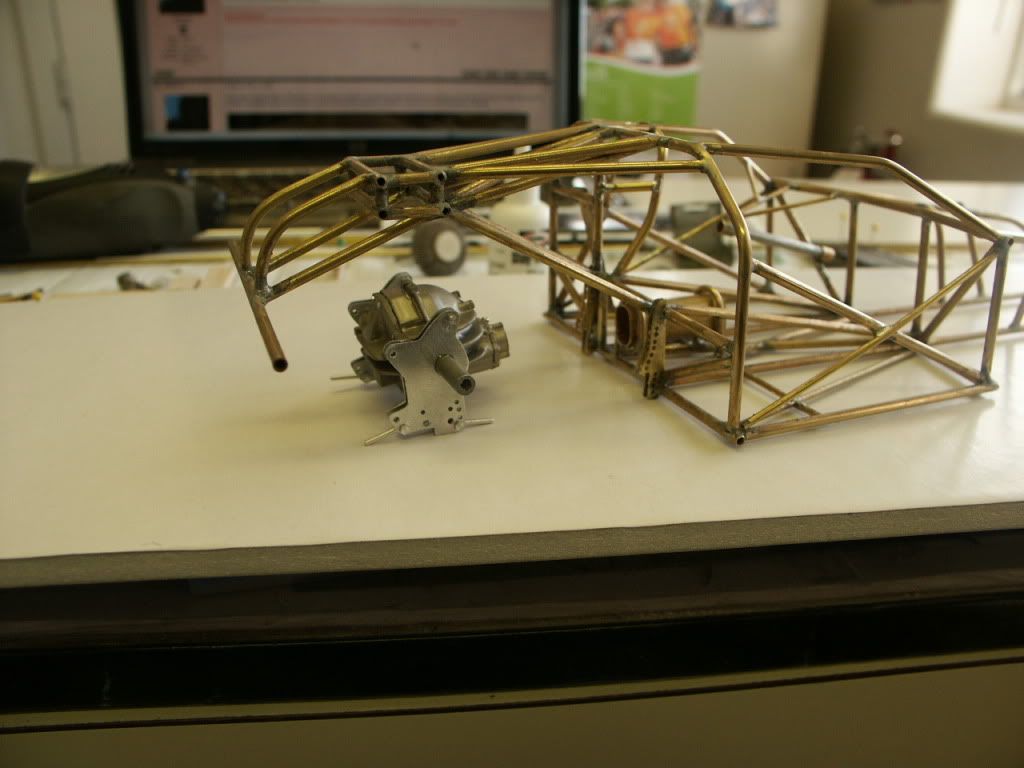

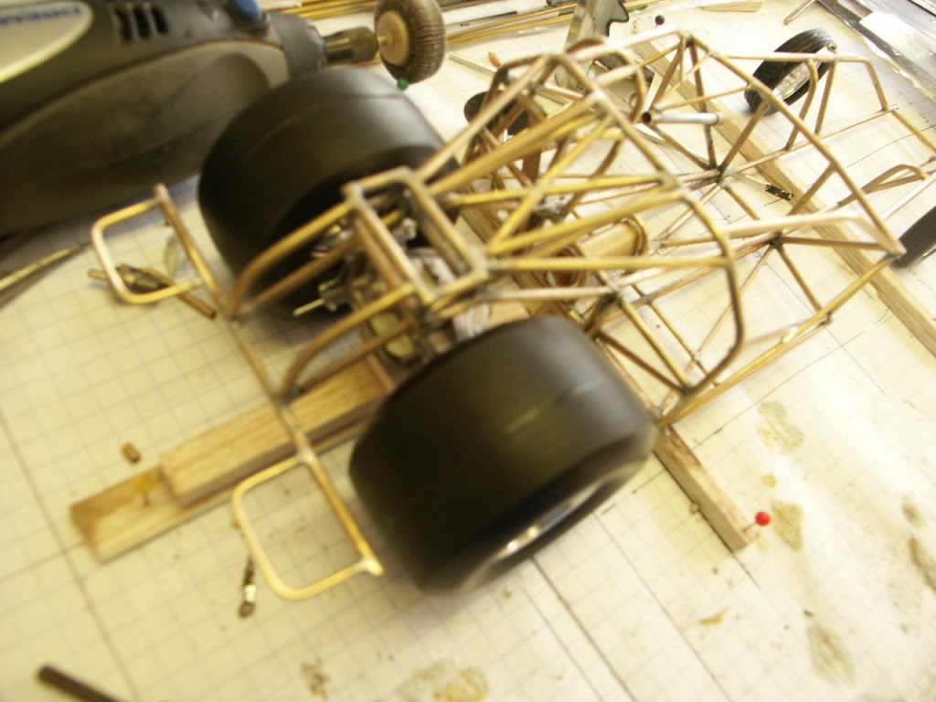

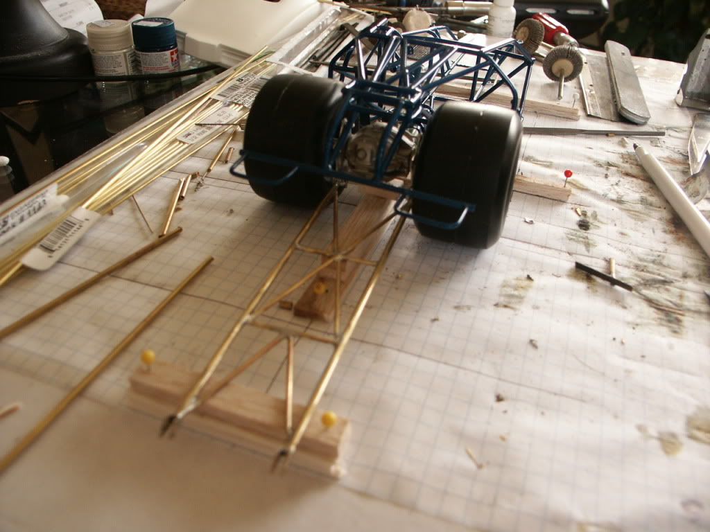

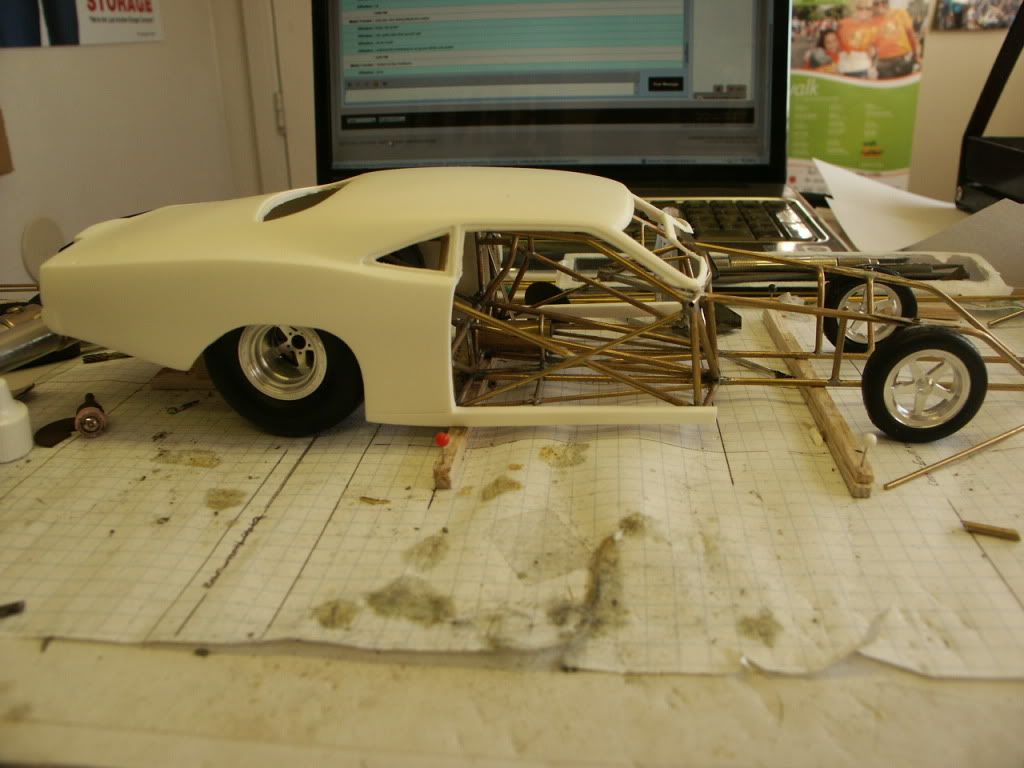

Hey Guys time for another update. I was able to get the 4 link braces on the rear end housing and i attached the brackets to the chassis. I also used a blueing chemical to blue the chassis to a gunmetal blue color anyway nough said on to the pics.....enjoy! ;)
a mock up .....

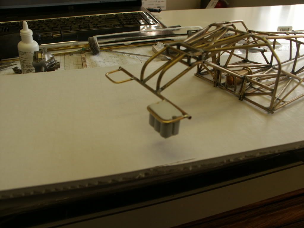

Here I have the battery holders soldered on ....
heres a mock up for ya.......

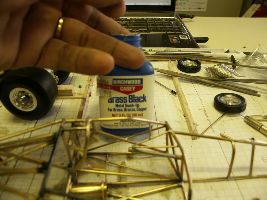

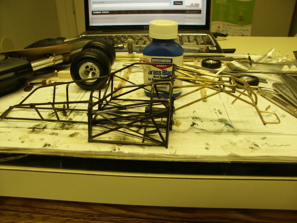

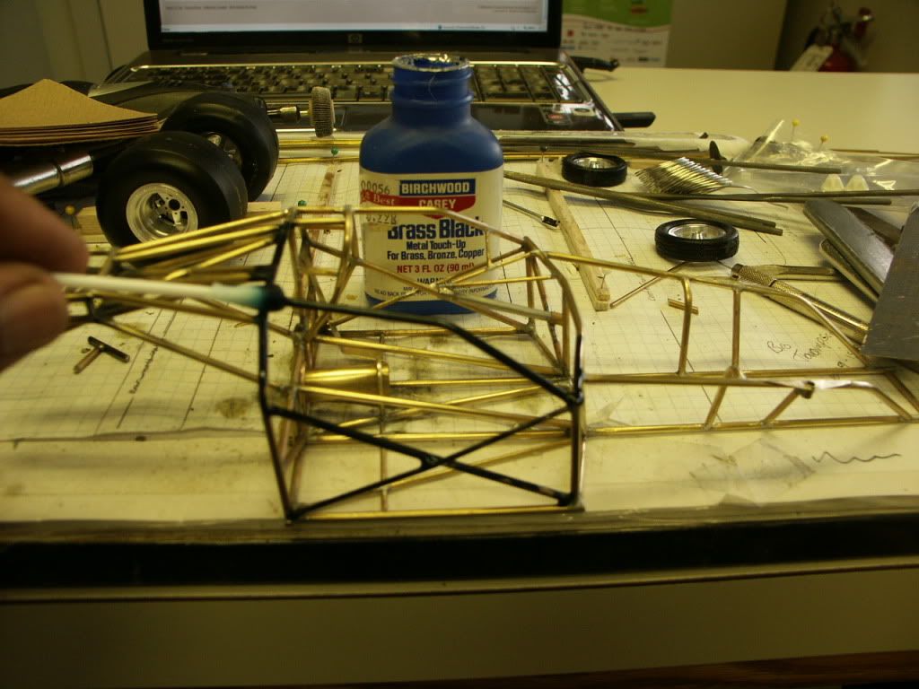

Here im using a chemical to Blacken or Blue the brass I wanted it to be close to a gunmetal blue. This is the same chemical used to blue guns and rifles. You have to rub the chemical on the brass , then rinse and buff . And repete untill you get the color you want. here it looks black but as you add more coats the color changes.
incase you wanted to know what im using.....

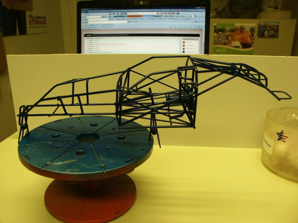

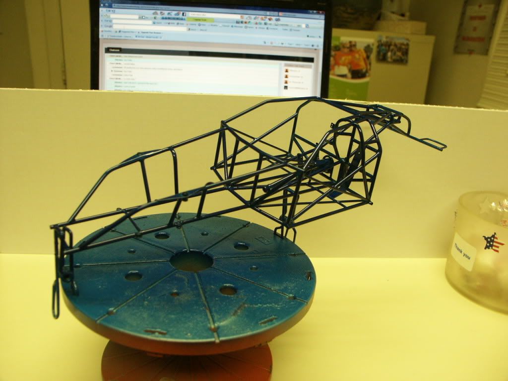

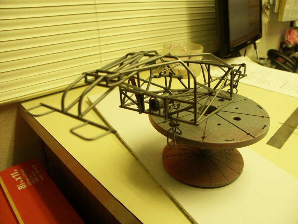

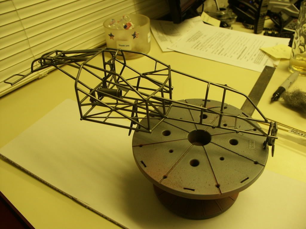

Well thx for the compliments myfriend. I had this puppy looking good fellas, but sometimes I can get in my own way, meaning i just dont know when to quit sometimes. Well this was one of those times. i over buffed the blueing and messed it up. So I primered this baby up and hit it with a coat of Alclad magnesium and then shot Tamiya clear blue on top of that. I think it looks pretty good what do you think?
Alclad Magnesium
Tamiya Clear Blue

now that it's painted, how are you going to add in the missing tubes? :huh:
You know I thought about that last night after I finished, and ive come up with an answer. There is only one tube missing and its on the very top where it wont be seen , but anyway I'll have to scrap the paint off where the piece will be soldered on, then i'll attach heatsinks to the chassis on both sides of the scrap, this will keep the heat of the solder from ruining the paint. Then I'll mask the area and spray the new tube and solder joints. Simple :P

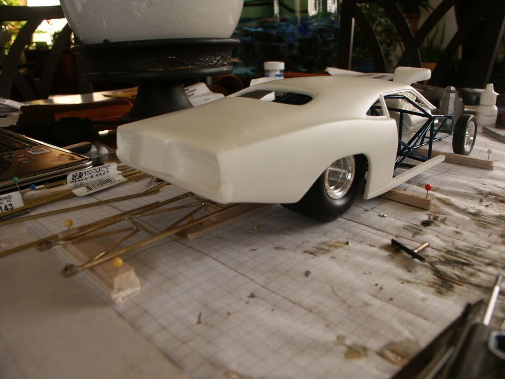

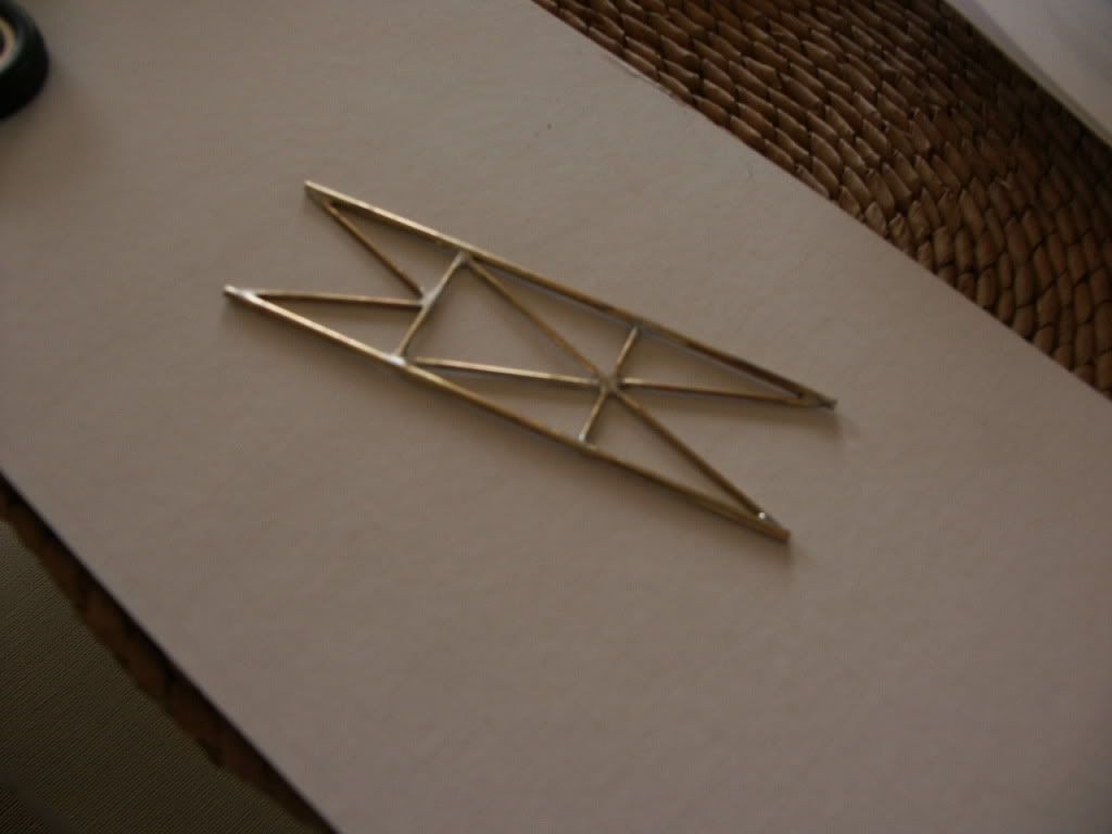

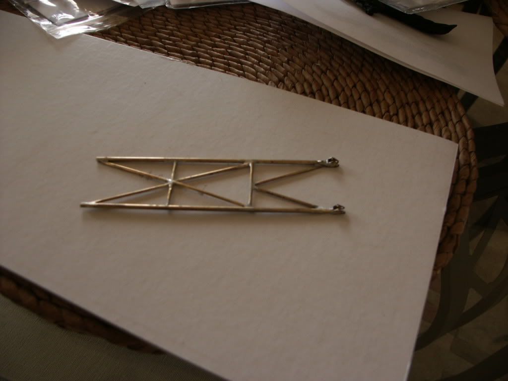

Well fellas i didnt have much I could do today , so I decieded I'd build the wheelie bars, well i'd start them anyway cause i forgot I didnt have everything i needed to finish them. LOL! but anyway here what i got done today.......
the bottom half
then this was used to make the brackets that will hold the wheels on.
here those bracket have been added
heres a with view with em hooked up to the rear axel the top bars have been cut but cant be added untill my hardware comes in the mail this week.......
and heres a couple mock up for ya......
