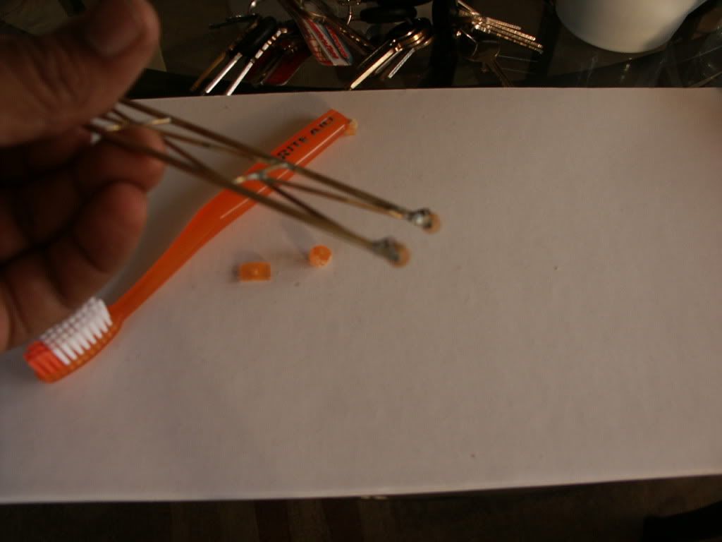

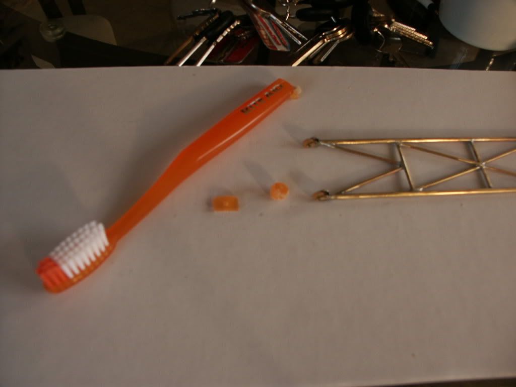

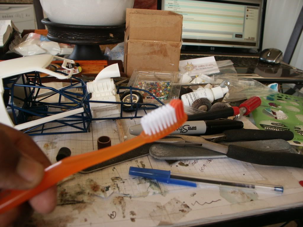

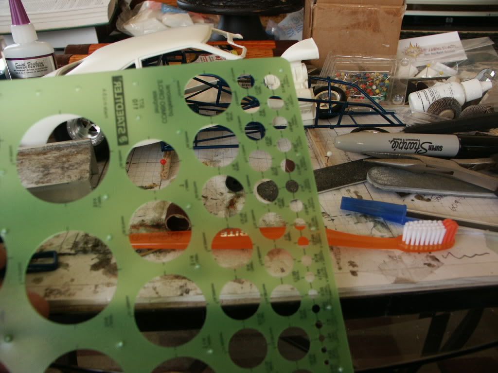

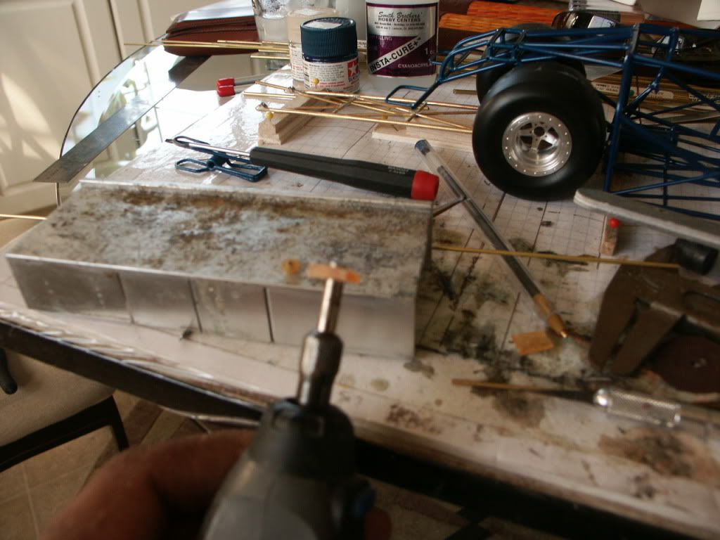

Romell R Posted June 21, 2011 Author Share Posted June 21, 2011 Thx go out to Chris & John for your kind words Hey fellas i have a small update (And I do mean small) I went out and purchased a package of cheap tooth brushes so i can make the wheels for the wheelie bars. the color of the plastic is very close to 1:1 wheelie wheels. So lets get to it shall we. The pack had four differant colors so i decieded to go with the orange. the size wheel im shooting for is 13/64th very close to scale , this staedtler combo circle template will help me with accuracy. I drill a hole in a small piece of the plastic then fasten it to the cutting wheel chuck of my dremel , then I used jewellers files to get the plastic into shape. as you can see in the back ground I already have the first wheel done. here we have all the pieces and the final product... the wheels have brass tube inserted as a axle.... Stay tunned for more tomarrow Quote Link to comment Share on other sites More sharing options...

Ben Posted June 21, 2011 Share Posted June 21, 2011 Preetttty smart idea Romell! The little wheels look perfect! I would have probably robbed the tiny wheels from one of those "finger" skate boards. I wonder if they have translucent wheels on those? Quote Link to comment Share on other sites More sharing options...

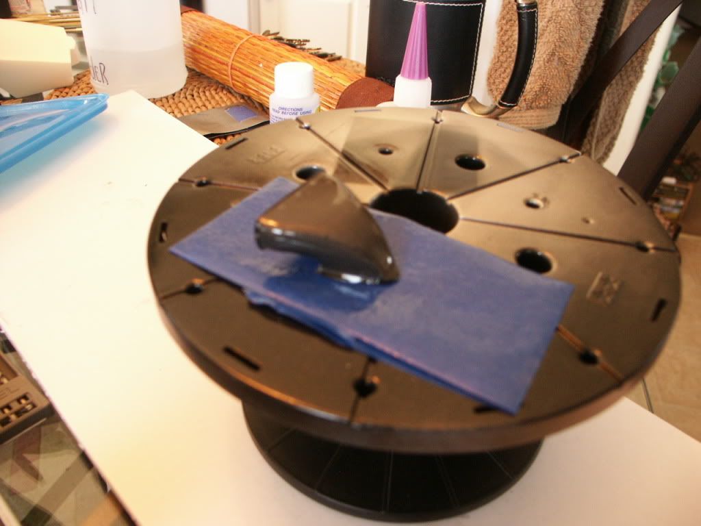

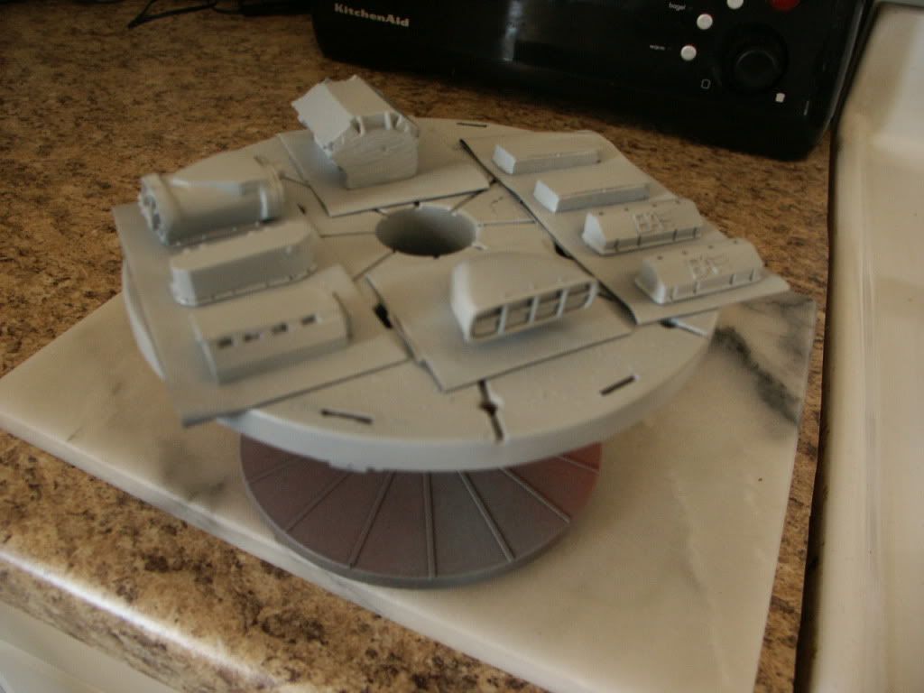

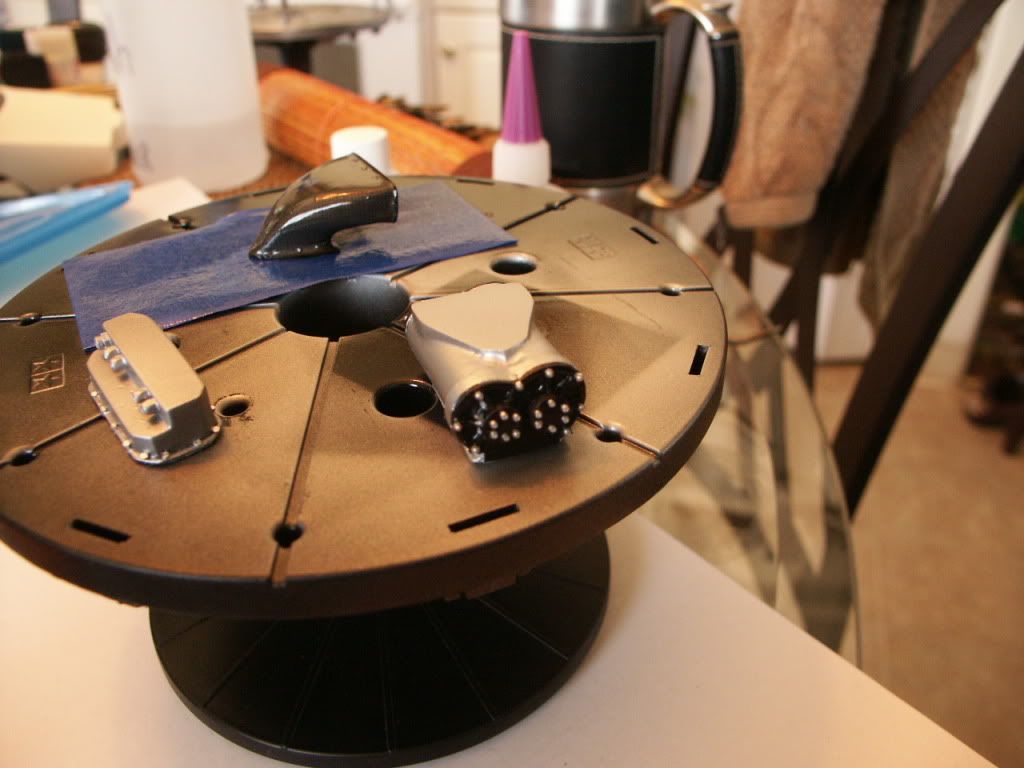

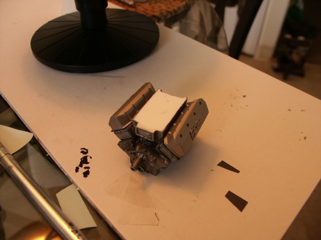

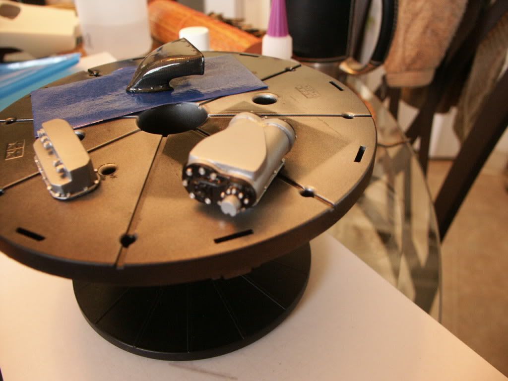

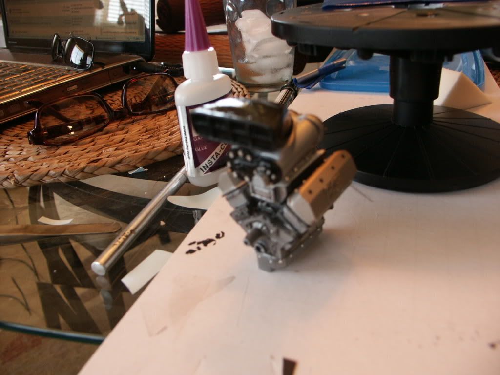

Romell R Posted June 25, 2011 Author Share Posted June 25, 2011 (edited) Love the progress! Amazing skills Dude.....&^%$#$% amazing. Hey thx bro for your sincere compliment.. Well fellas Im back with another update. I painted the motor parts and detailed with bolts made by my good friend Robert of RB Motions if youd like to purchase some of his good visit him at Http://www.rbmotion.com now on to the pics. This is a resin Pro Mod hemi from Flashpoint Motor sports http://flashpointmot...s.com/Index.asp here its primered and ready for color. Blower scoop with carbon fiber decals from Scale motor Sports http://www.scalemotorsports.com Heres some of the etail work done on the blower , oil pan & block stay tuned for part II of this update... Edited June 25, 2011 by Aftashox Quote Link to comment Share on other sites More sharing options...

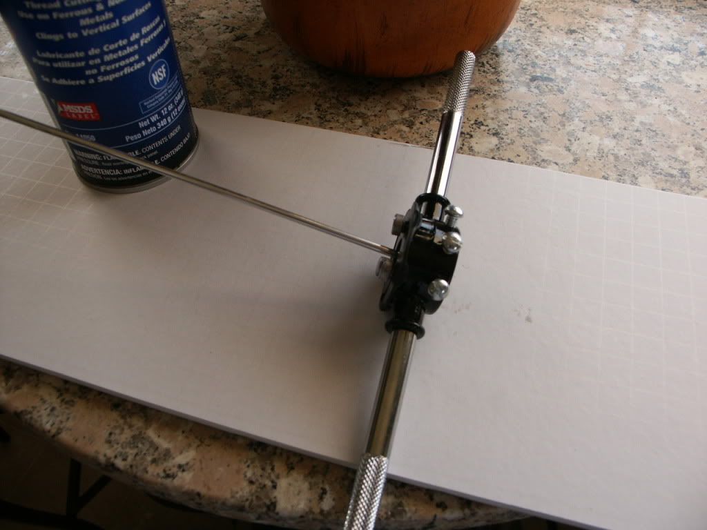

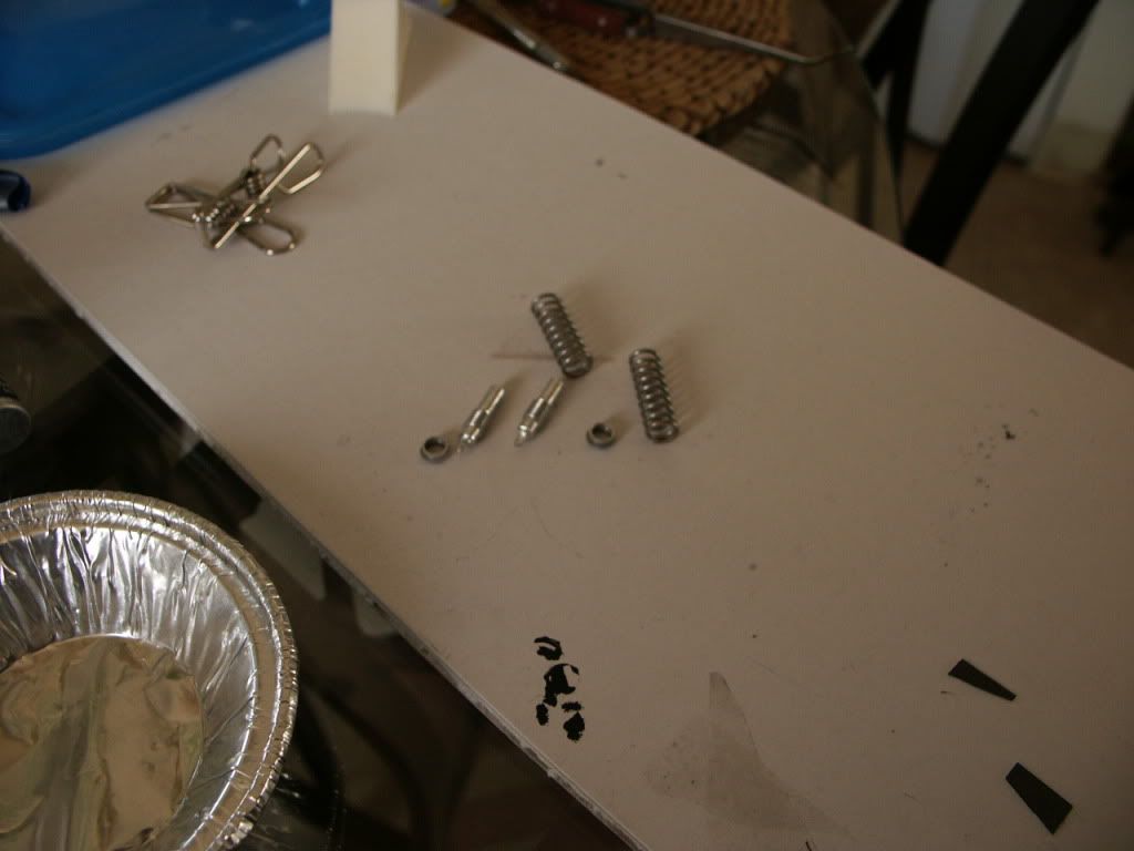

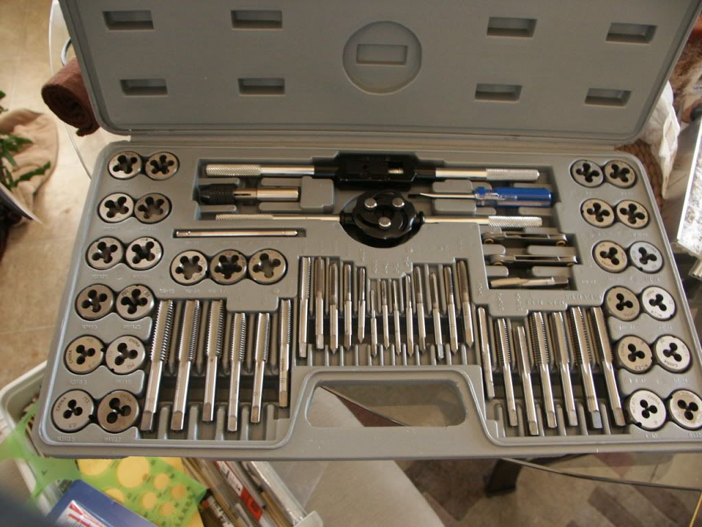

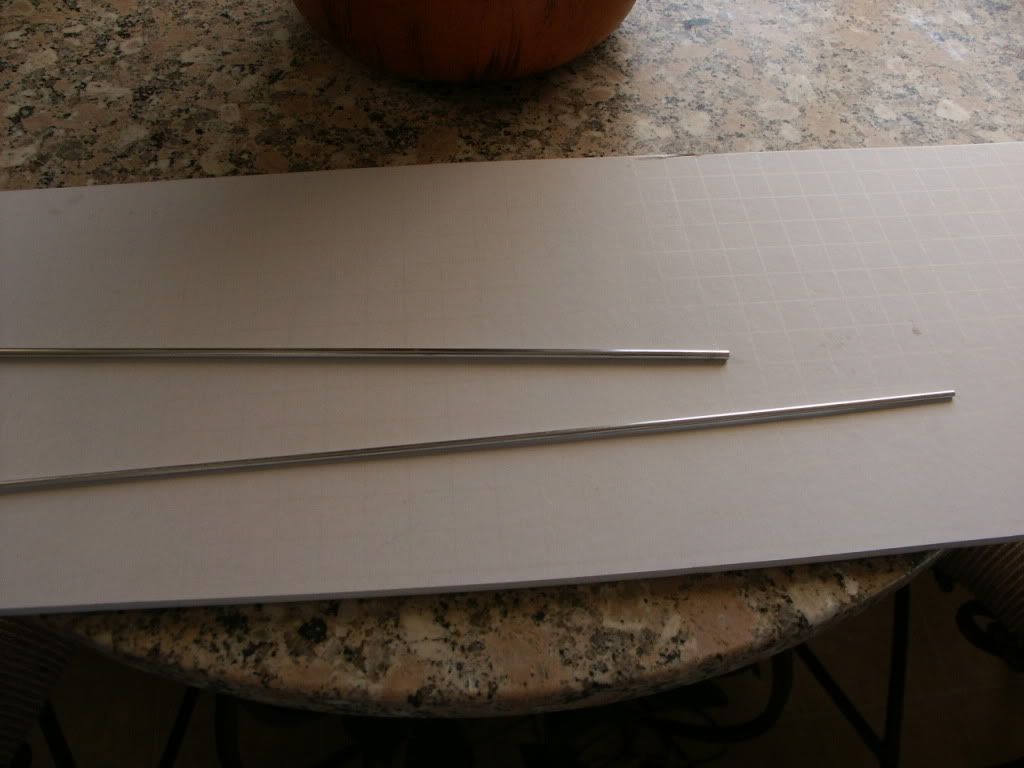

Romell R Posted June 25, 2011 Author Share Posted June 25, 2011 Welcome to Part II "COILOVERS" LOL! I started out with aluminum tubing and a tap & dye set ok on to the pics enjoy..... lets start with these.... And this..... I used an M5X.08 max die to cut threads on the outside of the 1/8 diameter aluminum tube make sure you use cutting oil now. well sorry i didnt do more of a tutorial , but if you have any questions feel free to ask i'll do my best to answer them for you. heres the bottom parts of the coilovers stay tuned and well put the coil overs together and get the wheelie bars done too..... Quote Link to comment Share on other sites More sharing options...
