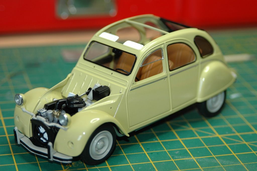

GeeBee Posted September 20, 2011 Author Share Posted September 20, 2011 With the Morgan away while the paint dries out on the bodyshell, I did a little more to the 2cv, the Headlamp bowls were stripped of there chrome as I thought the chrome in the kit looked a little bit toy like, so I stripped all the chrome and re-did them using chrome Alclad. The headlamps and lenses were fitted onto the bar, which needed fitting on top of the fan housing, but doing this, the bar didn't line up with the indents in the bonnet, so the fan housing had to be removed, the bar was glued onto the housing, once dried, the fan housing was refitted, doing this casued the housing not to line up with the rest of the engine, the bonnet isn't a great fit, but I'm hoping once the front bumper is fitted it will hold the bonnet in place. Quote Link to comment Share on other sites More sharing options...

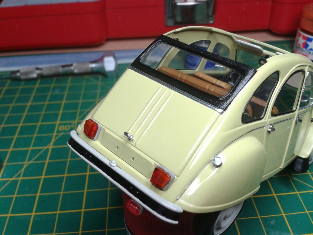

GeeBee Posted September 23, 2011 Author Share Posted September 23, 2011 Front & Rear bumpers fitted, looking on some other modelling forums and build reviews, it seems that the misalignment of the front lamps and bonnet are a common issue with this kit,I managed to get around the lamp issue by removing the fan housing, fixing on the lamps then refitting the fan housing,I am leaving the bonnet as it is, as the only solution is the glue the bonnet shut, which isn't what I wanted to do. There are two decals in the kit that are supposed to be for the black trim on the bumpers, I tried using them but they broke up into pieces, I'm not sure if they were just a bad set, or a common problem, but I got round the problem by simply painting the section needed to be done in black by using Tamiya semi gloss black paint. Quote Link to comment Share on other sites More sharing options...
Tony T Posted September 23, 2011 Share Posted September 23, 2011 Looks great...I like it! Quote Link to comment Share on other sites More sharing options...
jbwelda Posted September 24, 2011 Share Posted September 24, 2011 hey that looks great and a suggestion: maybe if you got two of those micro micro super strong magnets and glued them, one on the body and one on the bonnet, the hood would snug down tight against the body, given of course there isnt interference under the hood/bonnet. if you can find room at this late date, magnets work great for that kind of thing. Quote Link to comment Share on other sites More sharing options...

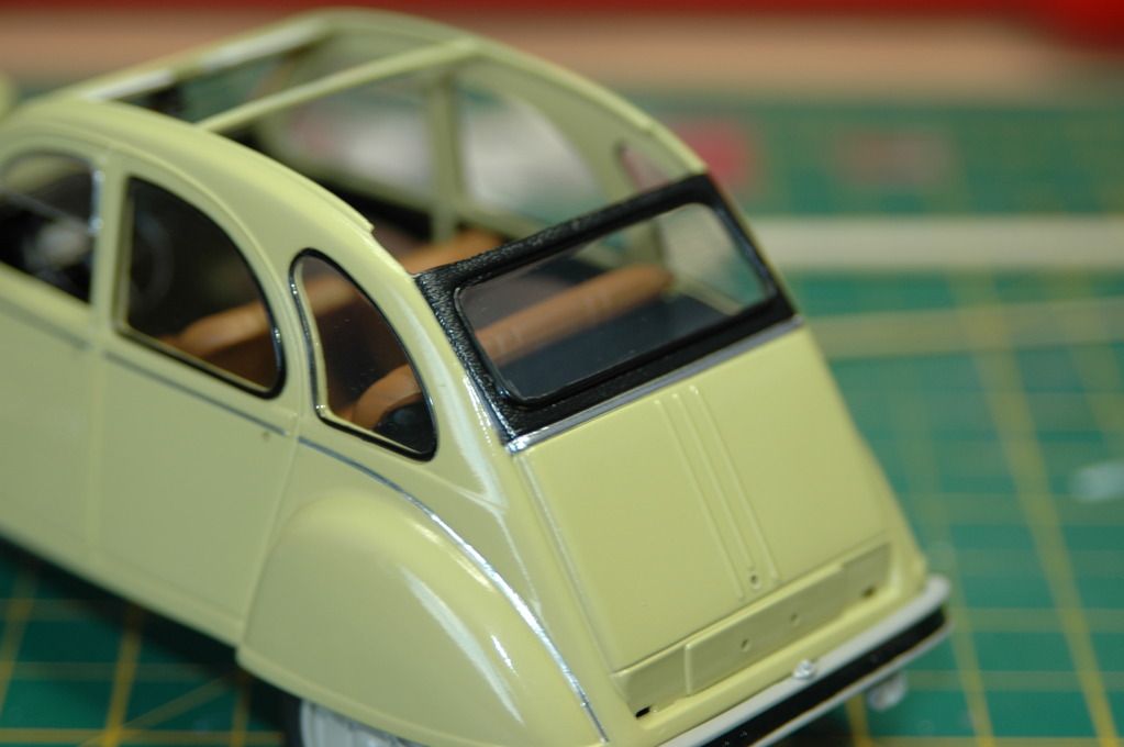

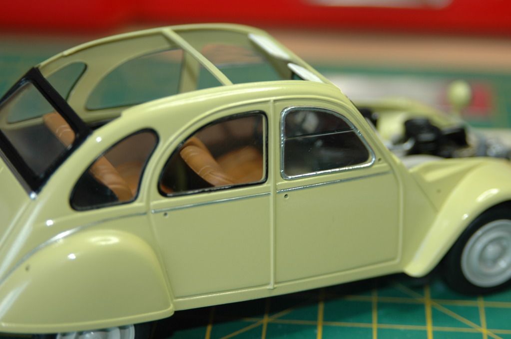

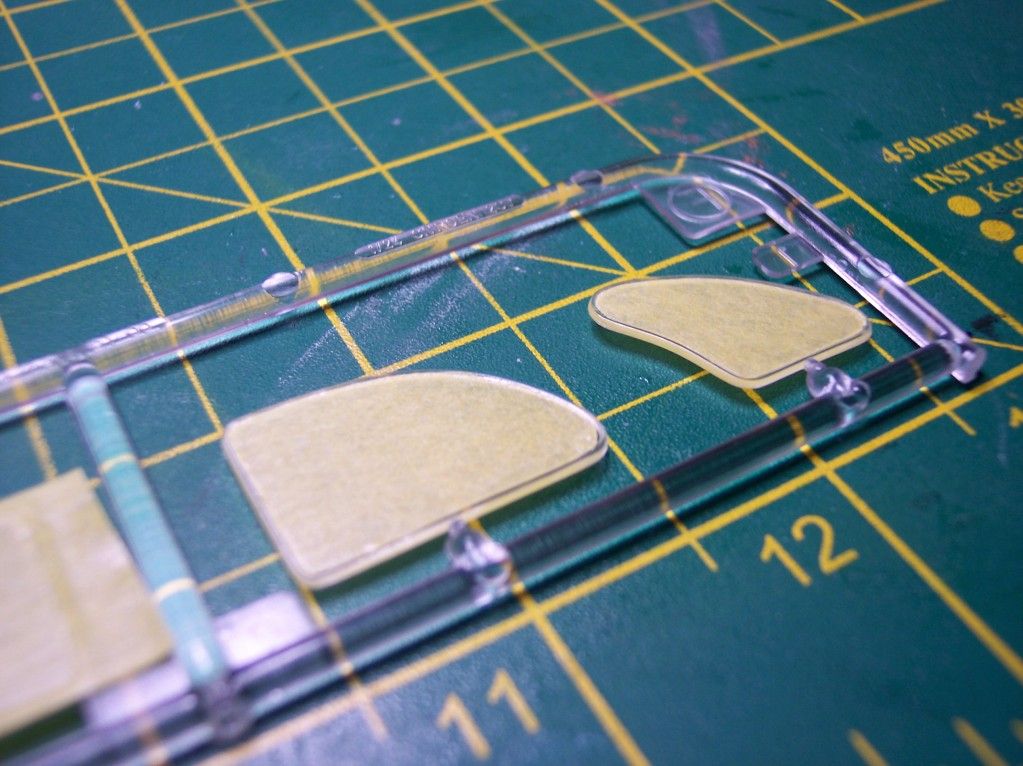

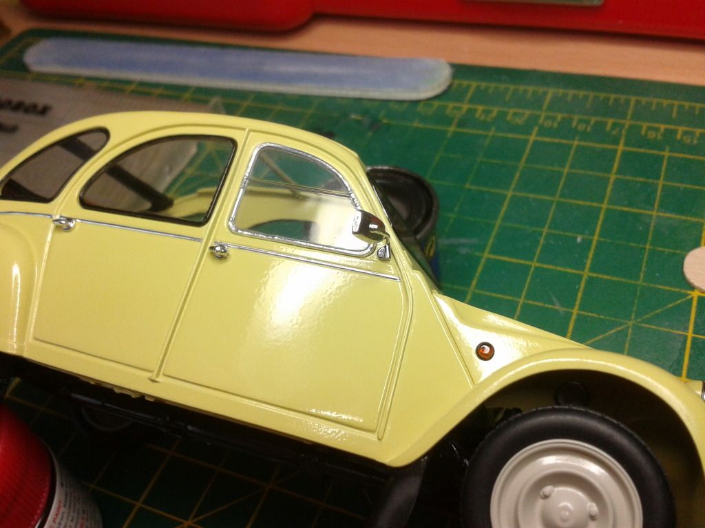

GeeBee Posted May 29, 2012 Author Share Posted May 29, 2012 I can't believe this one has been sitting in it's box since September, so with the Charger finished and waiting for the the acrylic showcase I've ordered for it, and the Porsche 911 cabriolet on hold, I thought I would get the little 2cv back on the bench, most of the small parts have been painted, and if I could spend a few hours on this build, I could get it finished .... the back, front and rear side windows needed to be done in black to replicate the window rubbers, while the 2 front side windows needed to be done in polished aluminium, the black was done by masking up the windows and airbrushing using Tamiya semi gloss black acrylic while the front side windows was done using aluminium BMF ... Quote Link to comment Share on other sites More sharing options...

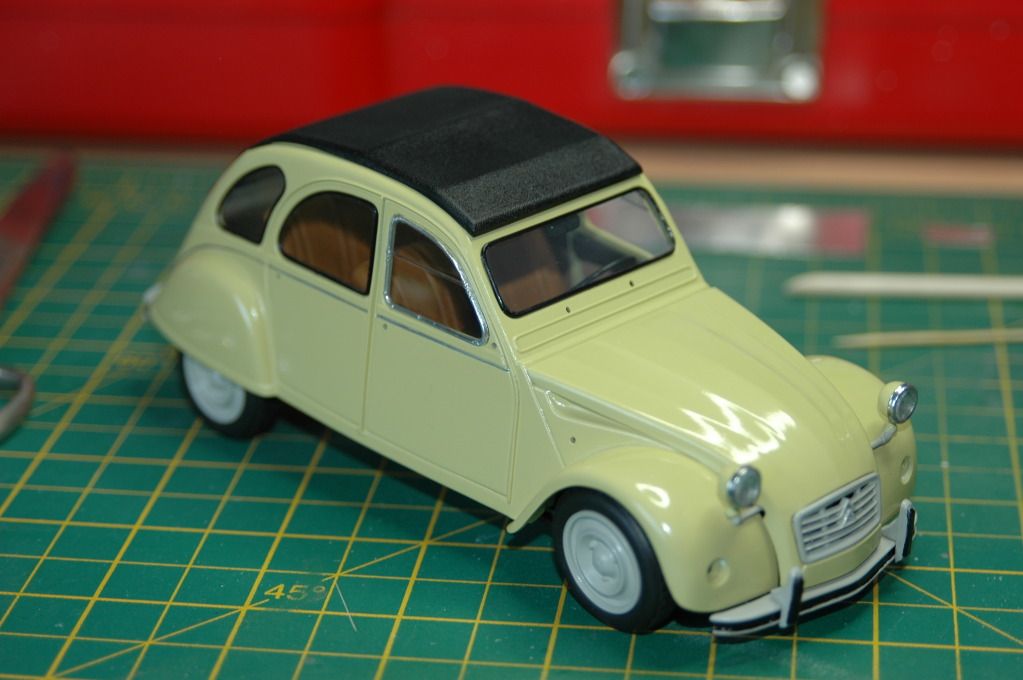

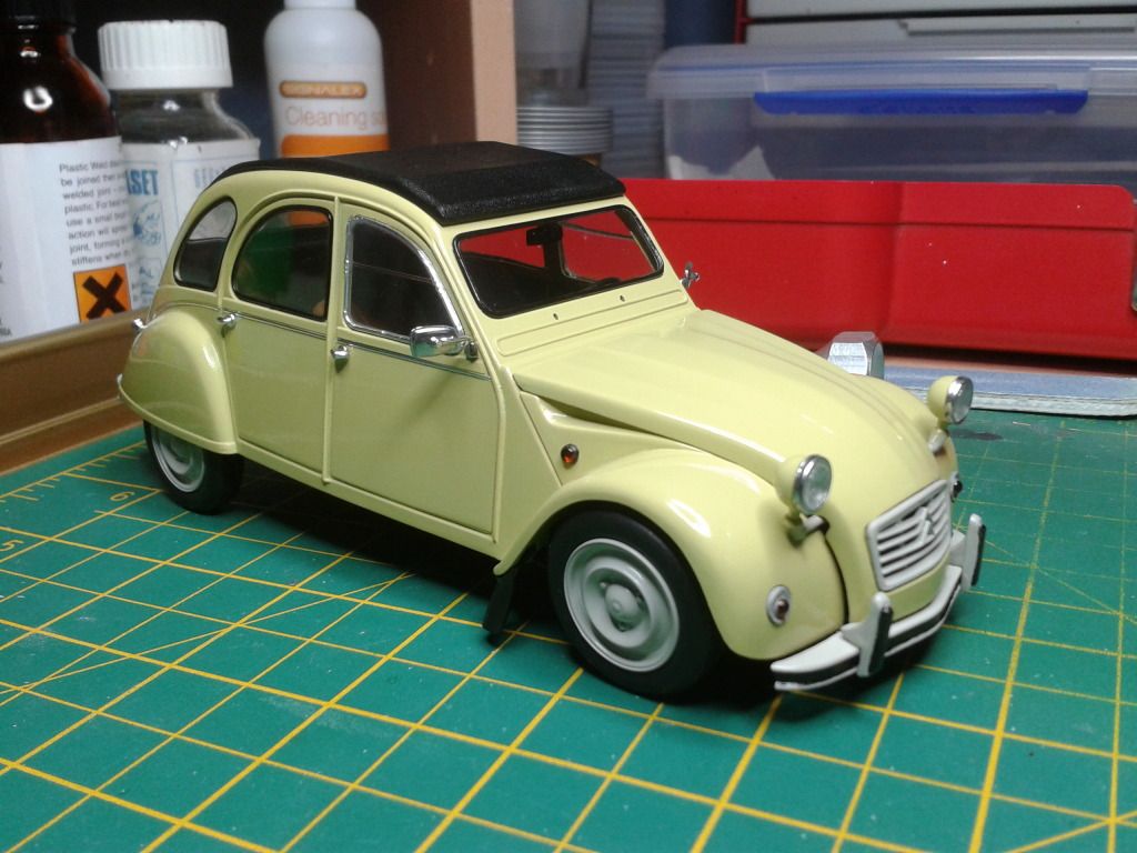

GeeBee Posted September 30, 2012 Author Share Posted September 30, 2012 Right, I think it's about time this build was finished, after taking a break for the summer months to concentrate on my photography, I managed to get in the hobby room and give it a good clean out, and now in 99.9% finished on this one, just the wipers and a few decals to apply .... Quote Link to comment Share on other sites More sharing options...
jonno356SC Posted September 30, 2012 Share Posted September 30, 2012 Looks Great! Love the paint choice! Quote Link to comment Share on other sites More sharing options...
Foxer Posted September 30, 2012 Share Posted September 30, 2012 Nice to see all those 2CV's looked new once! This is looking really good. Quote Link to comment Share on other sites More sharing options...
Brizio Posted September 30, 2012 Share Posted September 30, 2012 Very nice job done! Quote Link to comment Share on other sites More sharing options...
beeRS Posted September 30, 2012 Share Posted September 30, 2012 Nice work Geoff! It's so good to see a build of something a little different (ie.not a big V8 or an exotics). Please show us the finished article when it's done. Quote Link to comment Share on other sites More sharing options...
Ace-Garageguy Posted September 30, 2012 Share Posted September 30, 2012 All your extra detail work is really paying off, bringing this little car to life. Great color. Quote Link to comment Share on other sites More sharing options...
Bernard Kron Posted September 30, 2012 Share Posted September 30, 2012 Beautiful modeling. The precise attention to finishes and detail is an inspiration. I keep a mental list under "some day when I grow up I want to model like this", to which I am adding this one. There's something very liberating about having this much control over fit and finish. It makes it possible to extract the maximum pleasure available from a model car kit, especially this one where there is much crispness of molding and small detail to work with. Thanks for sharing. Quote Link to comment Share on other sites More sharing options...
