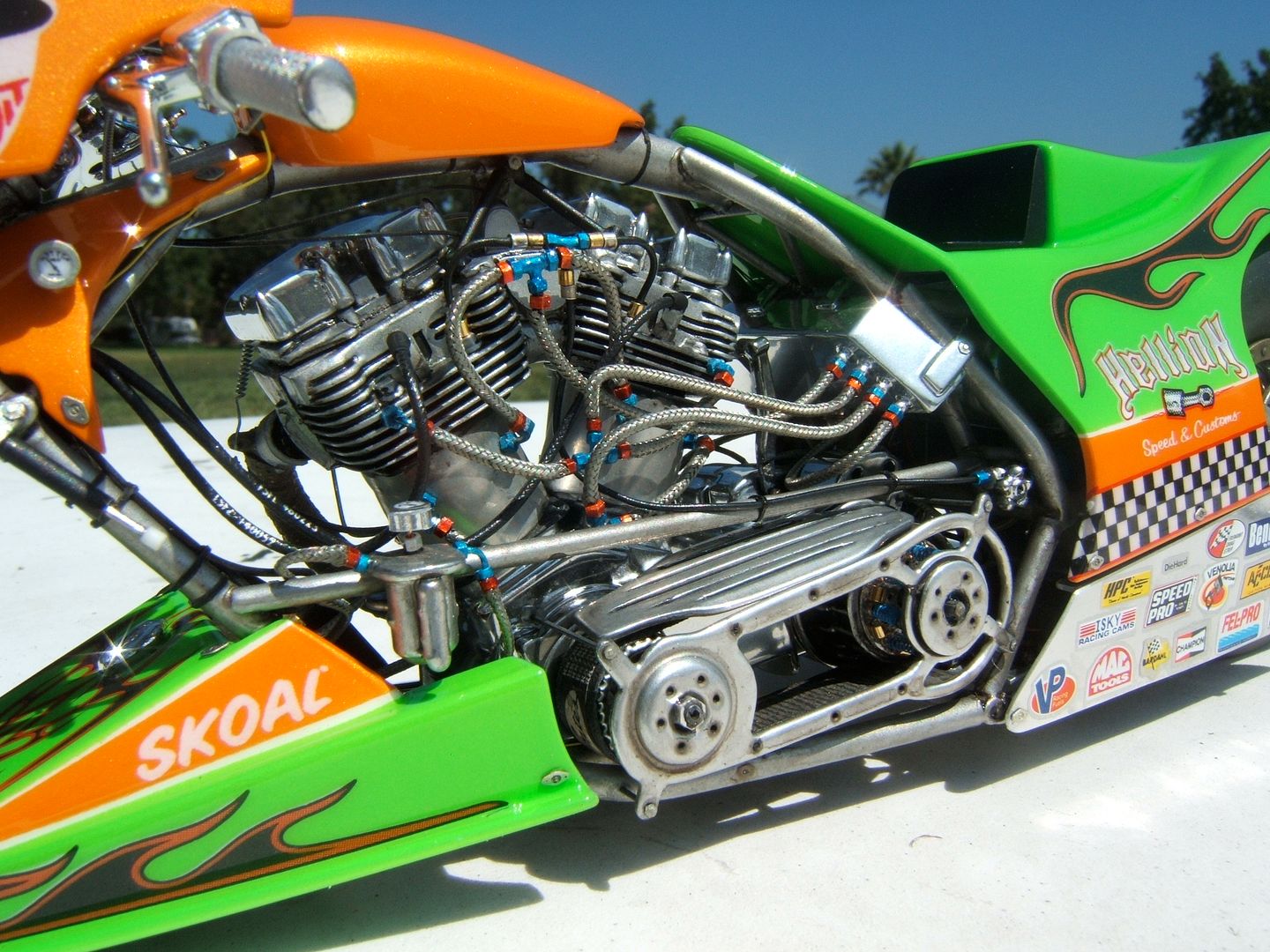

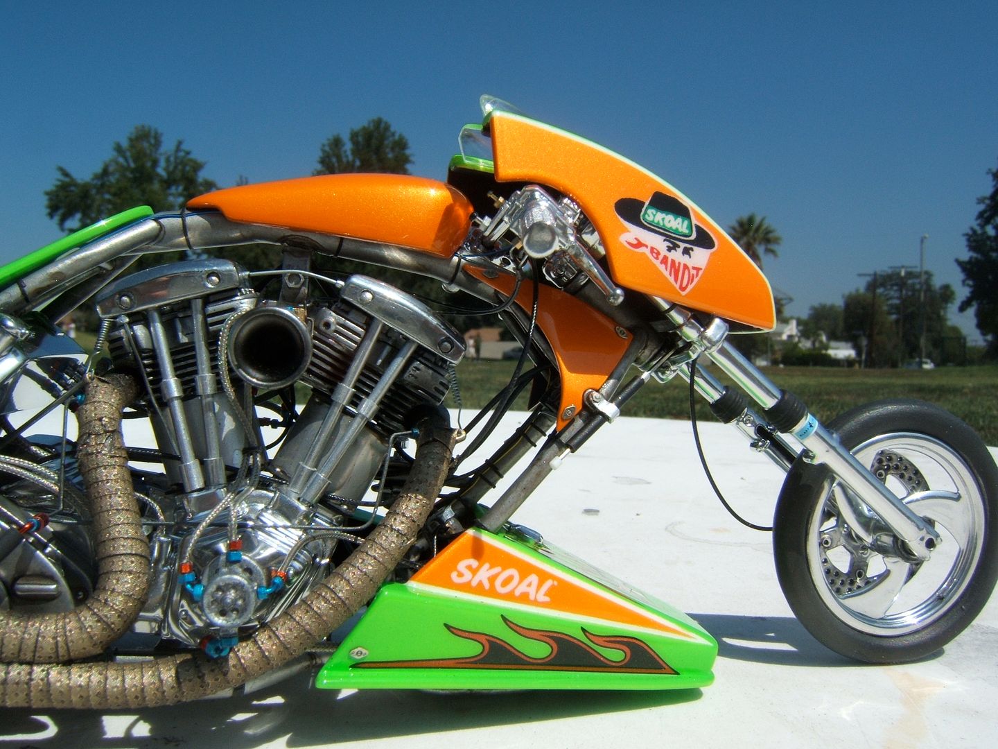

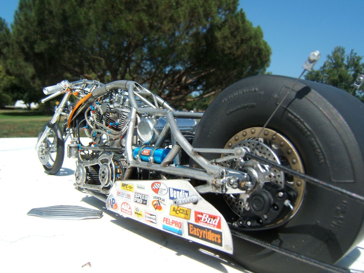

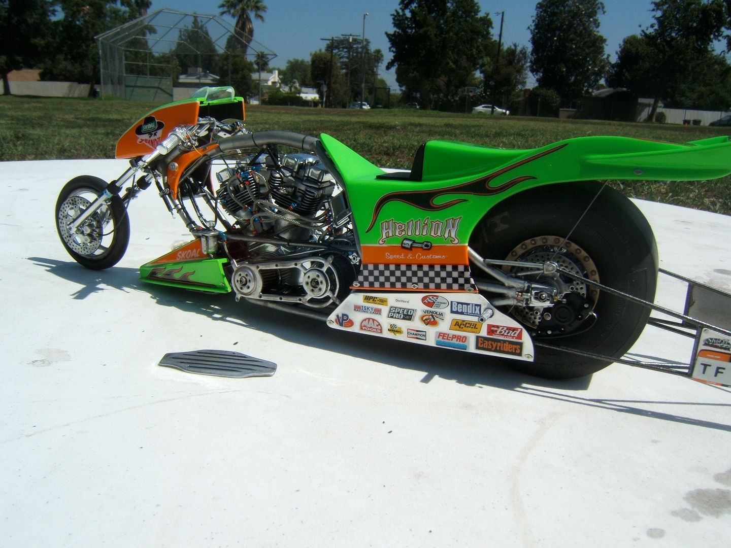

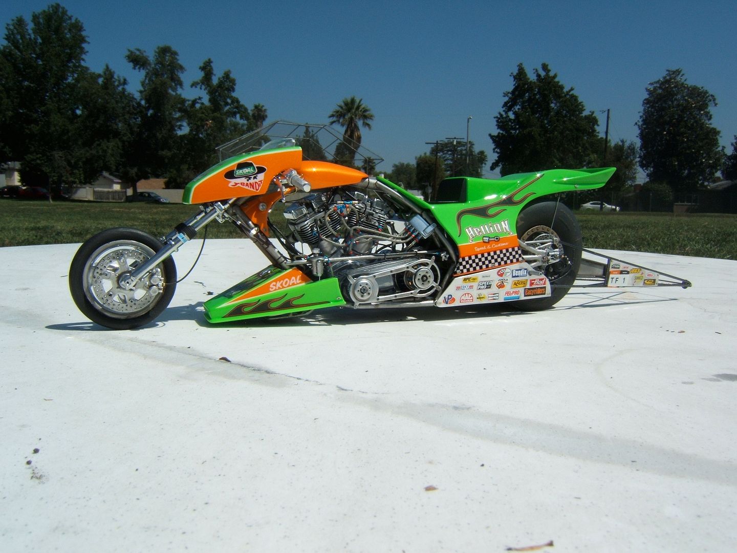

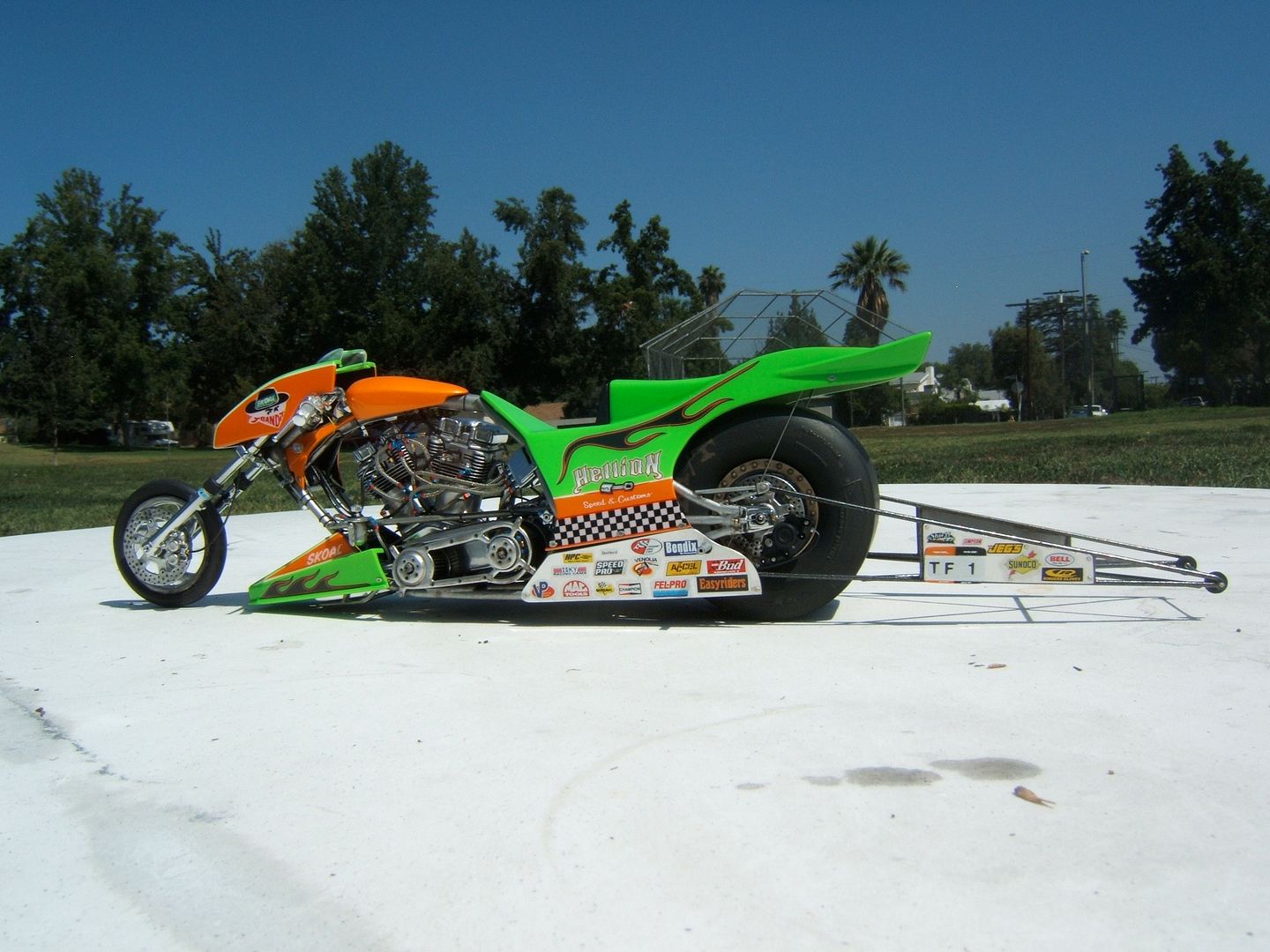

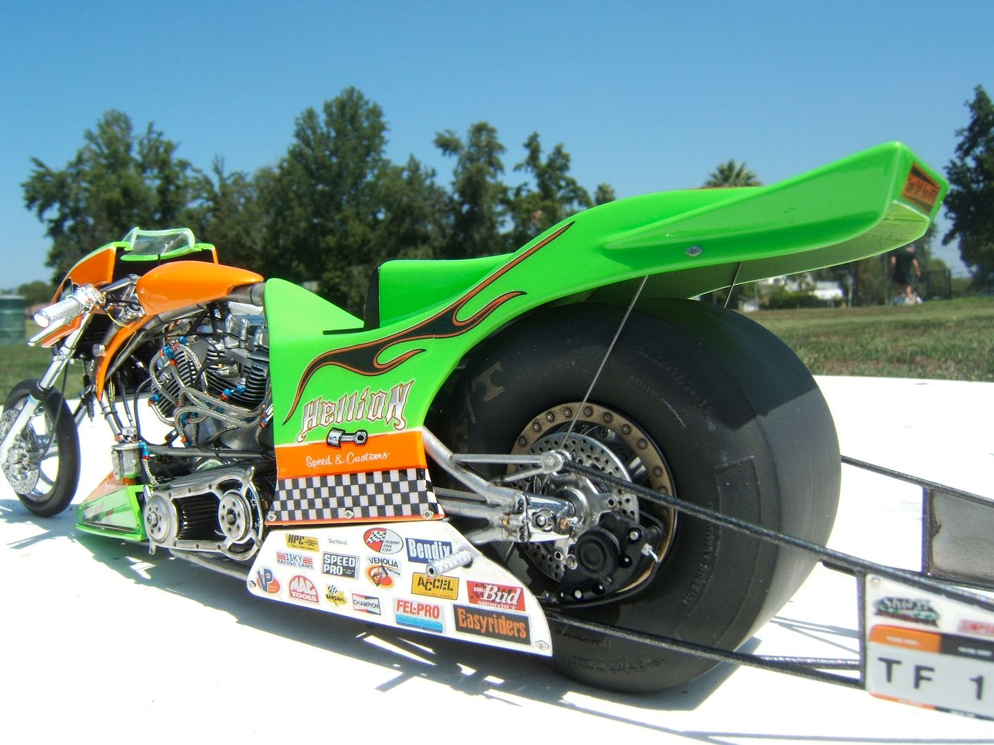

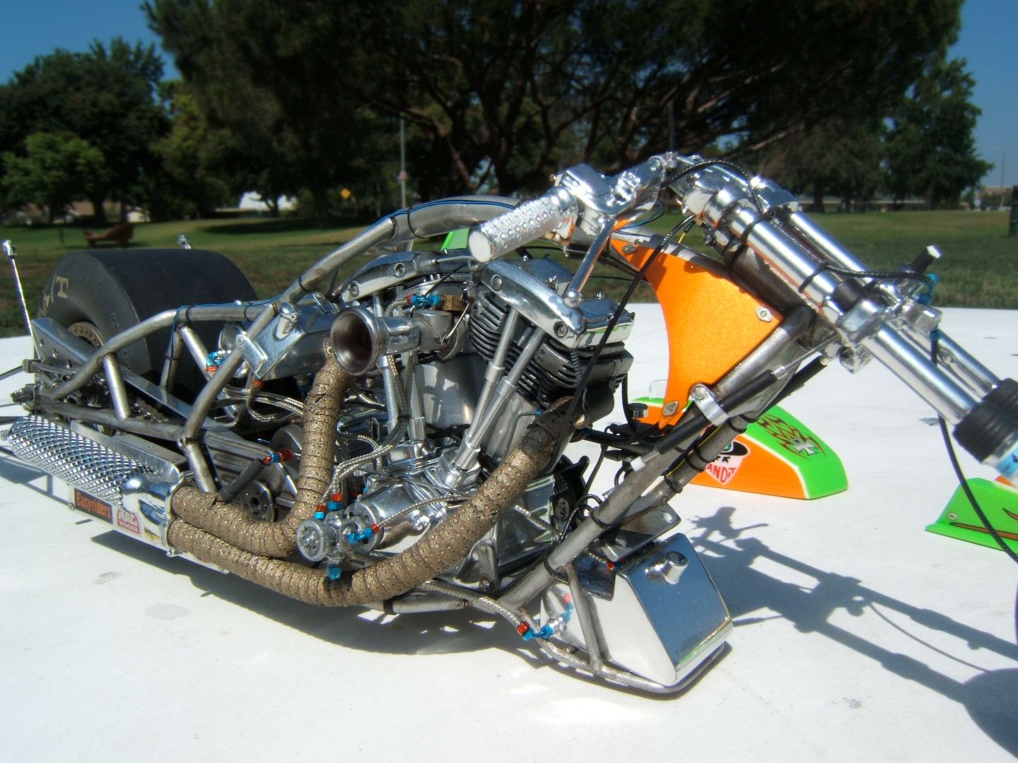

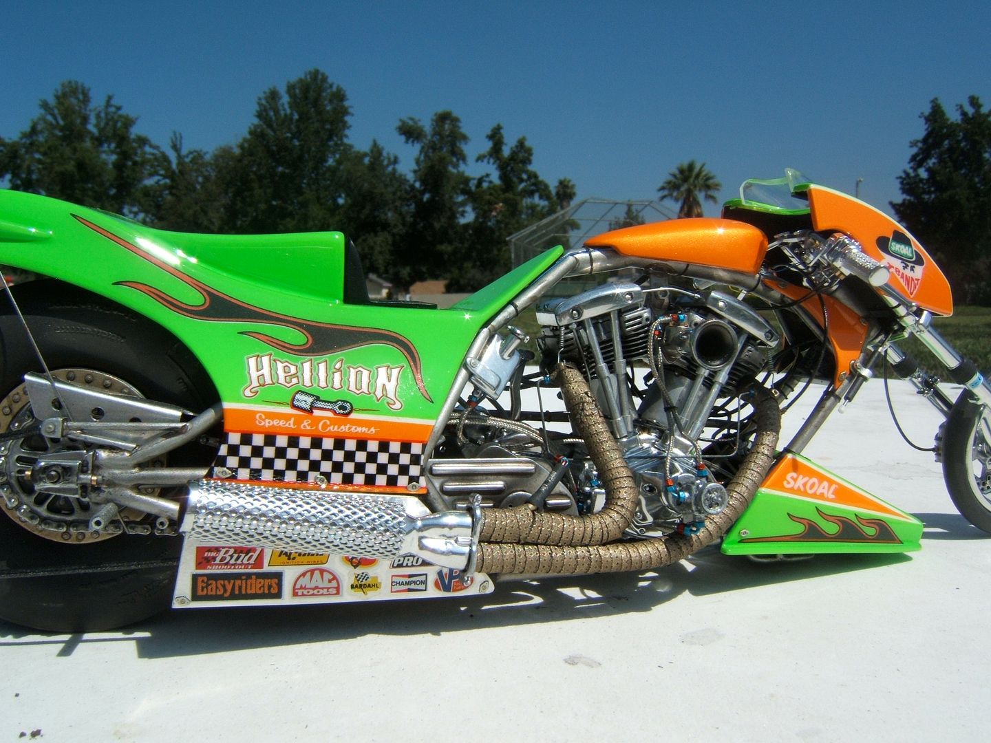

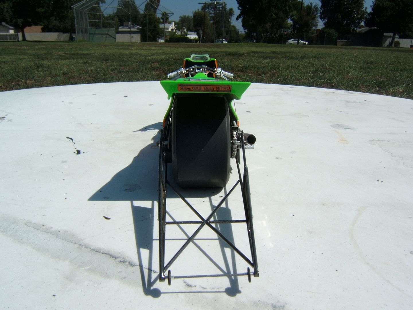

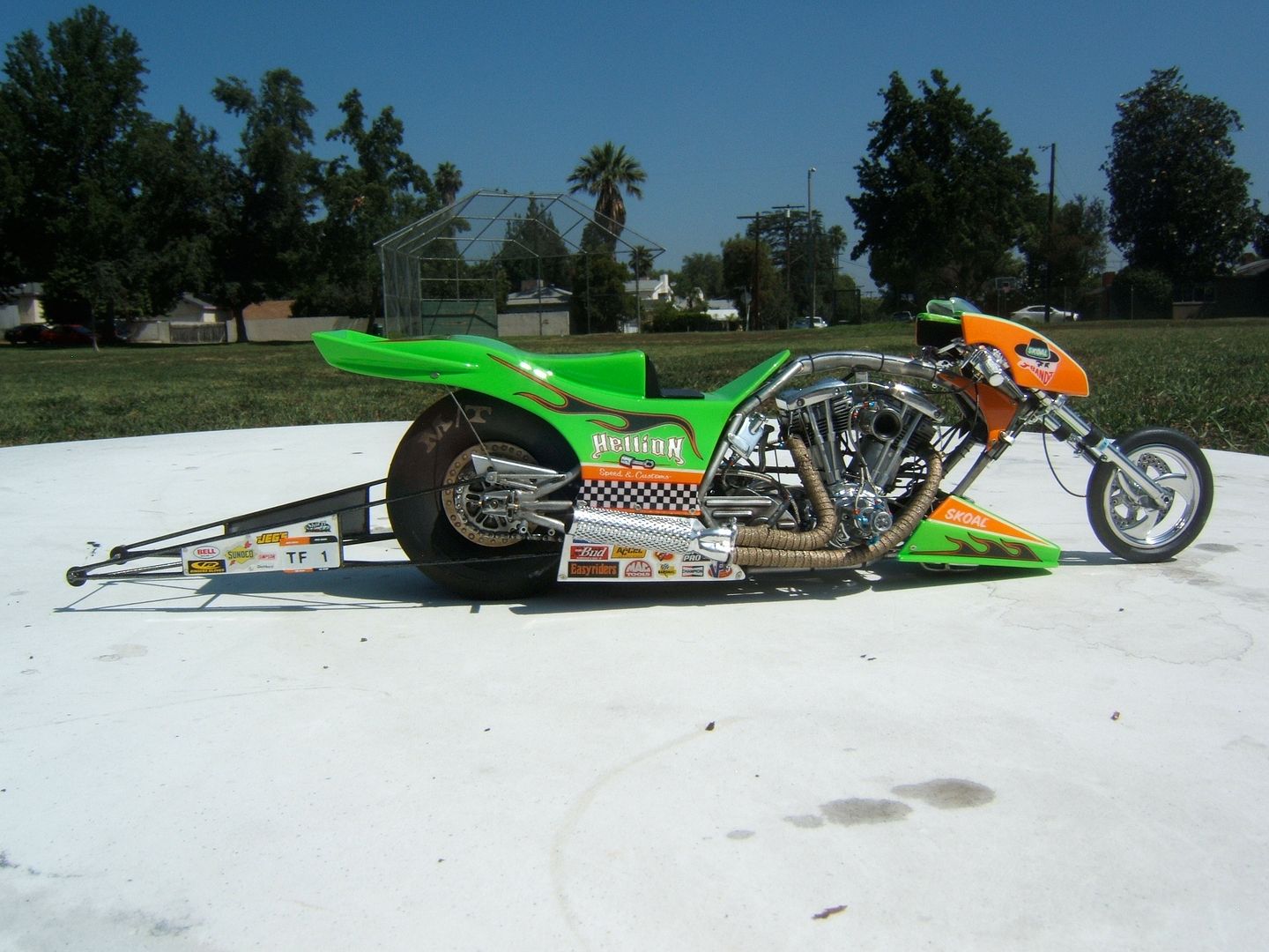

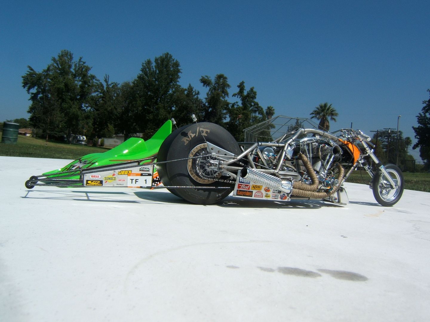

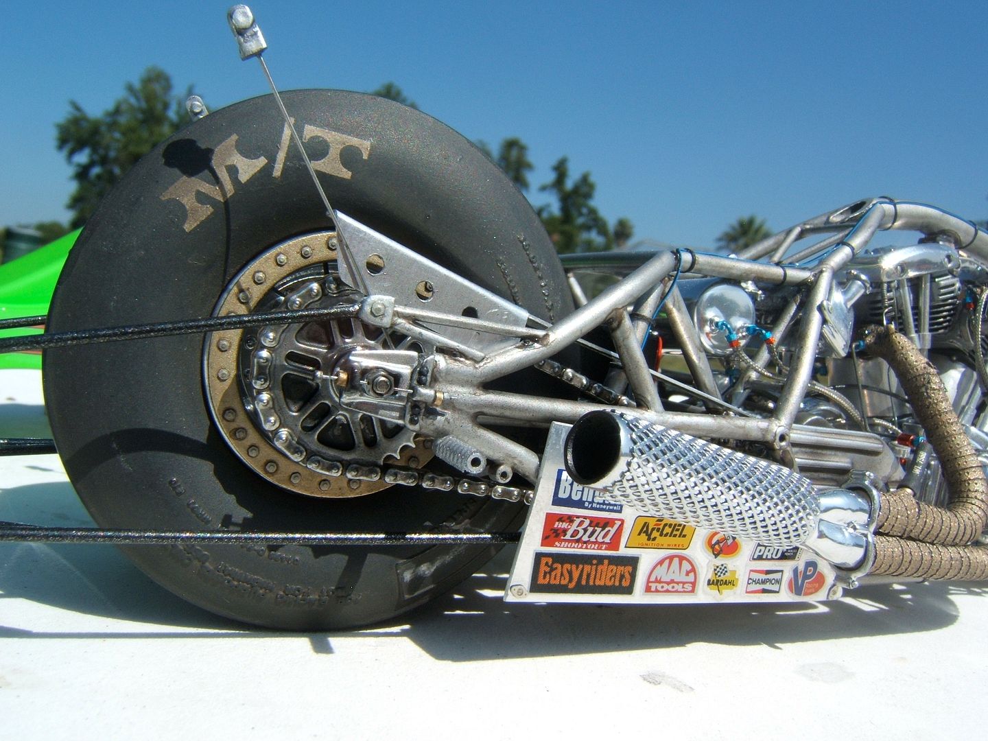

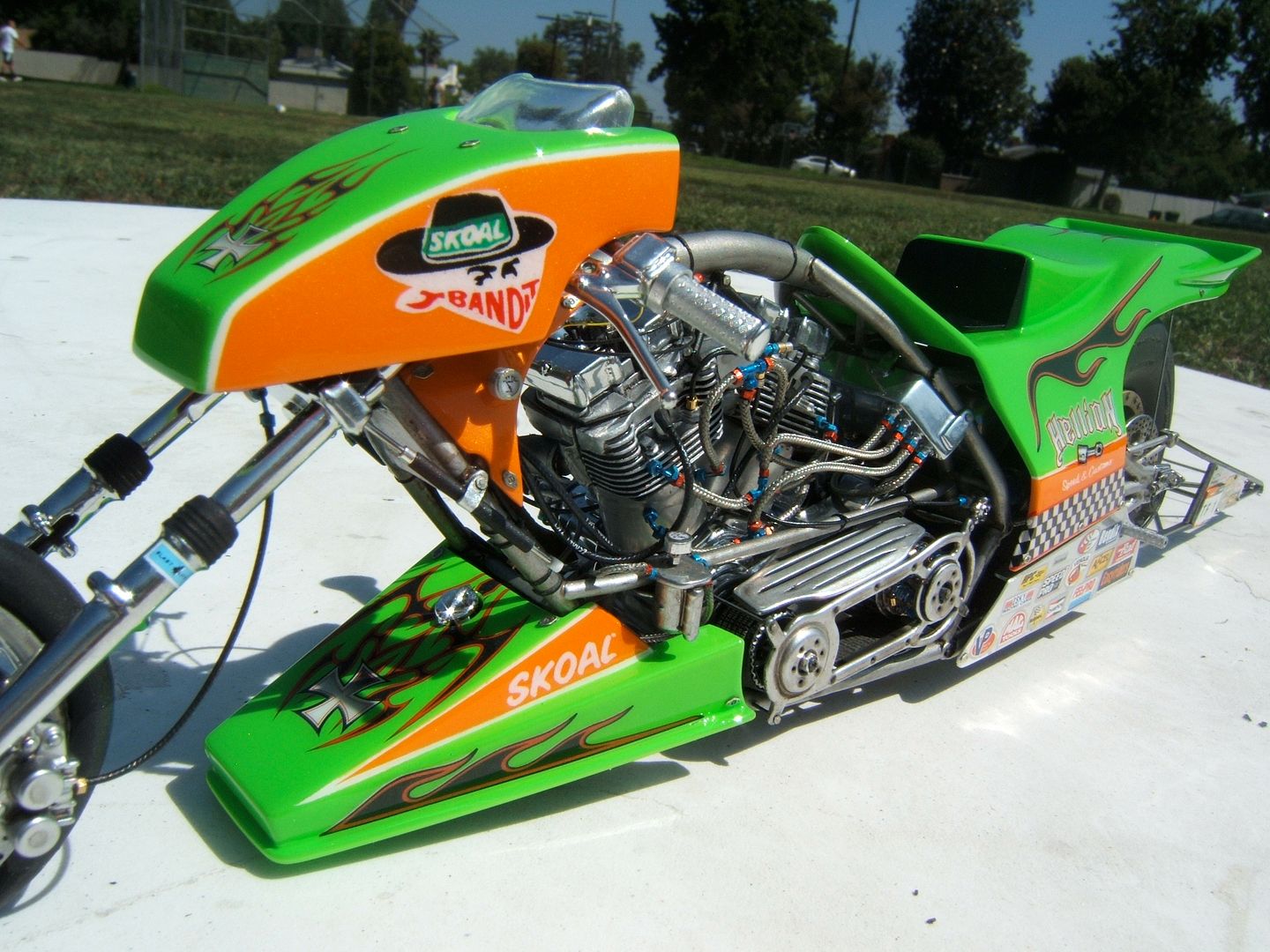

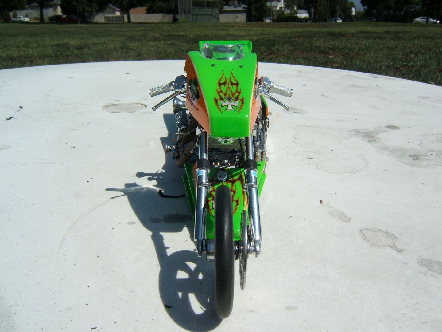

John Teresi Posted July 23, 2011 Posted July 23, 2011 (edited) Hello.....this started out as a Revell 1/12 scale Chopper kit........I converted the Evolution engine into a water cooled ShovelHead engine.....scratch built frame and body.....alot of scratch built stuff to many to mention.......wired and plumbed with "Pro Tech" parts: braided line,rubber fuel line,t`fittings,gauges,detailing wire,nut`s and bolt`s,body fasteners ......H.O.K. white base coat with sunset pearl and Tamiya light green......Slixx decals combined with Revell chopper kit decals........"Flashpoint Resins" rear slick......if you would like to see how I built this bike you can see it in the "workbench" section.......thank you for looking. Edited July 23, 2011 by John Teresi 1
John Teresi Posted July 23, 2011 Author Posted July 23, 2011 Few more photo`s with the body on......thank`s again for looking. 1
Chuck Most Posted July 23, 2011 Posted July 23, 2011 Doesn't look like there's much left of that Revell chopper! I'd ride that thing on the street.

Harry P. Posted July 23, 2011 Posted July 23, 2011 John, I forgot if you already mentioned this or not... but is that a model of a real bike or one you "made up?" Either way, it's fantastic. Totally off the charts!

John Teresi Posted July 23, 2011 Author Posted July 23, 2011 (edited) John, I forgot if you already mentioned this or not... but is that a model of a real bike or one you "made up?" Either way, it's fantastic. Totally off the charts! Harry........just a "made up" bike from a couple dozen pictures off the web.......my idea for the paint.......thank`s. Edited July 23, 2011 by John Teresi
Harry P. Posted July 23, 2011 Posted July 23, 2011 Harry........just a "made up" bike from a couple dozen pictures off the web.......my idea for the paint.......thank`s. Your eye for detail is amazing. This could have been a "Real or Model" subject. One more question... you used Alclad for all the "chrome," right? What do you use as a base under the Alclad?

John Teresi Posted July 23, 2011 Author Posted July 23, 2011 Your eye for detail is amazing. This could have been a "Real or Model" subject. One more question... you used Alclad for all the "chrome," right? What do you use as a base under the Alclad? Harry.....the base is "Osh" brand black enamel spray paint......with RM 3 part clear coat........then the Alclad......thank`s
Sixx Posted July 23, 2011 Posted July 23, 2011 AWESOME John!!!!! Geez, I feel off of my chair!! Hey man, how the heck did ya do the drive belt??? that looks real!!! Sixx

John Teresi Posted July 23, 2011 Author Posted July 23, 2011 AWESOME John!!!!! Geez, I feel off of my chair!! Hey man, how the heck did ya do the drive belt??? that looks real!!! Sixx Derrik......I used medical bandage wrap........i cut a piece...... folded it in 1/2 to the size i needed.......then painted one side with "Folk Art" black acrylic water based paint......then on other side.......I painted light grey "FolkArt" ............. from Michaels crafts store......cost around 89 cents a bottle...... then on the grey side I drew with a fine black ink pen lines that would appear to be groves in the belt.......I kinda messed that up though .......i drew the lines on it after I had .glued it to the pulleys ......i should have drawn the lines on it before I glued it down......they would have looked straighter.......I could fix it but......when the shield cover is on you can`t see the crooked lines......thank

Ben Posted July 24, 2011 Posted July 24, 2011 Wow John, another gorgeous build!!!!!!!!! How did you make the header wrap?
