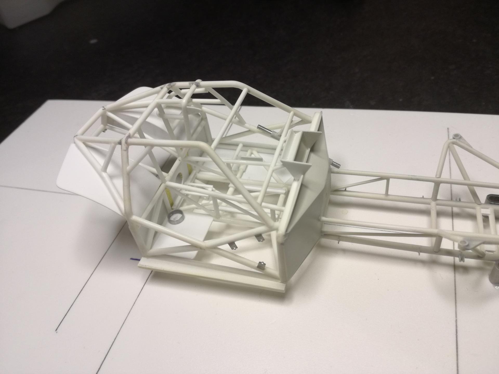

Small update on this one...and thanks for all comments!
Carbon tubs made from .020" Evergreen sheet.
Mockup.
Koni control box.
/ Rick

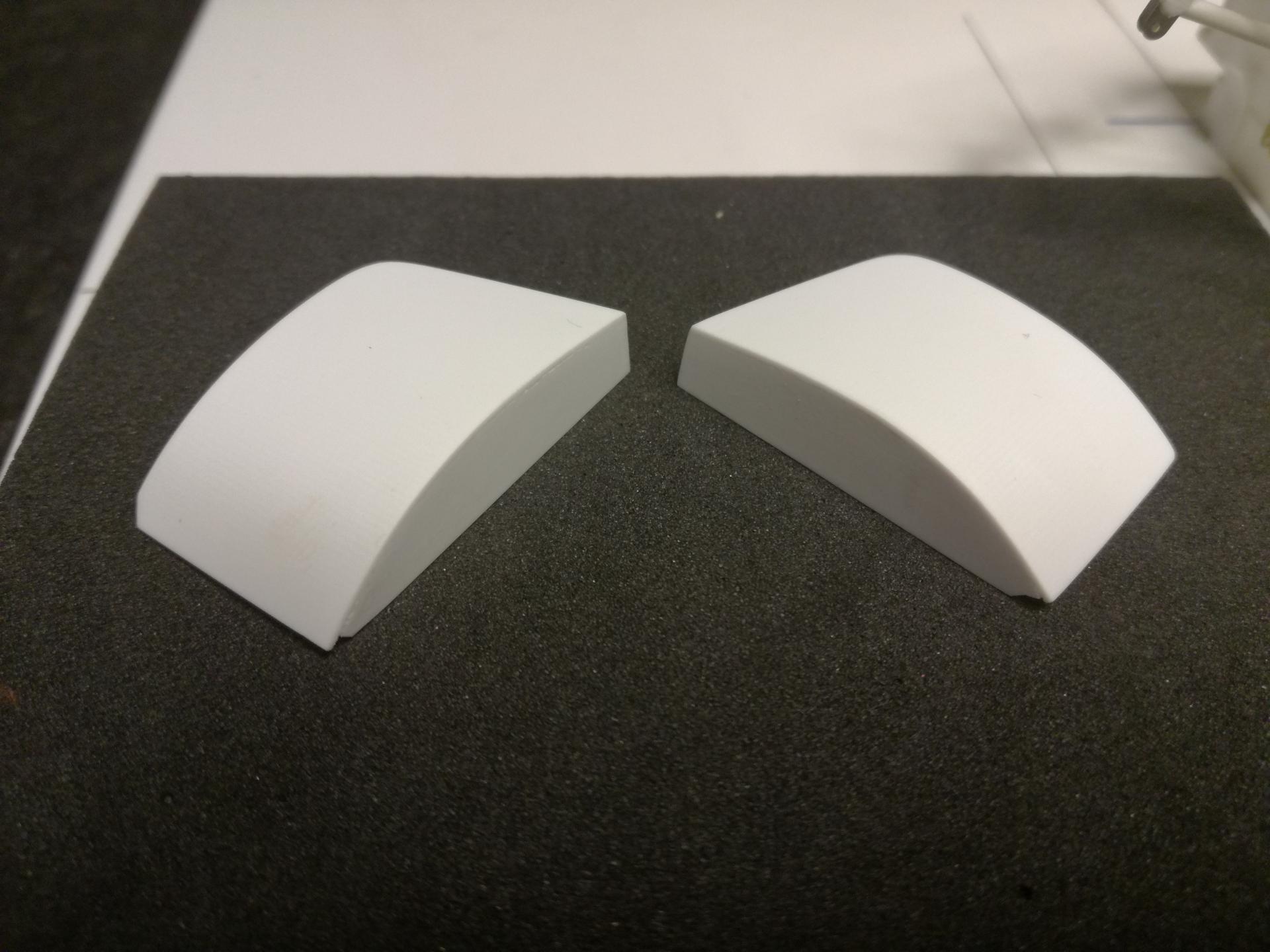

When I cut the doors open on the body it turned out exceptional bad and ugly. The doorgap was sooo uneven and rough.
Some weeks agoe I got an idea how to fix this problem...that probably should work...bodyfiller and aluminumtape.
I started to get the opening on the body as perfect as I could. I sanded the edges and curves smooth and made the opening just the way I wanted.
Now I want the same shape on the door as on the opening...and all bodylines must blend in perfectly.
I covered the thinn edge with aluminum tape all arround the opening.
I mixed the bodyfiller/hardener and added a few drops of aceton to get the filler thinner.
Then I applyed the filler on the aluminum tape and gently fixed the  door in the opening.  IMG_20181226_212637.jpg.d316e99efb70de088fc69cc253efcd03.jpg
I let the filler cure about 1h before I removed the door from the tape.
After some cleanup and sanding it was time to try it on.
...some minor adjustments required, but I think it turned out great...
