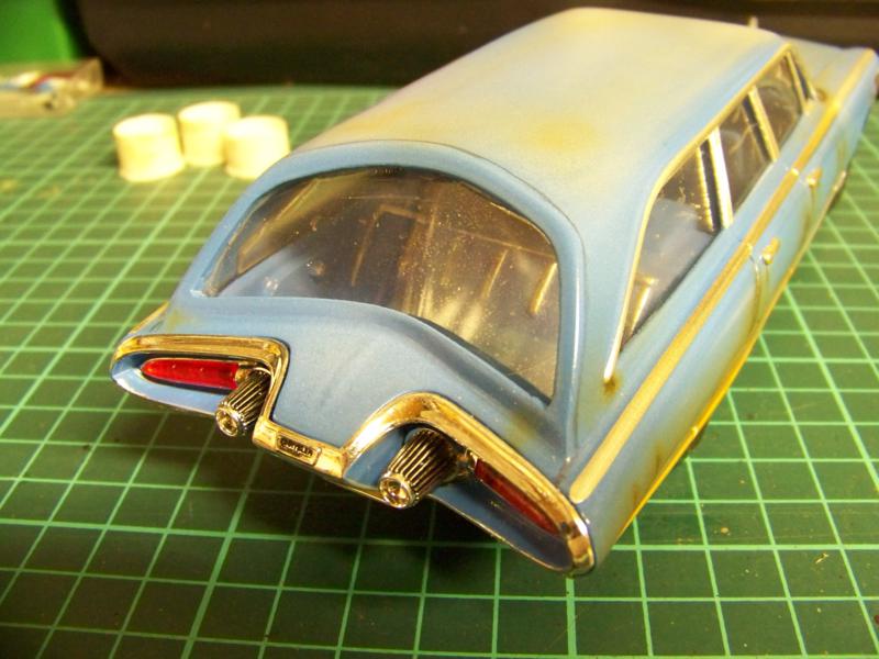

Hi,
here is my idea to open the hatch. It is not practical and more a lifestyle wagon:
There only swings up the part obove the bumper and a small frame around the rear window. The Bumper will be on there place.
I know, to load heavy and big things isn't possible. But if you look into the trunk....sooo much room isn't there and no seats to fold down ;)
Lifestyle wagon - the only purpose is to look good and make the neighbors envious :D
Edited by Dominik
Link to comment

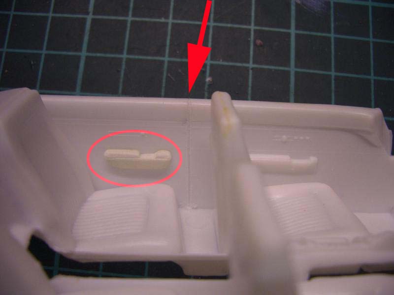

Thank you for comments!

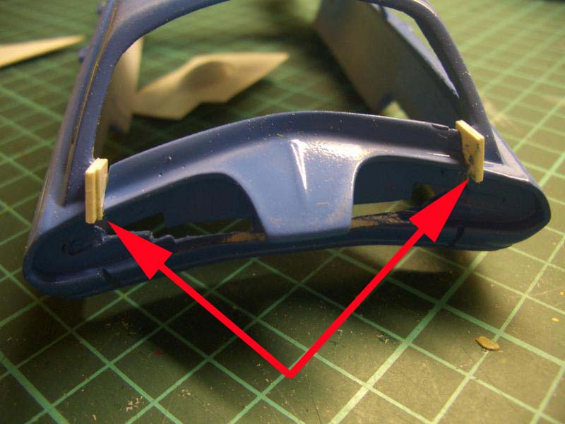

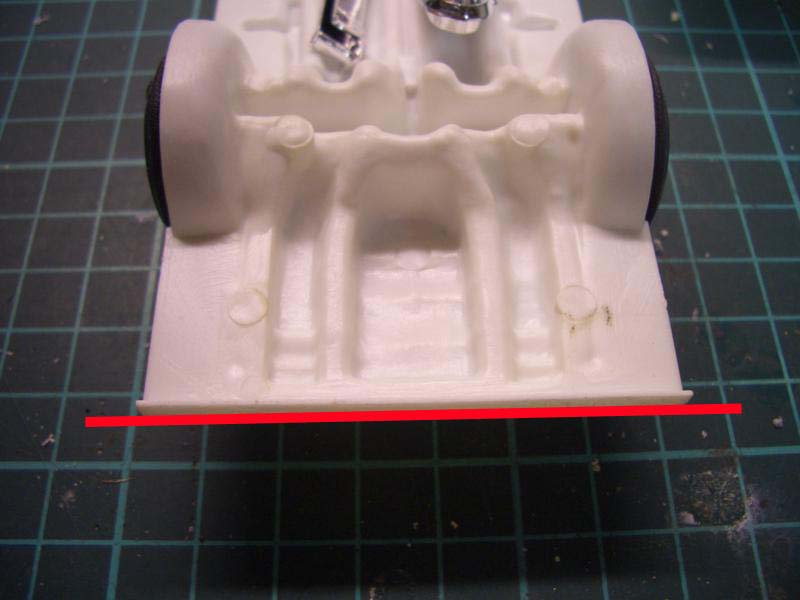

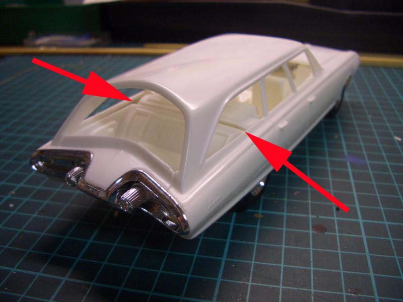

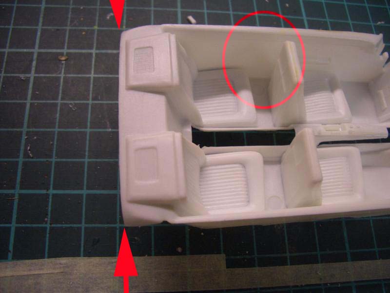

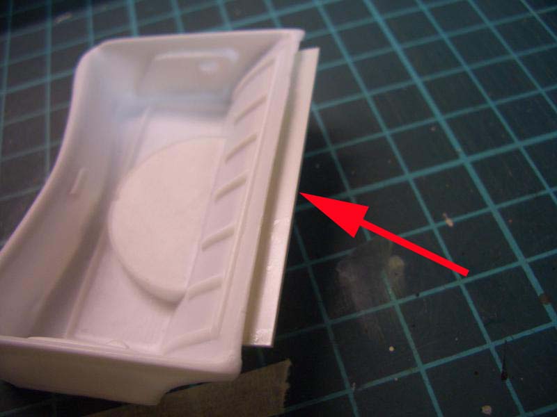

Ian, here i have some pictures of the EZ-Kit, what is the base of the body with the changes, to fit the interior and the underbody.
-> I cut the back tips of the underbody (red line)
-> i cut the rear tray behind the headrests (red arrows). the circle marks, that there is no fold from the (2-)door!
-> i glued a streak of sheet on the trunk
-> i fixed the body with the two parts of the interieur, to take some points of glue for fixing the trunk to the interieur
This gap i stabilized with sheet from the bottom, to fill it on the top with putty. That was the trickiest part of all, the upper line of the interieur similar to the windows looks "perfect"
-> next, i build a armrest for the rear doors (red circle) for both sides and scratched the doorline similar to the outter doorline (red arrow) into the interieur
-> last i filled the gap at the back with sheet, sanded it and made the rest of the boywork for finish
Thats it. I hope, this is understandable and useful, to make your Turbin a cool locking phantom
