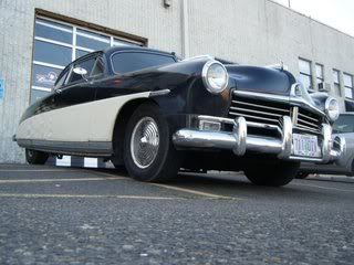

sobpinstriping Posted November 26, 2011 Posted November 26, 2011 I got mine yesterday! I have a custom 1950 chevy truck to finish (hopefully tonight) and I'm gonna jump on the hudson. A guy I know has a 49 which is close (diffrent grill, dash, taillights, rear window etc....) so I'm gonna build it for him. I'm so exited to get started!
