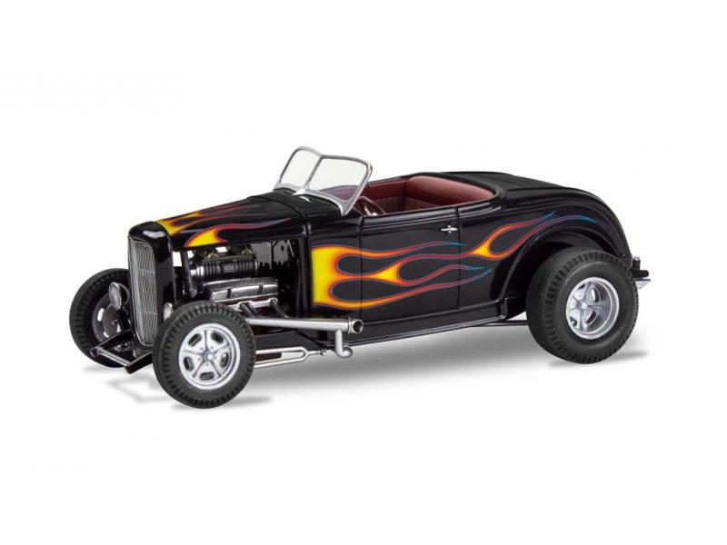

keyser Posted April 10, 2022 Posted April 10, 2022 Doesn’t seem much work to make this: https://www.mecum.com/lots/FL0119-359622/1932-ford-mcmullen-roadster/
tim boyd Posted April 11, 2022 Posted April 11, 2022 (edited) 8 hours ago, Dennis Lacy said: .... his roadster is an identity crisis. As Dennis said above, "...his roadster is an identity crisis." Couldn't agree more. Not one of the many (at that time) hot rod mags featured his original 1/1 car to my knowledge. Which is a pretty good sign of how it was viewed by most of the hot rod cognoscenti, Dennis and I included. Revell has long been looking at ways to repurpose their original tooling investment here. I pitched converting it to the McMullen roadster as a hail Mary, but many issues, starting with where to go to get copyright approval, killed that idea before it ever got off the ground. I think this version pictured above is a very nice resolution, and I predict it will sell well to scale hot rod enthusiasts.... TIM Edited April 11, 2022 by tim boyd 1

Fat Brian Posted April 11, 2022 Posted April 11, 2022 The Rat Roaster looks like a car designed for TV by a guy with a mullet. The improvements are very nice, if it still has the stacks with the air cleaners on top I'll get a couple more. 1

niteowl7710 Posted April 11, 2022 Posted April 11, 2022 3 minutes ago, CabDriver said: I'll be interested to see if they update that airbagged rear end - have we seen shots of the rear suspension yet? Again the only new parts are the ones show on the CAD drawing. The windshield, interior parts and exhaust. Otherwise it's the same kit. 1 2
bobthehobbyguy Posted April 11, 2022 Posted April 11, 2022 Looking forward to getting at least one of these. The new oarts look cool.
Rocking Rodney Rat Posted April 12, 2022 Posted April 12, 2022 On 4/10/2022 at 2:34 PM, keyser said: Doesn’t seem much work to make this: https://www.mecum.com/lots/FL0119-359622/1932-ford-mcmullen-roadster/ It would be easier to start with the original 'Rat Roaster' version of the kit with the stock windshield and body with the mounting location divots for the windshield than the new rendition. -RRR 1
