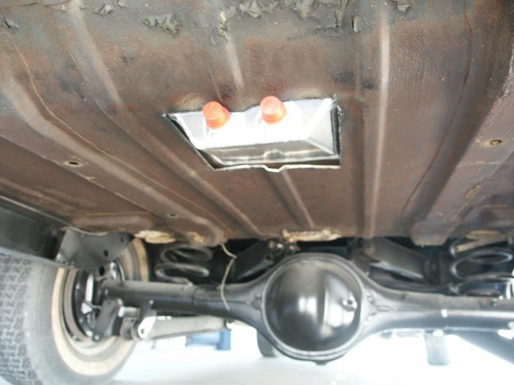

Thats clearly not a factory stock vehicle, so why leave the center section that horrid brown primer ??? why not just paint it to match the rest of the suspension, or even the body color if you want it to stand out.
I have always painted that part red oxide becuase that is the way I have always seen it. And I like to paint it this way. The extra color adds interest to a chassis that is mostly different shades of grey or black. But possible some came from the assembly line unpainted or painted in black. Make me wonder where people who restore car get they're information. Even floorboards. Some are red oxide, some are grey, some are black and some are body color. Who knows whats correct for a certain year make. Just paint it the way that pleases you.
