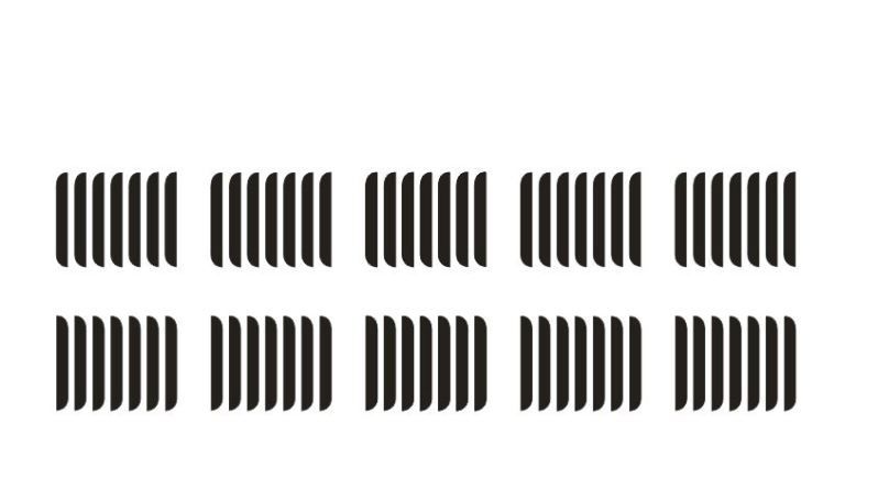

roadhawg Posted July 26, 2012 Posted July 26, 2012 Personally, I don't see why a well made decal wouldn't work just fine, especially on a darker colored car. It would give the appearance of vents without all that tedious work, and you couldn't tell the difference without actually touching it. Since it would be black, you could consider printing them yourself.
CorvairJim Posted July 28, 2012 Posted July 28, 2012 I have that resin kit too. I have no idea who made it, but it's definitely not a one-of-a-kind. I've seen a couple of them built up at CORSA national conventions over the years. Frankly, I'm not too impressed with it. I'm even considering trying my hand at converting an old '61 Corvair sedan promo to a Lakewood usning the roof from the Jo-Han Olds F-85 wagon. GM used the same roof panel, so if they both scale out the same (they're both supposed;ly 1:25), it should go fairly smoothly after I figure out how to do the rear of the car correctly. That's going to take some doing since it's so different from the sedan. As for the louvers, I'd just try to mask 'em out precisely and use a Sharpie! Smoother than paint and easier than making the decals. (I had a 700 Lakewood once, too. I had it for all of a month, and more than tripled my money on the car... Bought it for $300 in mid-1984, sold it for a cool grand!)
roadhawg Posted July 28, 2012 Posted July 28, 2012 As for the louvers, I'd just try to mask 'em out precisely and use a Sharpie! Smoother than paint and easier than making the decals...... Not really. Here, I've done the hard part for you (if you can call 3 minutes hard, lol.)....all you have to do is size and print them.
