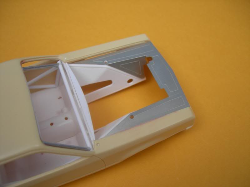

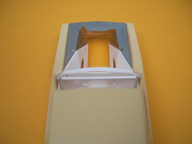

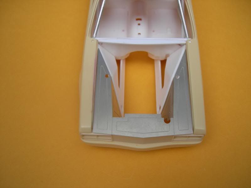

Well - I've got an update. In terms of major construction progress, it isn't, but in terms of psychological progress, it is significant. I got the PE nose tin soaked free of the rubber backing and got it more or less bent to the proper configuration. It may need a tiny bit of tweaking, but not much. So far it has passed the test... Now, will the radiator fit? LOL
